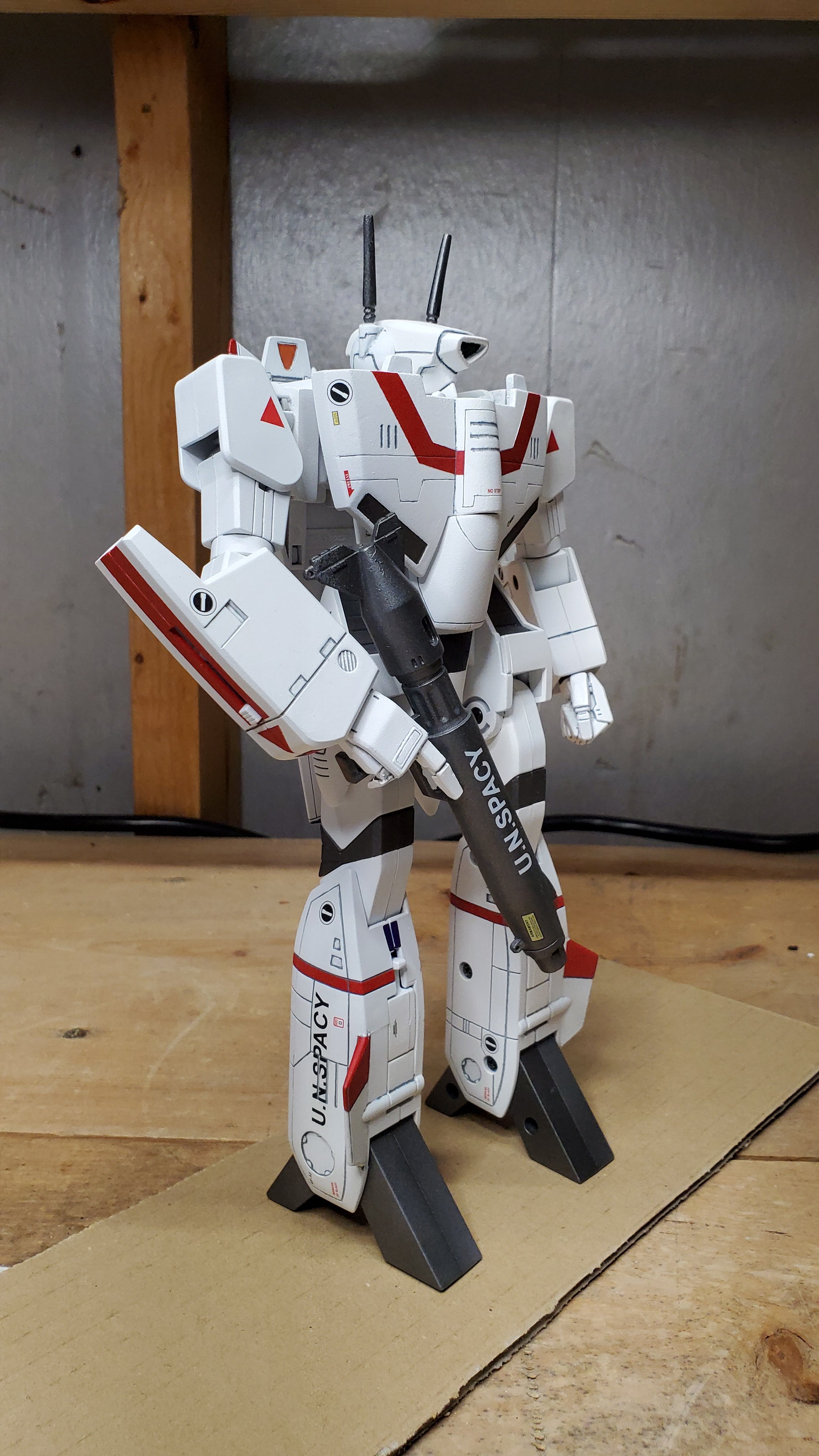

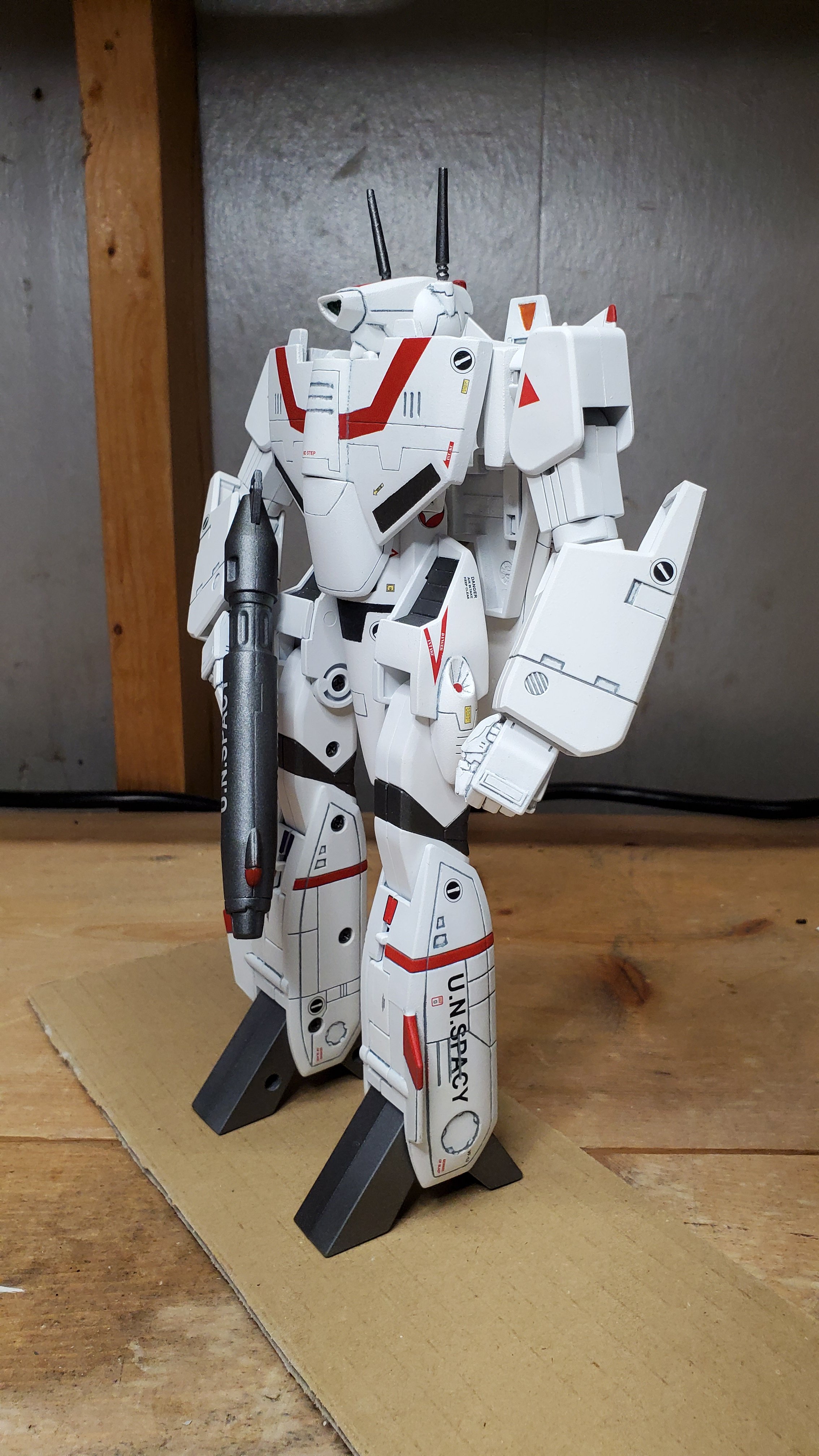

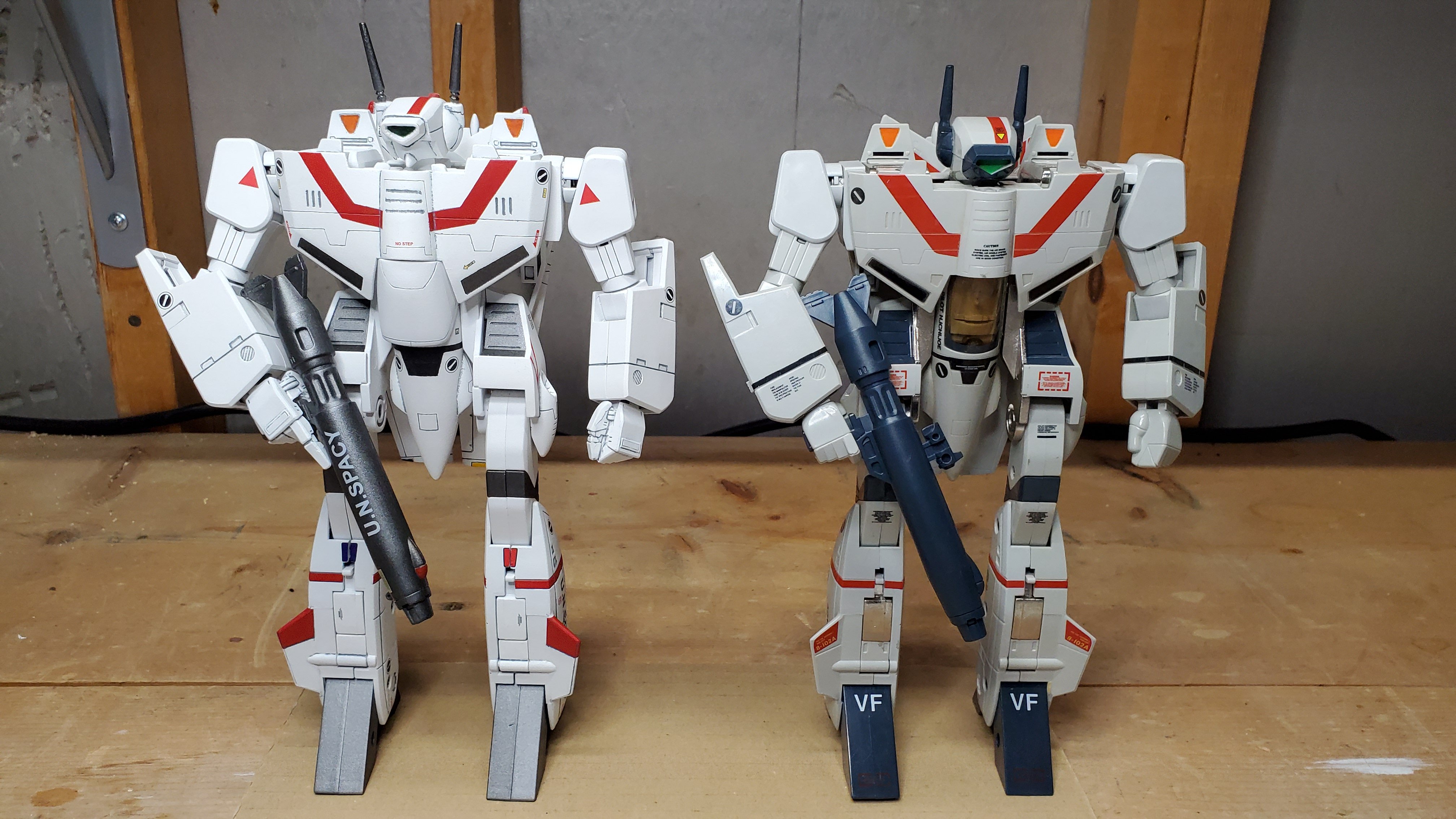

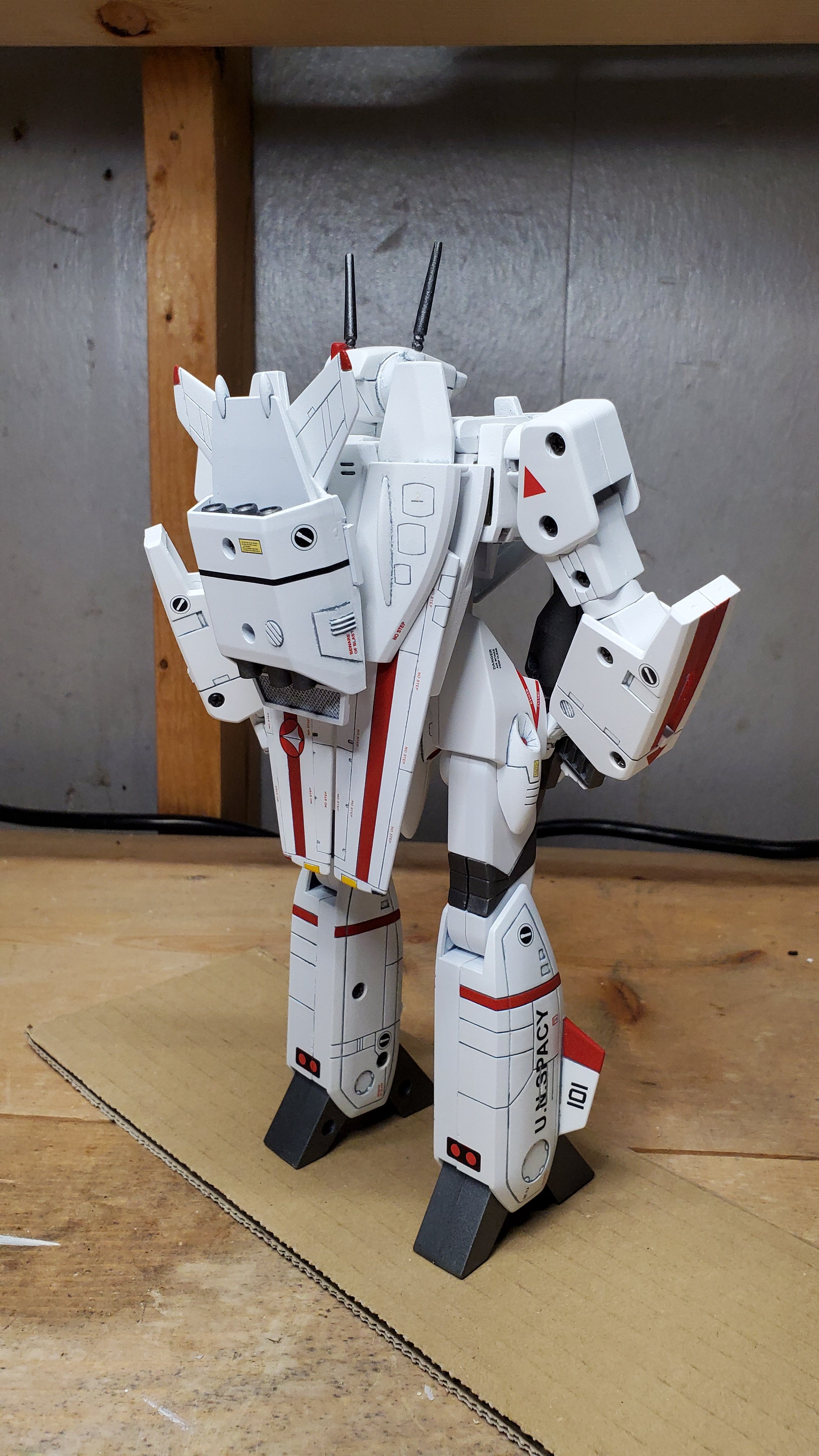

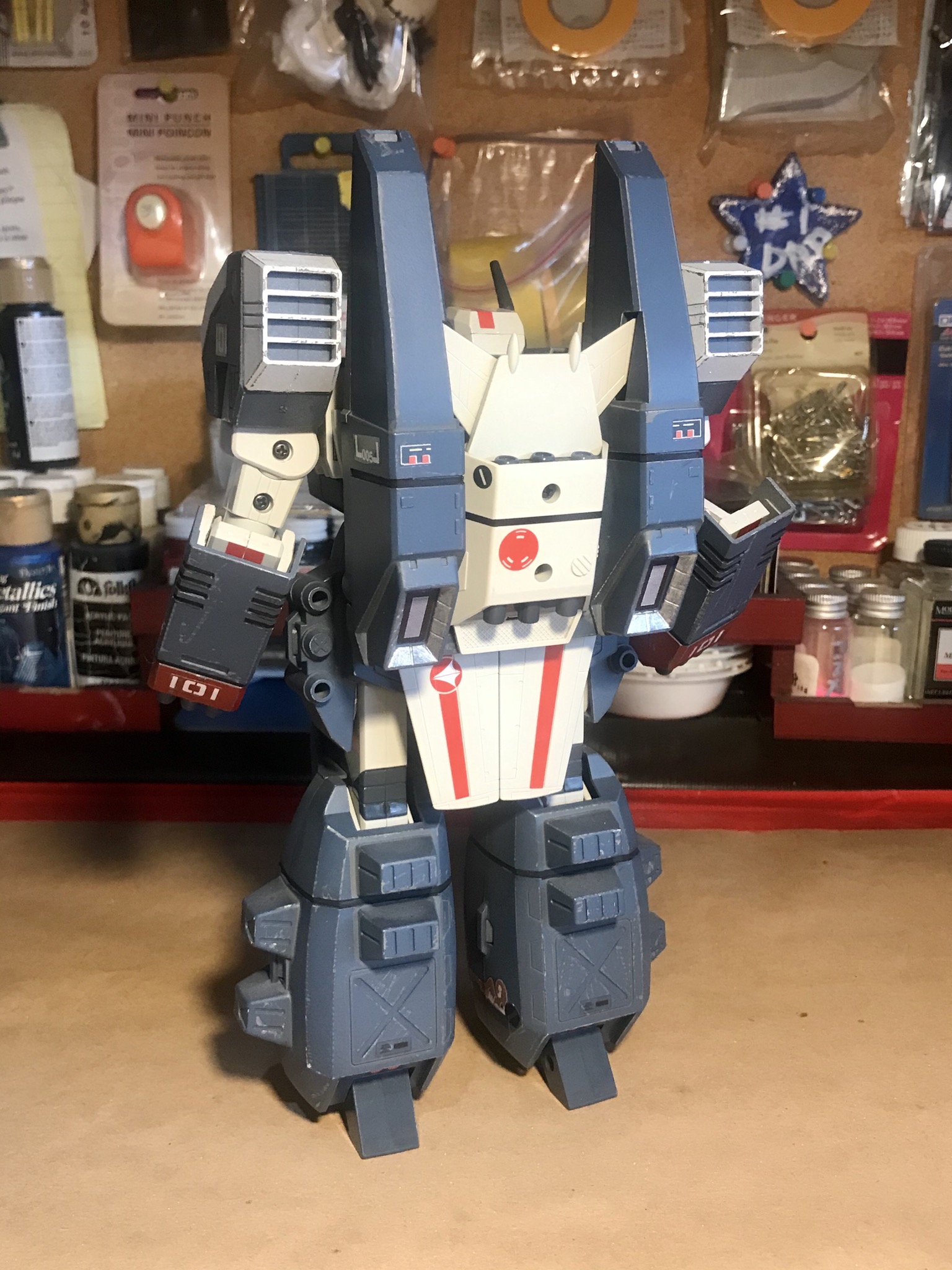

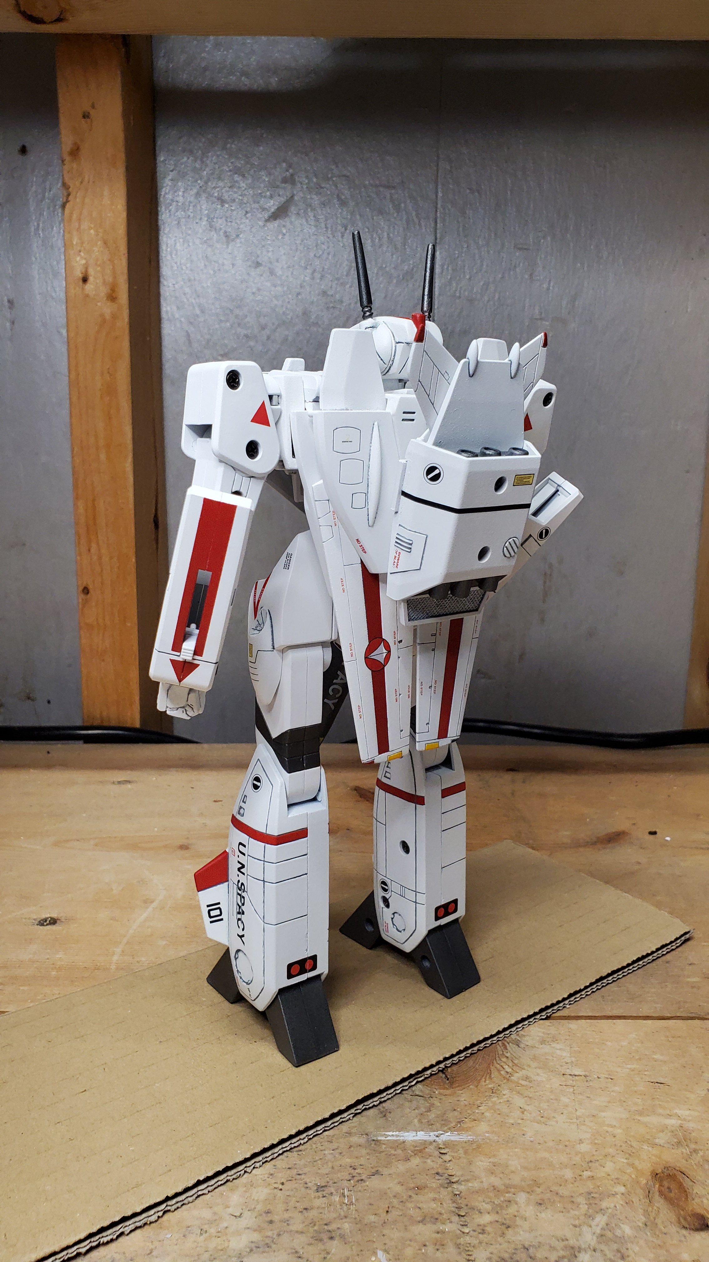

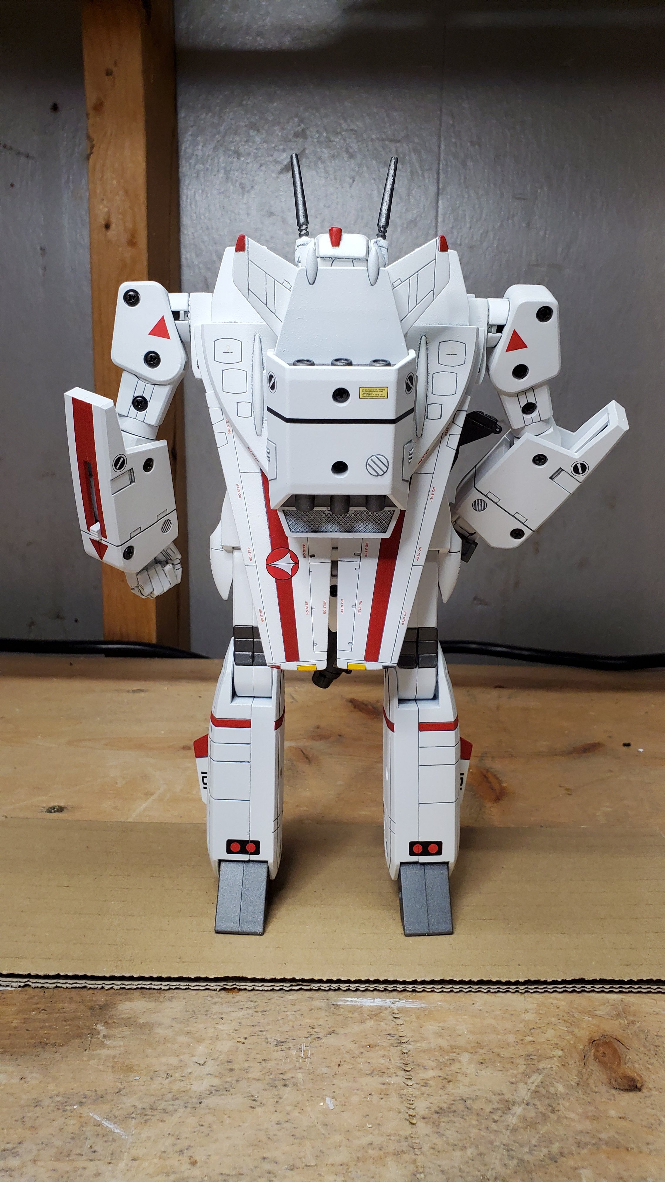

Anasazi37 Posted September 21, 2020 Posted September 21, 2020 Before the Bandai 1/48 DX and 1/100 HM/HMR lines, the Arcadia 1/60 line, and the Yamato 1/48 and 1/60 lines, there was only the 1/55: the Chunky Monkey. Not long after I joined MW in 2001, I started seeing all of the awe-inspiring 1/55 customization work happening and wanted to try it myself. I bought some beat-up Jetfires on eBay and started acquiring resin parts so I could recreate the entire original lineup of Takatoku and Bandai valks, because the alternative was to spend A LOT of money trying to track down rare ones like the Super Ostrich, Elintseeker, and VF-1S Strike. Plus, I thought it would be fun to do something this challenging and creative. I continued acquiring parts and eventually got my hands on a dozen Bandai reissue valks so I'd have enough to recreate the lineup, plus a few more variants that were never made. That's actually the origin story for all of the decal work I've done for this community: I needed decals for my own 1/55 customs. Printing decals for MW members quickly ate up my available hobby time, as did working on Yamato 1/60 and 1/48 customs for members. I put my own customs on hold, promising myself that I'd get back to them soon. Life interfered, as did work, and suddenly it's the fall of 2019 and I have no customs of my own. So, I kicked off a project to complete the entire lineup and the first one is finally done (see pictures below). As I complete the others, I will post pictures of them here. I have thirteen planned: VF-1J Hikaru VF-1J Max VF-1J Milia VF-1A Cannon Fodder VF-1A Max TV VF-1A Hayao TV VF-1D VF-1S Roy Strike (I prefer it to the Hikaru and having a TV Roy as well seemed redundant) VT-1 Super Ostrich VE-1 Elintseeker VF-1S Blue Roses 002 Strike VF-1S Minmay Guard Paris Act VF-1J Hikaru with GBP Part of my reason for making all of them is to work on, and finish, a project that has a lot of meaning for me. Another part is to show the 1/55 some love, making it look its absolute best. I have some crazy-fun, super-rare resin parts that I'll be using to help with that, like a highly-detailed custom nosecone with a canopy that opens and a DYRL pilot in the cockpit. This first custom took almost a year to complete because I had to rebuild my entire workshop, relearn a huge amount of customizing skills (and pick up some new ones), and repair a lot of damage to the custom I decided to start with. I began that one a very long time ago, before I had any idea what I was doing, and it showed. So I stripped it down and started over. I'm hoping to complete one every month or two, so this project could take a few years. I hope you enjoy these customs. The first custom is an iconic one: the Hikaru VF-1J. I spent months fixing all sorts of mistakes I made all those years ago, which included rescribing a bunch of panel lines, filling holes, and doing a complete repaint. The head is from Rob Beers, the heatshield is from Chris Barretta, hands are recast 1/48 Yamato GBP. The hands are swappable with the originals and attached using a Kotobukiya ball joint system. Gunpod was modified (I removed the gunsight). Decals, which look painted on, are of course my own designs. The chest stripe is also my own design, which is an attempt to honor the original line art within the confines of what can be done with the part. I used a Hasegawa chestplate as a reference and ended up creating a paint mask in Adobe Illustrator that I could run through my vinyl cutter. Beats using masking tape and trying to eyeball the stripes. Could I transform this? Yes. Would I? No. Turns out the tolerances on the swing bar were too tight and there's some nasty paint scrape on the midsection of the nosecone, so this bad boy is staying in battroid mode. He's eventually going to end up in customized GBP armor, so that's okay. I need to find a solution for the swing bar problem before I start on my next one. Last picture is a before/after. This custom started out life as a Hikaru 1J reissue. I thought that was fitting. Quote

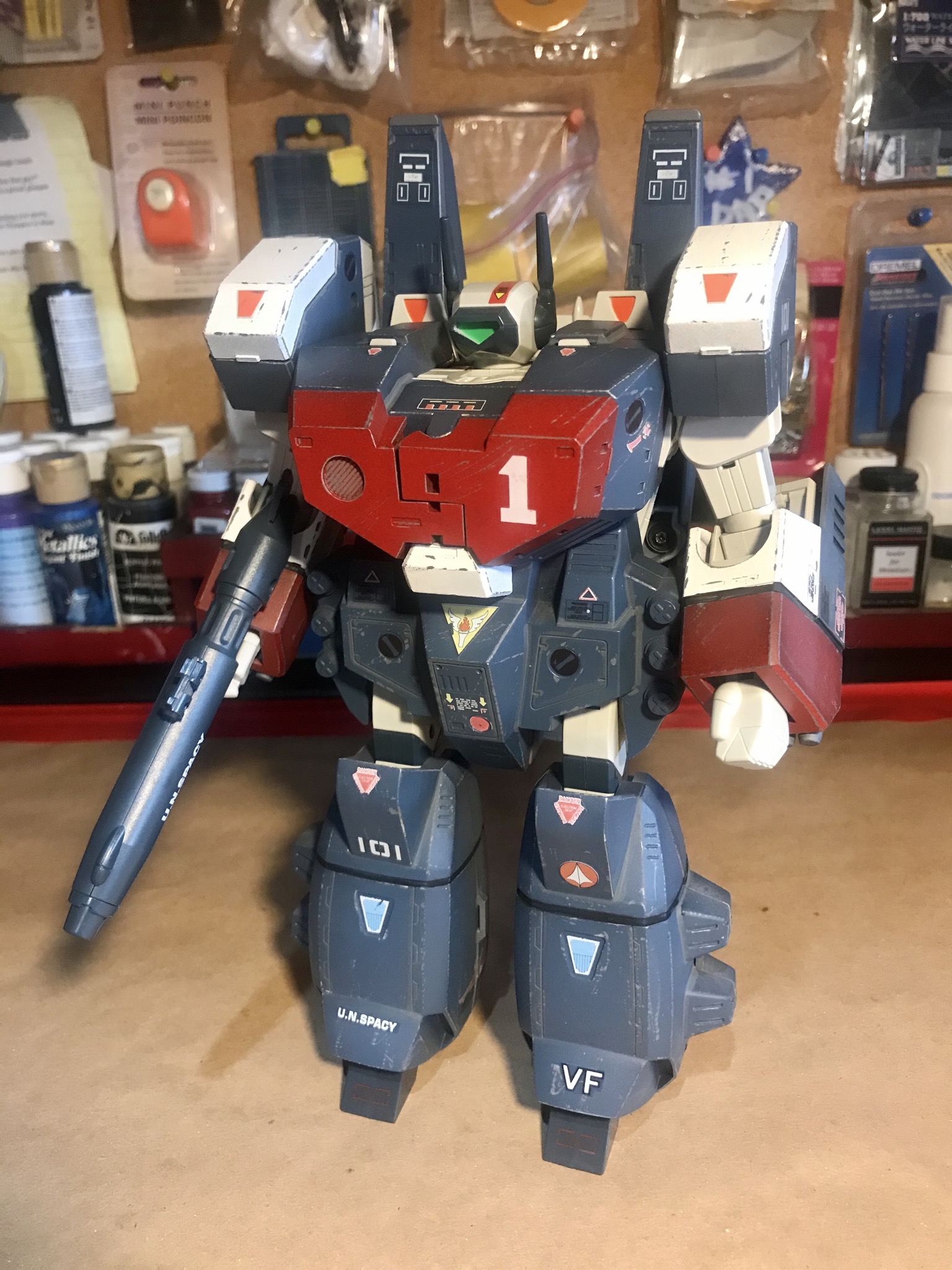

Corrinald Posted September 21, 2020 Posted September 21, 2020 So THAT'S what a 1/55 VF-1 looks like! Very nicely done VF-1J Hikaru. Quote
Anasazi37 Posted September 21, 2020 Author Posted September 21, 2020 4 minutes ago, Corrinald said: So THAT'S what a 1/55 VF-1 is supposed to look like! Very nicely done VF-1J Hikaru. ^^^ Fixed your post for you. And thank you. Quote
nightmareB4macross Posted September 21, 2020 Posted September 21, 2020 Simply stunning! After all the years you have spent supporting many other members here with your custom print shop, it is nice to know you now have time to carve our out your own pieces of heaven. Keep the inspiration going! Quote
sqidd Posted September 22, 2020 Posted September 22, 2020 All of a sudden my VF-1J Chunky doesn't seem so shiny. Looks great! I'm looking forward to following this thread. Quote

Lolicon Posted September 23, 2020 Posted September 23, 2020 Wow! Looks like a well-built vintage VF-1 model kit rather than a toy. Great work! Are those the DX hands? Quote
Anasazi37 Posted September 23, 2020 Author Posted September 23, 2020 (edited) 22 hours ago, Slave IV said: Magnificent! The most worthy of all toys to devote this much dedication to. Look forward to seeing the completed set and everything in between! I wholeheartedly agree! Finishing this one and getting this feedback from the community is inspiring me to start work on the next one sooner than I planned. 21 hours ago, Mog said: Looking forward to seeing this done chunky style. I've seen the 1/48 versions, but I don't think I've ever seen it done with the 1/55's. In regards to the custom above, it's pretty crazy to see all the work you put in on this Hikky 1J. Me, too! I might have provided a few 1/55 Minmay Guard sets to members back in the day, but I don't recall anyone ever posting pictures of a finished custom. I've had the decals set aside for mine for a very long time. My goal is have the MG in 1/72 (Hasegawa), 1/60 (Yamato v1), 1/55 (Bandai reissue), and 1/48 (Yamato). 12 hours ago, vladykins said: Love it! Looking forward to seeing the rest of them as you complete them. Thank you! 11 hours ago, valkyrie312 said: Gorgeous work! Can’t wait to see the rest! Thanks to you as well! 2 hours ago, Lolicon said: Wow! Looks like a well-built vintage VF-1 model kit rather than a toy. Great work! Are those the DX hands? That's high praise! The fixed pose hands are from a 1/48 Yamato GBP. Turns out that they're just the right size to fit with the overall "chunkiness" of the valk. I had to cut out some material on the inside of the right hand so I could get the gunpod in there, but otherwise it was an easy adaptation. I do have a closed right GBP hand, too, along with both original hands, all painted and detailed to match. To make the interchangeable hands work and allow for them to move a bit, I cut the originals off, drilled holes into the base of the pieces that slide inside the arm, attached a Kotobukiya Poly Unit Ball Joint L to each one (from behind), and then drilled holes into the back of each hand. Easy peasy. Edited September 23, 2020 by Anasazi37 Quote

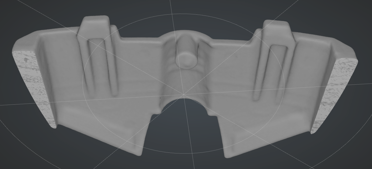

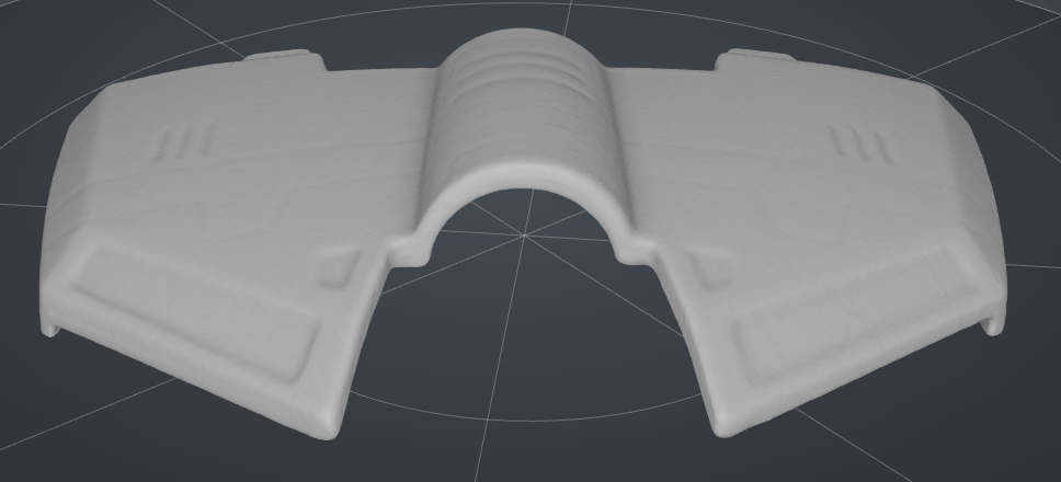

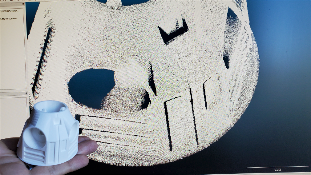

Anasazi37 Posted August 28, 2022 Author Posted August 28, 2022 On 8/22/2022 at 8:57 AM, nightmareB4macross said: How’s the progress coming along on the scans? I ran into some arcane and complicated hardware issues with the scanner I built. Took me about a year(!) to resolve them since I don't have a lot of free time these days. I'm now getting really consistent, insanely high resolution scans of objects. This is a sample scan of a 3D printed part from a 1/35 Gunstar kit. I use it for testing because of its complex surfaces. The dark portions are where the scanner couldn't see anything because of how the part was positioned with respect to the scanner, so you generally have to reposition the object multiple times across multiple scans in order to get data for all surfaces. The next step, which involves the most magic, is developing the method for automatically aligning multiple scans of the same object to produce the final model. This is the "secret sauce" for companies that sell scanners to consumers. I wanted to be working on this over a year ago, but couldn't due to the hardware issues. In the interim, I can use manual alignment to get things pretty close and then let the computer take over. It's a bit trial and error, and takes time, but generally works. Since I don't need to scan a large number of parts to get my custom projects moving again, I'll likely start with this approach. On 8/22/2022 at 12:02 PM, nightmareB4macross said: Any updates on your list? It’s hard carving out time for customs. Just wanted you to know we patiently await more to come. Looking forward to more. I really appreciate the continued interest. I will indeed be getting back to these soon. I first need to complete some decal orders for a few MW members that have been waiting a VERY long time. One of the things I'll likely do for my Strike customs is scale up and resin print the RMS-1 and UUM-7 that come in 1/72 missile pack that Senovis posted online: https://cults3d.com/en/3d-model/art/vf-missile-pack The quality of the designs is really nice. I wasn't looking forward to designing the armaments myself or scanning in the 1/55 resin cast ones that I have. Quote
nightmareB4macross Posted August 28, 2022 Posted August 28, 2022 38 minutes ago, Anasazi37 said: I ran into some arcane and complicated hardware issues with the scanner I built. Took me about a year(!) to resolve them since I don't have a lot of free time these days. I'm now getting really consistent, insanely high resolution scans of objects. This is a sample scan of a 3D printed part from a 1/35 Gunstar kit. I use it for testing because of its complex surfaces. The dark portions are where the scanner couldn't see anything because of how the part was positioned with respect to the scanner, so you generally have to reposition the object multiple times across multiple scans in order to get data for all surfaces. The next step, which involves the most magic, is developing the method for automatically aligning multiple scans of the same object to produce the final model. This is the "secret sauce" for companies that sell scanners to consumers. I wanted to be working on this over a year ago, but couldn't due to the hardware issues. In the interim, I can use manual alignment to get things pretty close and then let the computer take over. It's a bit trial and error, and takes time, but generally works. Since I don't need to scan a large number of parts to get my custom projects moving again, I'll likely start with this approach. I really appreciate the continued interest. I will indeed be getting back to these soon. I first need to complete some decal orders for a few MW members that have been waiting a VERY long time. One of the things I'll likely do for my Strike customs is scale up and resin print the RMS-1 and UUM-7 that come in 1/72 missile pack that Senovis posted online: https://cults3d.com/en/3d-model/art/vf-missile-pack The quality of the designs is really nice. I wasn't looking forward to designing the armaments myself or scanning in the 1/55 resin cast ones that I have. Just wanted you to know there are people here rooting for your success. Happy to hear you still support the community with your wonderful decal sets. Would be great to see more customs come out of them. Quote
