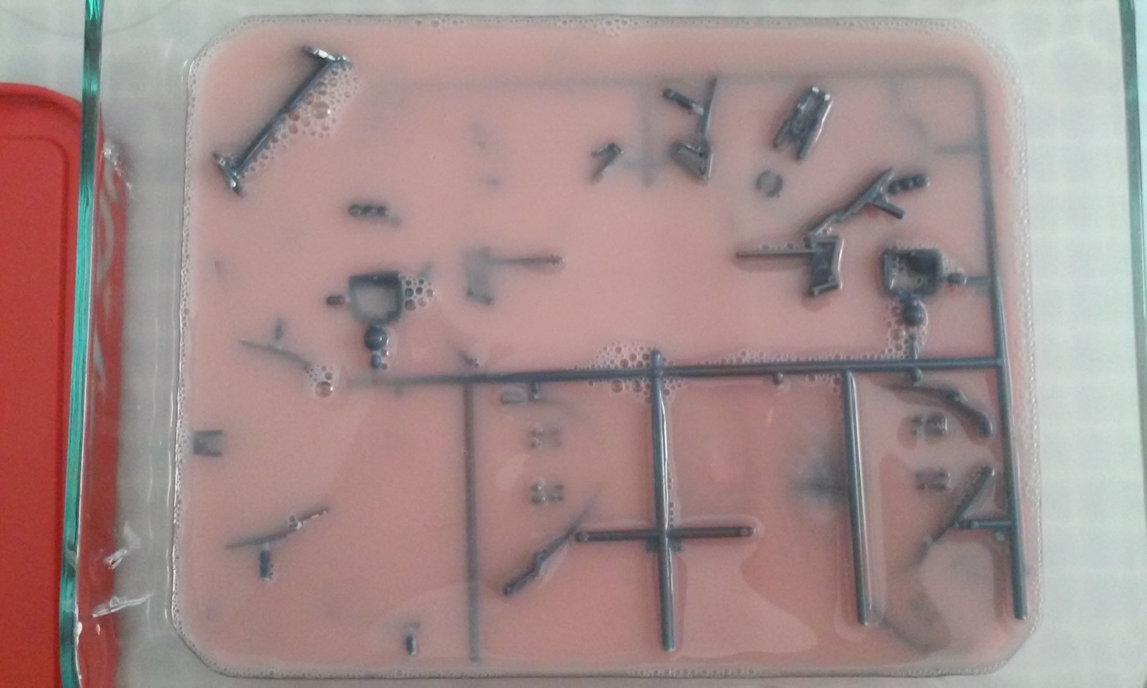

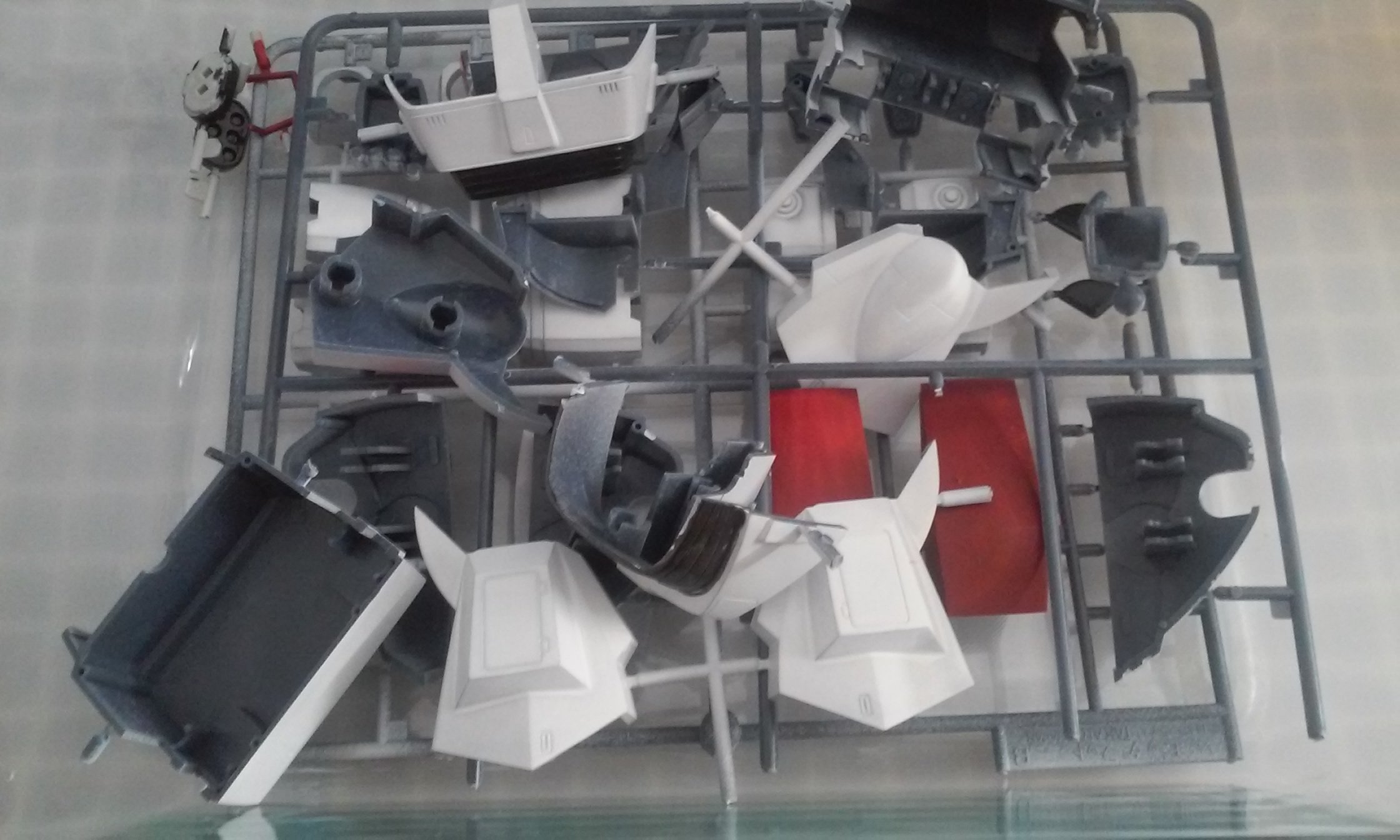

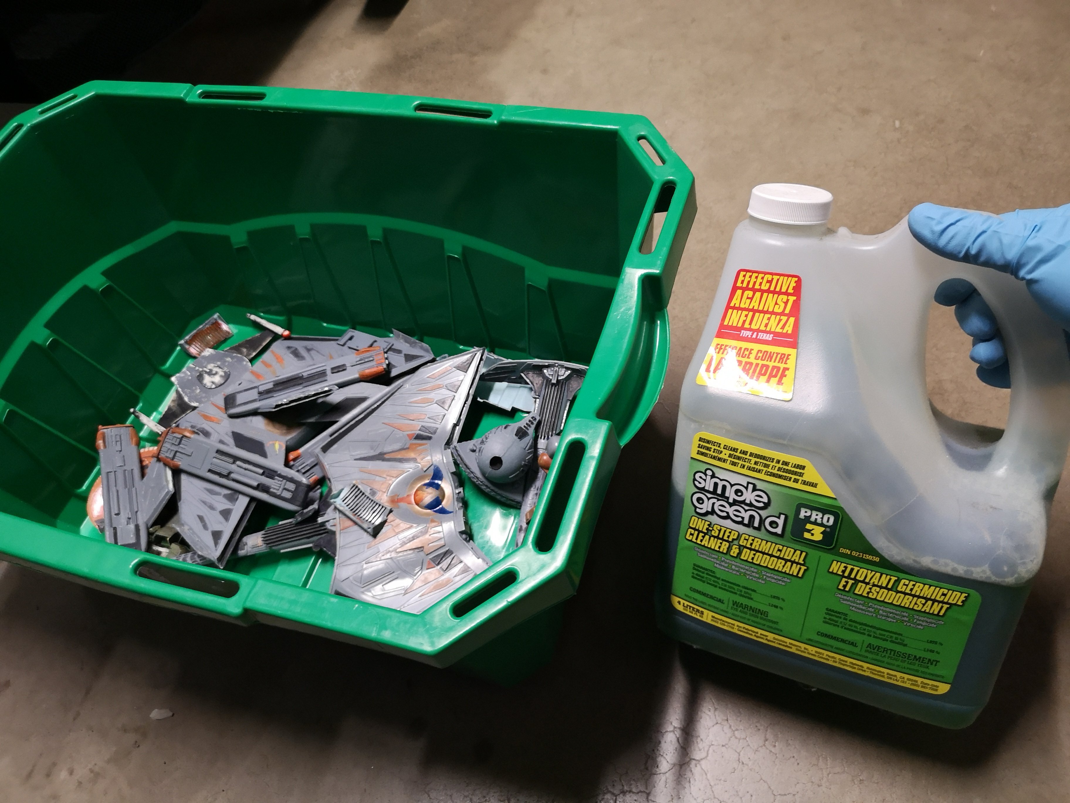

MechTech Posted August 16, 2020 Posted August 16, 2020 (edited) I recently bought a vintage model that was pre-painted on the sprues. It wasn't the color scheme I wanted to go with so I researched some common types of paint strippers safe for styrene. For several years I've said to use Pine Sol and 50% water, but heard mixed reviews about it being safe for styrene. Doing a search, the miniature RPG guys say that LA's Totally Awesome General Purpose Cleaner works great. So I gave it a try. It is only $1.00 at most dollar stores in the U.S. In Canada ($3.00 for a jug). It looks like you can get it through Amazon. Here's LA's store locator link: http://www.lastotallyawesome.com/store-locator/ First the parts. These were painted with Tamiya paints. The miniature guys say this will take other paints off too with more time (like 8 to 12 hours) overnight. The parts were then covered up with the cleaner UNDILUTED in a glass pan. Then allowed to soak for two hours. In a few minutes you could already see it begin working. I then scrubbed the parts with a brush to get into recessed areas, but really didn't need to. The paint was coming off with a rinse of water like melting butter. You're not done yet. The cleaner leaves a residue on your fingers and parts. No problem! A bath in a basin of dish washing detergent cleans you and the parts off. Then just a rinse in warm water and then dry with a towel or air dry. The important part is this stuff is non-toxic and of course, won't mess with the styrene. I've seen cleaners ruin styrene before. They break down the plasticizers and weaken the bond. You can feel and hear it when you tap the plastic. The plastic parts now look new - Mint In Box! No damage was done to the finish or to the styrene makeup as far as I could tell. This stuff worked so good, I thought I'd share it with everyone here. The de-greaser works so good, you may need to use some hand cream afterward or your hands will get chapped and dry. - MT Edited August 17, 2020 by MechTech Quote

MechTech Posted August 16, 2020 Author Posted August 16, 2020 Thanks, Gabe! It was so easy I just had to share it. That's a good question, David! I do not know. That may be a good job for Pine Sol. I would test some out on sprues to be safe. I know Pine Sol got sap off of Christmas glass balls, then stripped off the gold color too! The lacquer coatings on styrene can be a challenge. Cars guys I know say oven cleaner works. I've heard Walmart's Great Value heavy duty oven cleaner works in a bag over the parts. I personally don't use oven cleaner because of the fumes, but I hear it's great as a paint stripper and of course, chrome and chrome/lacquer cleaner. I hope that helps! - MT Quote

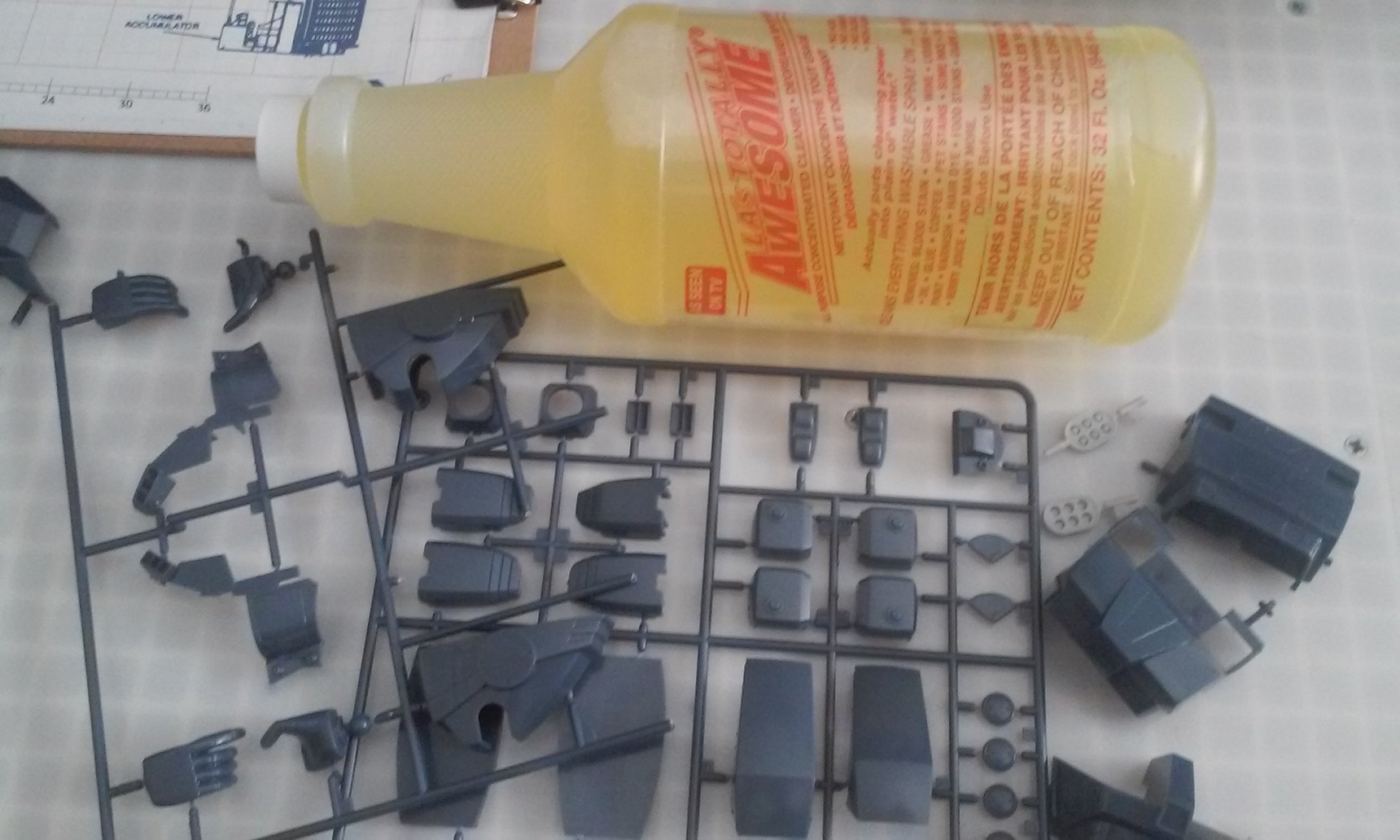

peter Posted August 17, 2020 Posted August 17, 2020 Haha, Simple Green works too? I have that stuff at home, maybe I'll try that first because LATA is kind of a rip off in Amazon, hahahahahha! Quote

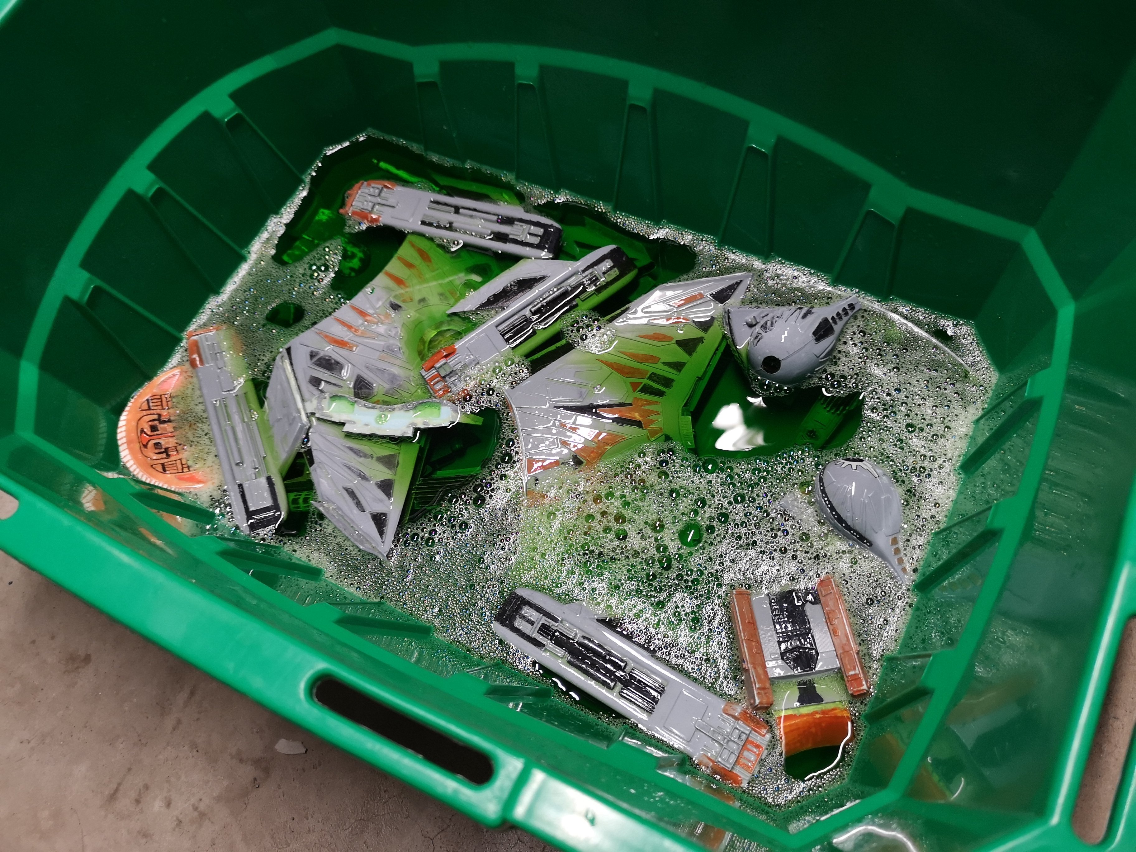

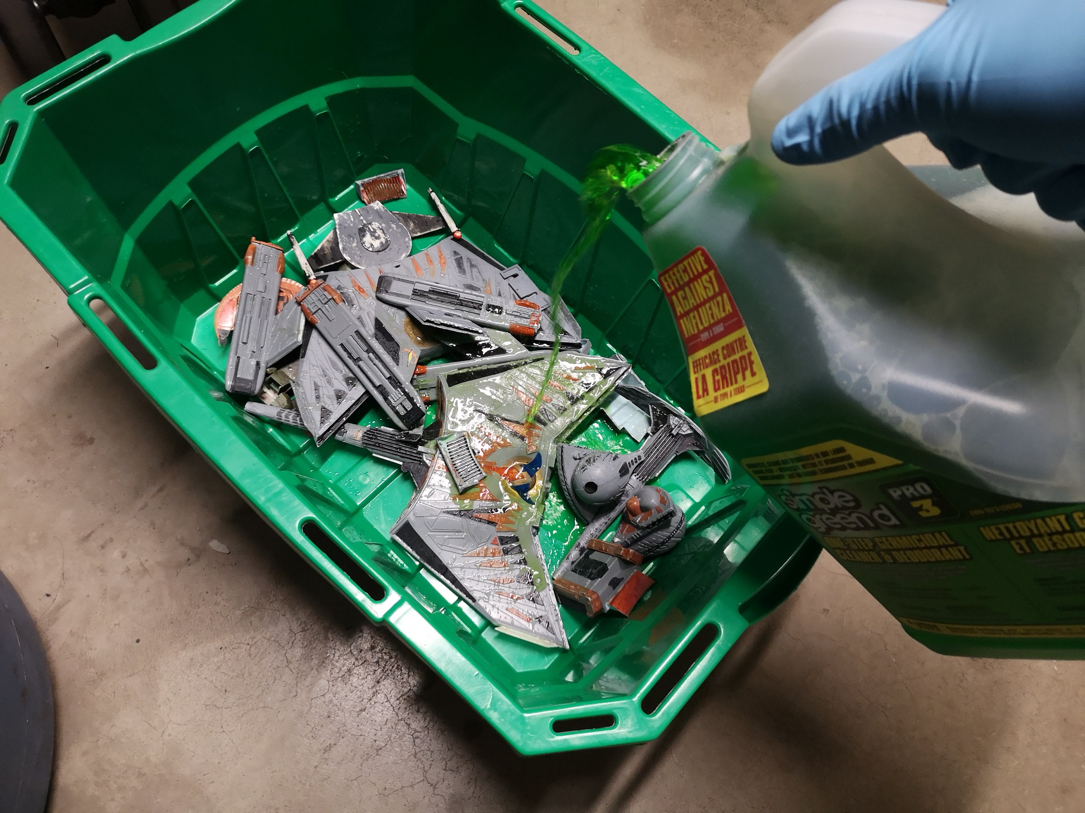

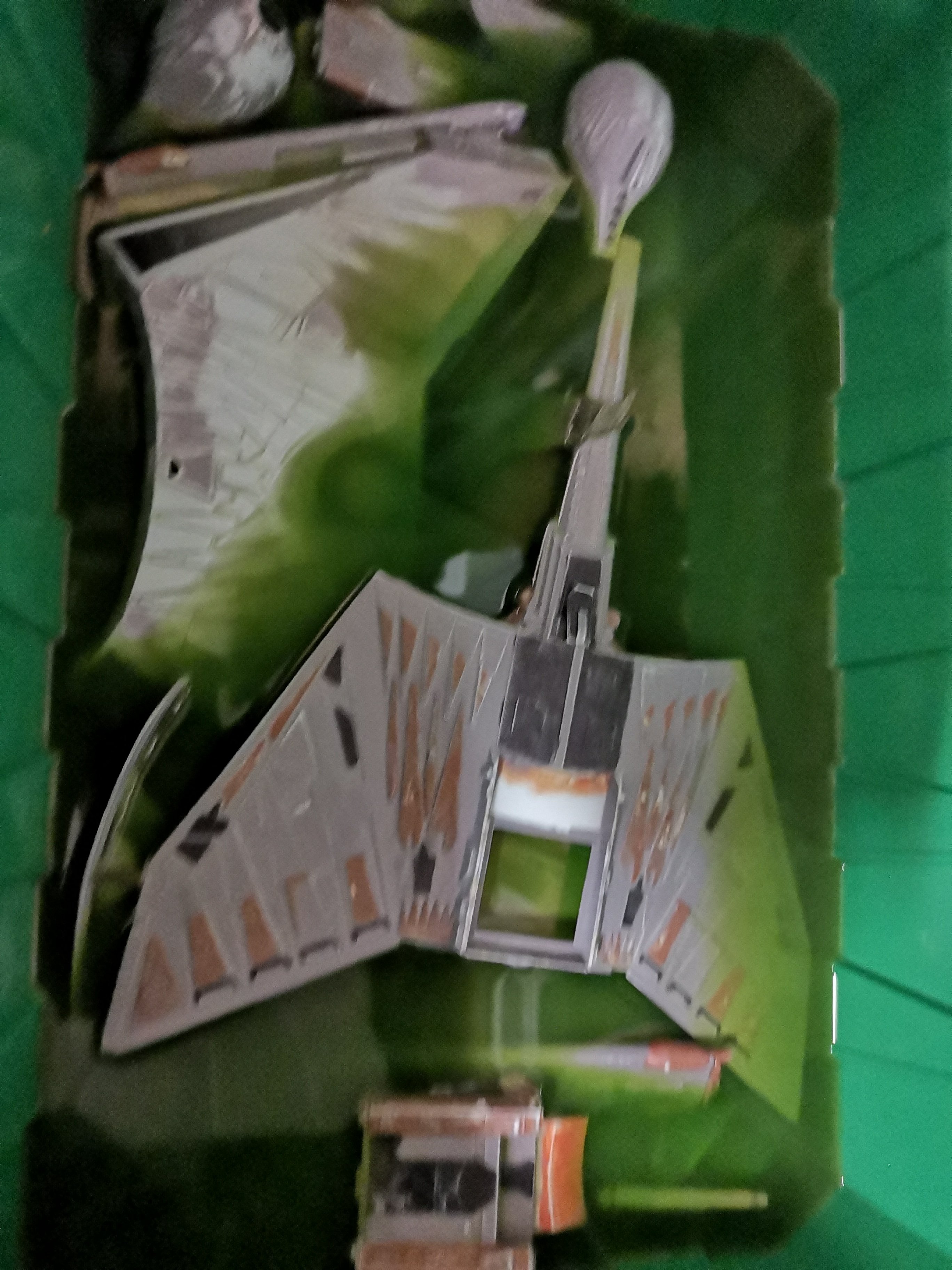

peter Posted August 19, 2020 Posted August 19, 2020 Btw, simply spraying on Simple Green doesn't work, I think the parts have to be completely immersed. I was too cheap to try it, so I just sprayed it on, left it to soak overnight, scrubbed with hot water and though some of the paint came off, it wasn't like with LATA. Quote

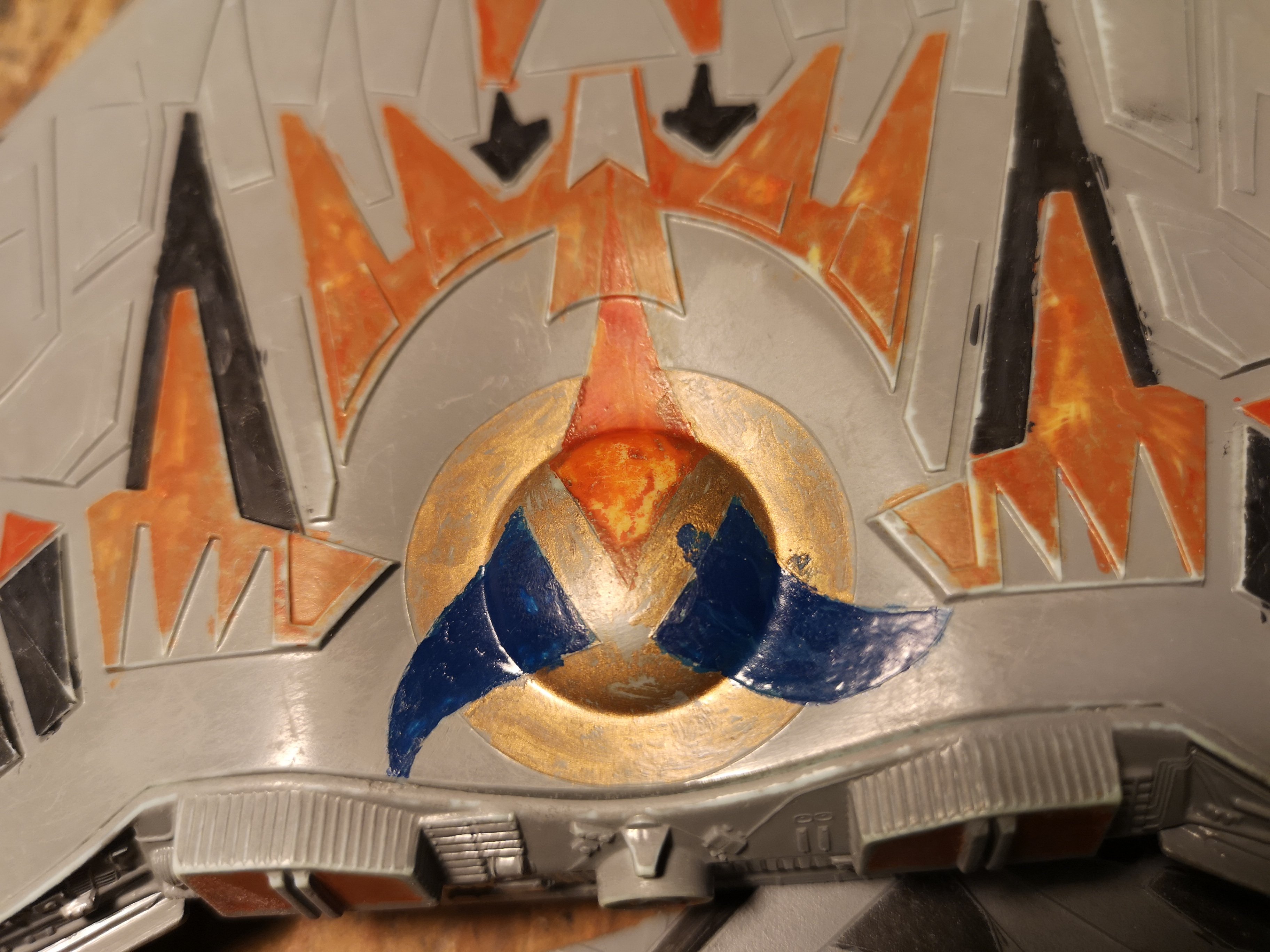

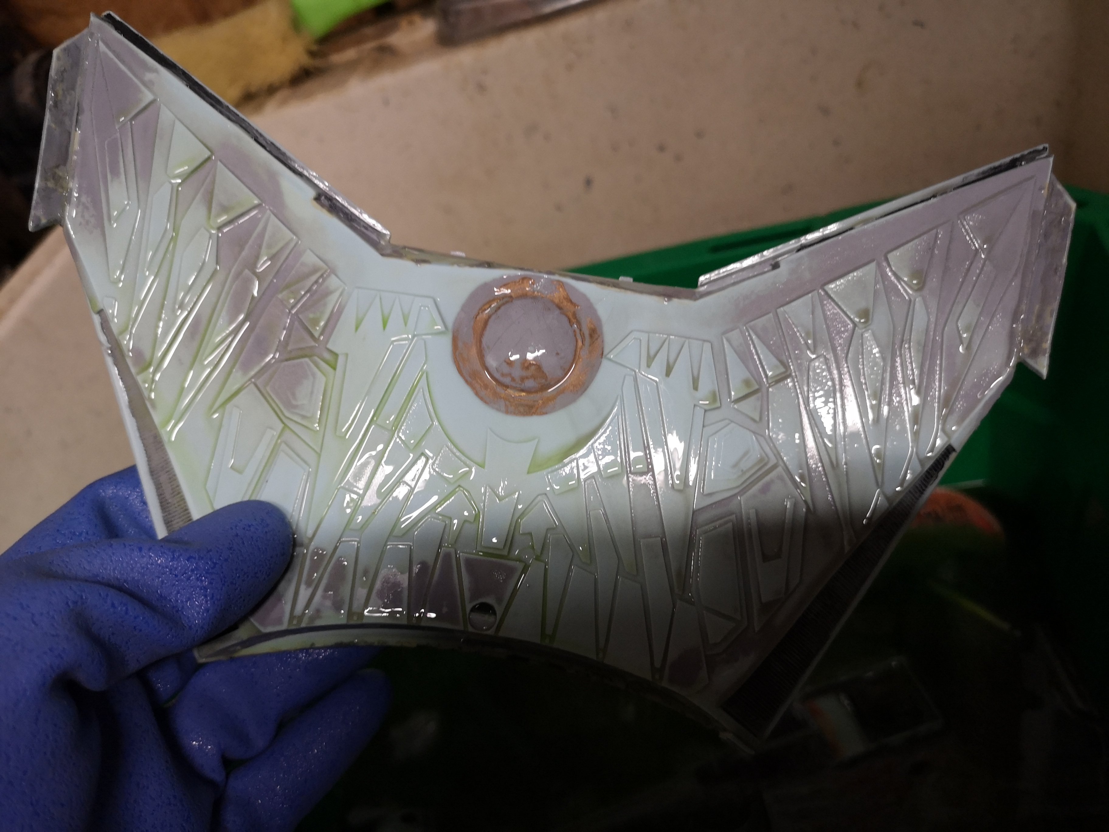

peter Posted August 19, 2020 Posted August 19, 2020 After spraying them with Simple Green and letting them soak overnight, I scrubbed them down and this was the result: It took some of the paint off. But still left a bunch. Took the decal off of this one. This one was poorly brush painted. Left the decal on this one. So I'll try more. Submerged the parts in undiluted Simple Green, let's see if it's easier to get the paint off tomorrow. Quote

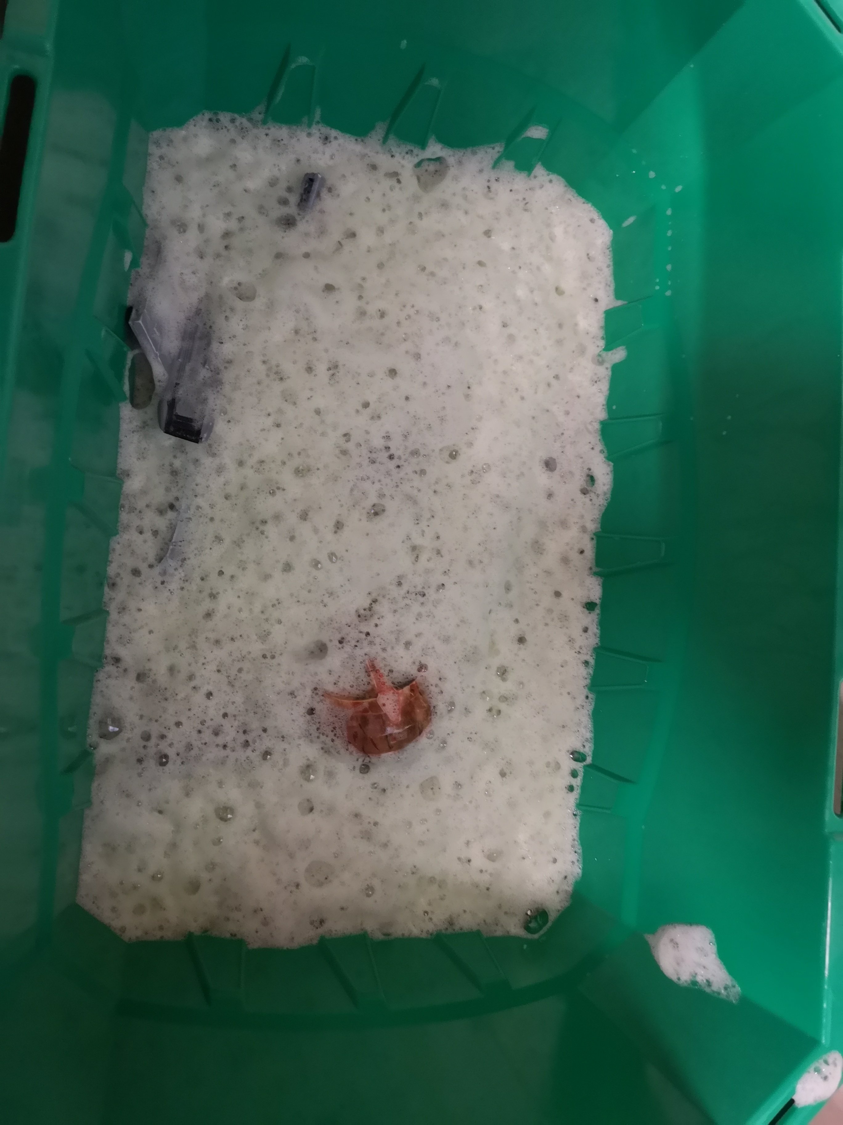

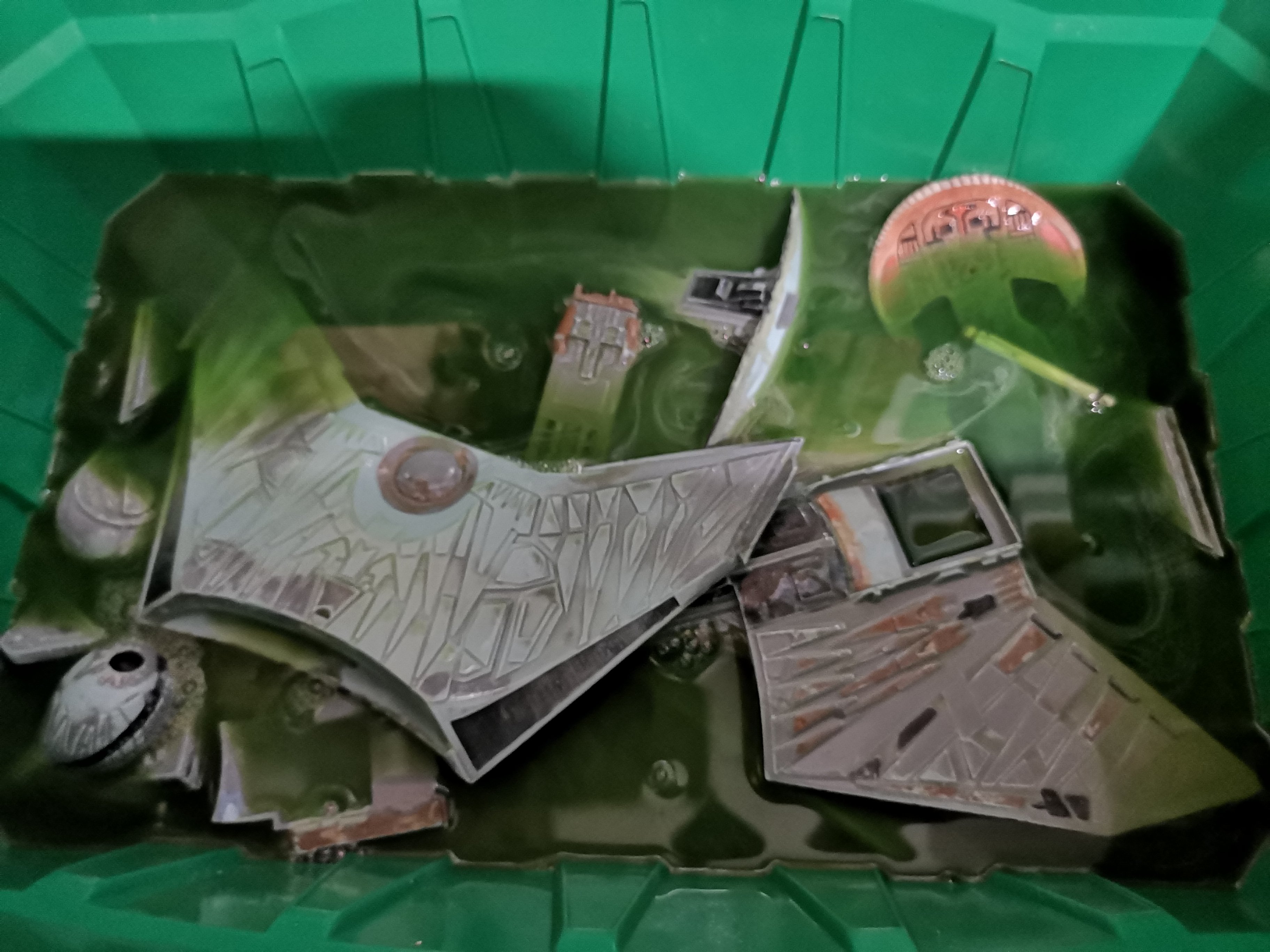

peter Posted August 20, 2020 Posted August 20, 2020 Paint is starting to come off after soaking for 24 hrs and a bit of scrubbing. Will let it soak longer and scrub again later Quote

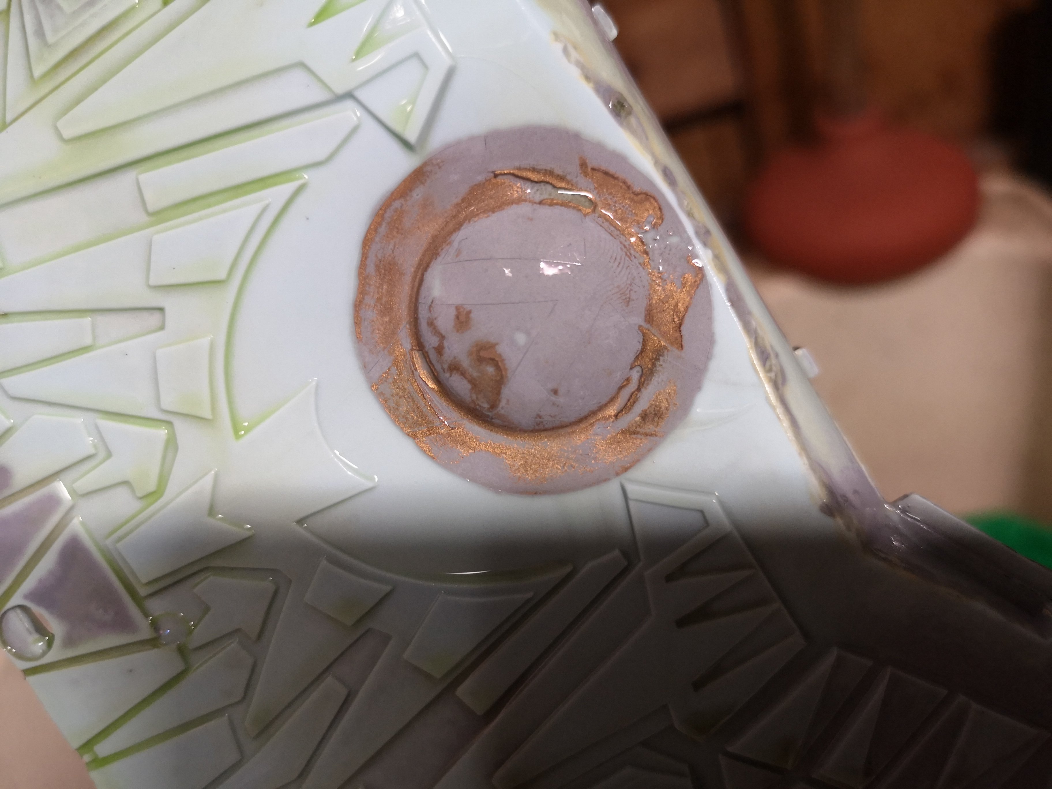

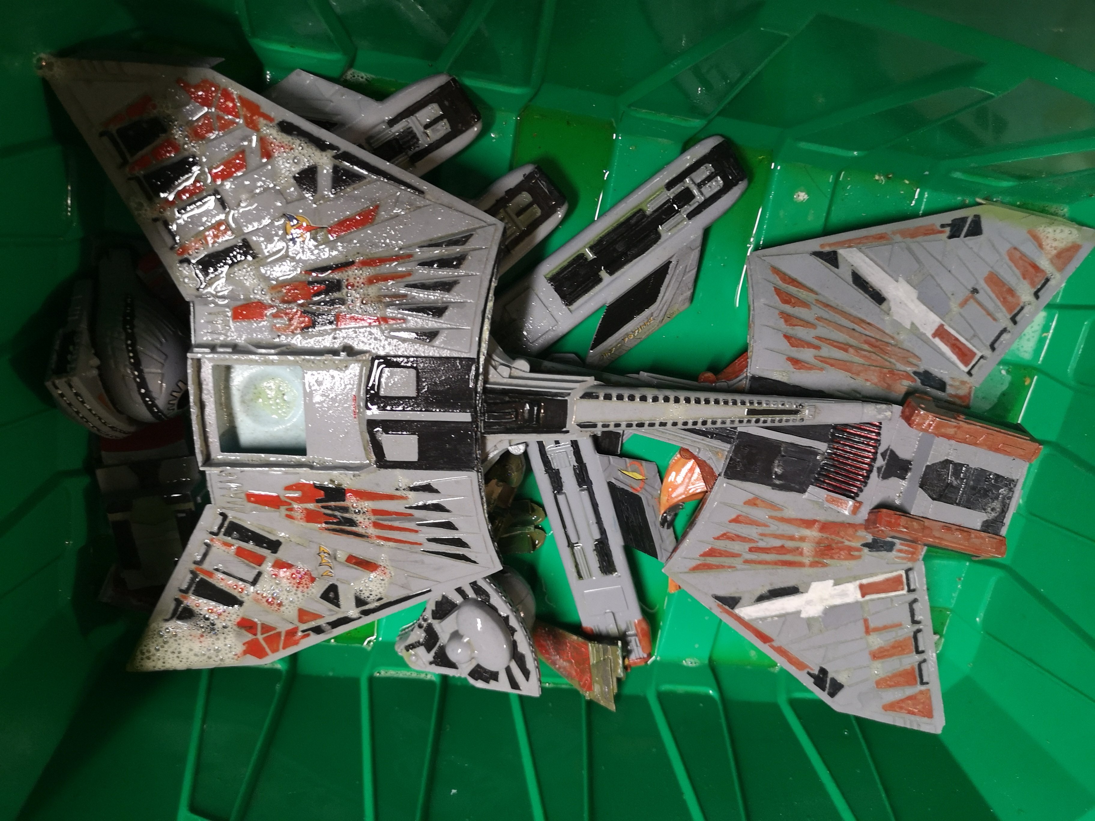

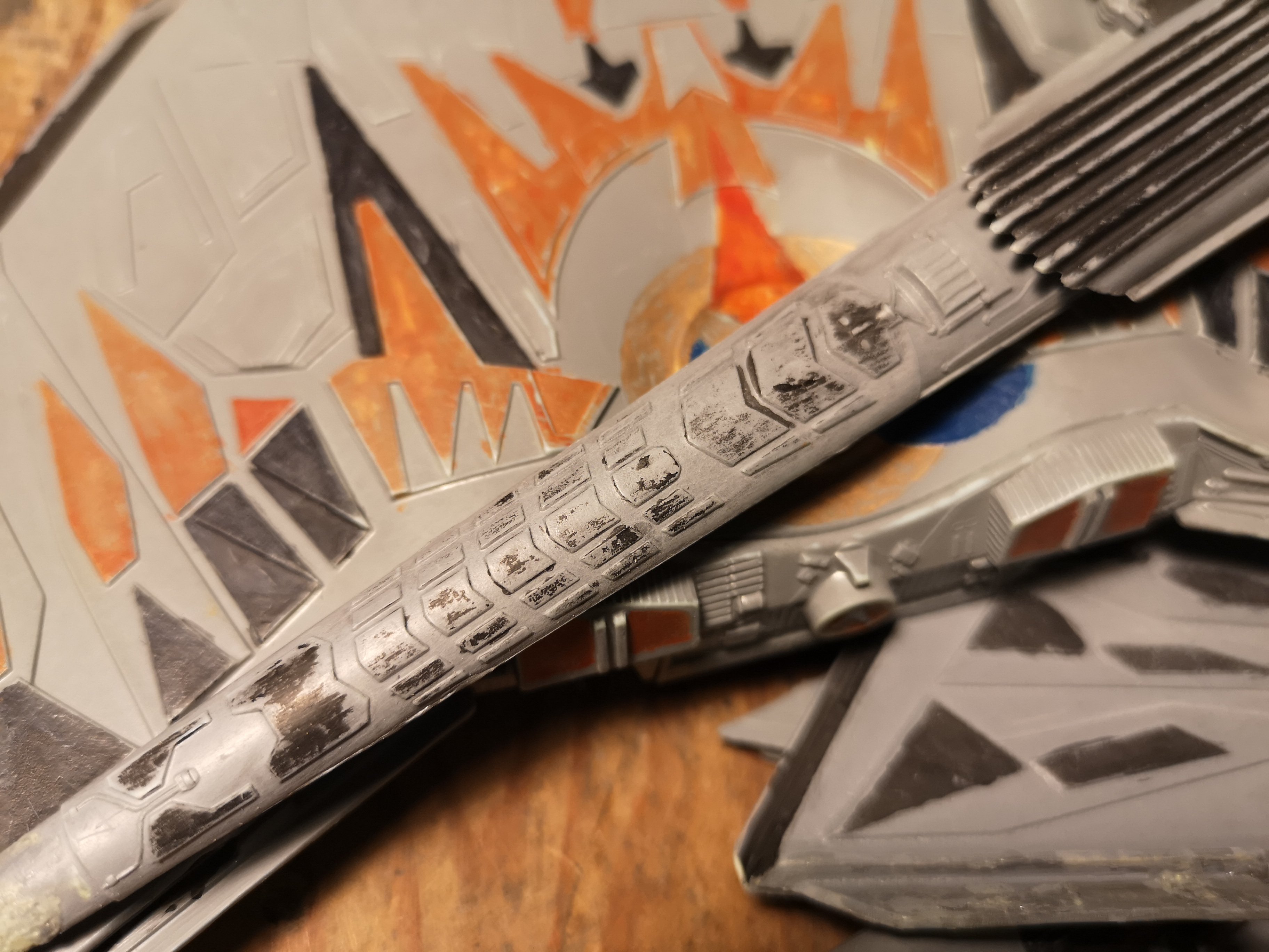

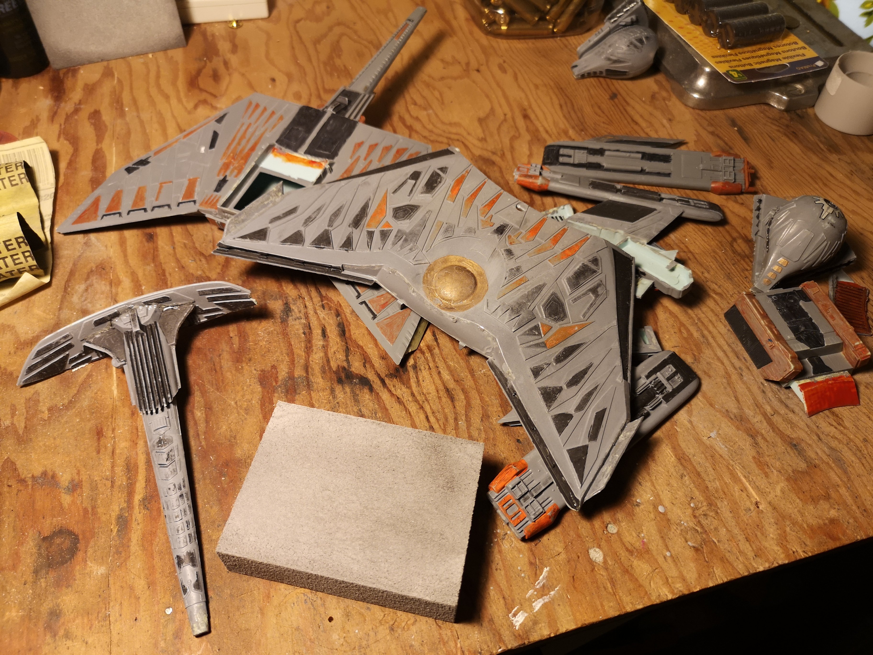

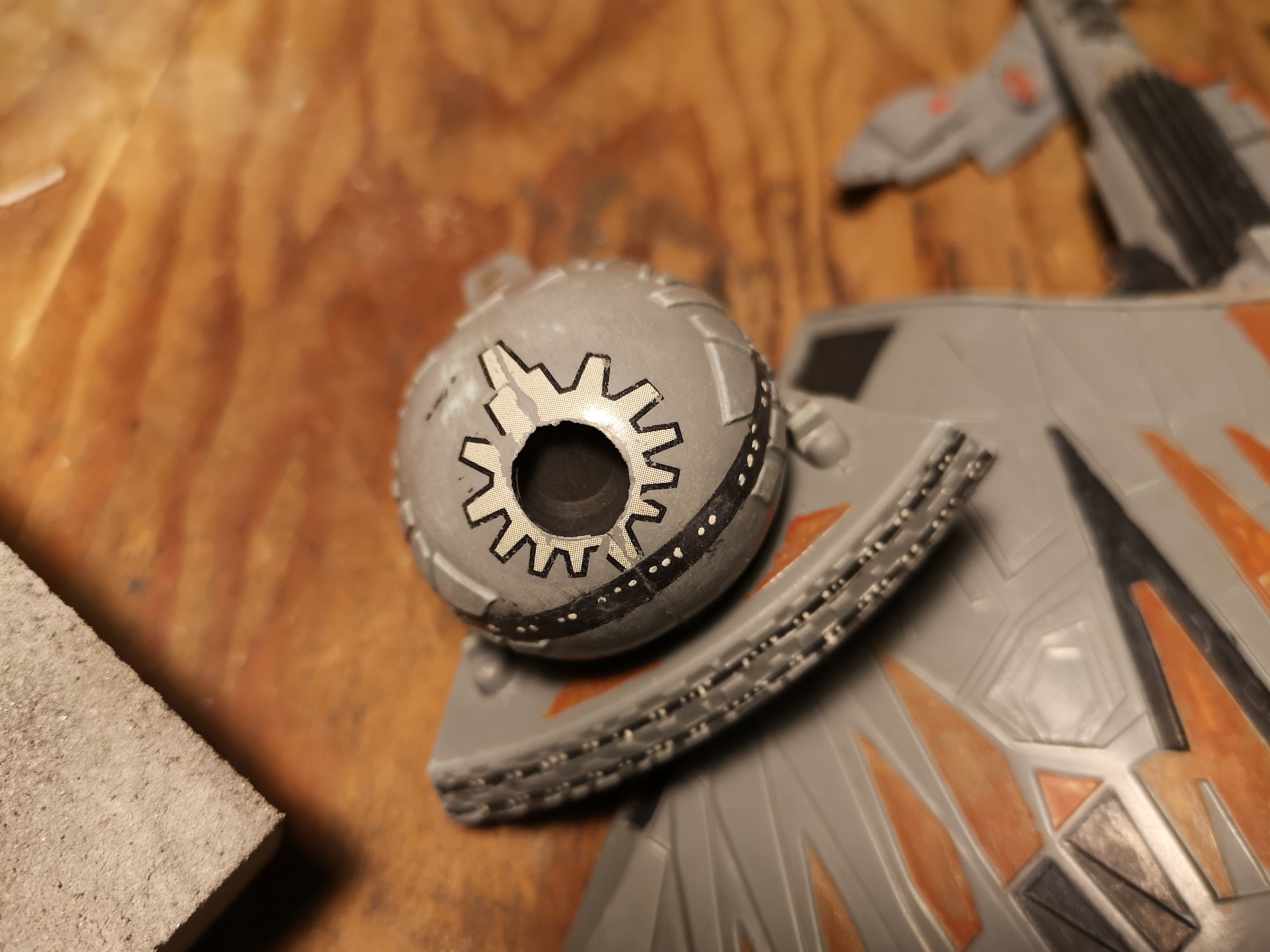

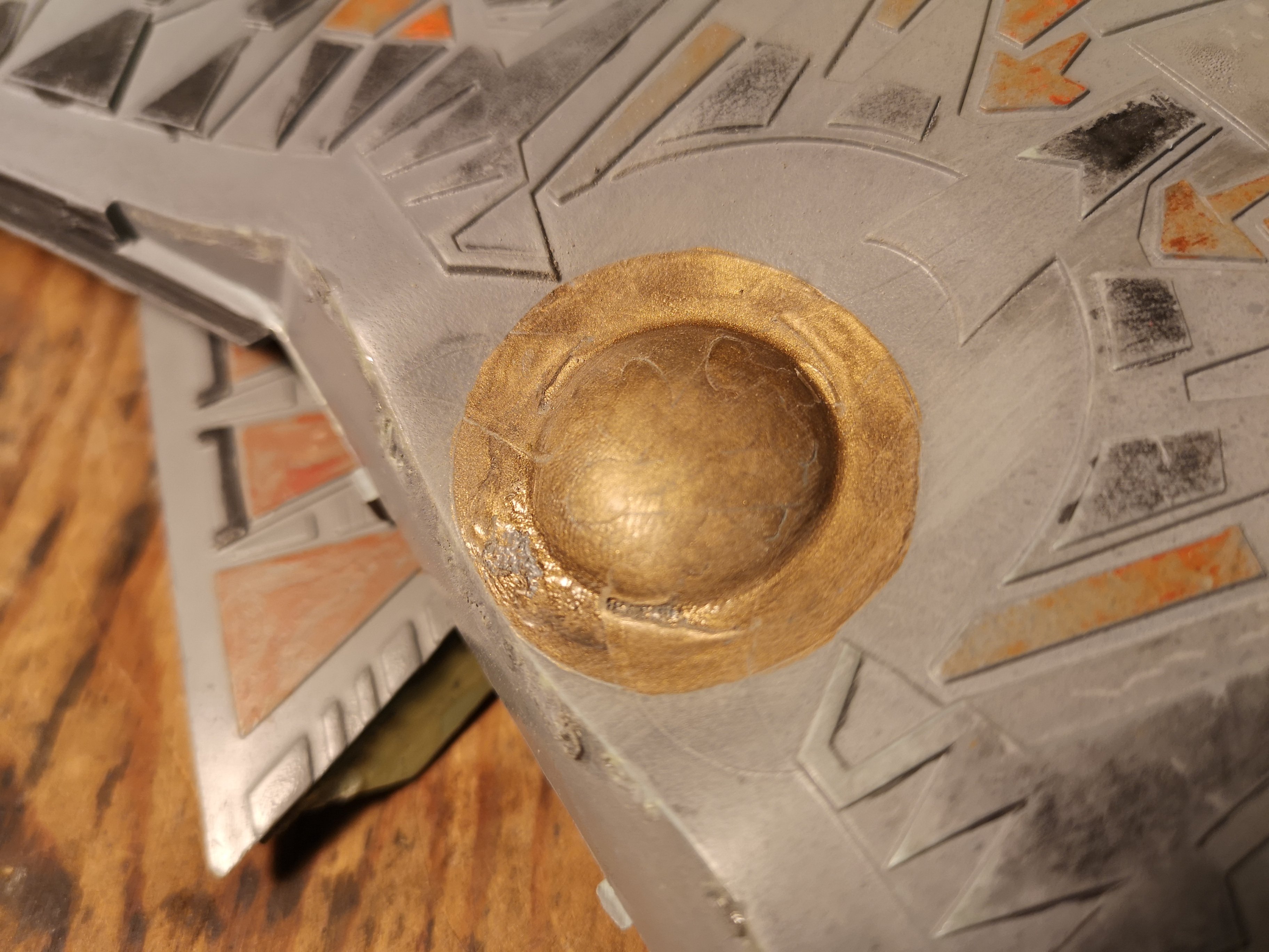

peter Posted August 21, 2020 Posted August 21, 2020 Some progress. Scrubbed the hell out of these, but I'll probably let them soak another day or so. Raining here anyway and I want to sun dry these parts after I wash the crud off. I guess I don't need to get them down to bare plastic, I just wanted to remove the paint with visible brush marks. I'll sand whatever the Simple Green missed and try to get started on these guys soon. Quote
MechTech Posted August 21, 2020 Author Posted August 21, 2020 It's too bad that's as far as it stripped down. I would have hoped even more judging by the bubbles, like down to the plastic. At least all the sanding will build up your arm muscles - MT Quote
peter Posted August 21, 2020 Posted August 21, 2020 Haha, I think I was being overly optimistic. The jug of Simple Green I had is at least 10 years old, the Testor's paint on the battlecruisers is at least 30 years old. Those might be contributing factors? Maybe if the Simple Green was a fresh jug, it might be more potent? The grey stuff is sprayed on, and I can't even recall if it was Testor's gray, engine enamel primer, or something else. The rest of the colors were all Resorts enamel, all brushed on. If anything, I hope that this process at least got rid of most of the paint that was brushed on to hide the brush marks. This morning: One of the K'Tingas is mostly stripped. The one on the right is still pretty stubborn I just gooped on that bronze didn't I? Since it's raining, I'll let the parts sit in the bath a bit longer. I'll rinse this stuff off when the sun comes out then let the parts dry under the sun. Quote
MechTech Posted August 21, 2020 Author Posted August 21, 2020 I'd let it soak another day! Then wash it with soapy water and some baking soda (to get rid of the perfume). It's looking much cleaner! - MT Quote
peter Posted August 21, 2020 Posted August 21, 2020 35 minutes ago, MechTech said: I'd let it soak another day! Then wash it with soapy water and some baking soda (to get rid of the perfume). It's looking much cleaner! - MT Will do, thanks for the tip. This is the first time I've seriously tried to remove paint to refurbish a model. Quote
