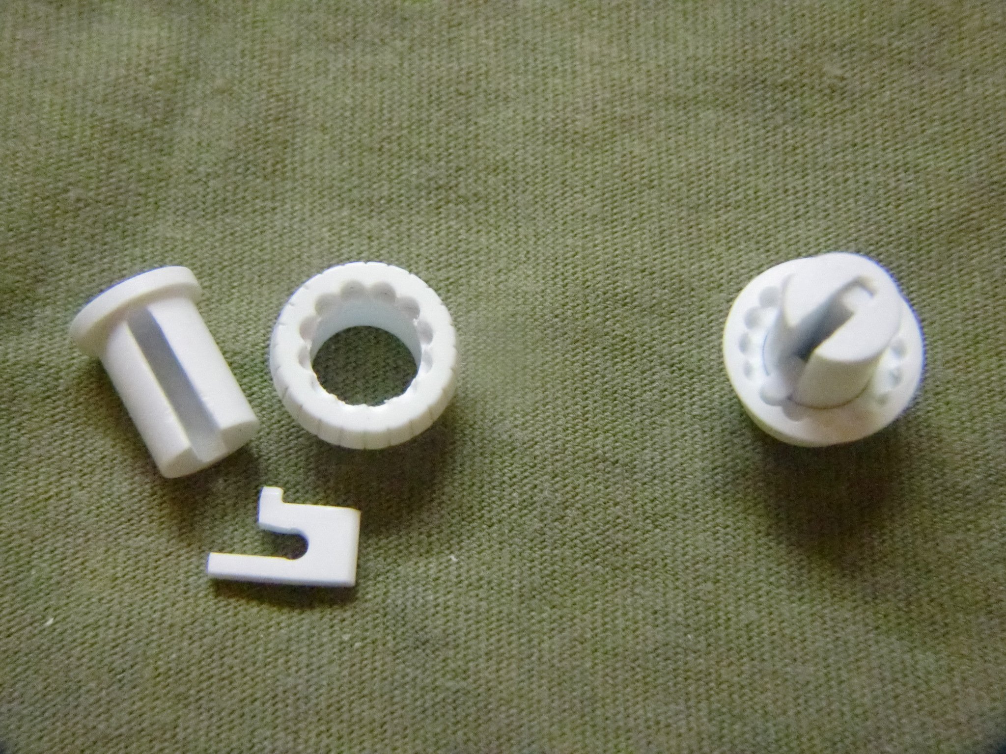

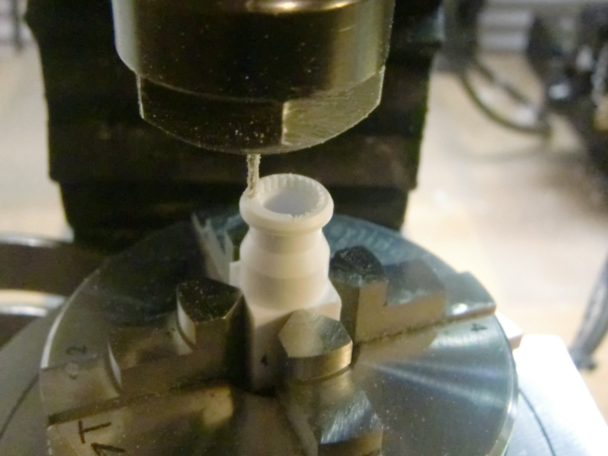

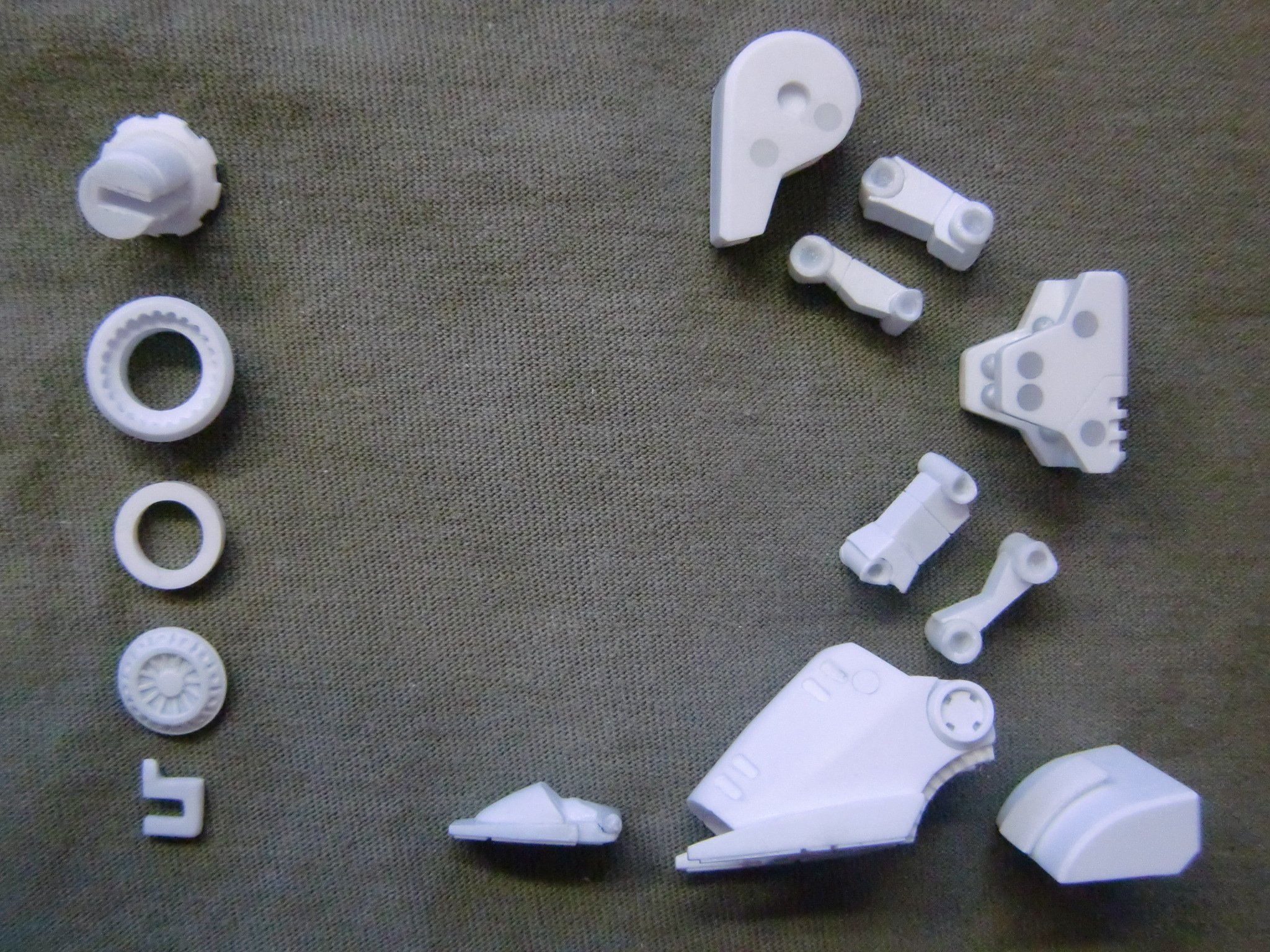

MechTech Posted August 31, 2020 Posted August 31, 2020 Your work is looking awesome Aztek! I'm with Sqidd, I'm going to have to buy this if my budget allows (then a 3D printer) and then buy stocks in a paint company! Your parts engineering is looking great too! I've attached a simple ratchet joint from a Monster I did if you're interested. The breakout shows the parts and the other photo shows it partially assembled so you can see the function. Friction joints with something this big and heavy may be an issue. - MT Quote

Aztek Posted August 31, 2020 Author Posted August 31, 2020 (edited) @MechTech that joint looks awesome! I planned on nylon washers and metric screws with nylock nuts. How does it work for you? Strong enough? Does it break/chip? Is that SLA printed or FDM? I’ll look to reverse engineer. ☺️ I got my SLA back yesterday and have resin on its way. @Chronocidal I have an stl for a sliding/friction hinge and since the leg is so big I may go back and look at that as an option. Right now the model is easily over 500 objects. I’d like to optimize much lower and that just might help. Also I have the ratchet/nub inside the upper thigh portion to ‘notch” in the upper accordion grooves. Thanks! Edited August 31, 2020 by Aztek Quote
MechTech Posted September 1, 2020 Posted September 1, 2020 Thanks Aztec. The parts are actually machined styrene pieces. They were designed to be cast from resin. The Monster is so heavy, I knew it needed ratchets to keep it upright. - MT Quote
Aztek Posted September 1, 2020 Author Posted September 1, 2020 @MechTech would you mind taking a couple more pictures of that from an angle that can show me the way it’s built? I can almost make it out but would want to see the male and female pieces better. Quote

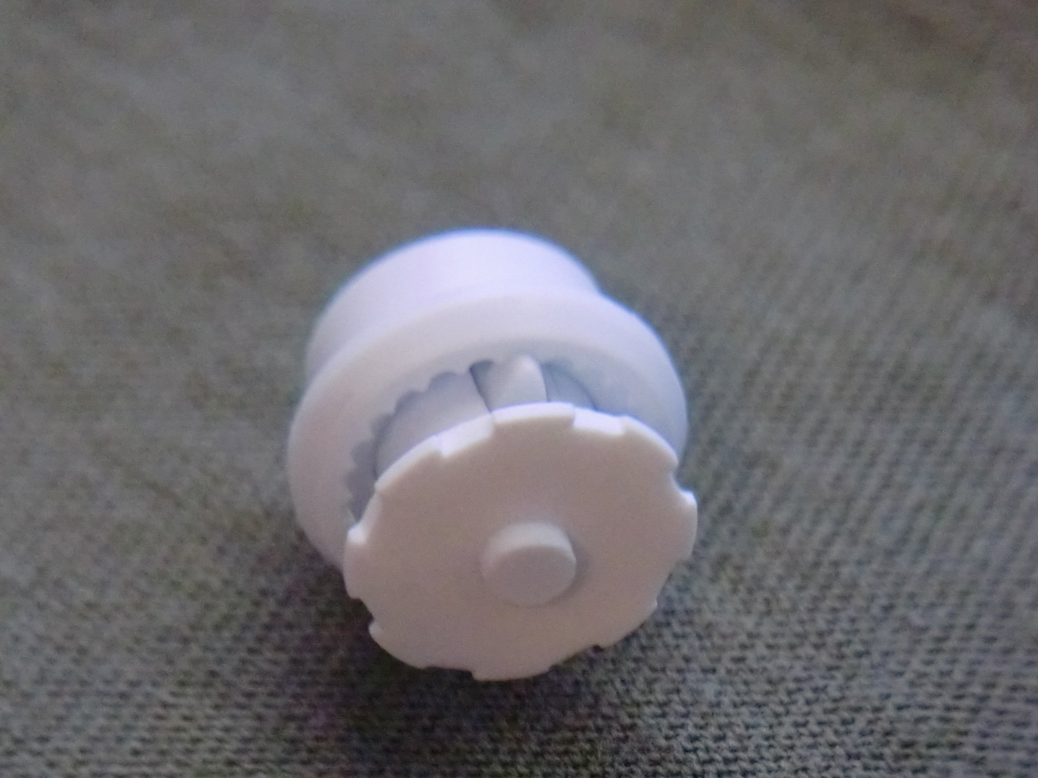

MechTech Posted September 6, 2020 Posted September 6, 2020 Here are some other shots that I hope help you out (they're originally from my build thread). Some of the same and different - but same idea- designs. It's a very simple design. Flanged ring has indents cut into flanged area. Slotted post goes into flanged ring. The "C" looking piece fits into the post and is the ratchet. The shape gives it spring while in the shaft. The post will probably need to be longer for your model. The last photo shows the indents being cut into the top part of the flange. The one here was for a smaller 1/350th model. I hope that helps you out! - MT Quote
Aztek Posted September 8, 2020 Author Posted September 8, 2020 @MechTechnice! I'll post some prototyping below off I did off your original photos. I took a stab and instead of doing the flange pressing against the center housing I double flanged it. Printed in PETG, cycled a few hundred times bu hand. Great tension and no sign of serious wear! This joint will be perfect for the knee and may try to adapt for the shoulder joint. Your work is amazing. How strong is the styrene? The smoothness looks great in the photos. With FDM I'll spend a fair amount of time post processing. The SLA is awesome but not structurally consistent enough nor strong enough for the main structure. Today is a small but proud update. I got my SLA printer back up and wanted to do a detail test. I wasn't sure where to start. Since the hands are one of the more daunting things to get right (for me) I said screw it and jumped in to these over the 4-day weekend. The proud part is I used the attached line art to draw the original mesh back in '03 while deployed. The hands have hardly changed over the years and are one of my favorite creations. On the 1/20 scale I'm trying to get as close to DYRL canon as possible. Some things like the visible ball joints are required for function but the details like on the palm and back hand are critical. The mock up below has the 1/72 and 1/48 for comparison. The gray PLA arm assembly was the draft I first did so there are gaps and loose joints. The mesh is fixed but I don't want to print it again until I start panel lining, More photos following this post since I'm having a hard time not getting errors when uploading on my PC. Quote

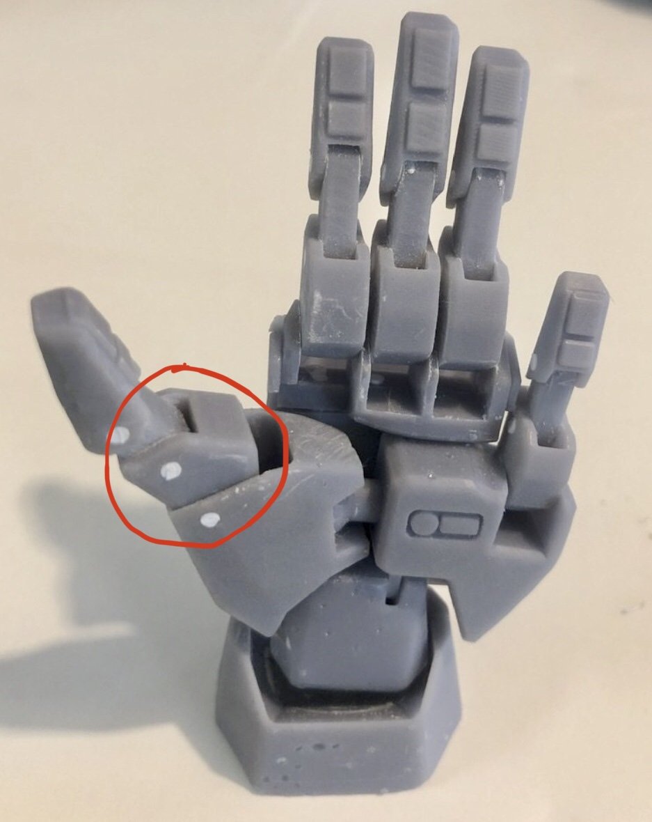

Chronocidal Posted September 19, 2020 Posted September 19, 2020 I think the big question is.. is the hand capable of holding a pose that will allow it to fill the back of the arm that way, so a panel is not necessary? Will the thumb fit into the fist enough to allow the hand to actually be block-shaped? Quote
Aztek Posted September 19, 2020 Author Posted September 19, 2020 Thanks for all the references and input. Need to go back and look at the joints and see if its possible. The thumb and pinky will be the challenge. Quote
nightmareB4macross Posted September 19, 2020 Posted September 19, 2020 5 hours ago, Aztek said: Thanks for all the references and input. Need to go back and look at the joints and see if its possible. The thumb and pinky will be the challenge. The hand will fit. All you need to do is rework this are circled in red as well as the palm to thumb section.The center part of the thumb should have a rotating joint. With this adjustment you can also achieve the proper orientation as seen in the line art. Quote
