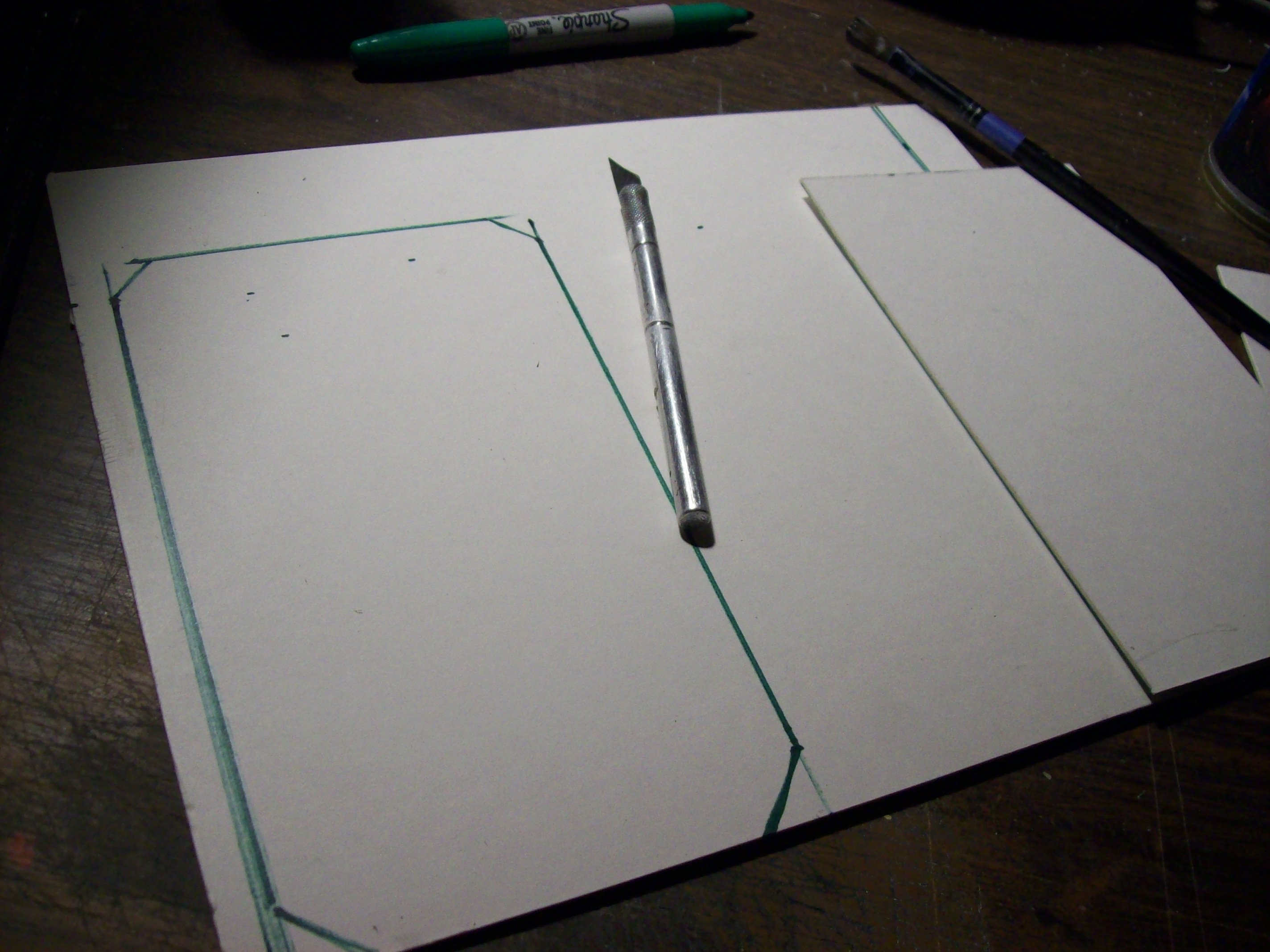

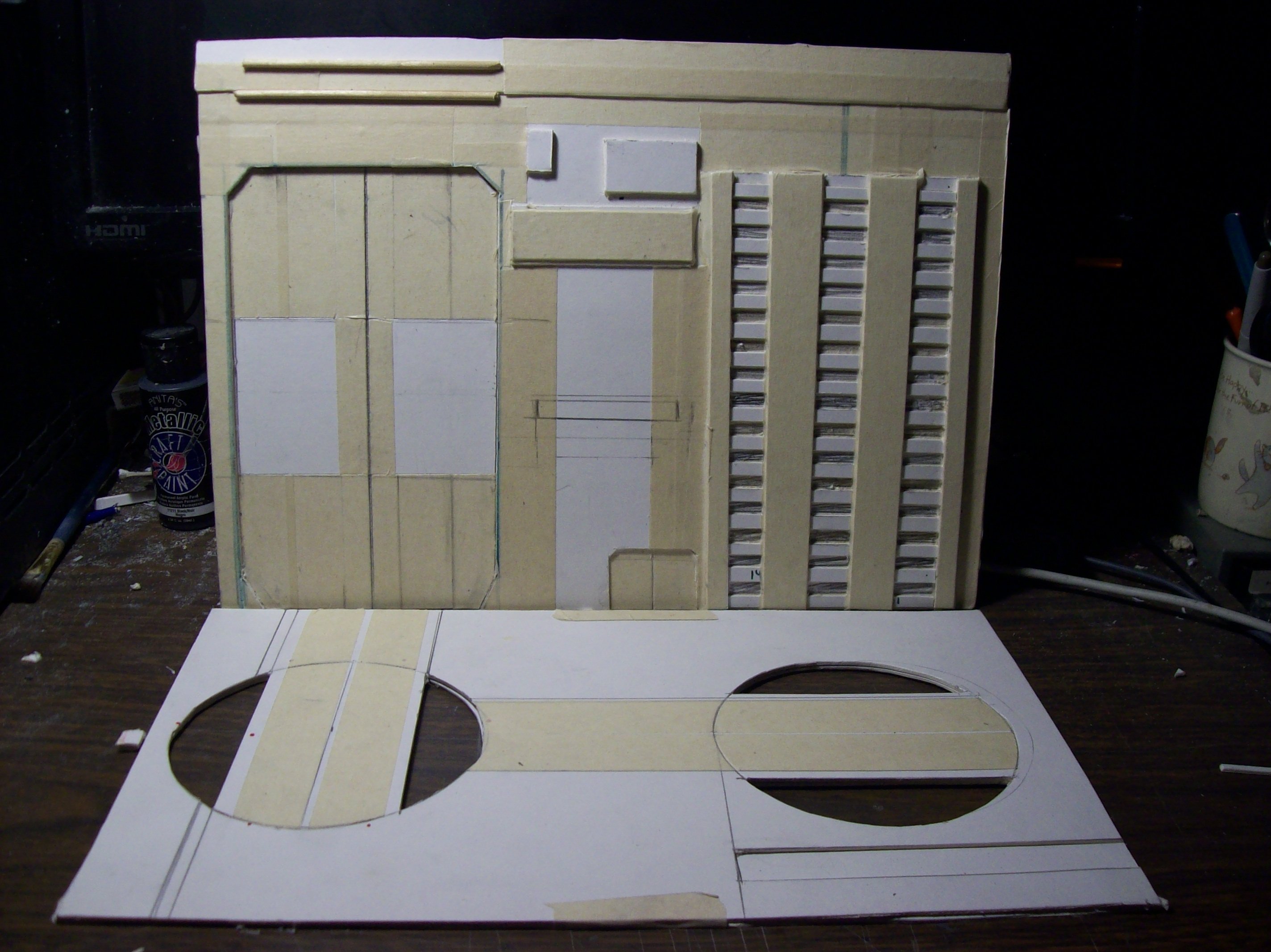

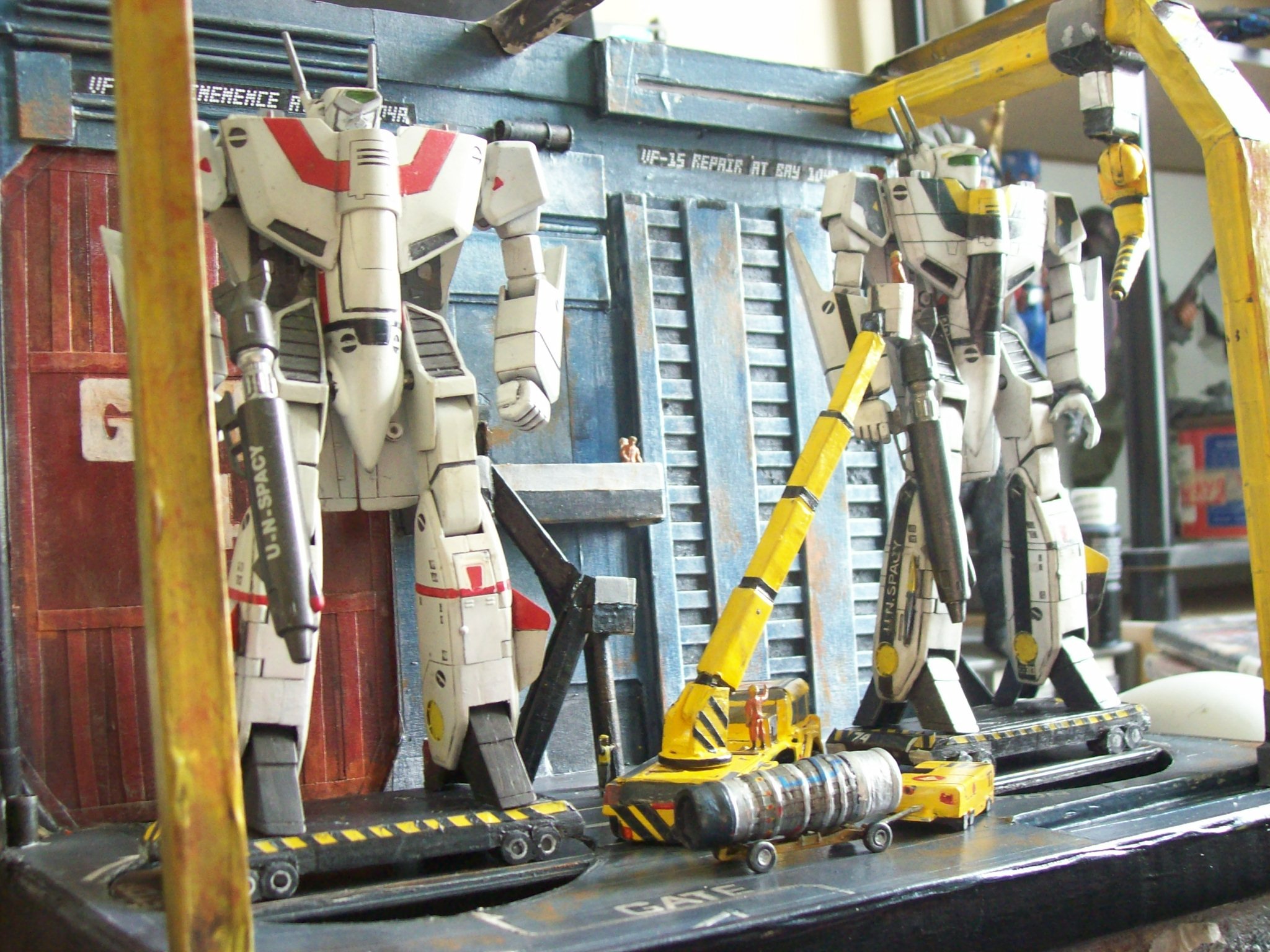

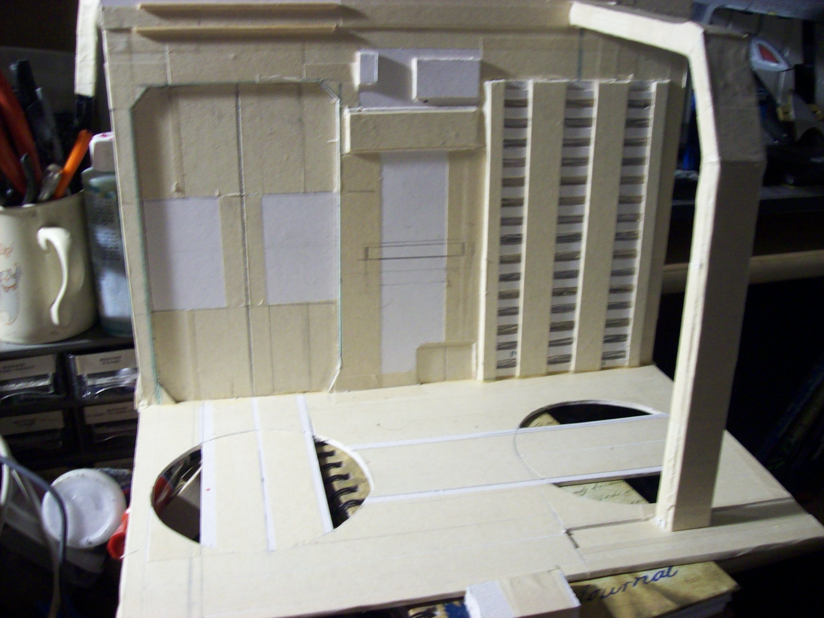

A low-cost alternative I have found when building hangar/ factory dioramas is using mat board (for matting artwork); it's denser than cardboard and can be cut and glued into differing shapes and whatnot. A huge sheet of it goes for about 7-8 bucks (If you're in the USA: at Hobby Lobby, they have 40 percent off coupons online). I found that by using Aileen's craft glue, masking tape and acrylic paints, you can get a pretty convincing scene going. Then just populate it with 1/72 scale figures and you should be good to go!
An example of what I mean:

This is great stuff here. While I do like displays to be a little more solid and maybe functional, this is an excellent idea I think, for filling in more static areas of a display.
