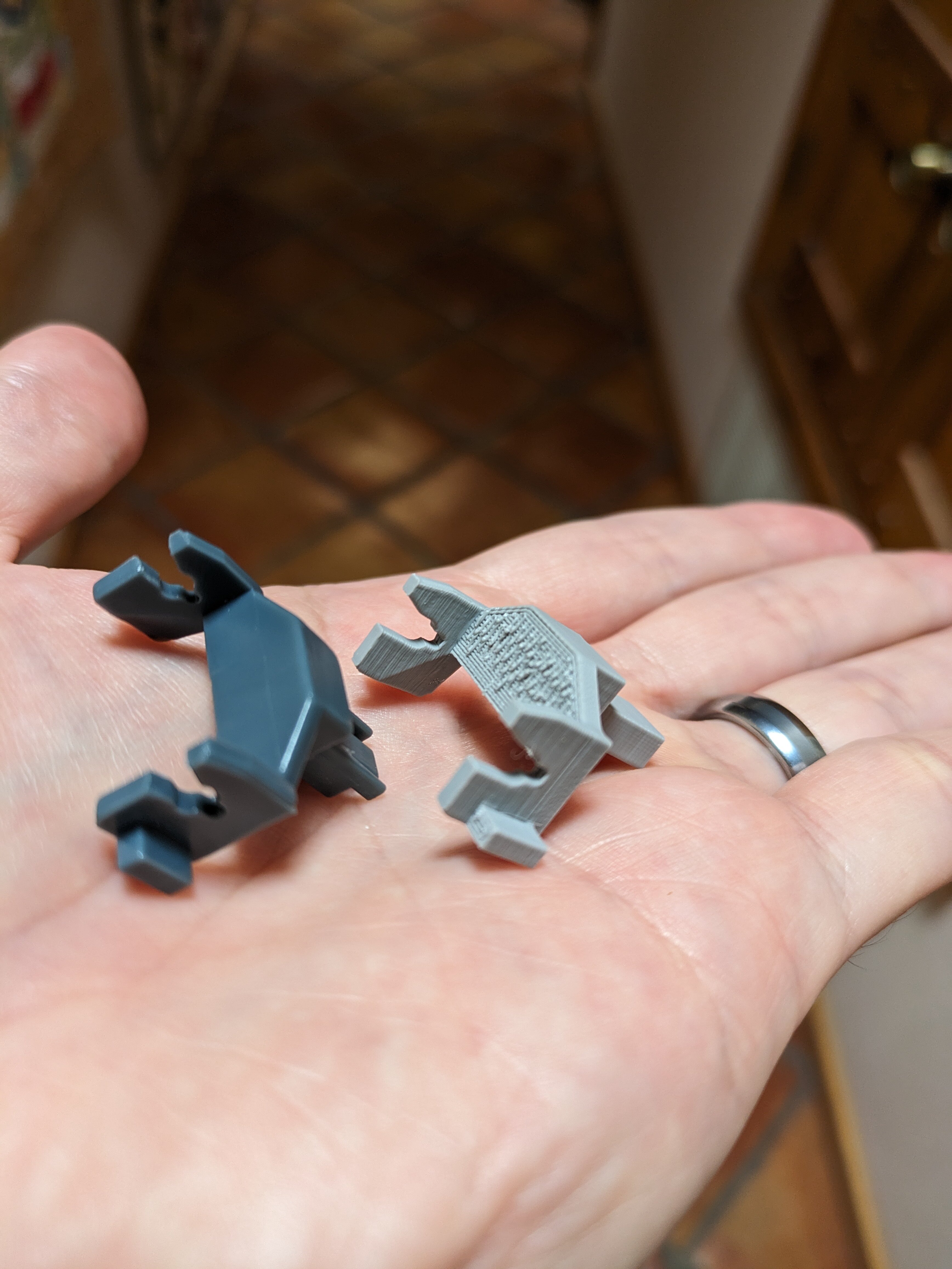

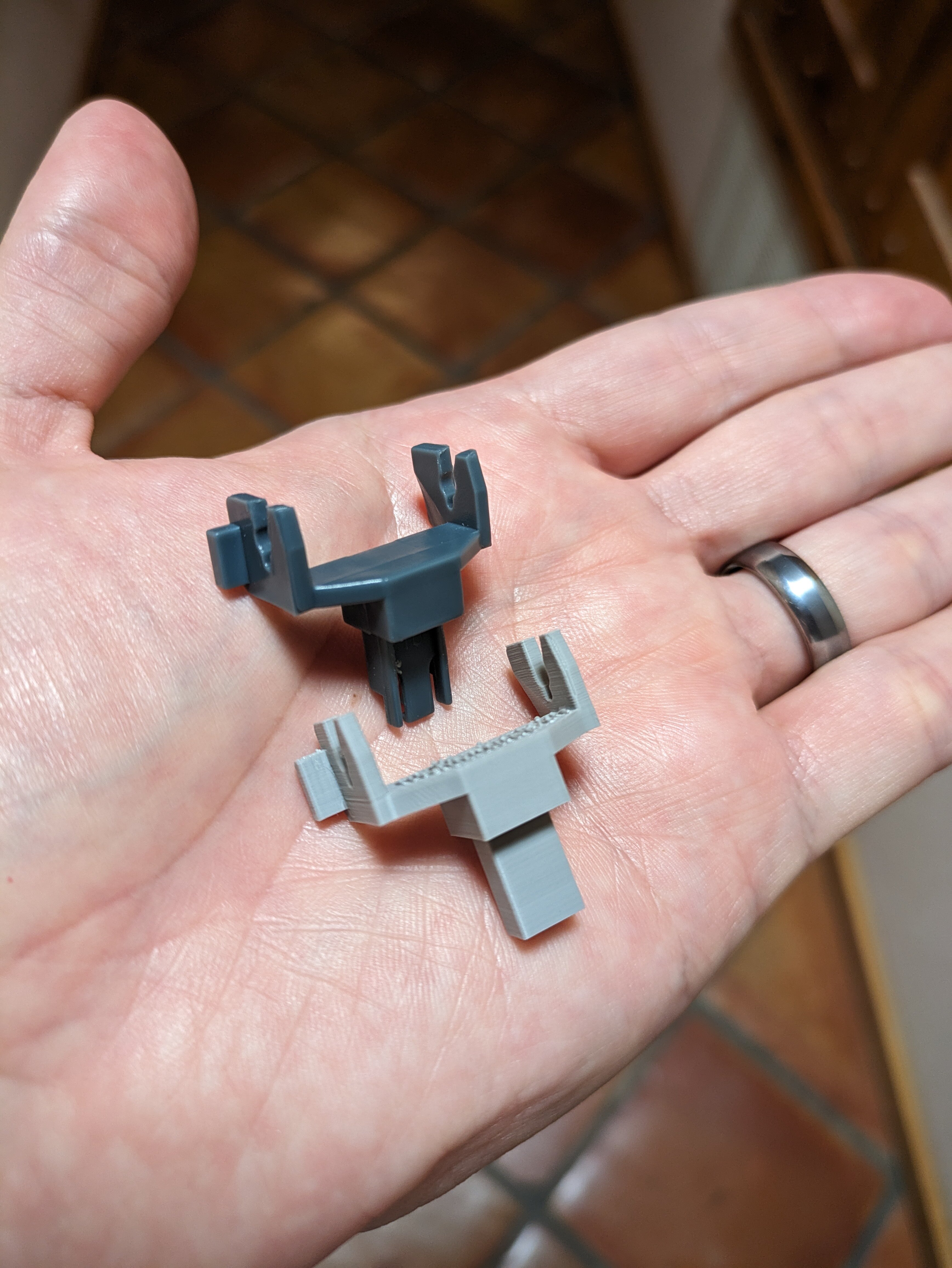

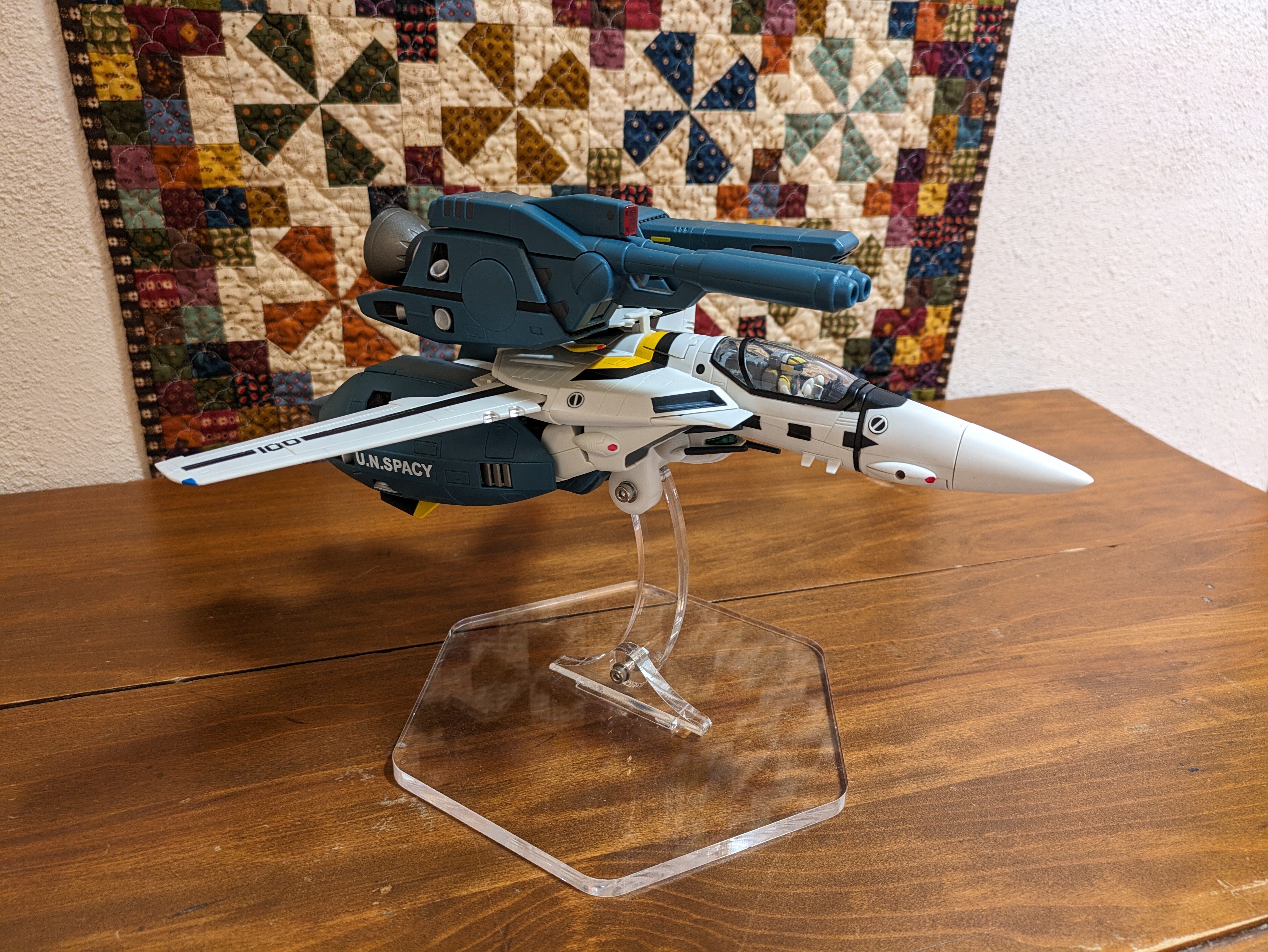

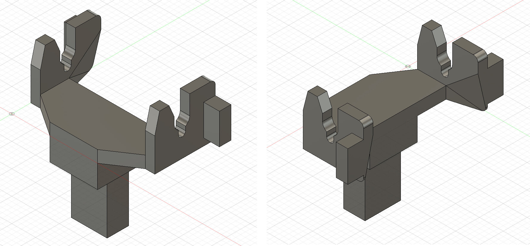

Anasazi37 Posted June 4, 2023 Posted June 4, 2023 As a fun weekend project, I created an adapter for the Yamato 1/48. It closely mirrors the original design. I wanted to start with that and see how it looked. Works well, but the one drawback is that you can't mount the gunpod--it runs smack into the Arcadia A adapter on the stand. I'll spend some time next weekend extending the design to allow for the gunpod in both regular Fighter and Super/Strike. Will also look at making a Battroid adapter. I'm not going to copy Yeti's designs, for the reasons already outlined above, but space and valk part constraints will lead to me making very similar choices. There are only so many ways to make an adapter.... A few design notes. The prototype is printed in PLA, which is not very sturdy. End goal is to print in ABS, but my new printer is being really temperamental about that material and I don't have it dialed in yet. Lots of failures yesterday. Much like Yeti's adapter, I chose to do a straight vertical slot for holding the hip bar in place instead of one that "snaps" the bar in place by closing around it. The latter puts too much strain on the printed adapter. There's just enough friction, based on the slot width I selected, to hold the bar in place, but I'd still avoid barrel rolls. Last, this adapter requires the use of supports when printing, so I tried to orient the part so you won't see the impacted areas. I only did a quick cleanup for this prototype, but you'll see impacted areas in the pictures below. Quote

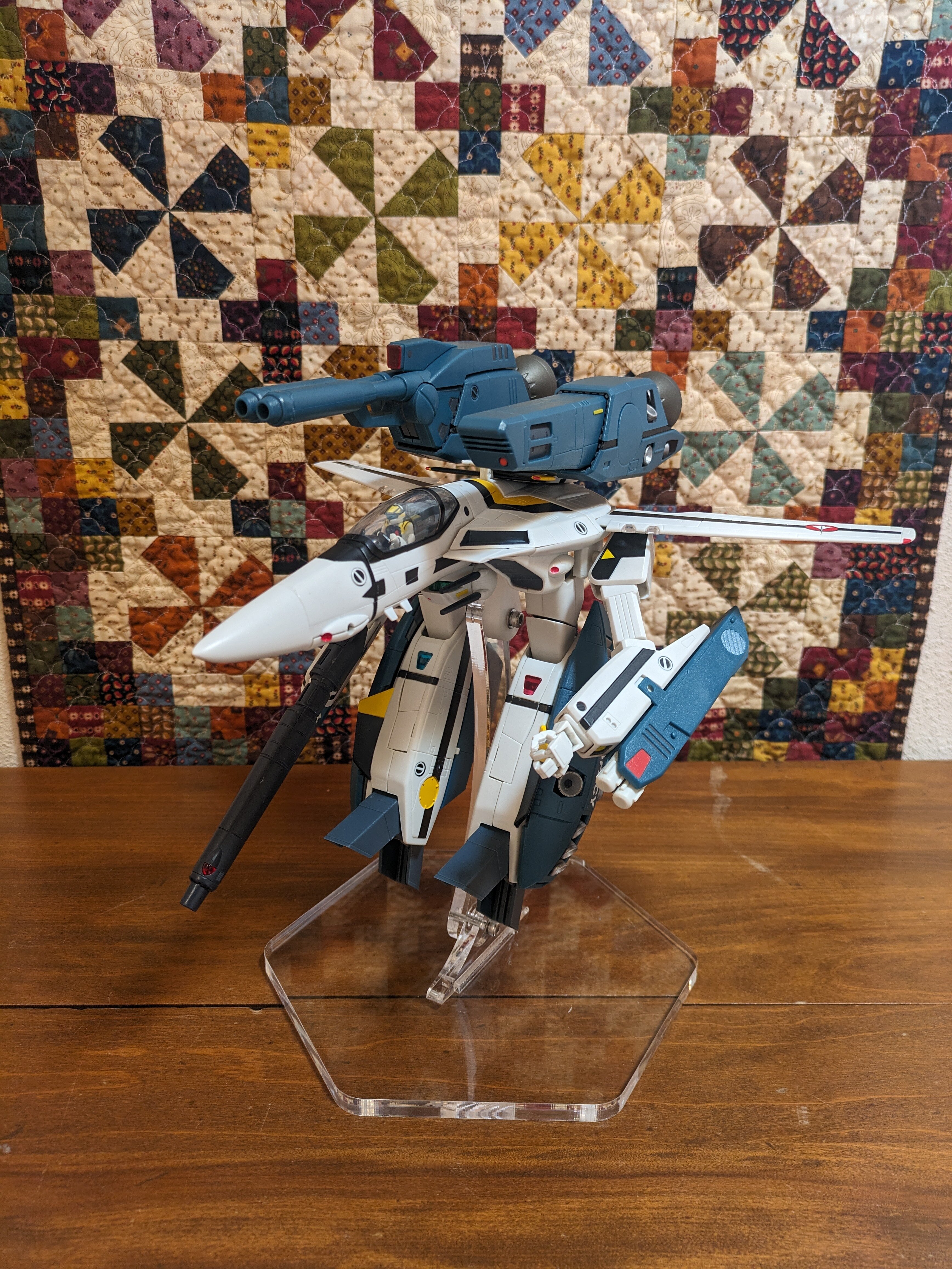

scand Posted June 6, 2023 Posted June 6, 2023 (edited) So the Archii double fit's nicely in a Detolf shelf with the correct angling of your birds. I also tried to capture the Badoolza face melting pose... Edited June 6, 2023 by scand Quote

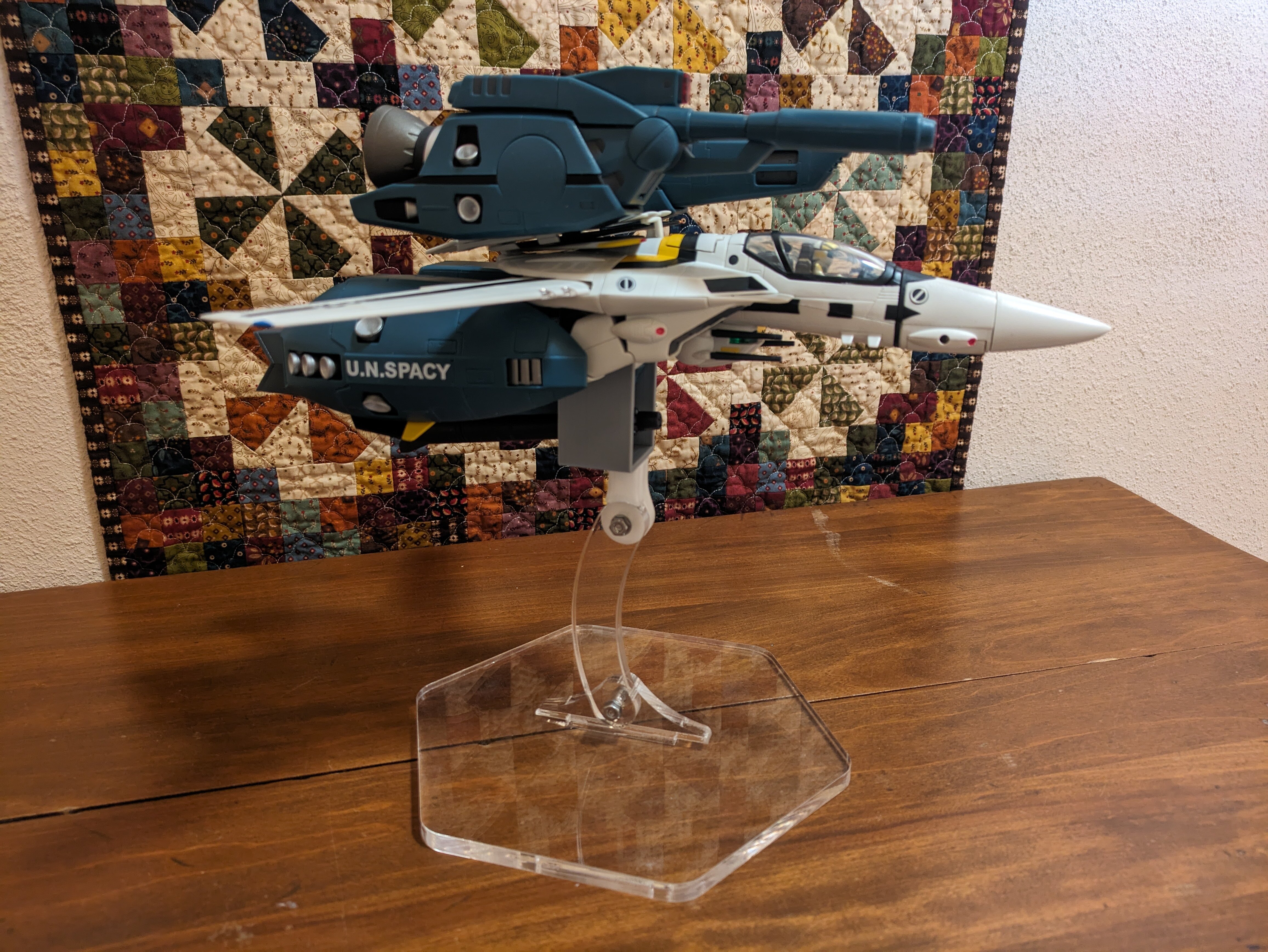

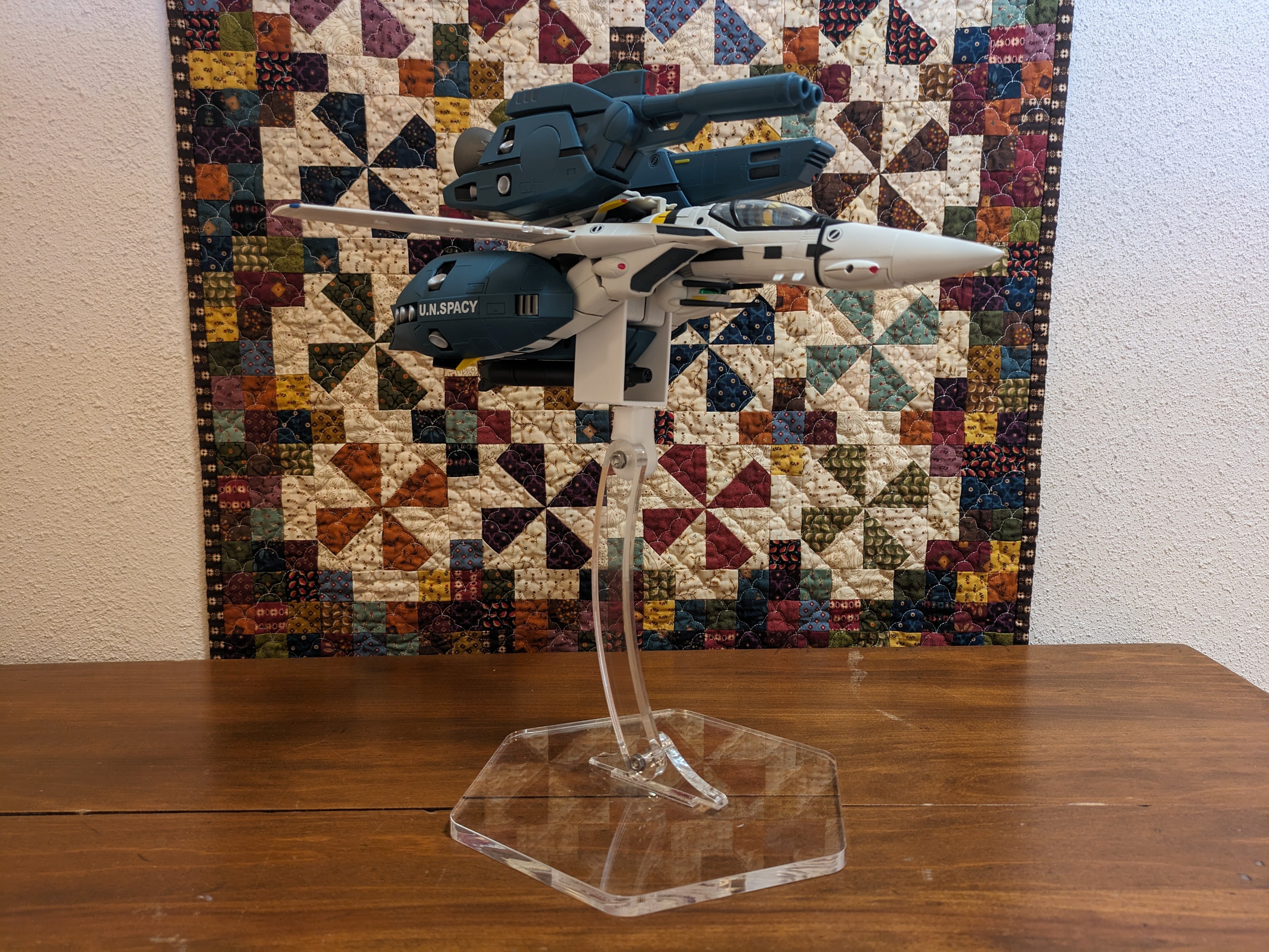

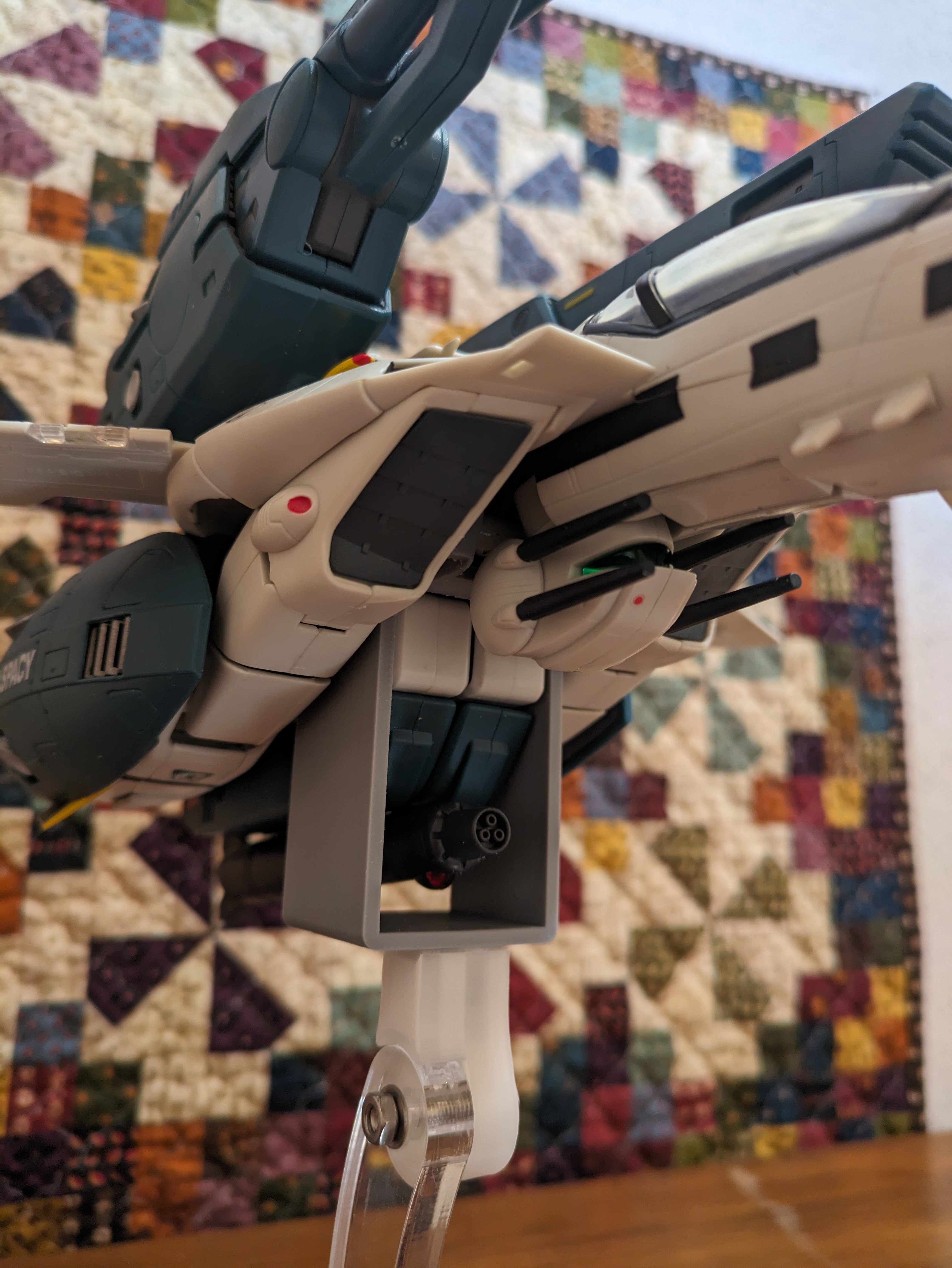

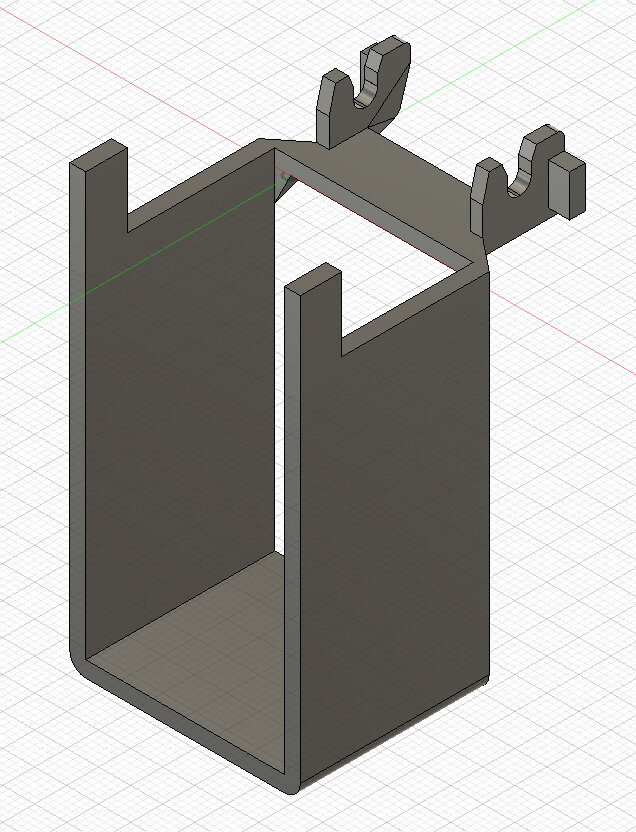

Anasazi37 Posted June 9, 2023 Posted June 9, 2023 End of week update for the Yamato 1/48 adapter project. I've been tweaking the design a little bit each evening, printing multiple prototypes along the way. I think it's pretty close now. Here's the latest version. It takes advantage of the original adapter design and uses it as a low profile anchor point behind the head, but also redistributes the weight of the valk further back (right behind the shoulders) in a way that holds the valk snugly in place without having to do any kind of snap fitting. It simply rests in the adapter. I wouldn't flip it upside down and expect it to stay in place, but other than that, you can do some extreme banking in the display stand and it seems to be rock solid. The tab at the bottom is moved just far enough back from the edge so the front of the adapter sits flush with the Arcadia A adapter when attached. I've been printing the prototypes in ABS for added strength, but you could probably get away with PLA since the adapter isn't subjected to a lot of pressure. I'm thinking about making a shorter version for a valk that doesn't have the armor attached. Adapters for Gerwalk and Battroid are also in the works. Quote
Slave IV Posted June 9, 2023 Posted June 9, 2023 2 hours ago, Anasazi37 said: End of week update for the Yamato 1/48 adapter project. I've been tweaking the design a little bit each evening, printing multiple prototypes along the way. I think it's pretty close now. Here's the latest version. It takes advantage of the original adapter design and uses it as a low profile anchor point behind the head, but also redistributes the weight of the valk further back (right behind the shoulders) in a way that holds the valk snugly in place without having to do any kind of snap fitting. It simply rests in the adapter. I wouldn't flip it upside down and expect it to stay in place, but other than that, you can do some extreme banking in the display stand and it seems to be rock solid. The tab at the bottom is moved just far enough back from the edge so the front of the adapter sits flush with the Arcadia A adapter when attached. I've been printing the prototypes in ABS for added strength, but you could probably get away with PLA since the adapter isn't subjected to a lot of pressure. I'm thinking about making a shorter version for a valk that doesn't have the armor attached. Adapters for Gerwalk and Battroid are also in the works. Looking good! Quote
Reni Posted June 9, 2023 Posted June 9, 2023 4 hours ago, Anasazi37 said: End of week update for the Yamato 1/48 adapter project. I've been tweaking the design a little bit each evening, printing multiple prototypes along the way. I think it's pretty close now. Here's the latest version. It takes advantage of the original adapter design and uses it as a low profile anchor point behind the head, but also redistributes the weight of the valk further back (right behind the shoulders) in a way that holds the valk snugly in place without having to do any kind of snap fitting. It simply rests in the adapter. I wouldn't flip it upside down and expect it to stay in place, but other than that, you can do some extreme banking in the display stand and it seems to be rock solid. The tab at the bottom is moved just far enough back from the edge so the front of the adapter sits flush with the Arcadia A adapter when attached. I've been printing the prototypes in ABS for added strength, but you could probably get away with PLA since the adapter isn't subjected to a lot of pressure. I'm thinking about making a shorter version for a valk that doesn't have the armor attached. Adapters for Gerwalk and Battroid are also in the works. Ah, smart thinking on the super/strike stand adapter vs non super/strike adapter. Very exciting to see these coming along! Quote

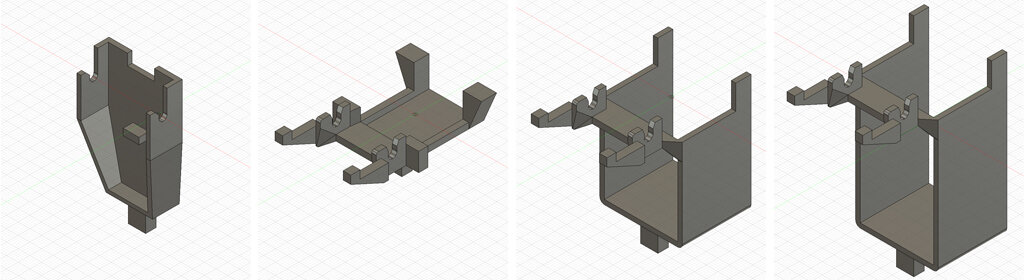

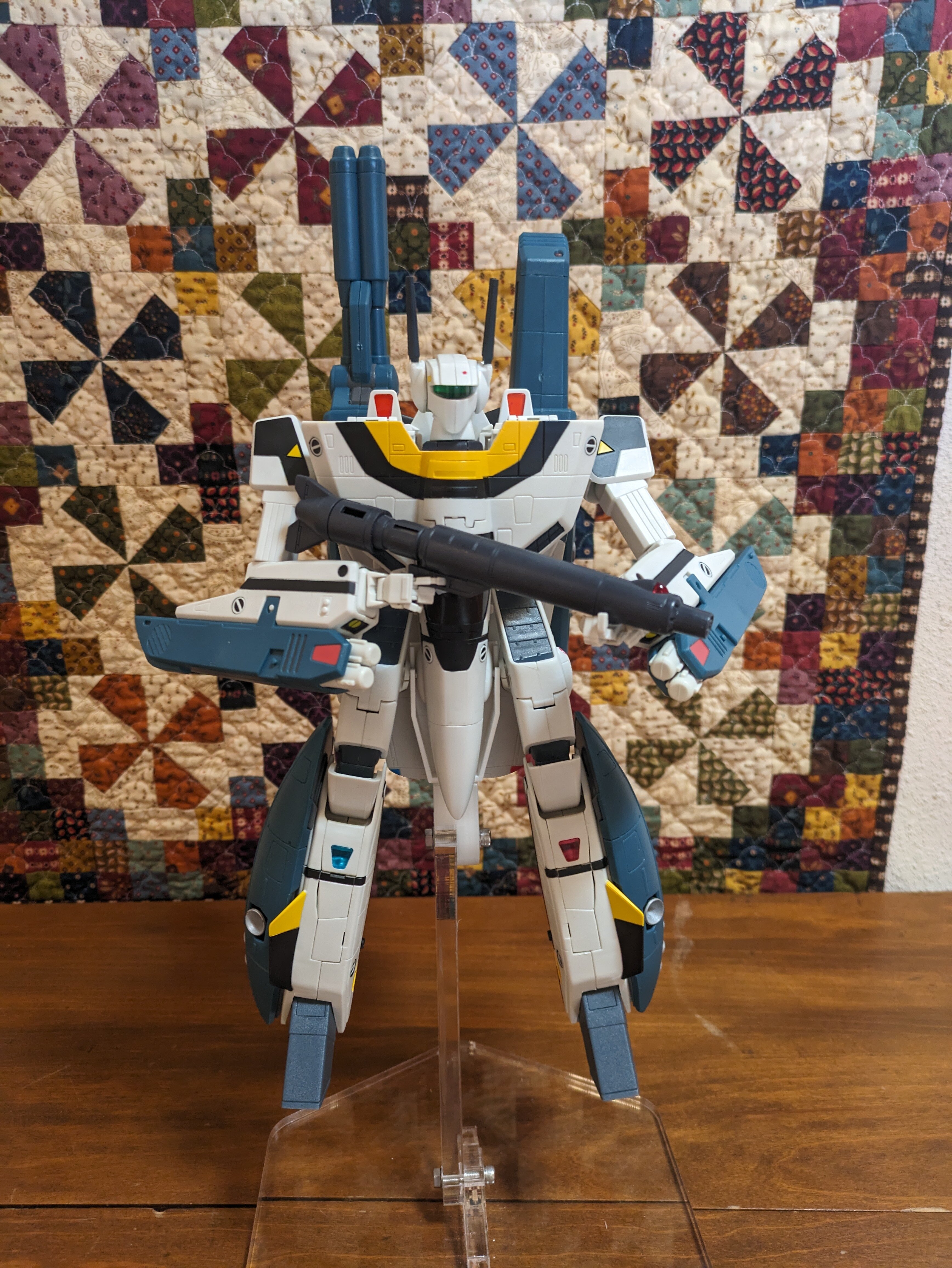

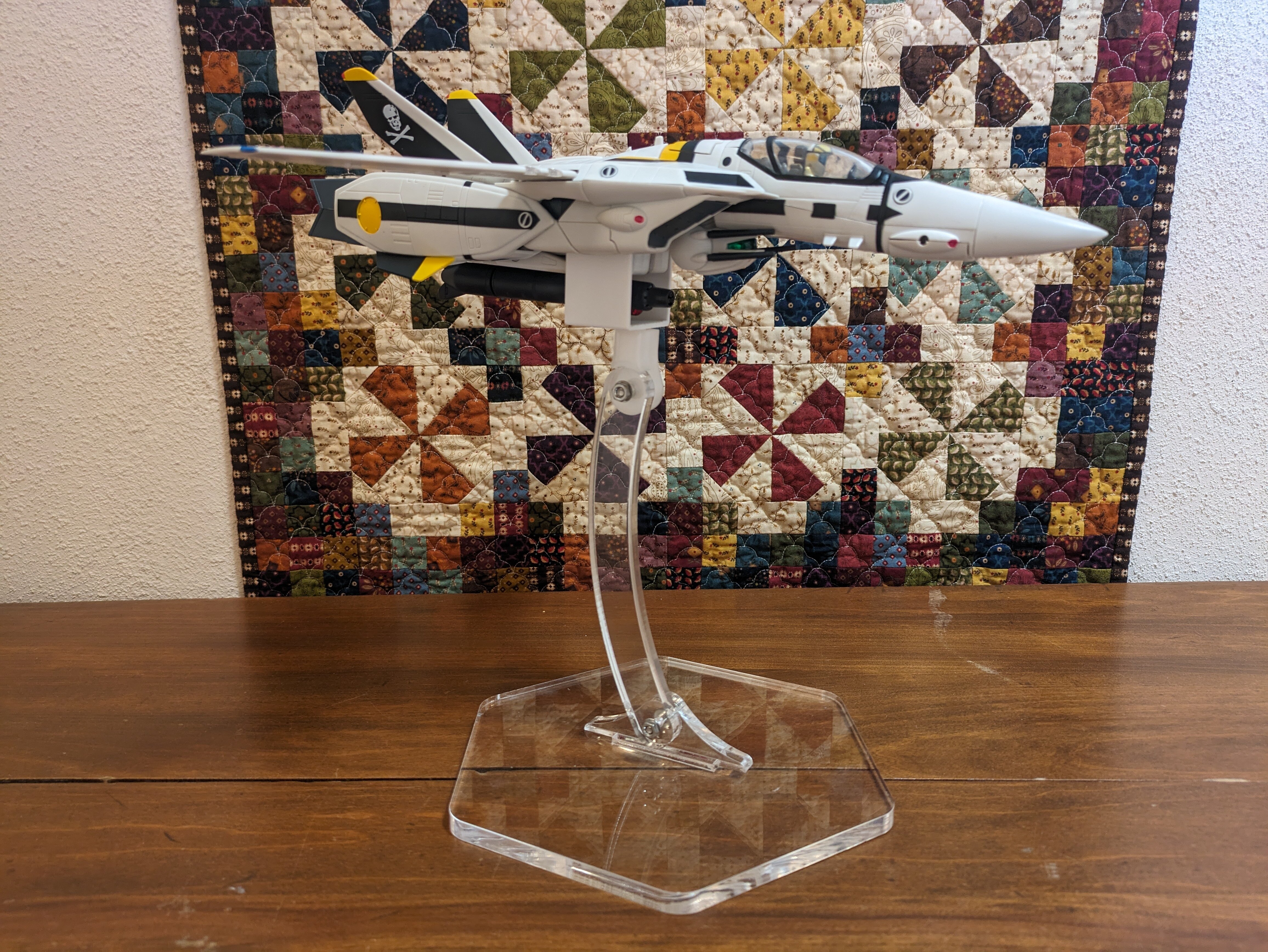

Anasazi37 Posted June 18, 2023 Posted June 18, 2023 Took a week longer than anticipated, but I finished up all four adapters for the Yamato 1/48: Battroid, Gerwalk, Fighter, and Fighter with Super/Strike Parts. The Battroid and Gerwalk adapters work with or without the Super/Strike Parts attached, but separate ones were needed for both Fighter mode variants so you don't end up with a lot of empty space under the gunpod. I printed them in some white PLA that I had on hand because it was much faster for prototyping and tweaking the designs, but grey ABS would be my choice for actual use. I'm still making some small adjustments, but they're looking pretty good now. My goal was to make them as low profile as possible, so you barely know they are there. They are also best thought of cradles because the valk rests in them, but isn't locked into place. You can do some pretty extreme banking poses, though. Quote
Slave IV Posted June 19, 2023 Posted June 19, 2023 3 hours ago, Anasazi37 said: Took a week longer than anticipated, but I finished up all four adapters for the Yamato 1/48: Battroid, Gerwalk, Fighter, and Fighter with Super/Strike Parts. The Battroid and Gerwalk adapters work with or without the Super/Strike Parts attached, but separate ones were needed for both Fighter mode variants so you don't end up with a lot of empty space under the gunpod. I printed them in some white PLA that I had on hand because it was much faster for prototyping and tweaking the designs, but grey ABS would be my choice for actual use. I'm still making some small adjustments, but they're looking pretty good now. My goal was to make them as low profile as possible, so you barely know they are there. They are also best thought of cradles because the valk rests in them, but isn't locked into place. You can do some pretty extreme banking poses, though. Looking good! Will the Battroid adapter work with GBP equipped Valks too? Quote
Anasazi37 Posted June 19, 2023 Posted June 19, 2023 16 minutes ago, Slave IV said: Looking good! Will the Battroid adapter work with GBP equipped Valks too? It might require some modifications. Good thing I have a VF-1J suited up and ready for testing. Quote
Slave IV Posted June 19, 2023 Posted June 19, 2023 3 hours ago, Anasazi37 said: It might require some modifications. Good thing I have a VF-1J suited up and ready for testing. Ah, nice! Look forward to hearing more results. Quote
