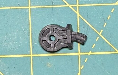

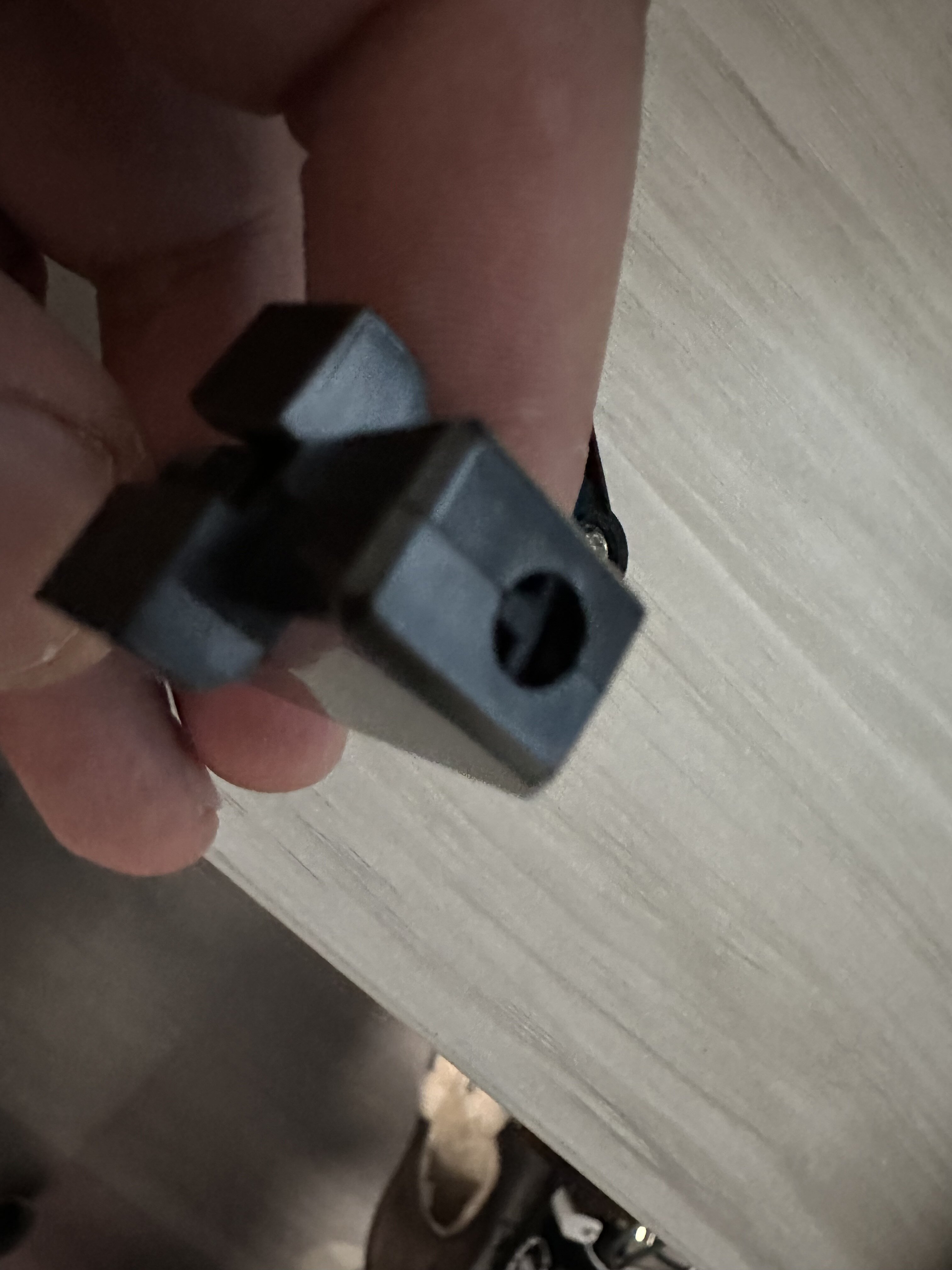

okinawaHAI! Posted October 17, 2023 Posted October 17, 2023 (edited) Sorry folks for the large photo but I am not technically savvy. Depicted on the photo (circled in red) is the plastic piece in question. I own two Mospeada Riders but reluctant to transform or pose them because of this issue. Some have commented that the connector point arrived to them with stress marks, new in packaging. The submitted photo is not my own but credited to Jenius who submitted it on this forum. -Regards Edited October 17, 2023 by okinawaHAI! typo and grammer Quote
m0n5t3r Posted October 17, 2023 Posted October 17, 2023 27 minutes ago, okinawaHAI! said: Sorry folks for the large photo but I am not technically savvy. Depicted on the photo (circled in red) is the plastic piece in question. I own two Mospeada Riders but reluctant to transform or pose them because of this issue. Some have commented that the connector point arrived to them with stress marks, new in packaging. The submitted photo is not my own but credited to Jenius who submitted it on this forum. -Regards Note sure if anybody's mentioned this, but it may be worth noting that the VR-038L uses a different, wholly solid pin for that connection (compared to the hollow, rolled metal pin on the first 3 VRs). That may have been the fix for that issue. 🤷♂️ Quote

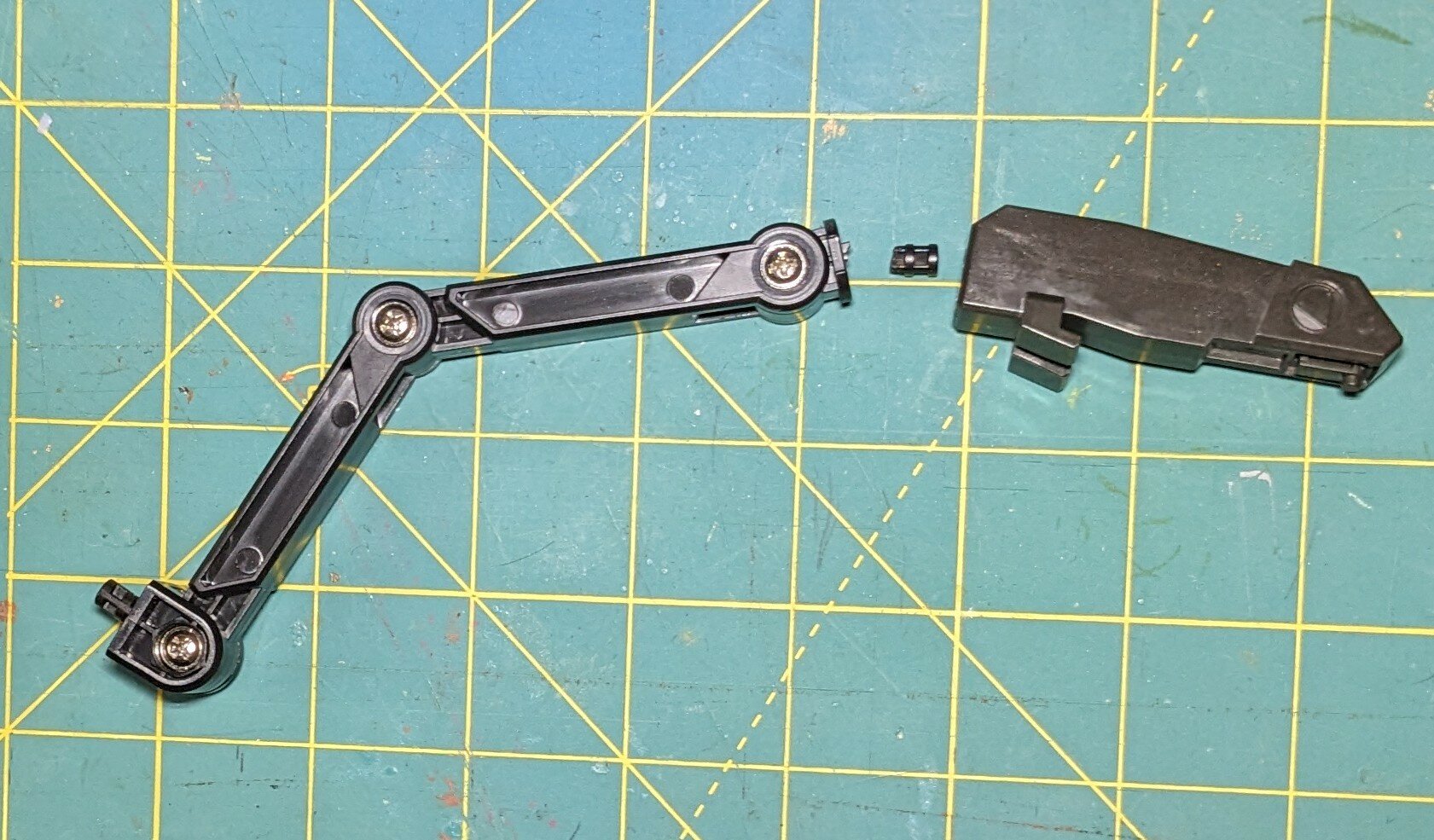

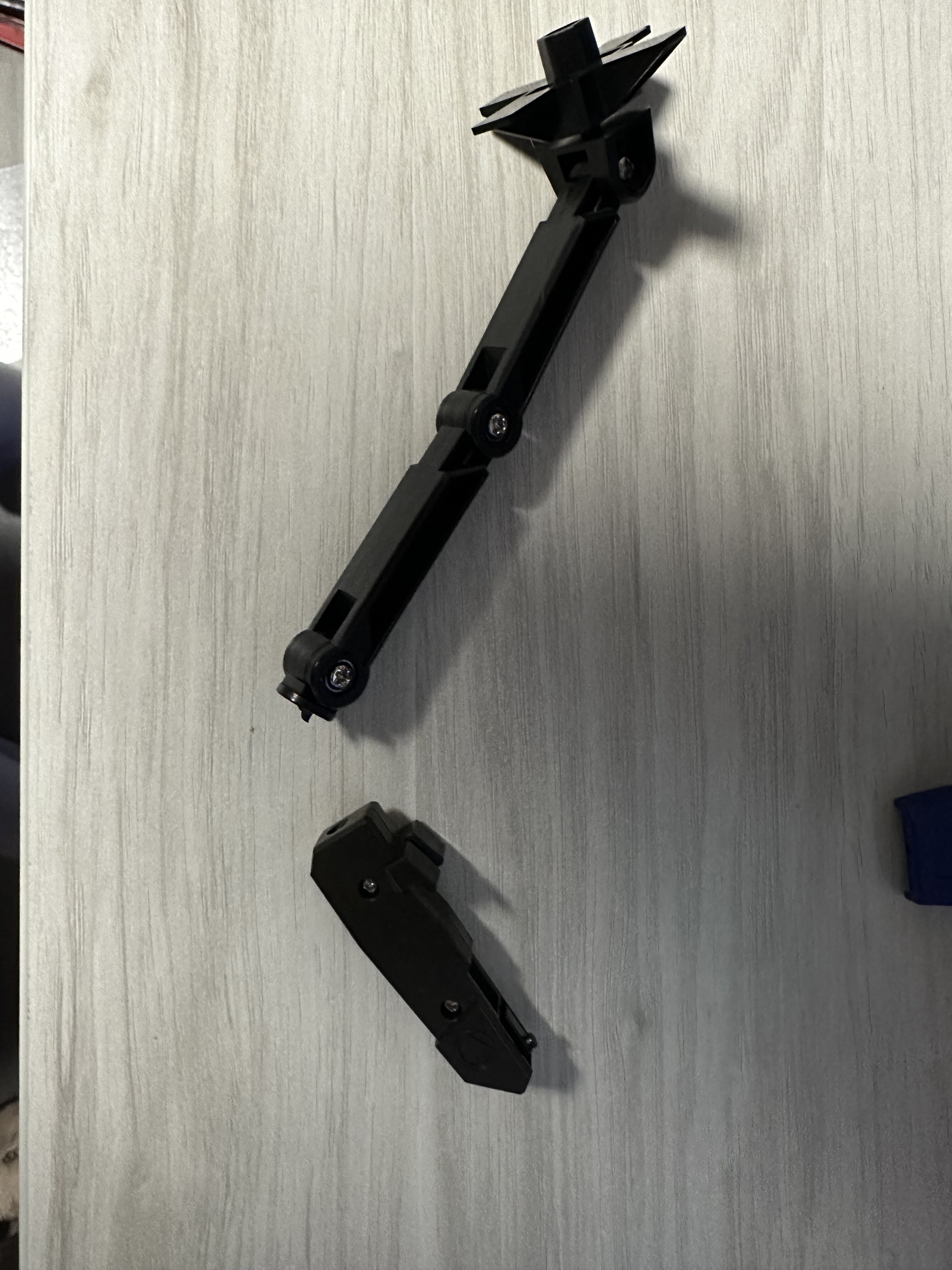

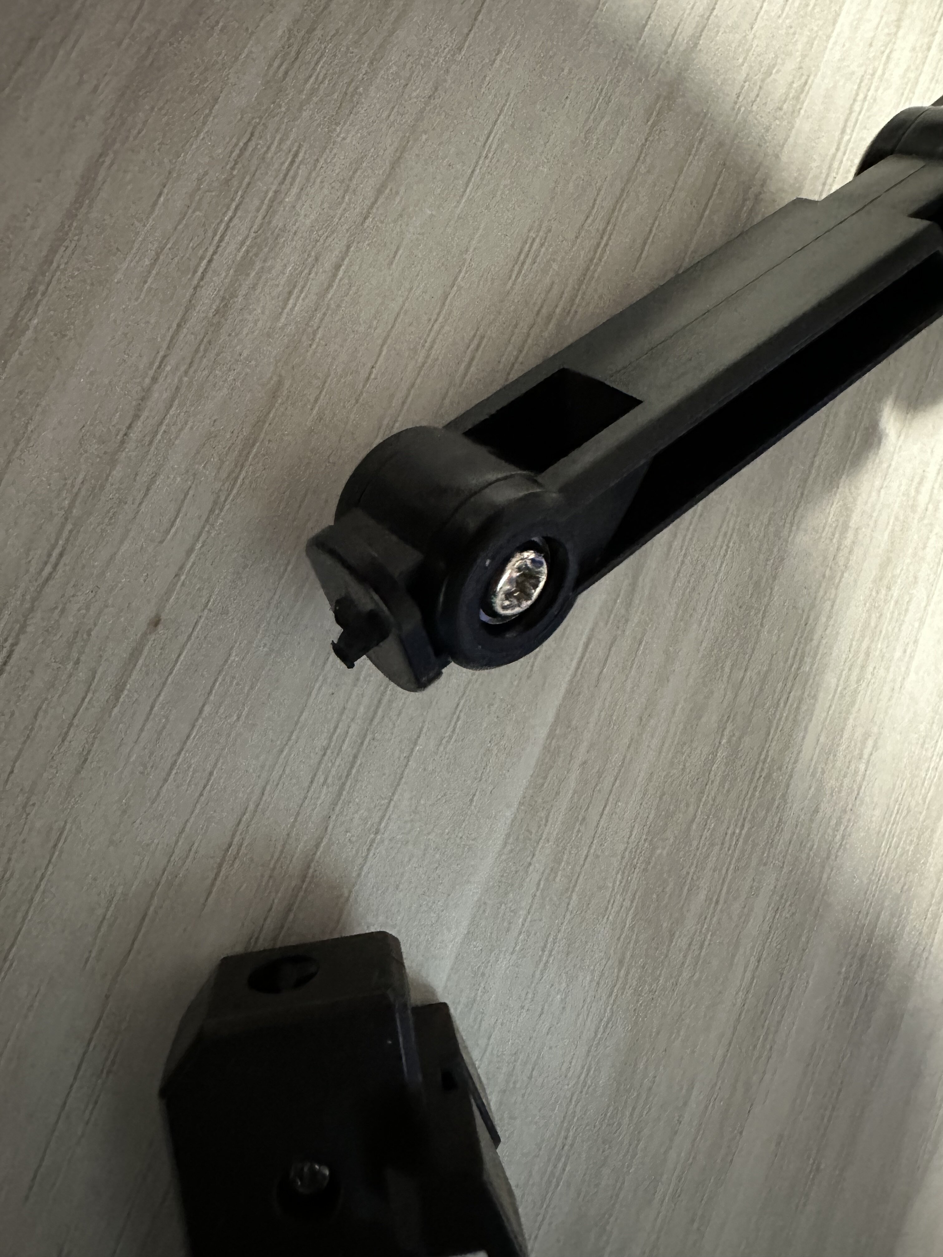

Sandman Posted October 21, 2023 Posted October 21, 2023 Anyone know if Sentinel offers spare parts? My Legios stand arm snapped. Or any other place? Quote
magicsp00n Posted October 22, 2023 Posted October 22, 2023 23 hours ago, Sandman said: Anyone know if Sentinel offers spare parts? My Legios stand arm snapped. Or any other place? Mine too! Too much leverage on the little peg in fighter mode. Quote
jenius Posted October 22, 2023 Posted October 22, 2023 You guys have pictures? Sadly, I just broke a tab off an Arcadia Vf-1 hip using their trouble fighter mode display stands adapters... Grrr. Quote
magicsp00n Posted October 23, 2023 Posted October 23, 2023 On 10/21/2023 at 10:43 PM, jenius said: You guys have pictures? Here's mine. They should have had the peg go up into the bottom of the cradle rather than the back end there. I tried 3D printing up a replacement part but the weight of the fighter bent the resin peg down after only a few hours... Quote
mechaninac Posted October 23, 2023 Posted October 23, 2023 (edited) 1 hour ago, magicsp00n said: Here's mine. They should have had the peg go up into the bottom of the cradle rather than the back end there. I tried 3D printing up a replacement part but the weight of the fighter bent the resin peg down after only a few hours... That's actually an easy fix. Use Plastic Cement (Tenax, Ambroid, Tamyia, the stuff used to bond PVC pipes from a hardware store, etc... anything that will melt ABS, Acrylic, PVC and the like - a small drop is all you need. NEVER USE CA glue; it does not work in these applications and looks ugly as all hell afterwards) to bond the broken peg back on the stand arm's base; once cured, carefully drill a hole through the peg into the knuckle, longitudinally, to add a pin to reinforce the whole thing. If done properly, you'll hardly be able to tell it snapped at all, and it will be stronger than it ever was. Edited October 24, 2023 by mechaninac Quote
magicsp00n Posted October 24, 2023 Posted October 24, 2023 (edited) 2 hours ago, mechaninac said: That's actually an easy fix. Use Plastic Cement (Tenax, Ambroid, Tamyia, the stuff used to bond PVC pipes from a hardware store, etc... anything that will melt ABS, Acrylic, PVC and the like - a small drop is all you need. NEVER USE CA glue; it does not work in these applications and looks ugly as all hell afterwards) to bond the broken peg back on the stand arm's base; once cured, carefully drill a hole through the peg into the knuckle, longitudinally, to add a pin to reinforce the whole thing. If done properly, you'll hardly be able to tell it snapped at all, and it will be stronger than it ever was. Unfortunately I tried a couple types of solvent (Plastruct Plastic Weld, Weld-On #4) and it didn't work. I think maybe the piece is maybe some kind of nylon? And I actually did try running a nail through the length of my 3D-printed part and it still bent. Bananas, huh? Edited October 24, 2023 by magicsp00n Quote
Sandman Posted October 24, 2023 Posted October 24, 2023 On 10/21/2023 at 7:43 PM, jenius said: You guys have pictures? Sadly, I just broke a tab off an Arcadia Vf-1 hip using their trouble fighter mode display stands adapters... Grrr. Quote
m0n5t3r Posted October 24, 2023 Posted October 24, 2023 On 10/21/2023 at 8:34 AM, Sandman said: Anyone know if Sentinel offers spare parts? My Legios stand arm snapped. Or any other place? You can try emailing them (Sentinel International). I emailed them earlier this year about my missing intake cover. They mailed it to me for free. Quote
mechaninac Posted October 24, 2023 Posted October 24, 2023 3 hours ago, magicsp00n said: Unfortunately I tried a couple types of solvent (Plastruct Plastic Weld, Weld-On #4) and it didn't work. I think maybe the piece is maybe some kind of nylon? And I actually did try running a nail through the length of my 3D-printed part and it still bent. Bananas, huh? That is indeed unfortunate; 99 out of 100 times the trick I elaborated, and you apparently tried, works like gangbusters... bummer. I'd be curious to know what kind of plastic they used for the darned thing; it has to be something outside the styrene family or anything remotely close. Quote
jenius Posted October 24, 2023 Posted October 24, 2023 It seems like a part that can be drilled out and replaced with a metal dowel if you could find one of the right diameter. Really good to know about this issue though, seems like it will be a widespread thing. Quote
Sandman Posted October 24, 2023 Posted October 24, 2023 2 hours ago, m0n5t3r said: You can try emailing them (Sentinel International). I emailed them earlier this year about my missing intake cover. They mailed it to me for free. Thanks i'll give it a try. Quote
Chronocidal Posted October 24, 2023 Posted October 24, 2023 10 hours ago, jenius said: It seems like a part that can be drilled out and replaced with a metal dowel if you could find one of the right diameter. Really good to know about this issue though, seems like it will be a widespread thing. I was going to suggest the same, though the length of shaft you can use is limited by the screw mounting the part. I think it should still have plenty of depth for the strength necessary though. Quote
Sandman Posted October 24, 2023 Posted October 24, 2023 15 hours ago, m0n5t3r said: You can try emailing them (Sentinel International). I emailed them earlier this year about my missing intake cover. They mailed it to me for free. They actually replies to me already. They asked me for a screenshot of a receipt. It's looking like they might replace this for me. Awesome. Thanks again. Quote
