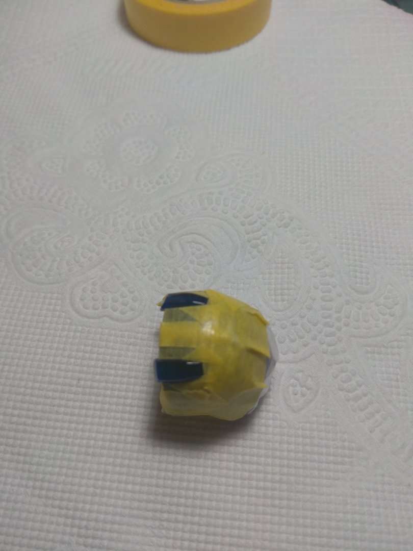

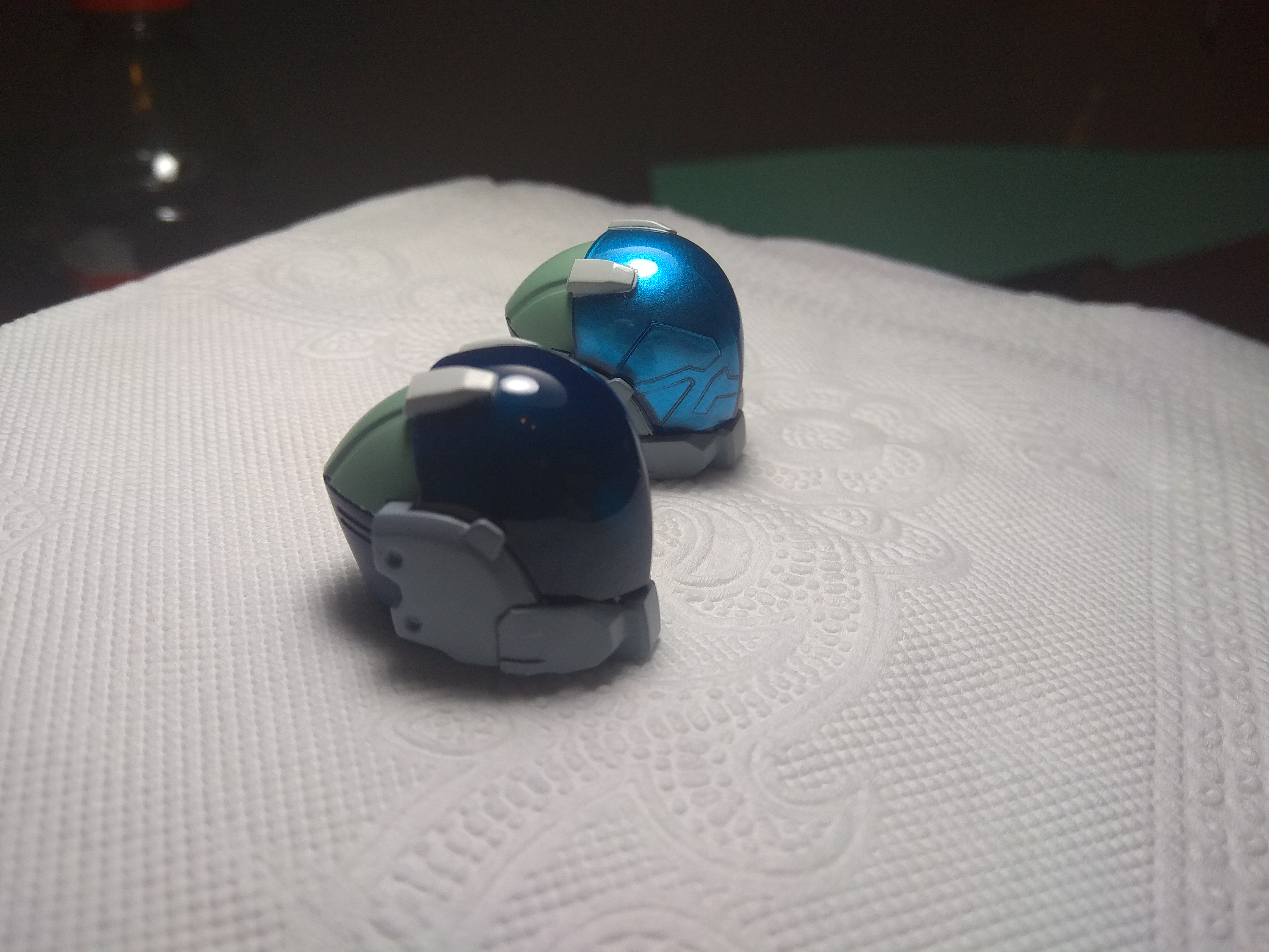

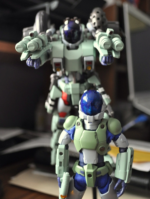

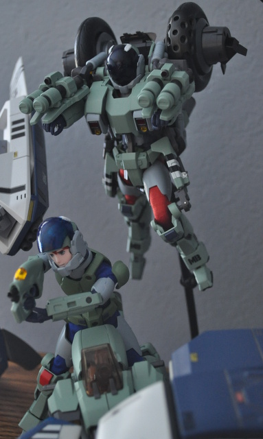

Snake Eyes Posted July 17, 2018 Posted July 17, 2018 (edited) On 5/19/2018 at 2:15 AM, Mog said: Second attempt on the visor (this time with Ray). Got the translucent look down now. Hopefully, the third attempt will be using Tamiya clear green instead. Until Yellow and Houquet get released, this will be the Stick and Ray combo display section. the visor paint... so paint on the outside... did you paint with clear then smoke? brush or airbrush? did you mask off the "visor clips" with tape first or just paint around it? Also... will 90% isopropyl Alcohol work for cleaning off the paint or will this damage the visor? Edited July 17, 2018 by Snake Eyes Quote

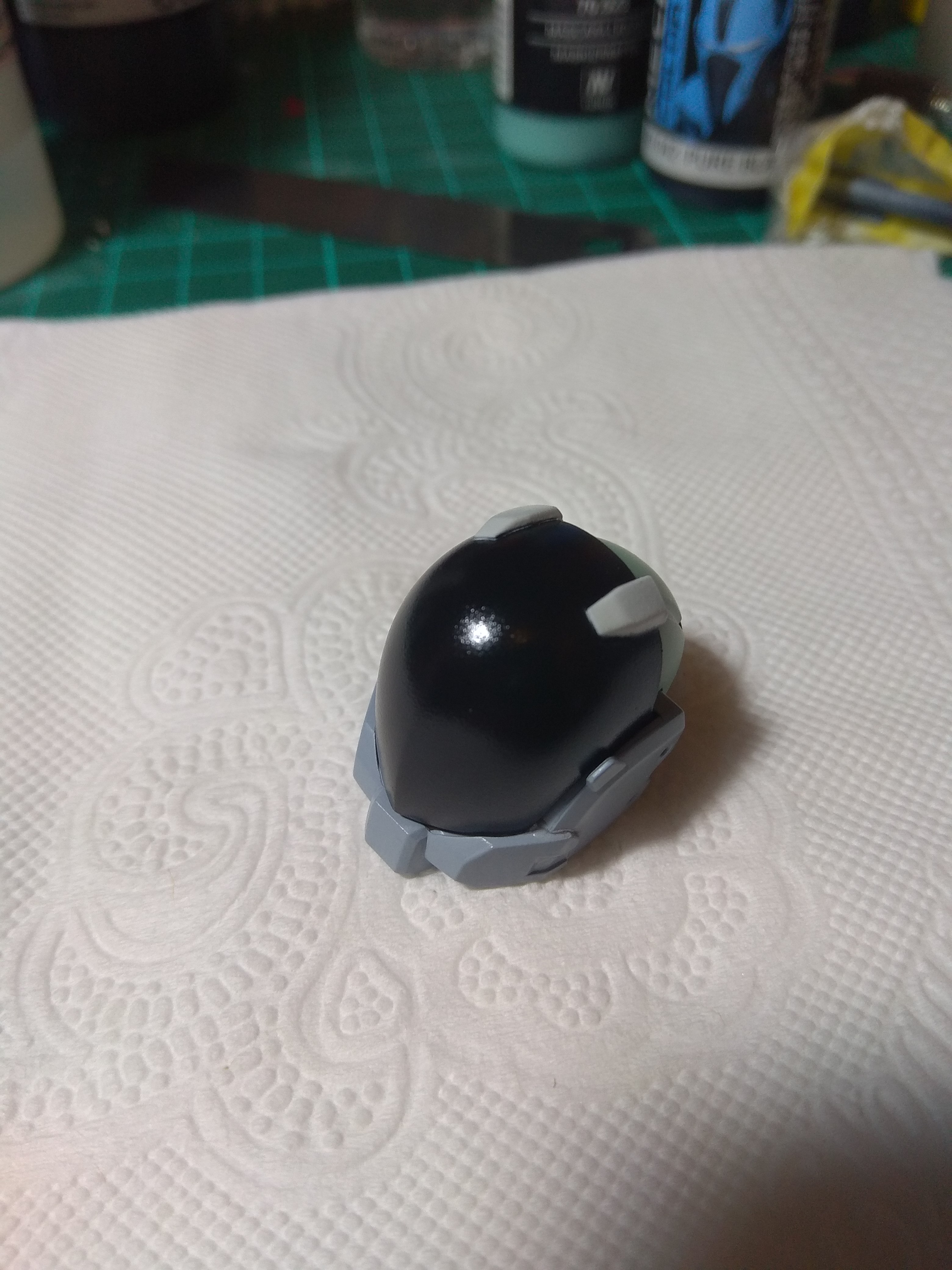

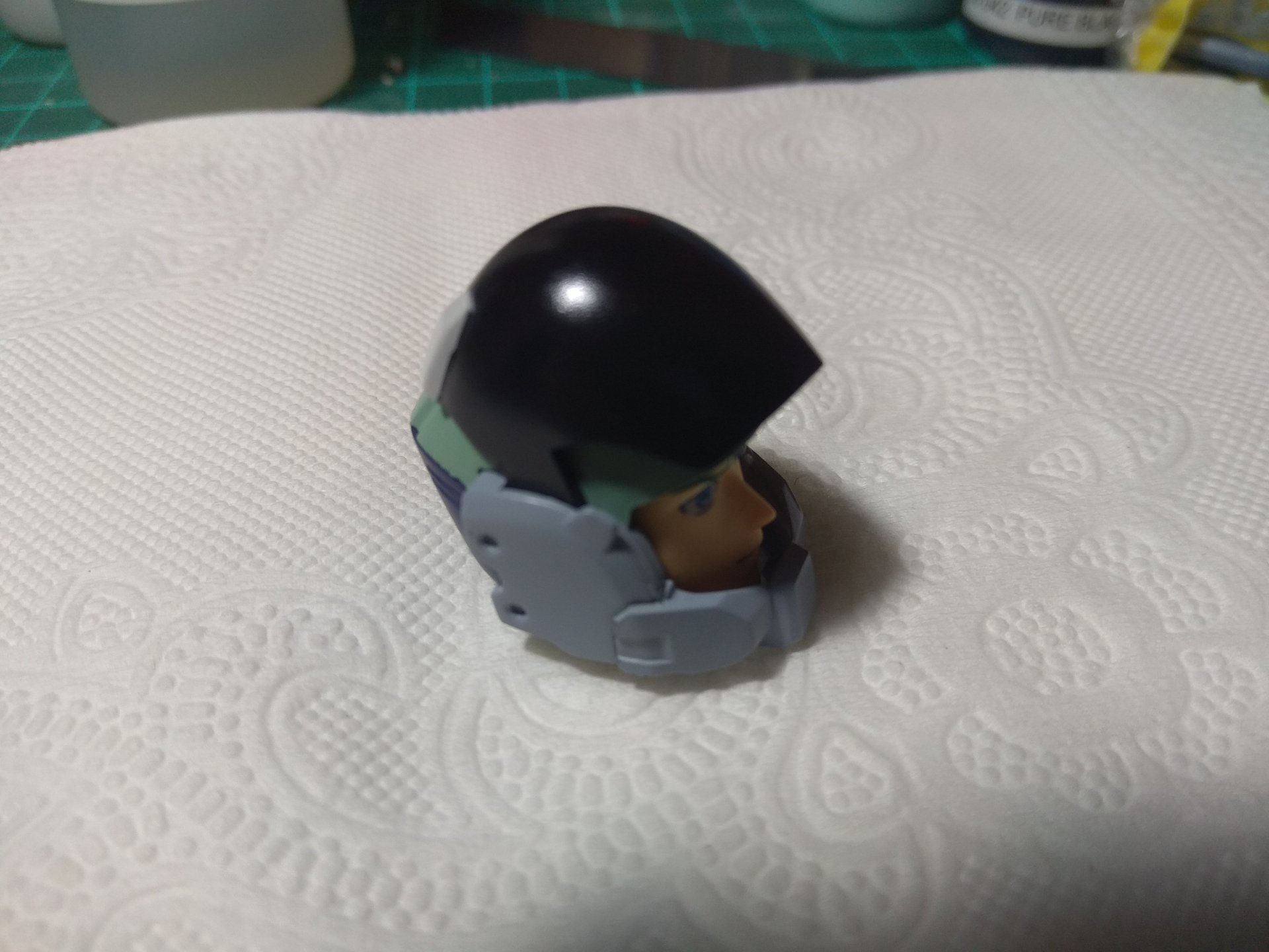

EmilianoAlfaro Posted July 17, 2018 Posted July 17, 2018 I just painted it black. Be careful to use thinner paints, as it eats plastic. To remove the gray metallic paint I used ethyl alcohol, I did not try with isopropyl because it could affect the plastic. With Ray's, try a combination of Clear Blue and Clear smoke with an airbrush. Quote

Mog Posted July 18, 2018 Posted July 18, 2018 15 hours ago, Snake Eyes said: the visor paint... so paint on the outside... did you paint with clear then smoke? brush or airbrush? did you mask off the "visor clips" with tape first or just paint around it? Also... will 90% isopropyl Alcohol work for cleaning off the paint or will this damage the visor? * As I've said in earlier posts, start with the Tamiya Smoke, then go with the Tamiya Clear Blue. Make sure you're painting against a white background, as it'll help you judge just how dark the smoke is being applied. If you're going to make a mistake, err on the side of applying not enough smoke. If you still want to see the face behind the visor, you'll definitely want to go light with painting the Tamiya Smoke. * Most folks here would recommend using an airbrush, rather than a standard paint brush. If you must use a paint brush, I cannot stress enough how difficult the Tamiya clears are to brush paint with. I've painted tons of custom figures over the years, and I still found the Tamiyas difficult as hell to work with. * Regarding the visor clips, I'm assuming you mean the white bits on top of the visor, correct? I tried my best to paint around and avoid them. They're just too small to tape over. After the Tamiya paints dried, I just went over those bits and touched them up with some white paint. Quote

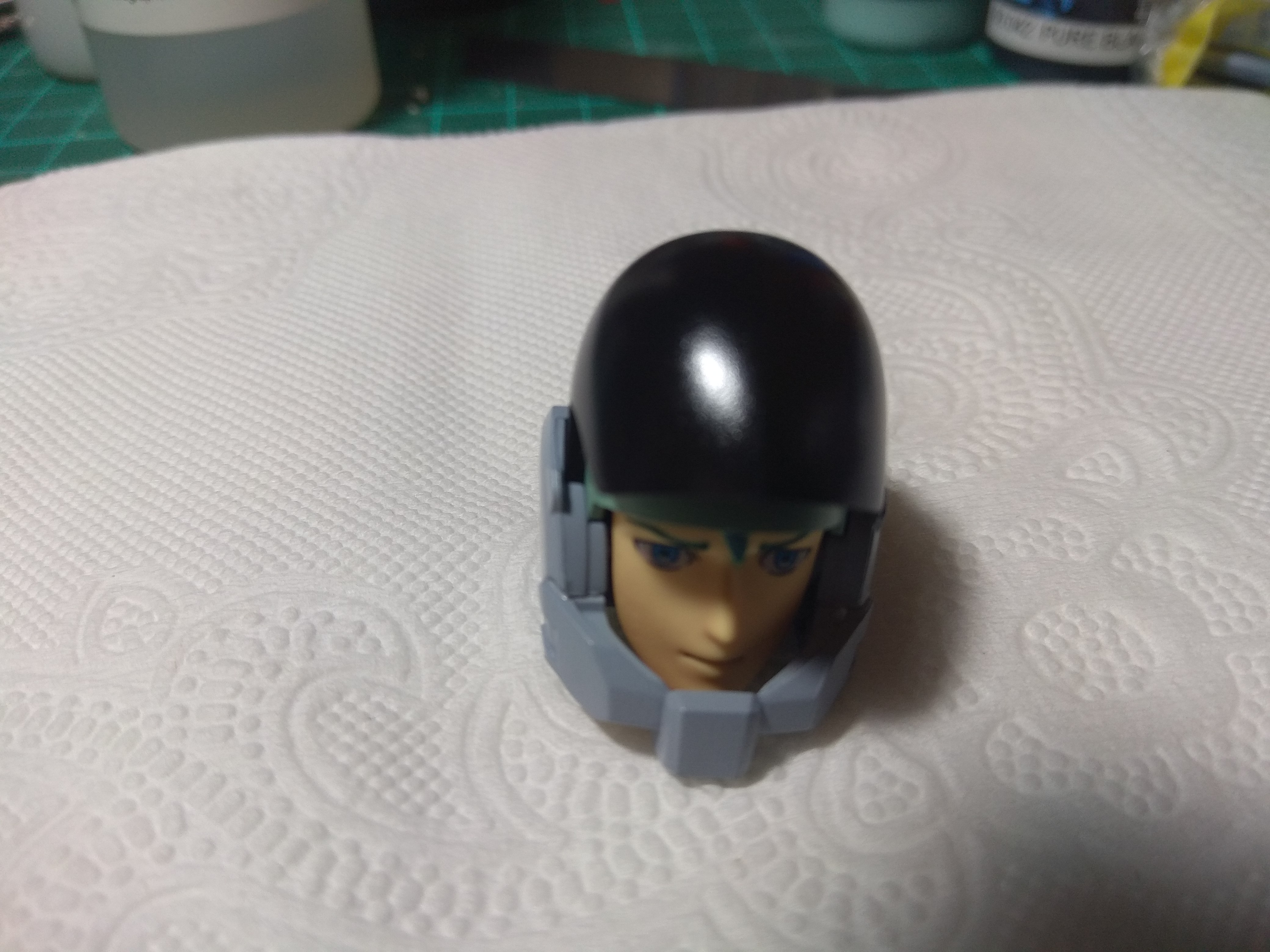

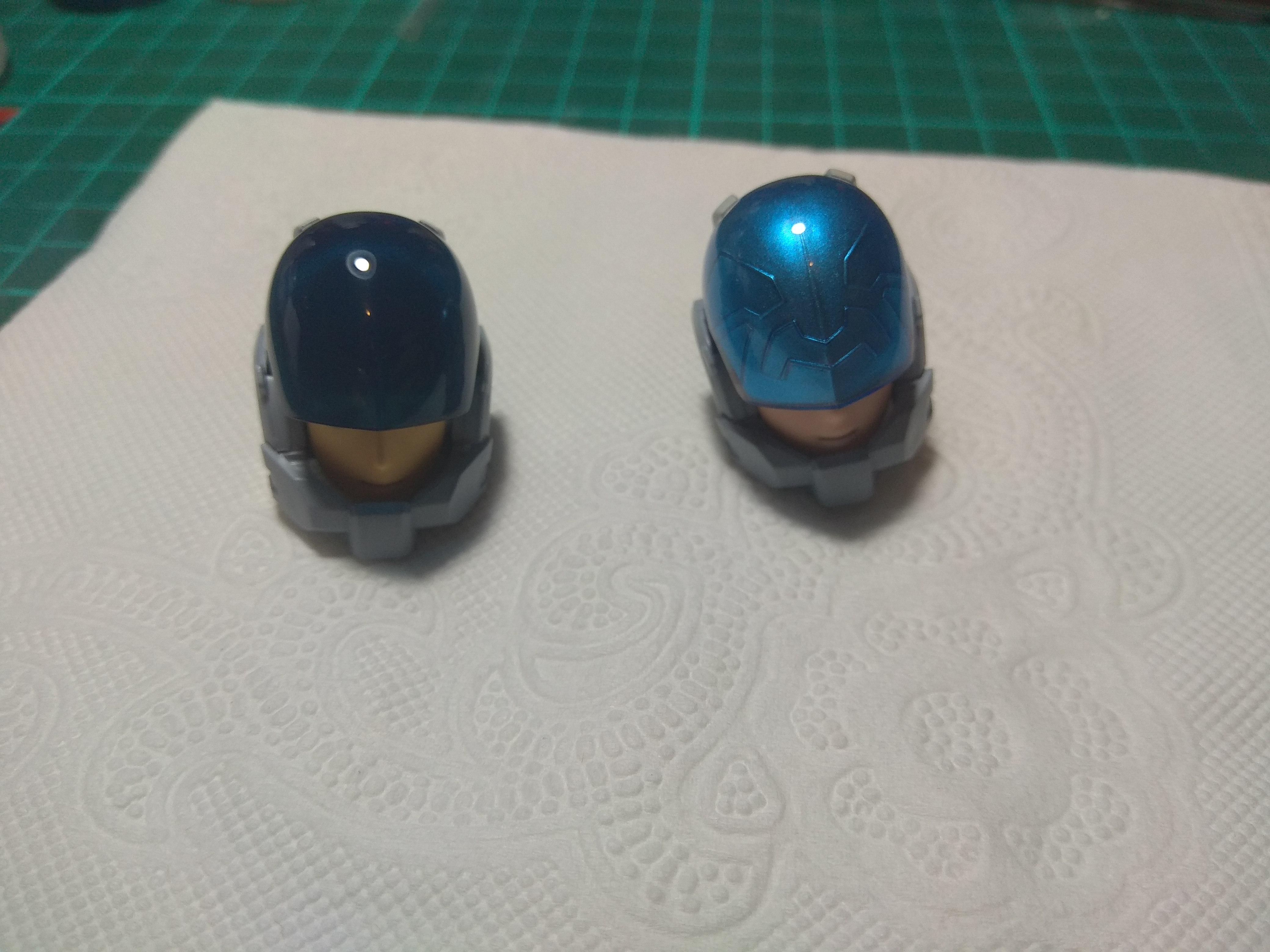

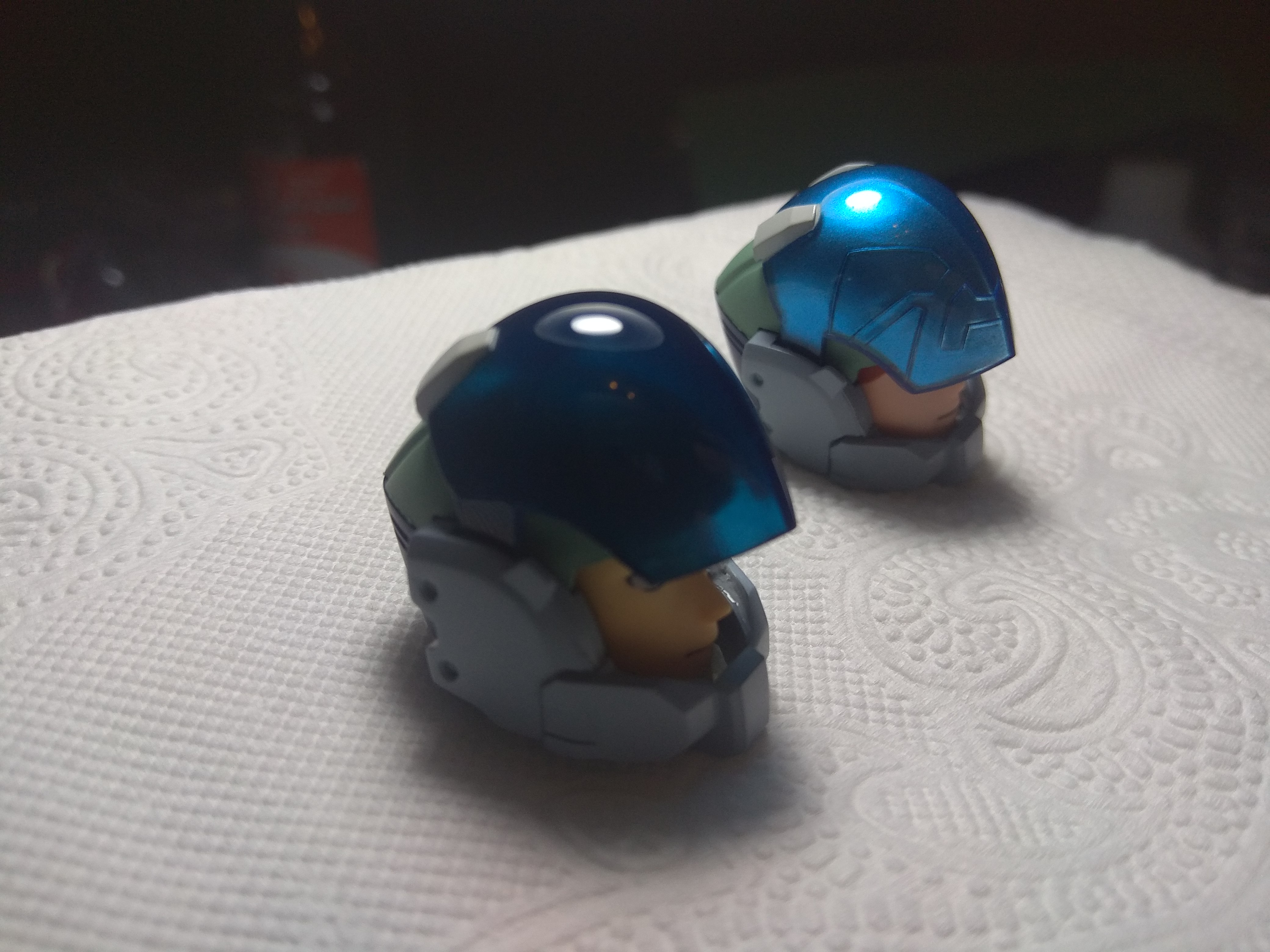

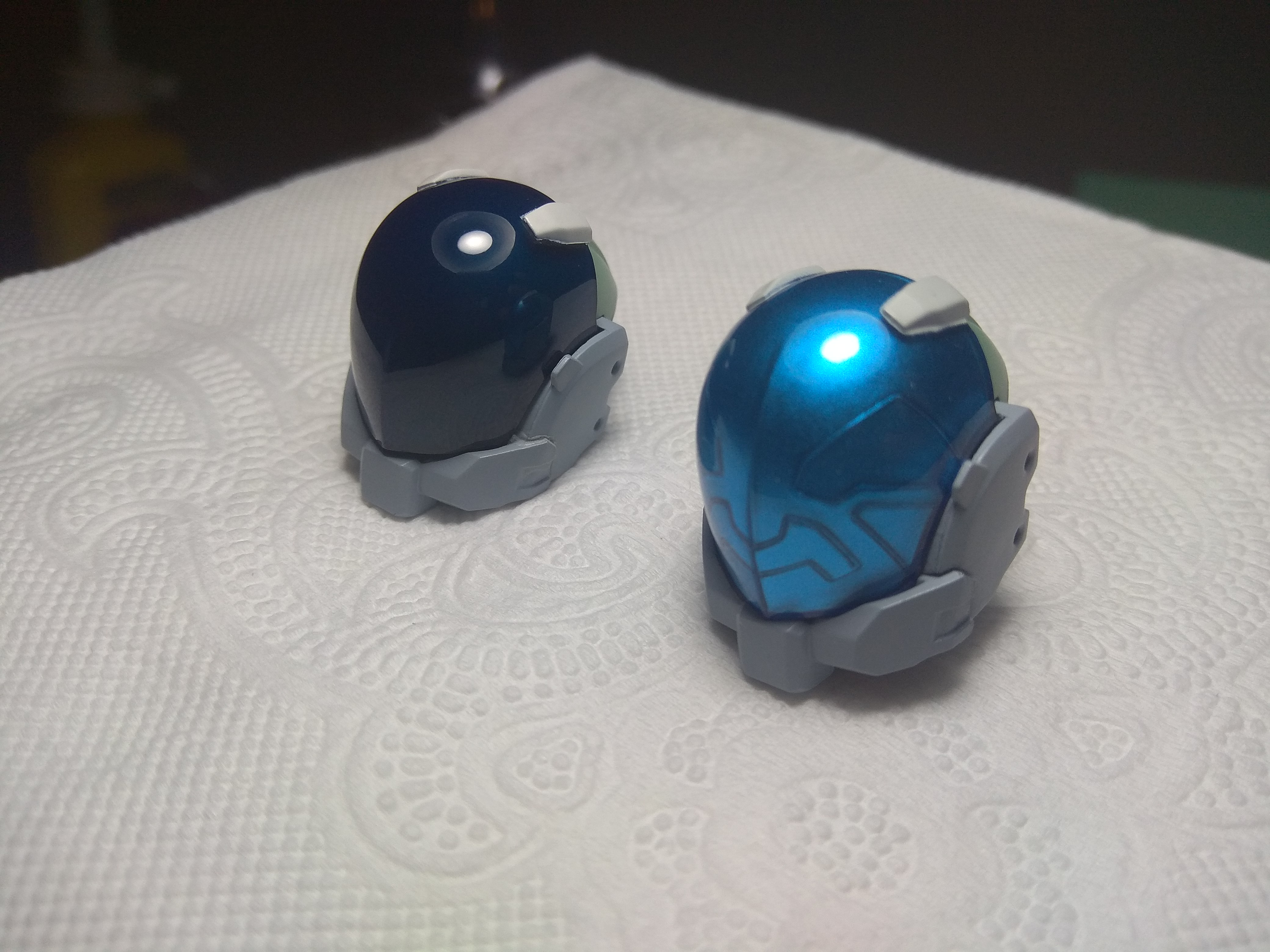

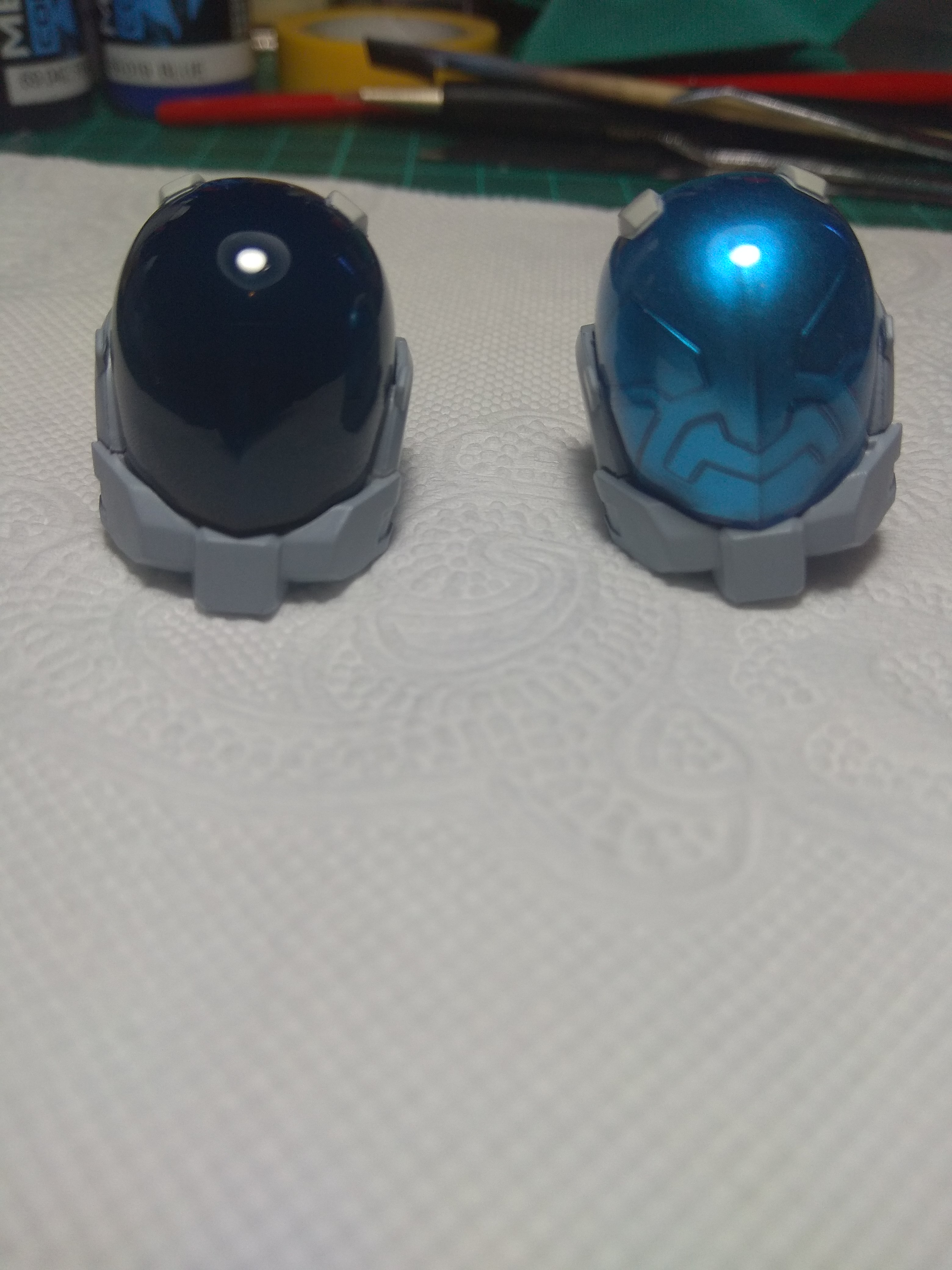

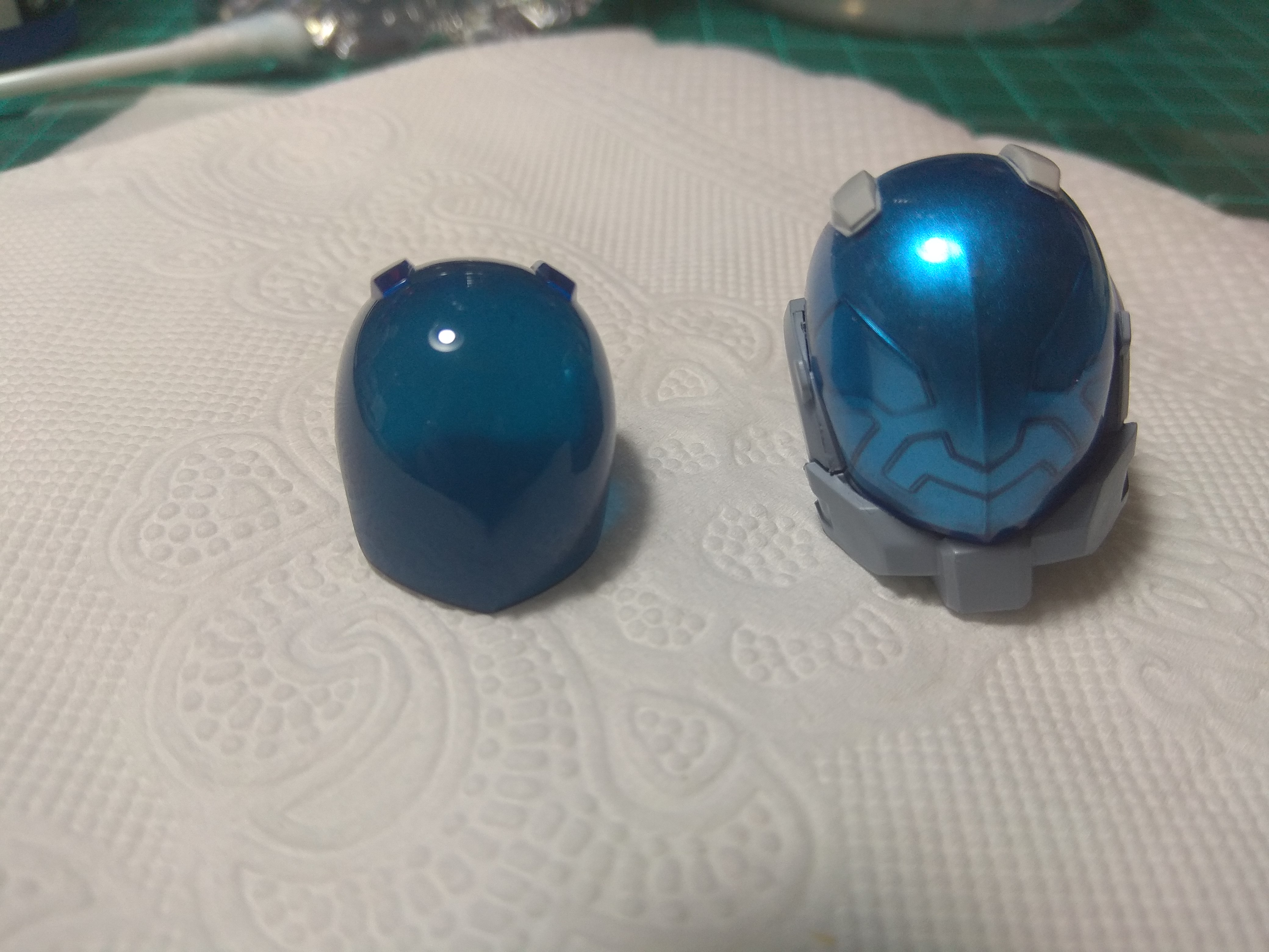

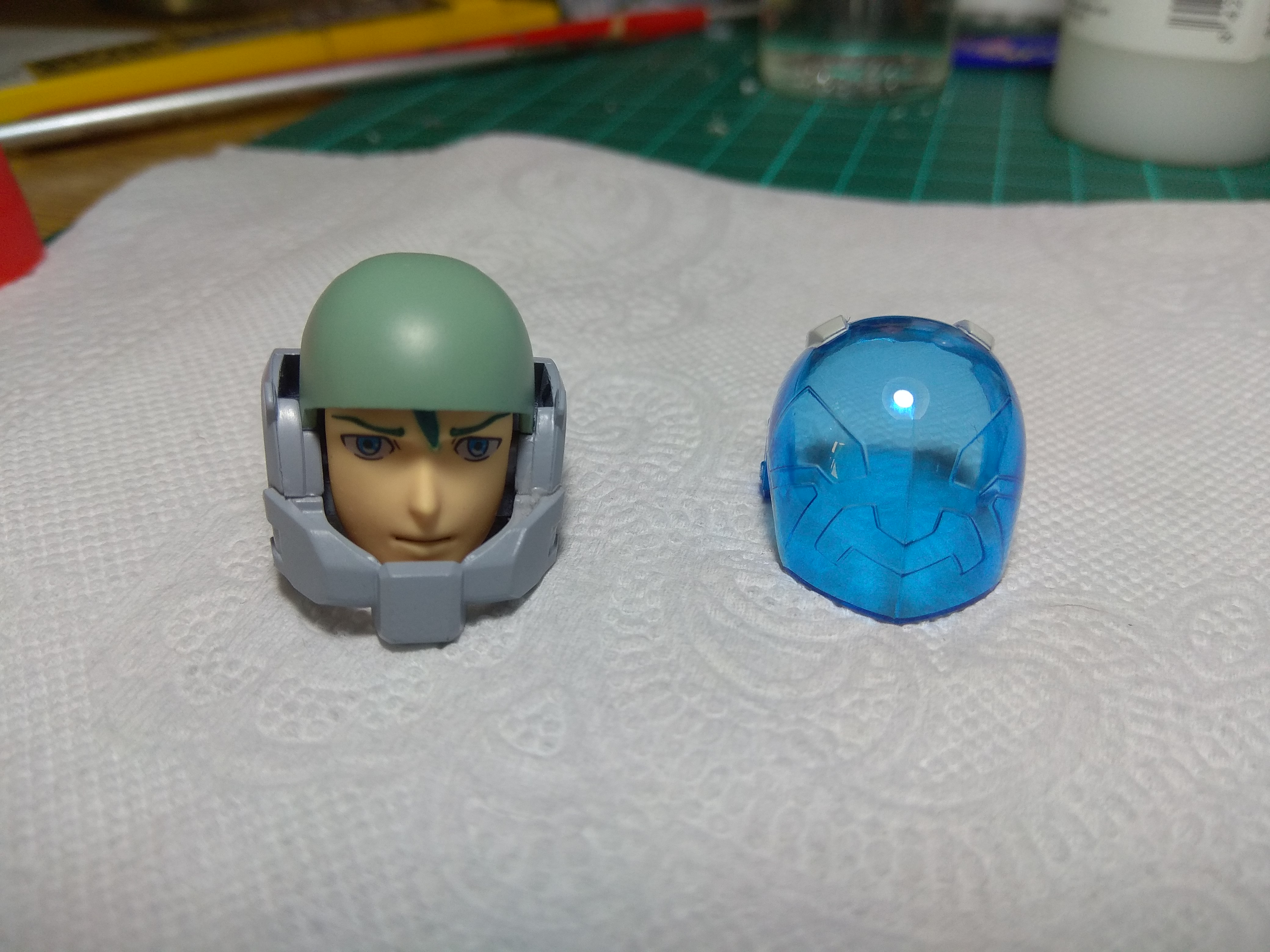

EmilianoAlfaro Posted July 20, 2018 Posted July 20, 2018 Second attempt with Stig helmet, what do you think, original or personalized? Quote
tekering Posted July 20, 2018 Posted July 20, 2018 2 minutes ago, EmilianoAlfaro said: original or personalized? I think "customized" is the word you're looking for. Still looks a little too dark to me, but much better than your earlier attempt. Quote
EmilianoAlfaro Posted July 20, 2018 Posted July 20, 2018 Yes, transparency is very subtle. I decided to make it a little darker so that the face is not easily seen. One of the things that bothered me (apart from the lines in the visor) is that when you posed the figure without the helmet, a loose helmet with a face inside was really ugly. Quote

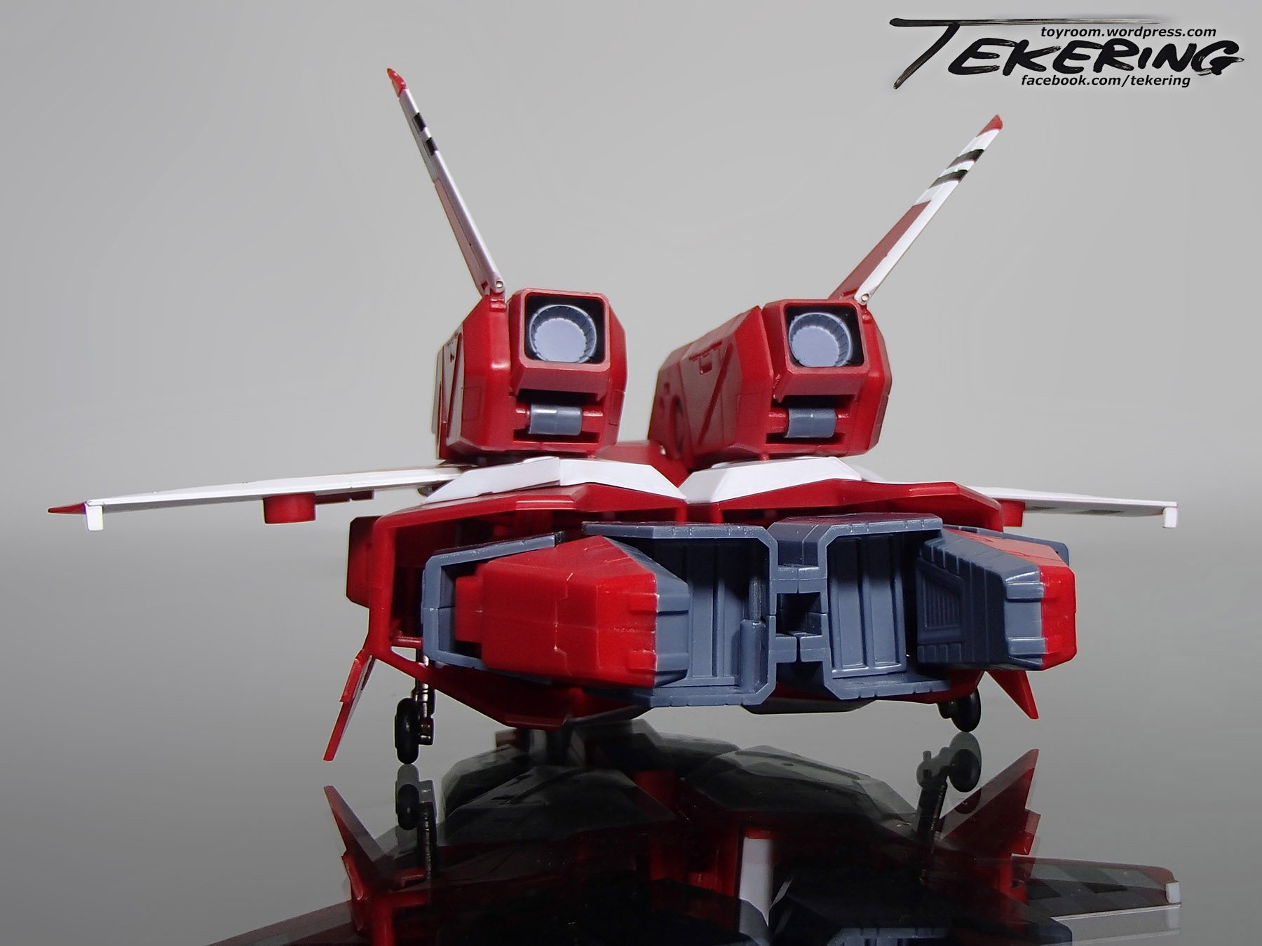

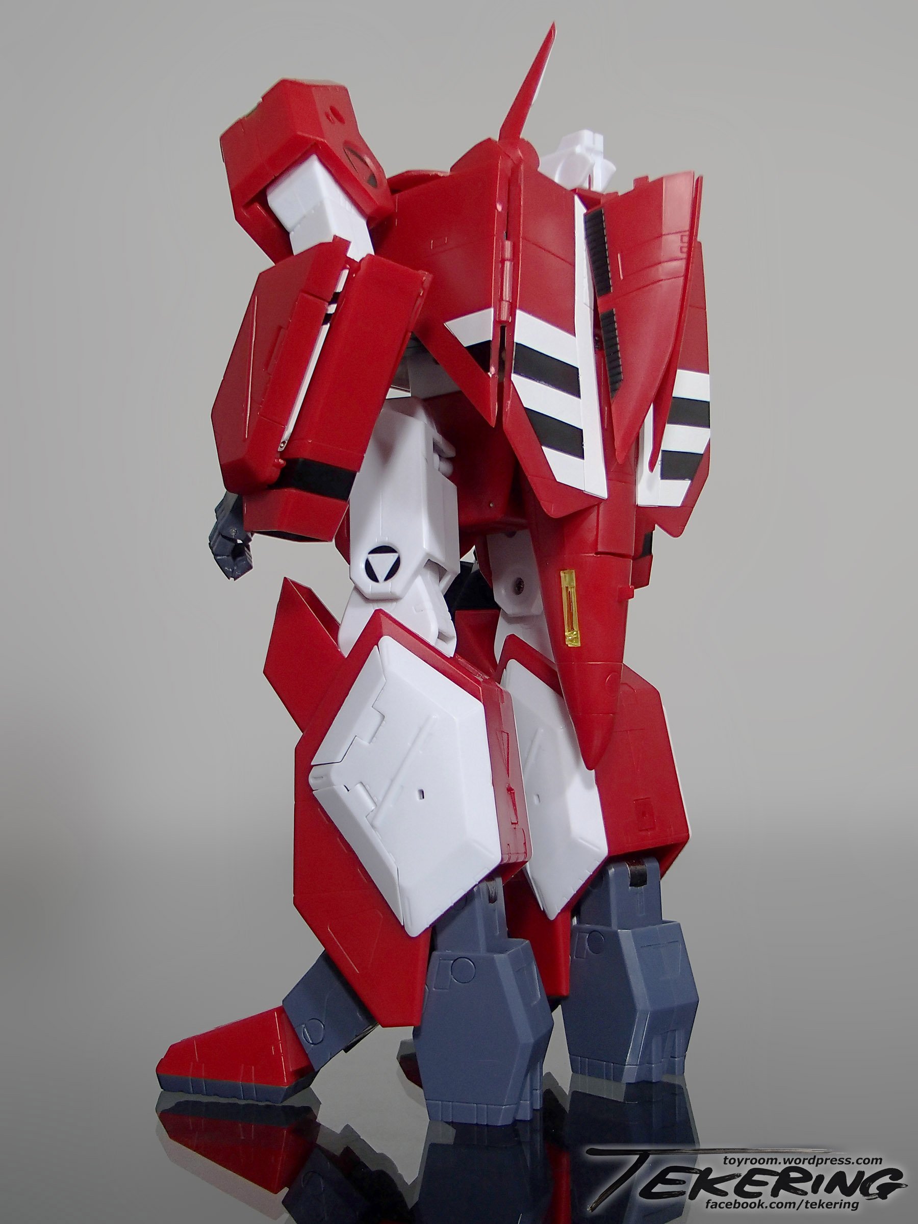

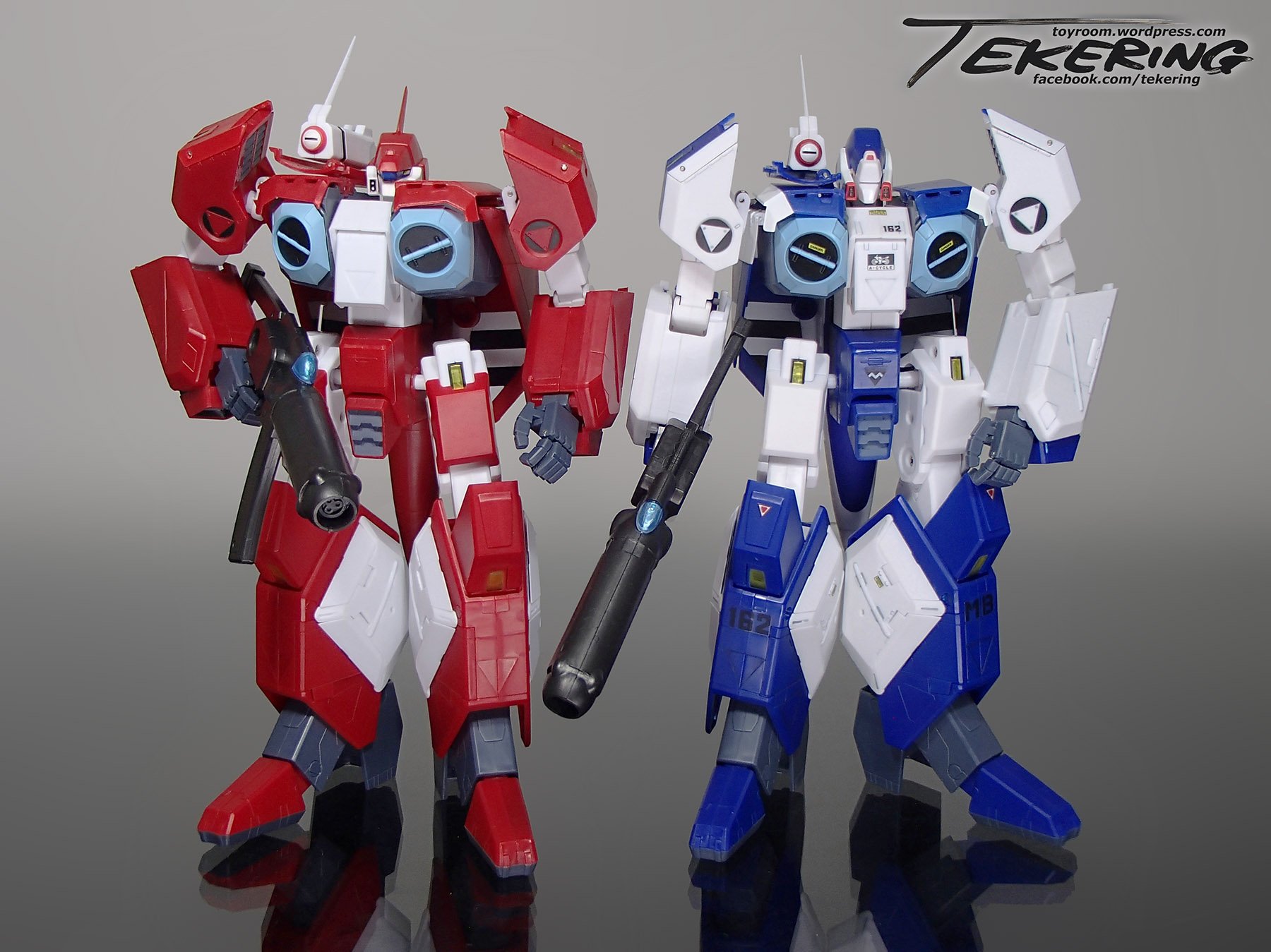

tekering Posted July 24, 2018 Posted July 24, 2018 ET Zeta in da house! First impressions, out of the box: It's the Evolution Toy Eta, only in red. The good news is, it's no worse than the Eta... The bad news is, it's no better. The Houquet pilot figure looks terrific. Like the Eta before it, it's hands-down the finest-looking Legioss toy ever produced... ...and, like the Eta before it, it's unjustifiably expensive for its relatively poor manufacturing quality. It shares all the advantages of the Eta, including the ideal proportions and superior articulation, as well as all the disadvantages we've come to expect from Evolution Toy... ...which is to say, it looks like a dream and handles like a nightmare. If you have the earlier ET Legioss release, you know what to expect; there are no unpleasant surprises here. Minor cosmetic changes aside, it's basically the same figure. Apart from the badly-needed (and much-appreciated) addition of a sliding mechanism for the shoulder-mounted sensor array, this Evolution Toy has not evolved. Quote

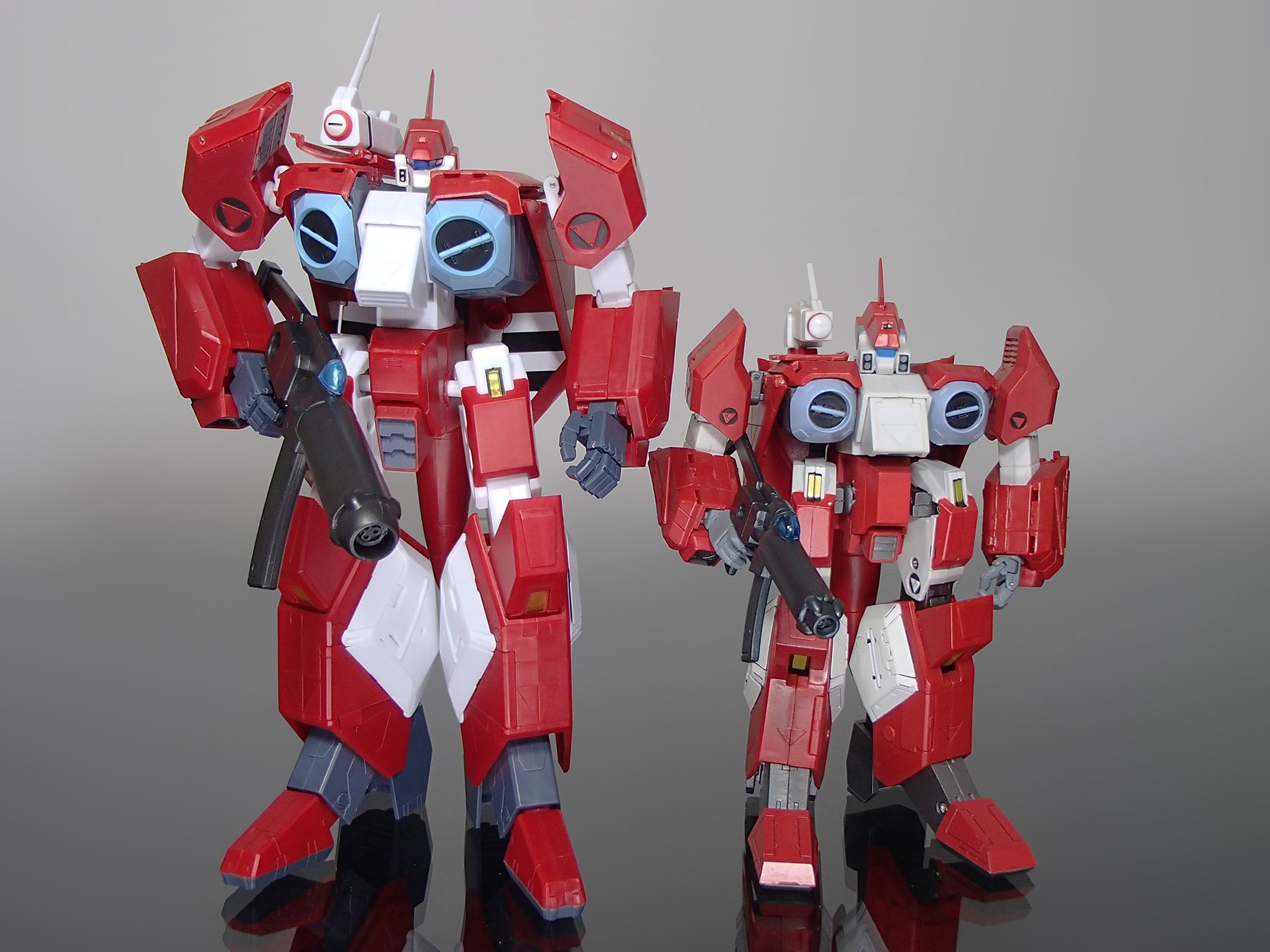

derex3592 Posted July 24, 2018 Posted July 24, 2018 I really want to want to want these, but I just can't get over the "cheap" look of the colored plastic, especially for the price. Say what you will about the Masterpiece Toynami's, yes they were crapptastic, but at least the plastic was a darker hue and better looking in my opinion. Quote
tekering Posted July 24, 2018 Posted July 24, 2018 4 minutes ago, derex3592 said: Say what you will about the Masterpiece Toynami's, yes they were crapptastic, but at least the plastic was a darker hue and better looking in my opinion. Dare to compare! They both nailed the anime color. The reds are almost identical! Quote
derex3592 Posted July 24, 2018 Posted July 24, 2018 Fair point on the red. Like I said, if the ET Toys one was like $150 or less, I'd be all over them. Quote
SuperSenpai Posted July 24, 2018 Posted July 24, 2018 3 hours ago, tekering said: Dare to compare! They both nailed the anime color. The reds are almost identical! I know a lot of people like the ET sculpt, but to me it always looked a bit stretched and elongated looking. In my mind, it needs to look a bit wider and bulkier. Having it next to the Toynami Alpha really makes this apparent. Quote
