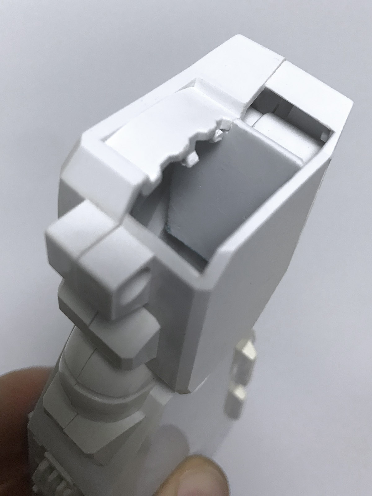

Everything's glued, puttied, sanded smooth, painted with primer, puttied, sanded smooth, painted with primer, surfacer, base coat and clear coat, and finally ready for final assembly...
...and then when you try and fit the parts back together, there's that horrifying sound of the plastic splitting and cracking, AGAIN. 🤕

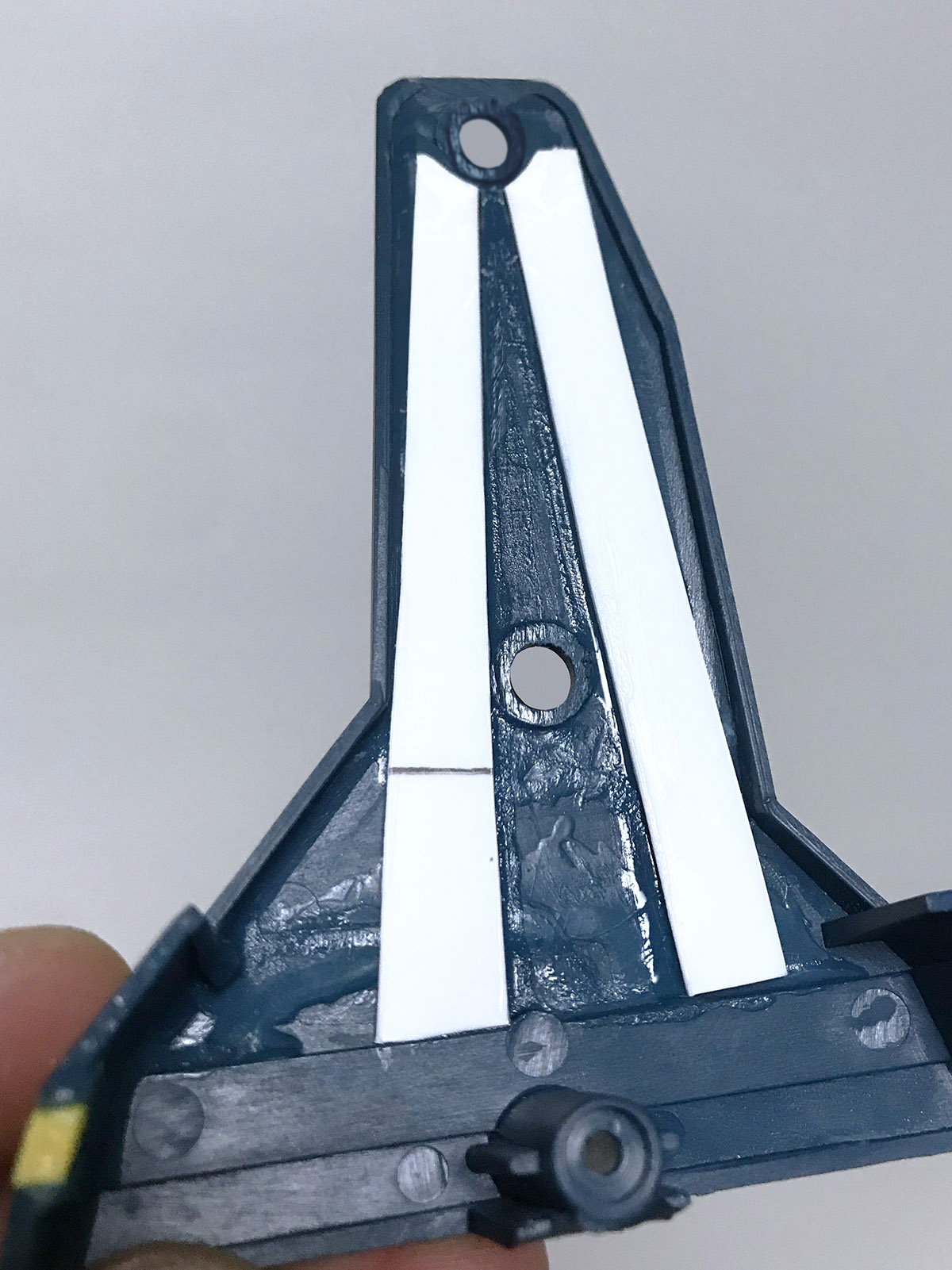

I ended up using a lot of scrap styrene for internal reinforcement, wherever I could make space to do so.
I could only imagine you disappointed and frustration after putting the finishing paints and it would crack.
My thoughts go out to you.
Would you post pics of you re-enforcement of the parts? Are you just adding glue or adding a styrene or metal structure for support?

These styrene beams will reinforce the thin plastic areas and provide greater structural integrity.

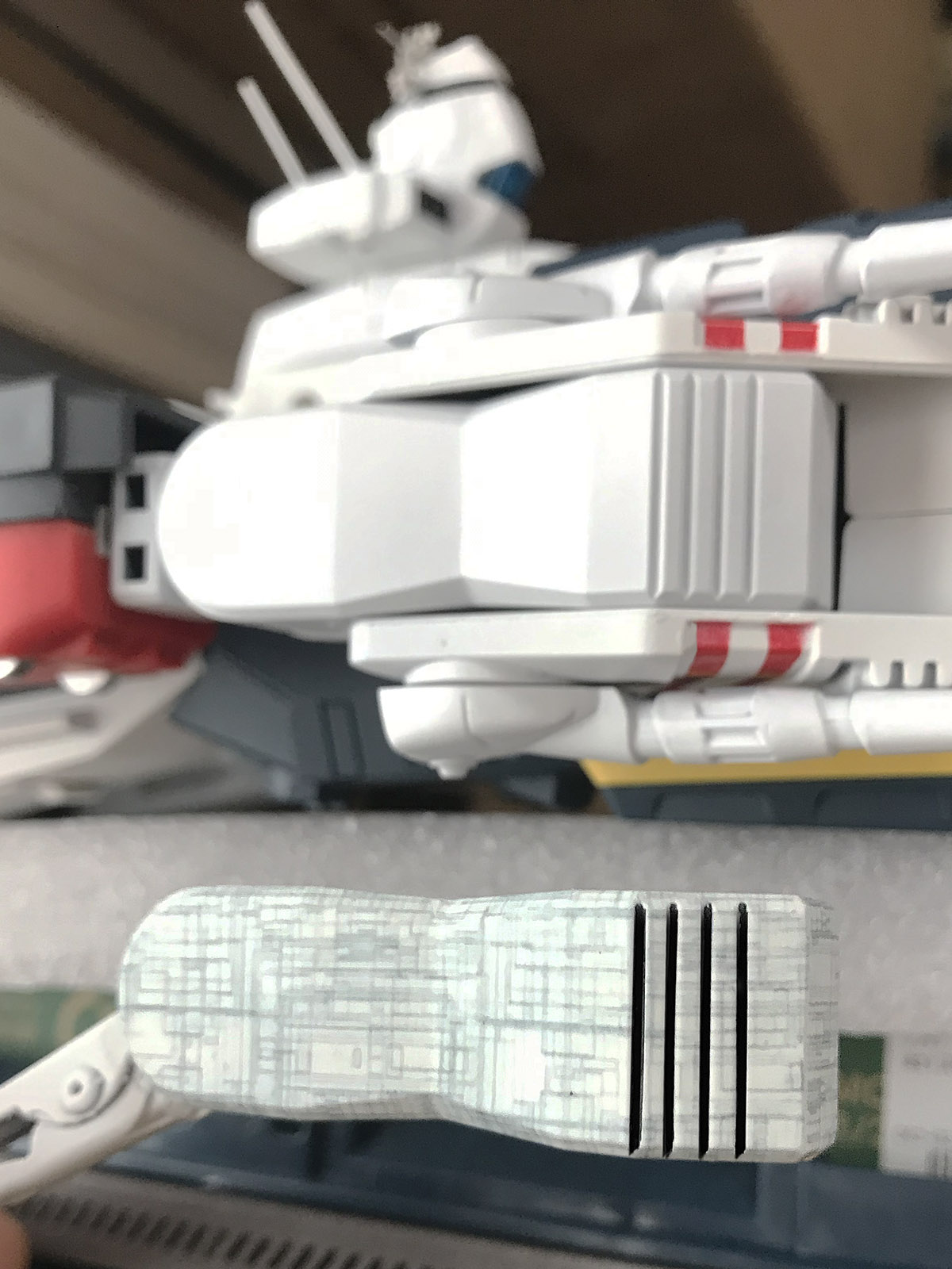

I'm preparing for phase two, hyper-detailing the surface for a proper sense of scale. I'm pushing my printer to the limits of its resolution, trying to get panel lines as thin as possible:
I might've overdone it a little. 😅
Hope that reinforcing holds. You've put a lot of hard work into this already. And real nice on the paneling. Should look great when it's on.

Actually, I'm not so sure...
The sealant coating turned the ink kind of greenish, and softened up the lines more than I had anticipated.
Plus, the pattern looks more like a circuit board than the hull of a battle fortress. 🤨

Perhaps a light, translucent coat of white over the top, not to cover it but to fade it?

It might just be the initial shock of the unexpected result on a single piece. I think it will look similar to anime close ups when the entire SDF-1 completely covered in this pattern.
Blending and weathering could diffuse this.

Basically, I agree with Thom and nighrmareB4macross:

As they said: if you mist a light coat of white over that and then pick out various panels and do them in differing shades of white/ grey, it would remove the circuit board effect. I had a similar result on mine when I did the tiny panels in paint and had to do that.
Don't get discouraged, tekkering: it's just a small speed-bump on the road to the Macross you always wanted. Been there, done that, ate the t-shirt. :D

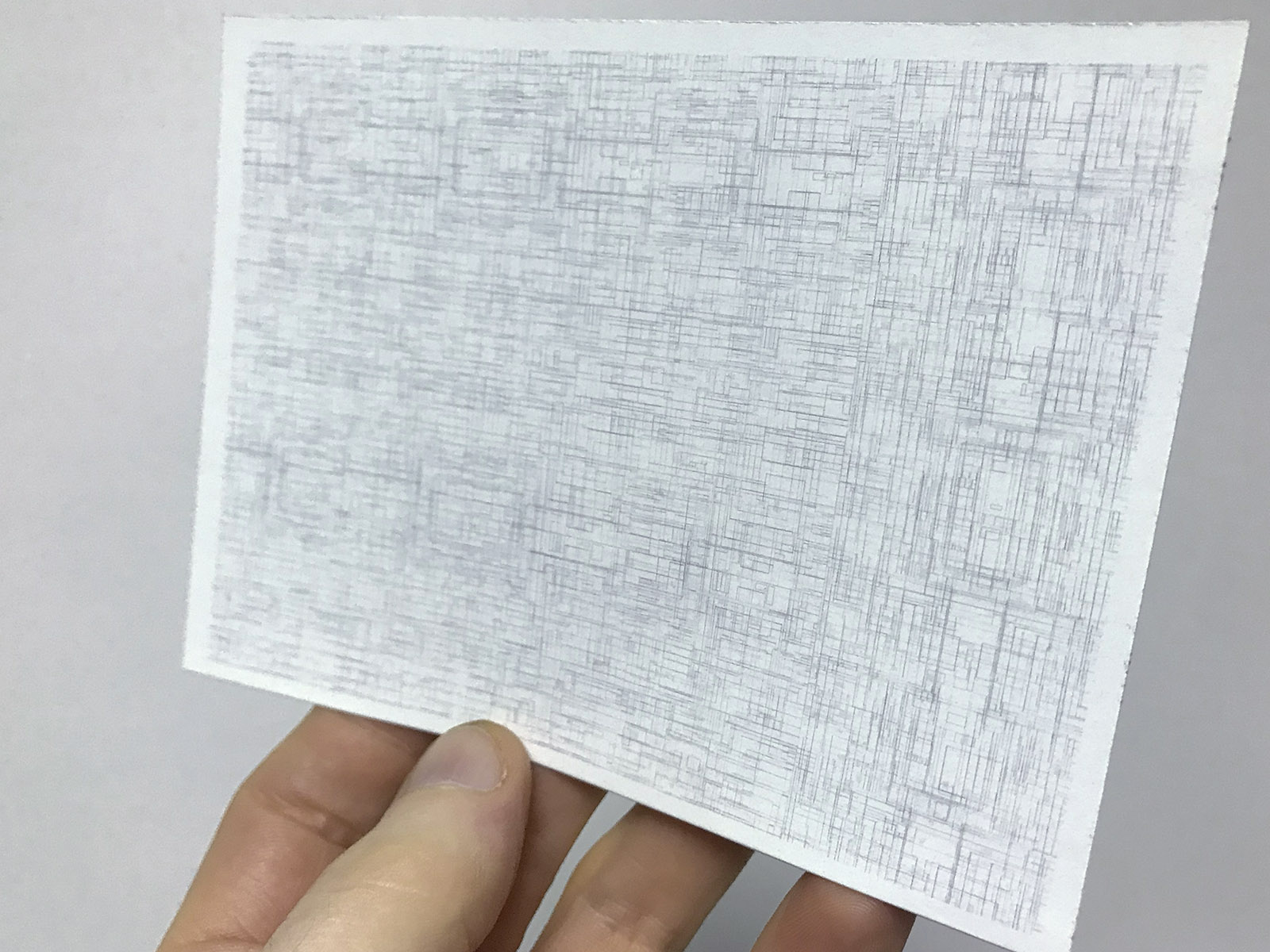

My second attempt is closer to the anime look I'm after:
I added a purple tint to the image, which counteracts the effect of the clearcoat and ends up a neutral grey. :good:
It's still not exactly what I want, but it's a definite improvement.
Ahhh...VERY nice on the 2nd attempt!  I like it! Are you printing it on decal paper on a laser jet or inkjet and then custom cutting them out to fit? Because if you are....bravo!

How did you figure the purple hue would counteract the bluriness and deliver a better finish when clear coat?

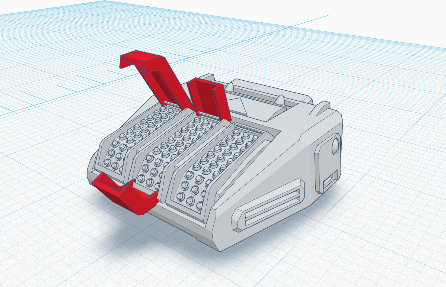

hi guys i made an updated version of my cannons, also i have uploaded new rail cannons too
https://www.thingiverse.com/thing:5961035 the new cannon
https://www.thingiverse.com/thing:5961048 the Rail cannon
https://www.thingiverse.com/thing:5961088 missile turrets
@tekering this is looking good, keep up the good work
Edited by Nyankodevice

It's not that clear to me what that elevating gun looks like, or where it goes exactly.
The rolling vehicle to carry the Daedalus is more clear, but you would have to design it for a specific model or toy, I guess.
31 minutes ago, arbit said:
Very nice!
The gun seems to be the entire back of the leg, like on the 1/3000 toy.

dont think it made it into any animated media, also imo its a badly placed weapon, theres already a turret and a missile turret placed on top of it..
but i could easily make a version for my ship, since its so big..
