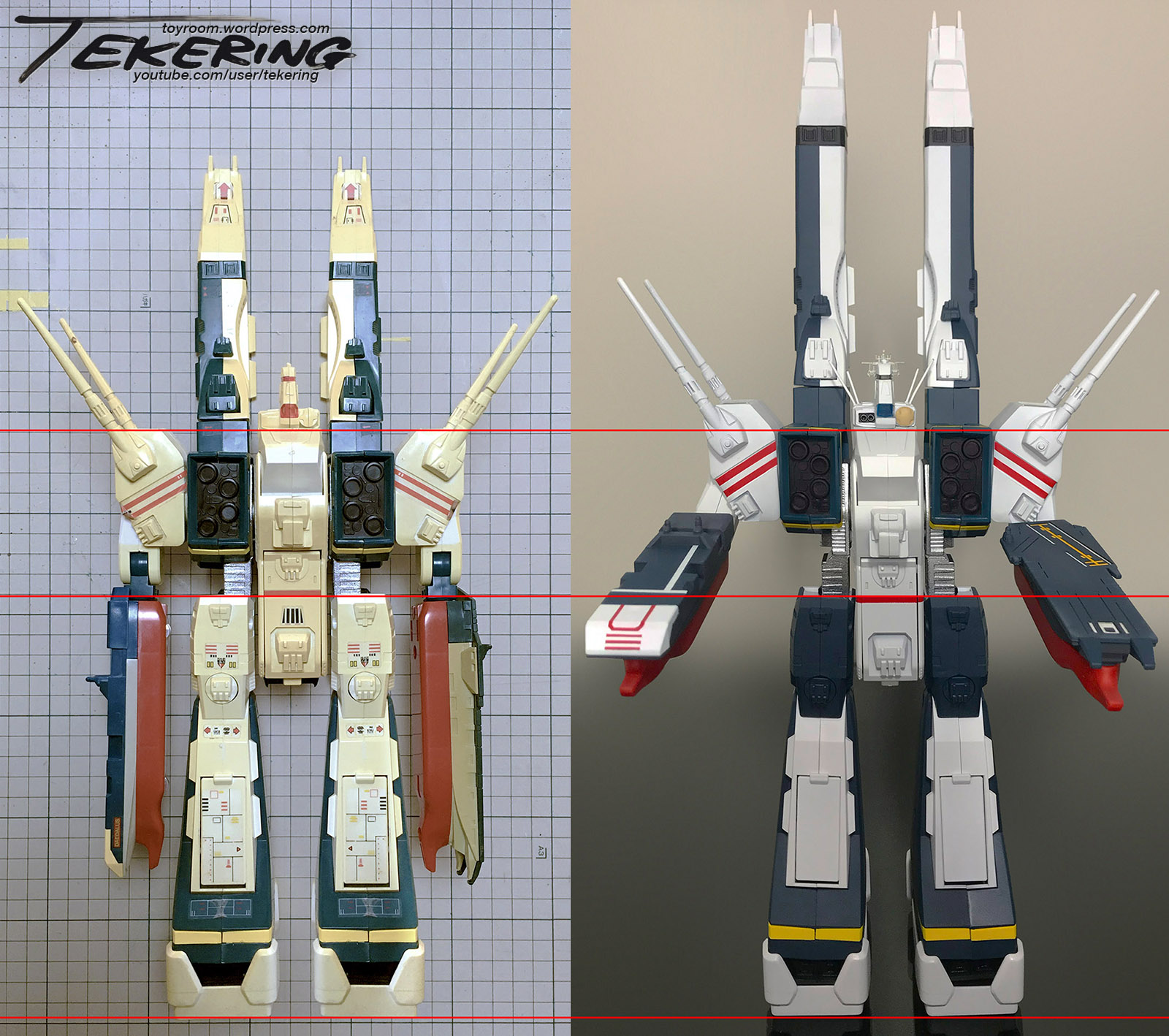

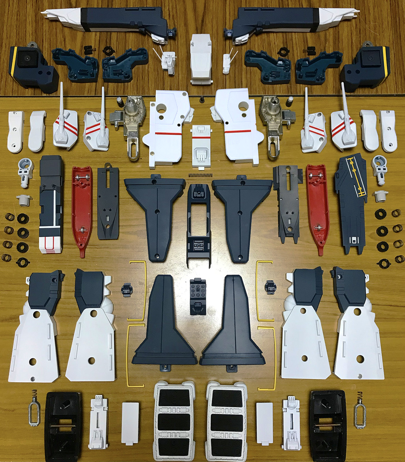

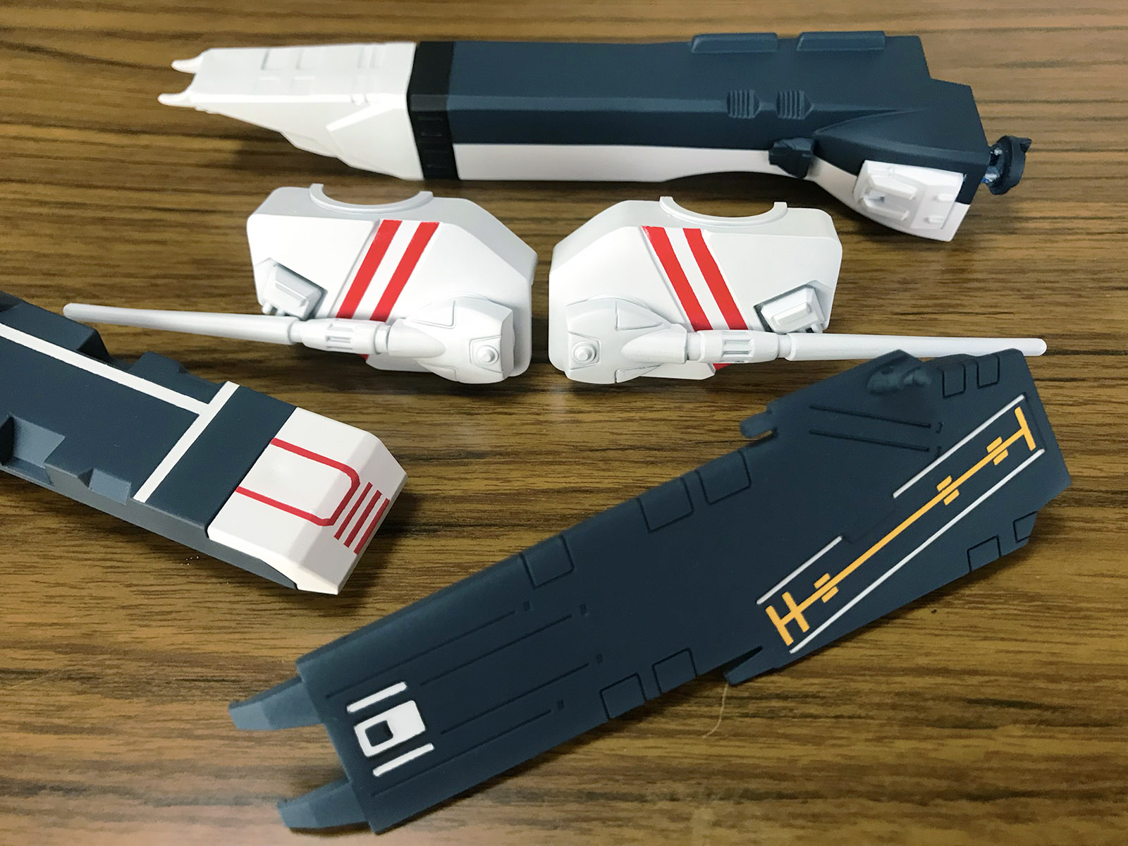

It's taken much, much longer than expected, but everything's more-or-less ready for final assembly.
Typically, I apply markings using custom decal sheets designed in Photoshop, but as I'm under the gun, past my self-imposed deadline, and ashamed it's taken this long already, I simply accomplished what I needed with 1mm masking tape.
I'm fairly pleased with the results, actually. 😊

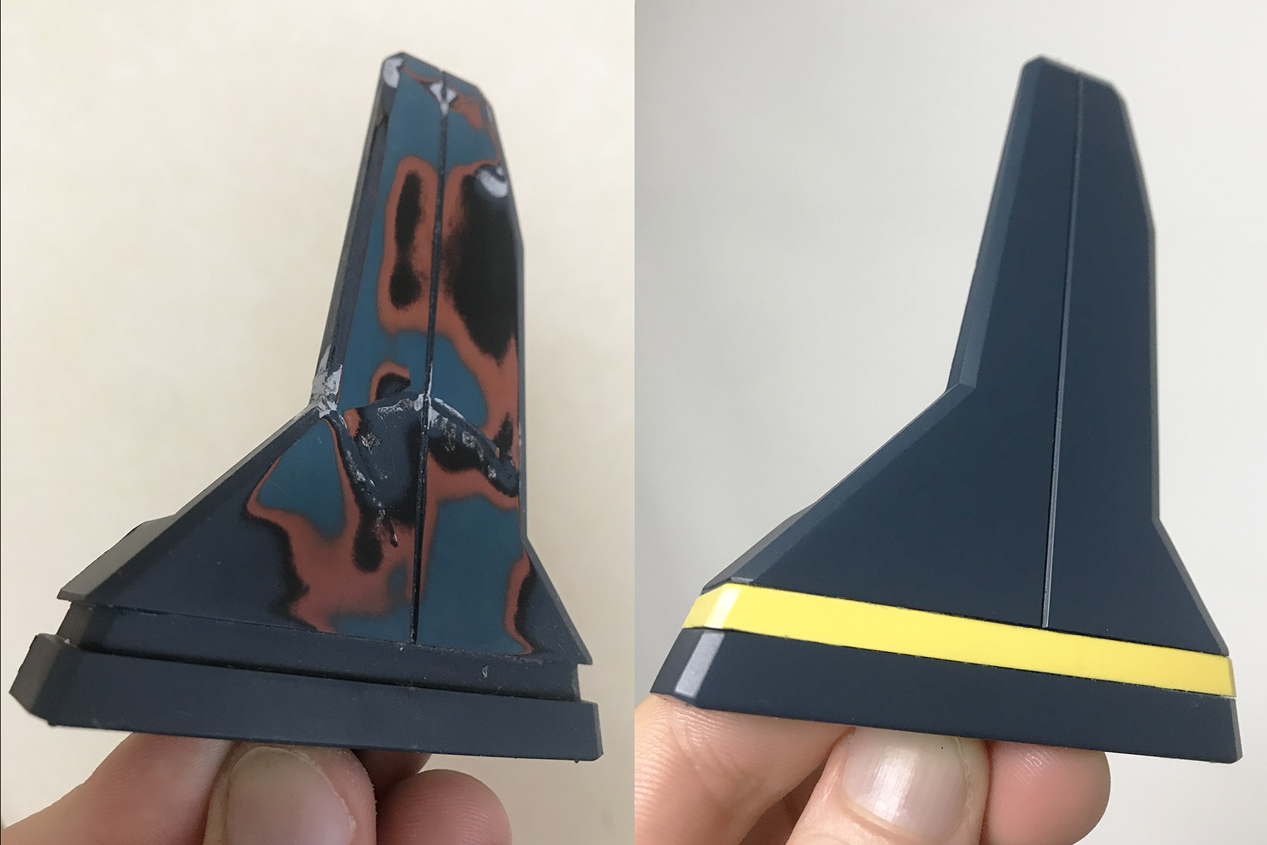

I particularly appreciate this acknowledgment, Gabe.  Trying to restore cracked and broken pieces to pristine condition was tedious, repetitive work in-and-of-itself...
...and as each visible layer of primer, surfacer, putty and plastic demonstrates, perseverance was key.
Even more time and effort went into making my main gun extensions look as seamless as if they'd been designed and manufactured that way to begin with:
Many of you made the same modifications in much less time than it took me, but left telltale signs that I fastidiously eliminated.

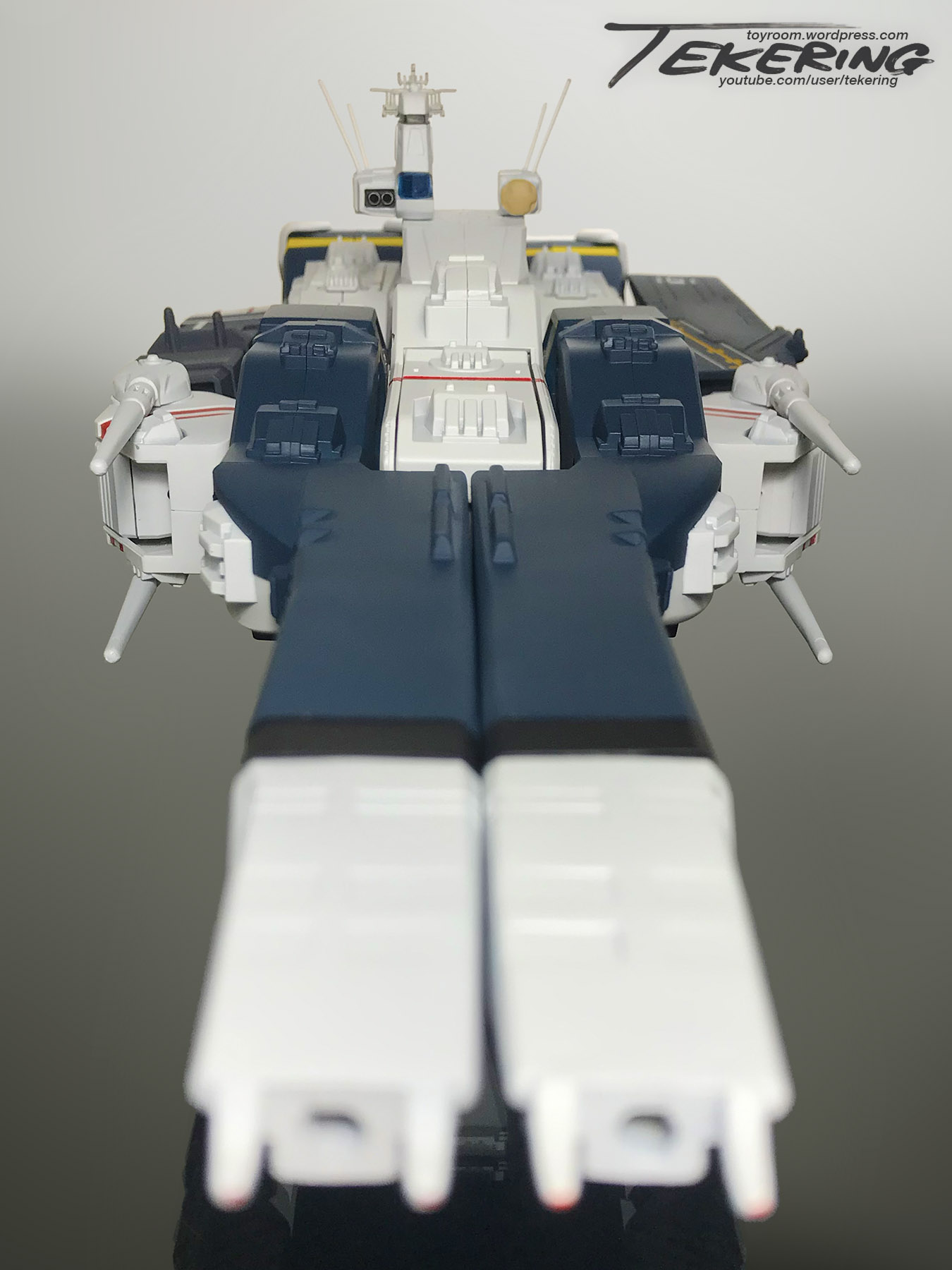

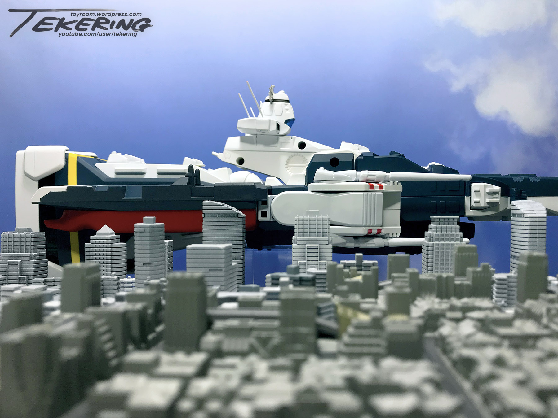

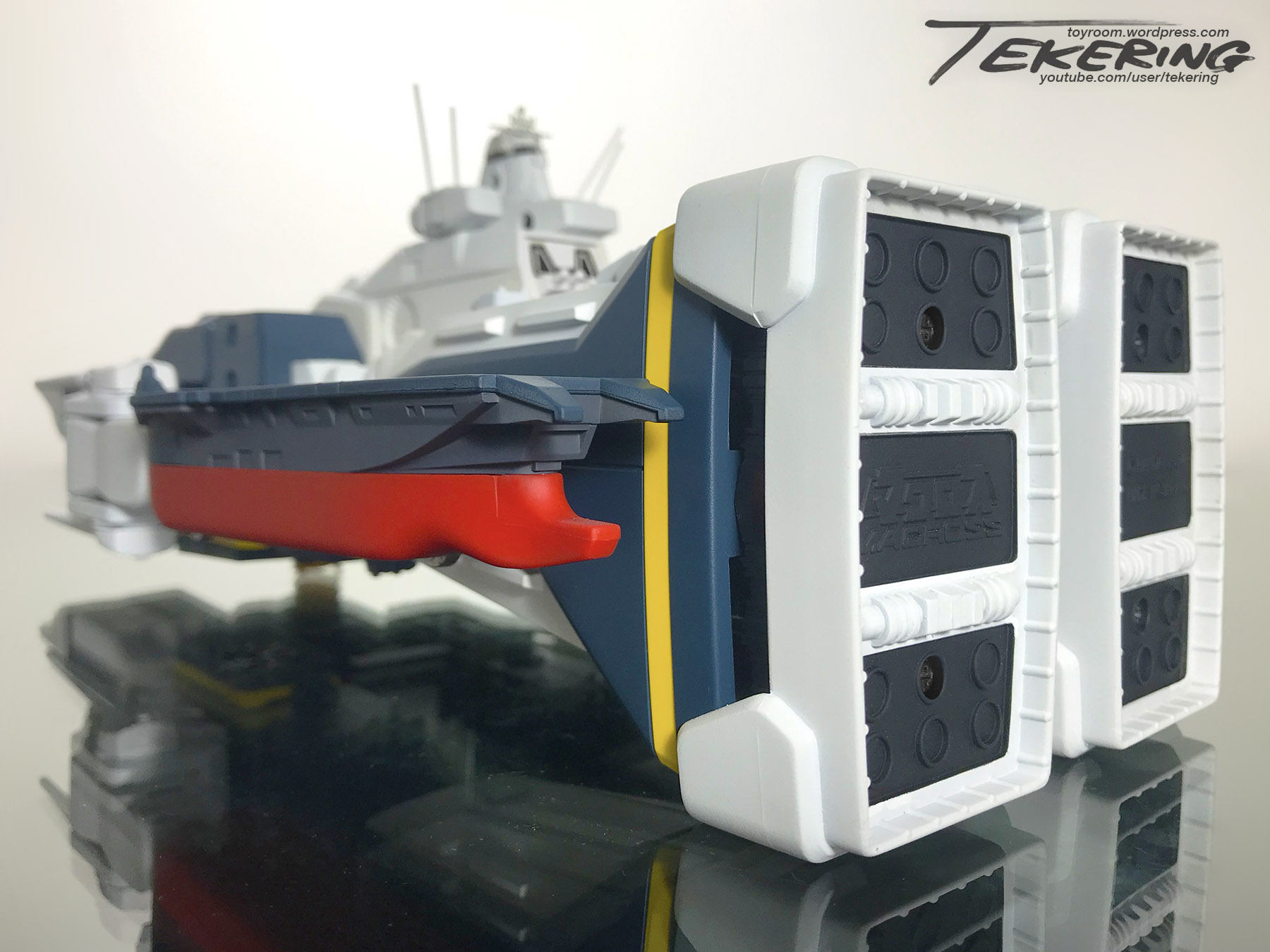

Here's cruiser mode:

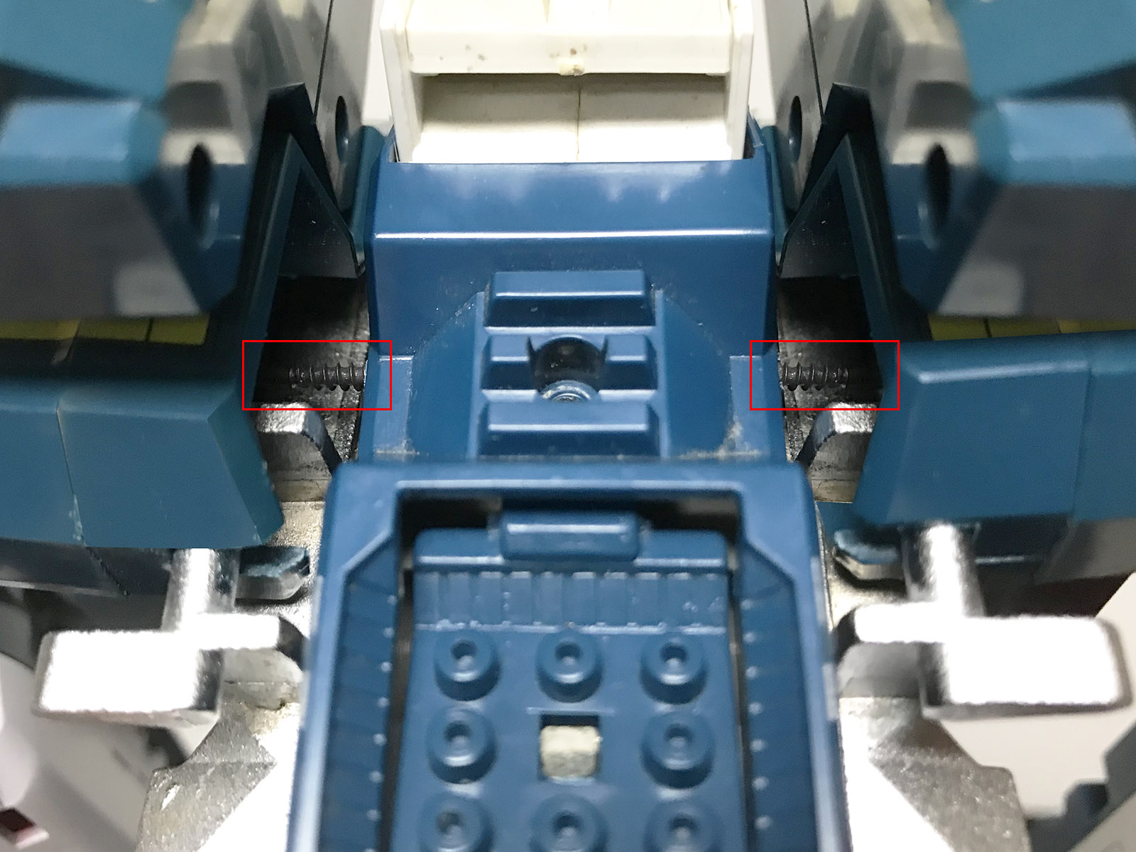

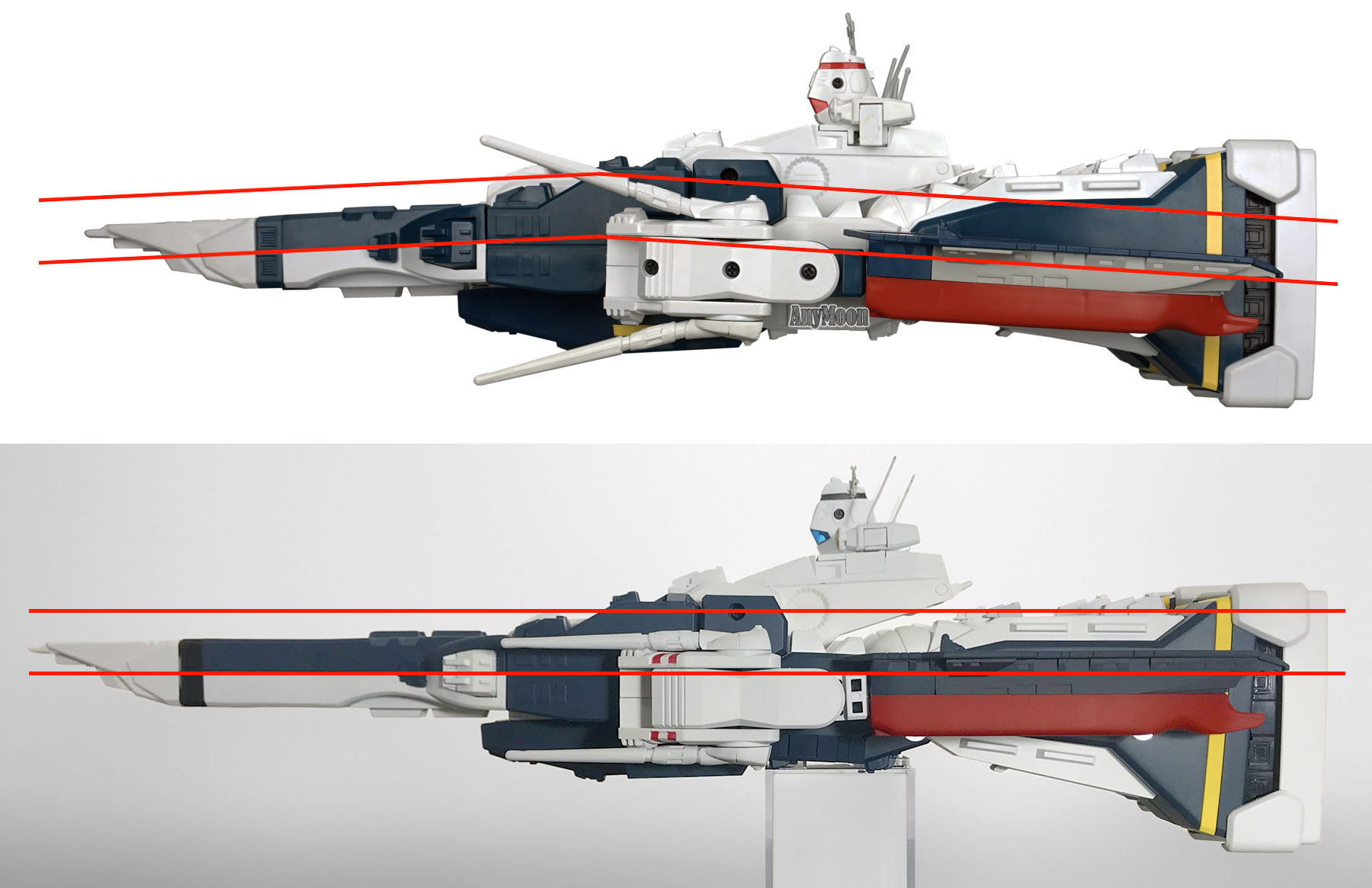

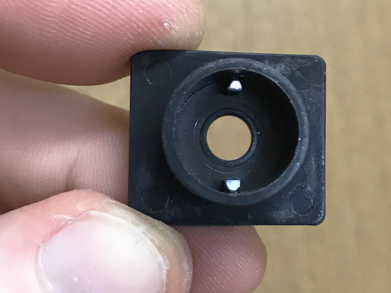

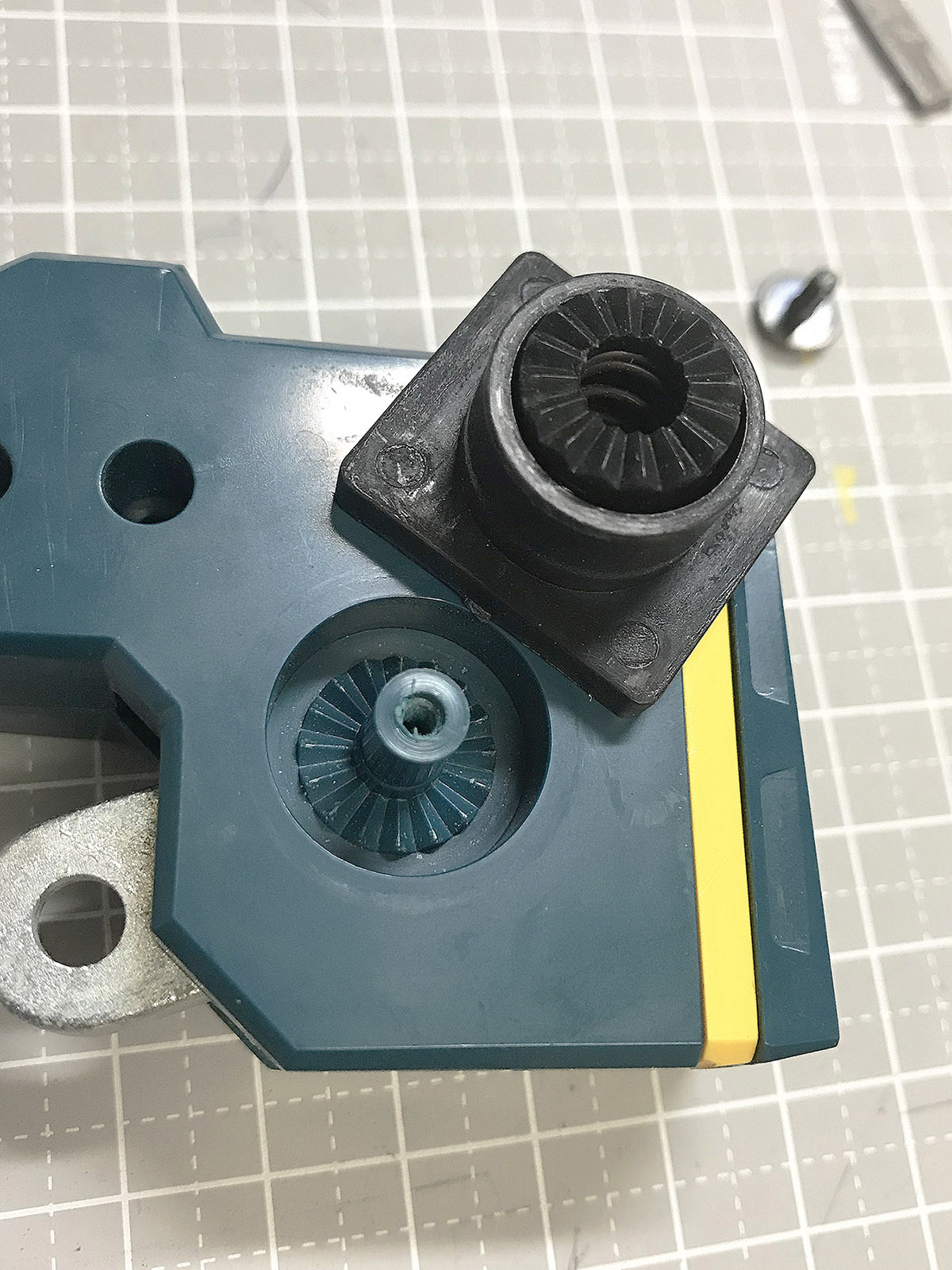

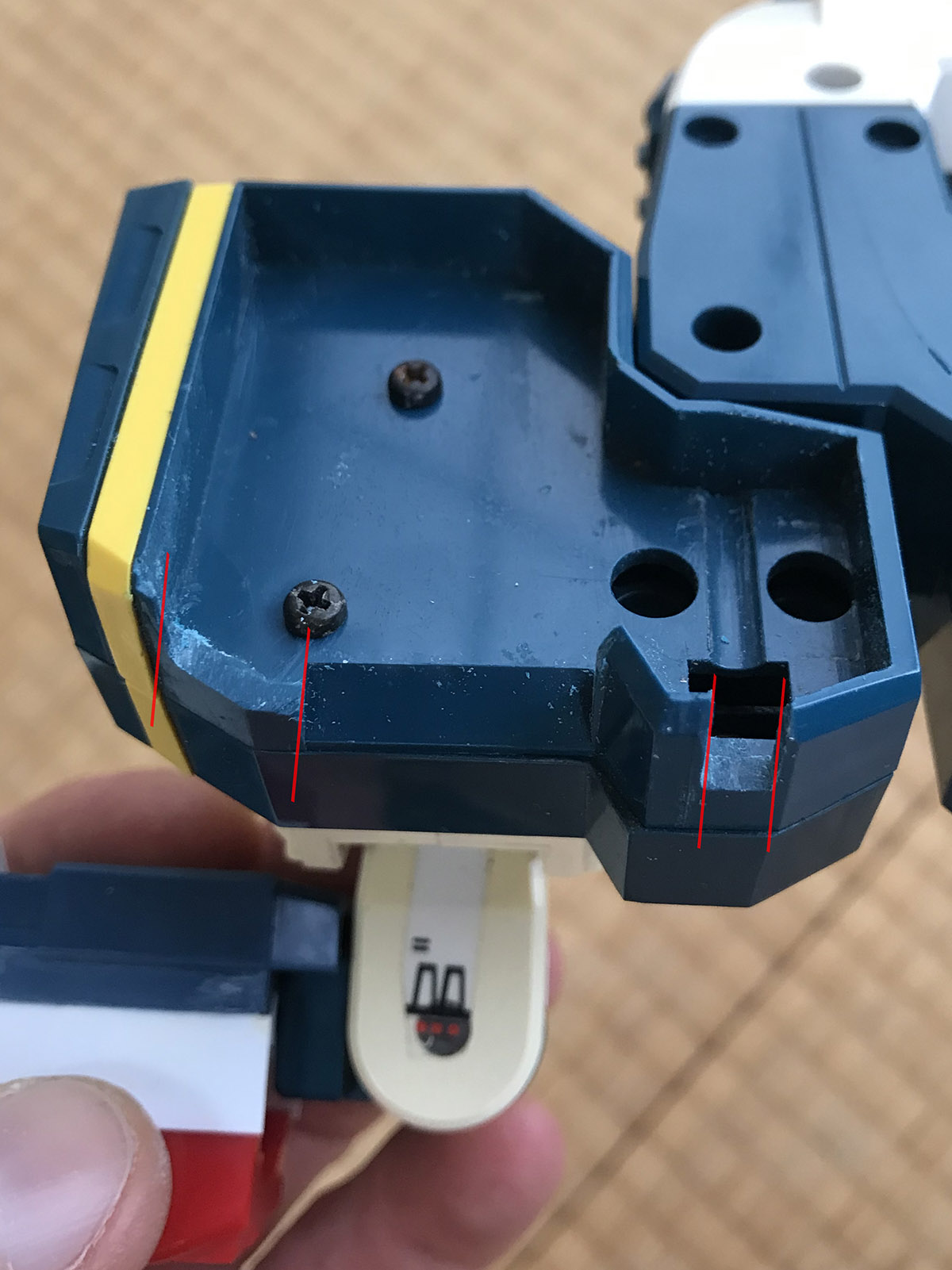

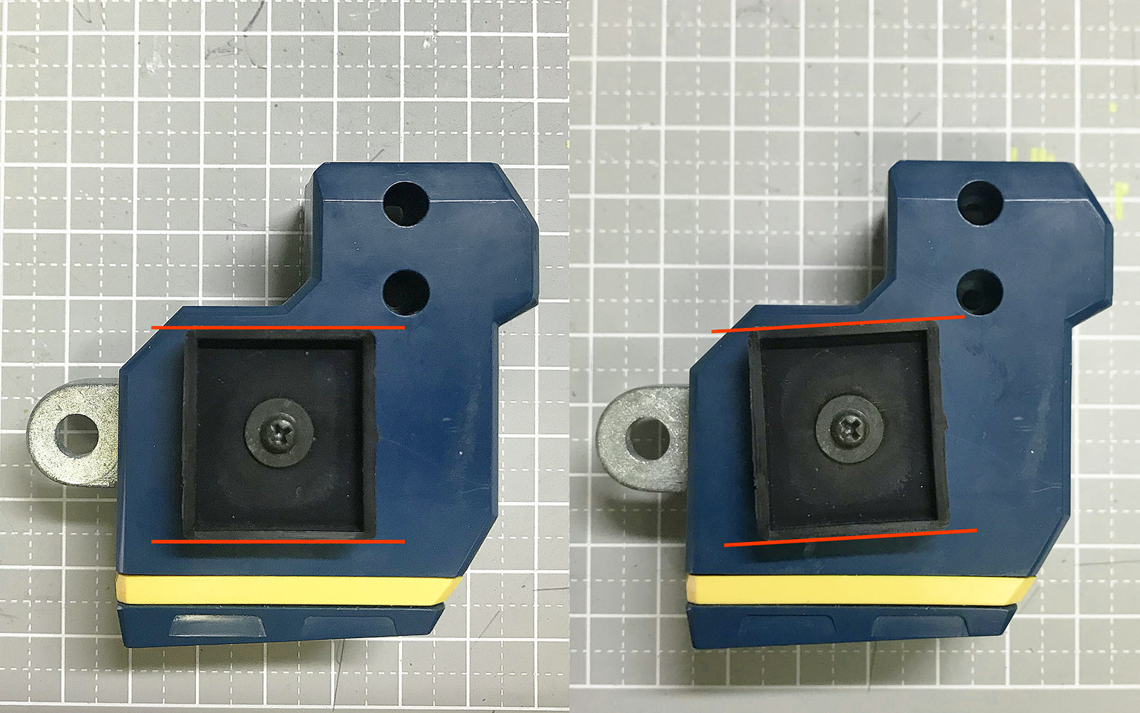

I've mentioned my use of magnets to keep the cannon boom arms straight, but I came up with a simple mod to the ratchet joints to account for the weight of the "arms" and keep the support carriers properly aligned as well.

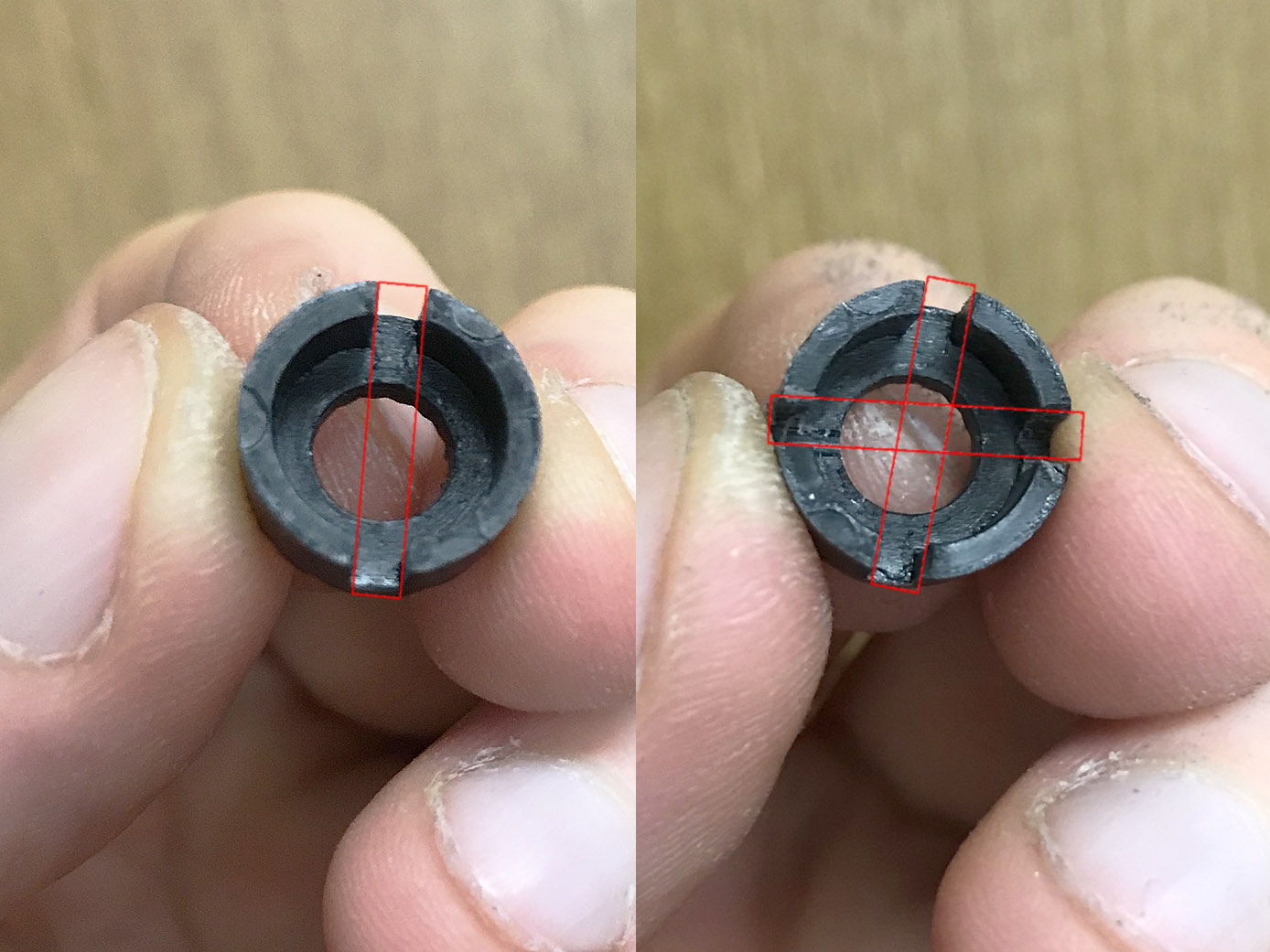

The ratchets were originally designed to position the joints at perfect ninety-degree angles, which would seem ideal for a battlefortress in space; however, in an Earth gravity environment, we all know how weight causes sagging in cruiser mode.  If I may borrow a photo from @jenius to illustrate:
Even a pristene-condition Matchbox specimen sags significantly in the bow, a little in the "shoulders," and quite profoundly past the "elbows," all of which I've managed to correct.
The joint housings align the ratchets with these tabs (painted white for the sake of this photo).
I realized I could cut my own notches into the ratchets, and thereby adjust the angle of the joint to account for the effects of gravity:
You can see how the ratchets now hold the shoulder joint at a canted angle, to correct for the sag caused by the weight of the arms.
Another niggling flaw that's bugged me for decades is finally fixed. :yahoo:

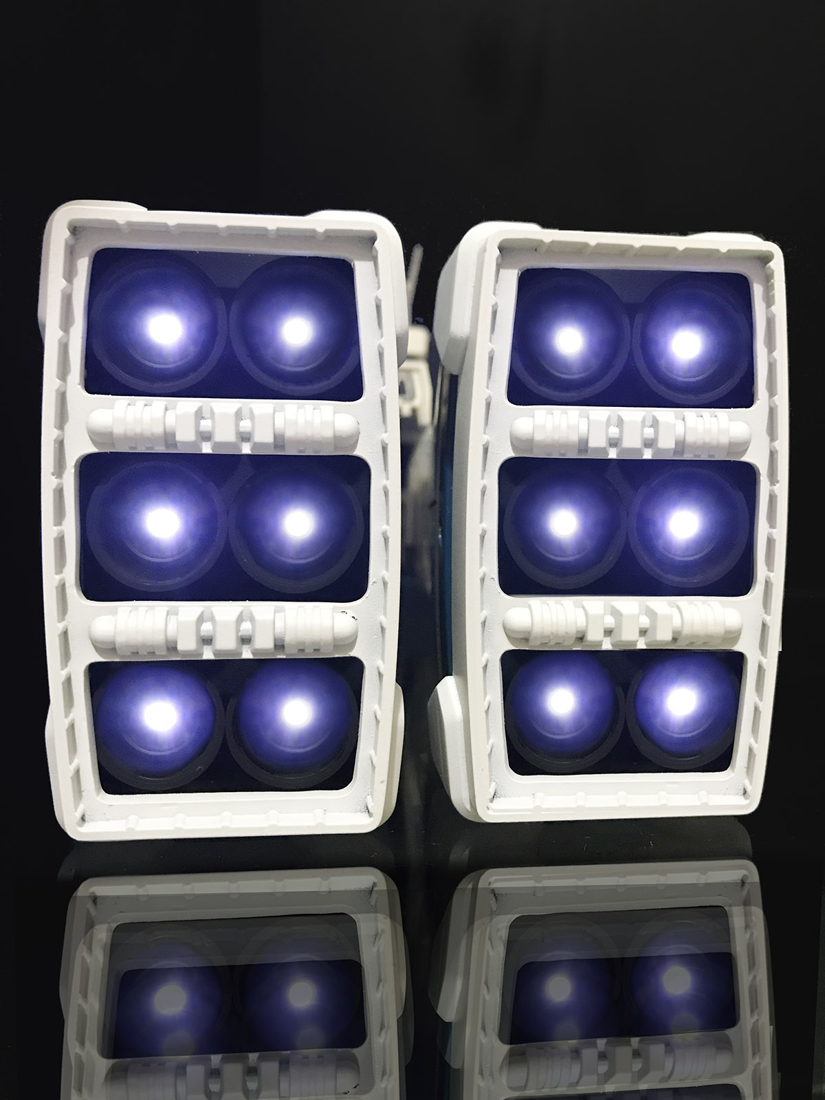

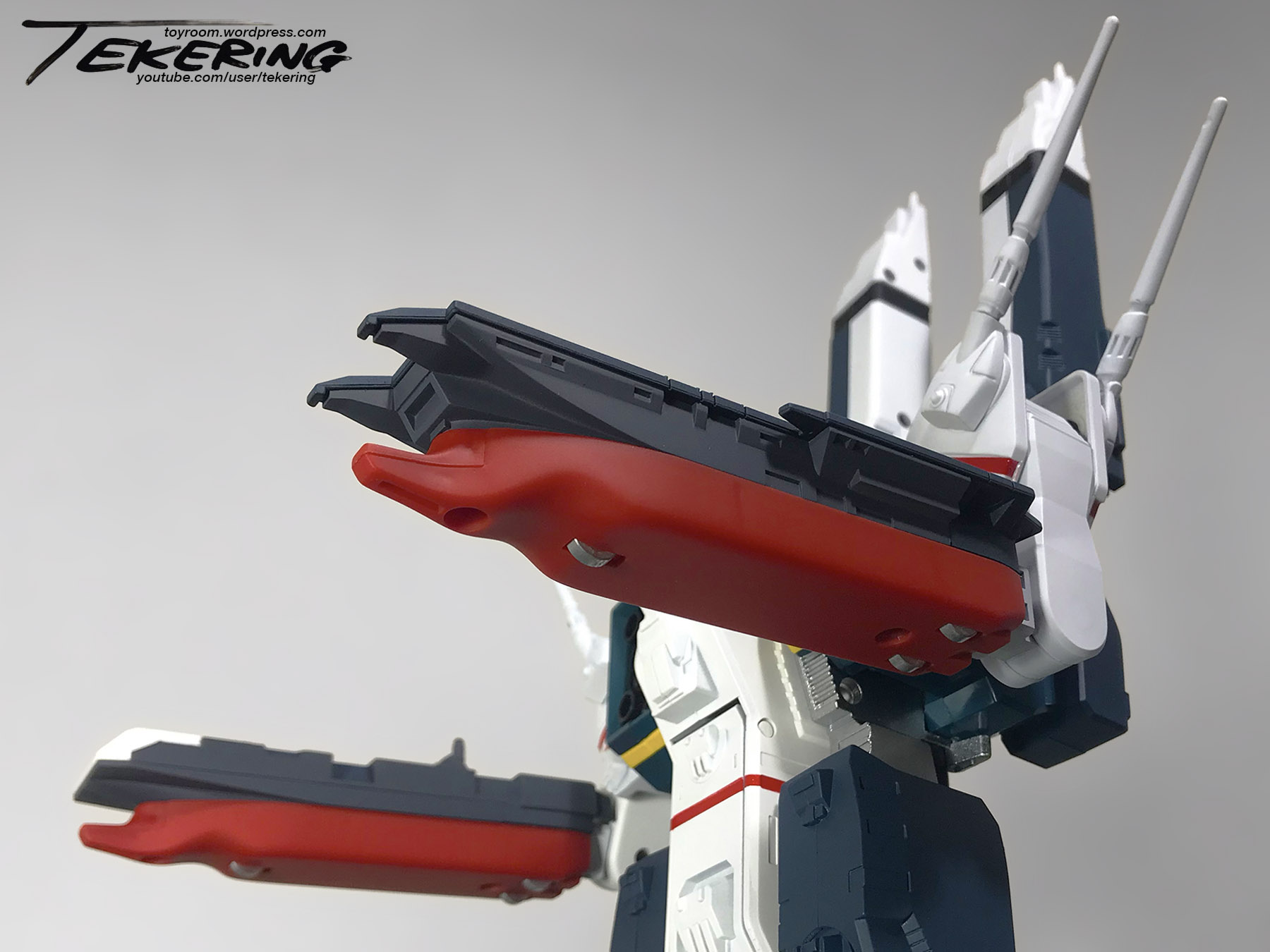

Oh sure, the restoration process is just the first stage for me.  The pristine toy look is fine, but I want to add a great deal more surface detailing, replace all the surface battery guns, conceal all the screw holes, and treat the whole thing more like a model kit.
I'm even considering a Macross Island diorama. 😇

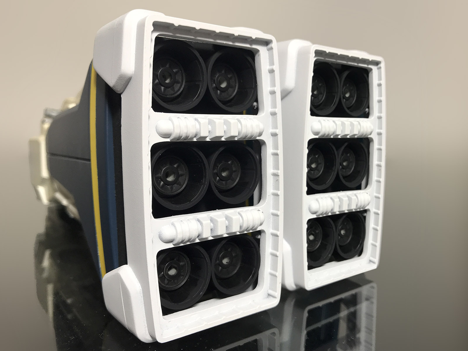

I've already painted up a set of recessed engines:
LEDs are installed, but I haven't figured out how to integrate a switch.

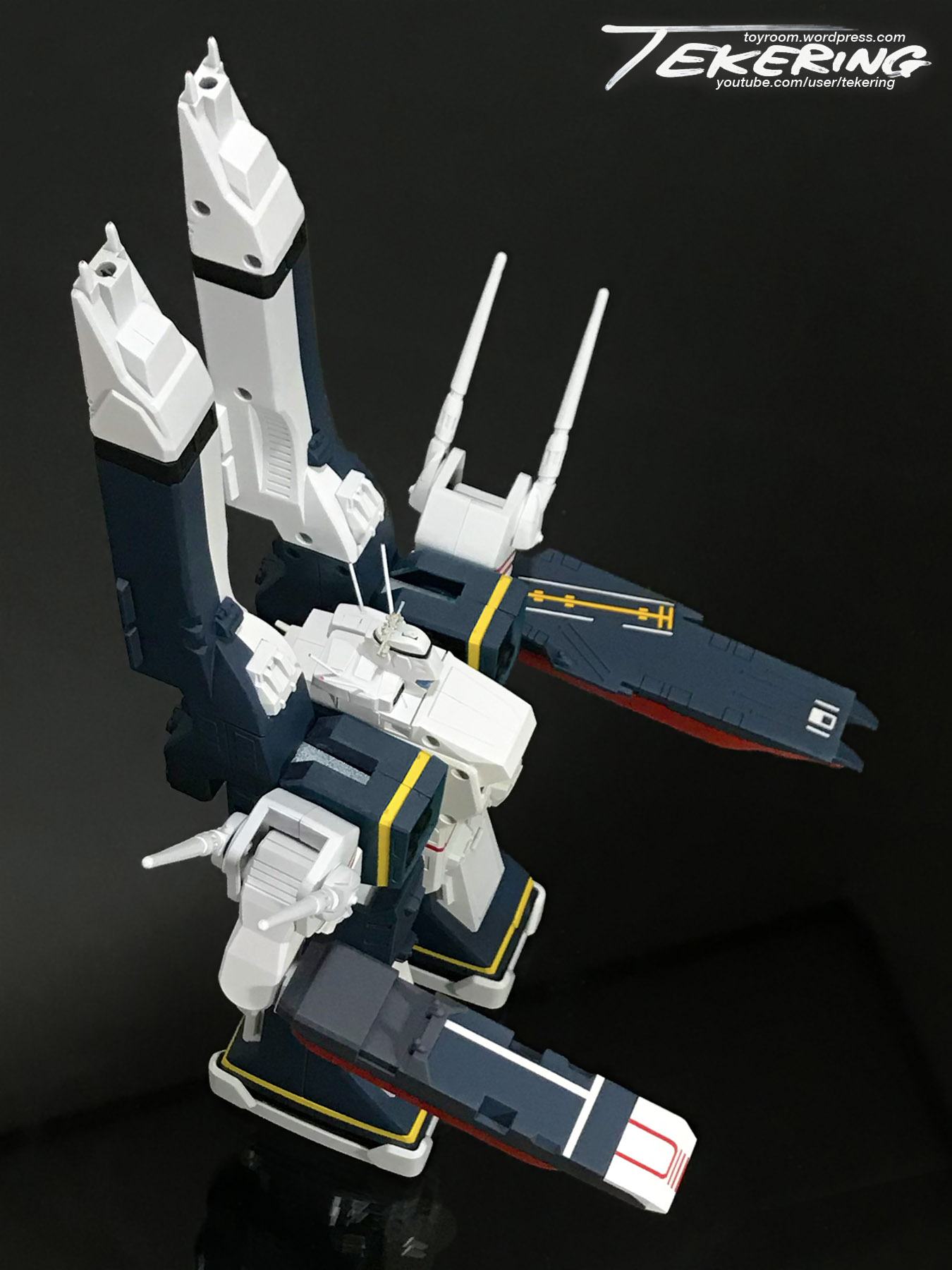

I did, however, figure out a solution to a much bigger problem:
The conning tower now sits parallel to the shoulders in "Storm Attacker" mode. 😎
I'm MUCH more satisfied with the proportions now. 😁

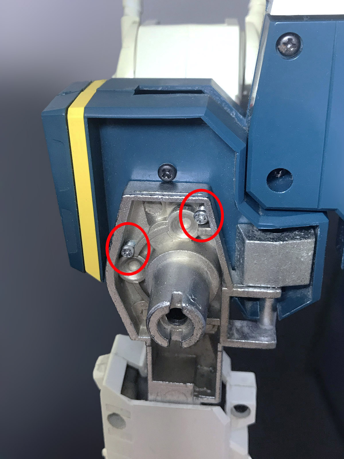

Nothing quite so elegant, I fear; as I say, I'm not much of an engineer, so transformation now requires a screwdriver. 😬
Most of you already know that each cannon boom is attached to one side of the chest, and that each "arm" is connected to the same subassembly.  This entire segment is connected to the diecast metal frame with only two screws, making it very easy to disassemble.
By removing some plastic from the bottom of each side of the chest, I made space for the diecast frame to fit much lower, allowing the subassembly to sit 16mm higher -- exactly the height required to align the top of the chest with the conning tower. 😇
This results in a taller, thinner profile that renders the overall proportions much more anime-accurate. :good:
However, the subassembly can't be screwed into the metal frame in this position, so instead I threaded 30mm wood screws (through the existing screw holes) and drilled mounting holes into the back to secure them to the main hull.
These screws will have to be removed for transformation back to cruiser mode, of course. :unknw:

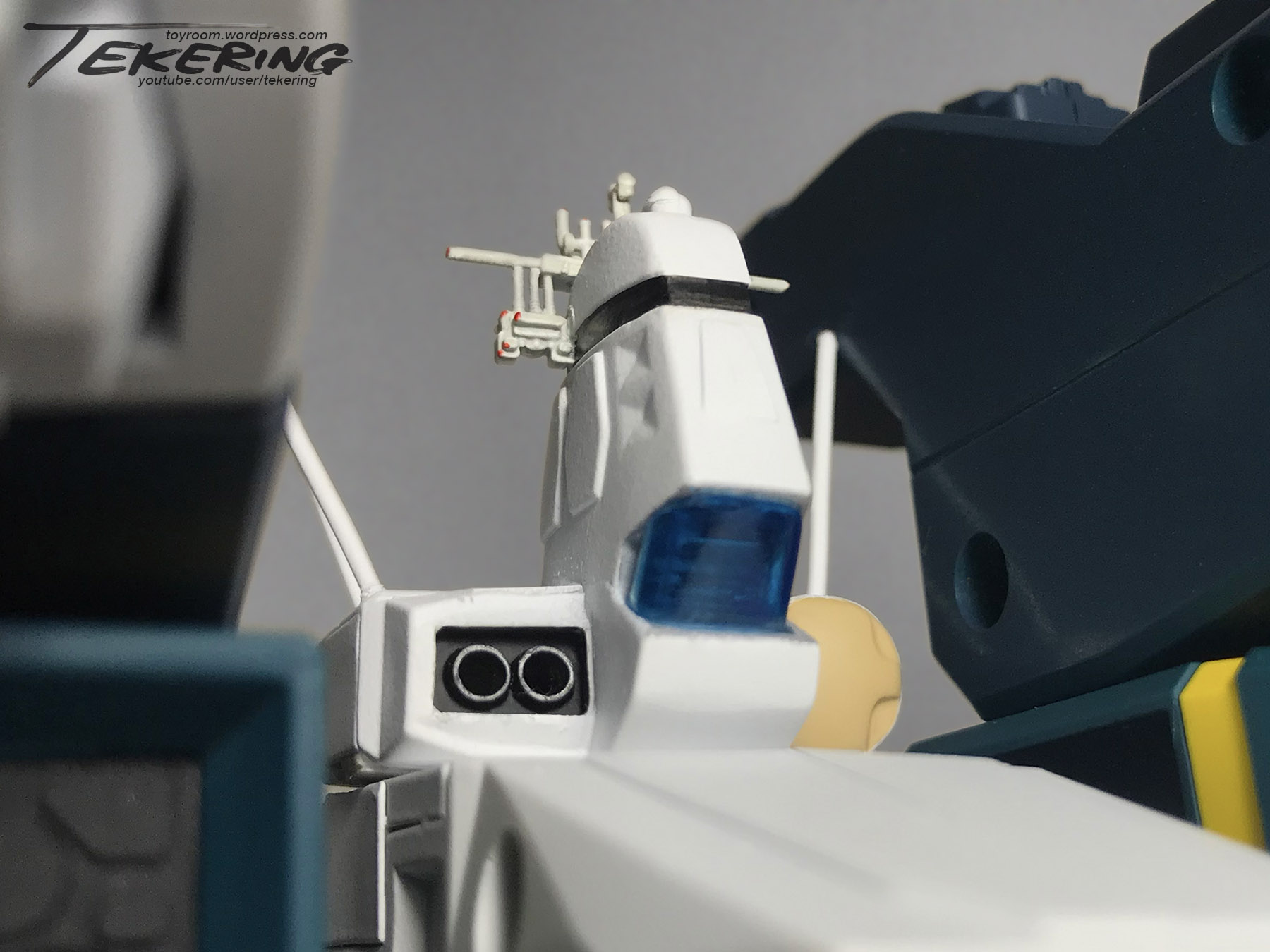

I added some tiny red lights to the radar array:

Actually, I think I just came up with a better solution:
A couple of 2mm holes (strategically placed to avoid interfering with the internal mechanism) allows me to secure each subassembly directly to the frame instead. 😊

Transformation would now require removing a couple screws from the outside, separating the frames, repositioning them and tightening the screws on the inside, and then putting them back together again.  It's not an elegant or toyetic solution, but hey... at least Minmay's not gonna fall off a cliff. 😇
Durability requires clean holes that are the precise diameter to the screws you're using.  The parts won't attach securely if the holes are too wide, but you'll crack that infamous blue plastic if the holes aren't wide enough.  There's not much margin for error, so proceed with caution! 😬
Yeah, it was pretty easy to drill/manually screw into that diecast metal (left divot in the pic below):
