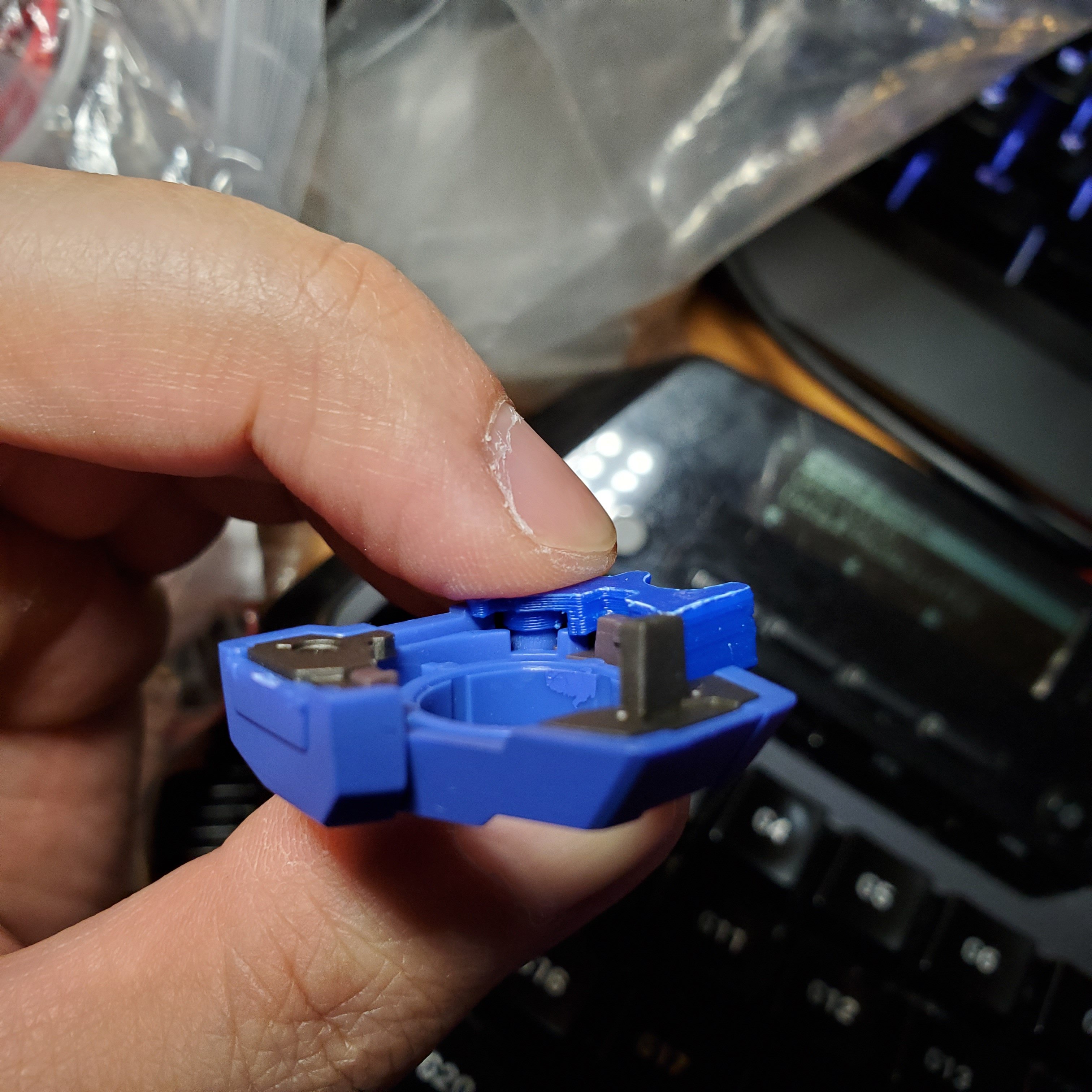

Stock backpack disassembled:
The two metal pieces are handed and will need to be mirrored, and I'll need to cut the left side of the shell to match the existing opening on the right. Beyond that this shouldn't need any modification.

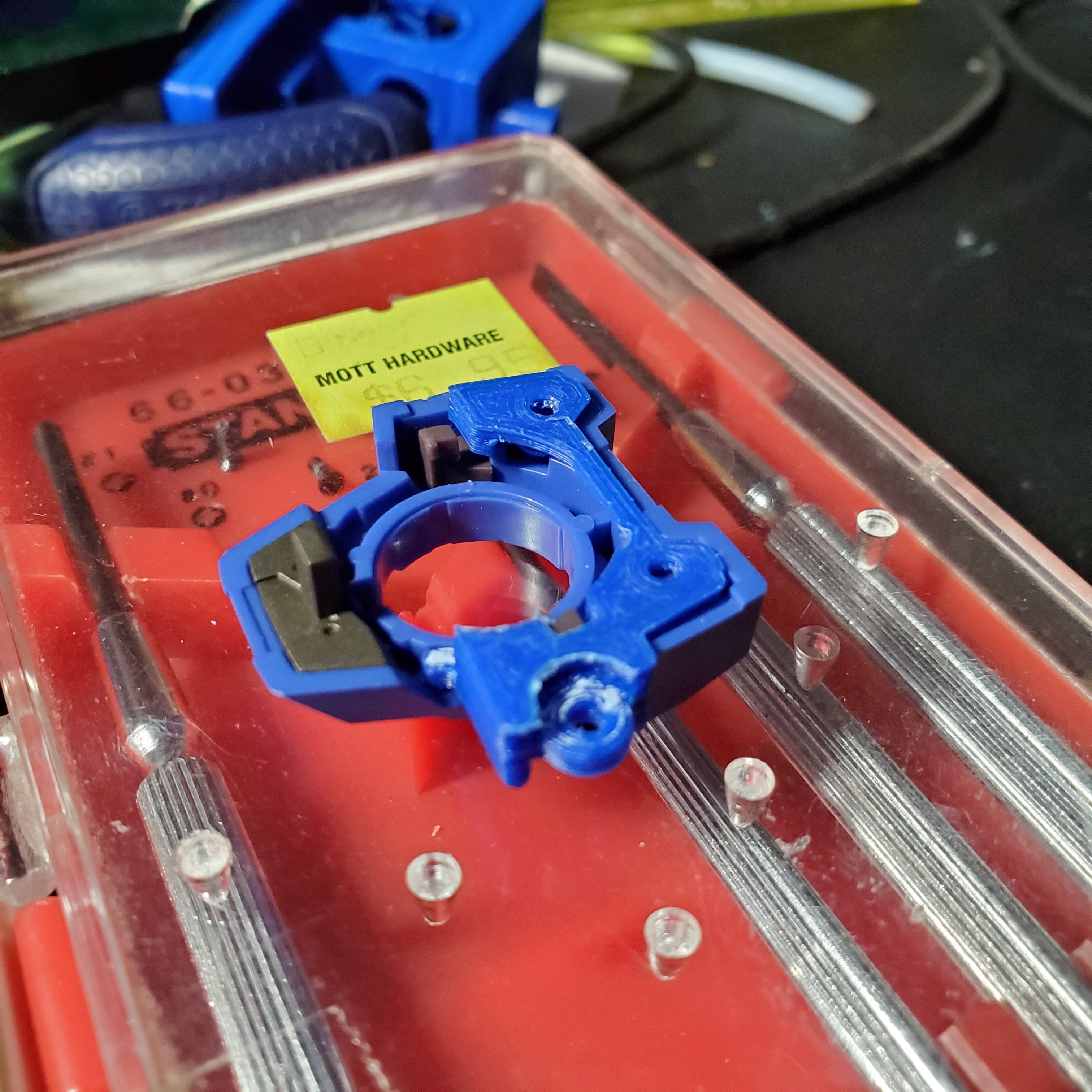

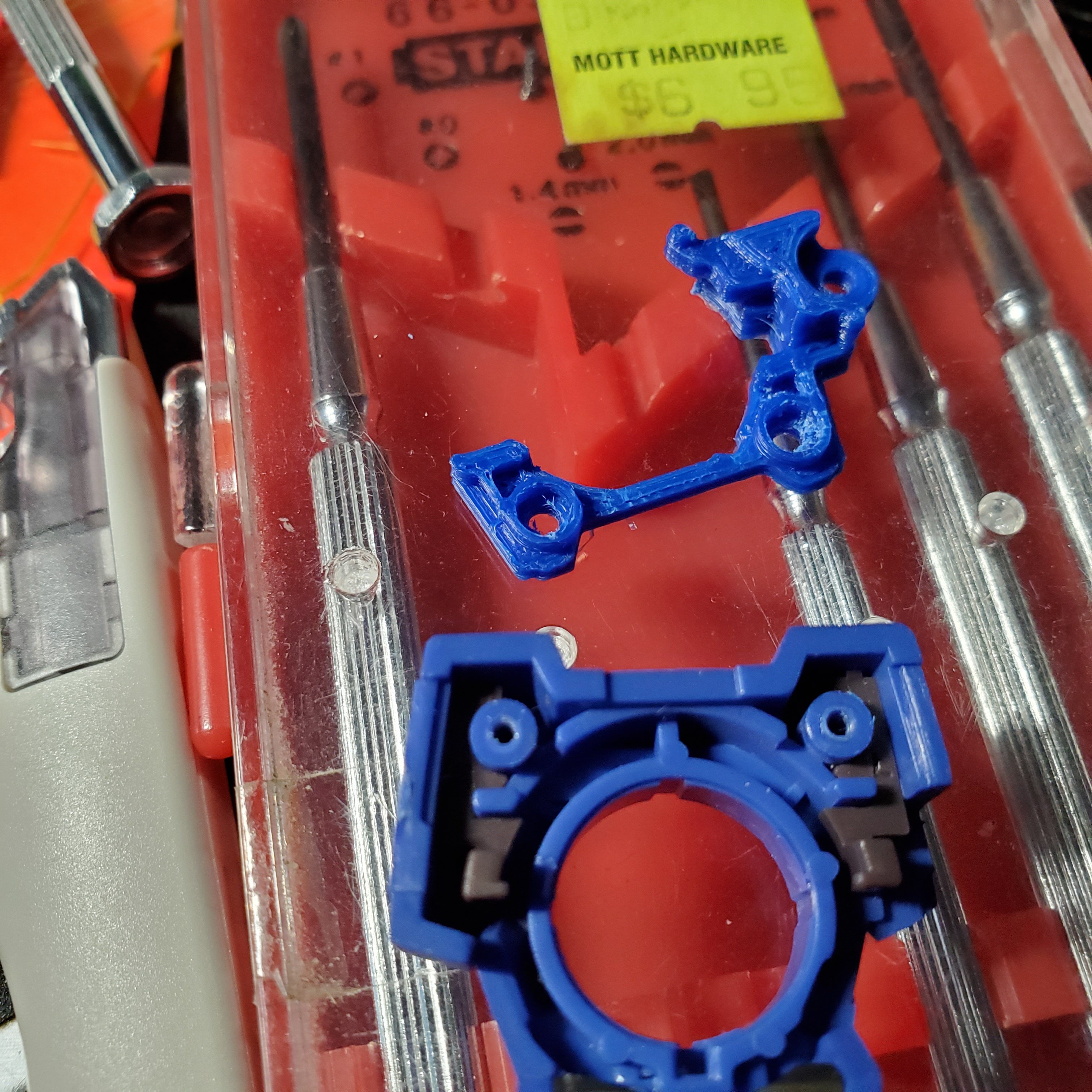

Bracket prototype #1 is a bust; doesn't fit either the shell or the first joint of the arm. It's fairly close for trying to model something that complex with nothing more than a pair of calipers though.
It looks like I've got to open up the features a lot to account for the low precision of the printing process. I'll probably leave the holes for the pins as they are and drill them out to cause the kind of tolerances they seem to get in printing just won't work for a force fit pin.
Now to revise the model and wait another month for shapeways to print it.

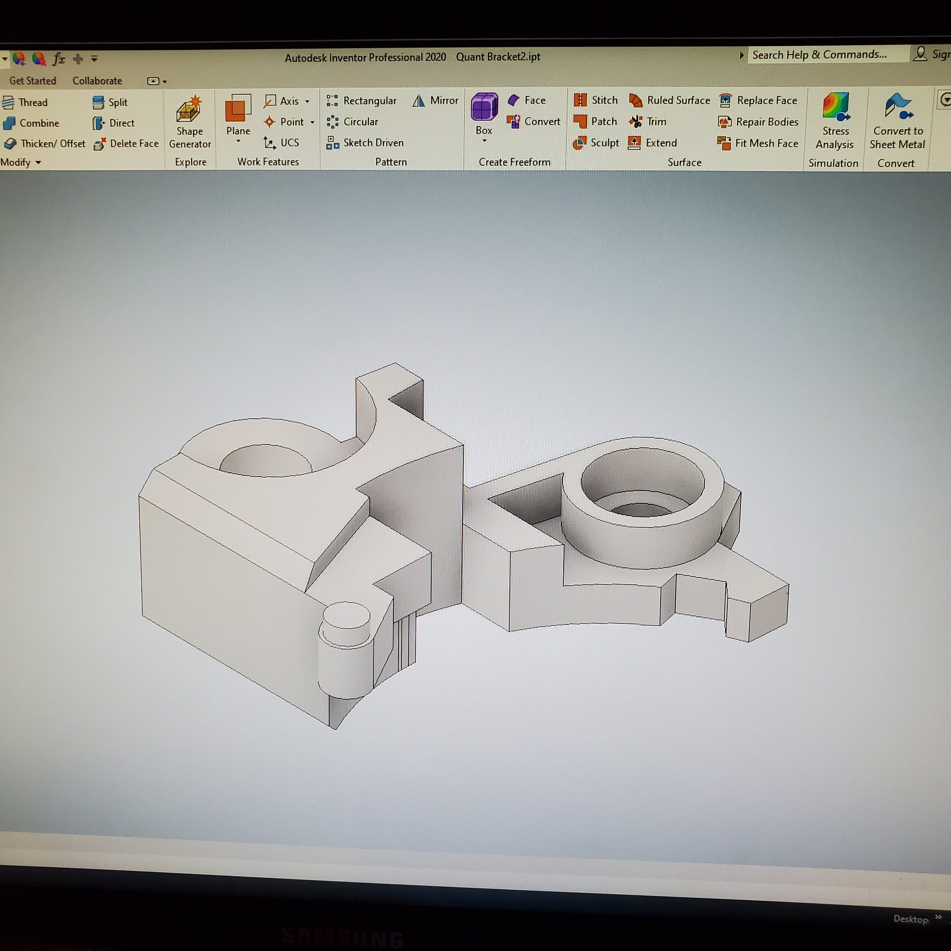

Thanks for the offer but I had version 2 of the bracket and version 1 of the arm joint ordered before I even made the post here; if you want to check it out anyway I've attached the .ipt file.
Quant Bracket2.iptFetching info...
It's not my best work since I'm stuck with Inventor LT at the moment (Burning through my free trials before I bite the bullet and get a personal licence; might end up going Solidworks since it's a one time payment rather than a subscription but that's a good chunk of money.) and doing an assembly of the easier to measure parts to drive the bracket off of is a non starter but it's decent for what I have to work with.

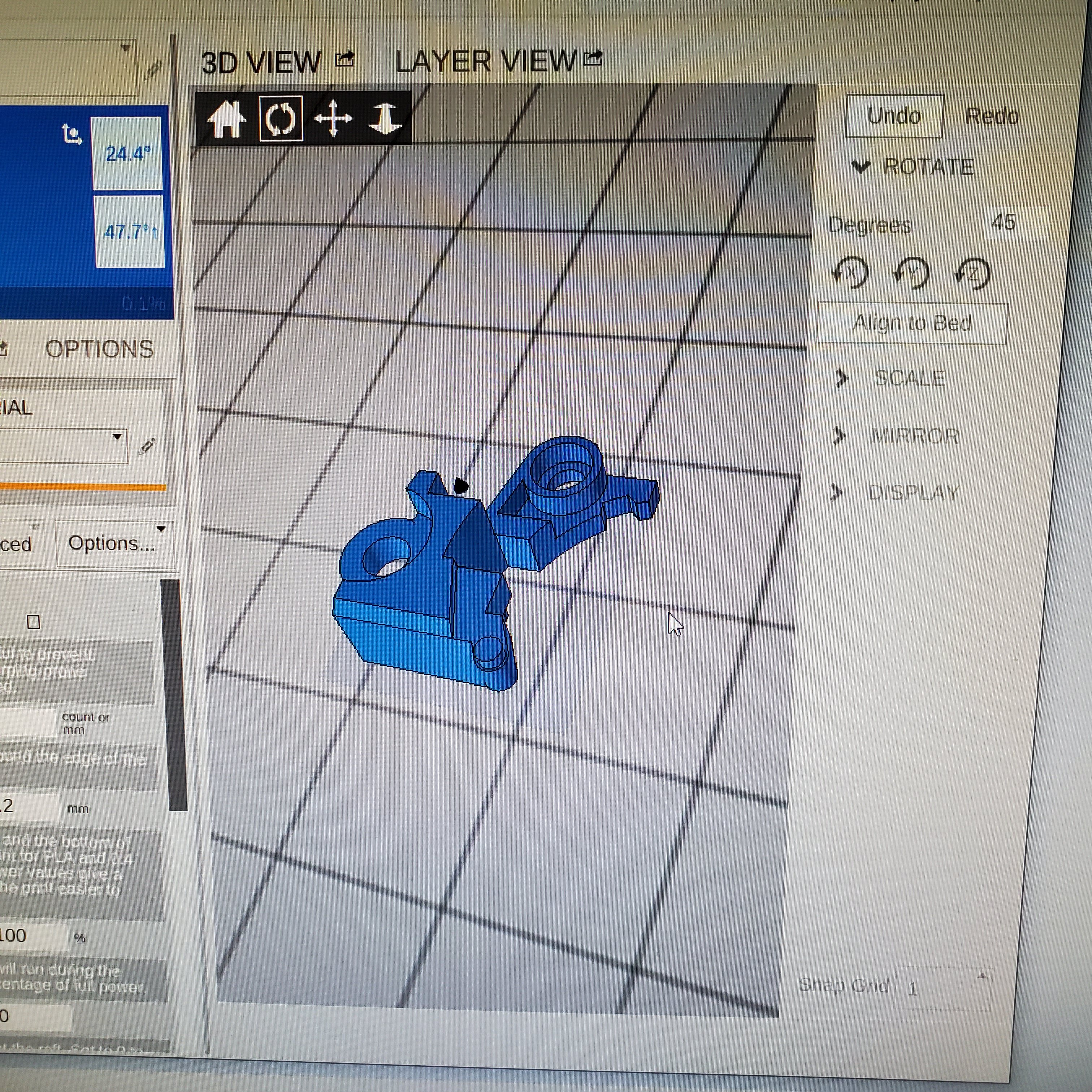

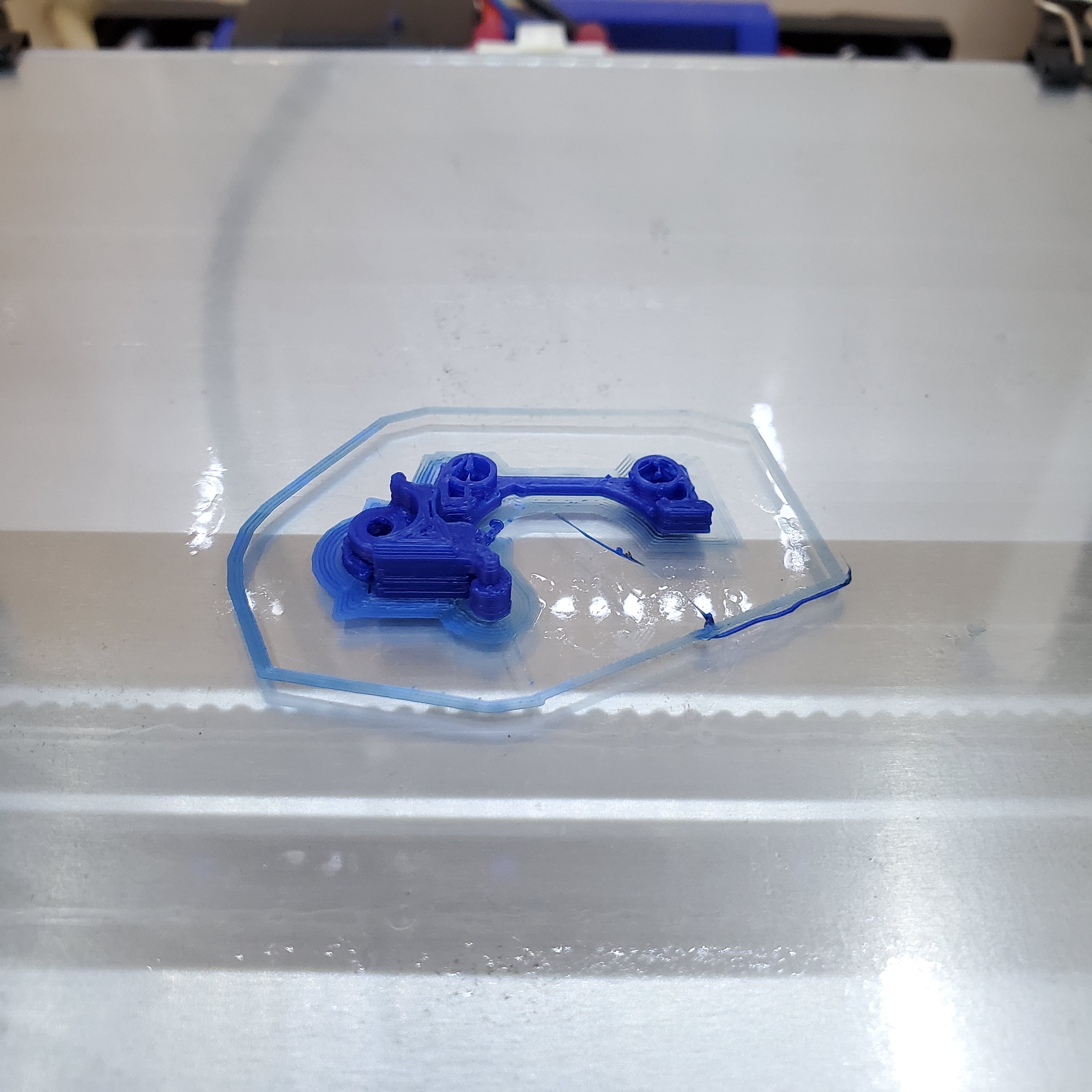

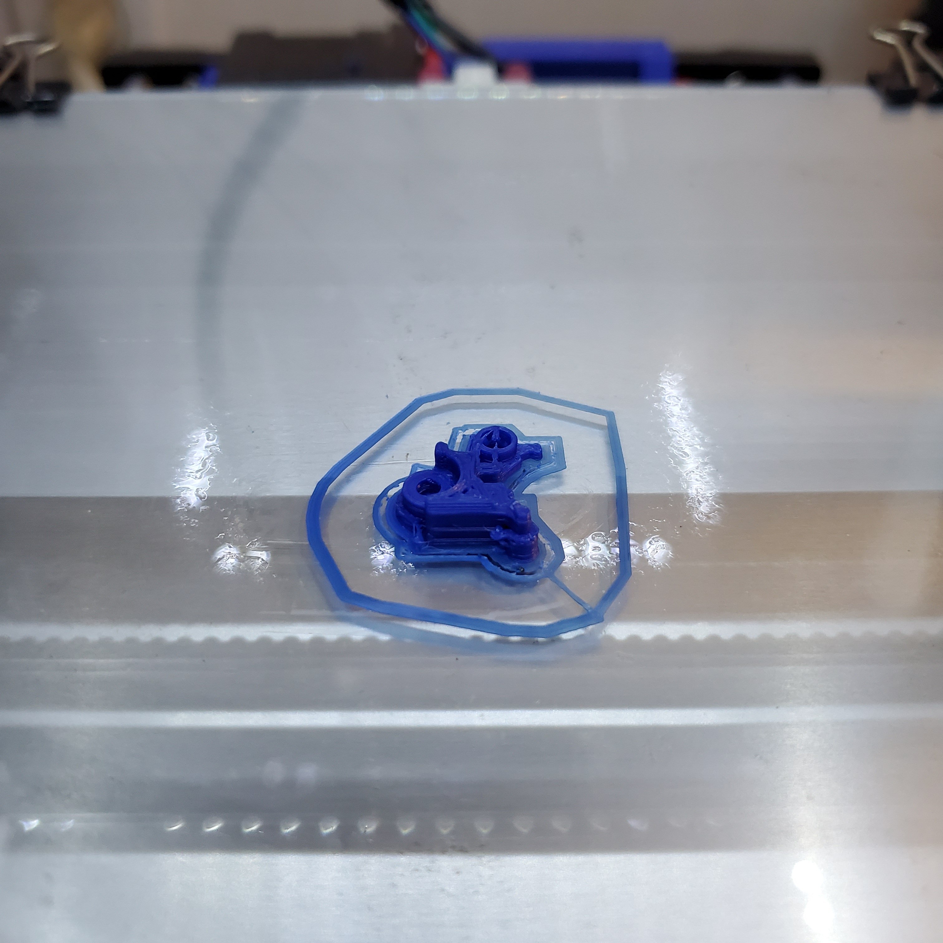

Okay I got the file and export it as an .stl. going to give this a few prints with different settings and see how it turns out.
20200314_194706.thumb.jpg.7a962509111f29c1bc10f6762c325730.jpg20200314_195325.thumb.jpg.76f2b8fd25cbaa6e1df42fd96671de13.jpg
Edit:
First print about 18 mins (with bed heating); ABS; 0.2mm 60mm/s speed, supports;
Now i just need to dig up the mb qant again... lol.
Edited by PsYcHoDyNaMiX

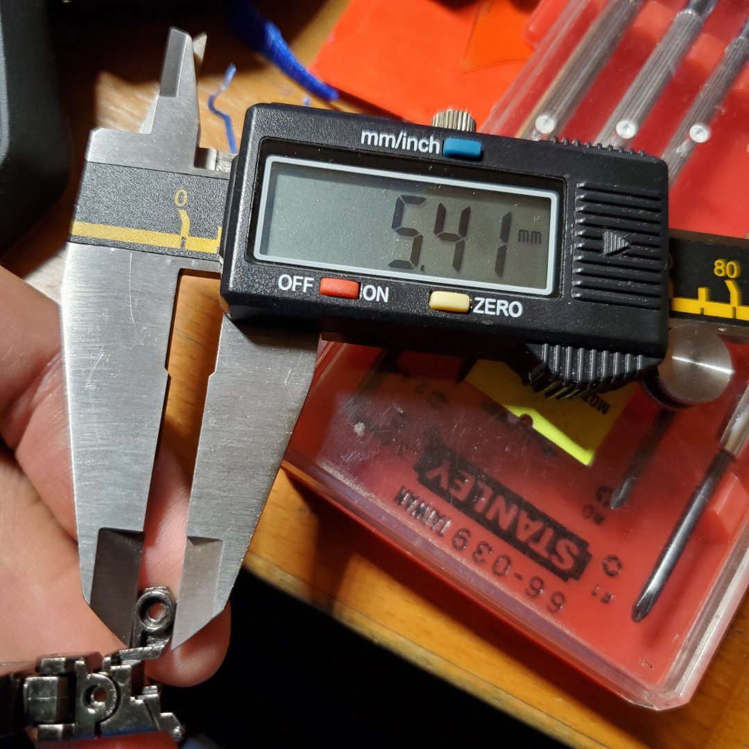

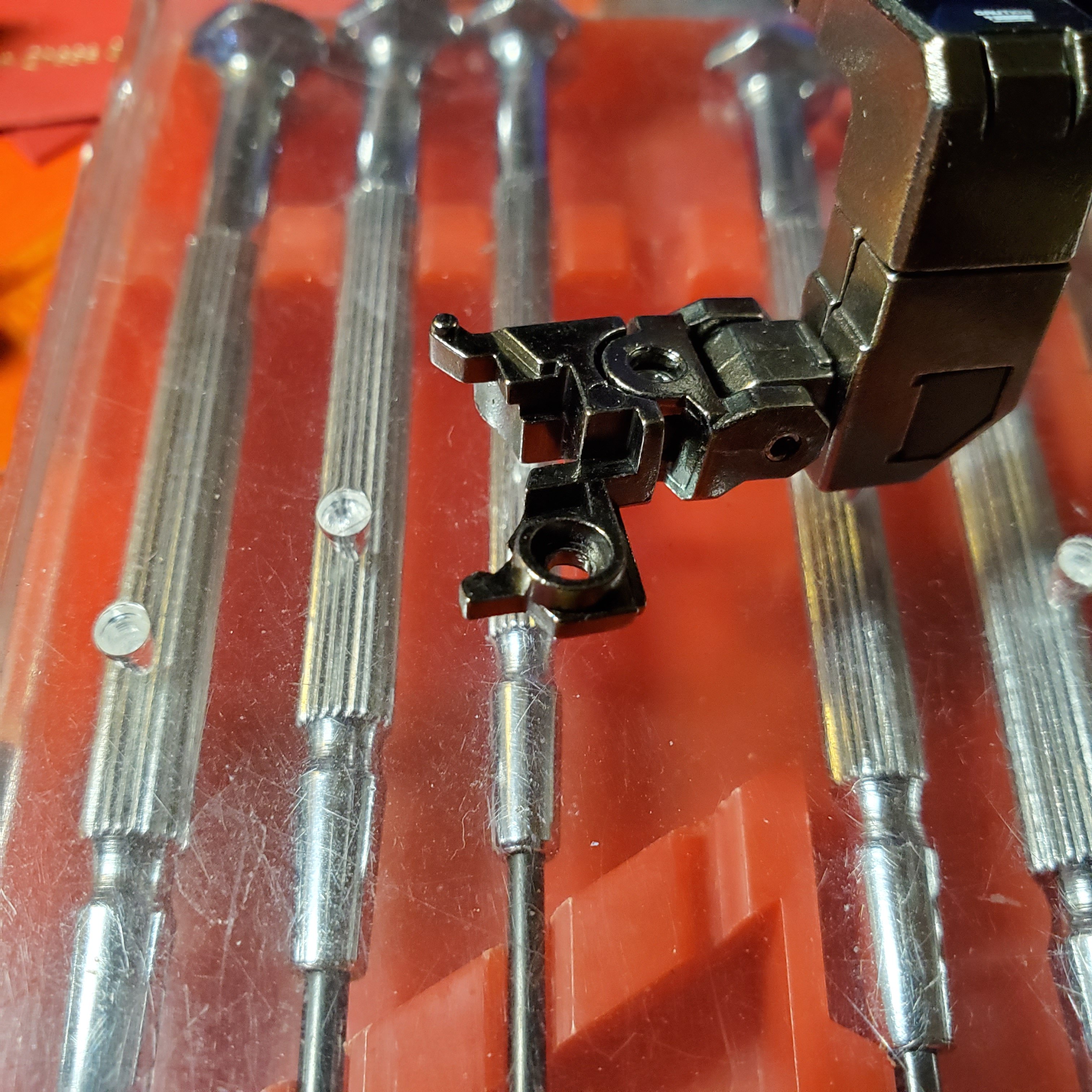

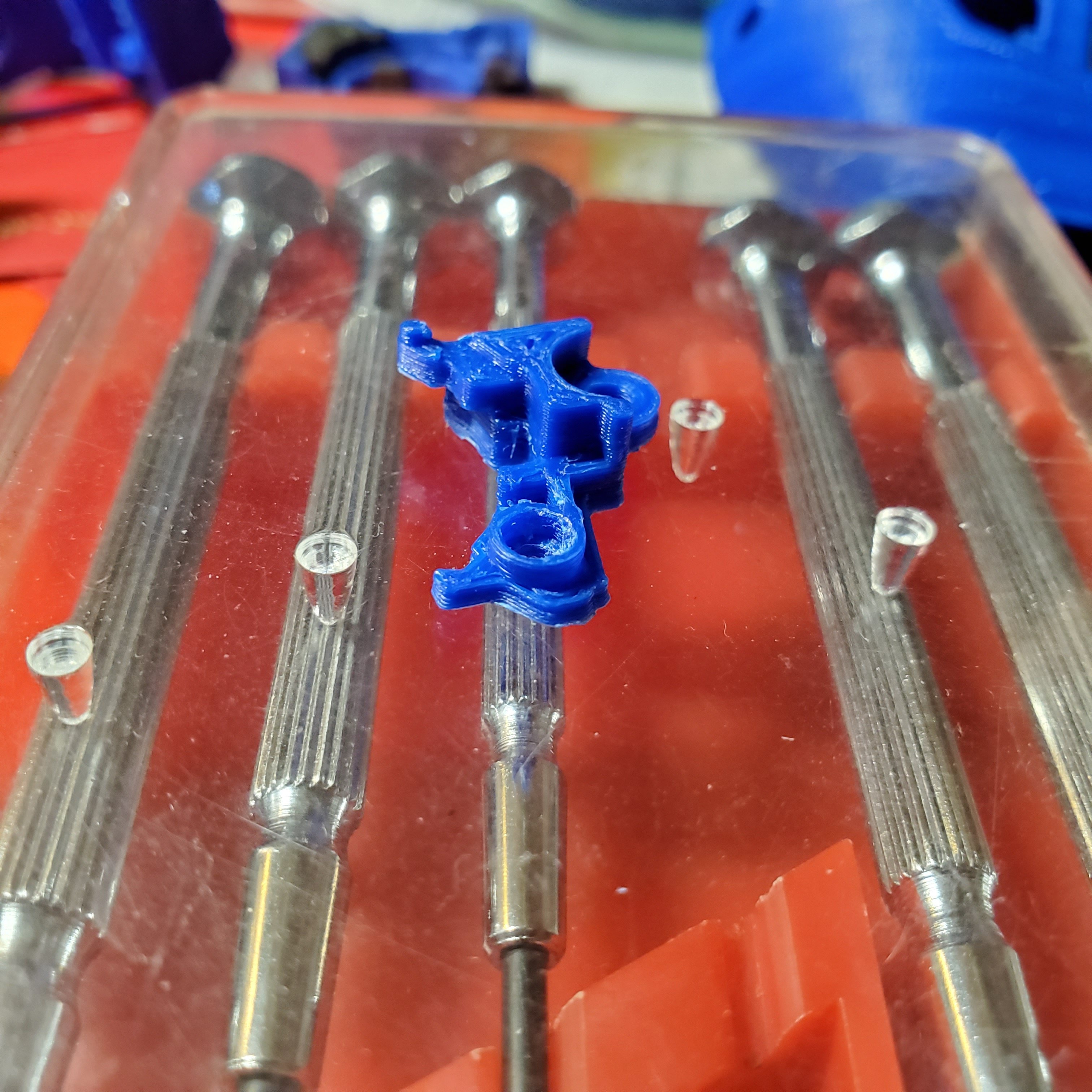

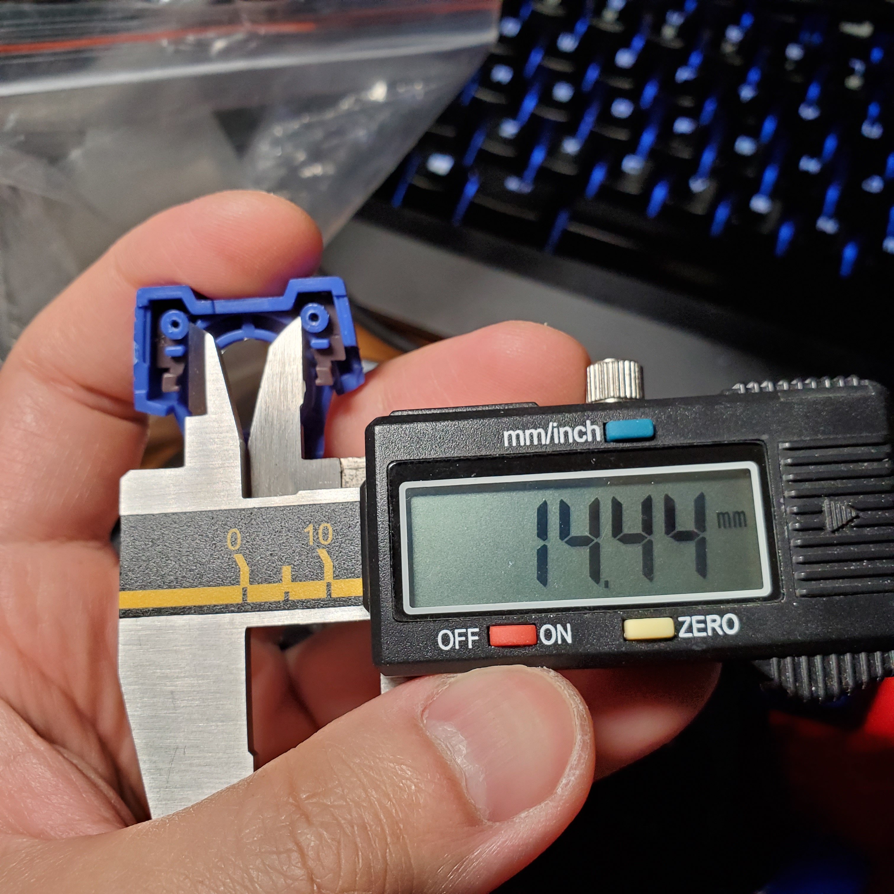

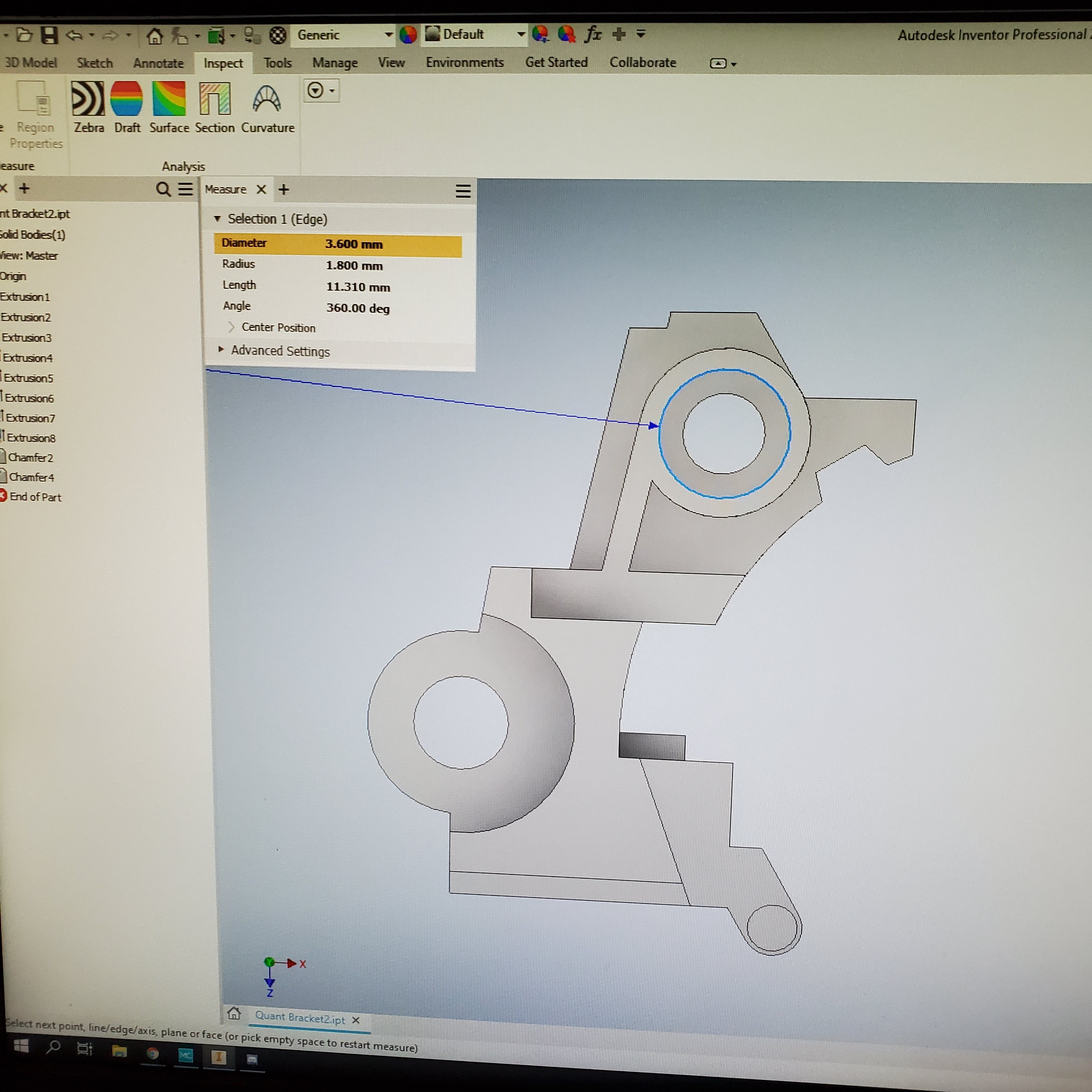

Okay I tried to fit the part after cleaning it up and the top part of it was a bit too tight (the inner diameter for extrusion 3).

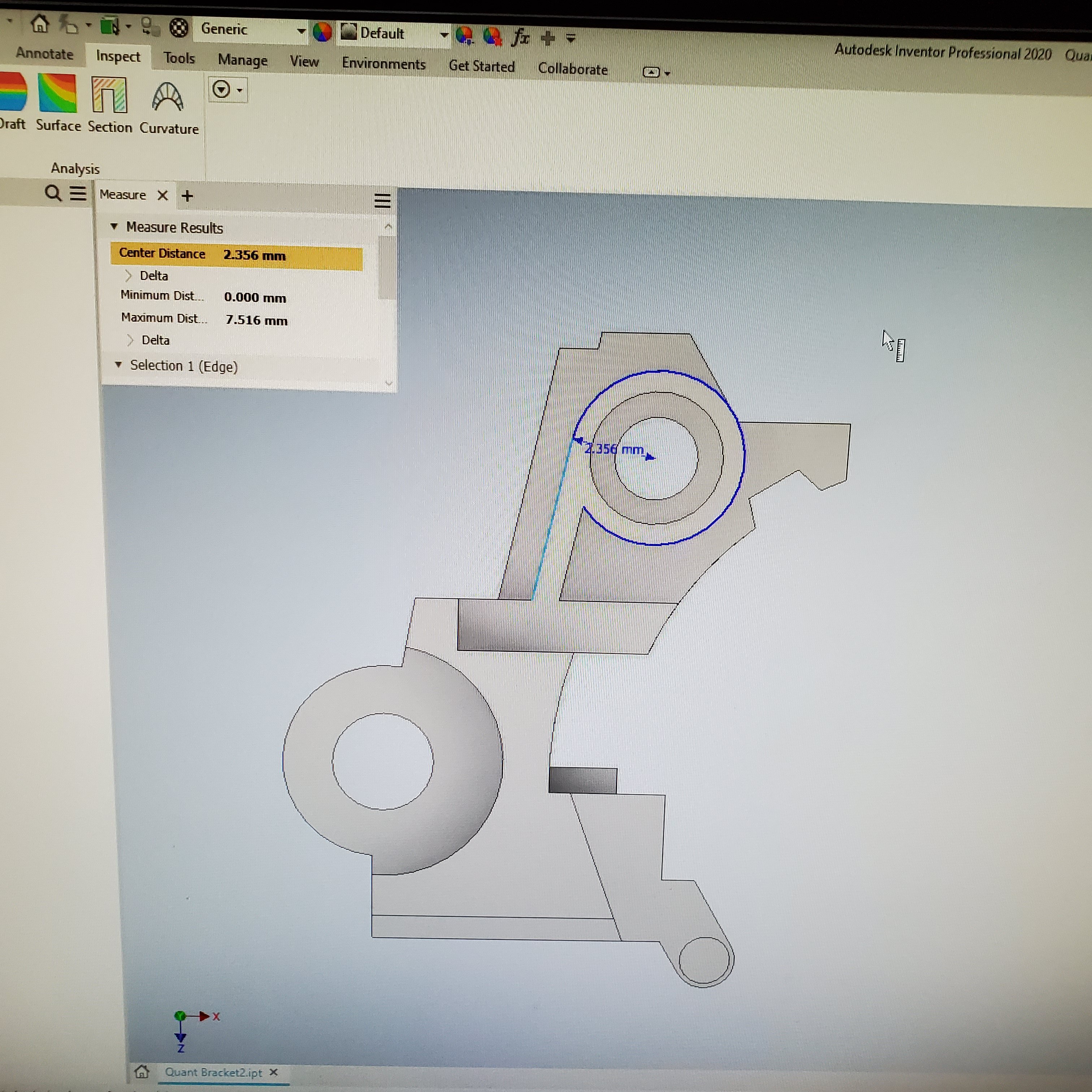

I also measured Bandai's metal bracket for the inner and outer diameter, theirs is about 3.65mm Diameter (inner) and 5.40mm D (outter).
20200314_205430.thumb.jpg.e393eab142ce6201225ea3e5d9e52ec3.jpg20200314_205800.thumb.jpg.17f7259b002da896fb00efae89035b9d.jpg20200314_205847.thumb.jpg.599e6d8ae2d0ffa5e13f54b525b9fcd2.jpg
I believe yours was 3.6mm D (inner) and 2.356mm Radius (4.7mm outer). I adjusted it so the inner is 3.7mm and left the outer the same since the circular extrusion looked to be measured to the outside of the bracket.
20200314_210457.thumb.jpg.76c5c4ea77f347bc48e43d59563d8390.jpg20200314_210856.thumb.jpg.d3929a1dcf3619508d20994935696969.jpg
Currently printing up another one with the slight modifications. I'll post a response after I attempt to test fit.
Edit:
Okie dokie the 3.7mm Diameter (inner) change seemed to work! Just a hair snug...
the unfinished surface is because my printbed was just a wee bit too high to the hot end.

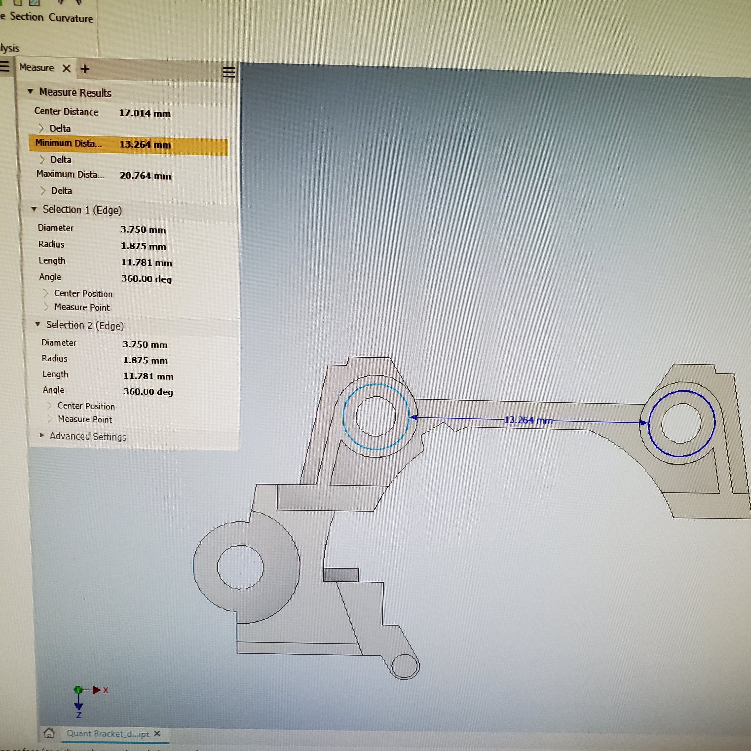

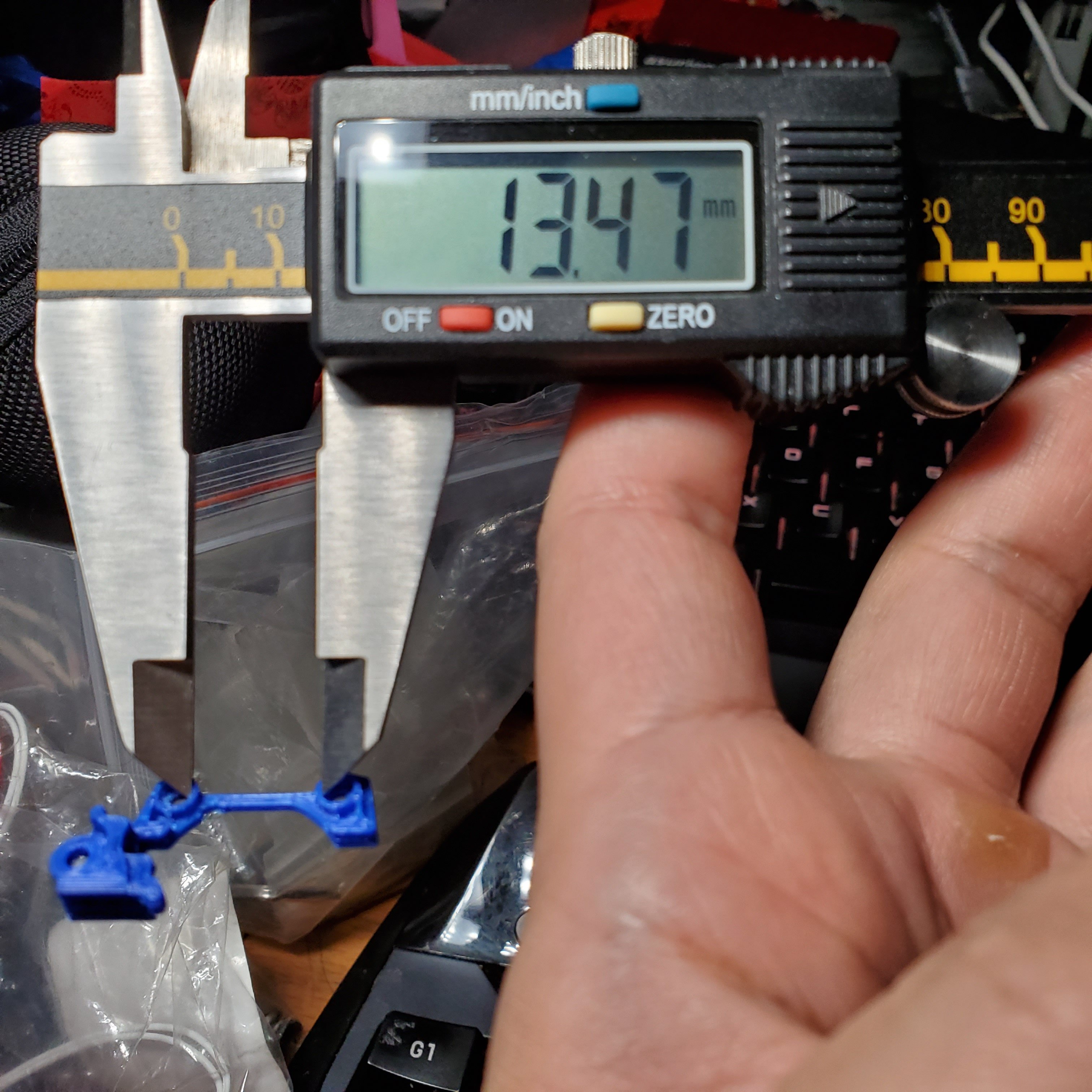

Awesome; thanks. It looks like the I.D. of that circular feature and the O.D. of the boss it fits around are tapered; I'm getting measurements from 3.55mm at the base to 3.75mm at the lip. It's probably just drafted for mold removal so I went with a straight I.D. of 3.75mm.
 Quant Bracket_double.ipt If you want to try that to see if everything lines up I'd appreciate it. Then I can get it ordered and find out if I have to adjust anything for the relatively low accuracy of the steel printing process.
Edited by Jaustin89

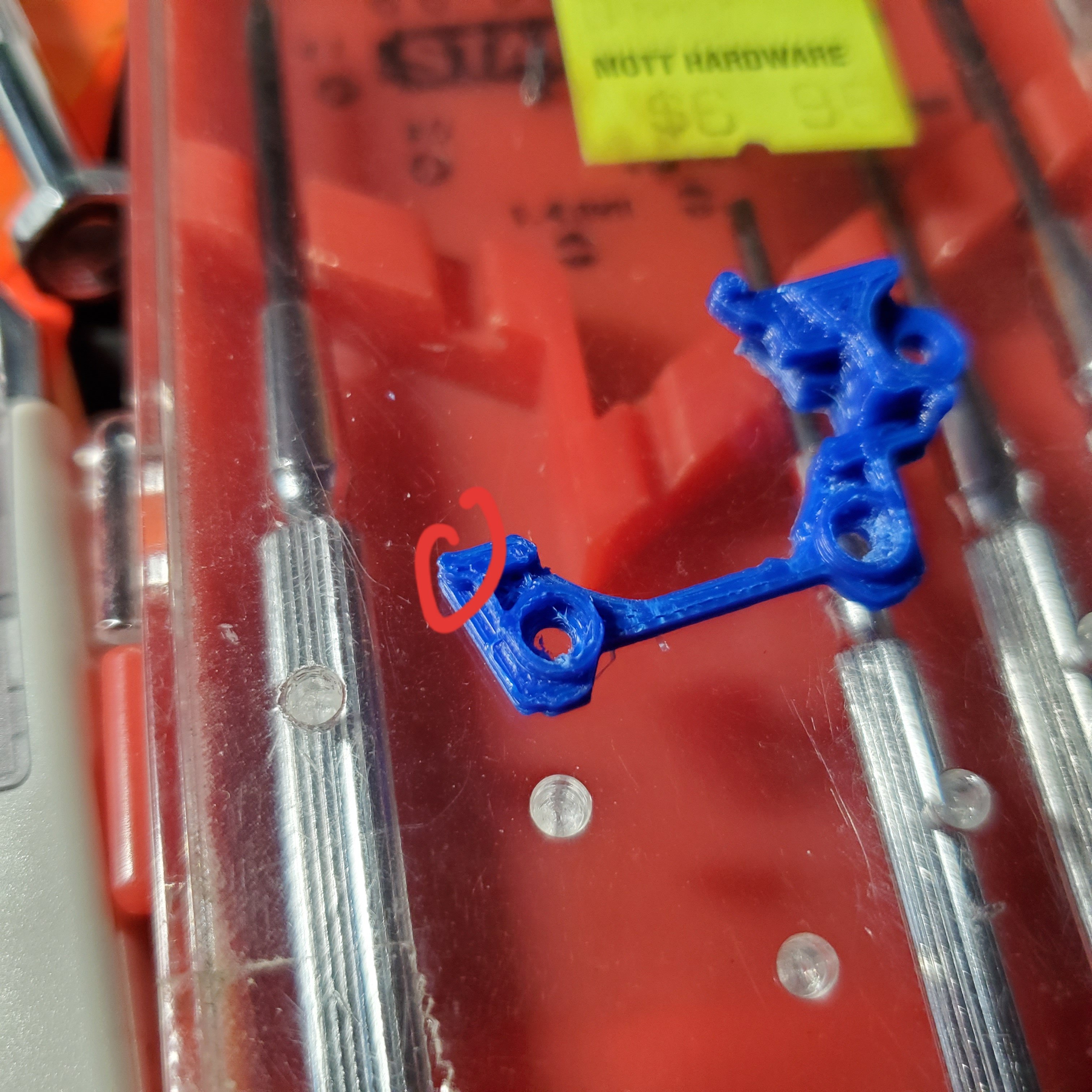

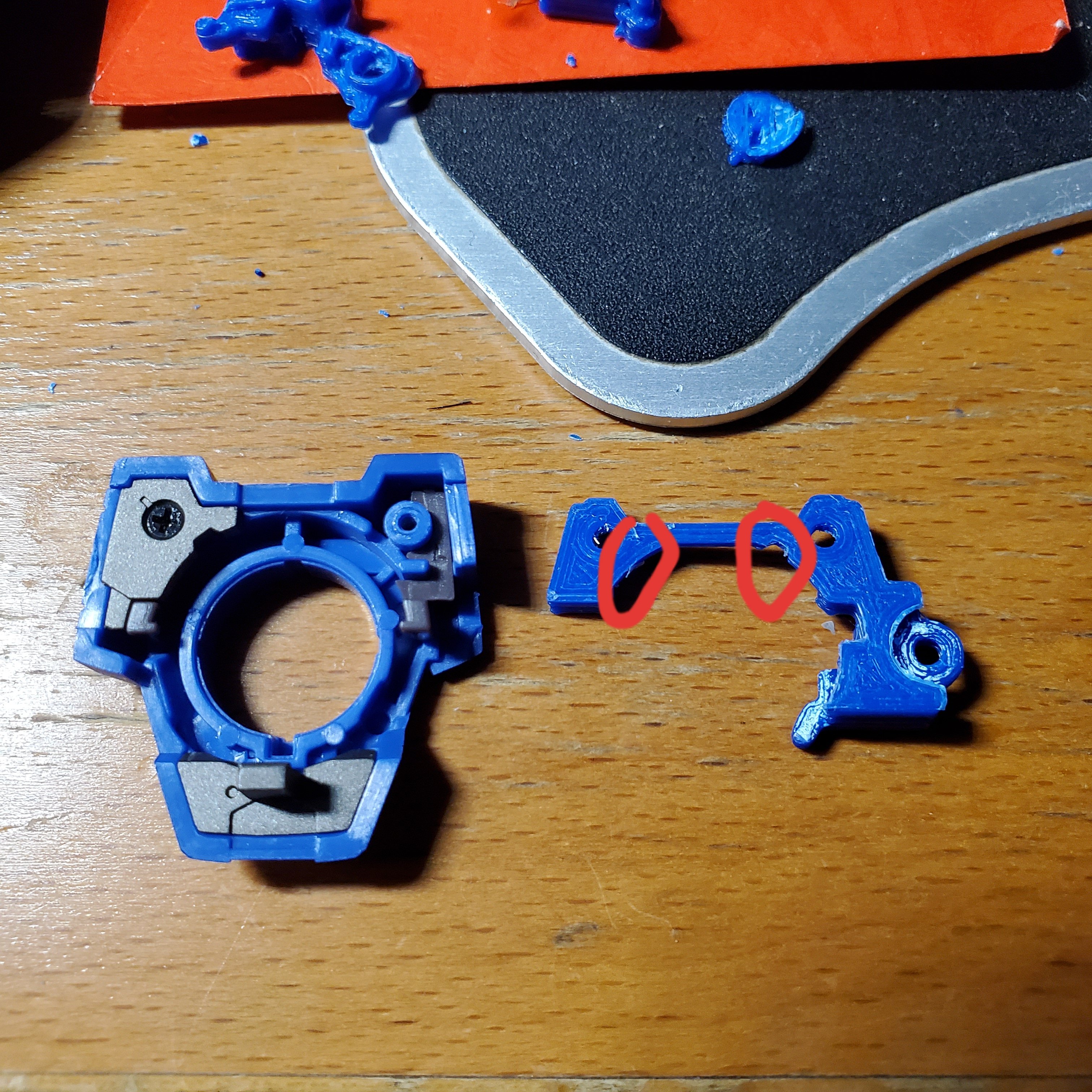

Okay I printed up the part. The orginal side fits with no problem.
  Reveal hidden contents
The issue with the doubled side is two (maybe three) problems.
1. The distance of the doubled part modeled is too short
2. There's a little nub (feature) on the outside edge that hits the blue backpiece (preventing it from sitting flush)
3. The little indentation (feature) that is on the original side but is missing on the doubled side? It might be needed when the backpack is fitted onto the qant.
Thanks for the help. The past two days saved me ~$50 and a month and a half of iterating through shapeways; the money's relatively trivial compared to te rest of the costs on this project but the time it takes drives me insane.
The nub and missing cutout on the mirrored side are fine. The nub is coming from just chopping off the lower portion of that side rather than checking the features in the shell; since I'm going to be cutting the shell off at that point anyway it won't be an issue.
The cutout is for the indicator on the LED switch it's only present on one side; I know the original plastic inset on the other side has the same feature but it serves no purpose and is a potential failure point in printing/polishing so I deleted it.
The shortness is concerning though; it means the radius that drives upwards of half the geometry is off. There's so many dimensions and constraints tied to it that trying to change it blows away the rest of the geometry.
Fortunately I made a construction sketch of the drive body (Really should've thought of that earlier but I'm so used to being able to interrelate parts through the assembly environment It didn't occur to me.) and it looks like in theory everything will work with the existing radius though some areas are a bit tight. Should be close enough that I can just grind down a bit of the bracket if it doesn't fit.
Now it's just a matter of if shapeways can print it accurately enough. Their page on the steel process says that the tolerances vary wildly and are unpredictable due to cooling shrinkage but can be as much as 5% which is massive compared to some of the margins I have to work with.
Edited by Jaustin89

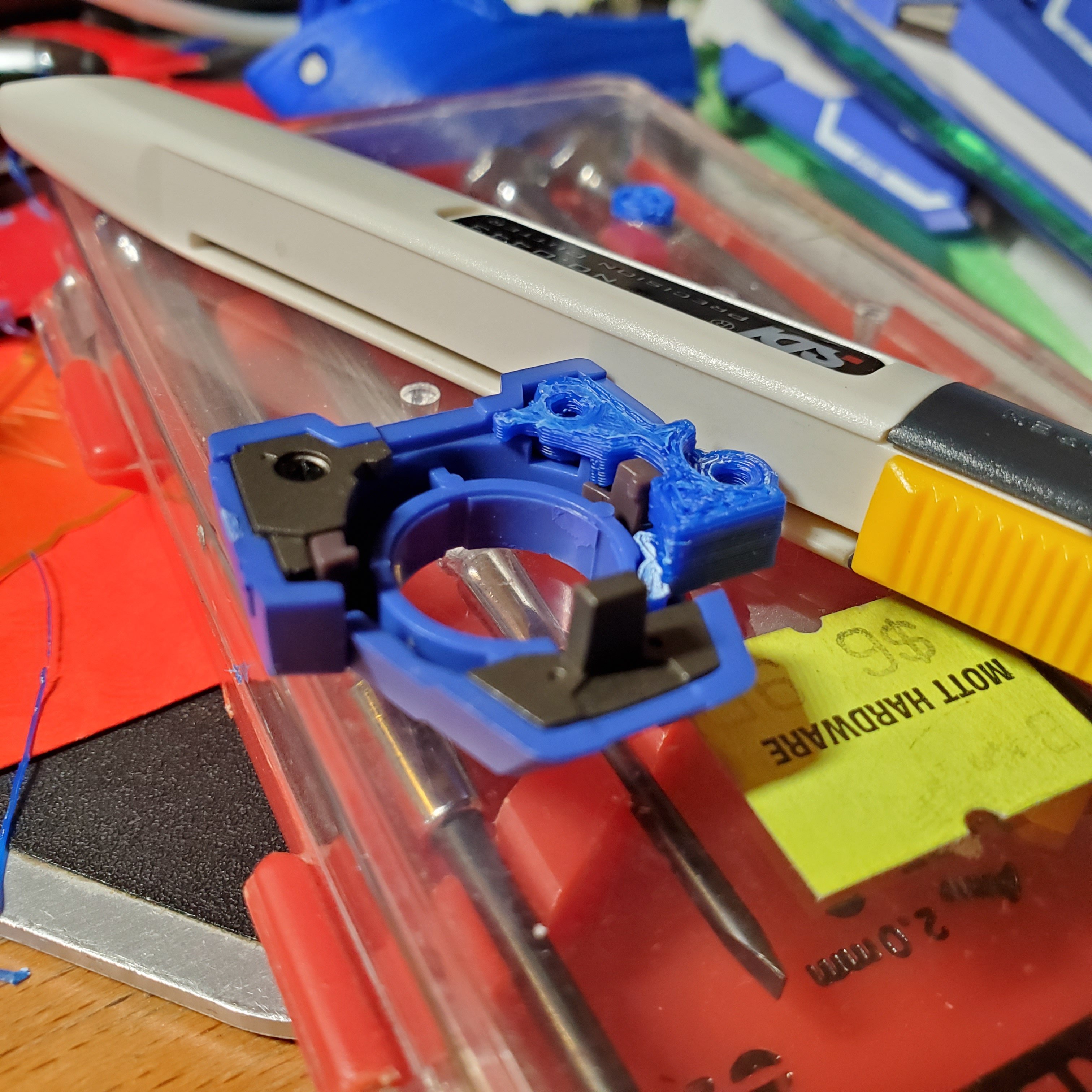

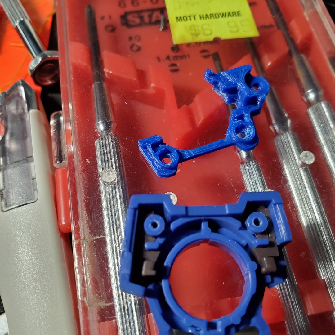

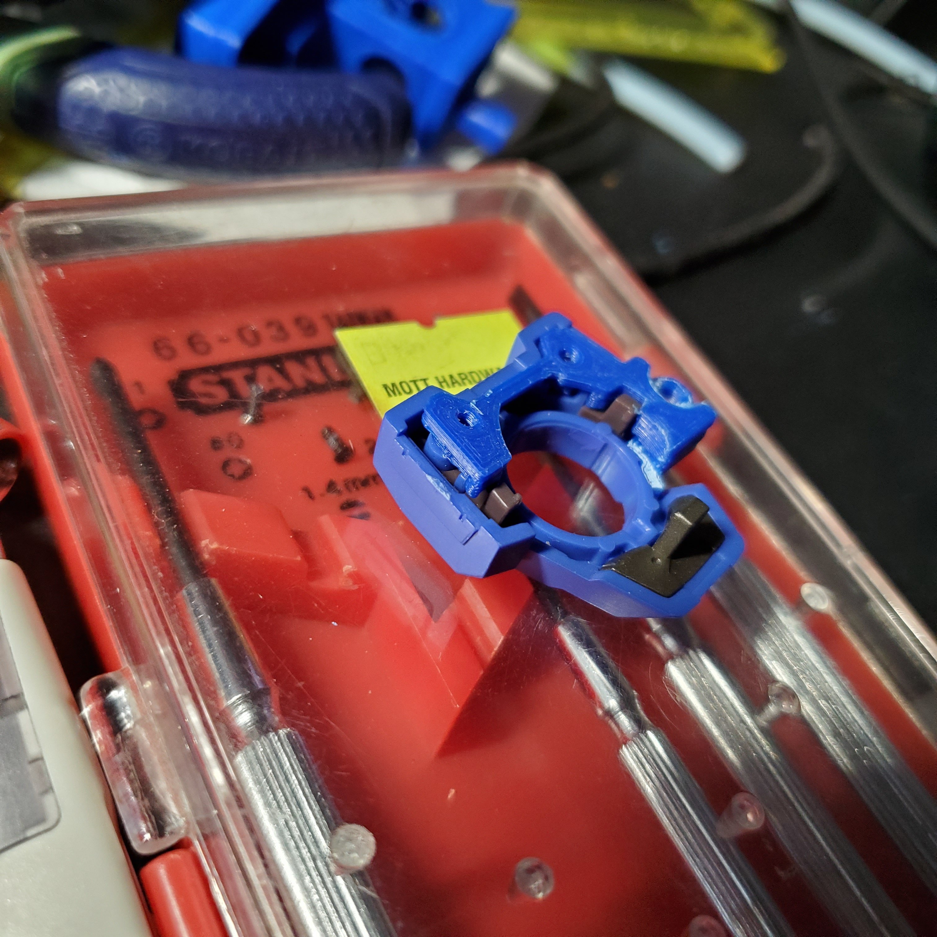

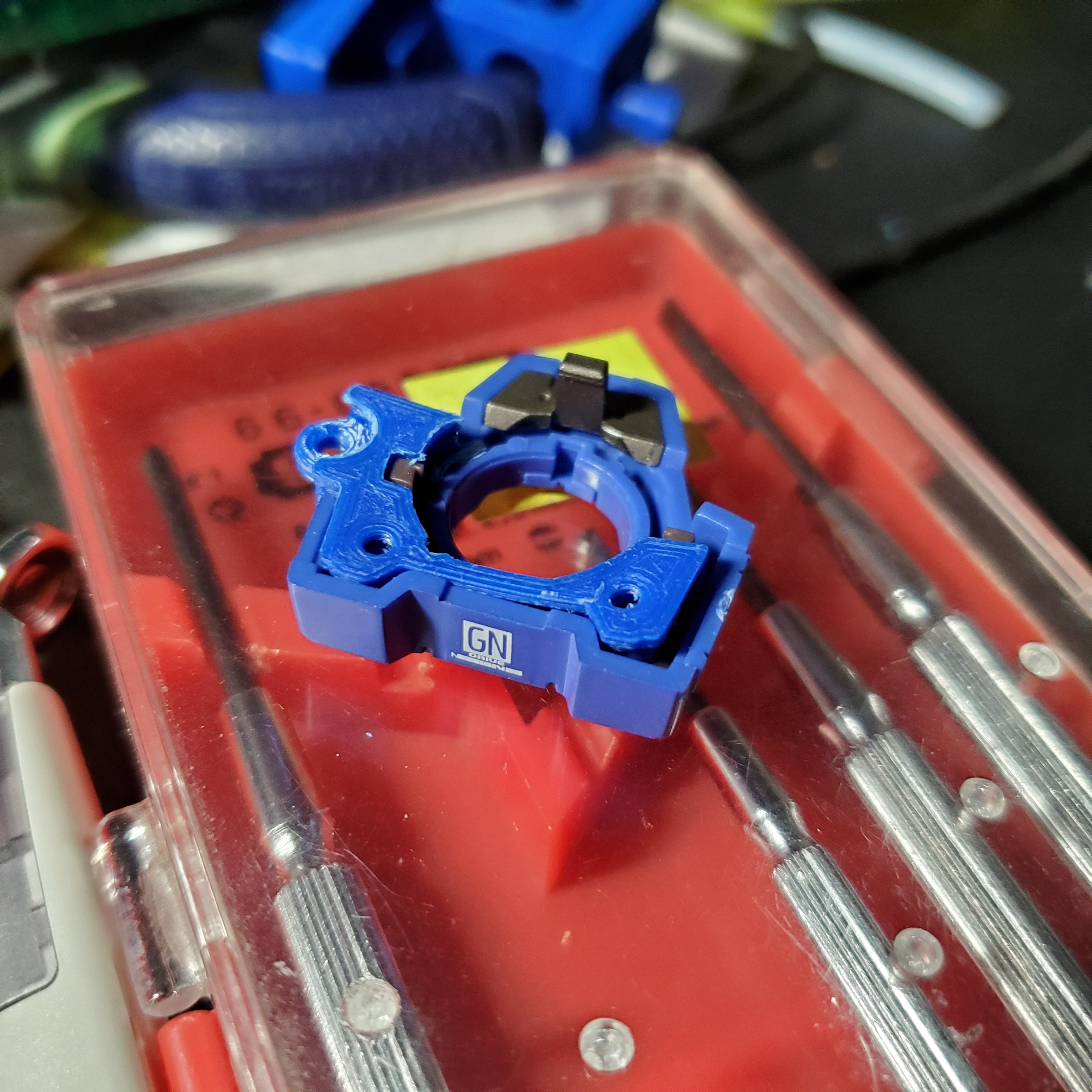

The 3rd bracket prototype finally showed up. I'm going to have to do another since I forgot to leave space in the interface with the first arm joint (it seats but in a raised position an wouldn't be able to move much); but I think I'll consider this good progress and proof that the idea will work.
Edit: photos won't upload for some reason but I got the backpack shell cut and the bracket installed and was able to mount it on the figure.
Edit2: still can't upload images here but I uploaded to Imgur to bypass the issue.
