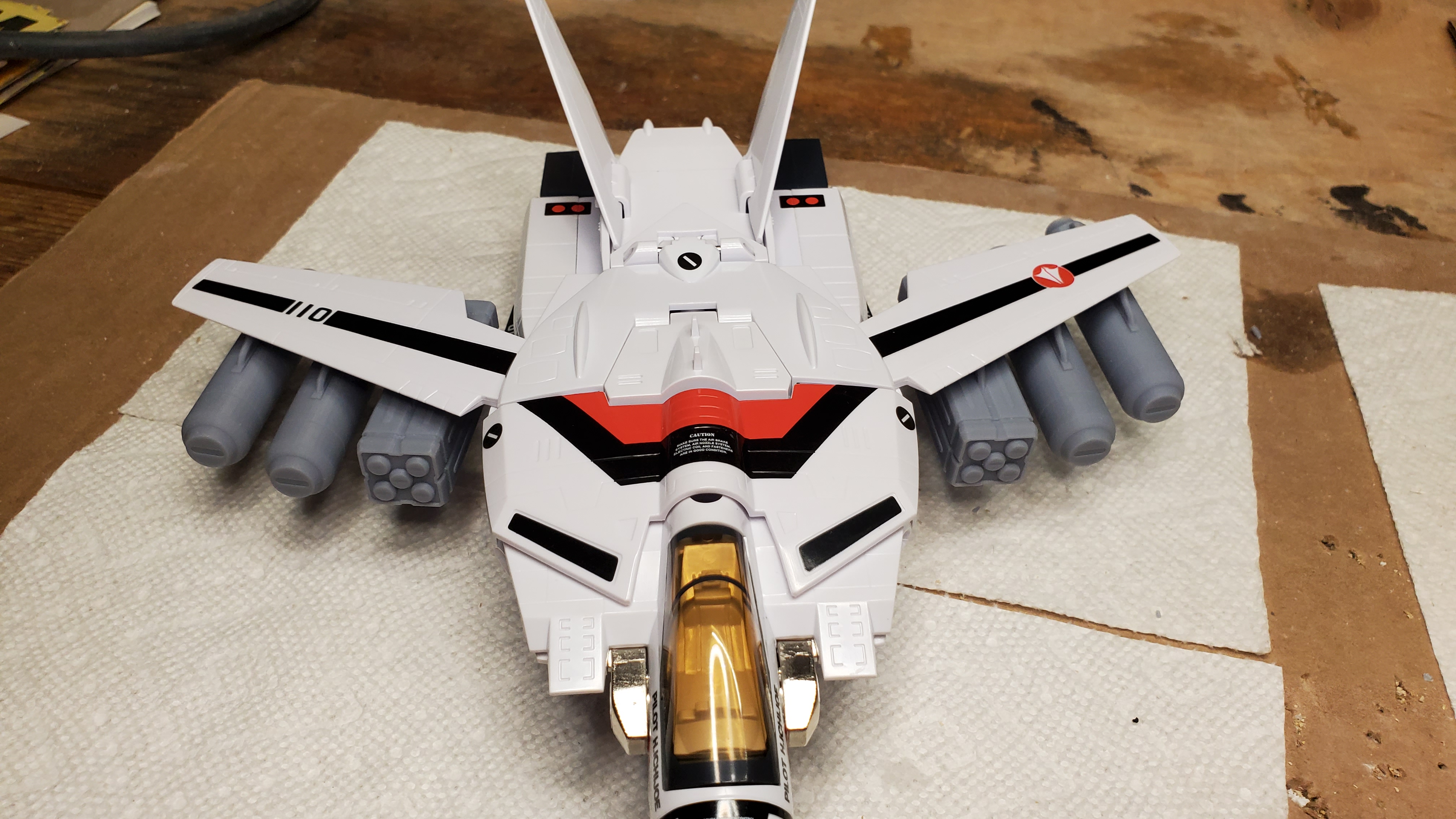

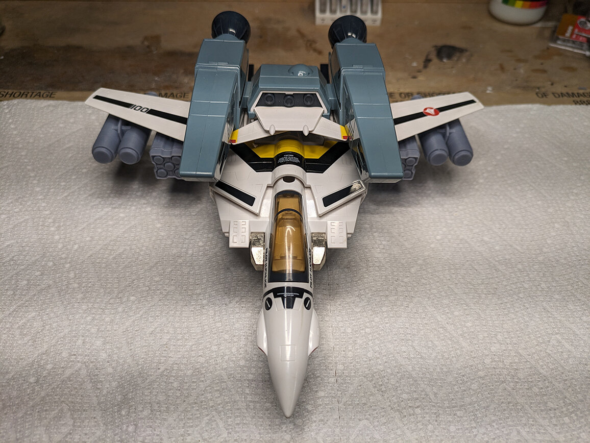

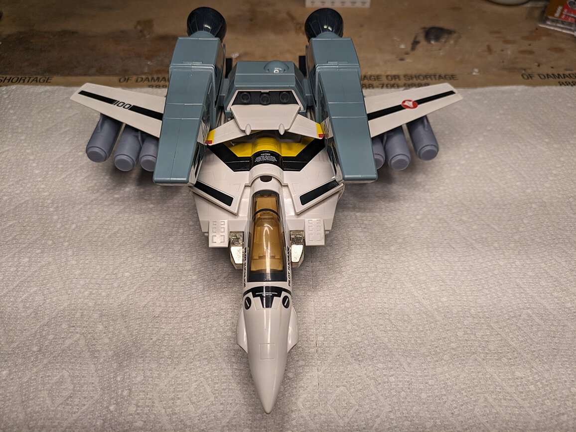

Anasazi37 Posted October 25, 2022 Posted October 25, 2022 16 hours ago, Chunky001 said: That That..................is...........................awesome!!!!! What are the plans for how they get attached? Thanks! Still a work in progress. I'm already designing new armaments, now that I've seen how these ones look on the 1/55. Stay tuned. Right now I'm attaching them using temporary blue tack, but doing so more permanently will require embedding small magnets in the parts and the wings. These are meant to go on some Strike customs I'm working on, so I don't mind altering the wings a little. Quote
Anasazi37 Posted October 26, 2022 Posted October 26, 2022 17 hours ago, Chunky001 said: Now that I think about it 3M has some nice thin double sided tape that may work a bit better than blue tack. I myself don't mind modding the wings. Keep us posted. Those look great. Especially the beefy reaction missiles. They look perfect on the Chunky! I'd love to get a few sets of these! Yeah, the blue tack was just a temporary thing so I could quickly stick the armaments on and get a sense for how they looked on the valk. Double-sided tape is a more elegant solution for longer-term attachment without having to modify the wings. Will keep everyone posted on availability. Worst case I'll post the files on a site like Cults3D so folks can print them, but could also potentially print some sets for MW members. I do like the chunkiness of the current RMS-1, but it's also been bothering me, so I decided to create a new version from scratch, using the Hasegawa 1/72 Weapons Set as the primary source, and will see how that looks on the valk. I'll do the same for the UUM-7, but the design is a bit more complicated and will take more time to draft. Quote

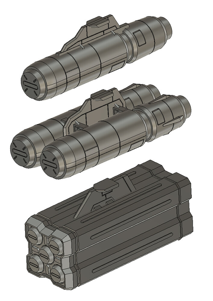

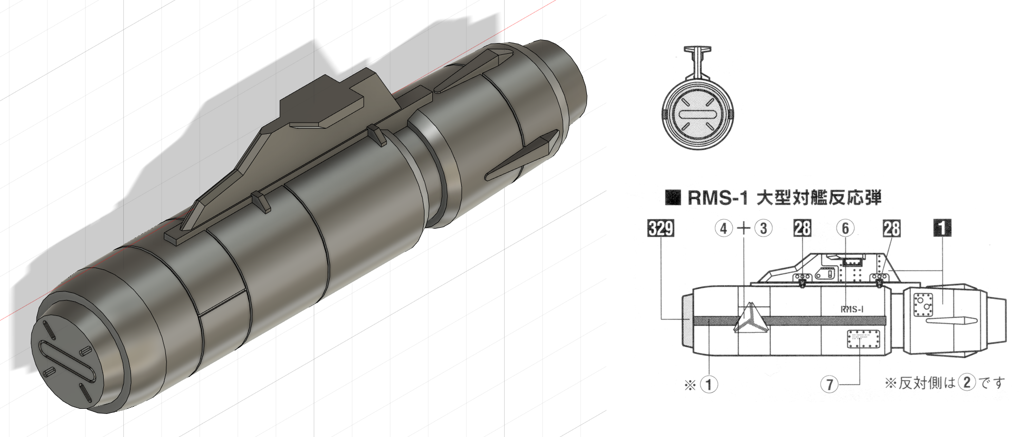

Anasazi37 Posted October 26, 2022 Posted October 26, 2022 Comparison of the old and new RMS-1 designs Quote

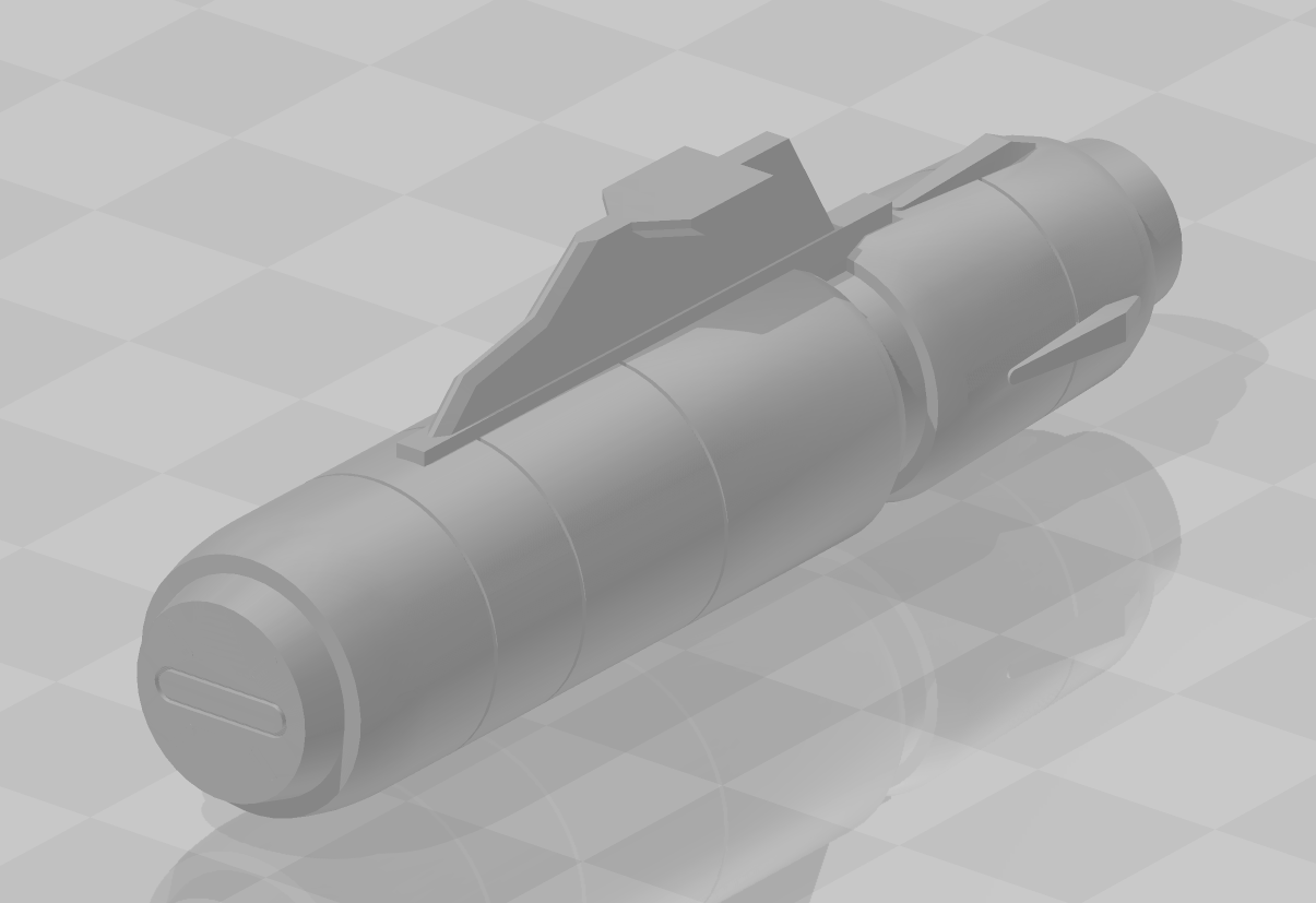

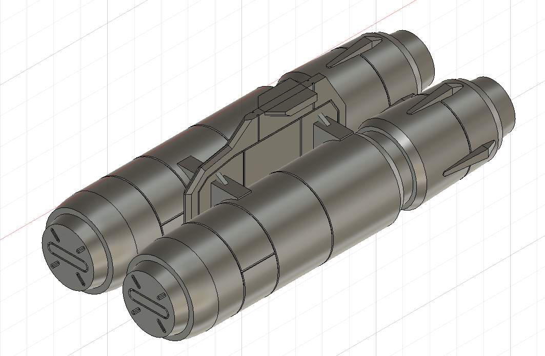

Anasazi37 Posted October 27, 2022 Posted October 27, 2022 The simplified version of the RMS-1 would look something like this: Quote

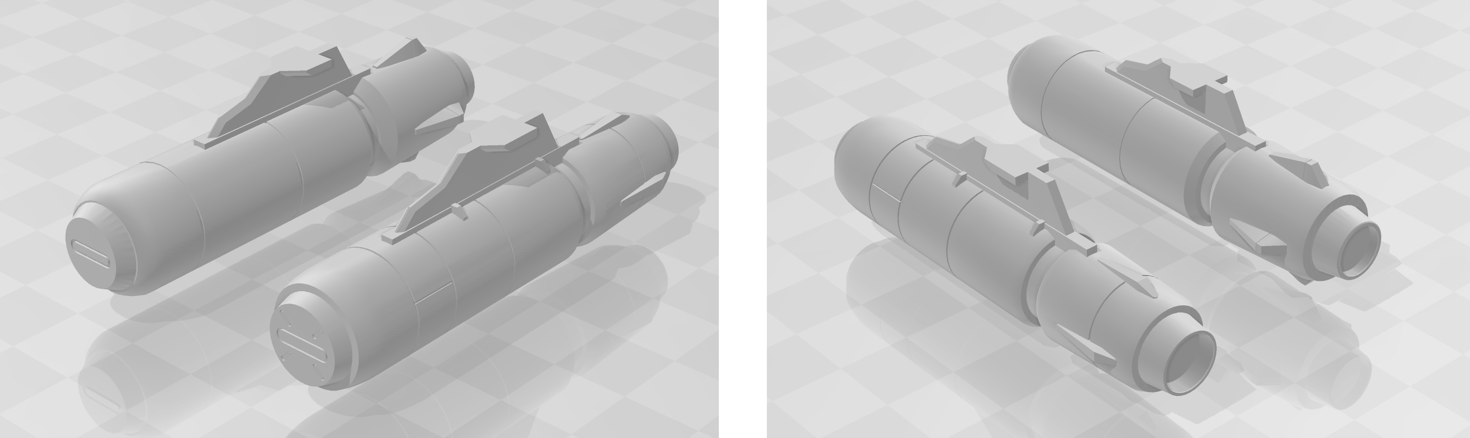

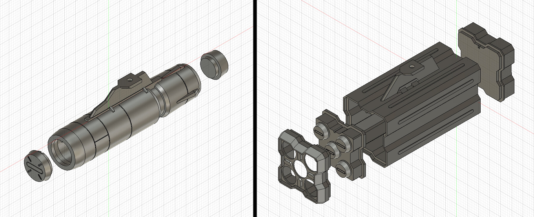

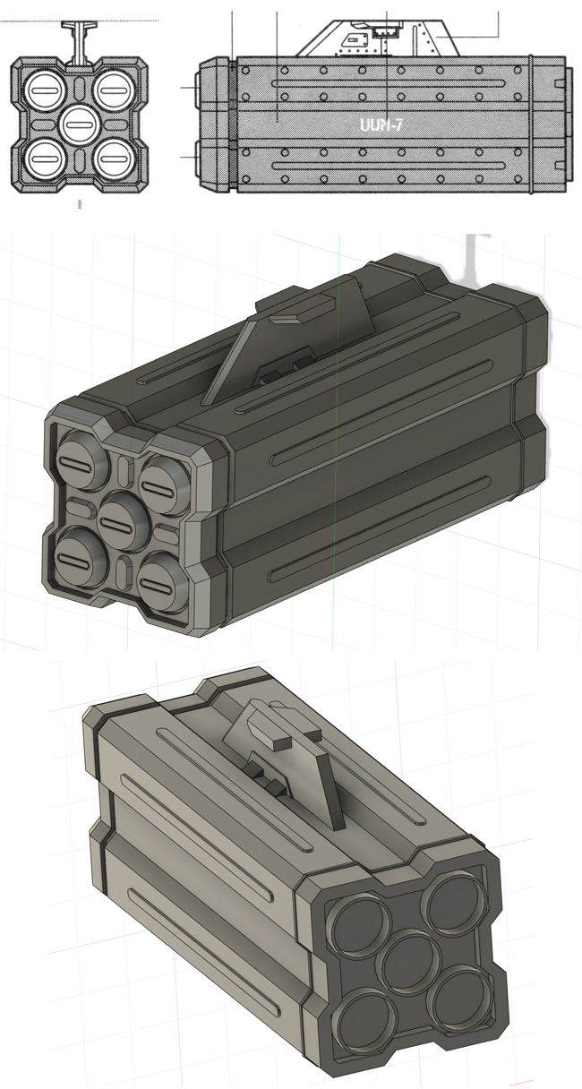

Anasazi37 Posted October 29, 2022 Posted October 29, 2022 Starting to get the hang of 3D modeling. Just completed the UUM-7, which was a lot more complicated to create than the RMS-1. Like the RMS-1, there will be two versions that have more or less detail. Quote

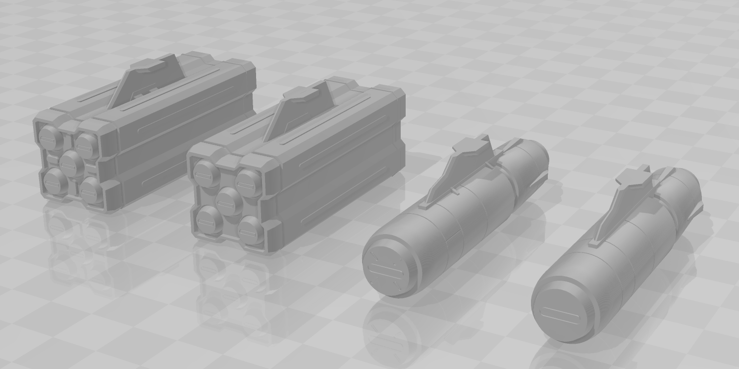

Anasazi37 Posted October 29, 2022 Posted October 29, 2022 Print-ready versions of each armament, with and without the extra details. Still tweaking some small things on the UUM-7, but otherwise I think these are ready to go. Quote

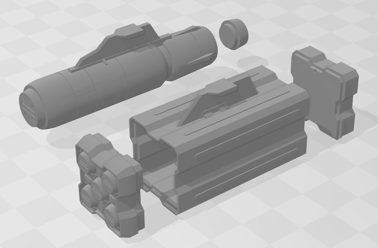

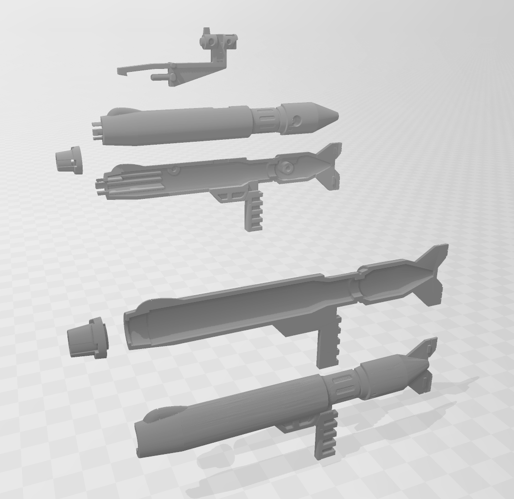

Anasazi37 Posted December 11, 2022 Posted December 11, 2022 (edited) Finally had some time to work on the armaments again. Ended up redoing them, but from the outside you wouldn't be able to tell the difference. Original versions were solid, meaning that after printing they'd be a bit heavy and could bend the wings. New versions are hollow and break down into multiple pieces for easy printing and assembly. I got a little smarter about 3D design over the past month. Edited December 11, 2022 by Anasazi37 Quote
nightmareB4macross Posted December 11, 2022 Posted December 11, 2022 7 hours ago, Anasazi37 said: Finally had some time to work on the armaments again. Ended up redoing them, but from the outside you wouldn't be able to tell the difference. Original versions were solid, meaning that after printing they'd be a bit heavy and could bend the wings. New versions are hollow and break down into multiple pieces for easy printing and assembly. I got a little smarter about 3D design over the past month. Nice work! Quote
Anasazi37 Posted December 11, 2022 Posted December 11, 2022 Appreciate the kind words. I've been inspired by the work of Robert James, who designs these truly incredible 3D-printable kits for a variety of starships--at really large sizes. Seeing how he breaks down all of the parts into components that are easy to print and fit together well is both impressive and humbling. https://cults3d.com/en/users/RobertJamesModels/creations After some additional tweaks this morning, I think the new designs are ready for a test print. I made the front section of the RMS-1 removable and also split the front section of the UUM-7 into two pieces so you can paint the missiles separate from everything else. Quote

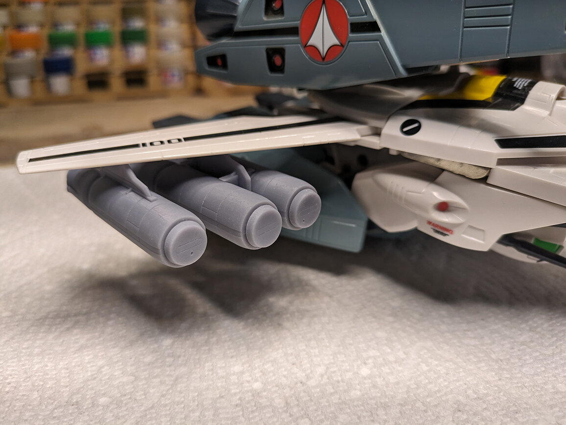

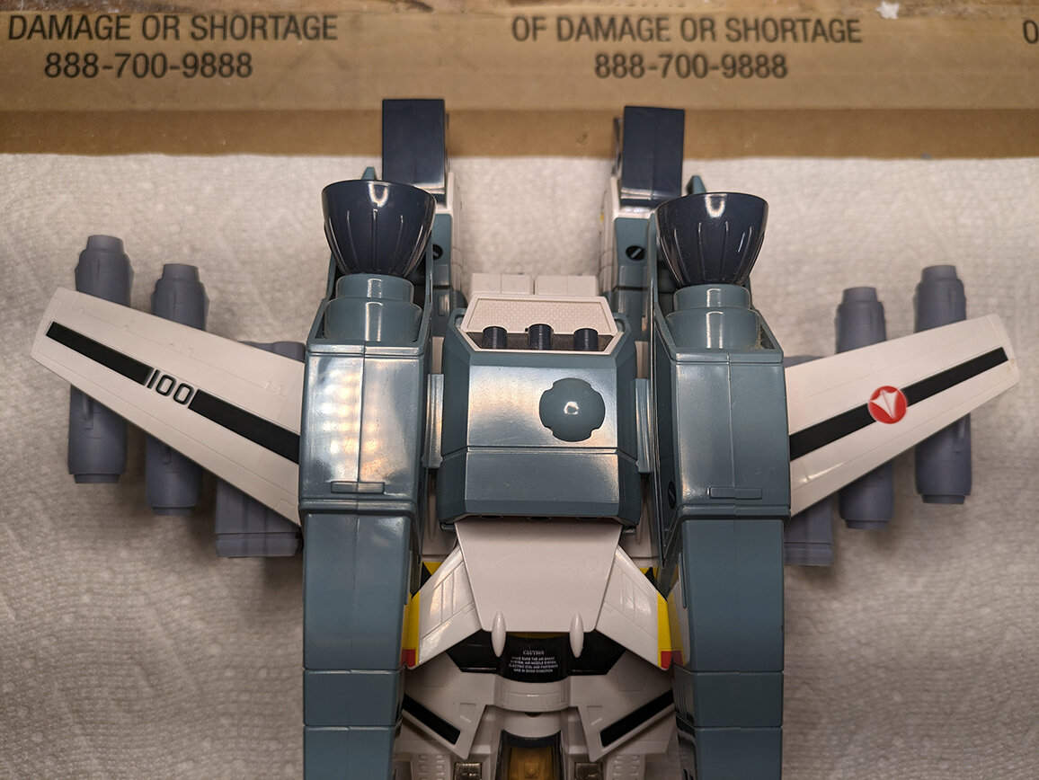

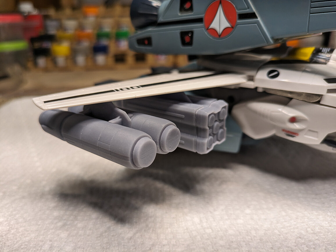

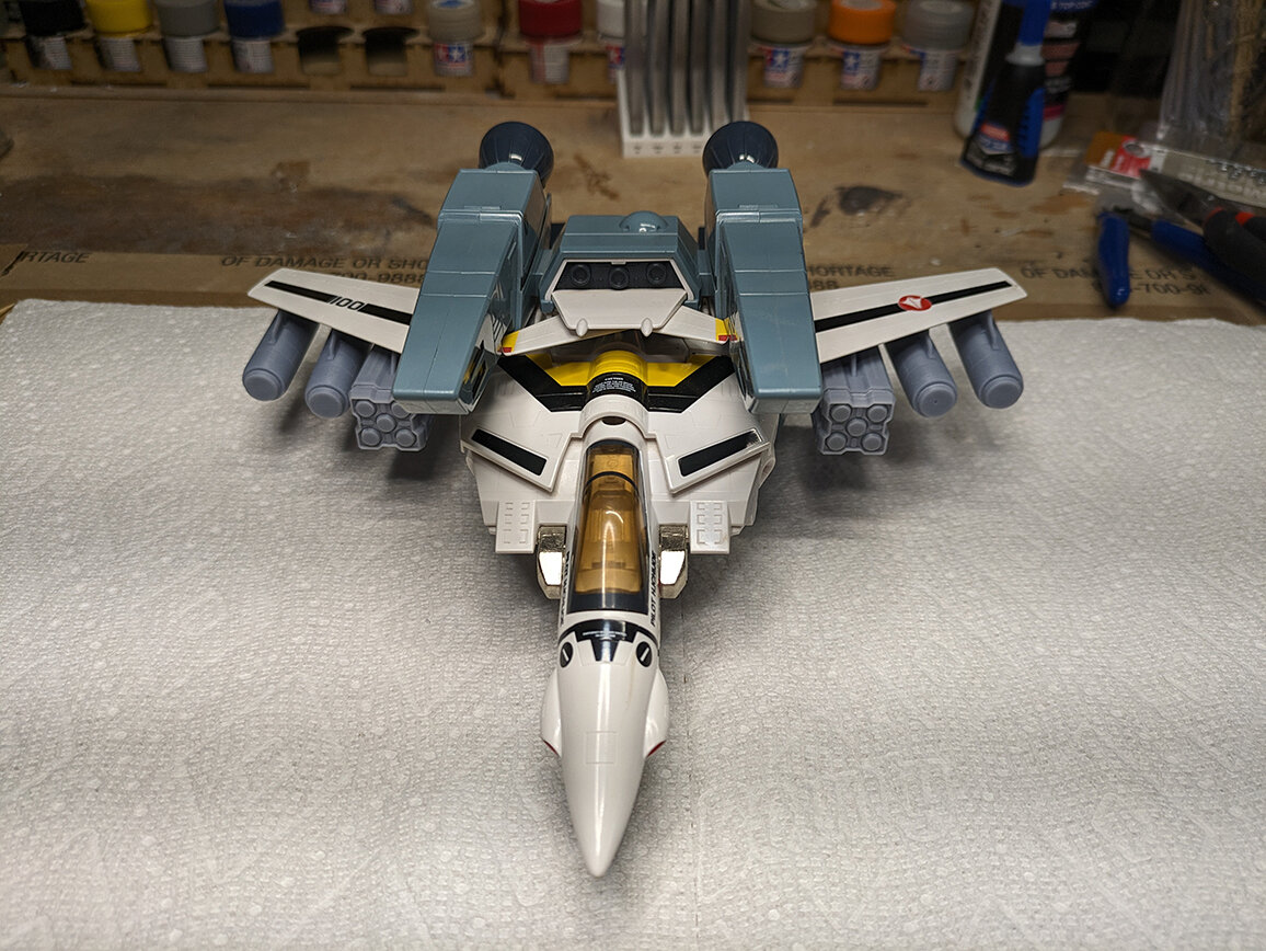

Anasazi37 Posted January 21, 2024 Posted January 21, 2024 It's been over a year since I started working on Hasegawa-style armaments for the 1/55 VF-1. I set the project aside for a long time, but picked it back up this past week. It's really coming together now. The armaments break down into multiple parts for easier printing, painting, and assembly. They are hollow so there isn't any strain on the wings from extra weight. They utilize tiny magnets for attachment (right now I'm using some blue tack for quick testing purposes). I'm also thinking about making a pylon to hold both RMS-1 missiles instead of having one for each. That would be more consistent with Yamato, Arcadia, and Bandai valks. Quote

nightmareB4macross Posted January 26, 2024 Posted January 26, 2024 Wow. Those look amazing. I will definitely be needed a set of these. Quote
Anasazi37 Posted January 26, 2024 Posted January 26, 2024 2 hours ago, nightmareB4macross said: Wow. Those look amazing. I will definitely be needed a set of these. And I'm currently working on a double-RMS pylon option, which is more consistent with the Yamato, Arcadia, and Bandai toy lines. Stay tuned! Quote

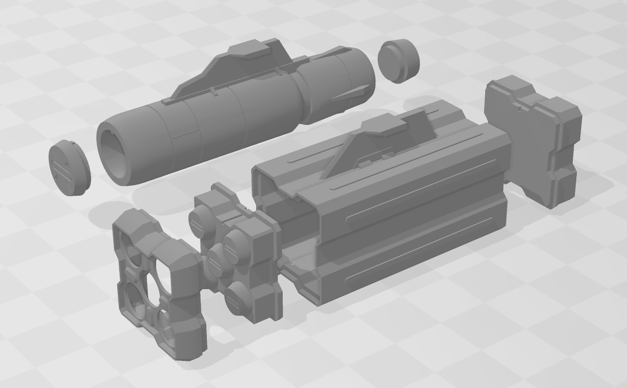

Anasazi37 Posted January 29, 2024 Posted January 29, 2024 Latest update. Added additional panel line details across the board, along with a very shallow channel on both sides of the RMS as a guide for painting the black stripes. Also made some internal improvement to help with printing and assembly. Quote
Anasazi37 Posted February 11, 2024 Posted February 11, 2024 Results of the latest test print. Panel line details came out well and the double RMS-1 pylon attachment system is working as designed. I'm not 100% happy with how the rear section of the UUM-7 is printing, though. Need to fix that before making the files available for purchase. Quote

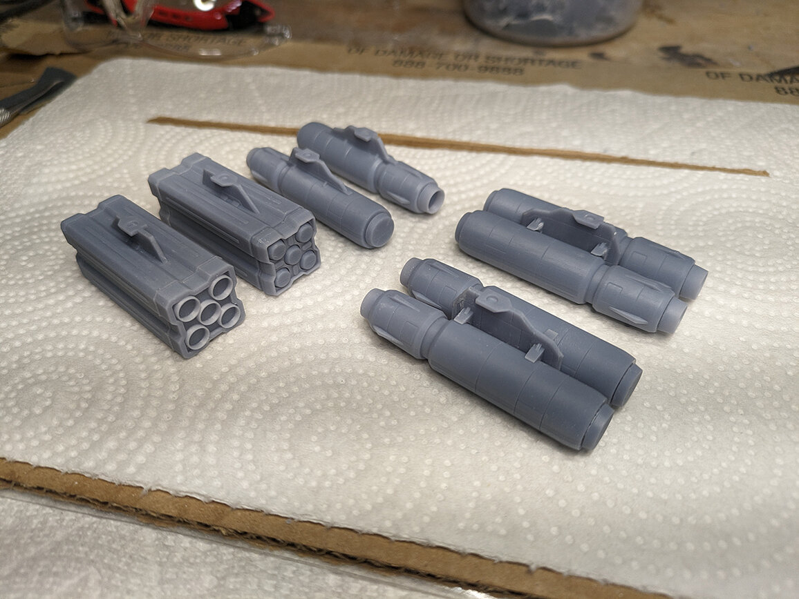

Anasazi37 Posted March 3, 2024 Posted March 3, 2024 (edited) Finally had a little time to wrap up the design work on the armament set, do a final test print, and upload everything to Cults 3D: https://cults3d.com/en/3d-model/art/weapon-armament-set-for-the-1-55-vf-1-armored-valkyrie @nightmareB4macross, let me know if you still want a set. I plan on printing and prepping a few of them for my own projects and thought you might want one for your museum (or a custom). Edited March 3, 2024 by Anasazi37 Quote
