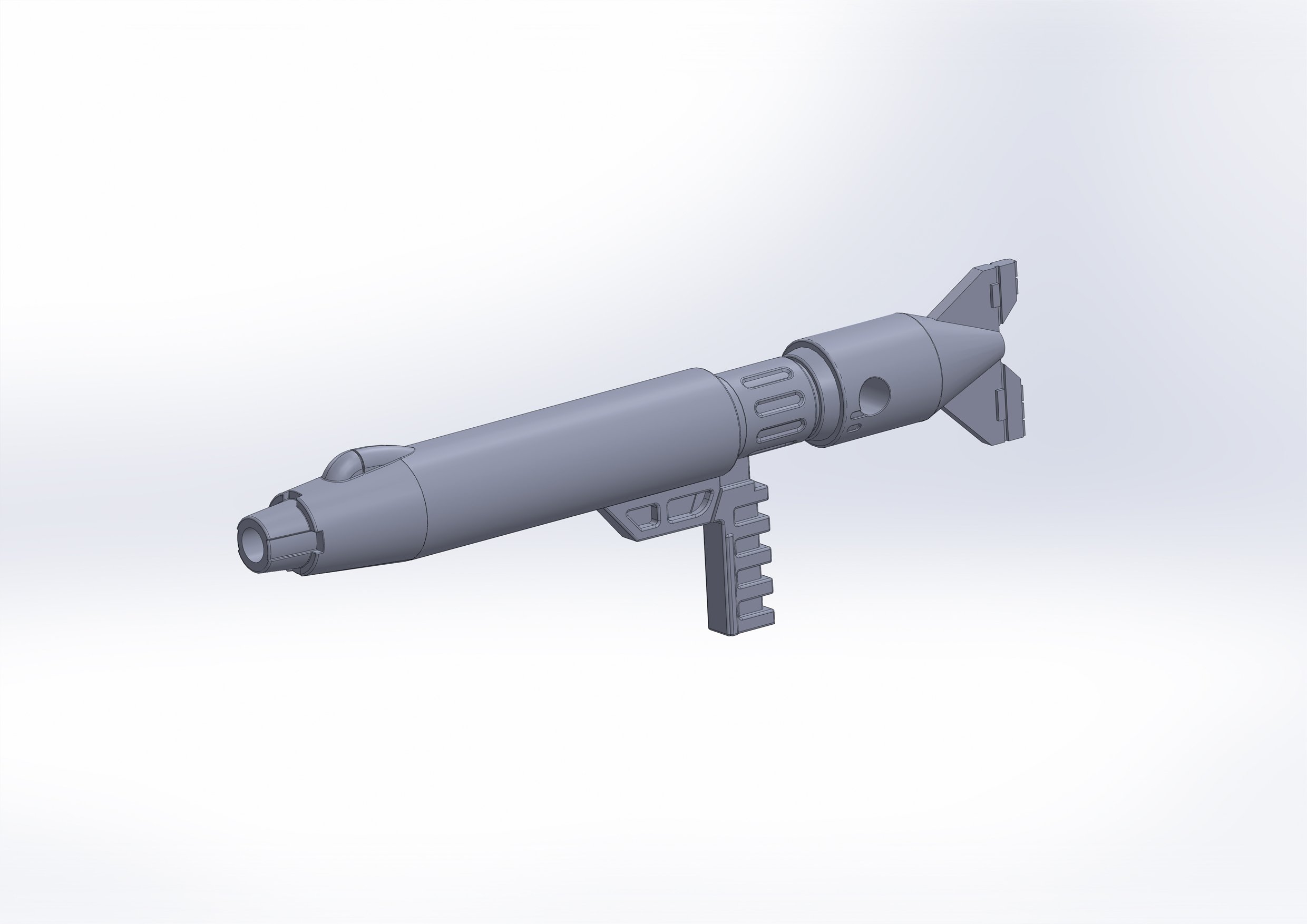

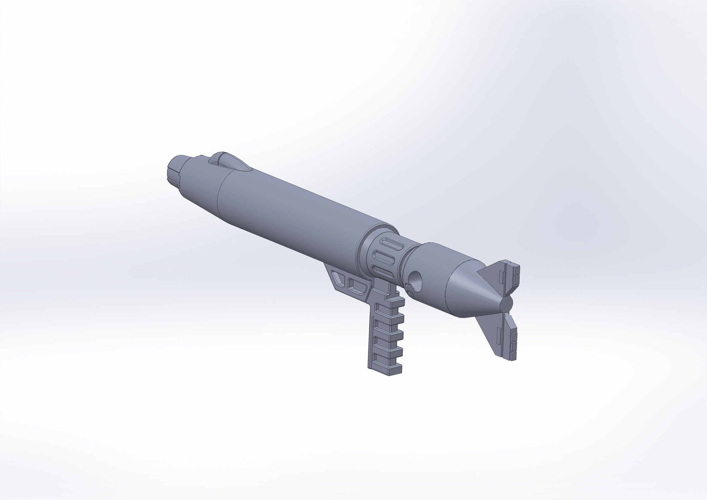

UN_MARINE Posted December 25, 2019 Posted December 25, 2019 Here's what "pretty darn close" looks like. Next step will be to split up the model + the missile gimmick (except for the spring). What do you guys think? Quote
Mazinger Posted December 25, 2019 Posted December 25, 2019 2 hours ago, UN_MARINE said: Here's what "pretty darn close" looks like. Next step will be to split up the model + the missile gimmick (except for the spring). What do you guys think? Very nice indeed. Those of us how first got out VF-1's as Jetfire never had the spring-loaded shooter guns, so to me, that model looks done. Quote

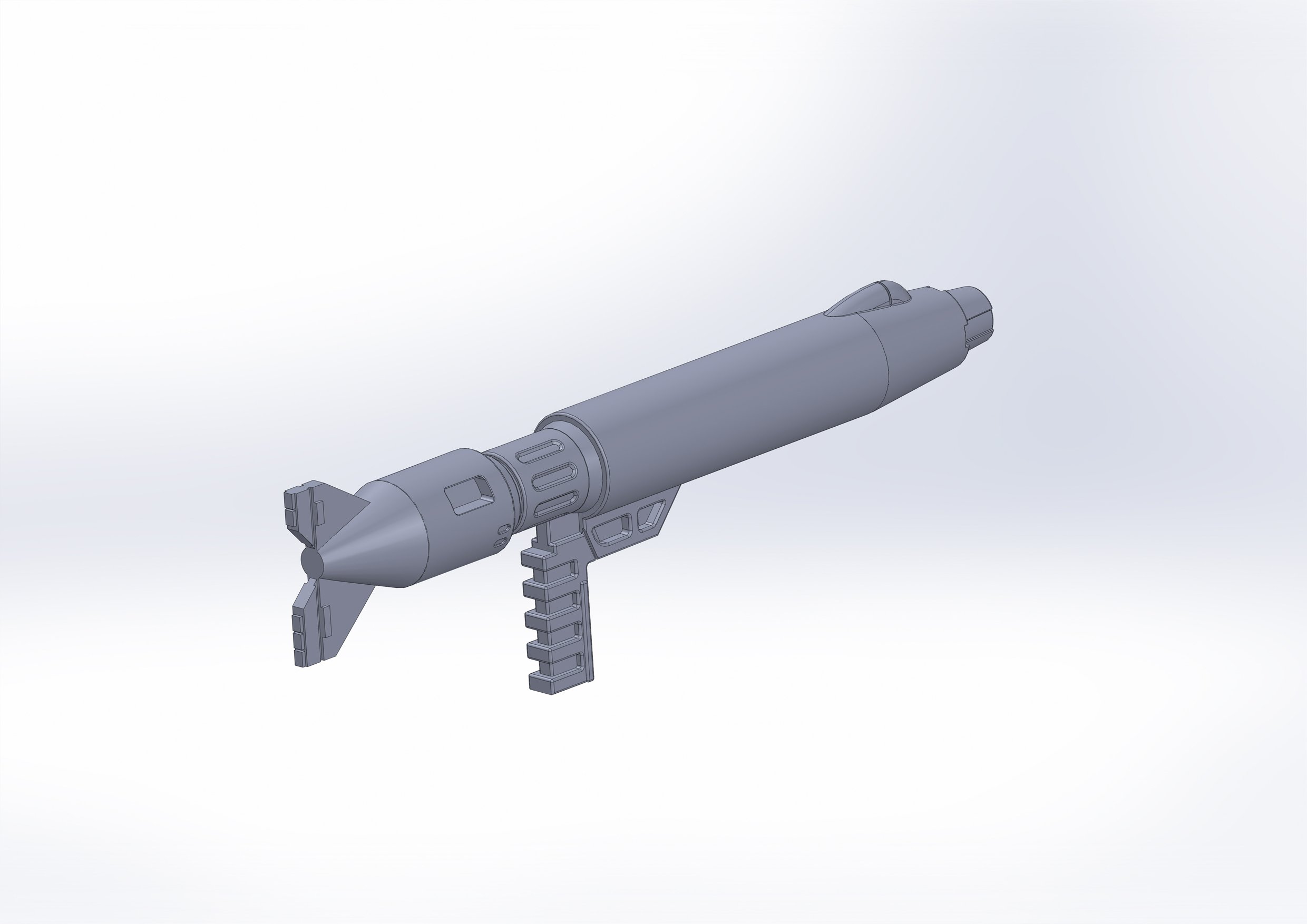

UN_MARINE Posted December 25, 2019 Posted December 25, 2019 Anybody willing to do some test printing? 1/55 GU-11 Beta All it's missing is the spring, and the screw. (I'll get to the missiles eventually) 2 hours ago, Mazinger said: Very nice indeed. Those of us how first got out VF-1's as Jetfire never had the spring-loaded shooter guns, so to me, that model looks done. Thanks! I suppose we have the option to make a "deactivated" version. Quote

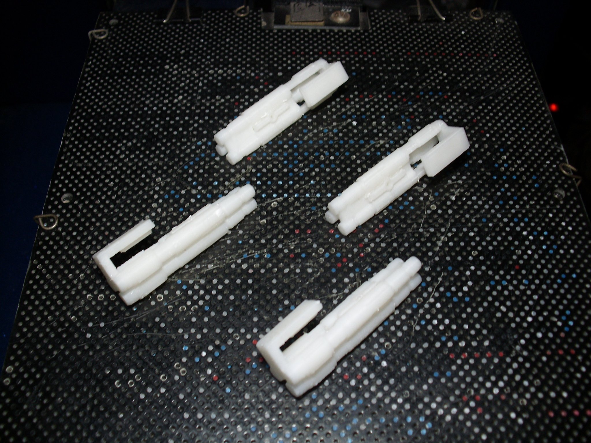

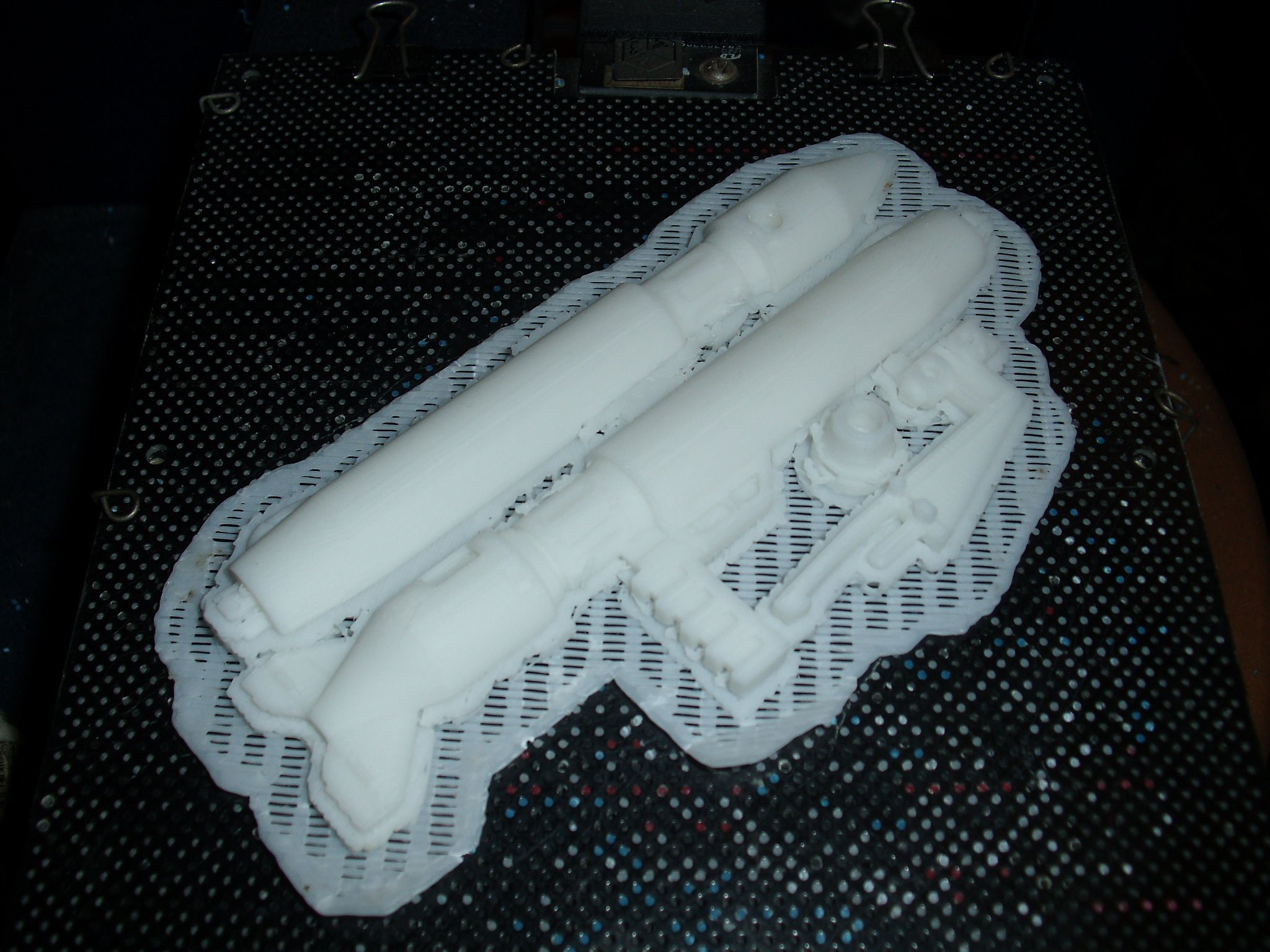

UN_MARINE Posted January 3, 2020 Posted January 3, 2020 Looks like I'll need to adjust a few things to make it more durable for FDM printing, otherwise, it's a successful test print. The back end warped a little, I'm keeping it in place with a rubber band. Quote

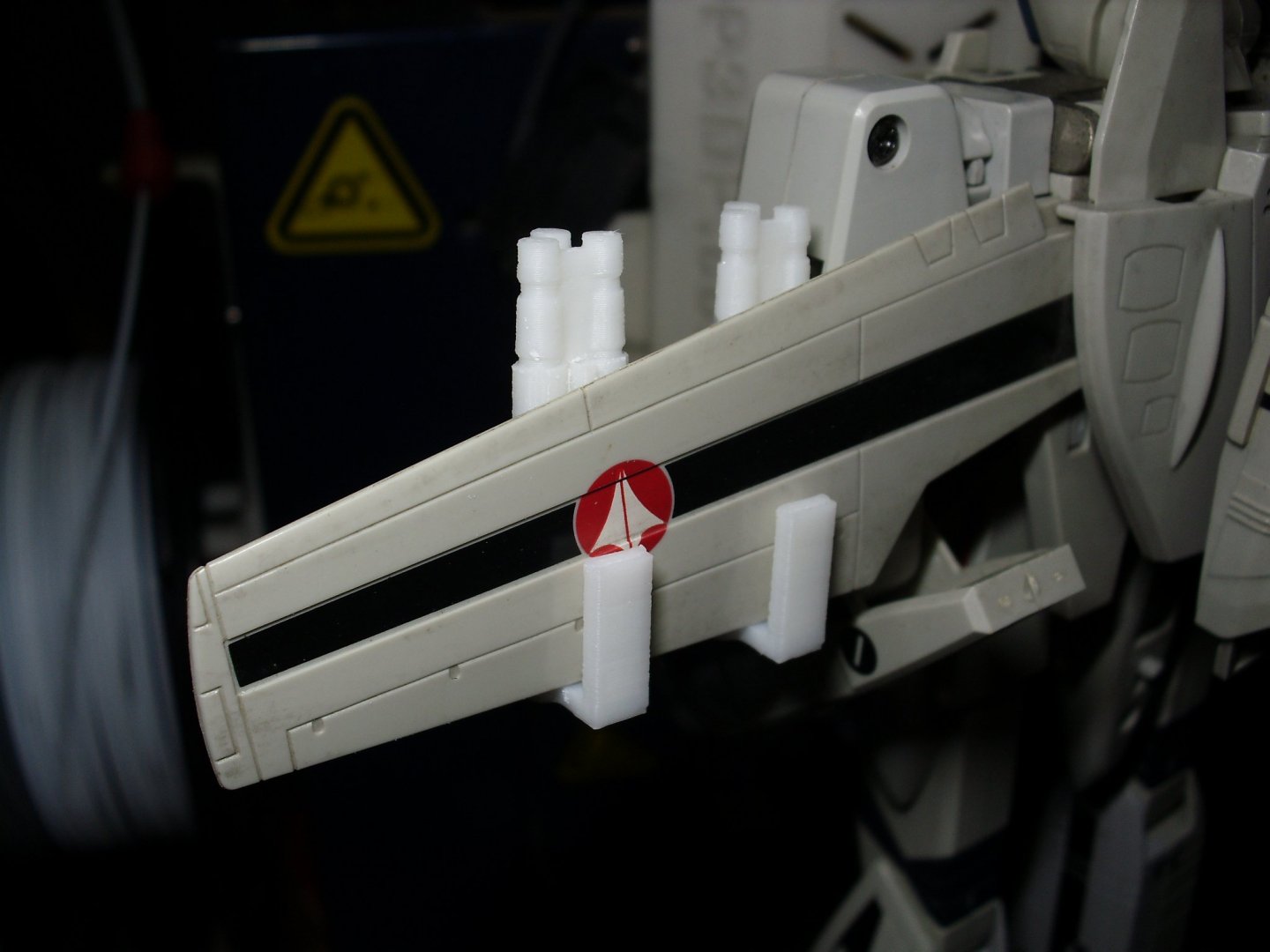

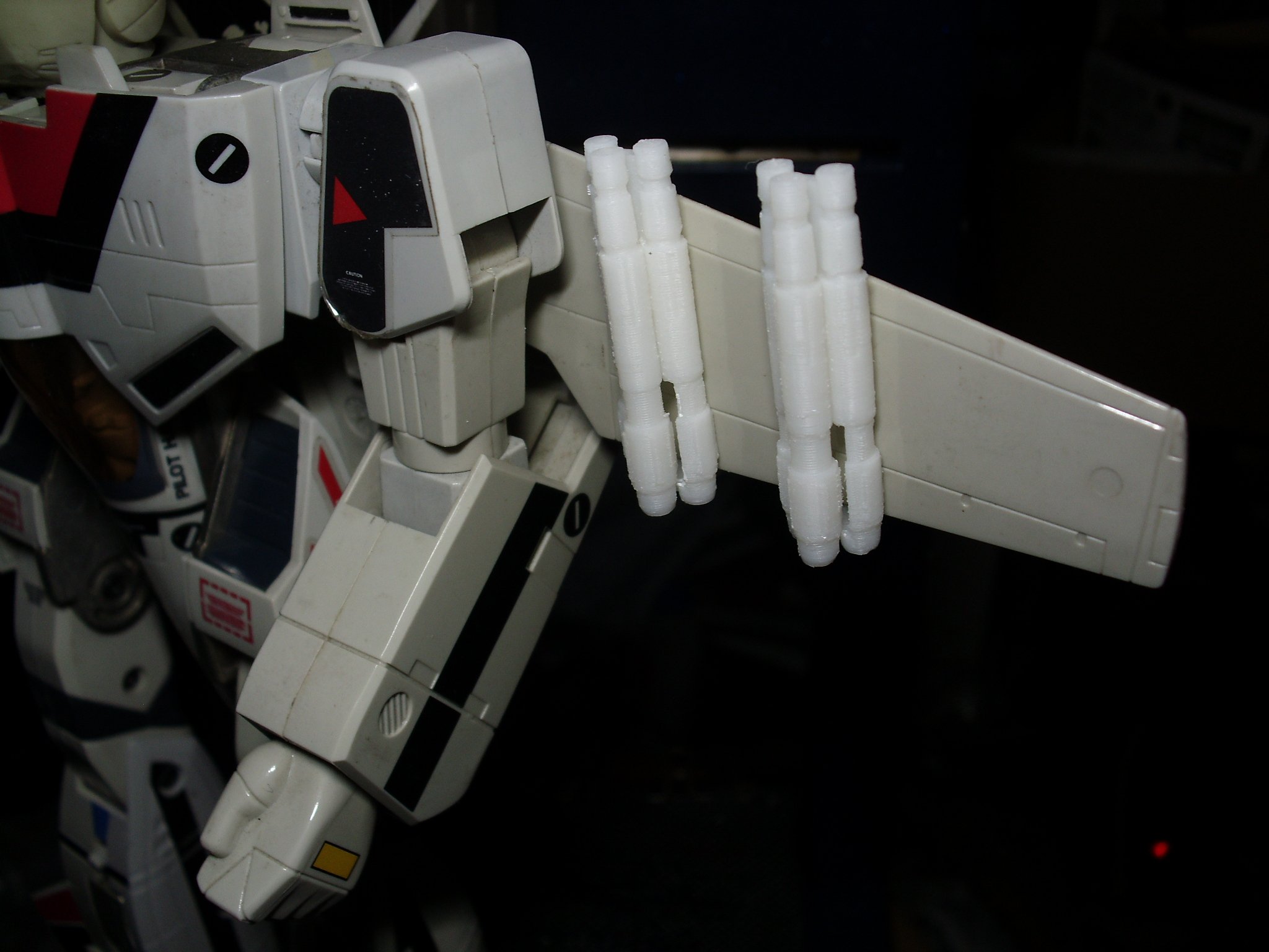

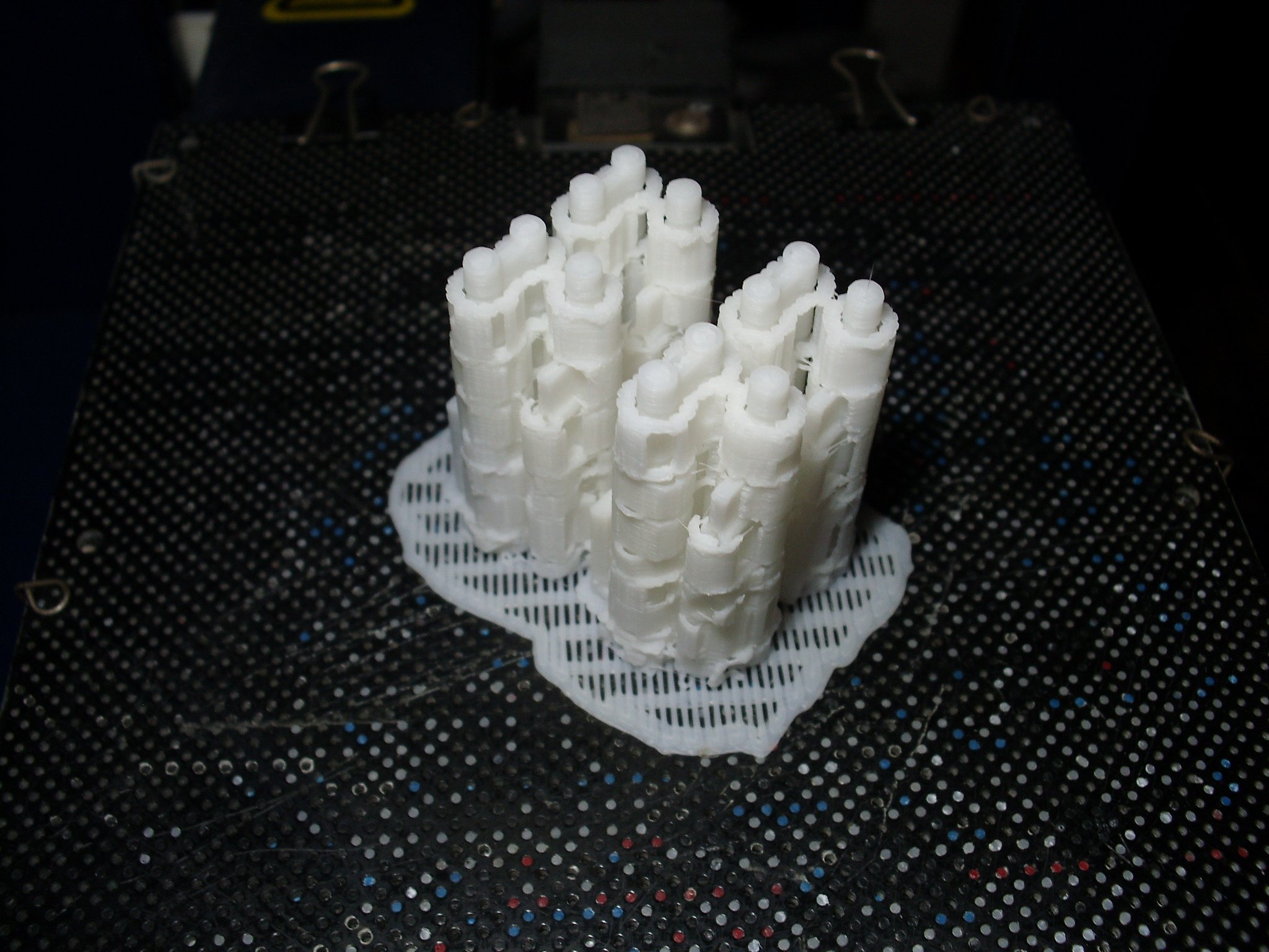

UN_MARINE Posted February 28, 2020 Posted February 28, 2020 Currently in development: ...no luck with Strike packs yet. Quote

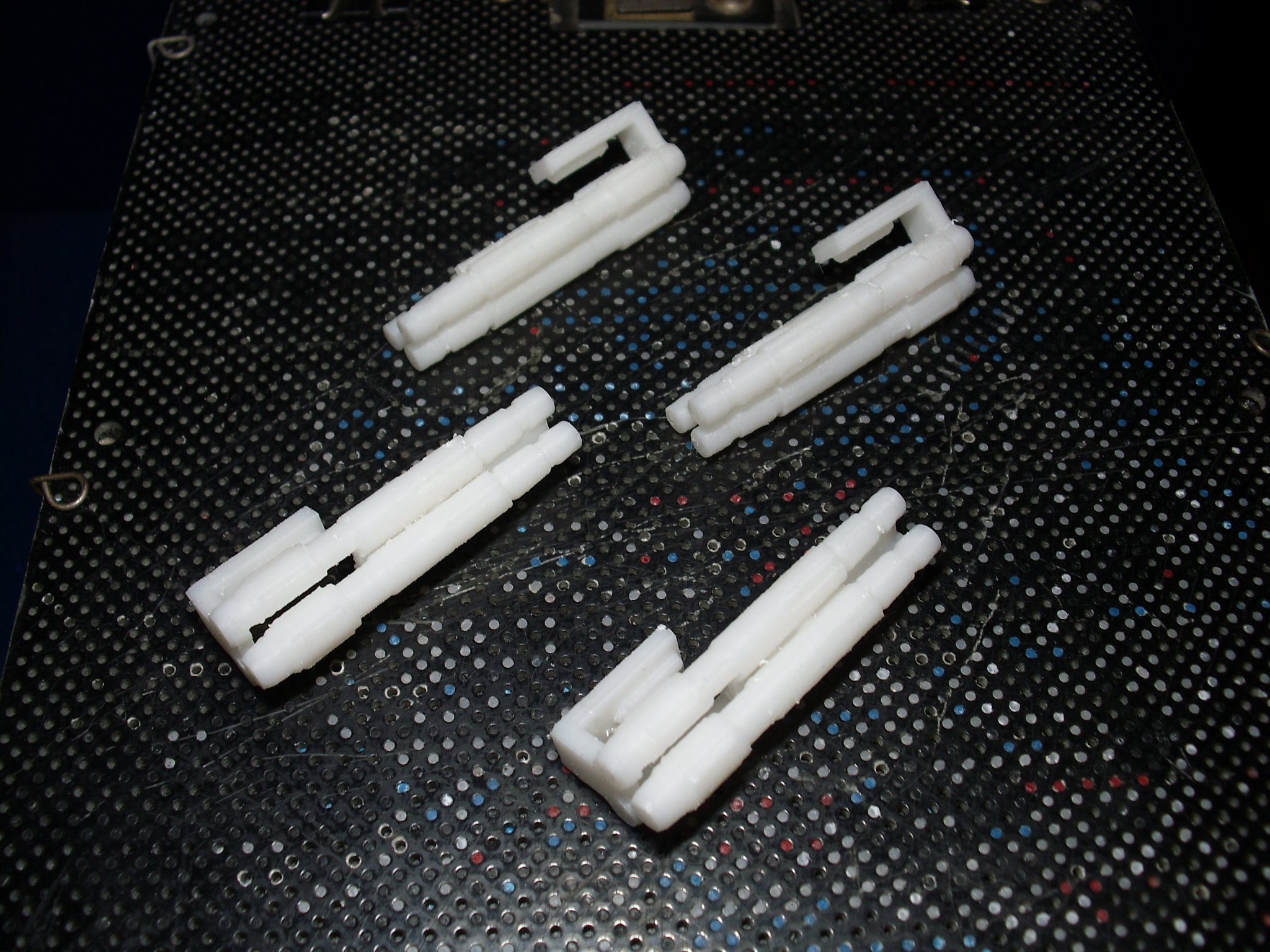

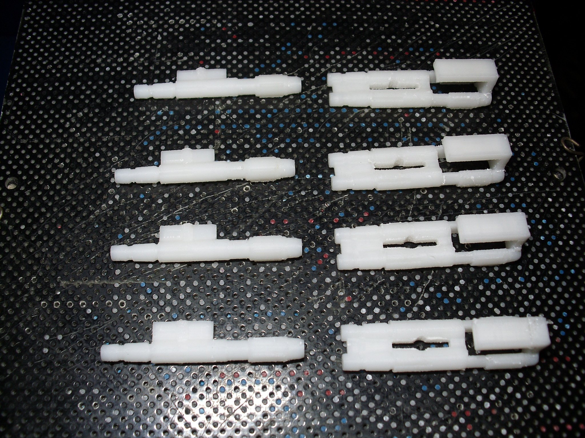

UN_MARINE Posted March 3, 2020 Posted March 3, 2020 Just printed out a test batch. I think the clips are a bit loose, I might need to tighten the gap a bit. Quote
UN_MARINE Posted March 4, 2020 Posted March 4, 2020 On 3/4/2020 at 12:52 AM, Mazinger said: Very nice @UN_MARINE! Thanks! I'll upload the files as soon as the final adjustments are done. Quote
F18LEGIOSS Posted March 5, 2020 Posted March 5, 2020 On 2/28/2020 at 11:02 AM, UN_MARINE said: Currently in development: ...no luck with Strike packs yet. You could use 4/6mm diameter*0,5mm neodyme magnets for the missiles. I'm working on my 1/55 VF 1A too . ( Have you tried to sand and polish the landing gears? They look nicer after a little bit of work ) Quote
UN_MARINE Posted March 5, 2020 Posted March 5, 2020 6 hours ago, F18LEGIOSS said: You could use 4/6mm diameter*0,5mm neodyme magnets for the missiles. I'm working on my 1/55 VF 1A too . ( Have you tried to sand and polish the landing gears? They look nicer after a little bit of work ) We're trying to keep it close to the originals, and without modification - it's pretty much a restoration project. Haha yeah... I need to give my Valk a proper cleaning. Eventually. (I'm actually amazed at how much these diecast parts oxidize.) Quote

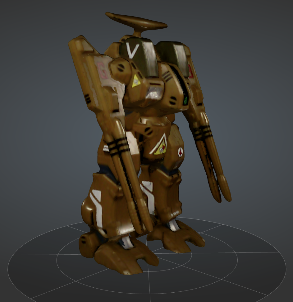

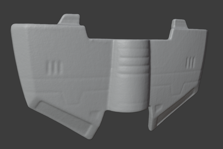

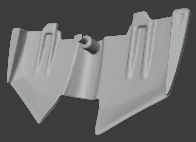

Anasazi37 Posted October 31, 2020 Posted October 31, 2020 On 10/24/2020 at 12:05 PM, mech9T8 said: I may get access to a scanner. If I do I’ll see what kind of model I can get. I picked up a structured light scanner recently. Has accuracy down to 0.1mm. Still trying to get everything dialed in, but here are the results of a quick test scan with the chestplate from a Jetfire. It's a fairly complex part with lots of panel lines, curves, sharp corners, and angles. Not too shabby. Should be able to improve the quality with additional time investment, additional scans, and more advanced data processing. And I'm not terribly concerned about crisp panel lines. I can always use a scriber to make them more clear on a printed version. Quote
Anasazi37 Posted October 31, 2020 Posted October 31, 2020 Dropped my HMR Destroid Defender on the turntable, with the camera enabled, to see what would happen. One scan only, so not a huge amount of detail, but still encouraging. Quote
jenius Posted October 31, 2020 Posted October 31, 2020 This is amazingly promising for lots of projects... I'm still waiting to make the 3d printing jump but looking forward too it more and more. Quote
