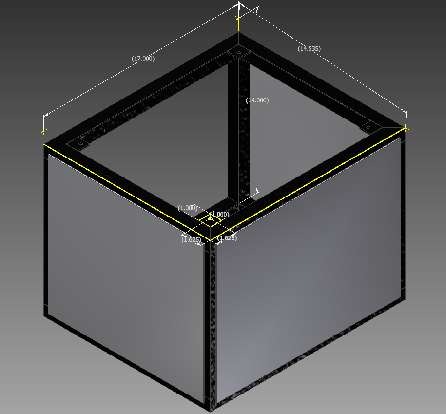

sqidd Posted October 6, 2019 Posted October 6, 2019 I couldn't think of where to post this that would get as many eyeballs as it needs to become a thing. Hopefully it's a non issue. @Rogueload showed me some pics of some Detolf bases available on feeBay but all decked out in Transformers logo's. I said that was interesting timing because I was planning on doing some for the couple of Detolf's I have (just got). I can sub-contract this stuff to vendors I already use for production stuff (my business). I'm designing them, but I'll farm the work out. I don't have the time to do this sort of thing anymore (which kinda sucks). Anyway, set up my first Detolf's last night and based on their shortcomings threw some quick drawings together to send over to a vendor for a quote. -Steel black powdercoated frame with brushed aluminum panels which would be riveted on. The panels could be just about anything though. This is just what I want. They could be done with a certain logo on them....... They could be back lit. -Adjustable feet -Frame anchors to the Detolf using the pre existing holes for the standard Detolf feet. If there is enough interest in something like this and the cost is right they would be easy enough to mass produce for board members. I'm not looking to get rich off of something like this. Just an opportunity to give back to the community. Frankly, I shouldn't even be offering. I'm back logged 2+yrs right now. But this should be pretty easy. I think I can subcontract everything right down to boxing them for shipping. Thought I would throw this out there to gauge interest, cultivate ideas, etc. Quote
Slave IV Posted October 6, 2019 Posted October 6, 2019 OK, I saw your response in the other thread and looking at this now, I have some ideas. It's just a frame and you say the panels could be anything. I would be in to just buy the frame and I would use something else for the panels. Probably even something super cheap and easy like foam board for three sides and then get on acrylic panel for the front. That should dramatically lower price and even shipping if I could assemble the frame from the parts. Quote
Slave IV Posted October 6, 2019 Posted October 6, 2019 Lighting would be easy, line the inside with led strips. As for height, why does the 14” extend above the base to the yellow line? Either way, around 12” would be ok but if you could just make it a bit taller, that would be great. If not enough to use as display space, maybe it would be a good storage space for all the parts that can be used for the items on display in the case? Quote
sqidd Posted October 6, 2019 Author Posted October 6, 2019 1 minute ago, Slave IV said: OK, I saw your response in the other thread and looking at this now, I have some ideas. It's just a frame and you say the panels could be anything. I would be in to just buy the frame and I would use something else for the panels. Probably even something super cheap and easy like foam board for three sides and then get on acrylic panel for the front. That should dramatically lower price and even shipping if I could assemble the frame from the parts. Panel-less frames could be an option. The nice thing about the simplicity of the design that you already noticed is that those panels can be just about anything. The frame will ship as a solid unit though. It will be all welded together and then powdercoated. It won't change the shipping cost much at all. maybe $5. The dimensions aren't so big as to trigger UPS's "dimensional weight" charges. The cost difference between all the parts and a assembled unit will be negligible. And designing it so it could be bolted together and then producing it that way would be cost prohibitive. Yeah, I know that sounds backward, but I'm guessing that would be the case. I would explore both methods. I'm waiting back on my first quote. Everything will work outward based off of that. Quote
sqidd Posted October 6, 2019 Author Posted October 6, 2019 Just now, Slave IV said: Lighting would be easy, line the inside with led strips. As for height, why does the 14” extend above the base to the yellow line? Either way, around 12” would be ok but if you could just make it a bit taller, that would be great. If not enough to use as display space, maybe it would be a good storage space for all the parts that can be used for the items on display in the case? That's just how it looks when I pull the dimensions out in CAD. This is a rough sketch. I didn't want to sped a ton of time on it. I chose this height because it puts it even with my big shooter display cases. Making the base a different height is a couple keystrokes. Easy peasy. The whole things is easy peasy. Changes are no problem. This guy on the other hand (below). A bit more involved. And that is still really, really rough. There are about 100-200hrs worth of work to do still. Quote

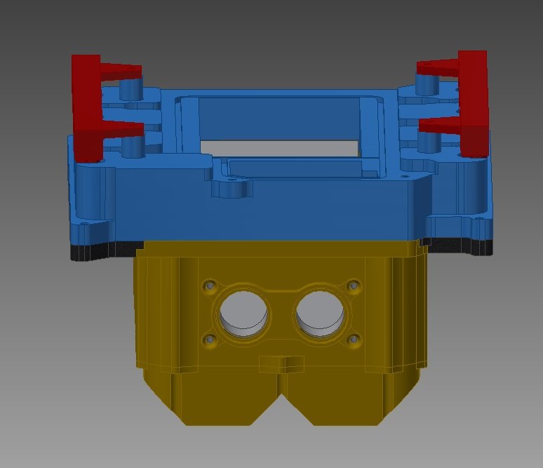

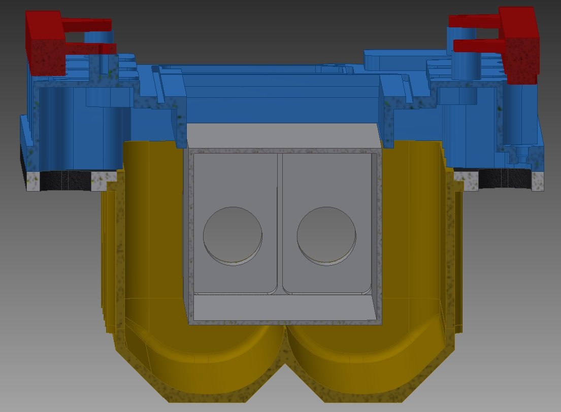

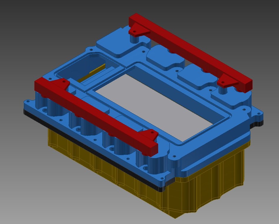

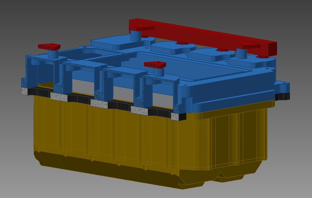

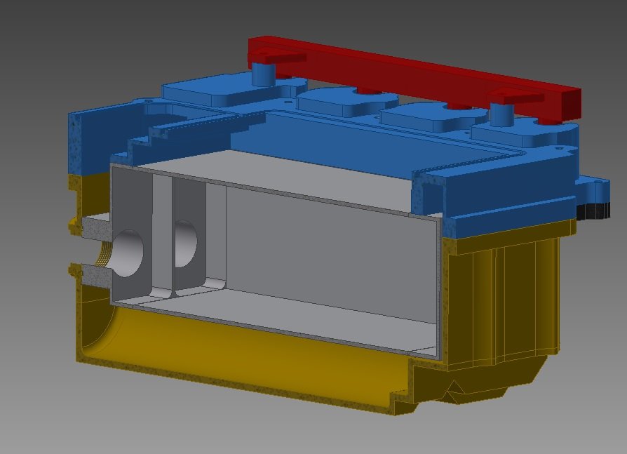

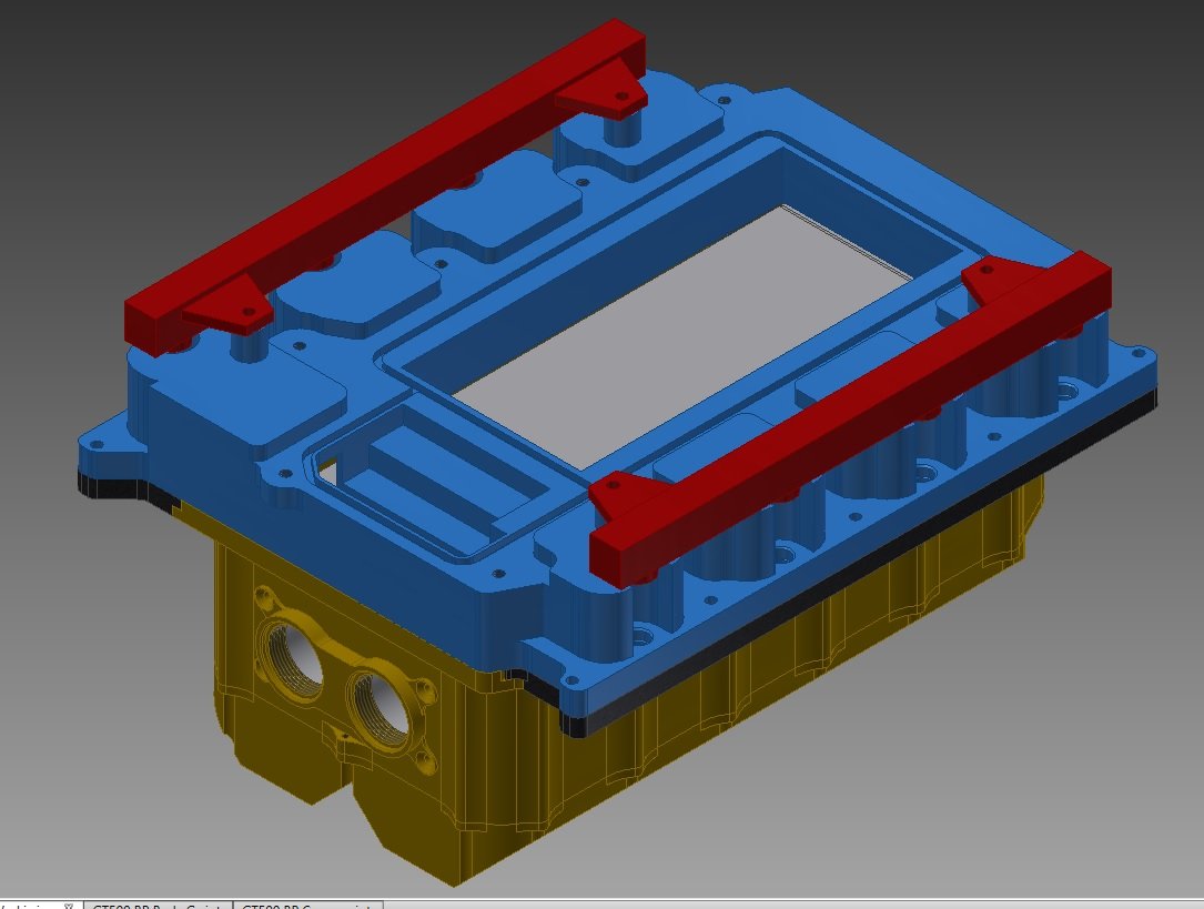

Slave IV Posted October 6, 2019 Posted October 6, 2019 Nice! Really cool to have those resources at your fingertips. Is that for a new fuel rail design? Quote
sumyumgoy Posted October 6, 2019 Posted October 6, 2019 Thanks for offering to do this @sqidd. Does that mean that the panels will be removable? Quote
sqidd Posted October 6, 2019 Author Posted October 6, 2019 3 minutes ago, Slave IV said: Nice! Really cool to have those resources at your fingertips. Is that for a new fuel rail design? Everything you're looking at is a new design. That's for 2007-2014 Ford GT500's and 2003-2005 Ford GT's (the Supercar). That is one seriously nasty piece. That's 15hrs in machine time! It's better than the OEM manifold/intercooler in every way by a huge margin. Because of the target market I was able to incorporate every trick I have without a lot of worry about cost. It's bee a fun project. Quote
Slave IV Posted October 6, 2019 Posted October 6, 2019 1 minute ago, sqidd said: Everything you're looking at is a new design. That's for 2007-2014 Ford GT500's and 2003-2005 Ford GT's (the Supercar). That is one seriously nasty piece. That's 15hrs in machine time! It's better than the OEM manifold/intercooler in every way by a huge margin. Because of the target market I was able to incorporate every trick I have without a lot of worry about cost. It's bee a fun project. Oh damn! Fun stuff! I need to start saving up for my turbo kit(s) in order to keep playing with the big boys out there! Quote
sqidd Posted October 6, 2019 Author Posted October 6, 2019 1 minute ago, sumyumgoy said: Thanks for offering to do this @sqidd. Does that mean that the panels will be removable? Worse case riveted on (which is still easy to remove). I would like to fasten them with some nice stainless button head socket cap screws. The cost of tapping all of those holes will determine in that's an option. Tapping a ton of 4mm holes in steel is very, very time consuming. Even in a CNC. And this is not a CNC type project. All of the parts will be cut by a CNC laser. Those won't thread holes. Quote
sqidd Posted October 6, 2019 Author Posted October 6, 2019 Just now, Slave IV said: Oh damn! Fun stuff! I need to start saving up for my turbo kit(s) in order to keep playing with the big boys out there! I have over 50 people waiting on that manifold. The least powerful car makes a 1000 at the tires. Quote
Slave IV Posted October 6, 2019 Posted October 6, 2019 10 minutes ago, sqidd said: I have over 50 people waiting on that manifold. The least powerful car makes a 1000 at the tires. Sweet! 1000 to just the rear sounds like a lot of tires gone! Quote
