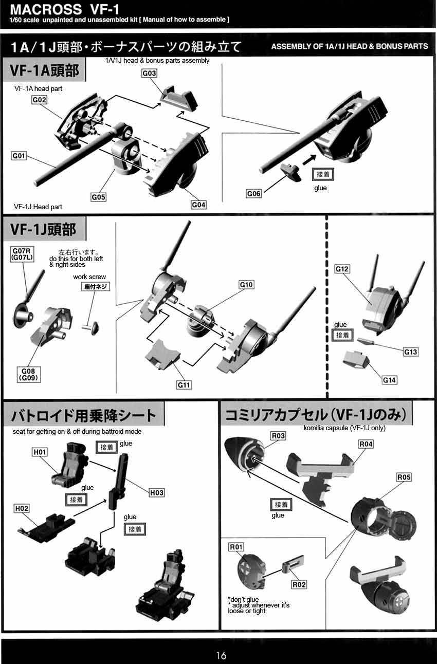

levzloi Posted October 6, 2019 Posted October 6, 2019 I'm trying to dissemble a VF-1J head for painting, and I was wondering if anyone had any experience with that. Can it be done without destroying the head, or should I resign myself to painting it assembled and living with it more or less fixed pose? I have the unassembled instructions, and it looks like it's pretty well glued together with no real clear seams to attack. Quote
william02 Posted October 6, 2019 Posted October 6, 2019 its heavily glued together. i dont recomend use force to break the glue. maybe some googone in the seams? i try some time ago with a vf-1s with no luck. but maybe you can find the manual to a seemble the "no paint" version to see where the parts get together. Quote
levzloi Posted October 6, 2019 Author Posted October 6, 2019 Yeah, I have the unassembled instructions courtesy of anymoon, but like you say it's pretty well glued together. maybe a brief soak in googone? Quote

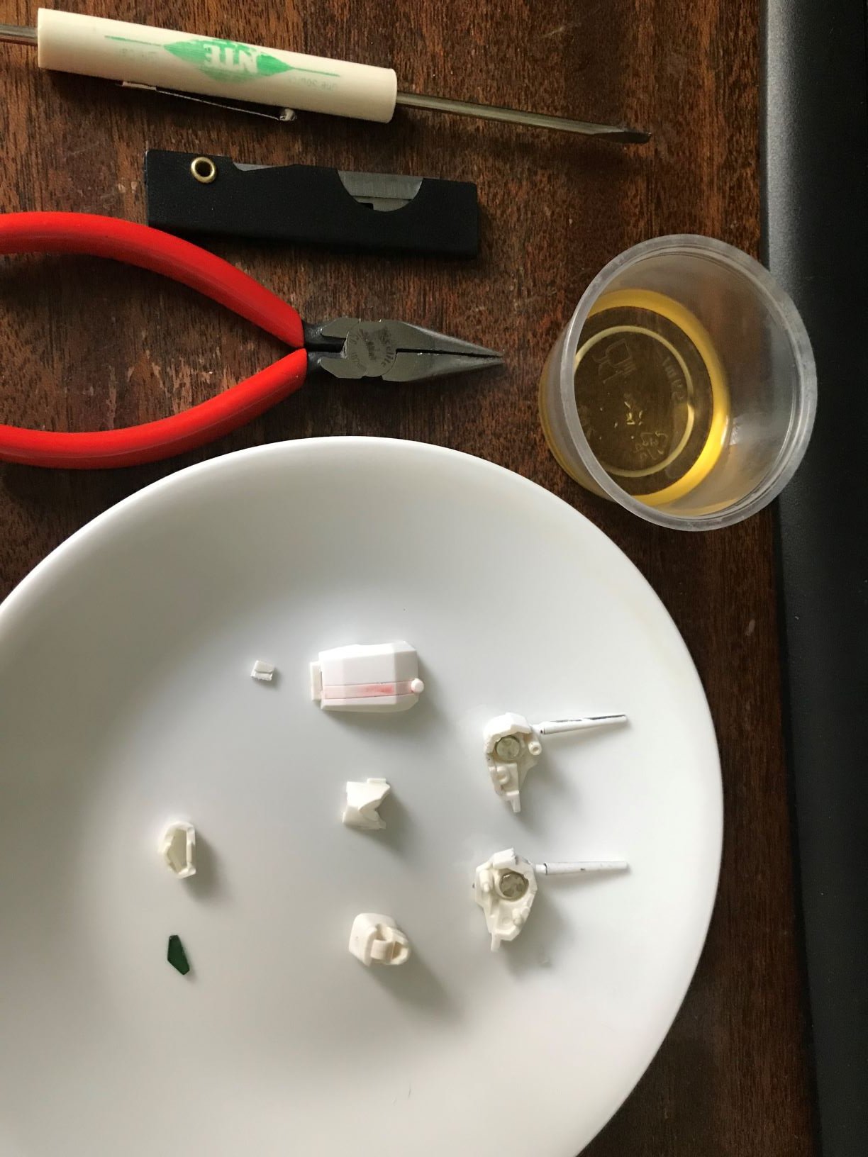

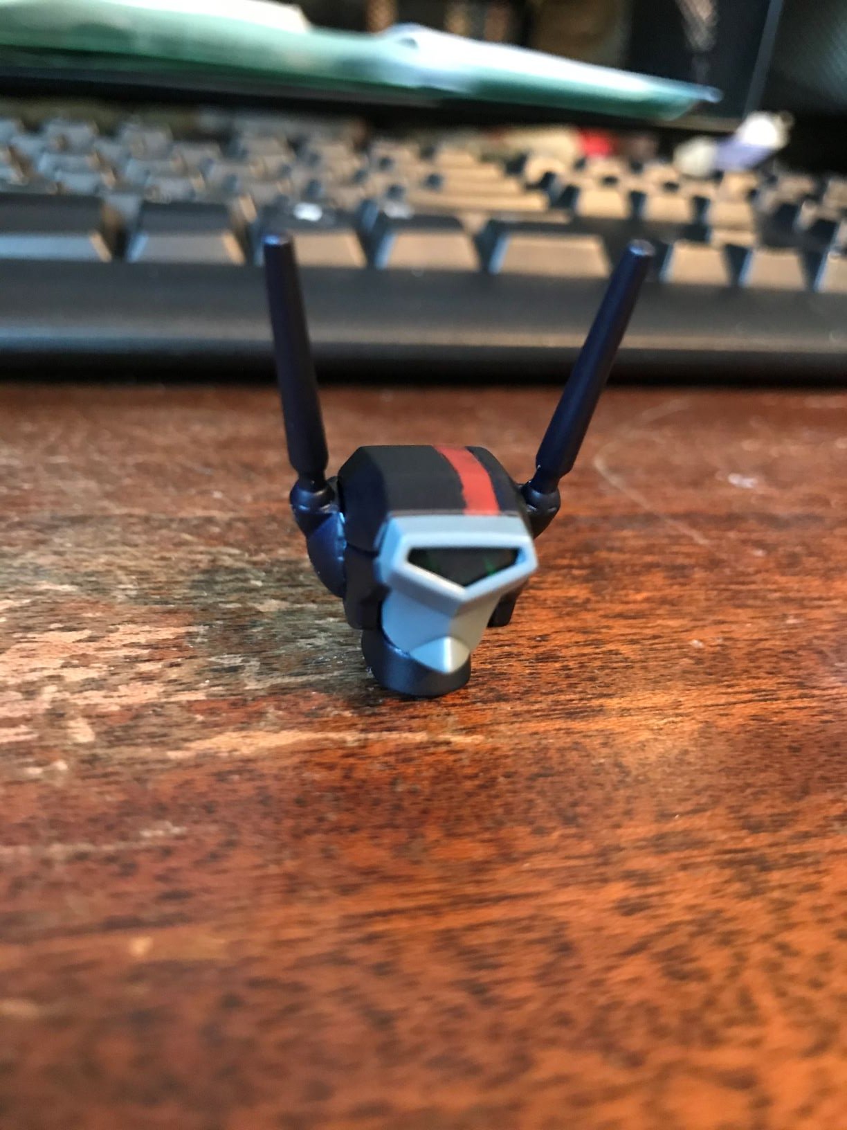

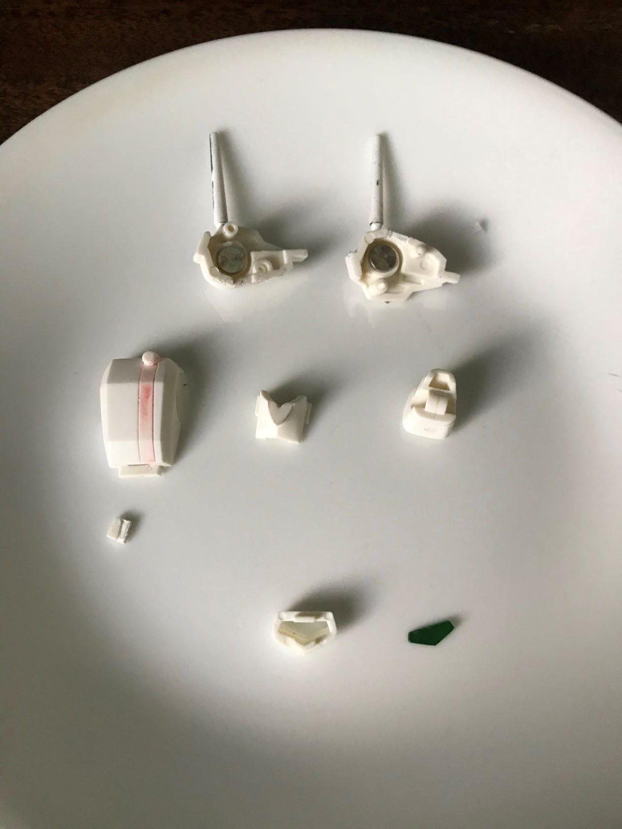

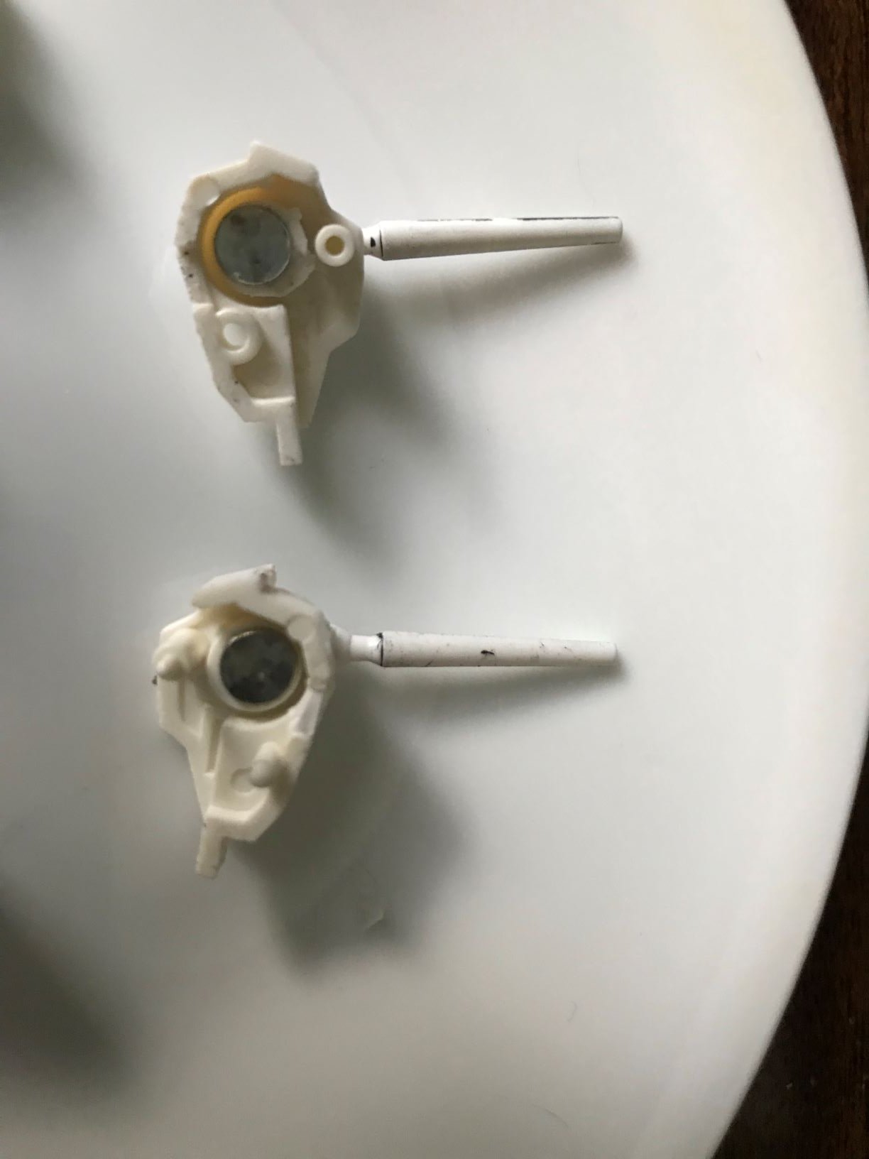

levzloi Posted July 1, 2020 Author Posted July 1, 2020 So I finally followed through on this, and I've included the results in the pictures below (instruction page courtesy of Anymoon.com). I was able to remove the front of the visor and the colored green plastic with just a razor blade and not much fuss. The rest required an overnight soak in GooGone. As you can see it also did a reasonable job softening up the paint for me and I was able to wipe most of it off. Using a razor blade and small screwdriver to attack the joints I was able to carefully pry off the head cap, and then it was easy to split the other pieces. Where I am now, is trying to get the screws/pegs off of the head lasers. Has anyone done this before or assembled the kit? They don't seem to be unscrewing when I use the pliers to twist them, are they just glued metal pegs? Would another GooGone bath do the trick? Quote
levzloi Posted July 2, 2020 Author Posted July 2, 2020 (edited) Turns out the "screws" are metal pegs with anchoring grooves, they will come out if you slowly and gently pry them up with a small screw driver while turning the laser in a circle. So deconstructing a Yamato VF-1J head can be accomplished. When I'm finished I'll have to post pictures of my finished custom VF-1J Cavaliers. Edited July 2, 2020 by levzloi Quote

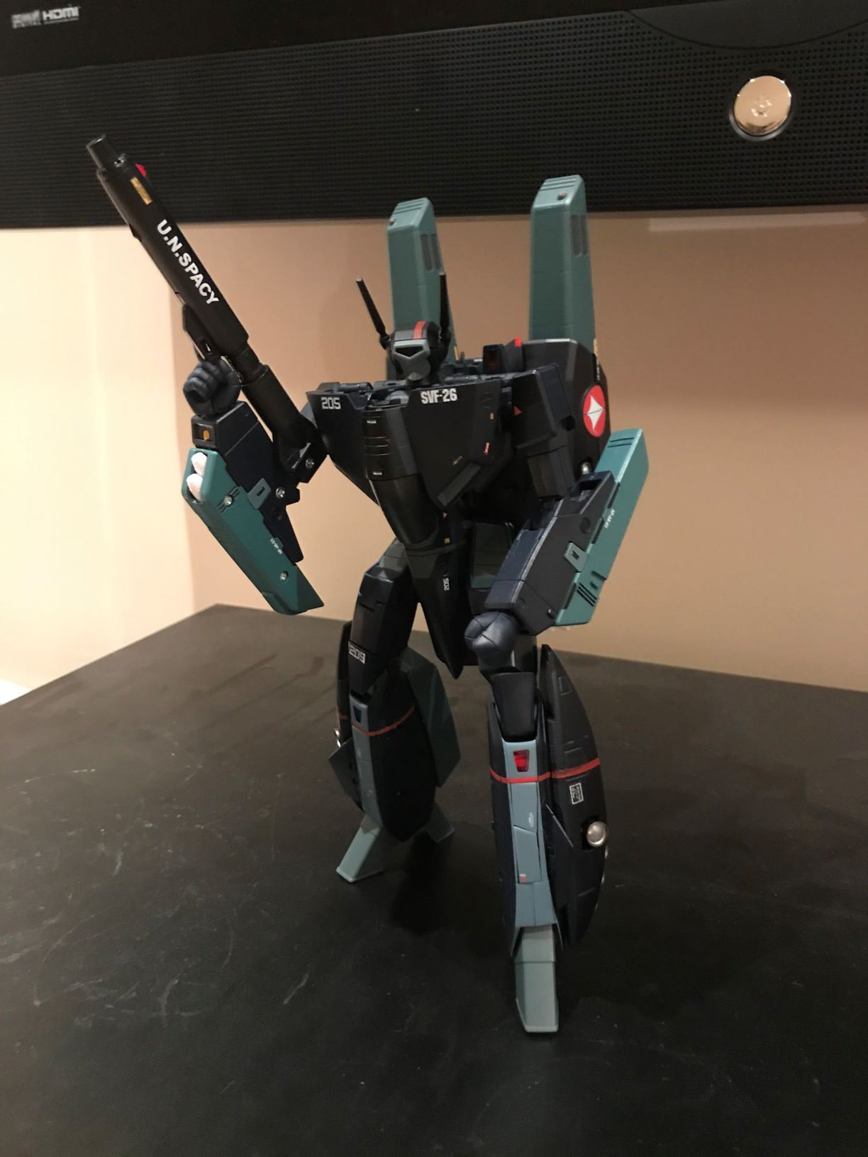

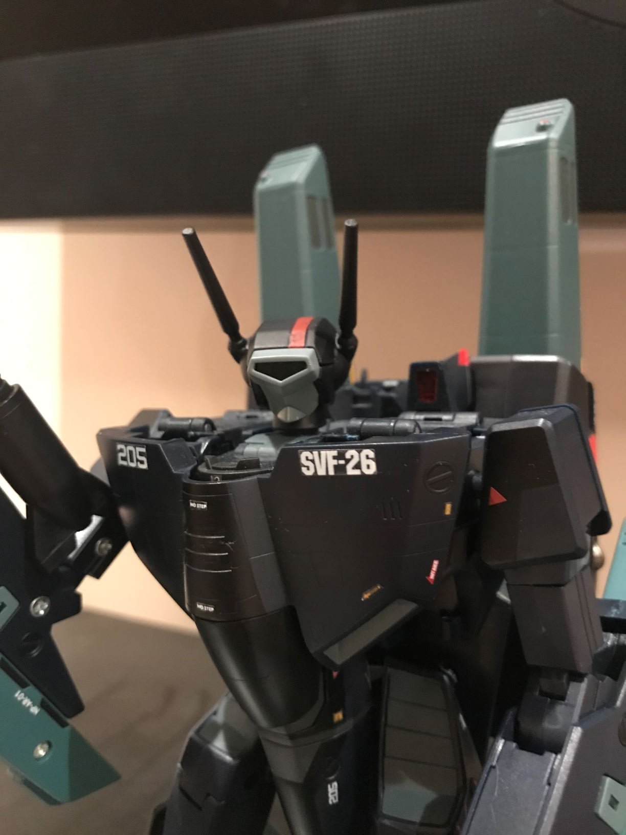

levzloi Posted July 18, 2020 Author Posted July 18, 2020 (edited) Well here you go, not a perfect result, but looks pretty %$&*ing cool in my book. Thanks for everybody's input! Edited July 18, 2020 by levzloi Quote
valhary Posted July 18, 2020 Posted July 18, 2020 WOW!!!!! Looks so much better than the "A" version Quote
levzloi Posted July 18, 2020 Author Posted July 18, 2020 Yeah the grey and red really make it stand out more. Quote
