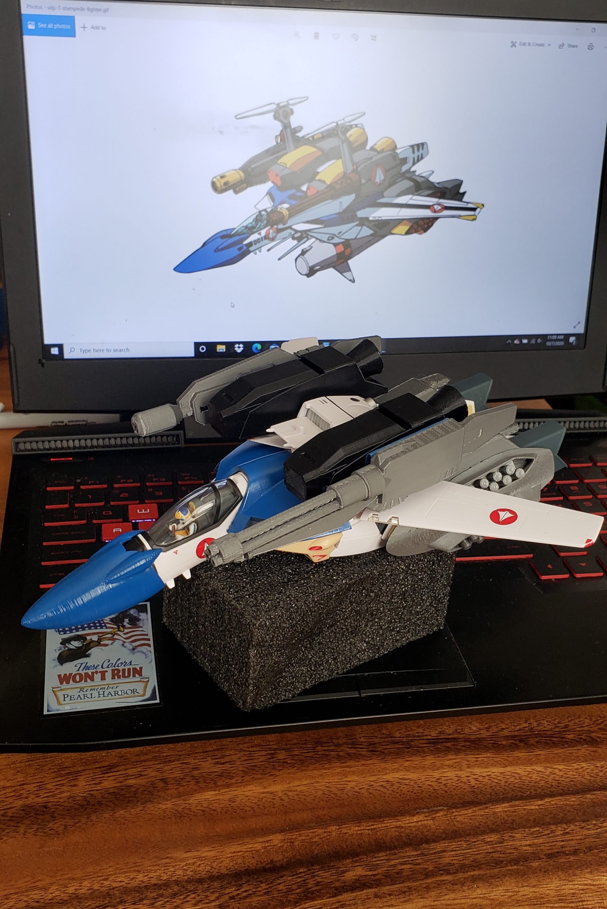

First thing I did was look for reference material. I couldn't find too much info or lineart.  I found some courtesy of Mr. March's Macross Mecha Manual and used those as reference.

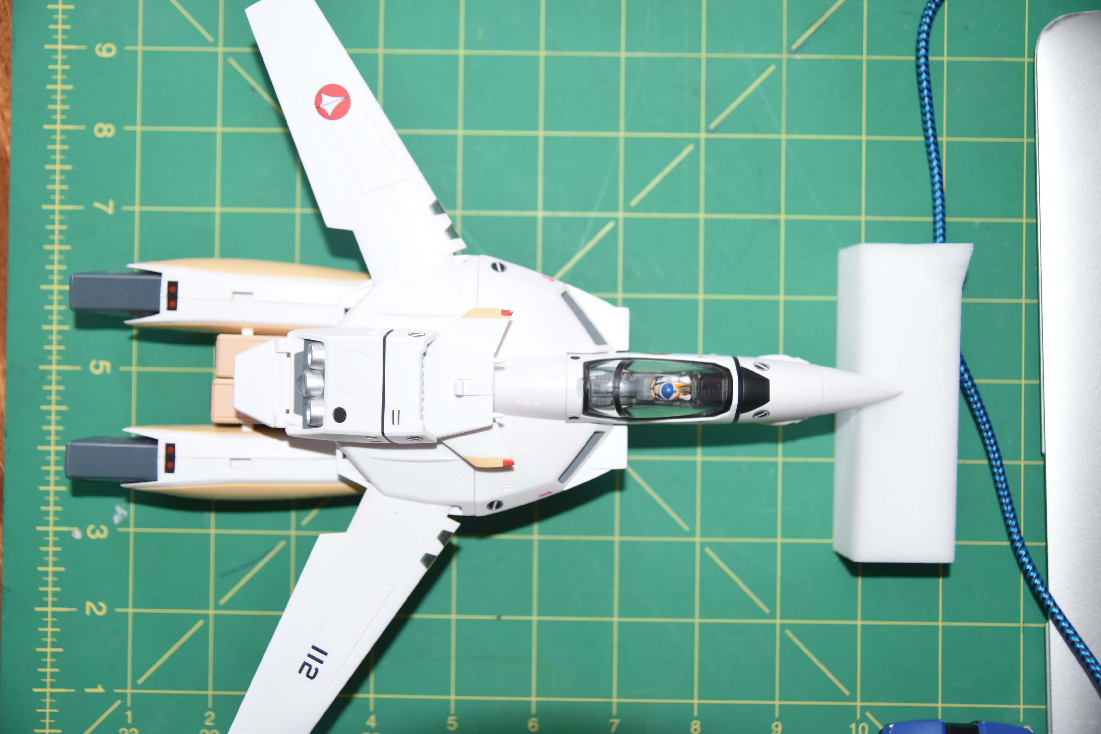

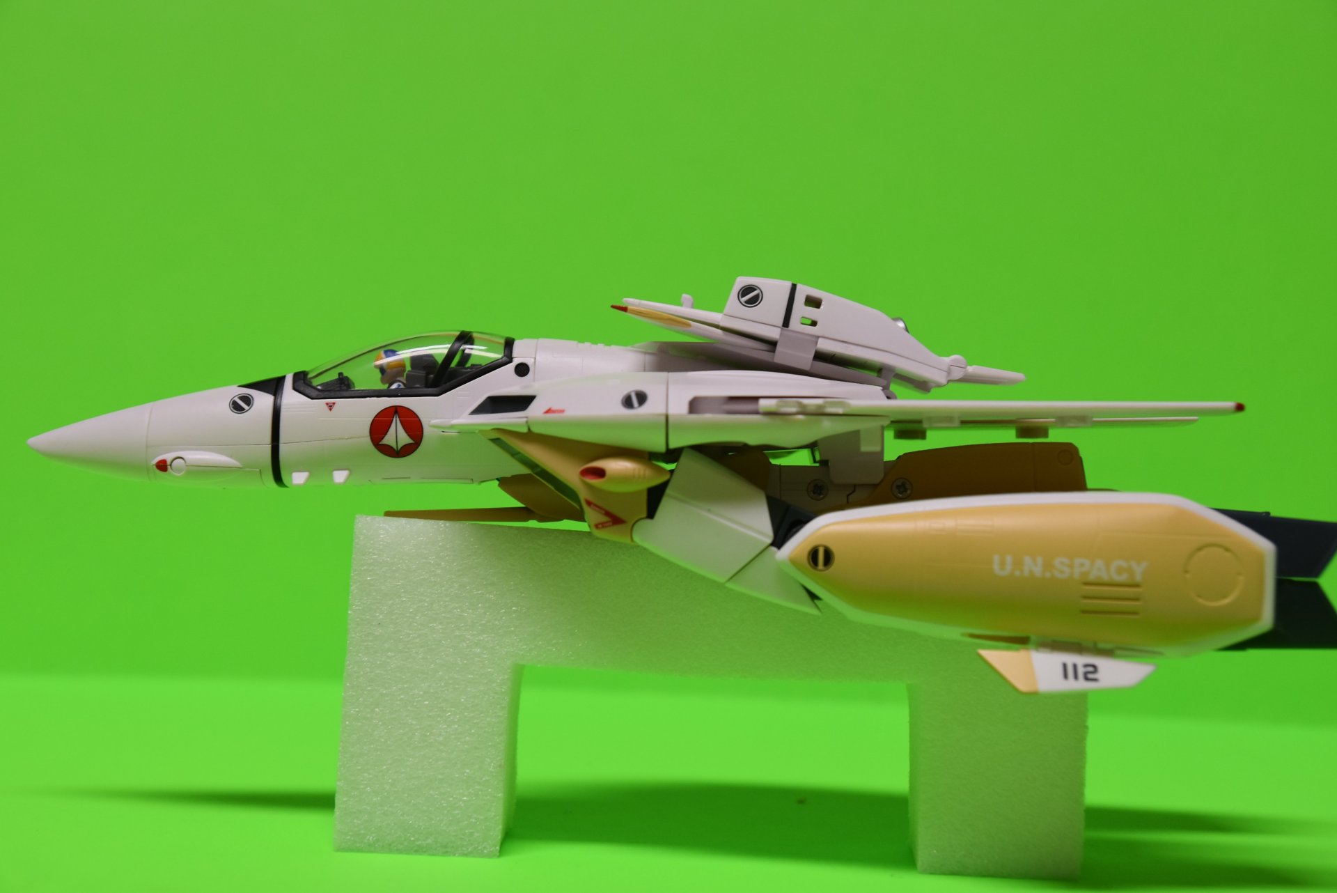

Next thing I did was take some pics of a 1/60 for reference. I'm using a VF-1A Kakizaki. Something like these.
Spoiler
D55_3320.thumb.JPG.ec45f250681da1486e1812c98fd73d5f.JPGD55_3346.thumb.JPG.a9e54b35366844072993eb199956fd82.JPG

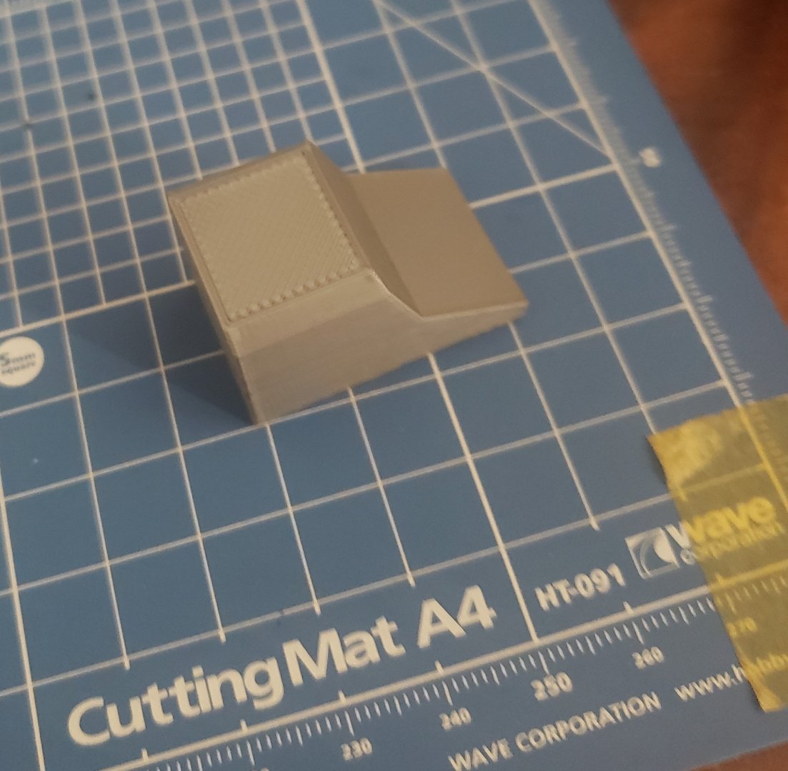

I just took measurements with a caliper to get the general idea. I then started to sketch up some ideas and used plastistruct to build some mock ups. Here I built a mock up of the right shoulder missile pod and used my VF-1J as the model.  As Majestic pointed out, lineart vs what you got to work with is a huge pain.
Spoiler

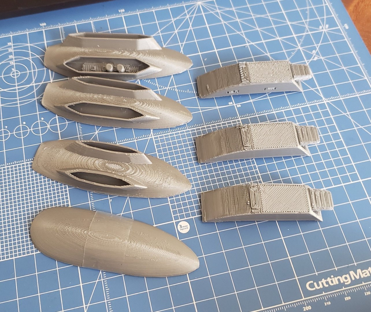

The first thing I started to work on was the booster sections. I made the front except for the missiles and hinges but I'll get to that later. Here are pics of the fron section, rear boosters, and sides made out of styrene sheet as wanna work on the shape of the sides.

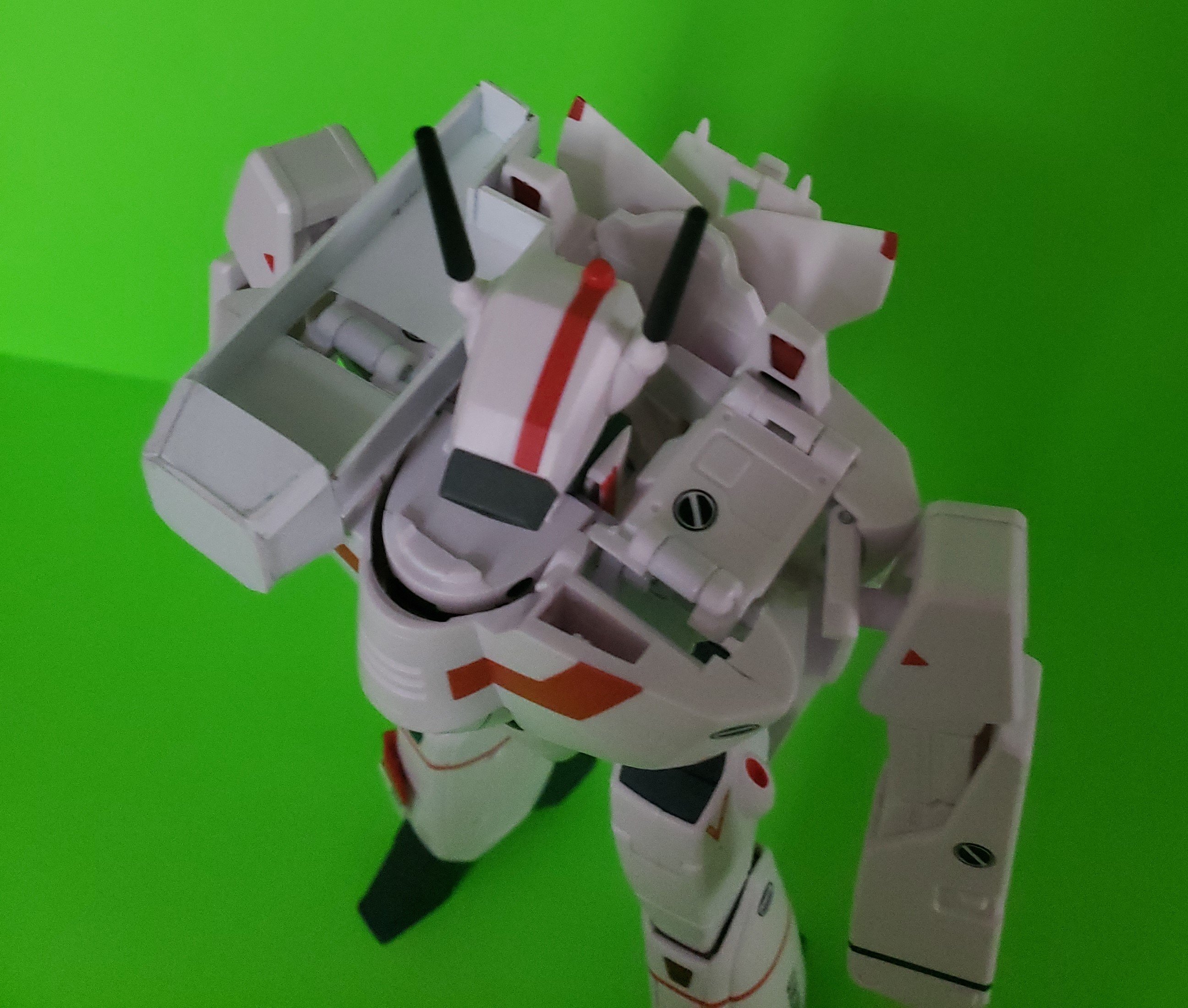

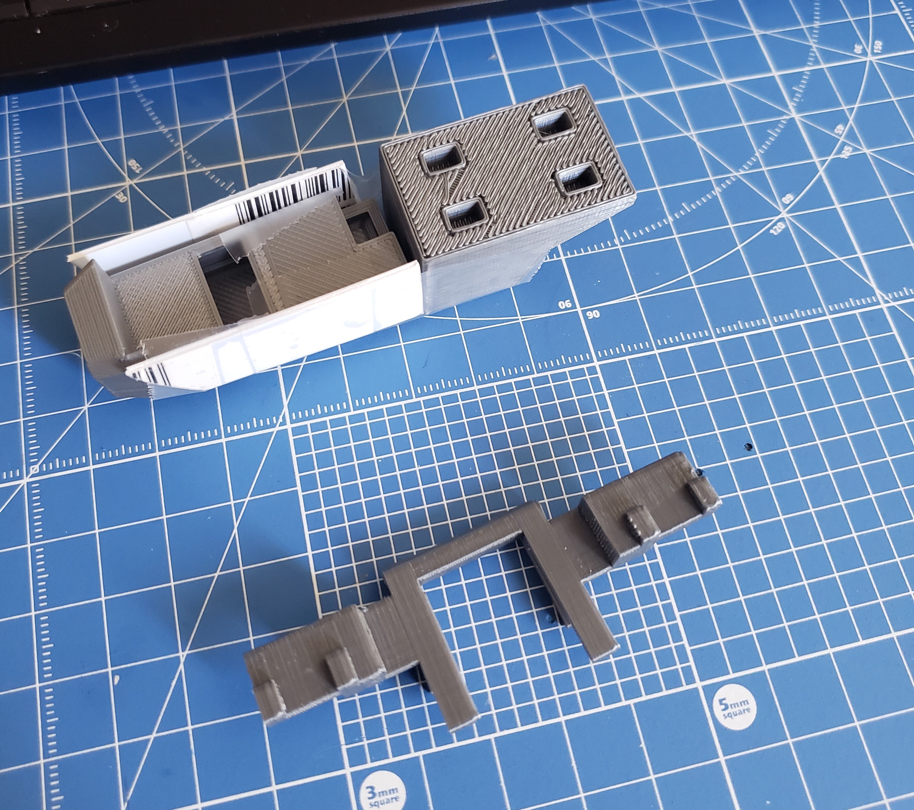

Next I had to figure out how 1. Where do I want them to go and 2. How am I gonna put them on? From the line art it seems the boosters move up in Battroid so I had to have the boosters move.  After using a general area I then measured it out exactly where I wanted it. I also decided that I'm just gonna put holes in the bottom of the boosters and use those as mounts. I then made a bracket for the boosters.
Spoiler

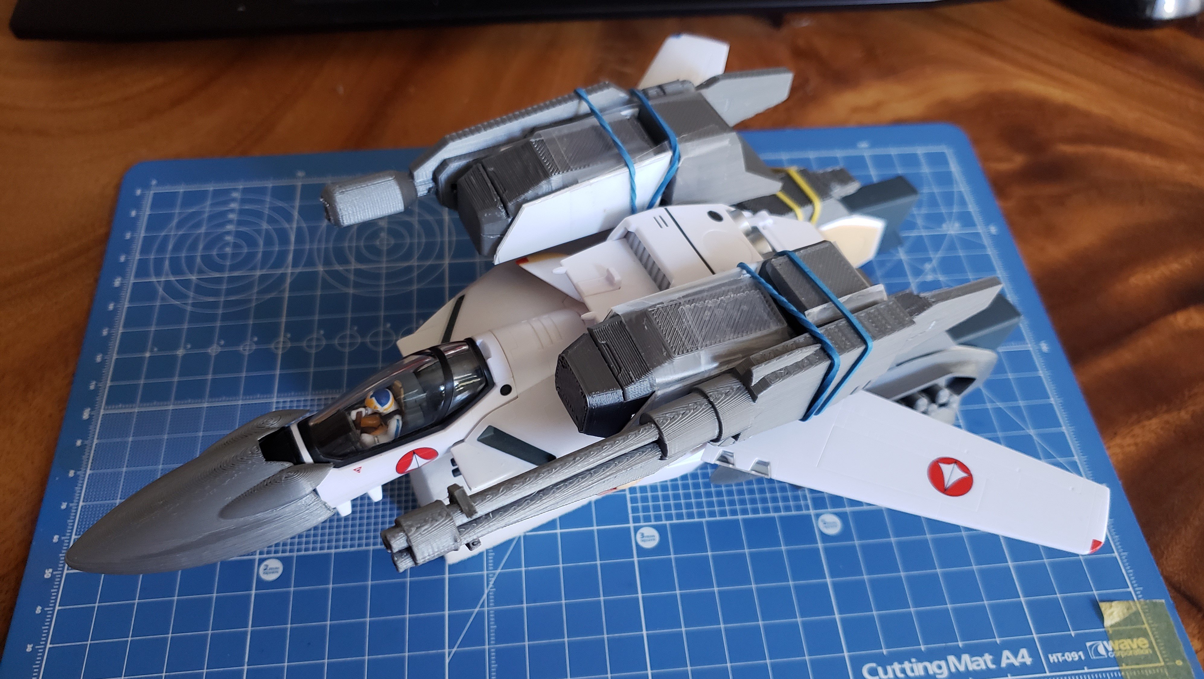

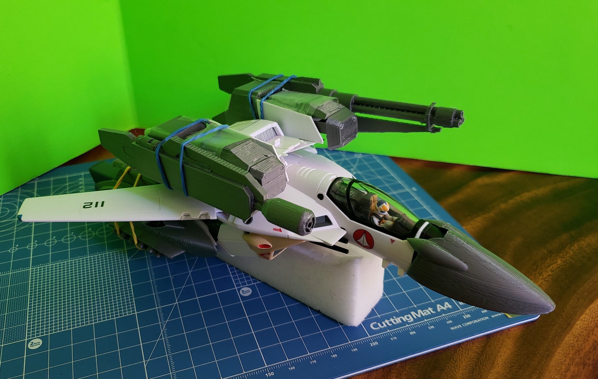

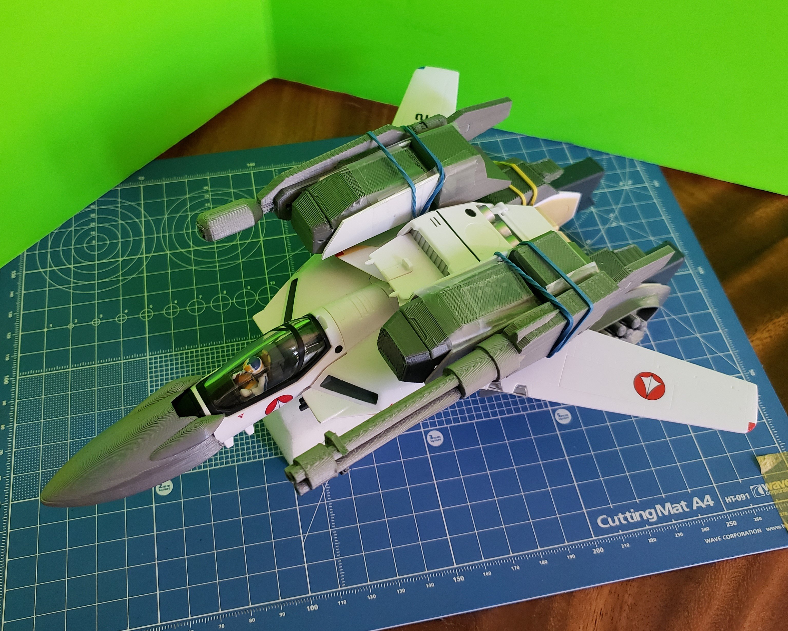

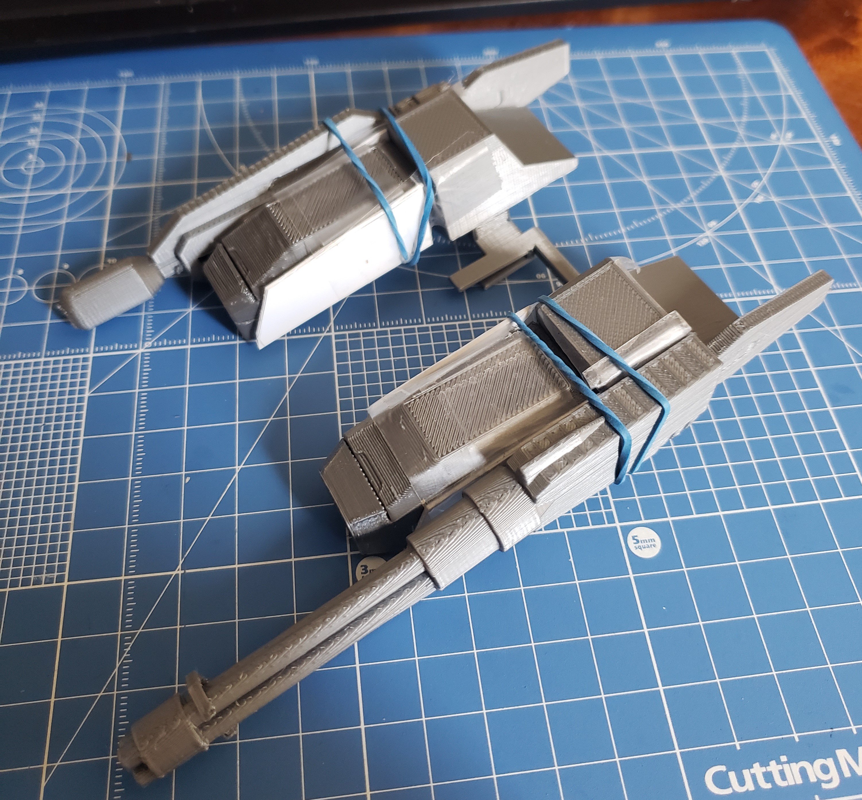

When that was finished I decided to do the guns next. I printed the general shapes out going with the lineart for best guesstimate but I'm still trying to figure out how I'm gonna mount them to the boosters. Either magnets of clips. We'll see. Here is a pic of them a together (held together with rubber bands lol).
Spoiler

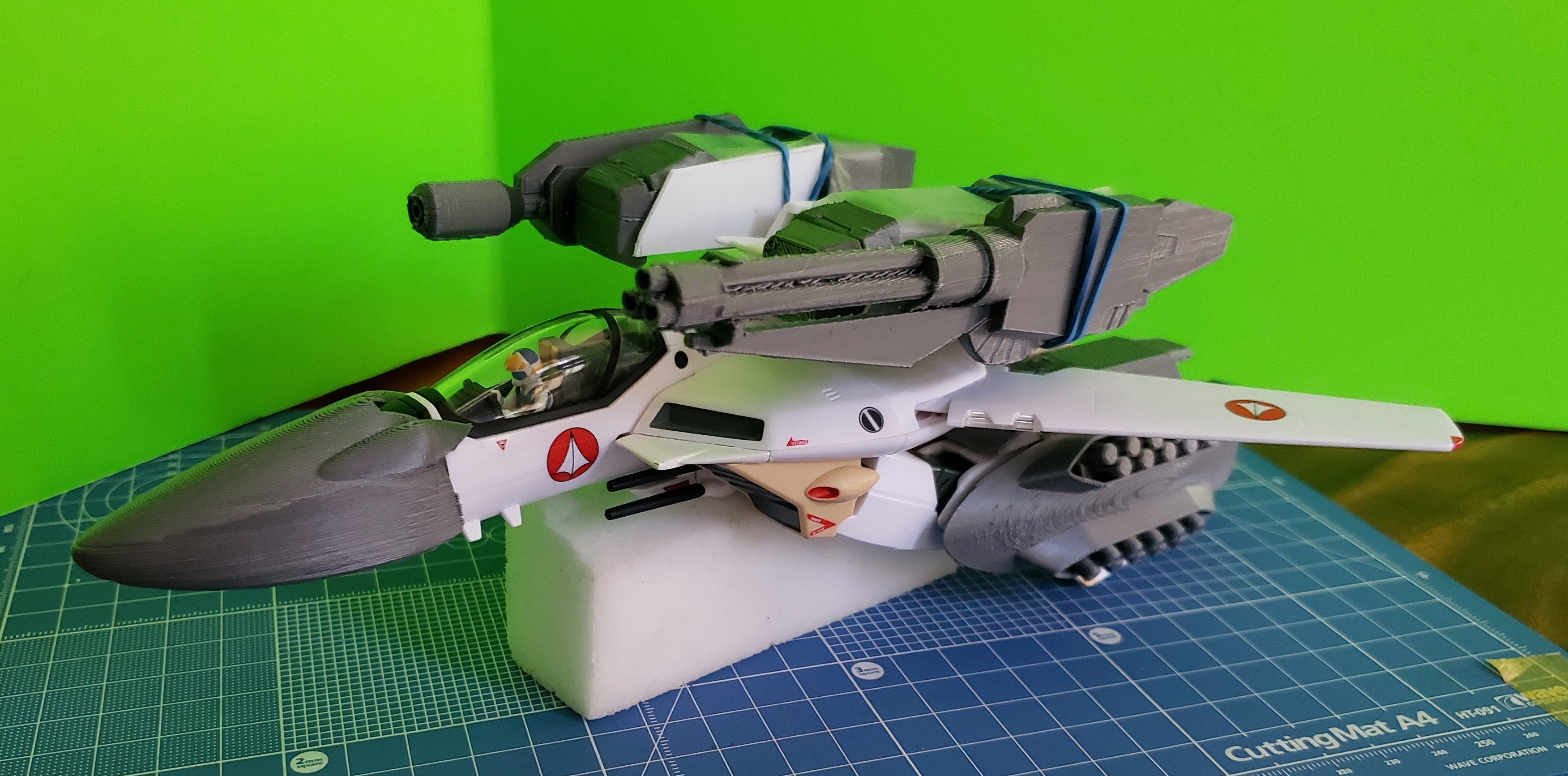

So if you've stuck around and read through all of that you're probably wondering how it looks like right? This is where I'm at right now. Don't laugh:
Spoiler
Spoiler
Spoiler
Spoiler

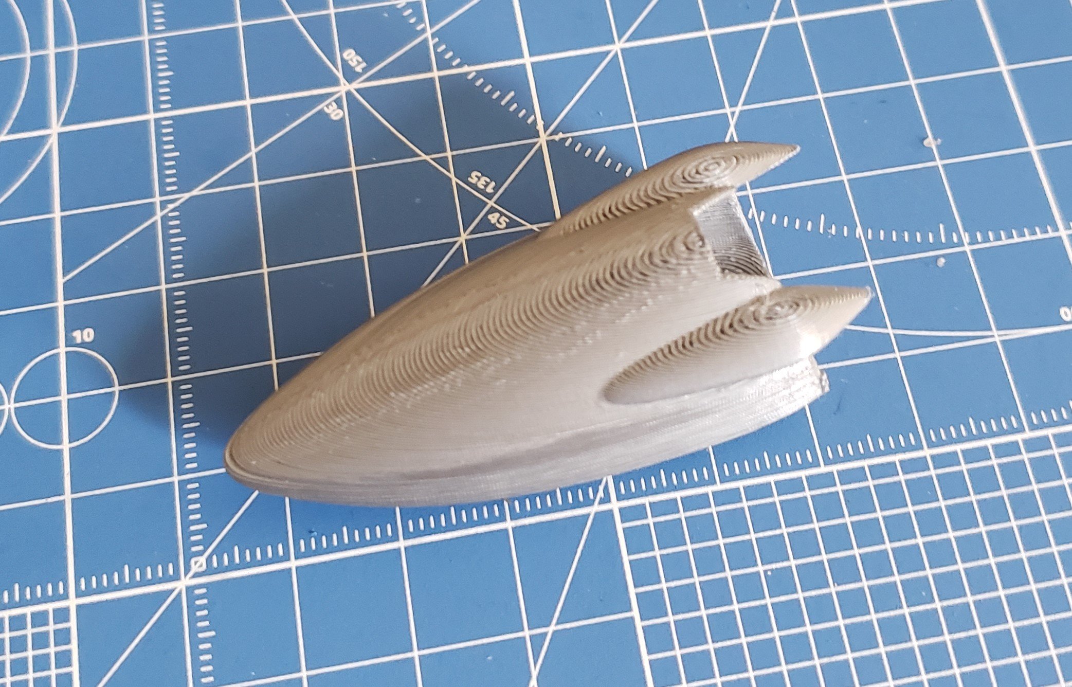

Right now I'm working on the intake covers which is the hardest ones yet. Thanks for looking.

Thanks for the feedback folks I really appreciate it! The plan is to make these prints to see the fit and finish of things, try to overcome what the lineart shows vs how real life ain't gonna let you do it,  clean up and refine them,  then send them of to a 3d printing service. I could post process these but I'll stew over it a bit before I decide whether I want to or not.
That's exactly what I was thinking, your printer is rough but it helps building something accurate, then when you are done with the global shapes, you can add as many details as the printing service will be able to render then print it! This is such a nice time where anyone is capable of making its dream come true :D Love 3D printing!

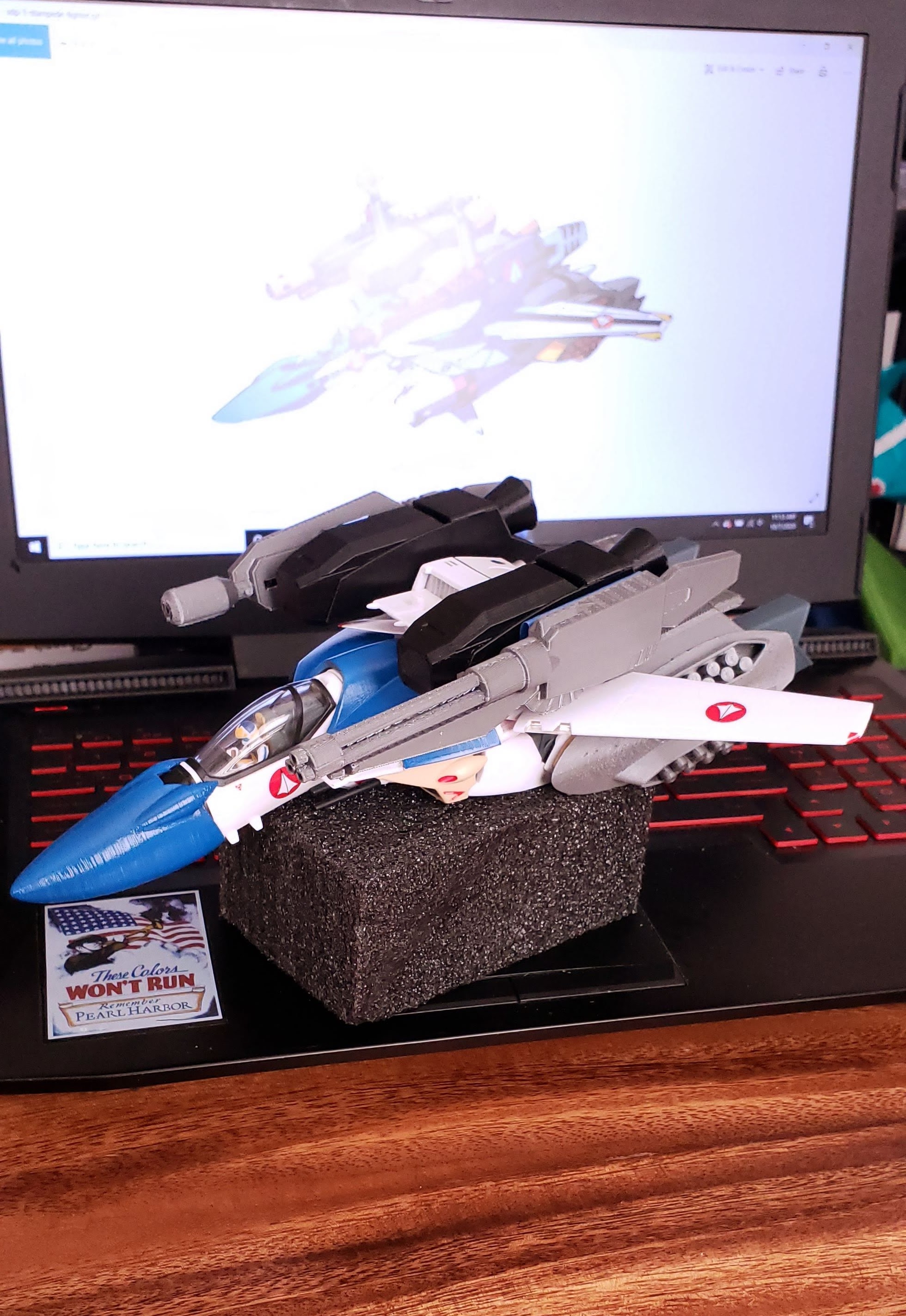

I know it's been awhile but nothing much to report. I'm still trying to find a compromise on the intake cover/fin part.  Finished the chest piece. Here are test pics of fixed boosters and the chest piece.
1146589253_Chestpiecetest1.thumb.jpg.83b5e3766b0d0ccaf5739176500248f3.jpg1199123328_Chestpiecetest2.thumb.jpg.d84a0ef08a9ec938959a9351929e678d.jpg
This is looking great. You've really captured the look and aggressiveness of the Valk. It looks great.
