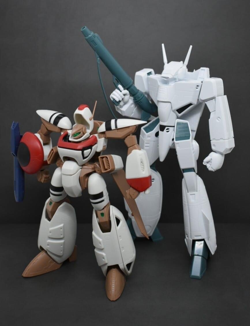

TMBounty_Hunter Posted May 18 Author Posted May 18 So this is the first side-by-side with the Hasegawa that I see and the vertical chonkiness is interesting. The person is also using a old Bandai head on the PLAMAX Quote

KOG Water Dragon Posted May 18 Posted May 18 1 hour ago, TMBounty_Hunter said: So this is the first side-by-side with the Hasegawa that I see and the vertical chonkiness is interesting. The person is also using a old Bandai head on the PLAMAX I'm disturbed that my first thought is "dang, I sure do like the hasegawa". I think I like seeing more of the jet intake vents at the top of the leg (hasegawa) vs less (max factory). Quote
GMK Posted May 18 Posted May 18 7 hours ago, KOG Water Dragon said: I'm disturbed that my first thought is "dang, I sure do like the hasegawa". I think I like seeing more of the jet intake vents at the top of the leg (hasegawa) vs less (max factory). You’ve just been programmed over the years. Normal service will resume shortly. Quote
Thom Posted May 19 Posted May 19 10 hours ago, TMBounty_Hunter said: So this is the first side-by-side with the Hasegawa that I see and the vertical chonkiness is interesting. The person is also using a old Bandai head on the PLAMAX I'm actually still preferring the 'slimmer' Hasegawa version. But love what you love, right!? Quote
VF-1A Grunt Posted May 19 Posted May 19 2 hours ago, Thom said: I'm actually still preferring the 'slimmer' Hasegawa version. But love what you love, right!? It made me immediately think “TV vs. Movie.” I think DYRL’s more sophisticated animation and attention to detail made the Battroids look taller and slimmer, which is what I see in Hasegawa model. More realistic looking, if you will. The Plamax definitely has the feel of the SDFM artwork. I like them both, and I plan to add a few Plamax models to my collection, but the Hasegawa model just looks more believable to me. Quote

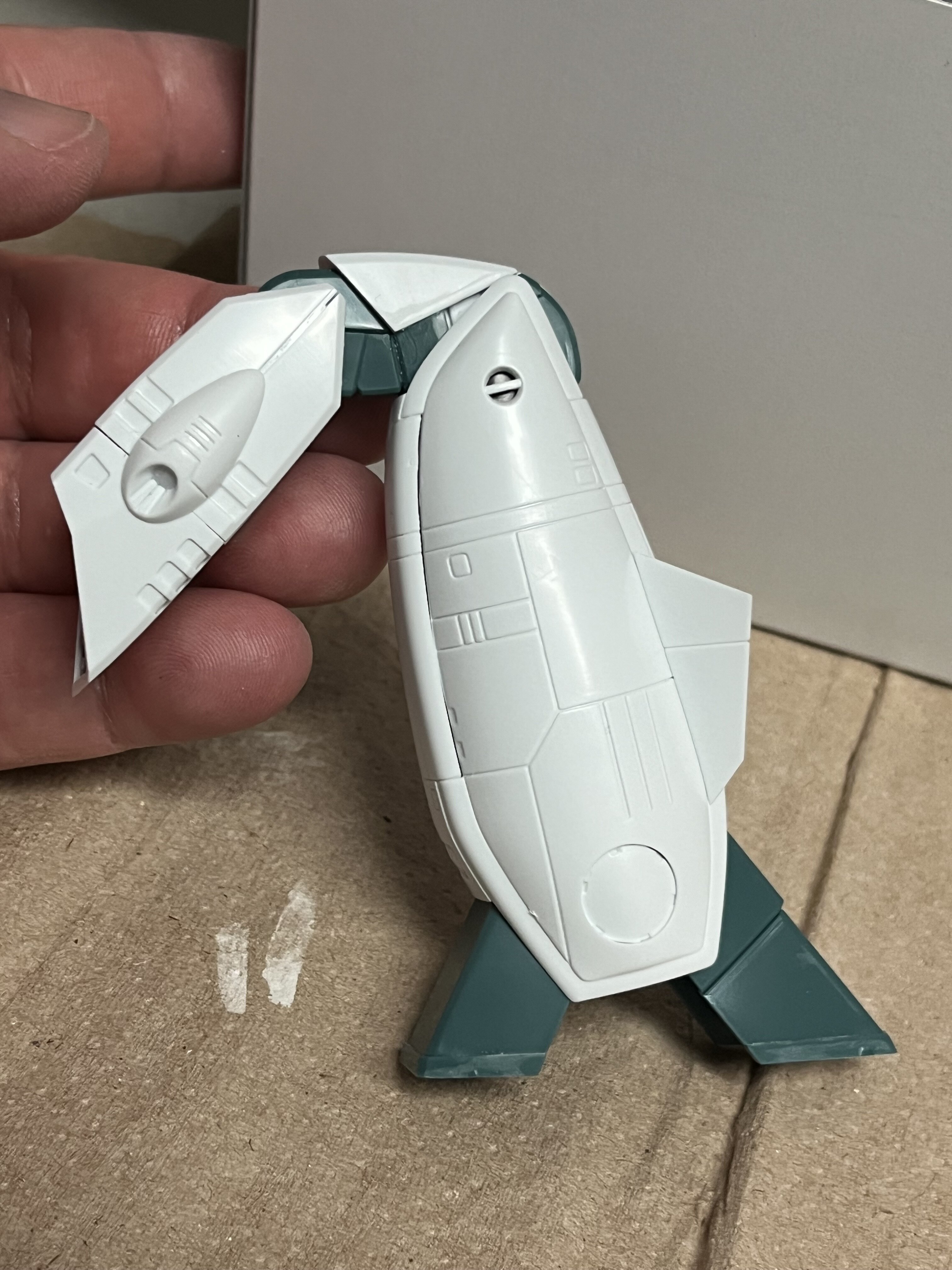

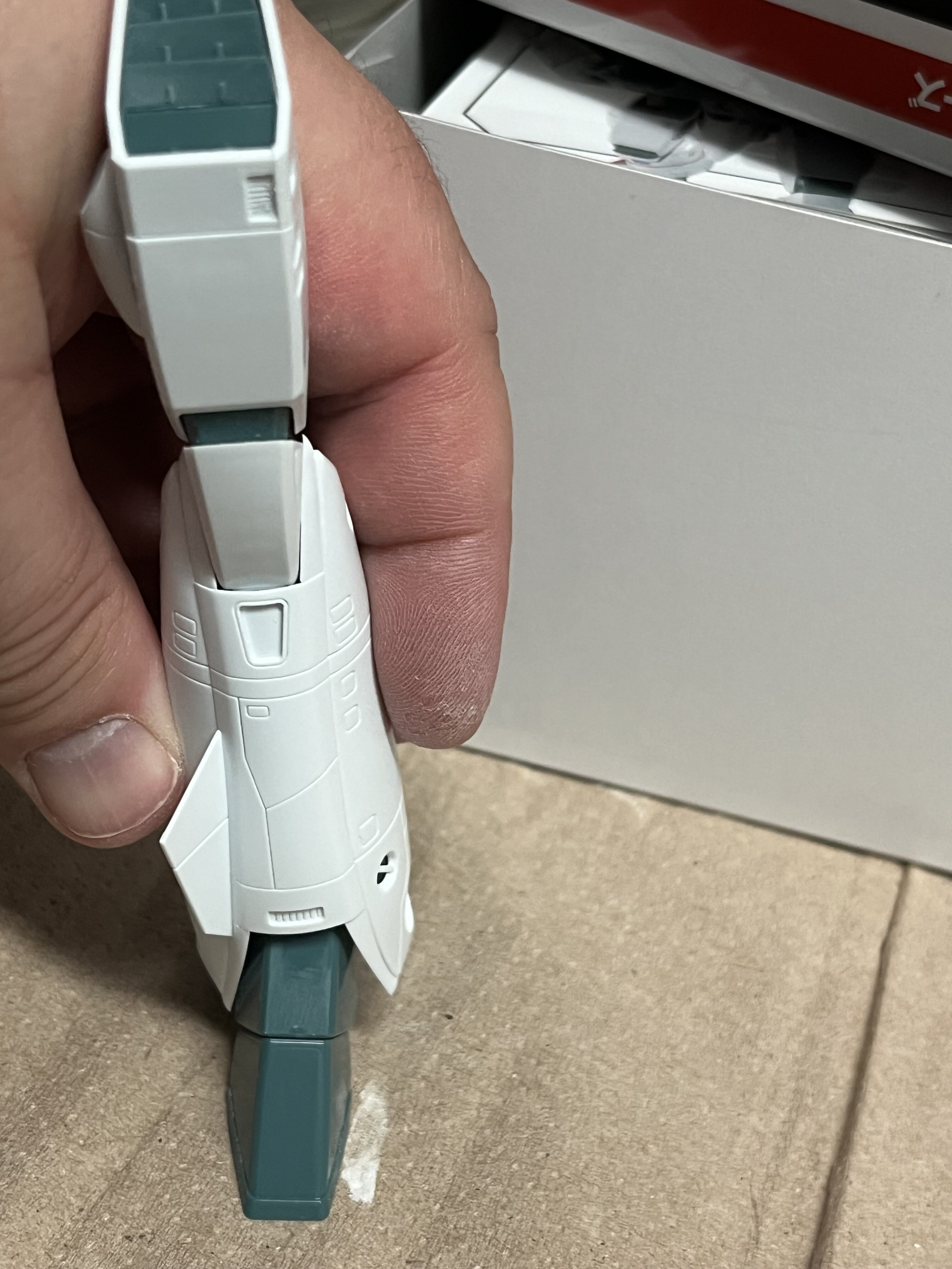

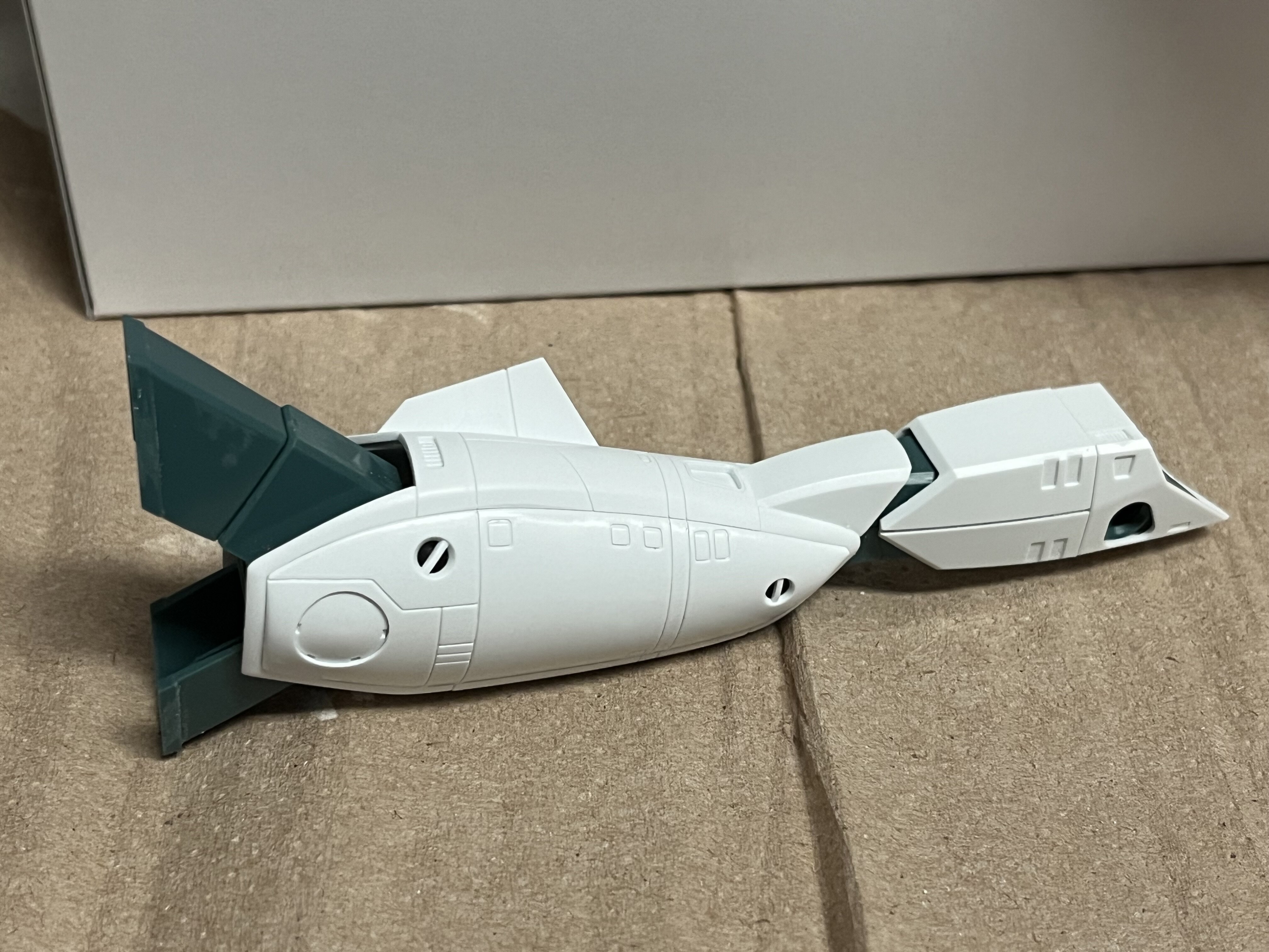

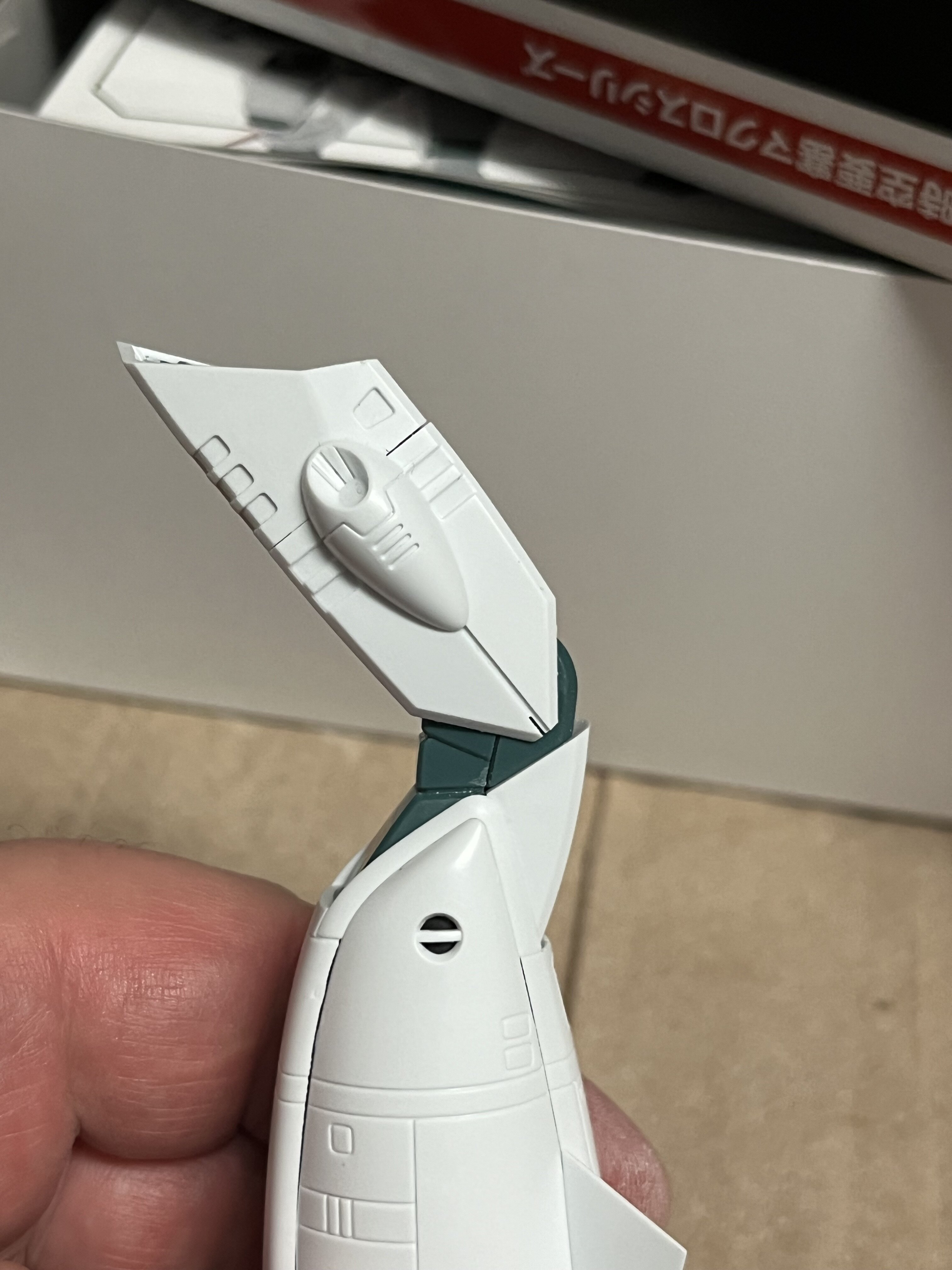

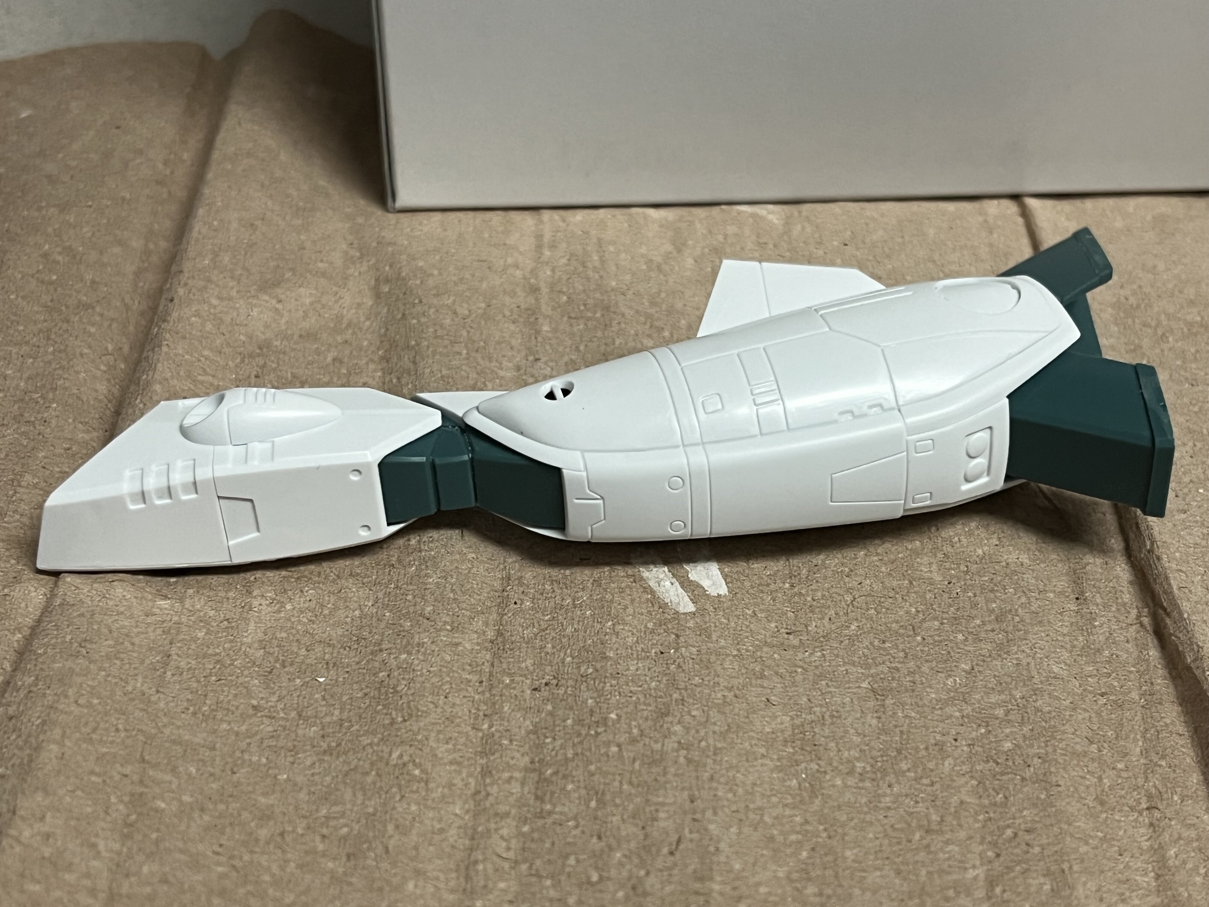

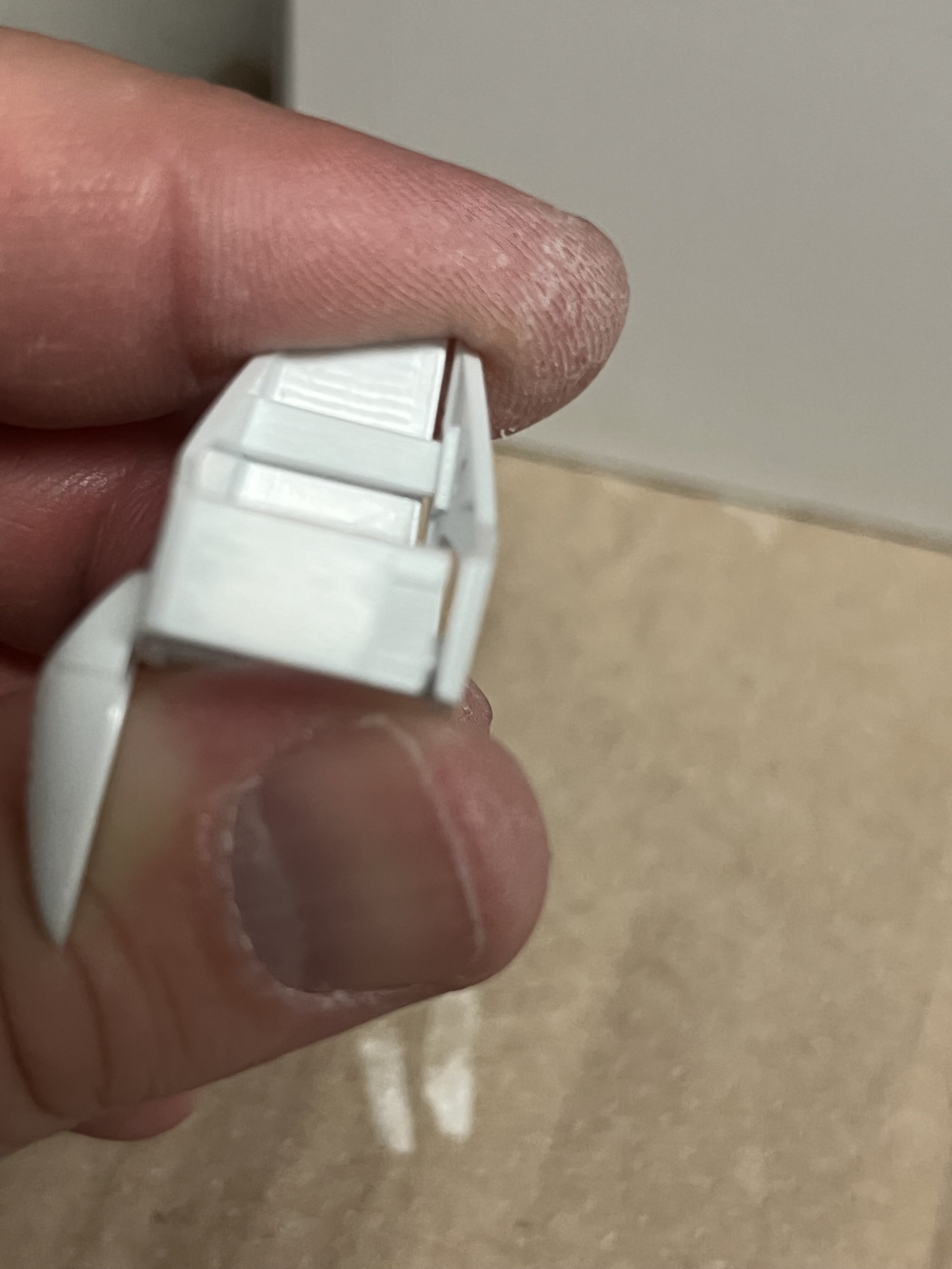

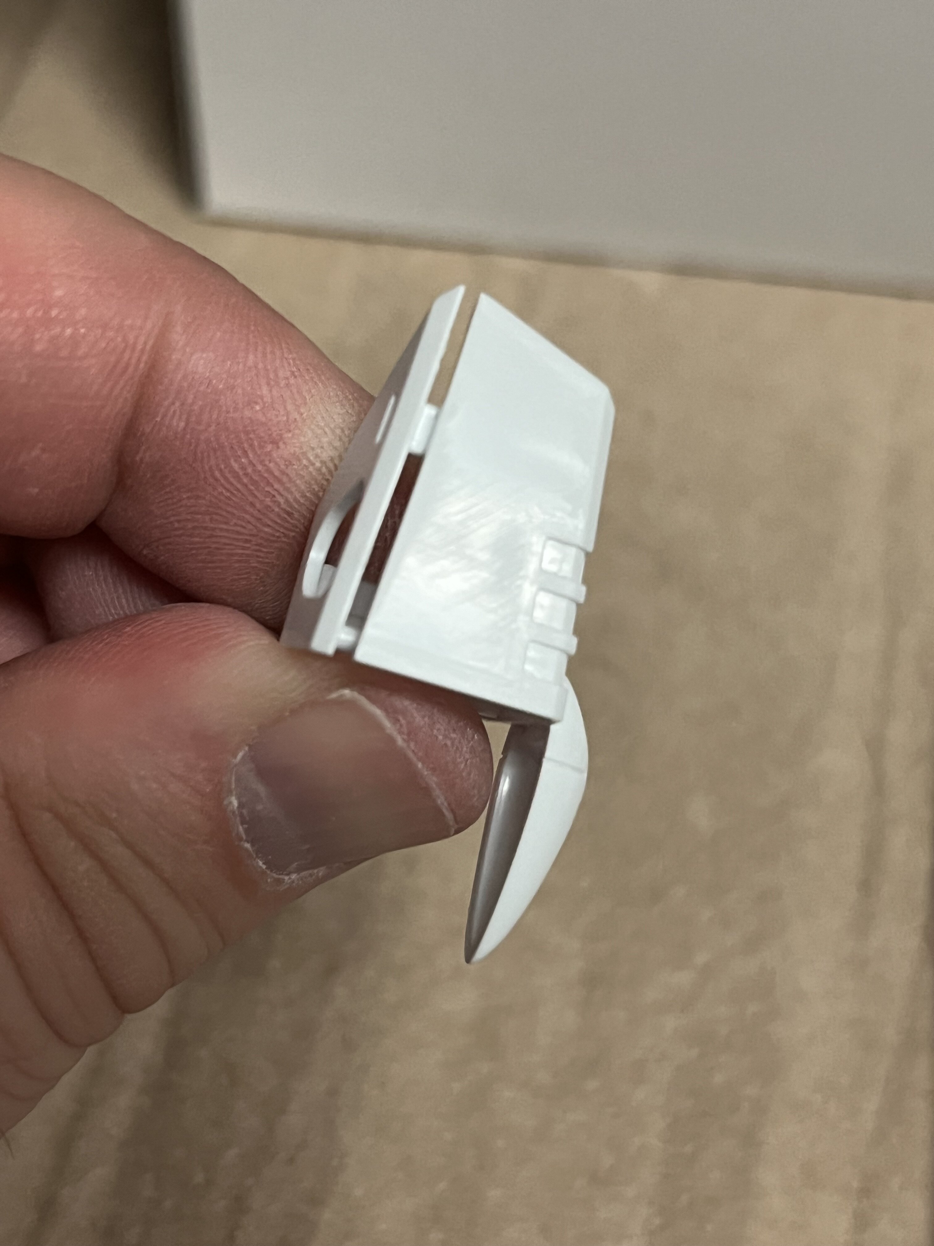

Big s Posted May 19 Posted May 19 Finished the legsdefinitely need glue since some parts are very loose. The knees are pretty good with the poly caps, but the feet are a bit loose and may need a bit of thickening at the ball, but there’s not too much back and forth or side to side movement out of them.The knee gets a bit of a decent bend due to the double jointthe only seams on the entire leg is at the top around the intakes and they’re done in a way that a lazy person could just leave them alone and it will barely be noticeable Quote

Big s Posted May 19 Posted May 19 Something I forgot to mention is that there’s a few parts that definitely need glue, there are some parts to take caution with like the white armor around the lower legs. Those panels are pretty loose and I have a feeling they’re designed to be removable for extra add ons like super parts, so those you may want to leave a little loose just in case you want to eventually add something on instead of buying an additional kit. The little circles around the ankles will probably be fine to glue in place though, those things just plop off too easily Quote
