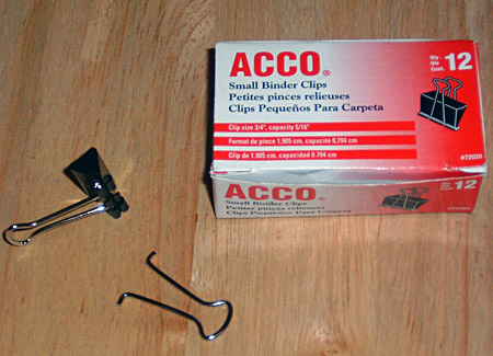

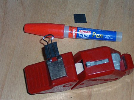

Texan29 Posted January 20, 2004 Posted January 20, 2004 (edited) Mods; I know this isn't macross, but I didn't know where else to post this. Okay, you'll need two things for this, first is either a flat eraser or the tread from an old shoe (anything that is a good semi-solid rubber) and the second is a small binder clip: Edited January 20, 2004 by Texan29 Quote

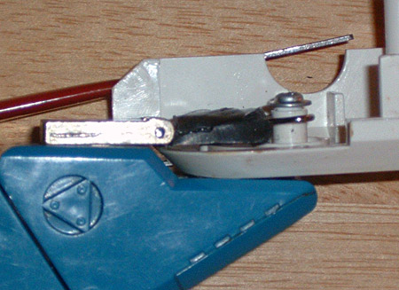

Texan29 Posted January 20, 2004 Author Posted January 20, 2004 Take the rubber and cut it into a small 1 inch rectangle. Then slice it in half lengthwise. Pull off one of the arms from the binder clip. Quote
Texan29 Posted January 20, 2004 Author Posted January 20, 2004 Next take apart the shoulder with the arm, unscrew and remove original plastic piece inside the shoulder: Quote

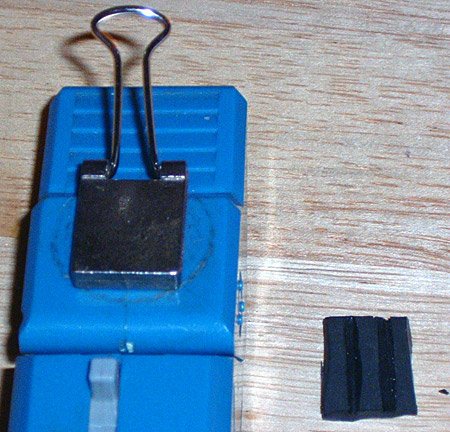

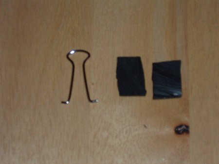

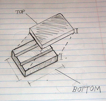

Texan29 Posted January 20, 2004 Author Posted January 20, 2004 Cut grooves into one piece of the rubber like so: (Pardon my horrible drawing skills heh) Quote

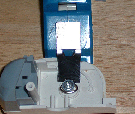

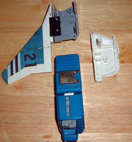

Texan29 Posted January 20, 2004 Author Posted January 20, 2004 Attach the clip piece to the arm like this: Quote
Texan29 Posted January 20, 2004 Author Posted January 20, 2004 SuperGlue the grooved rubber piece to the clip like so: Quote

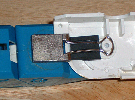

Texan29 Posted January 20, 2004 Author Posted January 20, 2004 Screw the clip onto the top of the shoulder piece: Quote

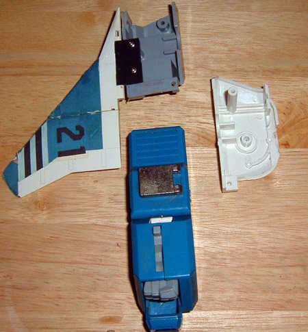

Texan29 Posted January 20, 2004 Author Posted January 20, 2004 Glue the other rubber piece to the clip to cover the grooves. The rubber makes a spacer for the clip so it is smooth when you move the arm. Quote

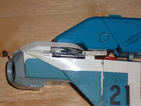

Texan29 Posted January 20, 2004 Author Posted January 20, 2004 Re-assemble the shoulder with your NEW arm joint and that's it! NOTE: IF the rubber is too thick, just trim it down with a razor carefully until the top and bottom of the shoulder come together and the arm moves snugly and freely. Quote

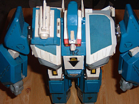

Texan29 Posted January 20, 2004 Author Posted January 20, 2004 Straight and in line, and stronger than the original! Quote

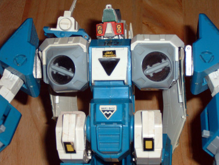

Texan29 Posted January 20, 2004 Author Posted January 20, 2004 Last shot. (Gee, i need to clean it don't i?) Quote
