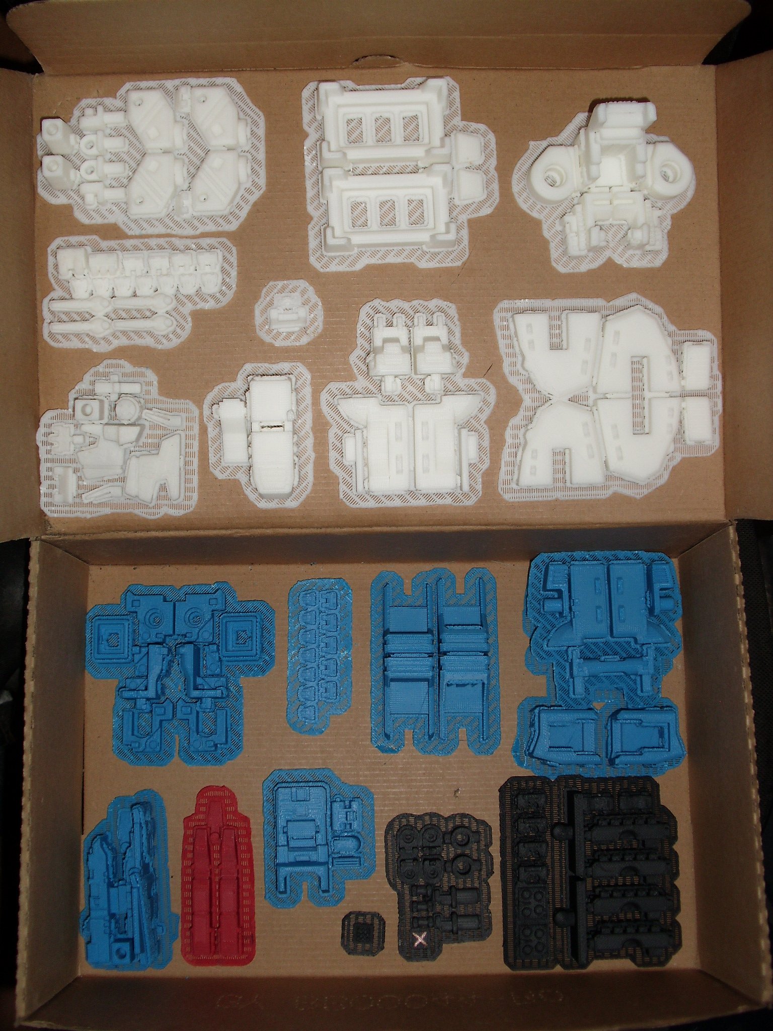

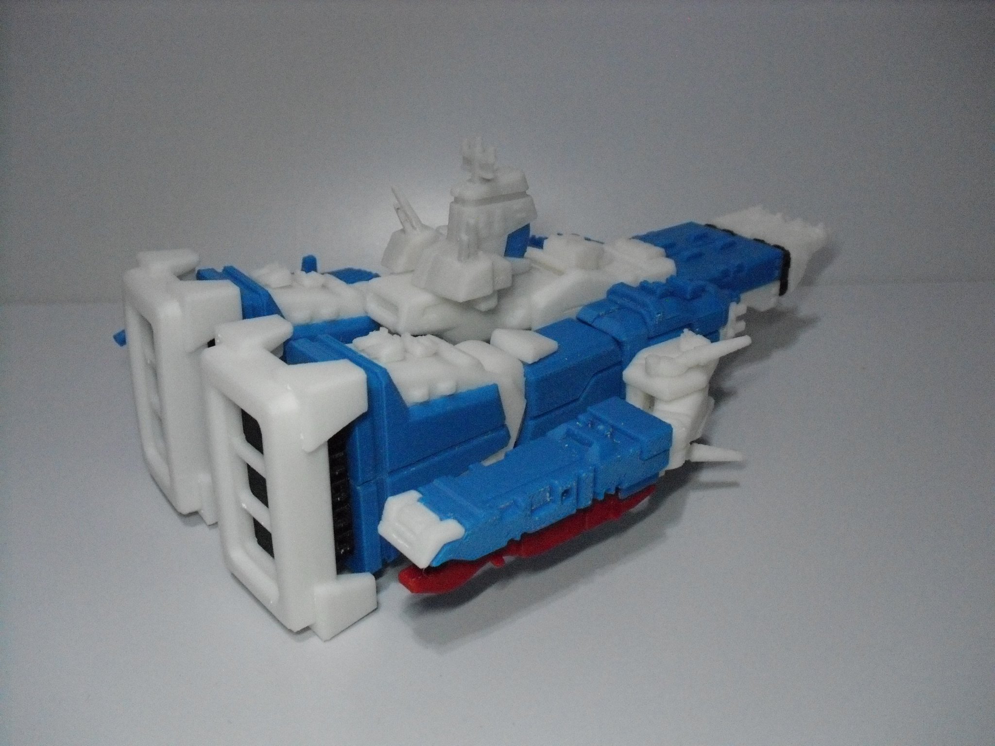

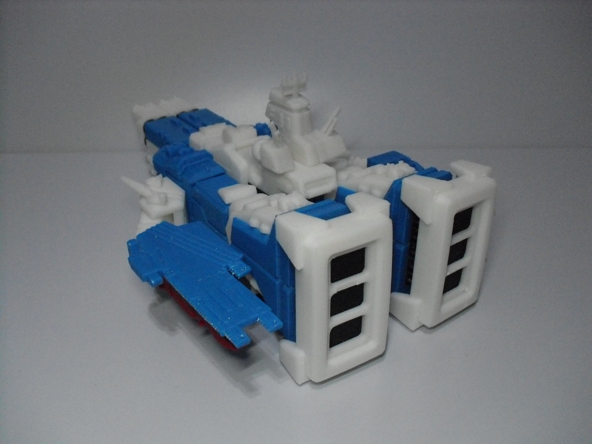

UN_MARINE Posted August 23, 2019 Author Posted August 23, 2019 All the printing's done! I forgot about the control tower deck parts... so it's 17 sets total. It'll be assembly for the next few hours. Quote

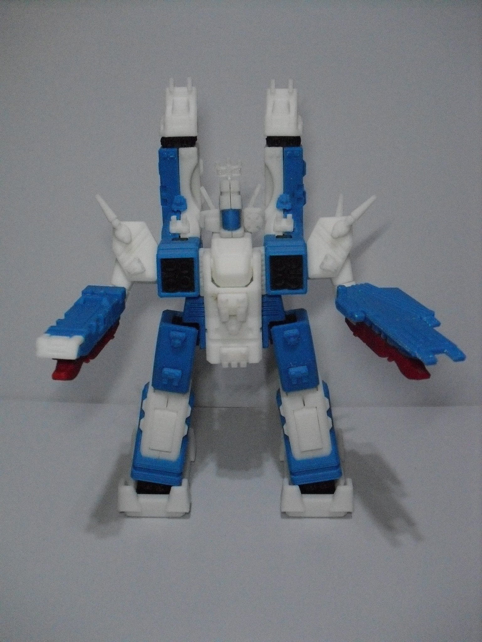

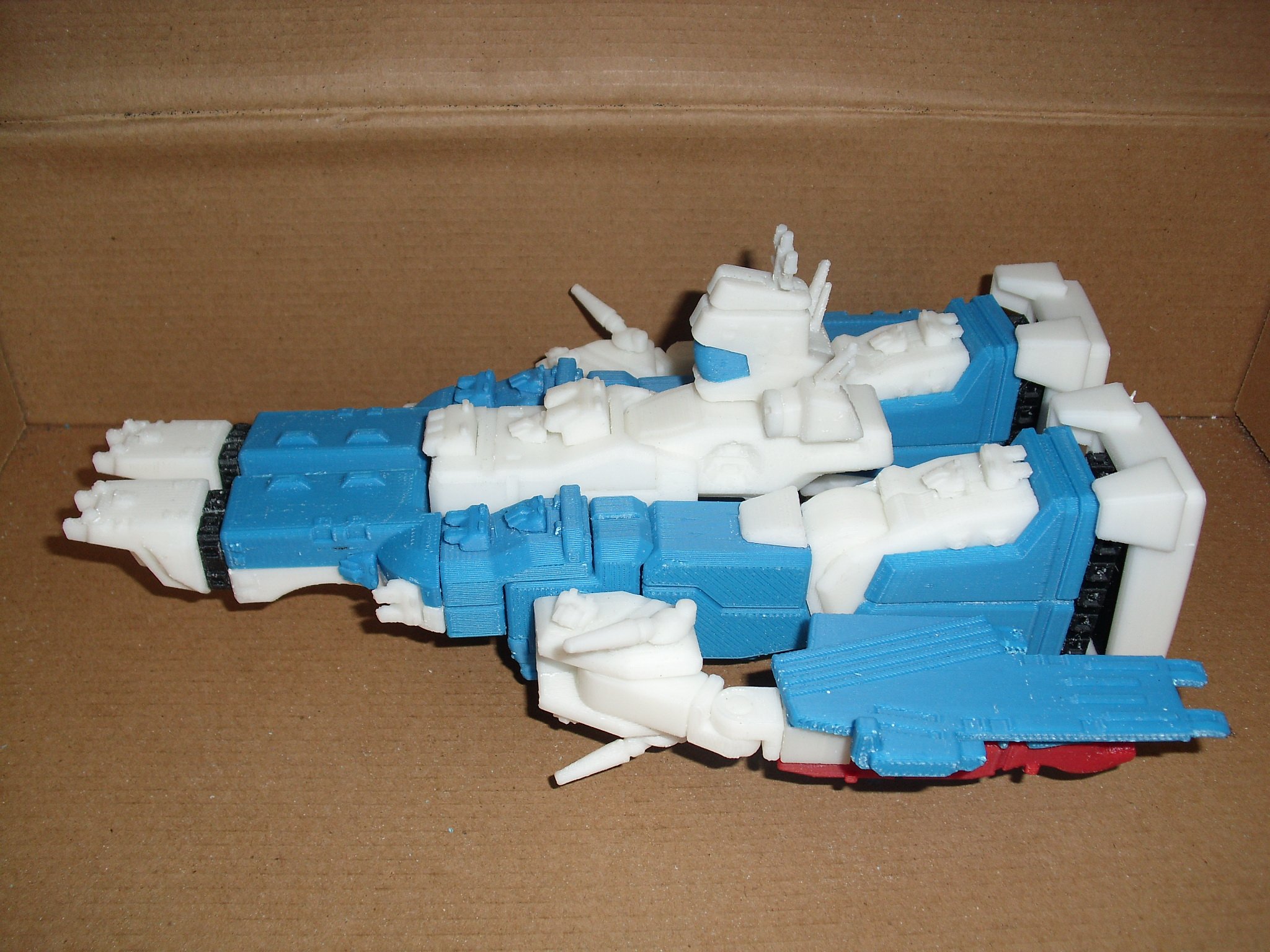

UN_MARINE Posted August 23, 2019 Author Posted August 23, 2019 It's in 1 piece! Slight fit issues due to shrinkage/warping, but nothing a truckload of sanding & putty can't fix. Quote
tekering Posted August 23, 2019 Posted August 23, 2019 Dude, you work fast!* Amazing to see your design become a reality... and so quickly, too! * Your printer's no slouch, either. Quote
UN_MARINE Posted August 23, 2019 Author Posted August 23, 2019 20 minutes ago, tekering said: Dude, you work fast!* Amazing to see your design become a reality... and so quickly, too! * Your printer's no slouch, either. Thanks! I wanted to get it to this stage before work picks up in a couple of days - everything will get much slower from this point. The printer and I have an understanding - I keep the models "print-friendly", and it doesn't have unscheduled catastrophic failures (often). Quote
UN_MARINE Posted August 23, 2019 Author Posted August 23, 2019 Oh right... technical stuff: Approximate print time is 31 hours on 0.25mm layer height, "loose" (75%?) infill. Roughly 470 grams of ABS. Quote

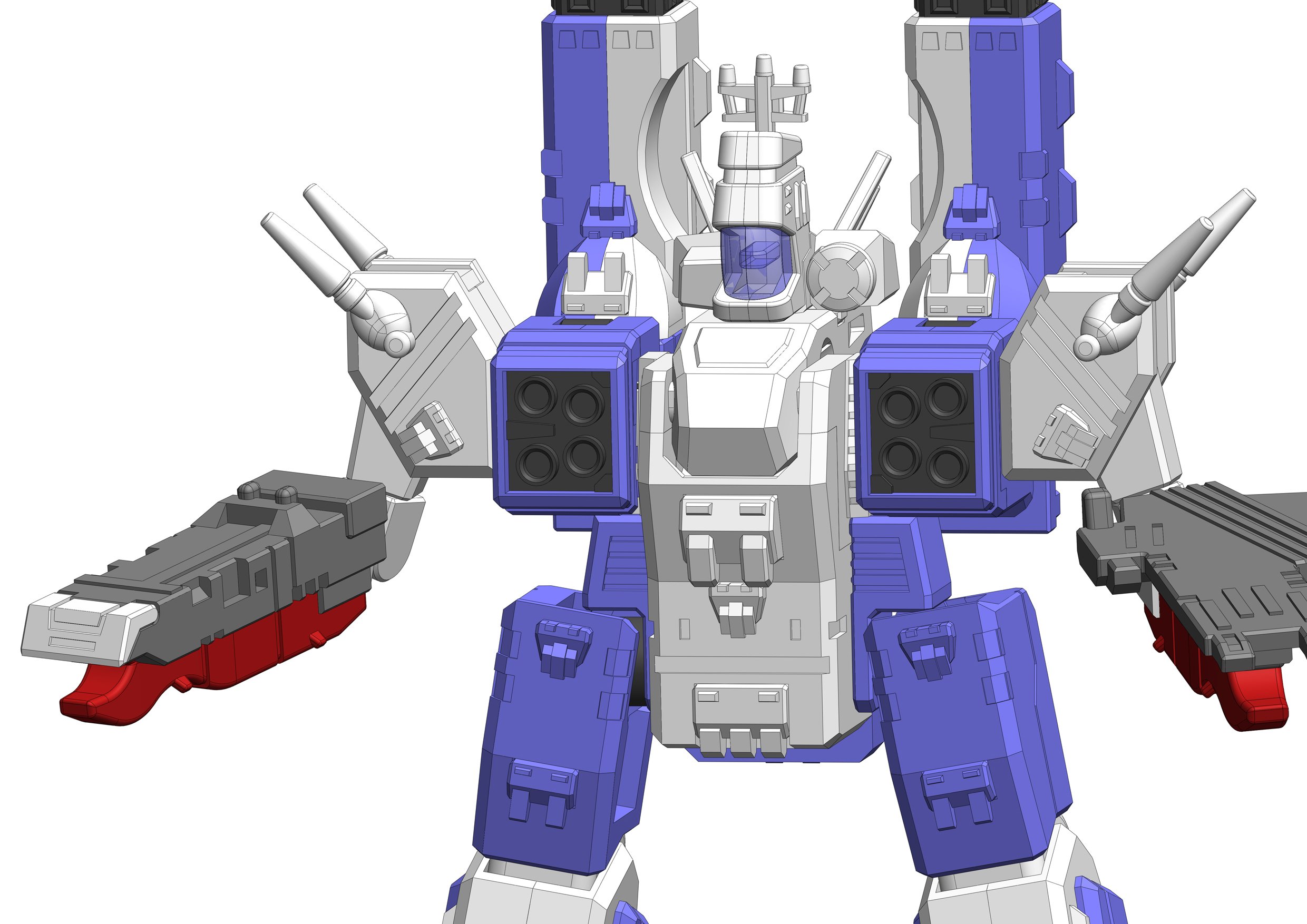

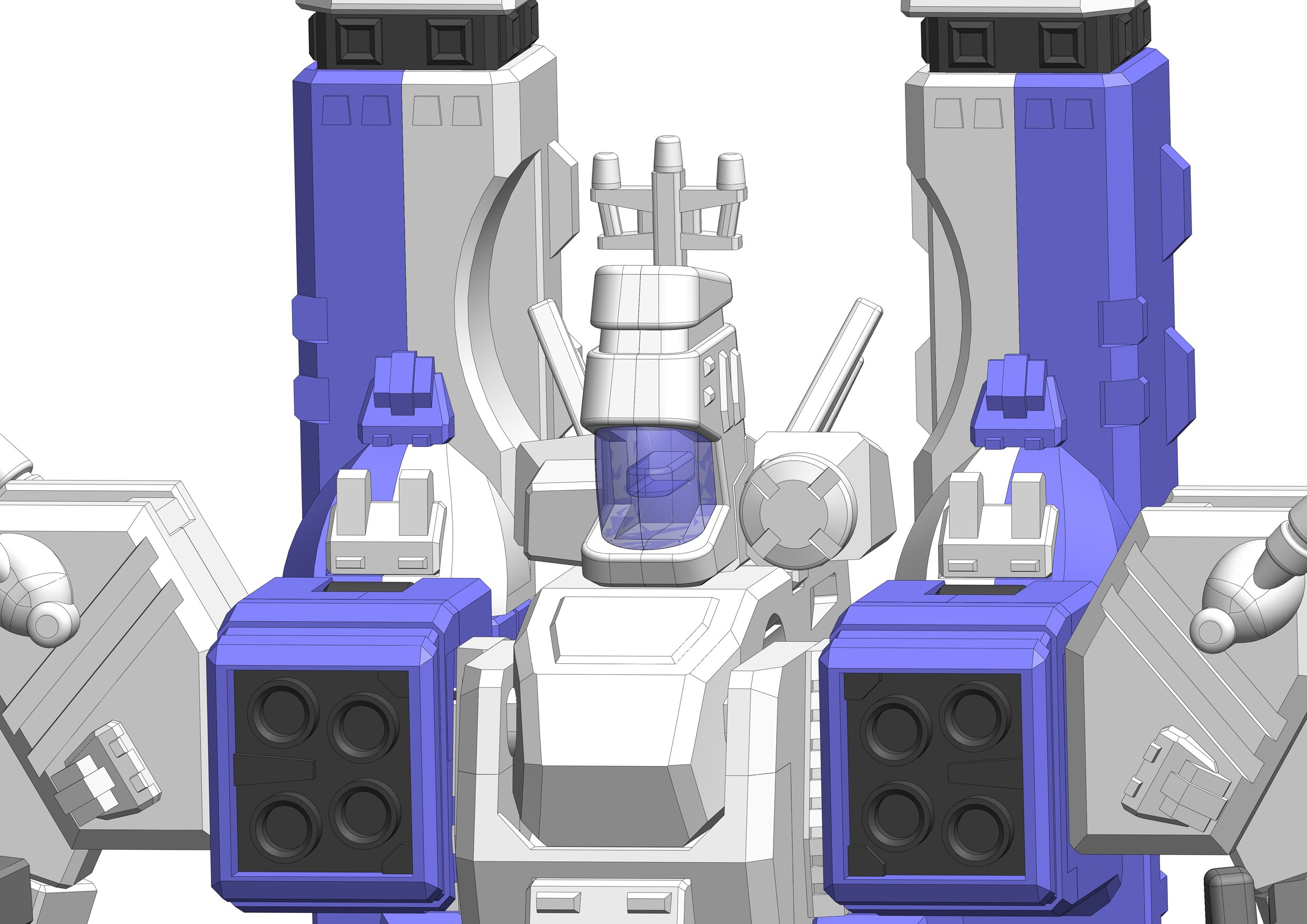

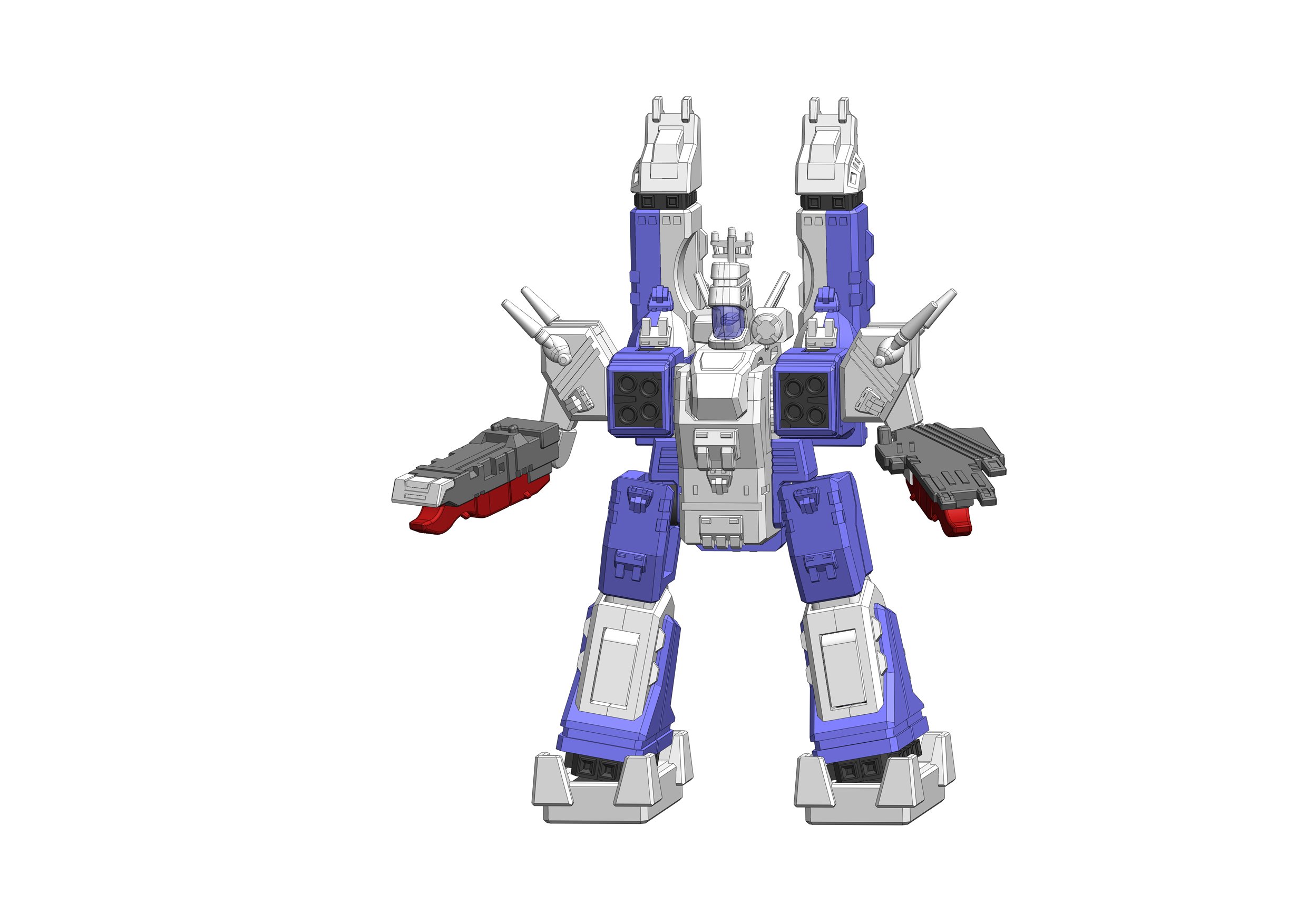

UN_MARINE Posted August 24, 2019 Author Posted August 24, 2019 (edited) 13 hours ago, derex3592 said: Hey, that looks great!! Thanks! EDIT: New feature! Edited August 24, 2019 by UN_MARINE Added pic Quote

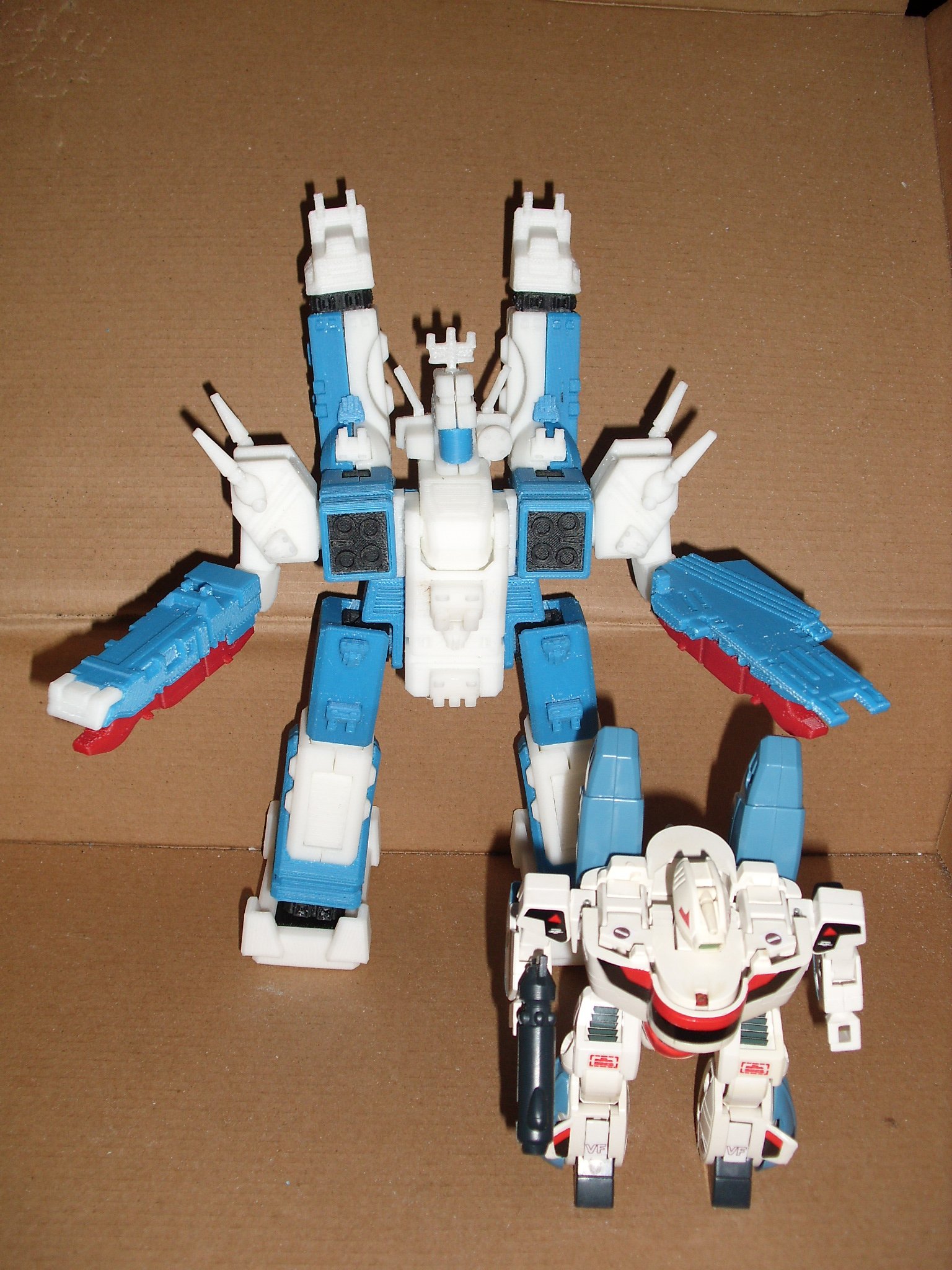

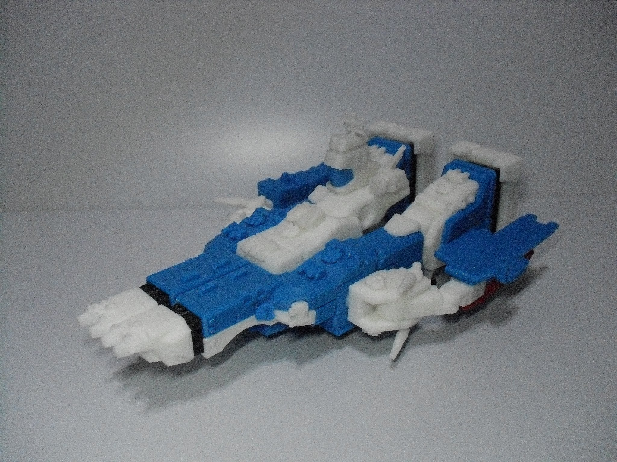

UN_MARINE Posted August 27, 2019 Author Posted August 27, 2019 After a bit of sanding, the parts fit a whole lot better. I can probably run a v1.5 print with improvements next week. Tiny Destroid Monster! Also got rid of the chest/cannon drooping in Storm Attacker mode. Quote
coronadlux Posted August 28, 2019 Posted August 28, 2019 That is very cool. You do work fast. Where did the Valk come from? Quote
UN_MARINE Posted August 28, 2019 Author Posted August 28, 2019 3 hours ago, coronadlux said: That is very cool. You do work fast. Where did the Valk come from? Thanks! I found the Valk at a local swap meet/convention, the box was messed up, but everything inside was complete, including the sticker sheet. Quote

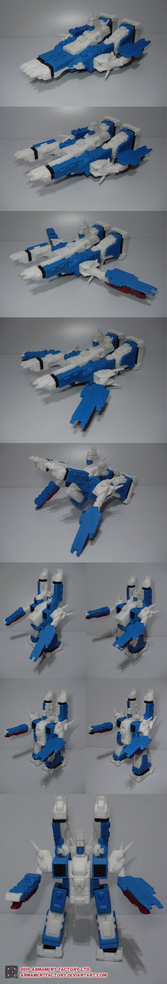

UN_MARINE Posted August 28, 2019 Author Posted August 28, 2019 Messing around with a composite of the transformation sequence. Quote
