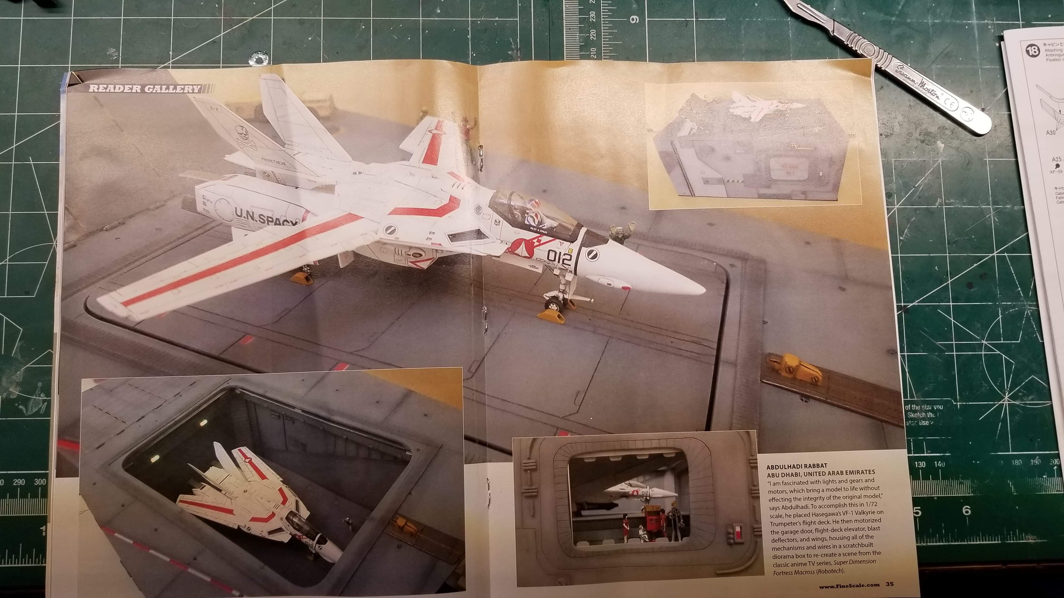

Thanks. I never thought I'd be a centerfold model... (Sorry, Dad joke).
Edited by arbit
That's AWESOME Arbit!!! I used to subscribe to them for years! I stopped because they rarely had sci-fi stuff in there. It would have been cool to see this! - MT
On 10/10/2020 at 12:51 AM, ulvdemon said:
Excellent build, any idea which issue this  is it in?
Pretty sure it is this months issue. I can't take credit for the photo as a mate of mine sent it when he saw the build. He's a member of MW but doesn't come here often.
12 minutes ago, Thom said:
Very cool, Arbit! You've reached 'Teen-dream Status' among your fellow modelers!
Hilarious. Keep the 80s jokes coming.
Gen Z members are now Googling, "What's a centerfold?"
Edited by arbit
