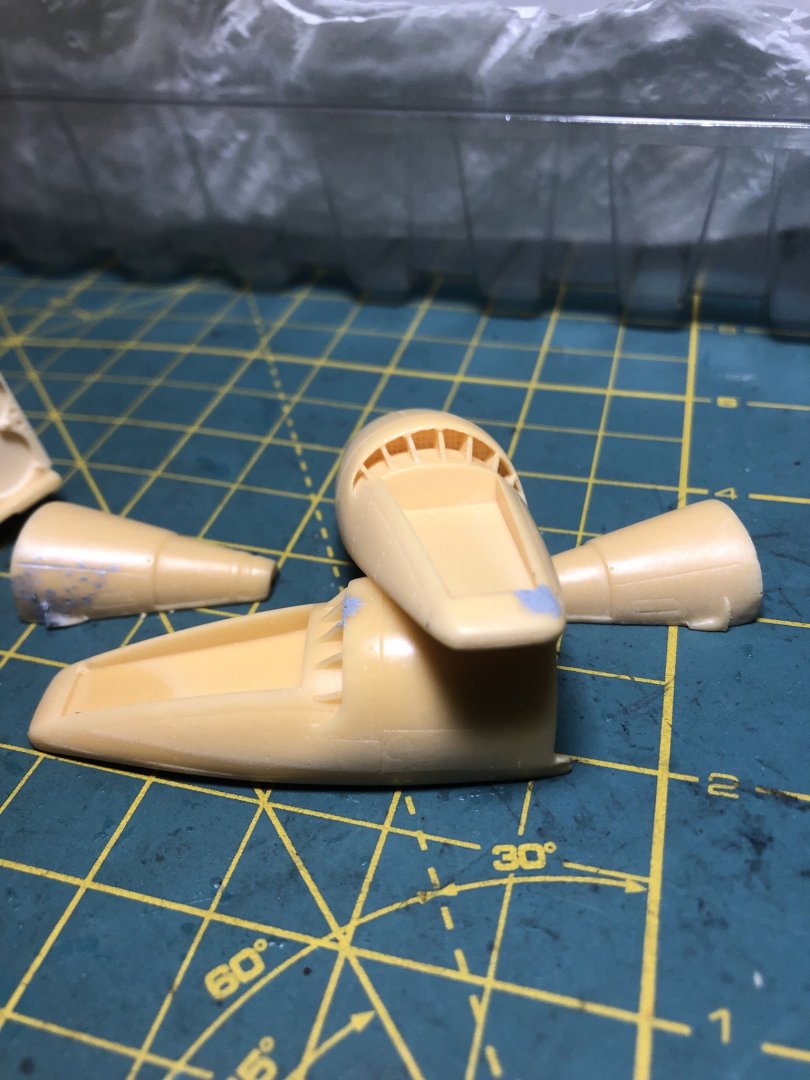

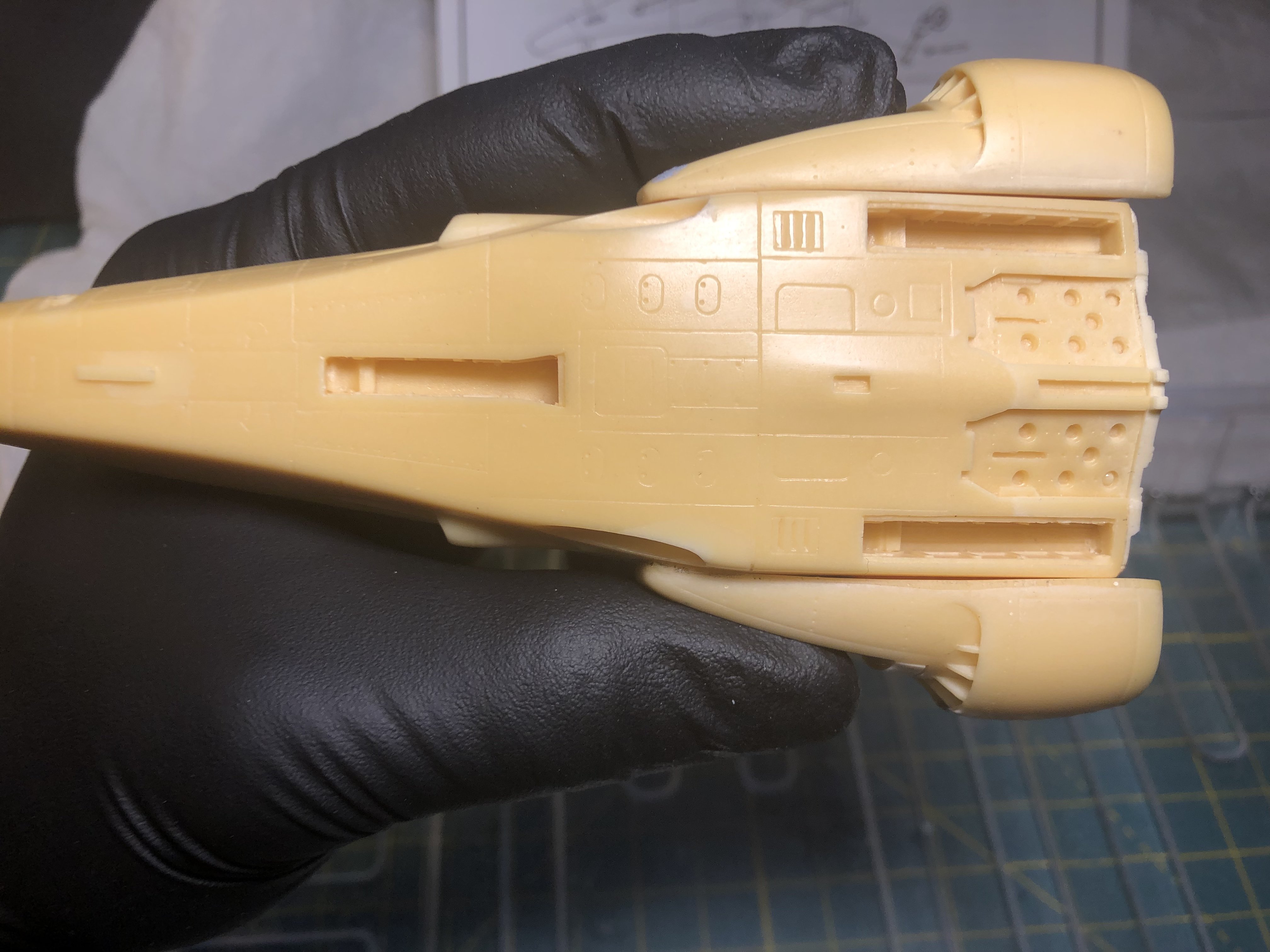

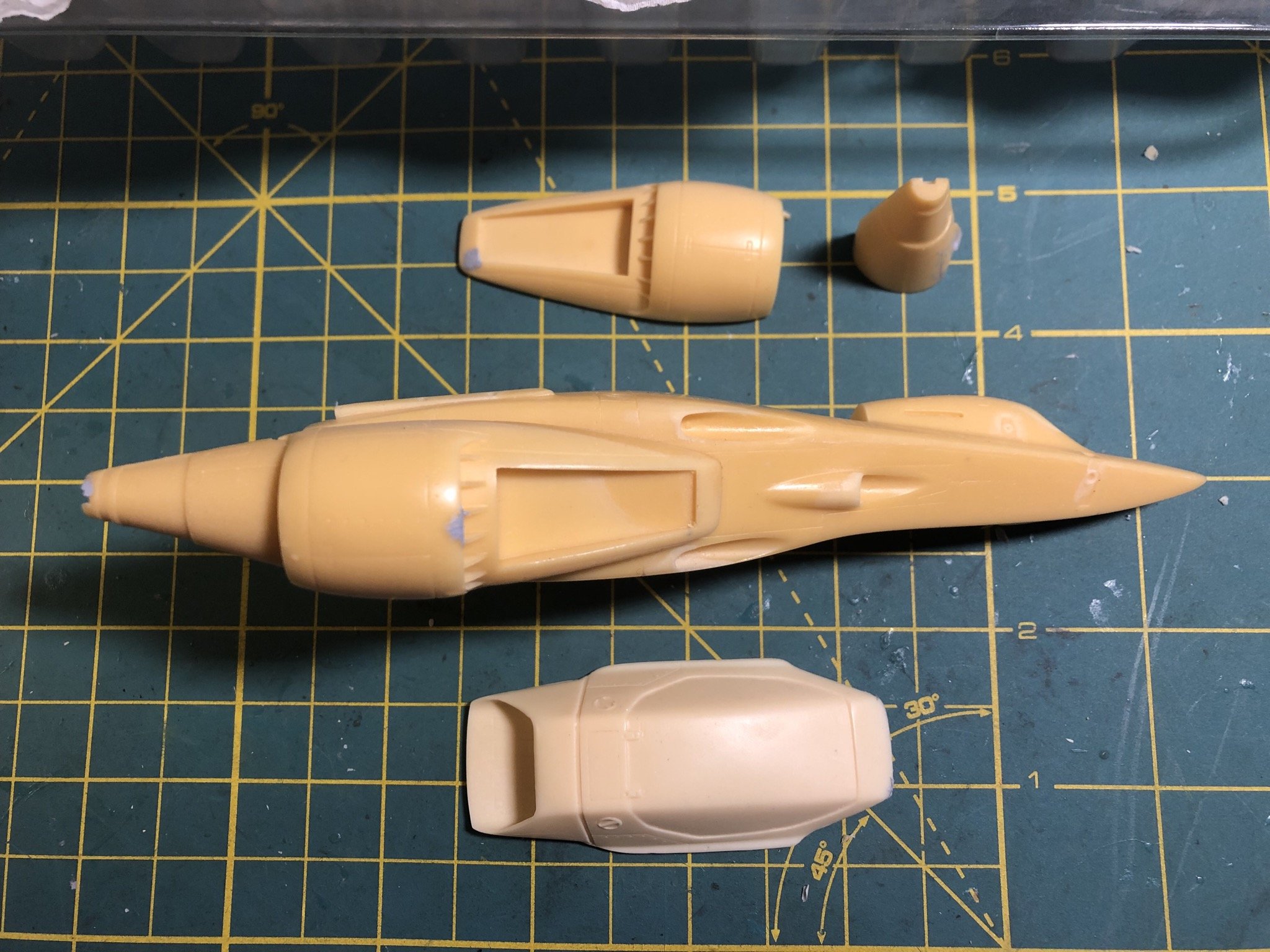

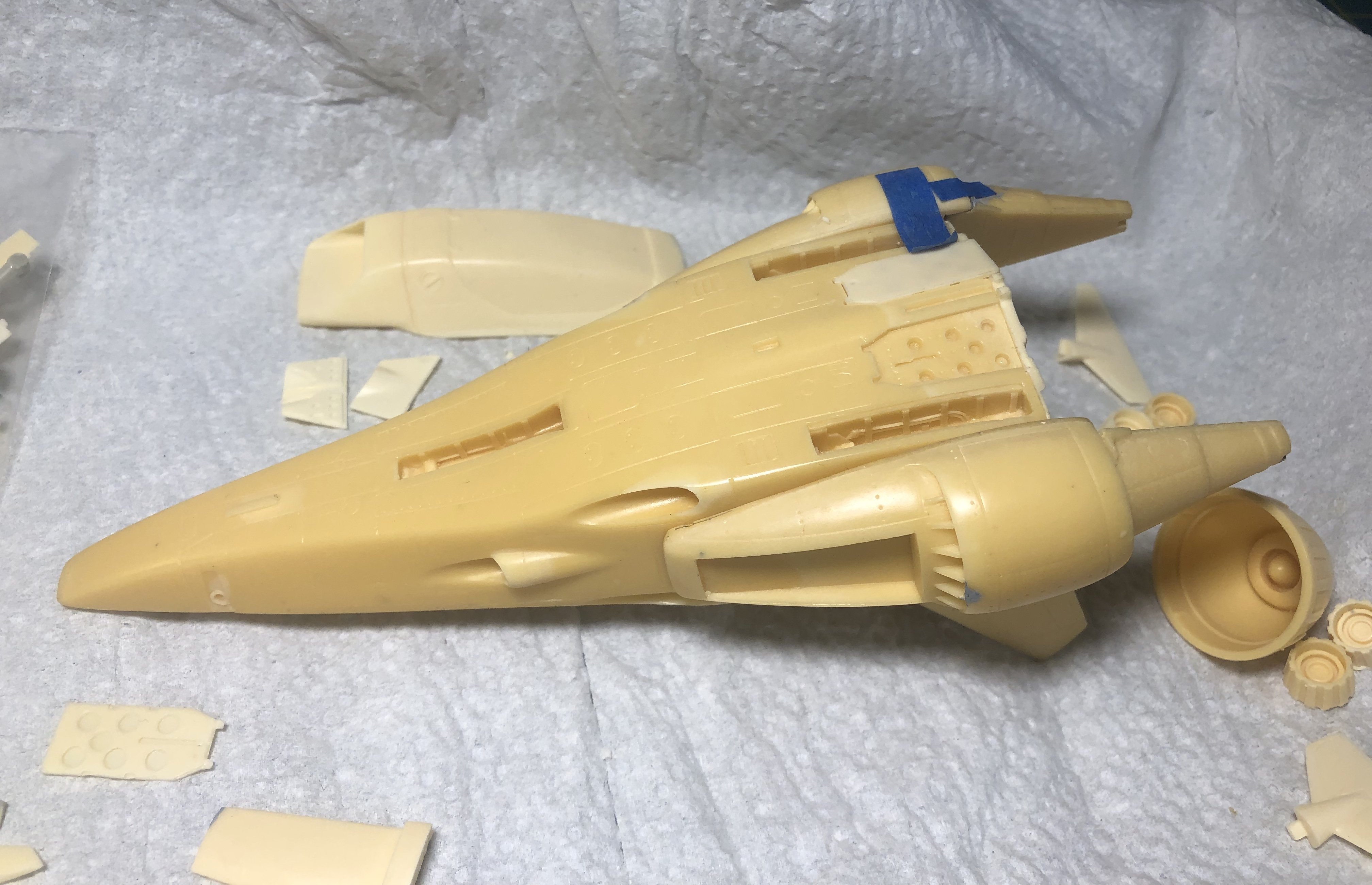

Did some of this today, as well..Some cutting and tamiya epoxy fill on minor air bubbles and voids..

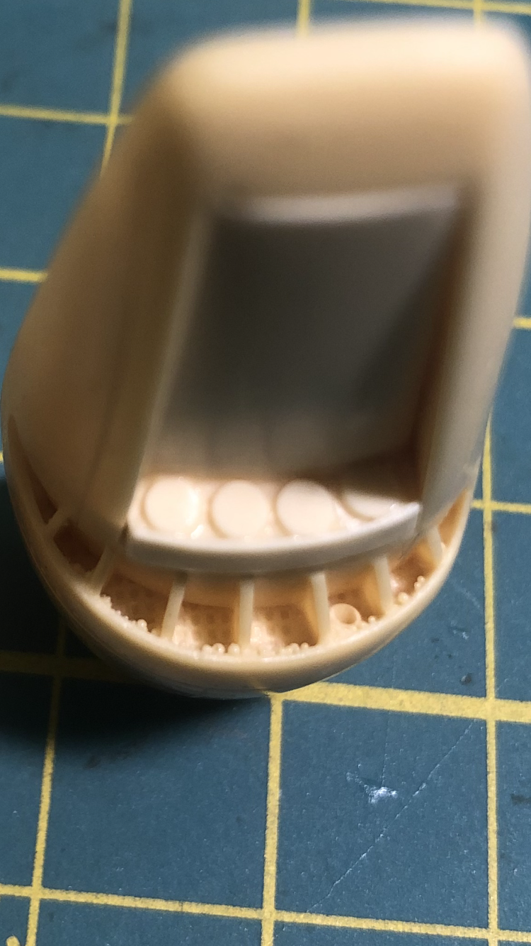

These lovely Engine details are all buggered up with resin balls!
Those are missles you’re also looking at..
Much better..

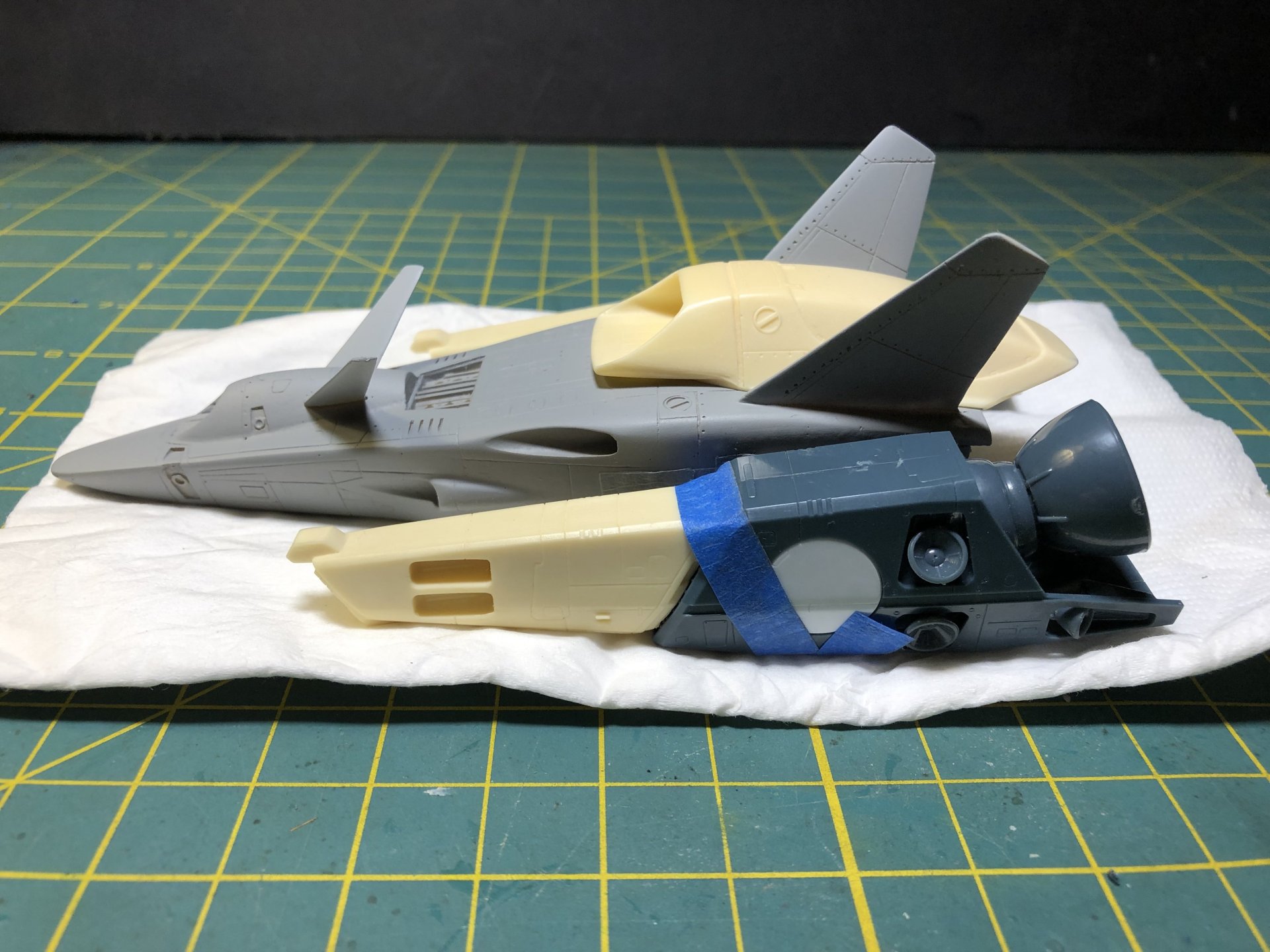

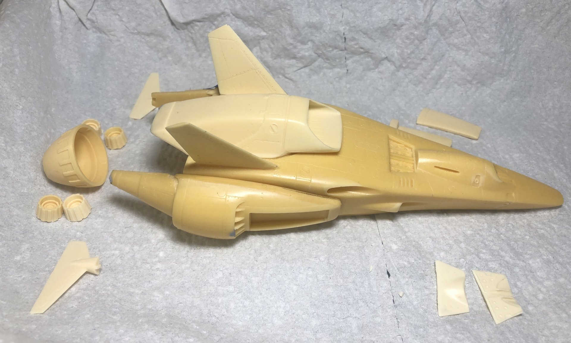

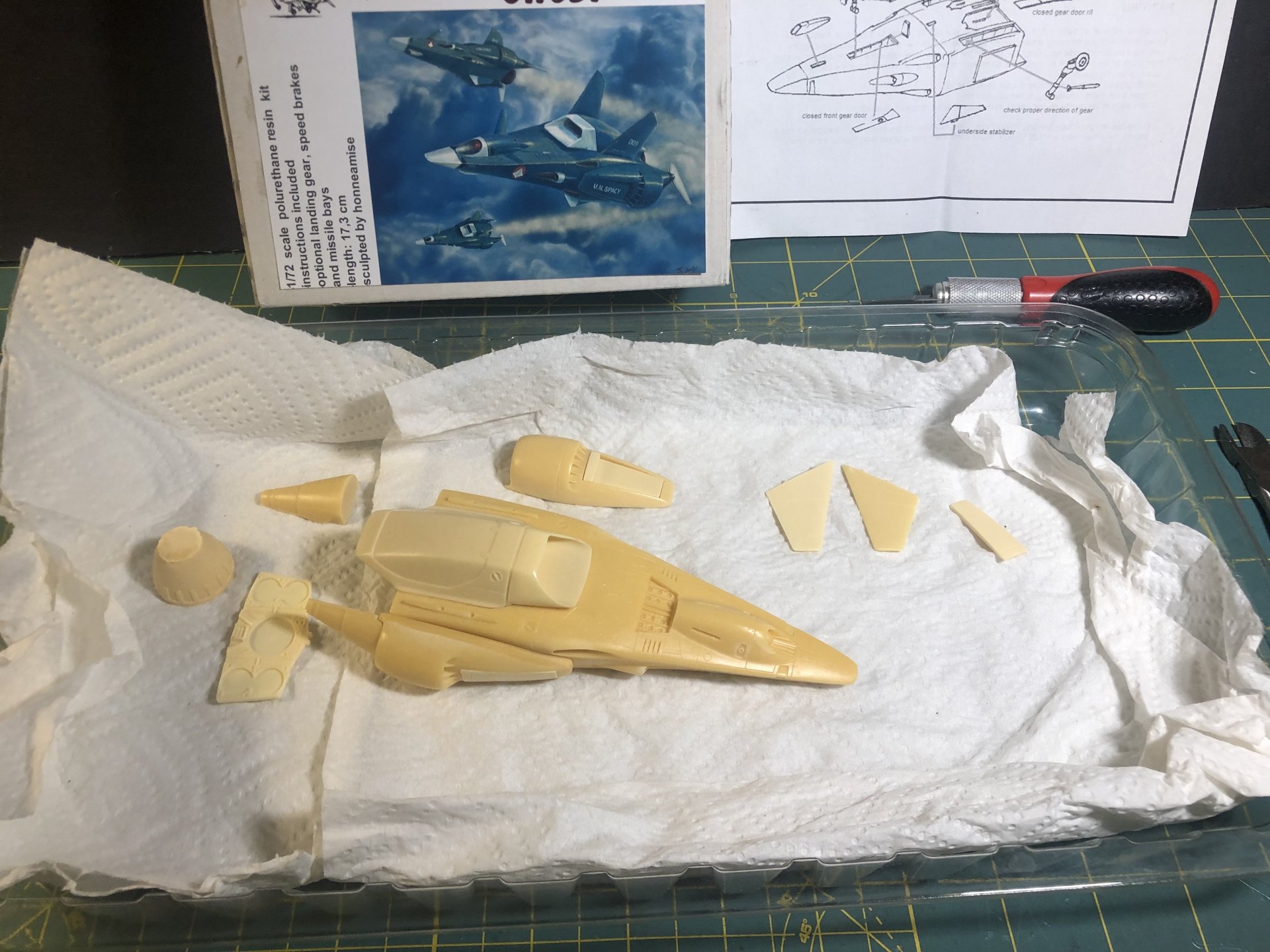

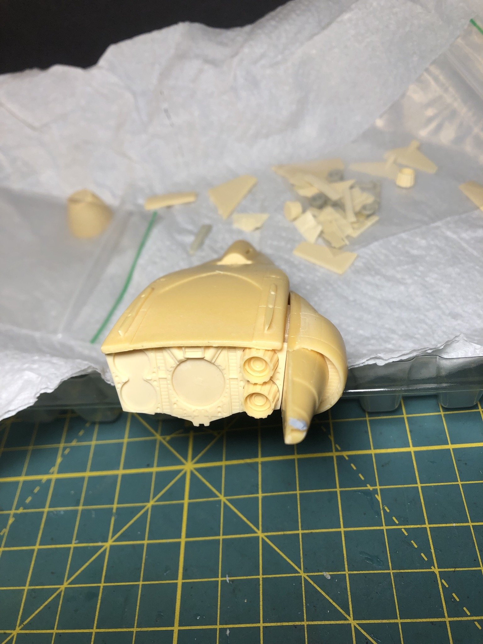

More dry fitting..

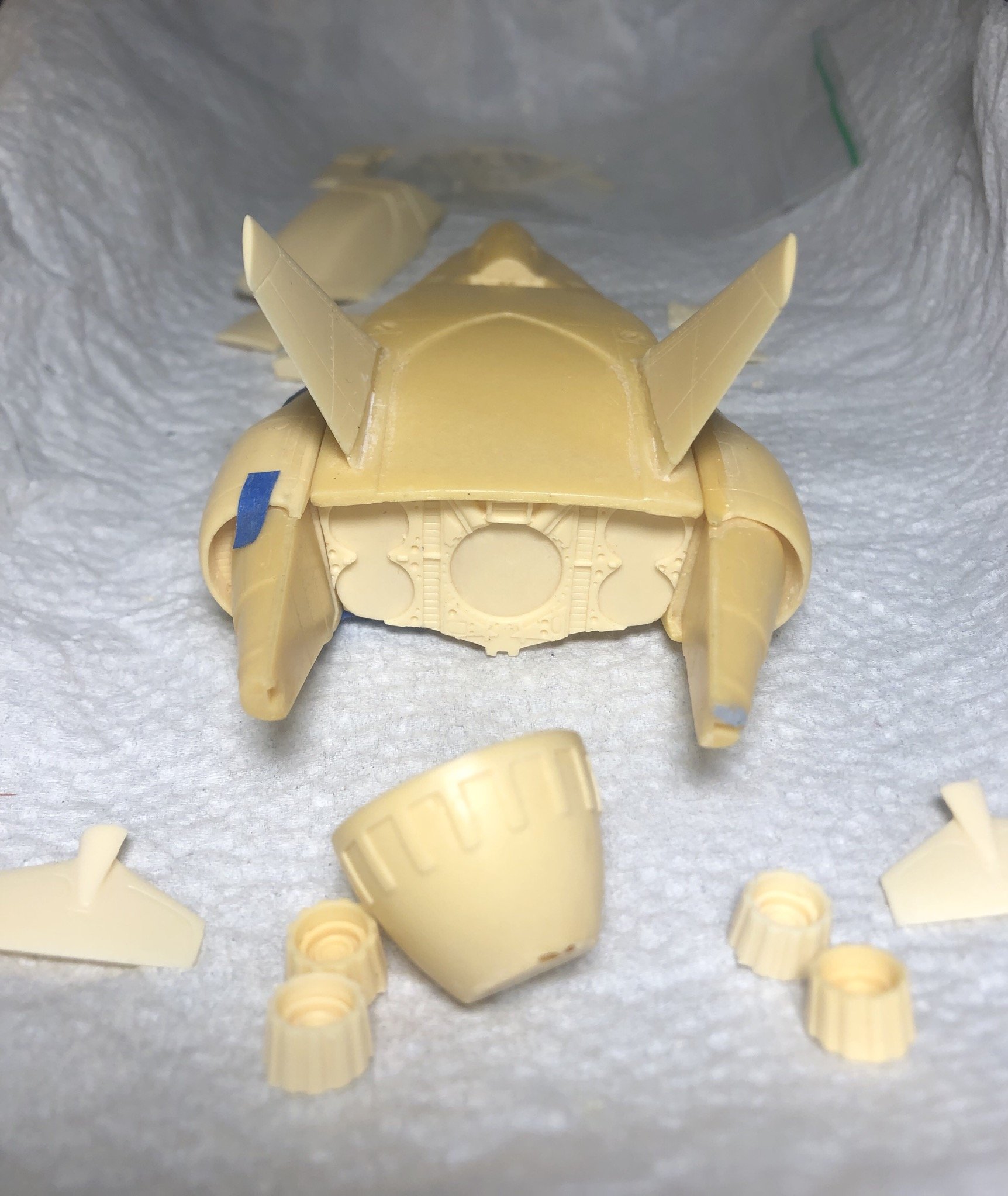

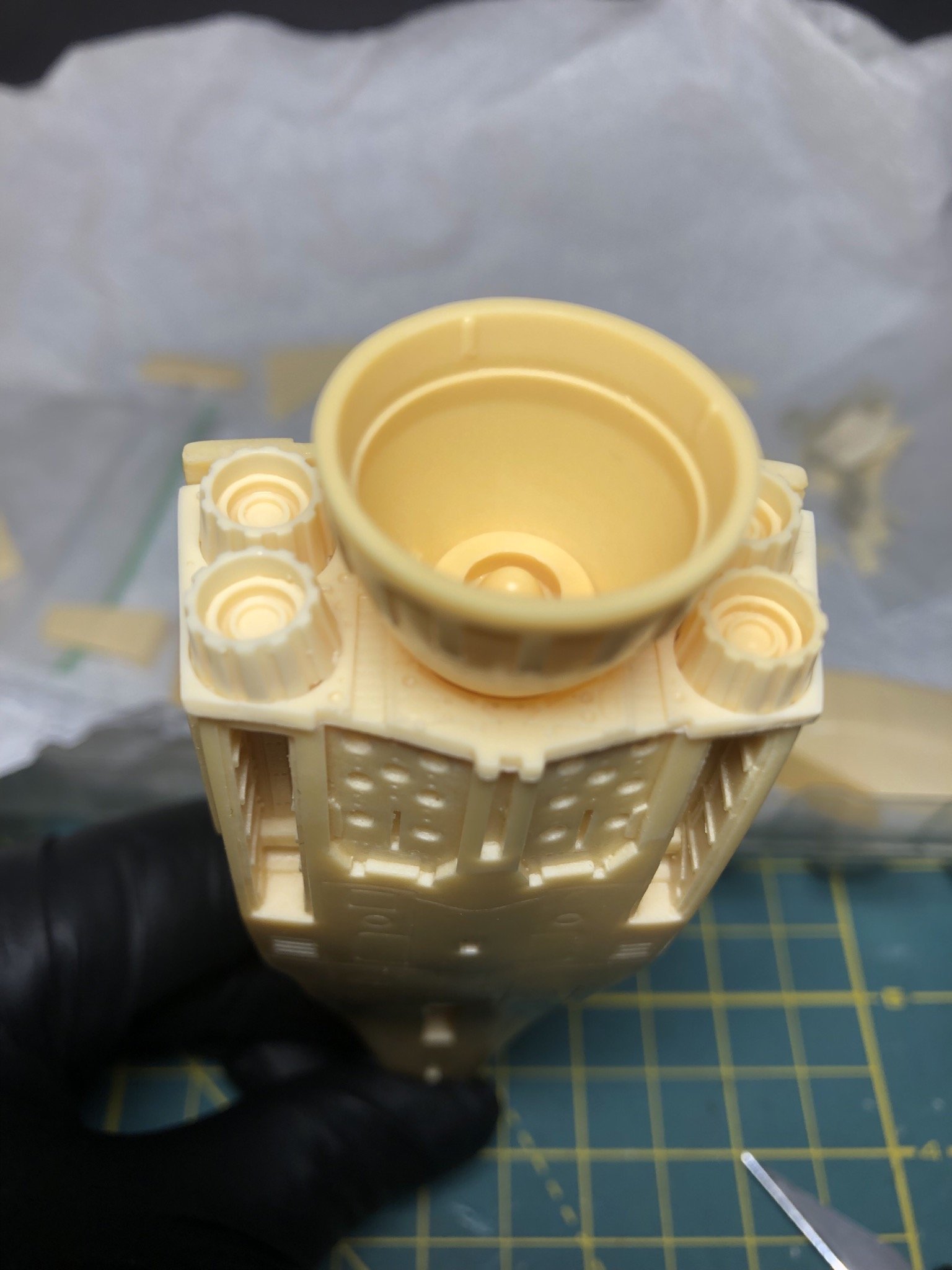

And problems.. the back piece, which holds the engine nozzles is a bit oversized . Once nice, tight joints between the lateral thrusters and the main fuselage are now huge gaps, I don’t want to deal with filling..
Though there’s not a lot of tolerance,  I’ll trim the edges of the back plate and lose some details. But I doubt it’s going to be noticeable with all the nozzles installed and the lateral engines attached tightly.
..And the details are lovely!

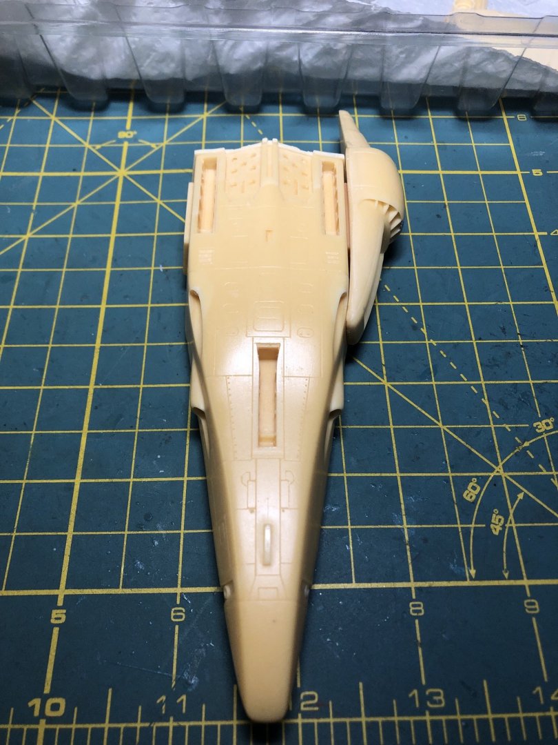

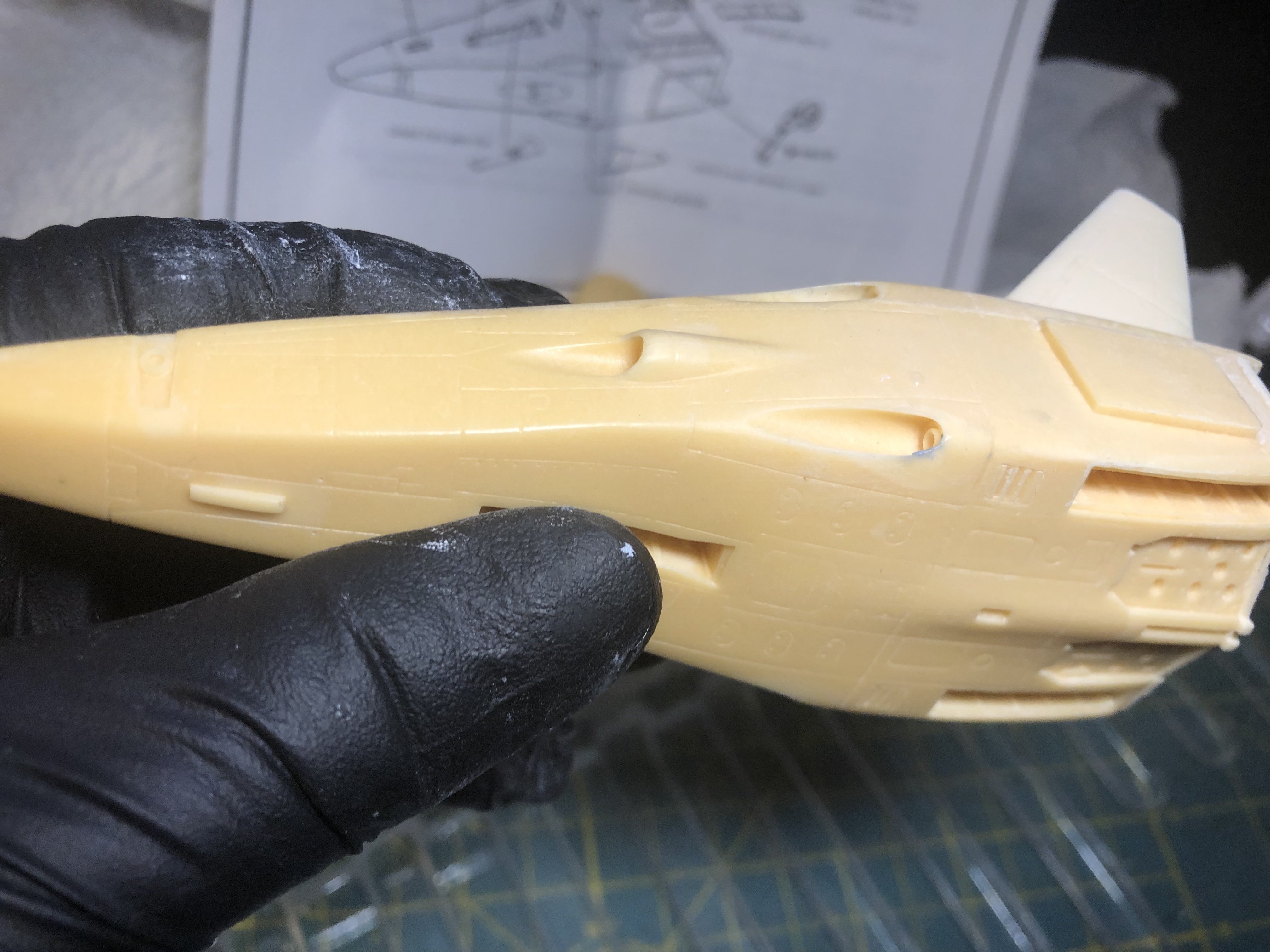

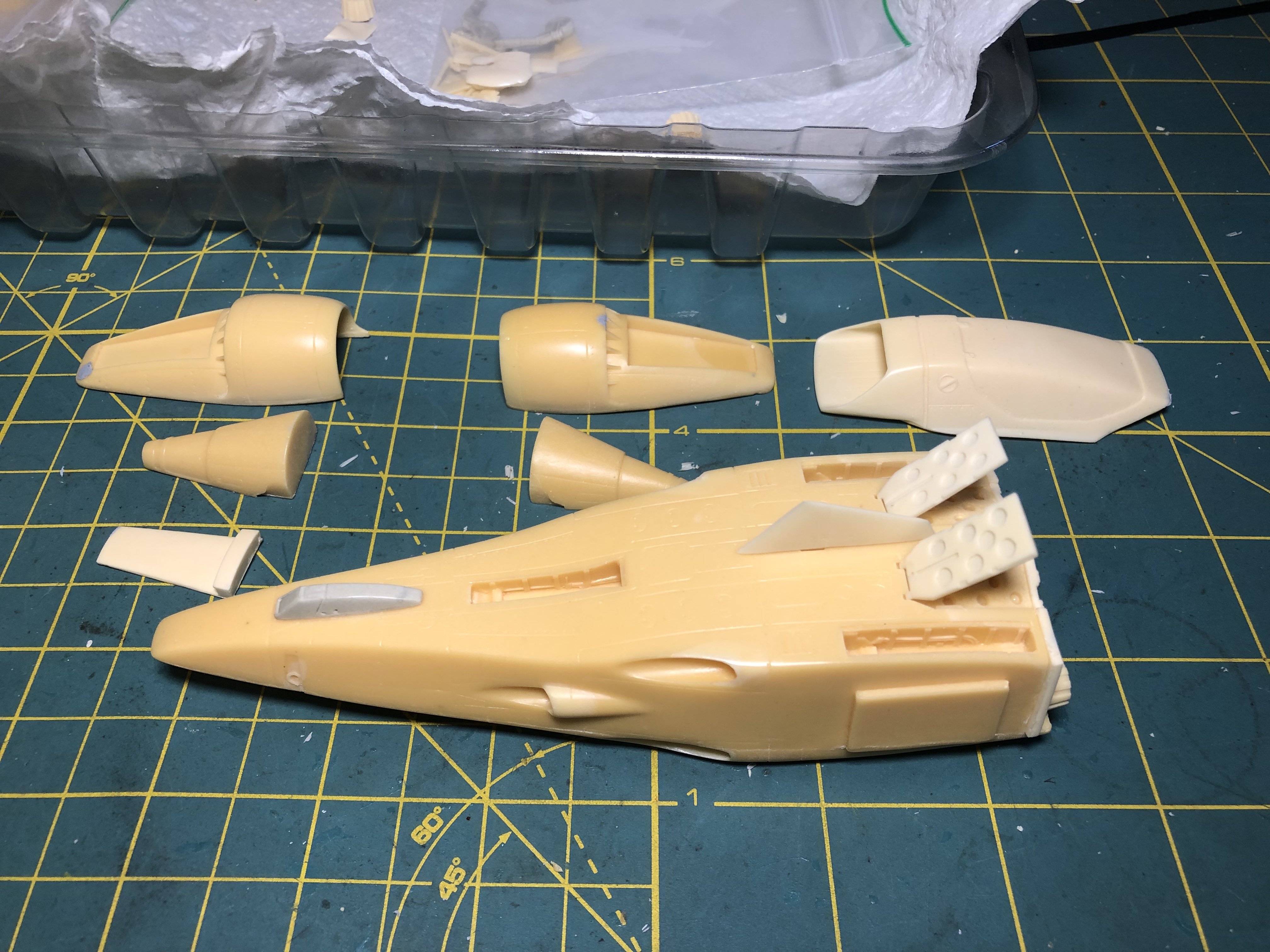

Speed brakes on the underside fit so perfectly snug, they hold themselves open. Though it looks cool , I think they should be turned with the circles facing in. The underside sensor pod is a softer resin and, seemingly rougher around the edges than everything else..
Edited by Bolt

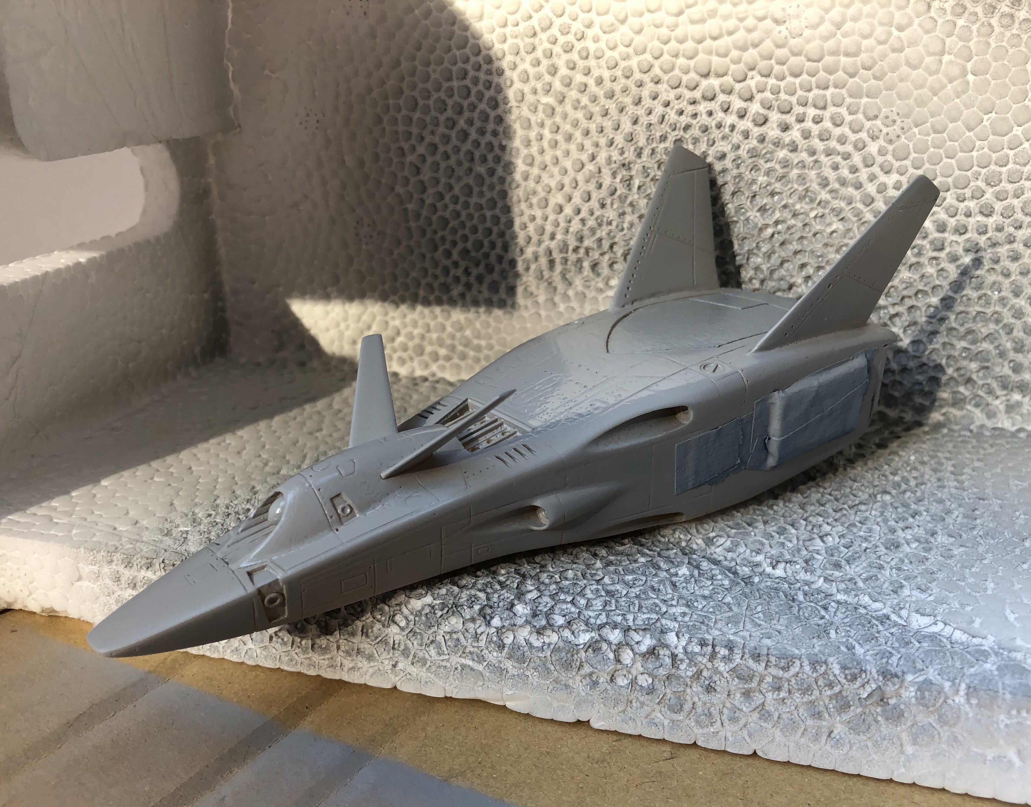

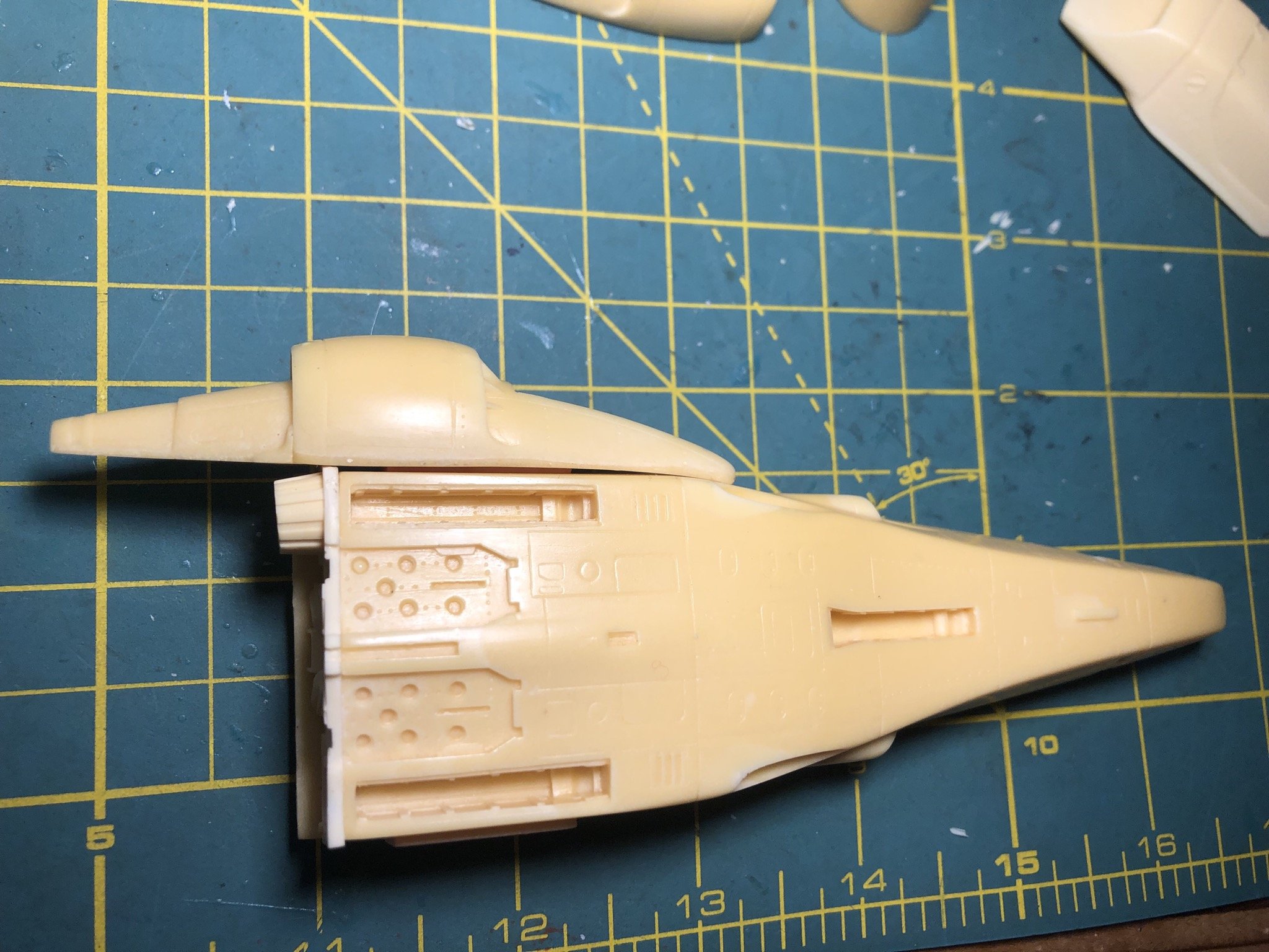

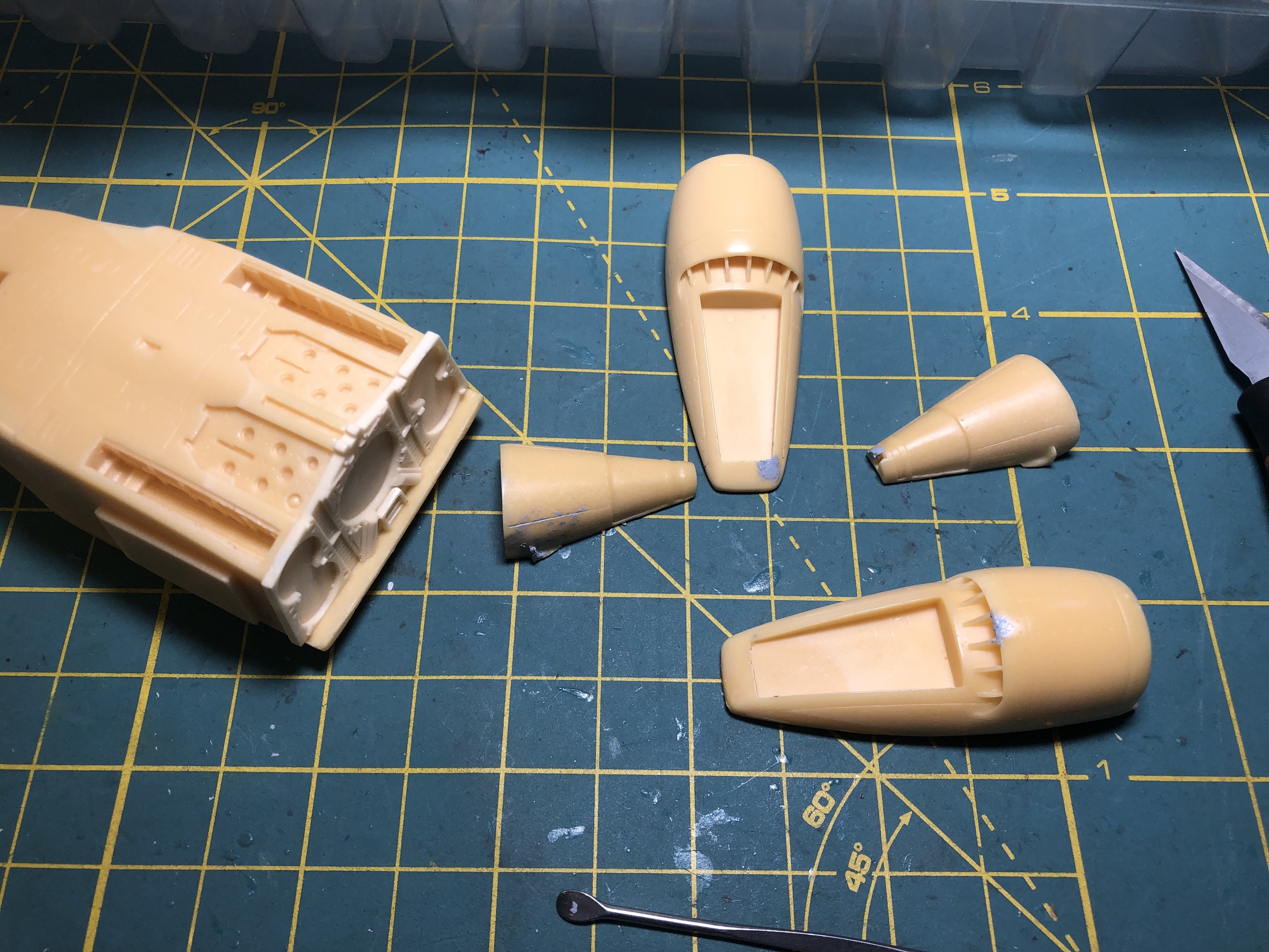

Trimmed the back piece..glued vertical stabilizers on and some more test fitting..the side thrusters fit much better now..
Again, the speed brakes(one test fitted proper side out) will need a little sanding but this one fits perfect  out of the baggie.

Been a month. Starting to have more time.

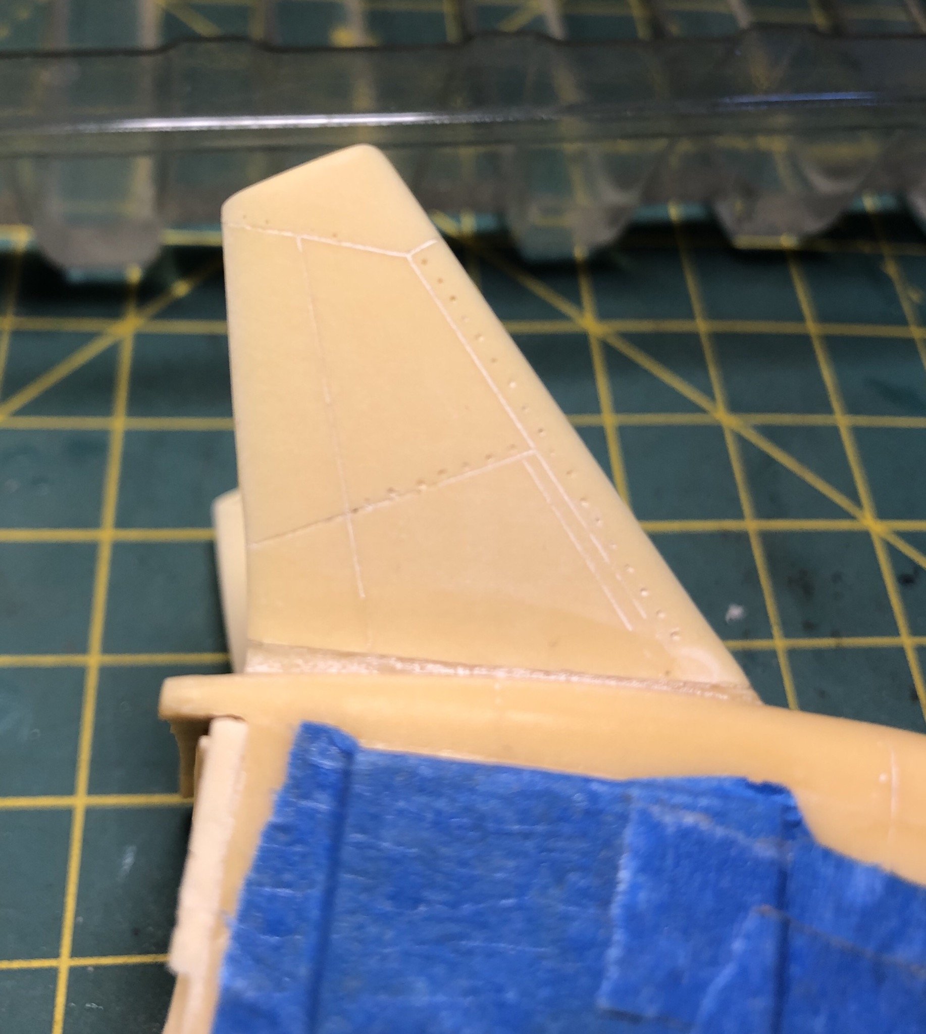

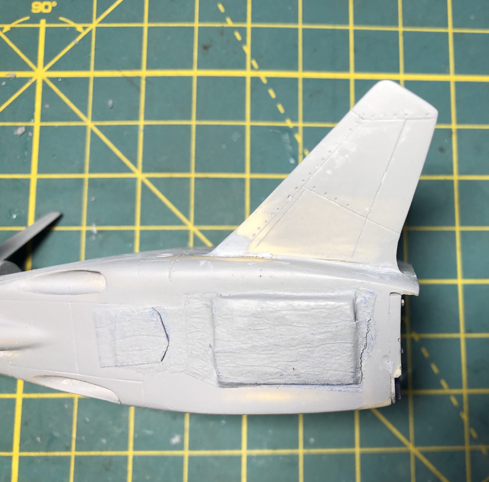

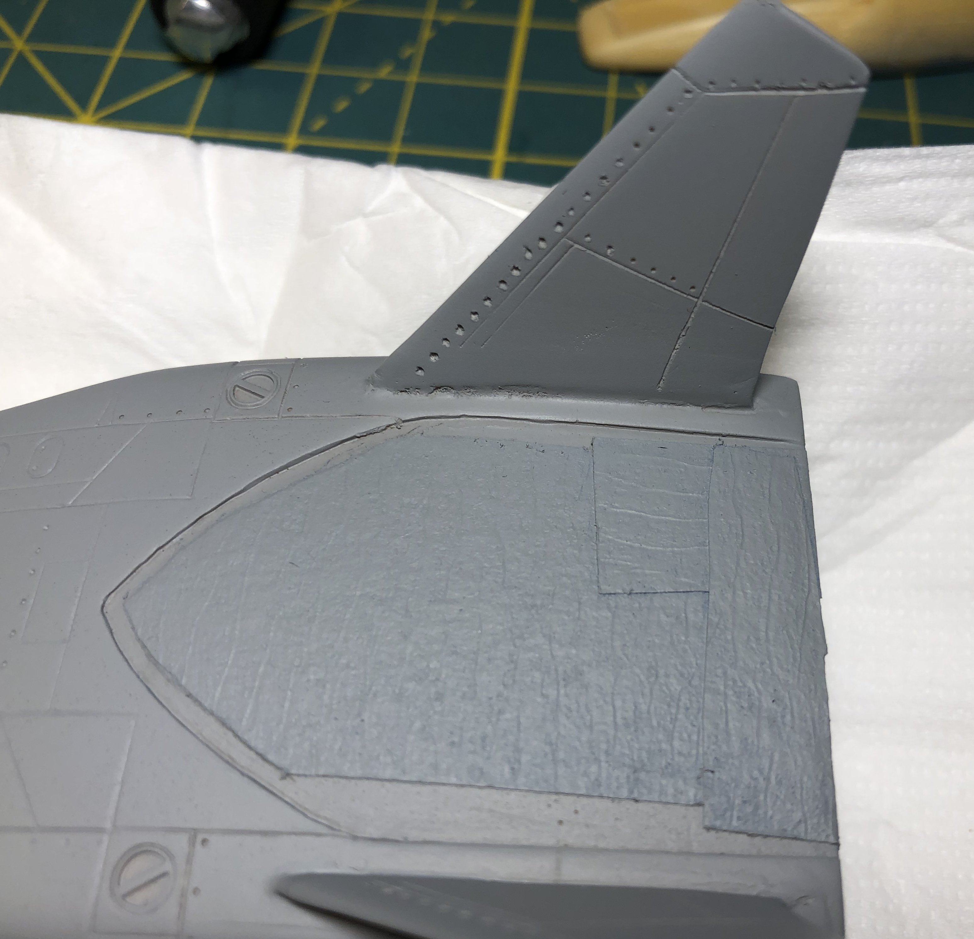

Filling and sanding the joint at the vertical stabilizer..116C01C0-221E-4BEF-A5F4-C388CE383EC5.thumb.jpeg.6b804d74642f7f3a4f4228f64ba2d63f.jpeg

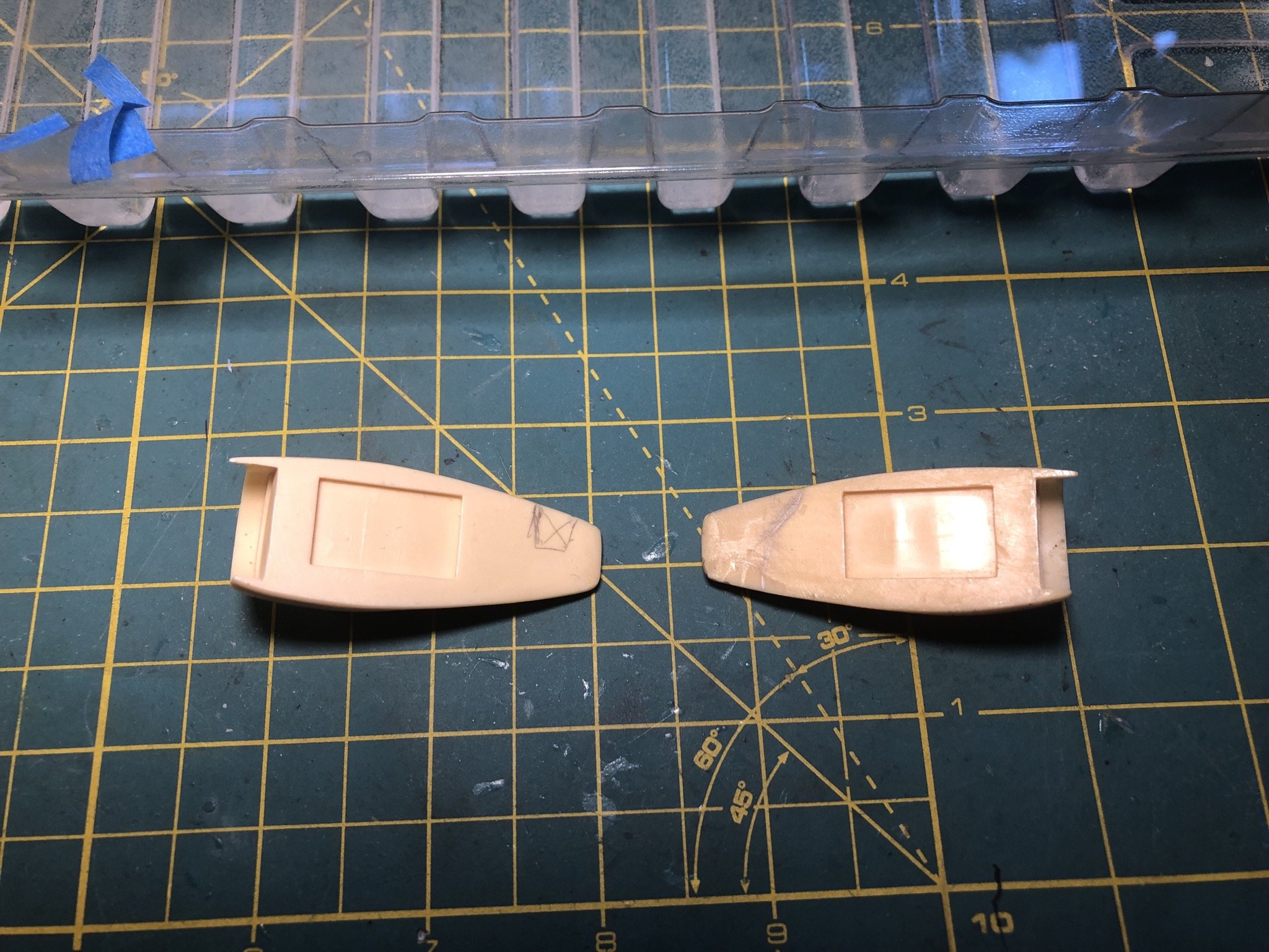

Ever so slight gap remaining between the fuselage and side thrusters..
75D8C0B2-D20B-4C8D-8B79-E1B6BD7A4873.thumb.jpeg.3d32b0d018d59f240d71666e00b51293.jpegC4085E41-4141-451A-85EF-4F287D7646BE.thumb.jpeg.6103df0f91ea4a89d03e5cb17ab9cdfa.jpeg
Mark areas to be cut with pencil and start hacking..6D363C5B-C759-4FD4-893E-D71FF7BAD432.thumb.jpeg.fc3aa12eb1f3033bc7eecb4378dfae1a.jpeg
Until it’s good.. then a little sanding and see how it looks..4E4CF276-7E37-4DC9-8818-EAEA00E6EDE8.thumb.jpeg.2fc98dd328af79bb2a8ee7084a2e78c7.jpeg
And a little more Tamiya putty in a few tiny holes and voids..02012B5F-54E7-4DF9-B54C-6D1C9B7F9646.thumb.jpeg.c5ba2ef58deaf9728a96aa3c5ebe294c.jpeg

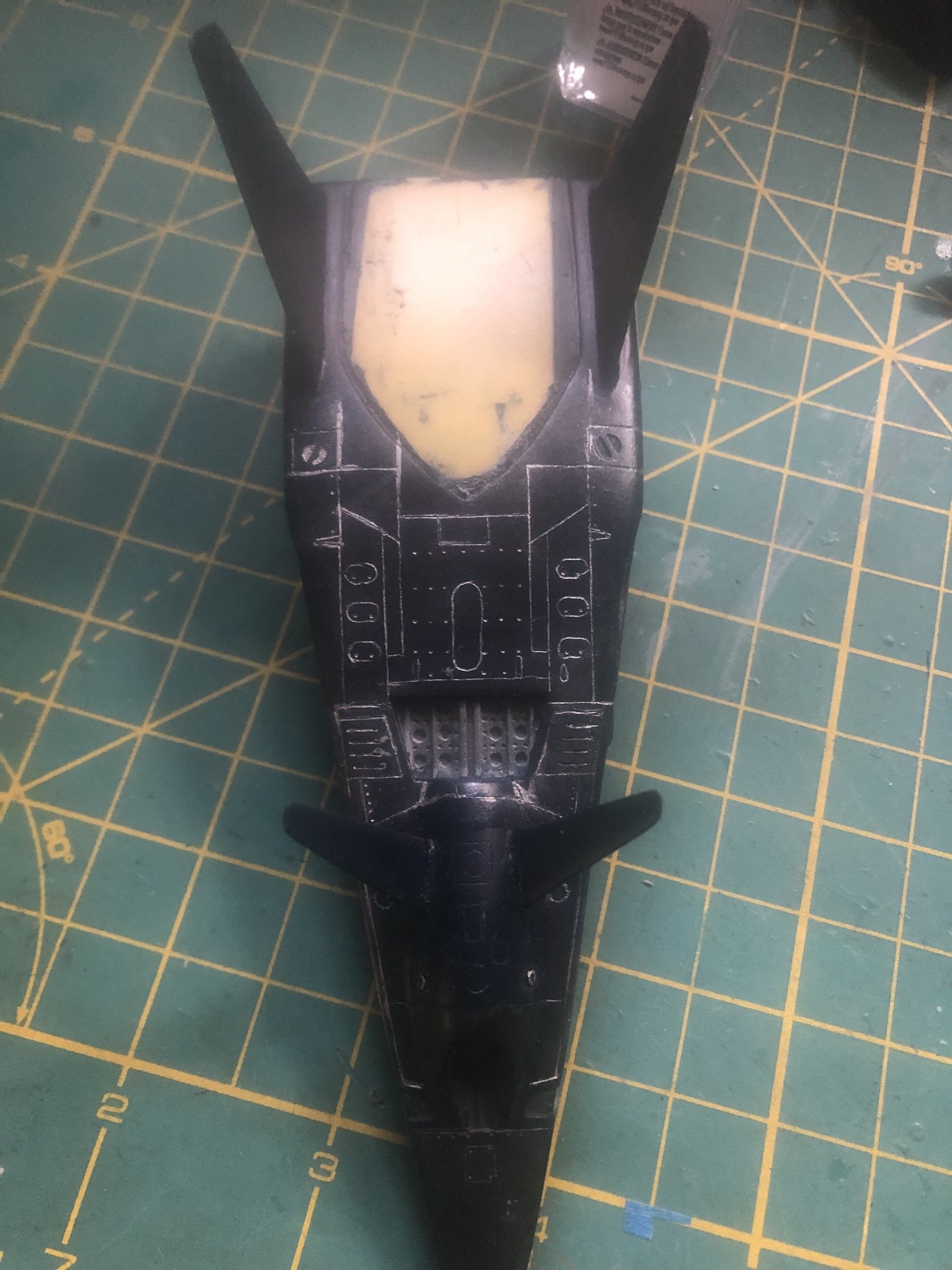

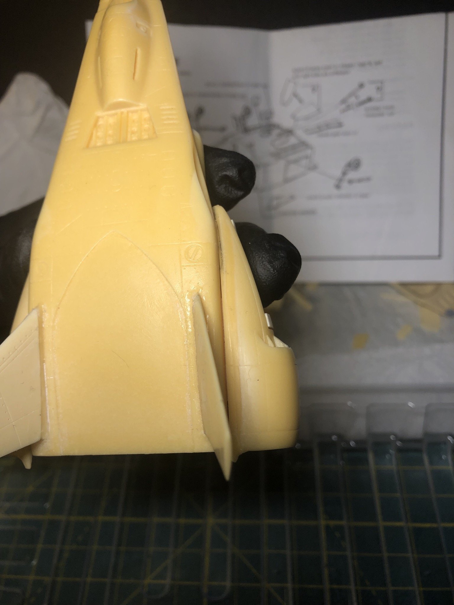

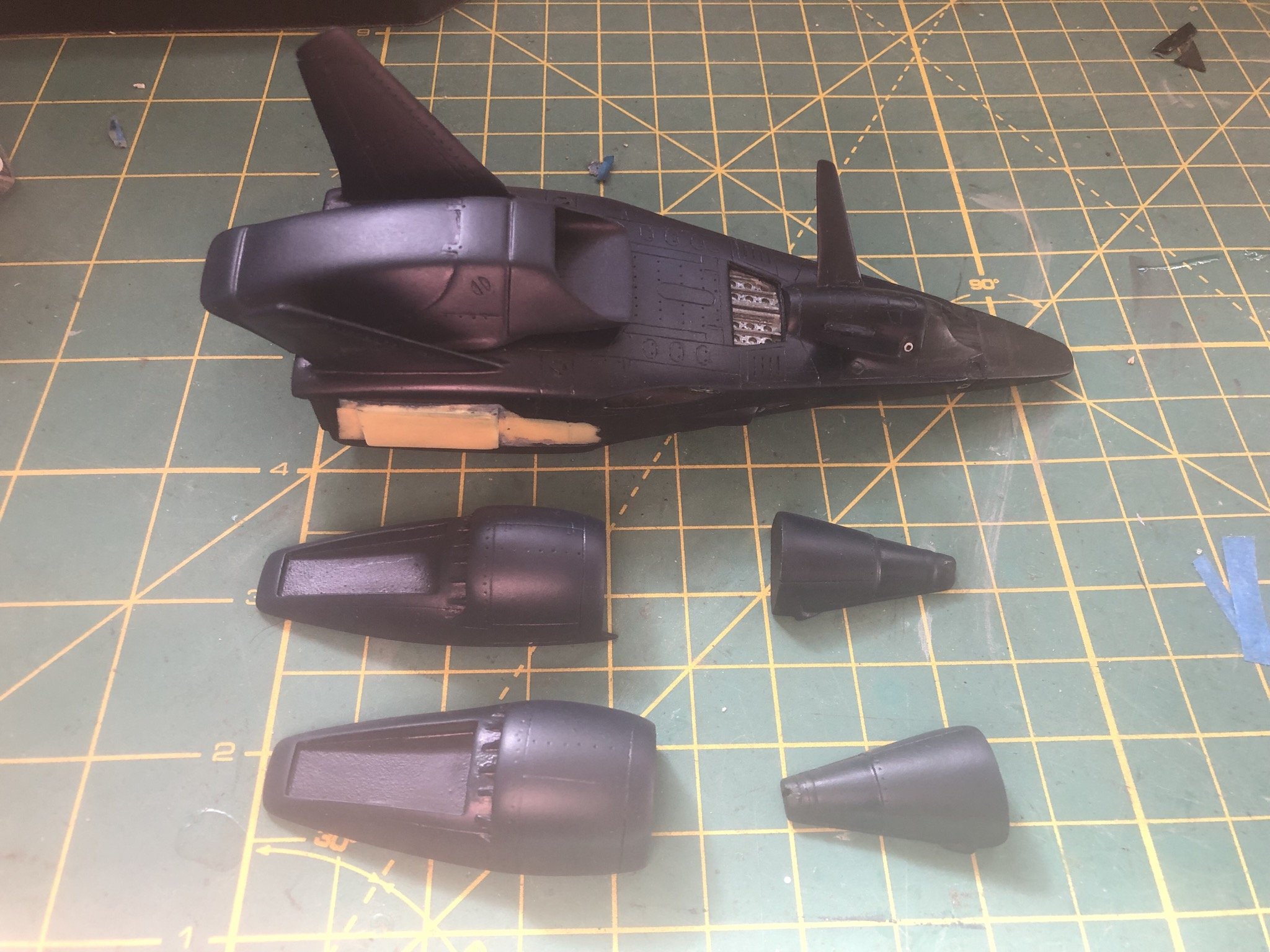

Everything looks like it’s lined up ok. 017F270C-7622-4E7C-83F5-EFFAA2C9D217.thumb.jpeg.21c891a89be3badde4f9cef6b24d58e4.jpeg
I’ve Sanded various areas with magnification but I’m still having a hard time finding the inconsistencies I know are there..5550B3E6-BBF9-47C5-9F48-EF59E3458573.thumb.jpeg.f6f2ccccaf82a4f26e326134174697a2.jpeg

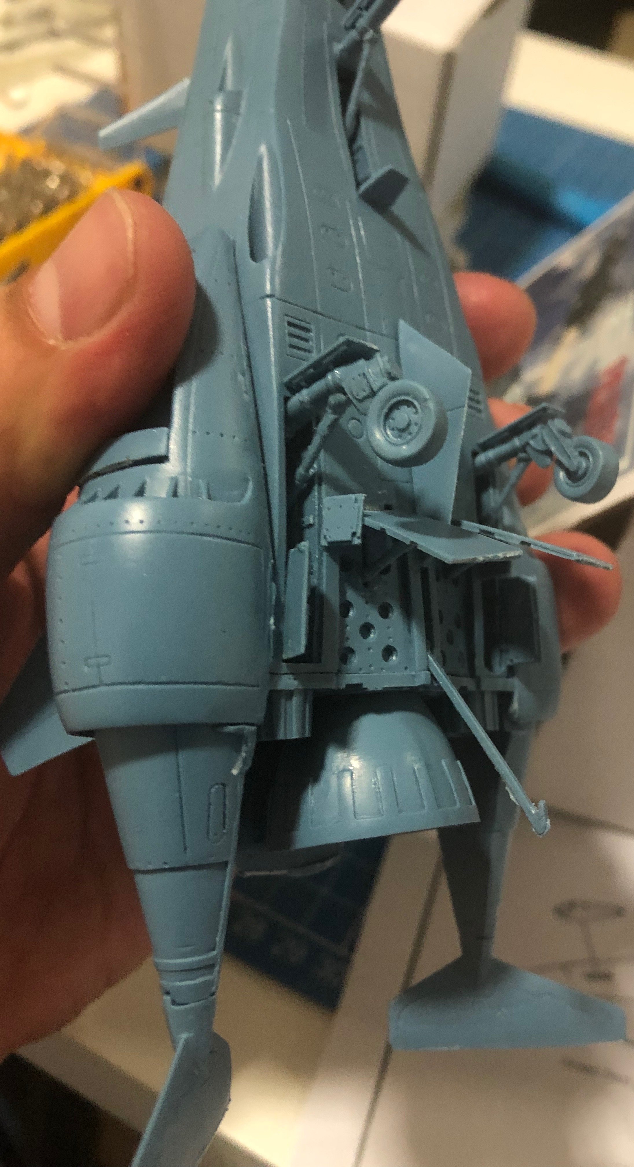

So it’s time to primer.. paint reveals all..

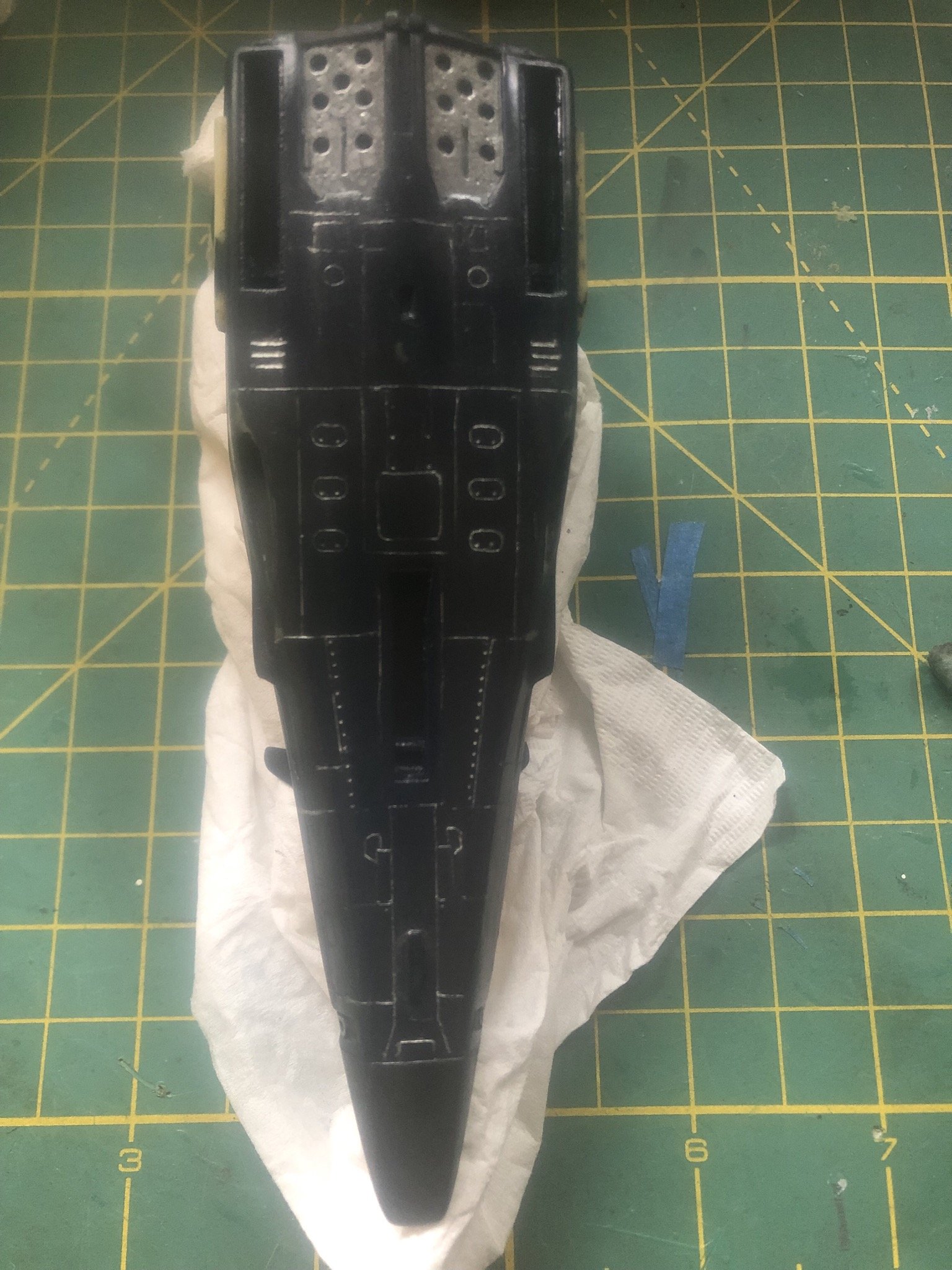

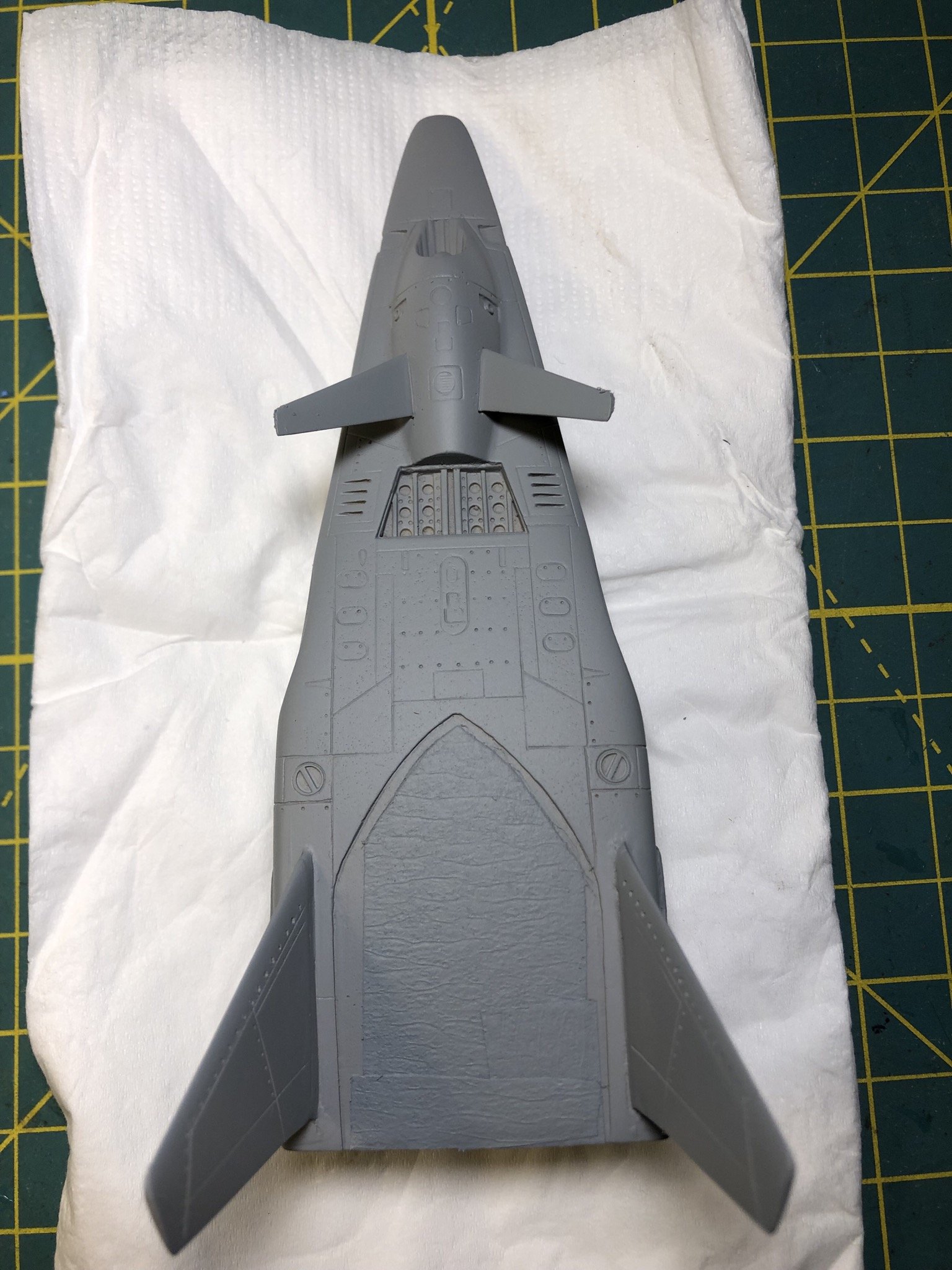

And everything pops out..now I can see what’s going on! So I start to obsess over the vertical stabilizers..lol !  I don’t like the transition from fuselage to stabilizers..front and back..
So I work it. And rather than the line art accurate straight lines, I swoop the back end a bit and slightly extend the front end. It looks better to me..

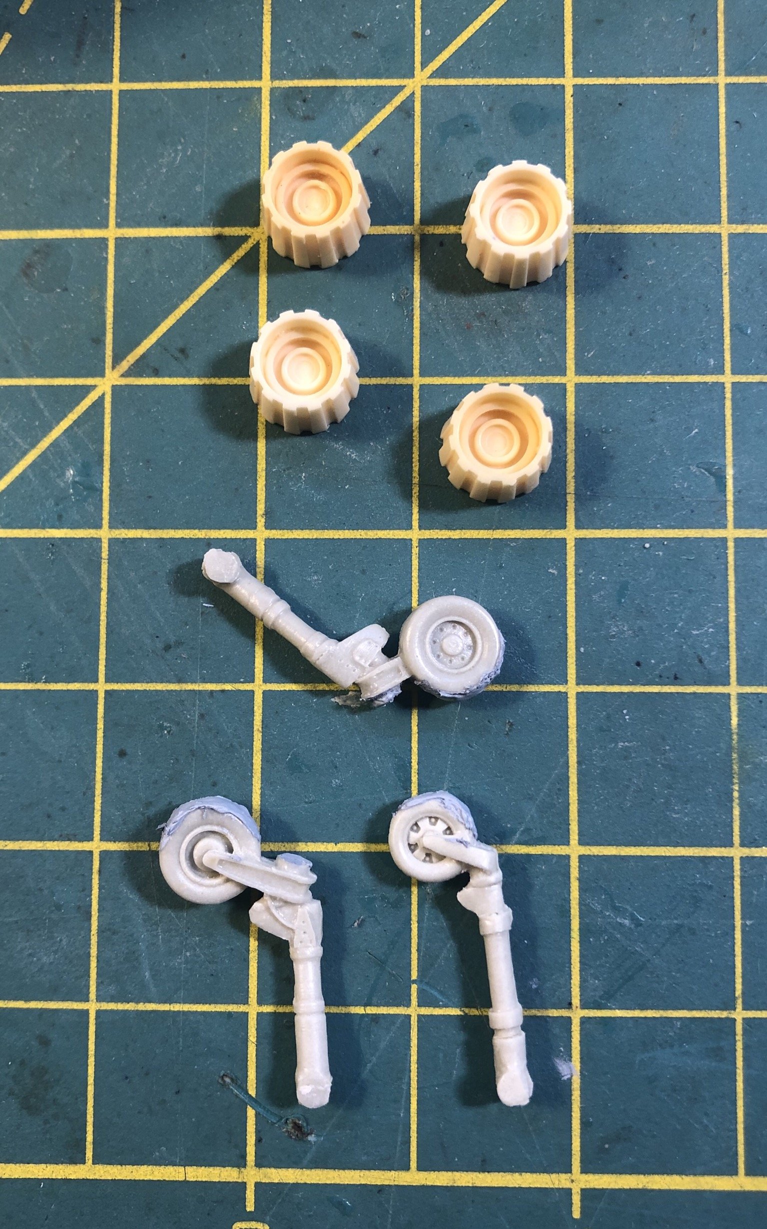

I’ve been working on the tiny bits..some cleaning, sanding and filling and shaping. The landing gear is made of softer resin, like the underside sensor pod. And the quality isn’t so nice as the main bits. There’s prominent air bubbles and the wheels look a little miscast, giving them a wobbly look. So I smother them in putty..4E1A0228-6CAE-468C-934E-3007A007ECC9.thumb.jpeg.995365b4032c994c447474d6ee371b8c.jpeg
Also recutting some panel lines here and there. It’s slow going and tedious ..

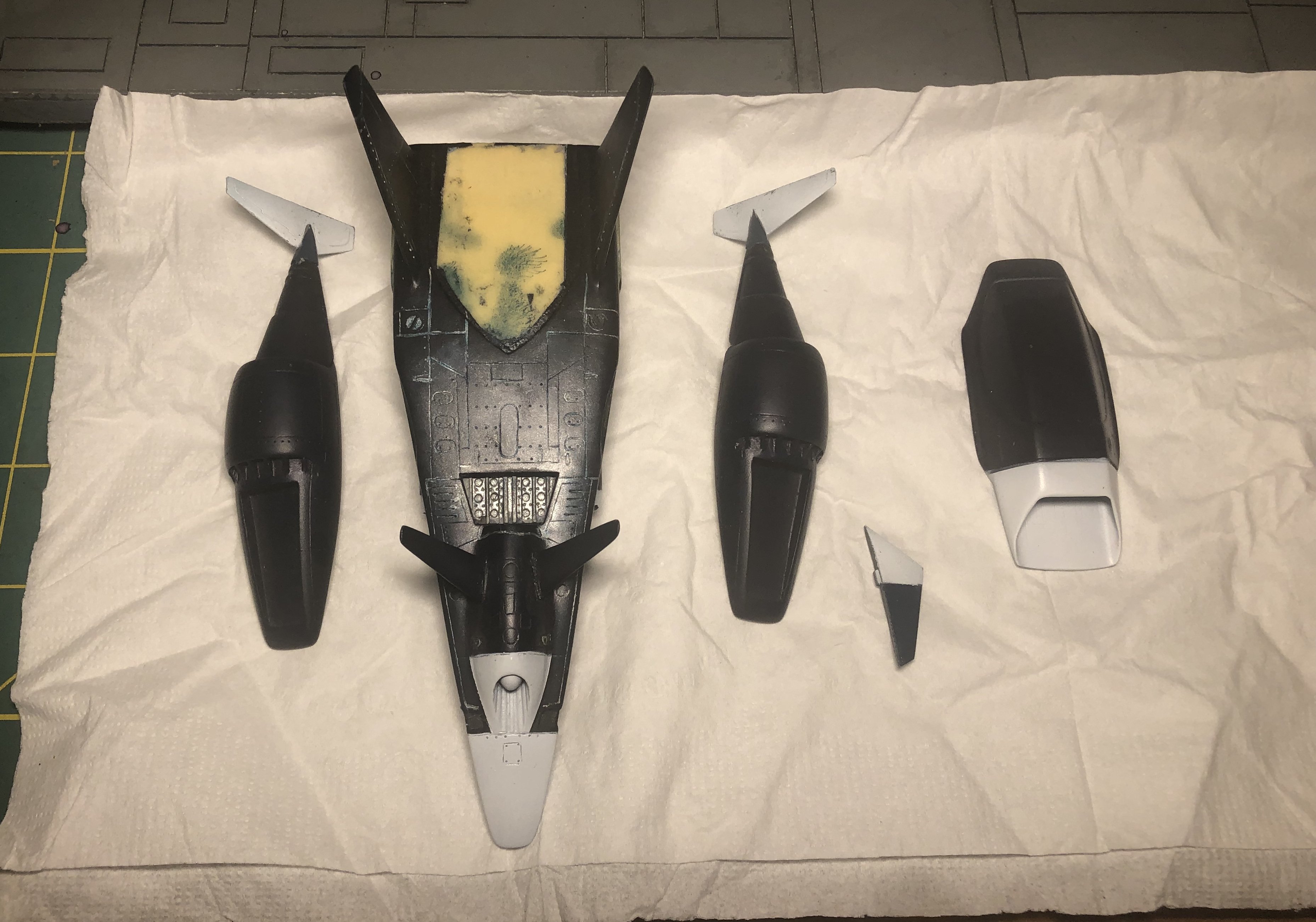

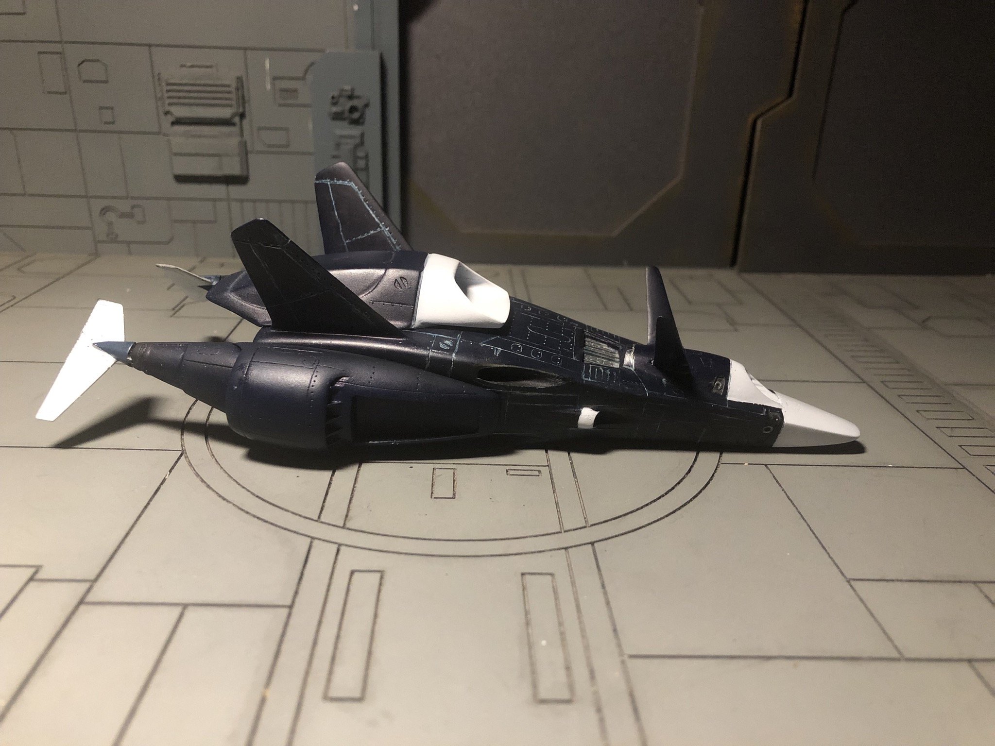

Ok, sooo.. here is the latest progress on this project..bean very focused on the Armored VF, but that's nearly complete and I'm putting time in over here..
The main upper intake still has the masking tape inside, got to finish the "red eye" and surrounding port..
The side thrusters need panel lining , over all needs another light round with the white, some dry brushing , detailing and weathering , a clear coat, bit more panel lining , another clear coat and decals. Oh ya, landing gear, air brake, side panel missile launchers attached, etc., Lol..
See you next Deculture :hi:

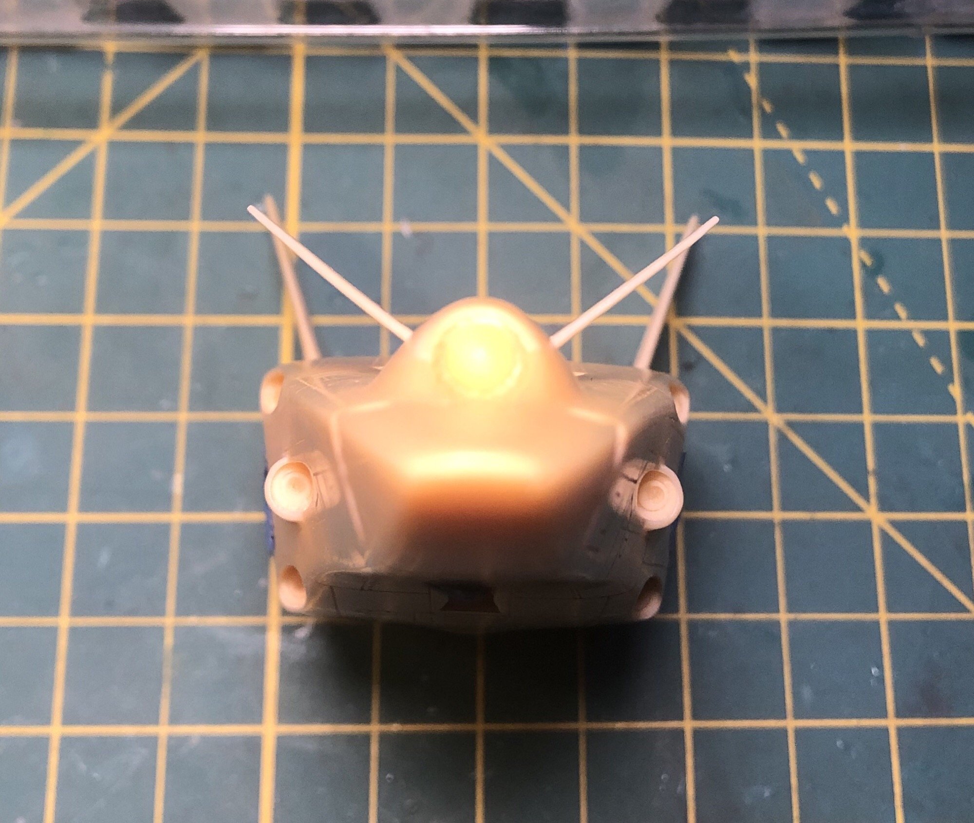

Thanks amigo:) ya , using a clear eye with an led would be the best. The rear thrusters on the main fuselage are glued to a detailed piece that would cover a battery  compartment and allow to drill straight through to the eye. But I wasn't feeling nearly ambitious enough to bore that space out enough to hold a 9v and drill through. Figuring out how to make the rear thruster plate attachable and detachable would be the easy part,  but still take some doing..
Edited by Bolt
No need for a big old 9v. A 3v button cell would light an led for days.

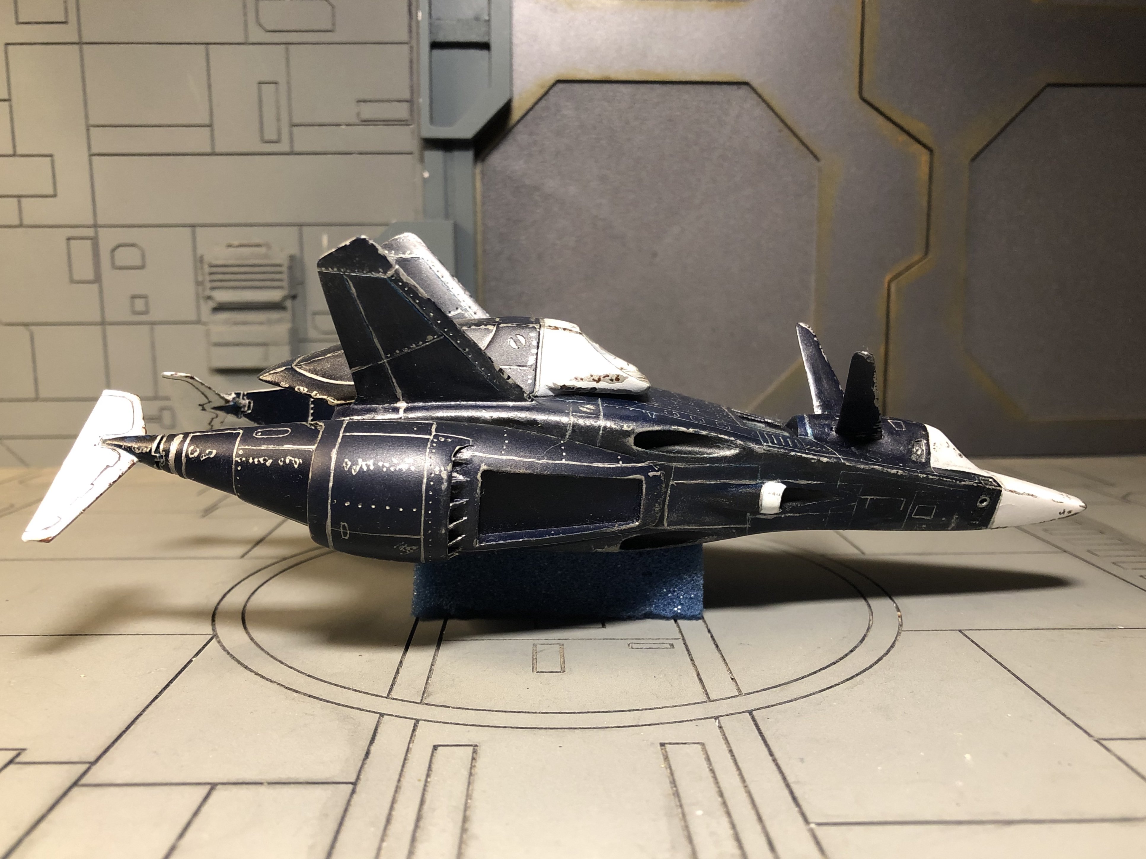

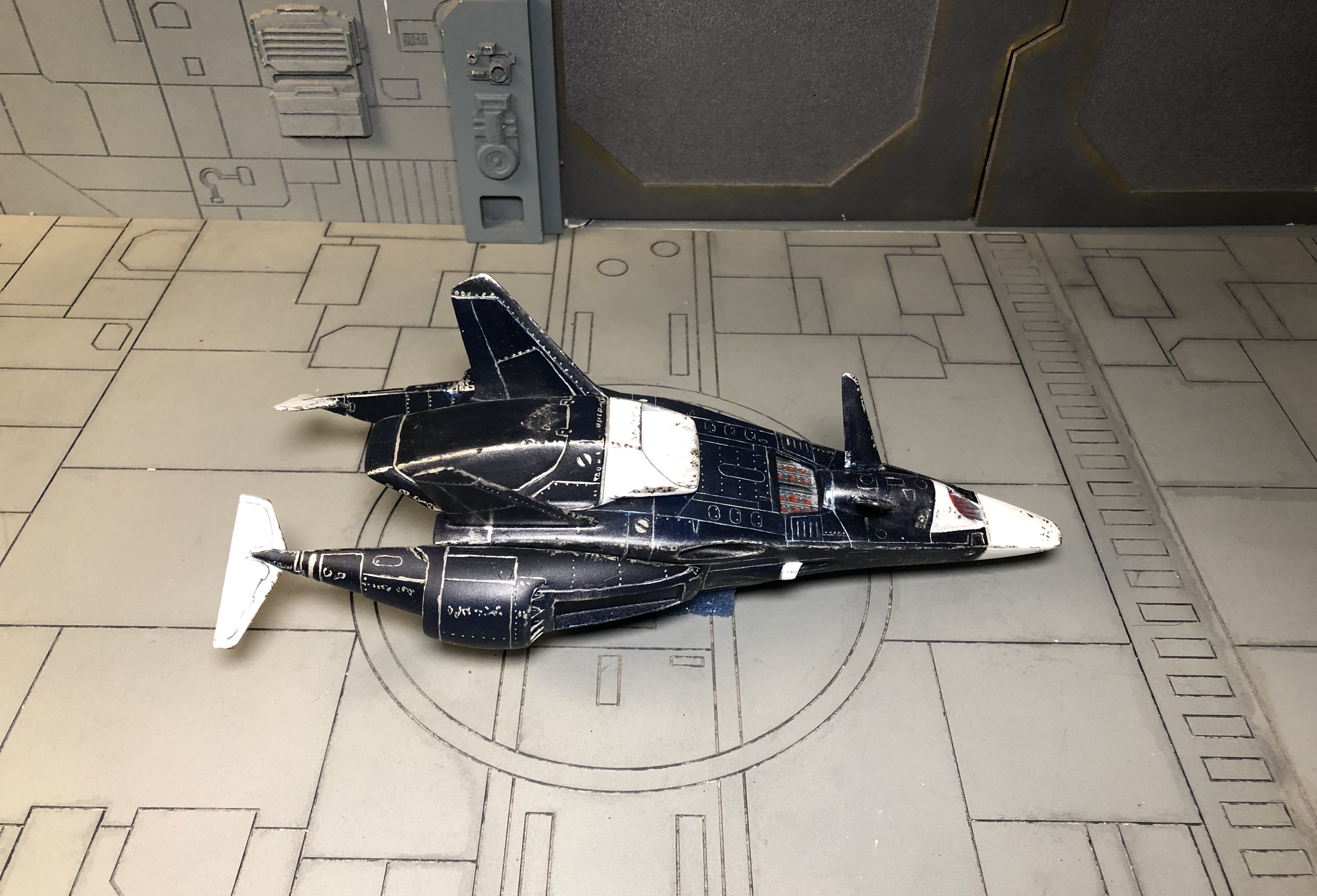

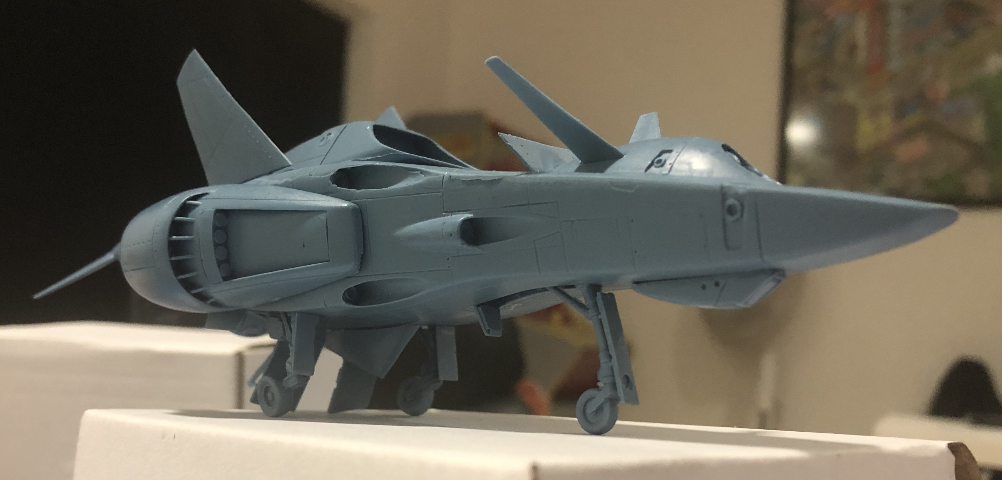

Thought I'd update some progress. She's heavily weathered. Will wash it down a bit more (some lines need to be thinner too) before clear coat and decals. In the process of painting landing gear and hatches and rear thrusters too..7C81A4A3-4773-4818-A26E-A12B0B6EEDA7.thumb.jpeg.722945867f1735097e1af4a5e35b1537.jpeg81129B1B-FB56-4A62-A9B4-642E5D0DF3D5.thumb.jpeg.43ff61329937cd65145e99d560295a4a.jpeg93F131BC-630D-45A8-9CD3-13CD1101FAF9.thumb.jpeg.359dc1d8ff9c4643fd989df0505f631d.jpegF7219EB8-D214-43D7-9D6A-DEB756260170.thumb.jpeg.ddab193ef46db12454c6dc8709c52fe3.jpeg
And there's always more details to add..
Edited by Bolt
