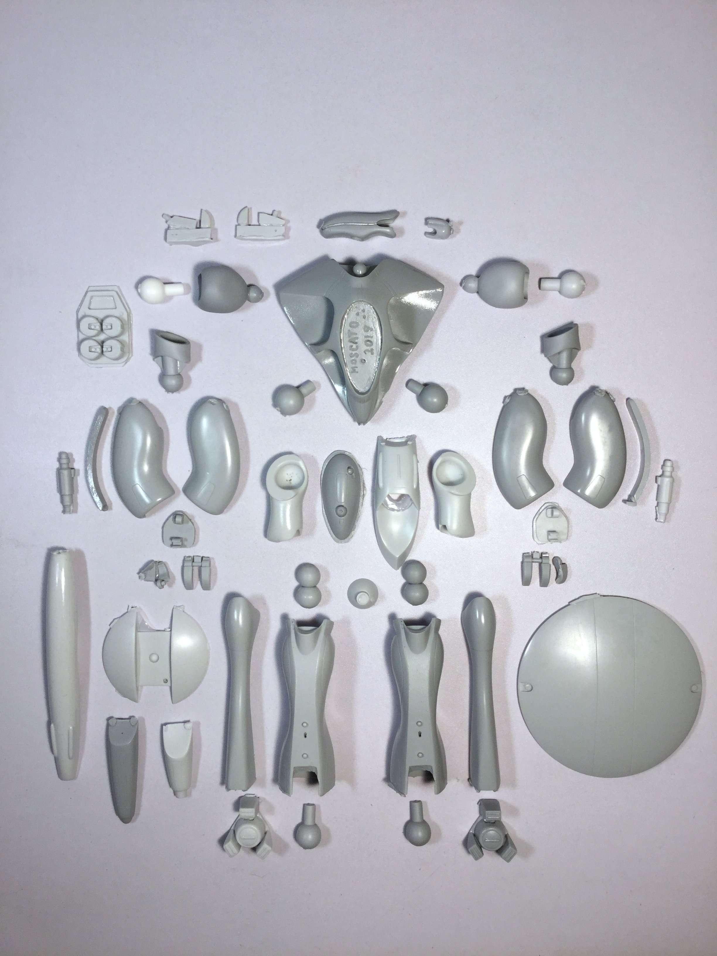

captain america Posted March 25, 2019 Author Posted March 25, 2019 Casting is a go! Making a few tweaks to the molds as I begin... There are more parts than for the Gosu, so getting everything poured in one shot is proving to be a bit of a challenge. Quote

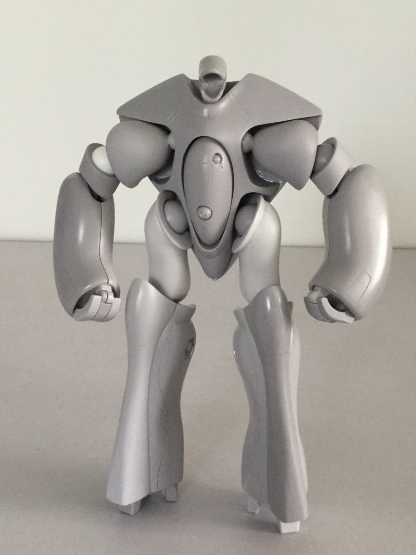

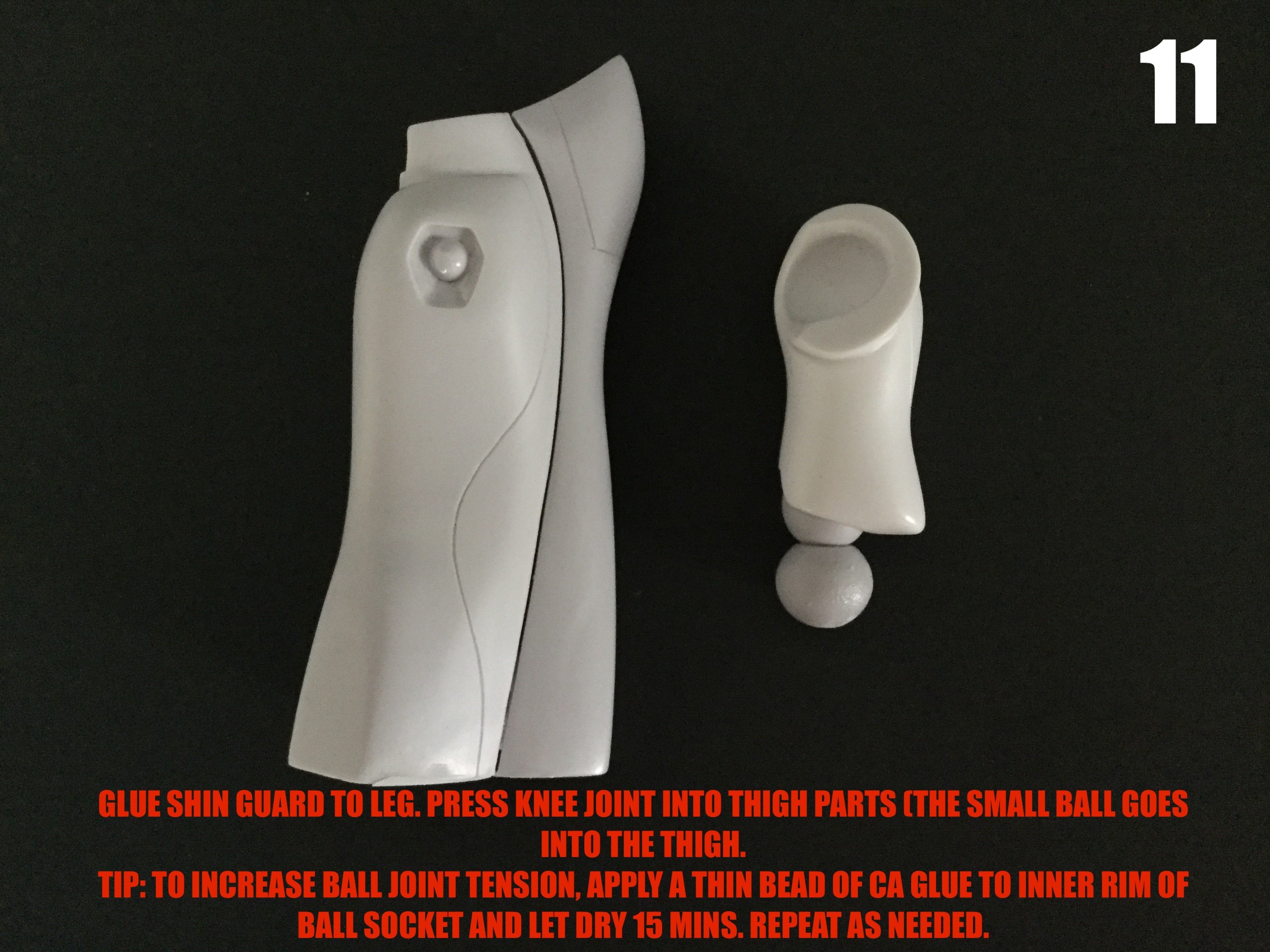

captain america Posted March 29, 2019 Author Posted March 29, 2019 Crabby godness!! The figure holds together with no glue, just the tension of the ball-joints! Will have pics of the clear parts early next week Quote

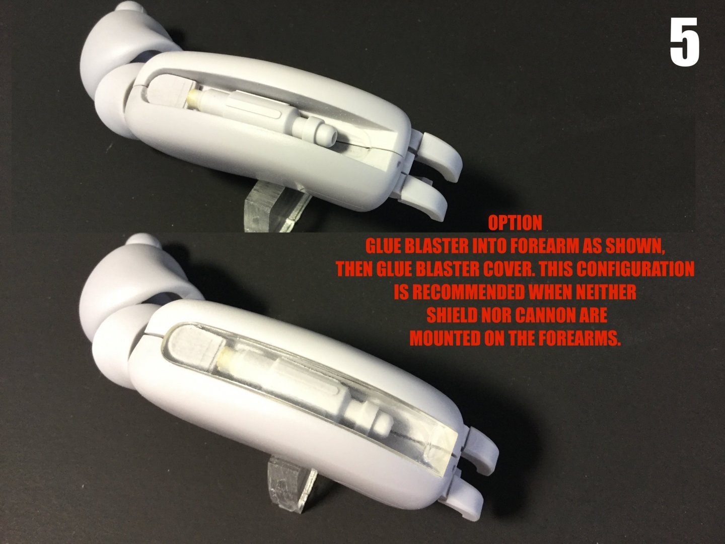

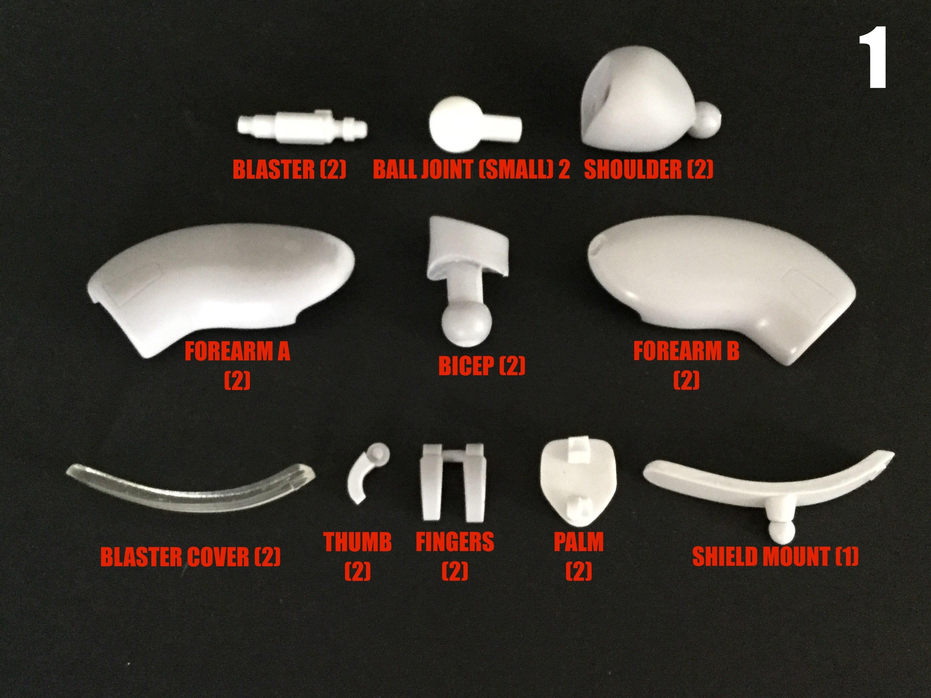

Tober Posted March 30, 2019 Posted March 30, 2019 On 3/30/2019 at 3:23 AM, captain america said: Crabby godness!! The figure holds together with no glue, just the tension of the ball-joints! Will have pics of the clear parts early next week Awesome work Capt! How many transparent parts are there? Quote

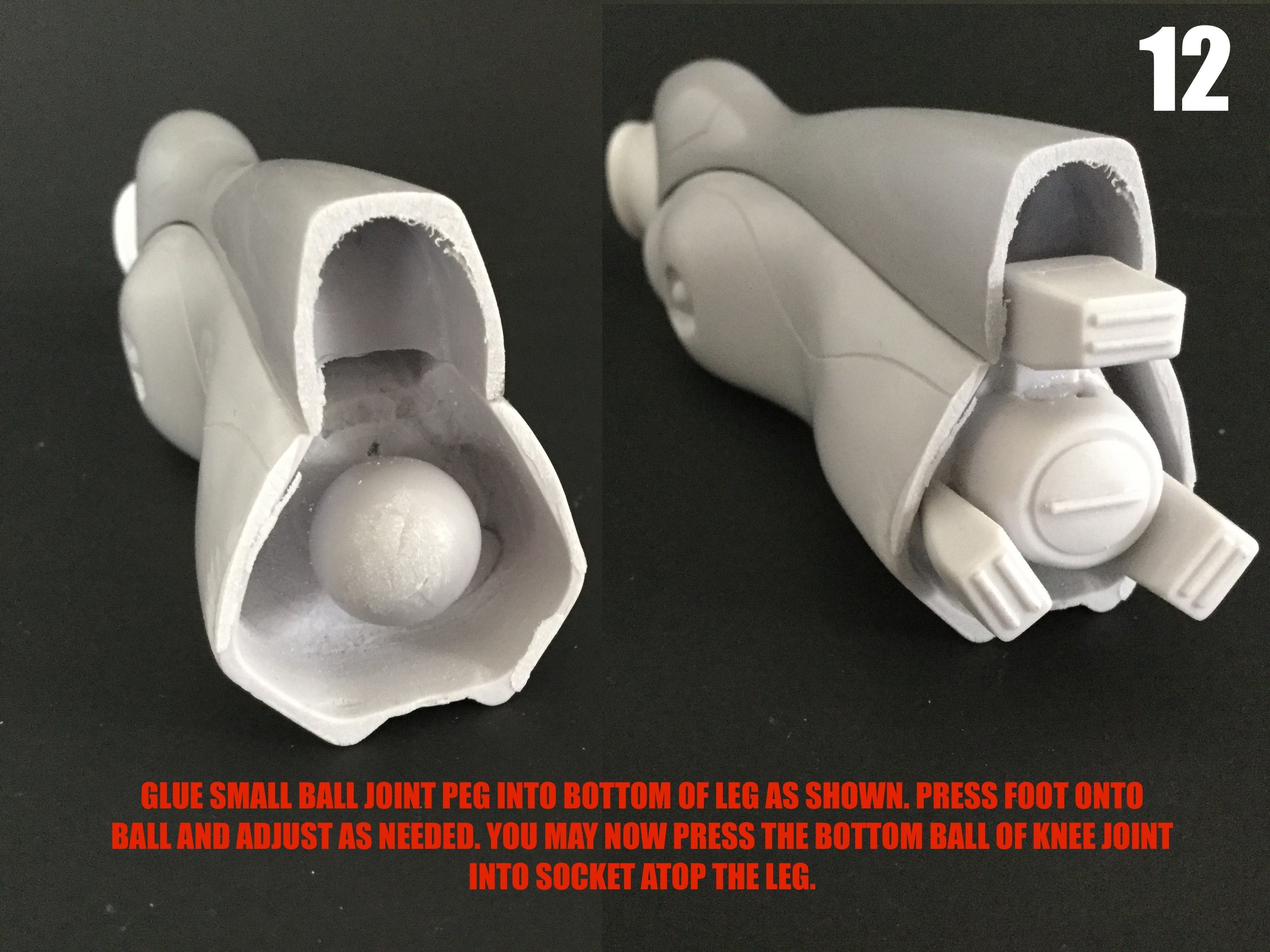

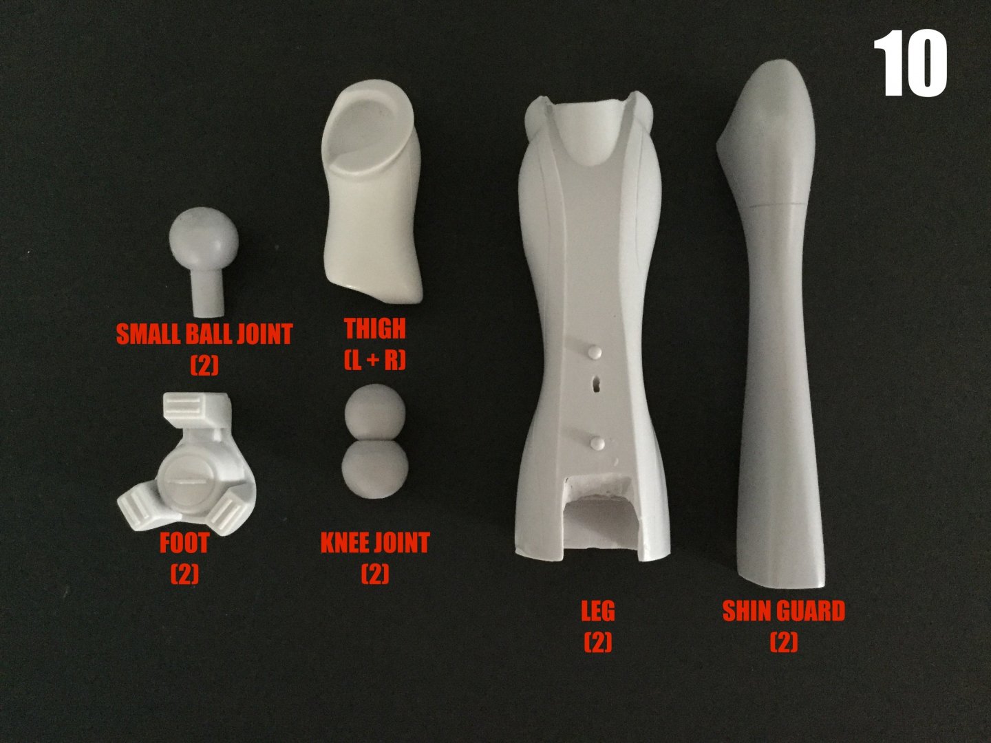

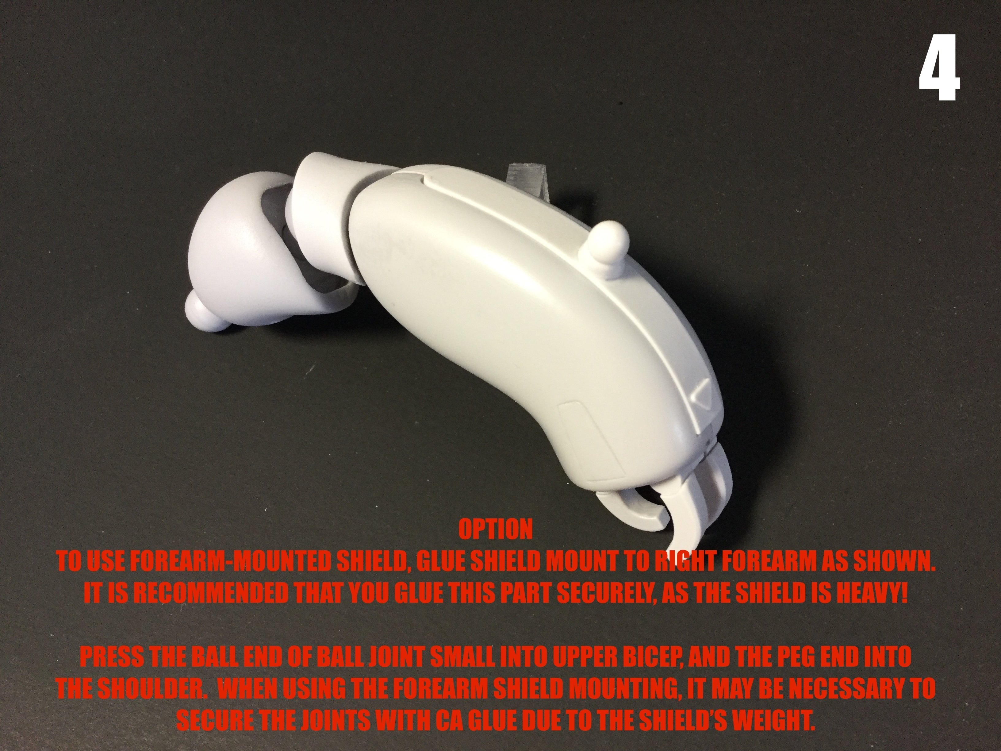

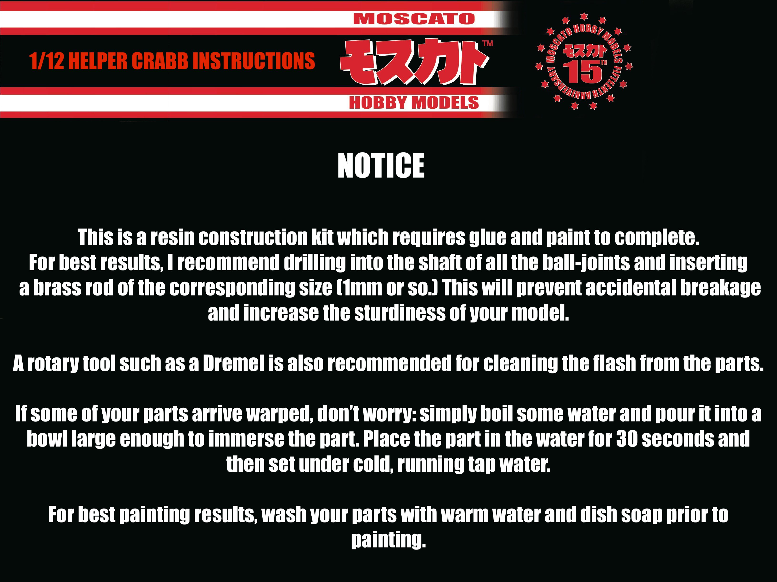

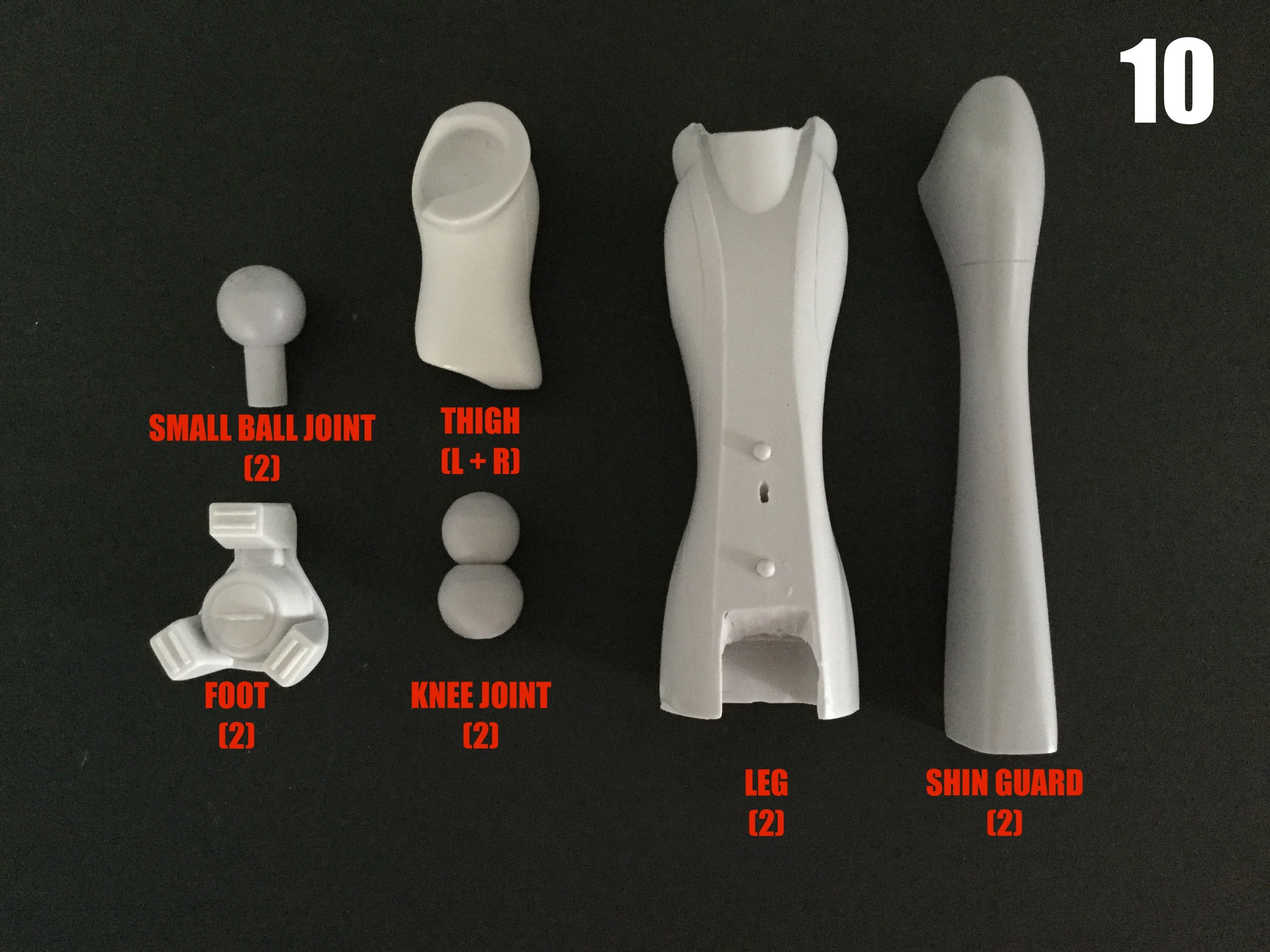

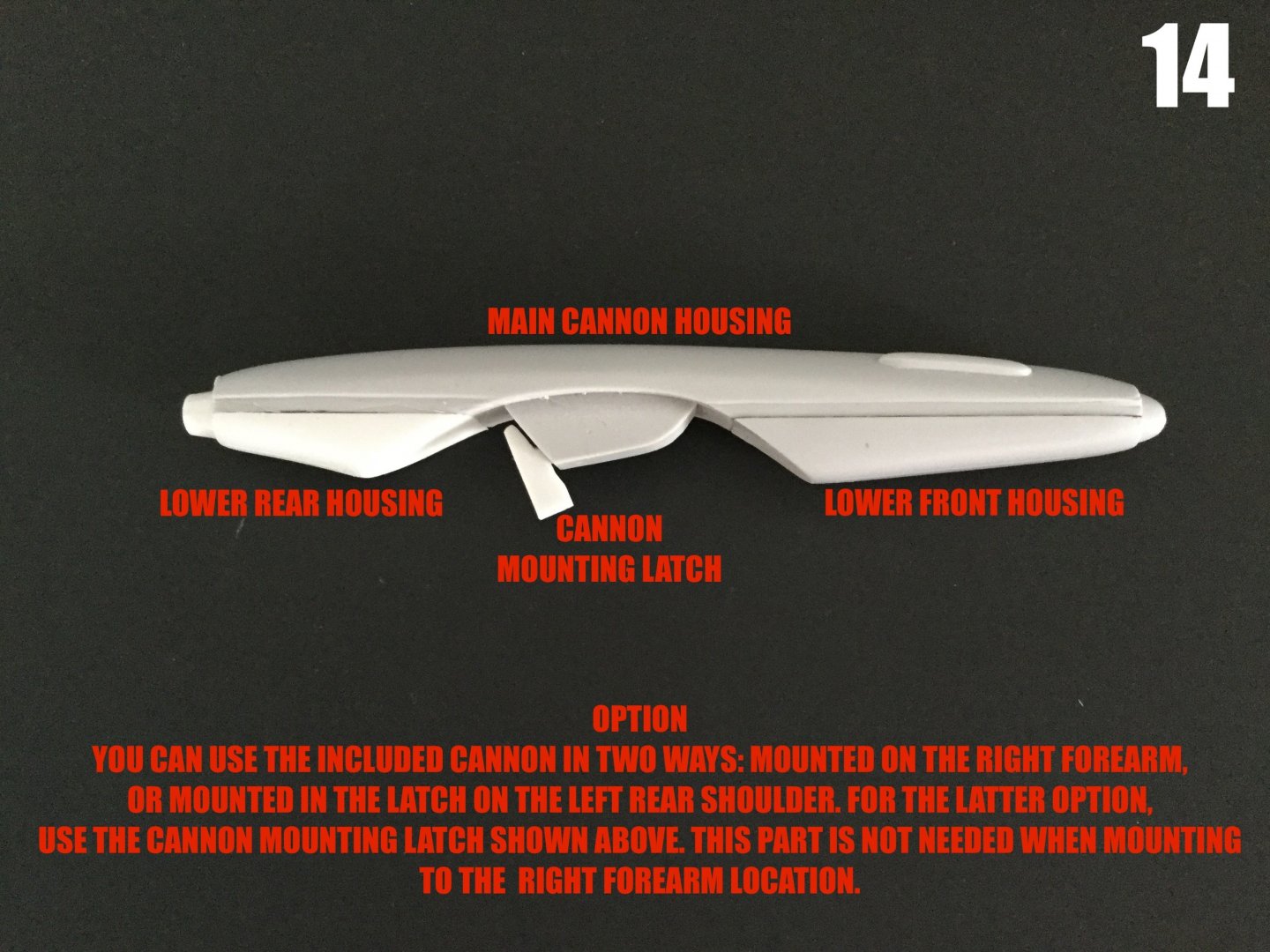

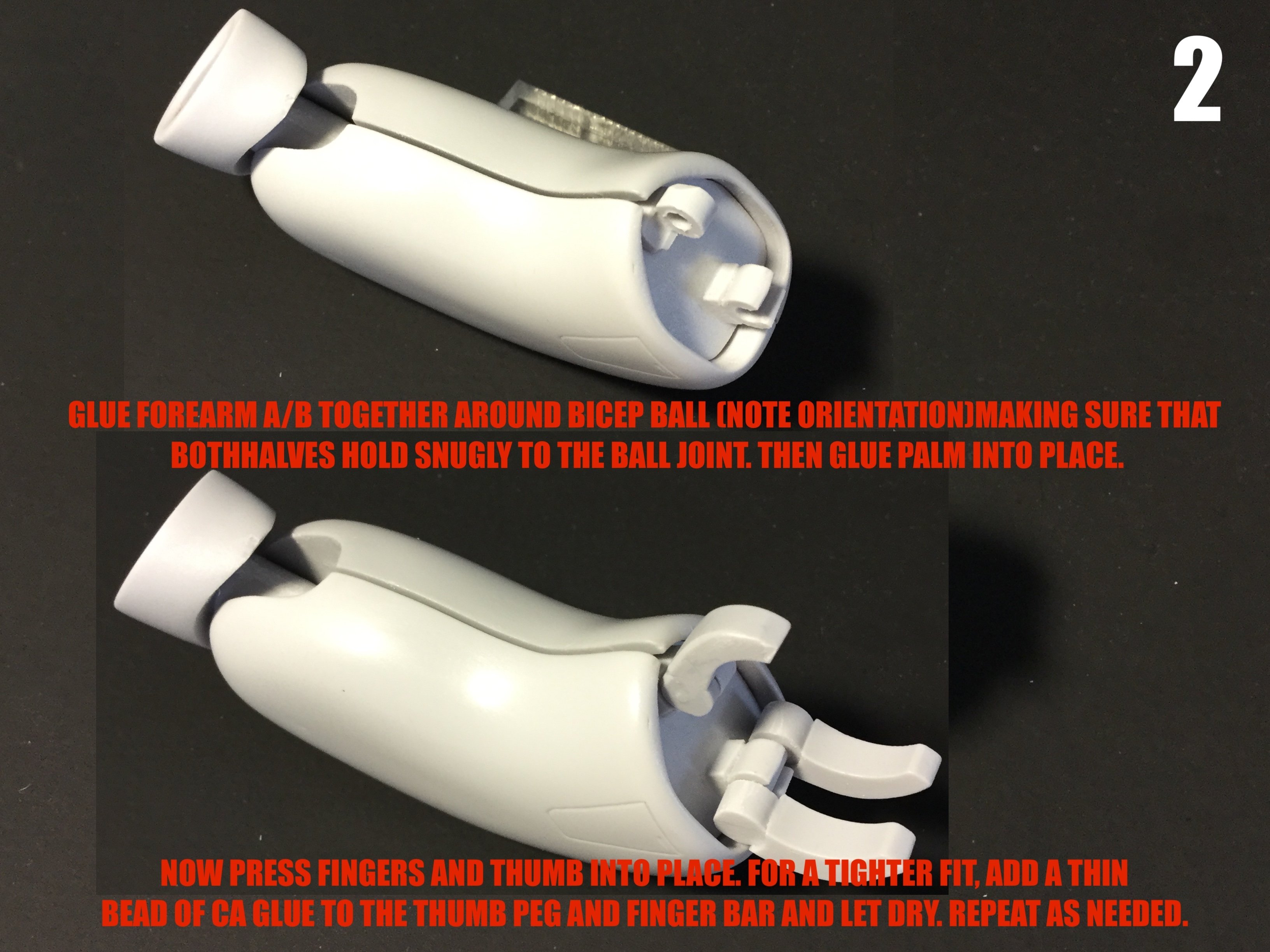

captain america Posted March 31, 2019 Author Posted March 31, 2019 (edited) 7 hours ago, Tober said: Awesome work Capt! How many transparent parts are there? Three: the eye, and two forearm blaster covers. 505thAirborne: from the looks of it, Sentinel seems to be paying attention, as can be evidenced by the saddle-packs and Gallant weapons to be included wth their upcoming Blow Superior release. They certainly get my approval for upping their game, as well as making great products. With regards to the Malar, it's definitely sturdy by garage kit standards, but it ultimately remains a kit. It goes together very nicely though, and the ball-joint tension is easily adjustable: sand the ball very lightly to reduce tension, or add a thin bead of CA glue to the inner rim f the socket cup to increase tension. Oh, and just by-the-by I realized that this year marks the 15th anniversary of my garage kit making. Edited March 31, 2019 by captain america Quote

Podtastic Posted April 1, 2019 Posted April 1, 2019 On 3/29/2019 at 6:23 PM, captain america said: The figure holds together with no glue, just the tension of the ball-joints! That is an excellent feature. Quote

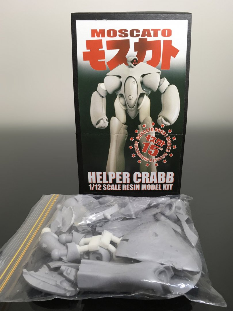

captain america Posted April 1, 2019 Author Posted April 1, 2019 This year marks the 15th anniversary of my garage kit enterprise. So much for my aspirations of being a fly-by-night operation. I think I'll carry that box art theme throughout the rest of the year's releases. Seems only logical. Quote

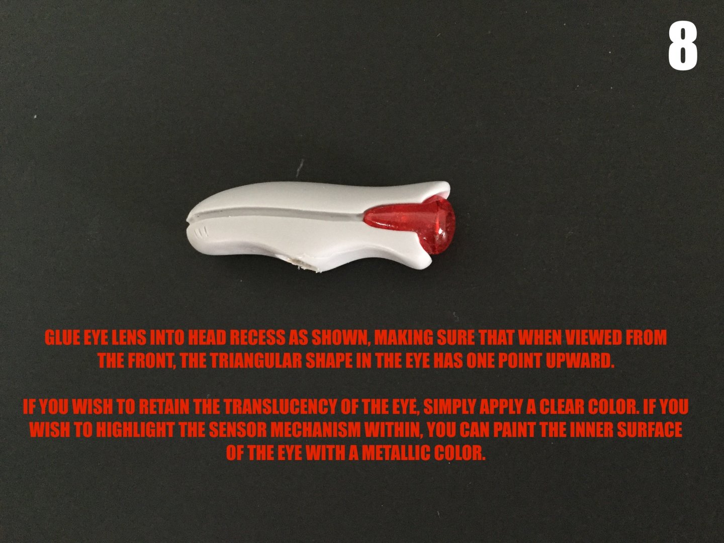

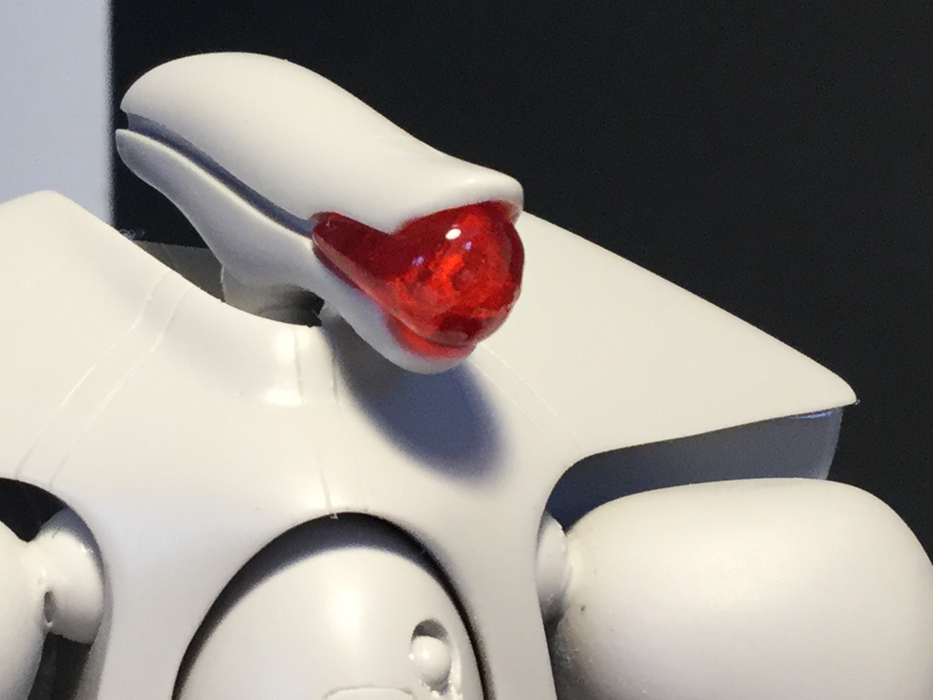

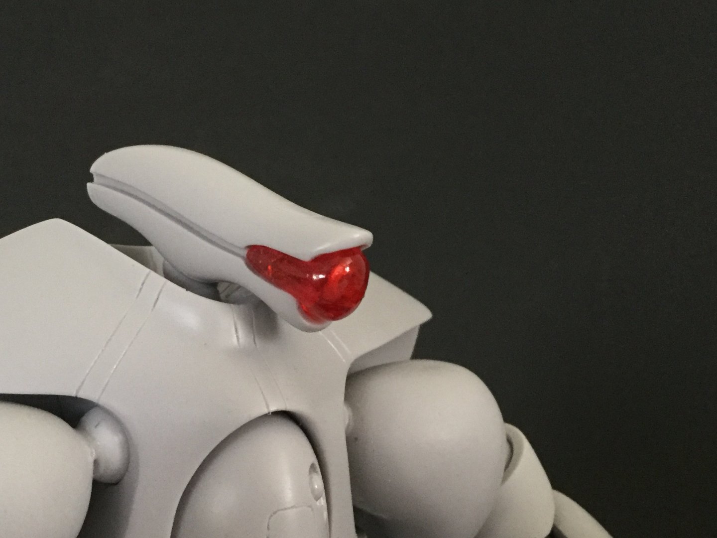

captain america Posted April 5, 2019 Author Posted April 5, 2019 Quick Friday update. Helper Crabb kits are cast and will be shipping starting Monday. I also wanted to provide a few pictures of the sensor-eye. It's molded as all one piece, with the sensor shape molded as a cavity on the inside. I added a coat of clear red which shows the detail in a very subtle way, but you can use silver/gun metal paint on the inside if you want the sensor to be more prominent. Quote

tekering Posted April 19, 2019 Posted April 19, 2019 Check your mailboxes, guys! On 3/30/2019 at 1:23 AM, captain america said: The figure holds together with no glue, just the tension of the ball-joints! It's true! The ball joints are awesome, Cap'n. Quote
