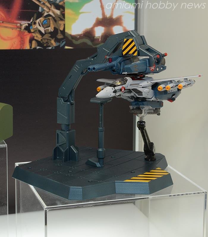

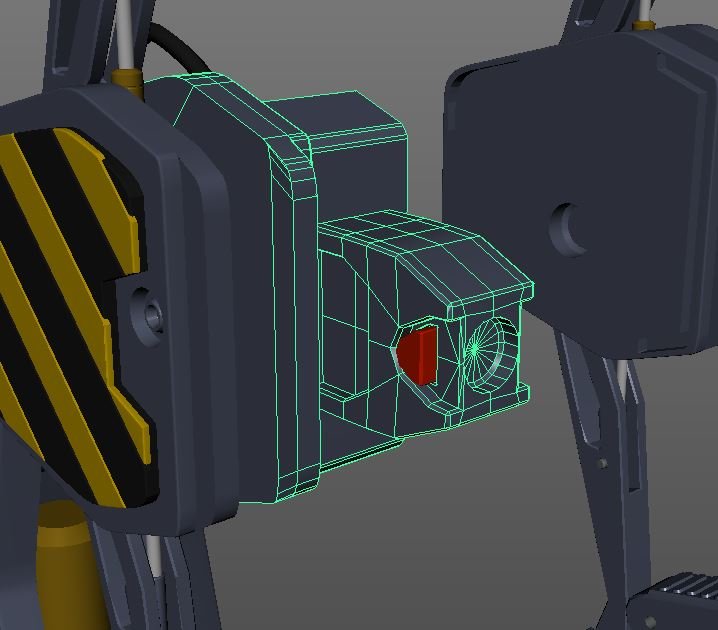

kyekye Posted November 13, 2018 Posted November 13, 2018 Started working on custom Display Base for Hi-Metal-R series. This will be 3D printed and possibly made into mold. Probably some parts are too thin to hold weight, but will see after first print test I know there is a Bandai official one displayed at one of the toy shows. I want something more detailed. Quote
Convectuoso Posted November 13, 2018 Posted November 13, 2018 Looks good so far. I'd love to see how this turns out Quote
no3Ljm Posted November 13, 2018 Posted November 13, 2018 That looks good! But now you're making me want a HMR Hikaru VF-1S. Quote
kyekye Posted November 13, 2018 Author Posted November 13, 2018 Parted out for assembly after print Now has slide slots, screw holes and pin holes..etc Next step - layout parts for print and test print! Quote
kyekye Posted November 24, 2018 Author Posted November 24, 2018 On 11/13/2018 at 6:09 PM, Knight26 said: Very nice work Expand On 11/14/2018 at 2:54 AM, sh9000 said: Cool. Expand On 11/14/2018 at 5:29 AM, Bolt said: Looks awesome! Good job mate! Expand Thanks for the comments On 11/24/2018 at 4:07 PM, arbit said: Cool. How will it hold the valk? Expand That was TBD after test print. As it stands now (after test print), the clamp parts are too weak to hold Valkyries (unless it's made out of diecast metal or I display in space..) So I'm thinking the Valkyrie will be placed on the base platform and have clamps hung over on top. Kinda like this baseidea2.bmp Quote

kyekye Posted November 25, 2018 Author Posted November 25, 2018 On 11/24/2018 at 11:02 PM, sh9000 said: If you are planning on selling one, I’d be interested. Expand Thanks for the idea. Not sure where I'm going with this yet. I made into too many parts for the first test, but that's why it's a test. Will see which parts I can merge and make stronger. This is first test print (sanded/cleaned a bit) This is how base will be assembled (with screws after painting) This is how clamp parts are assembled. This area needs some major reinforcement. Quote

kyekye Posted November 29, 2018 Author Posted November 29, 2018 On 11/29/2018 at 7:16 AM, arbit said: Expand Then it just becomes this.. Which is not bad at all, - but look at all the support it needs. Also this pic is from 2 years ago. Quote

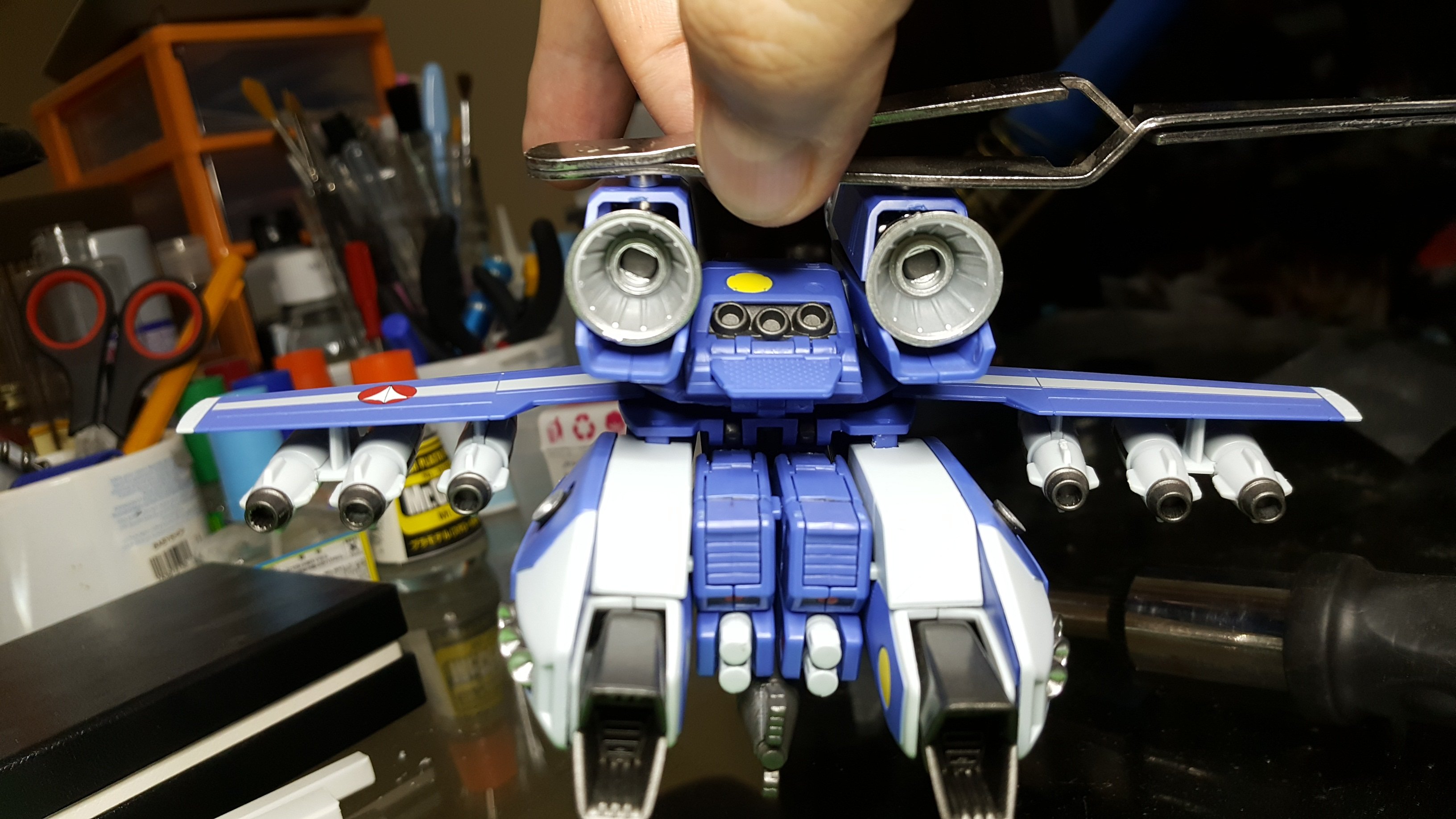

arbit Posted November 30, 2018 Posted November 30, 2018 If those HMR Supers can be opened, you could put magnets on the inside, and then magnetize the claws. Quote

kyekye Posted December 1, 2018 Author Posted December 1, 2018 Oh, These Valkyries are light, but not light enough to be held with magnet. I'm thinking about making 2 different versions now. One with correct scale + articulated (poseable) - just decoration base Another one with oversized Clamps that has attachment for the connector - something I can actually connect it and display Stay tuned now. Need some design tweaks. Quote
Xigfrid Posted December 1, 2018 Posted December 1, 2018 Have you tried the Neodynum magnets N52? That’s almost incredible how strong they can be. For instance the small discs diam 5mm x height 3mm can hold 730g, that means that 4 magnets would hold easily a 2L bottle of coke! Quote
arbit Posted December 1, 2018 Posted December 1, 2018 On 12/1/2018 at 7:11 AM, Xigfrid said: Have you tried the Neodynum magnets N52? That’s almost incredible how strong they can be. For instance the small discs diam 5mm x height 3mm can hold 730g, that means that 4 magnets would hold easily a 2L bottle of coke! Expand Agreed. Four magnets in the claws should hold it. I would test 4x 2mm & 3mm diameter magnets and see which will work. But you will have to redraw the design of the claws with holes to take the magnets. Quote

kyekye Posted December 2, 2018 Author Posted December 2, 2018 On 12/1/2018 at 7:11 AM, Xigfrid said: Have you tried the Neodynum magnets N52? That’s almost incredible how strong they can be. For instance the small discs diam 5mm x height 3mm can hold 730g, that means that 4 magnets would hold easily a 2L bottle of coke! Expand I've been using Neodynum magnets since 2008, so I know what it can hold. The claws aren't big enough for them in this scale. On 12/1/2018 at 6:37 PM, arbit said: Agreed. Four magnets in the claws should hold it. I would test 4x 2mm & 3mm diameter magnets and see which will work. But you will have to redraw the design of the claws with holes to take the magnets. Expand Maybe I can use magnets if I make oversized clamps, but again the parts material and size need to be tested multiple times. On 12/1/2018 at 6:41 PM, arbit said: If you want feedback, show us the designs before printing to save money. Expand Thanks for the help. I'm using my home printer, so it's just me fiddling with different tries. Not worrying too much about the cost. Just having fun Quote
arbit Posted December 2, 2018 Posted December 2, 2018 On 12/2/2018 at 3:40 AM, kyekye said: Maybe I can use magnets if I make oversized clamps, but again the parts material and size need to be tested multiple times. Expand Yes, you will need to redesign the arm for strength and balance. I have 4x magnets holding up my 1/72 to the Launch Arm (I can't remember if they were 3 or 4mm diameter). The valk weighs 100g. And the magnets were at least twice or three times as strong as required to hold it securely. Quote

kyekye Posted December 3, 2018 Author Posted December 3, 2018 Originally that was part of the plan. the center circle was made for either attachment part connector or possible magnet, Like I mentioned, I realized it came out smaller than I thought (although it's in correct scale) Quote

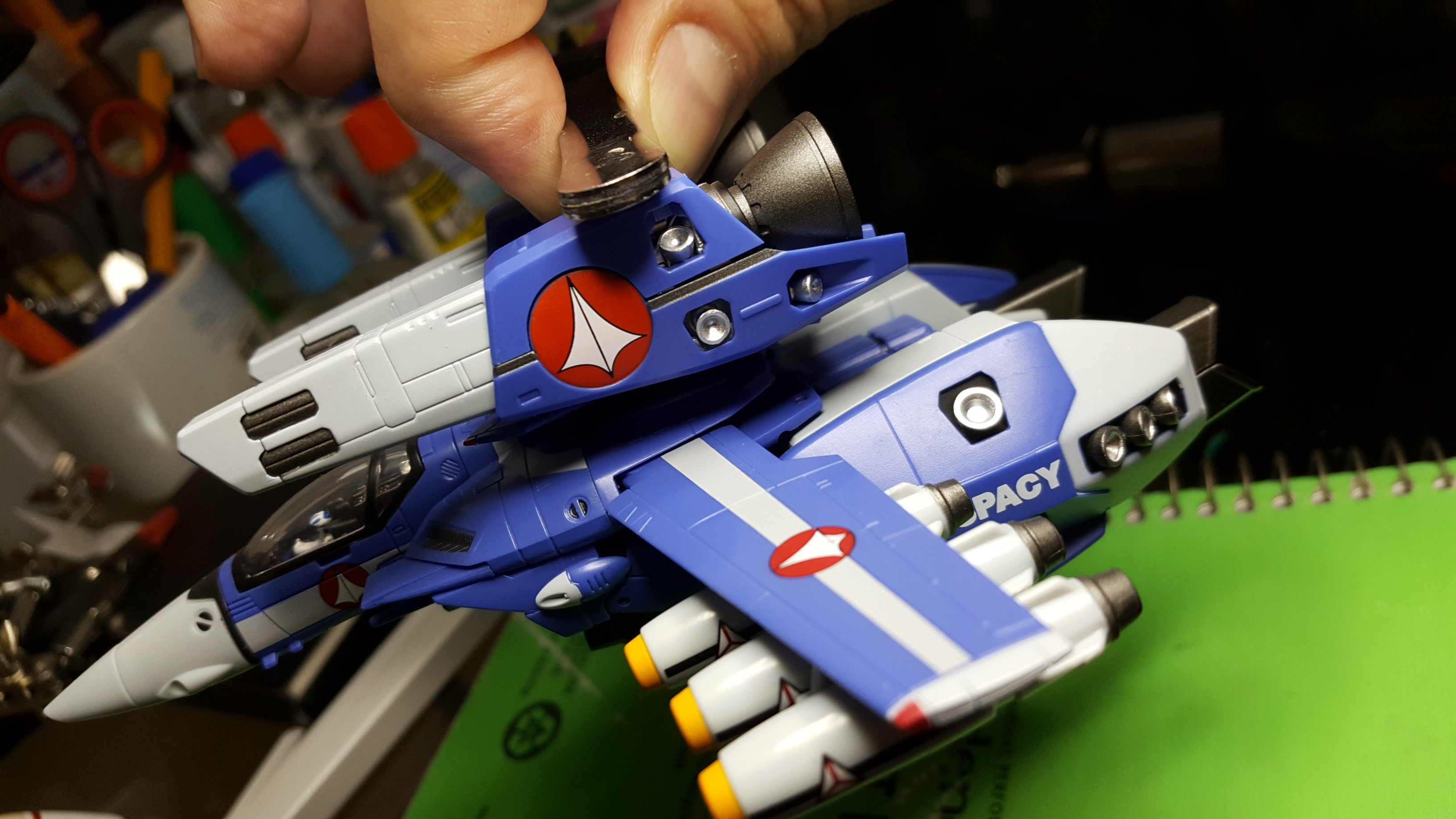

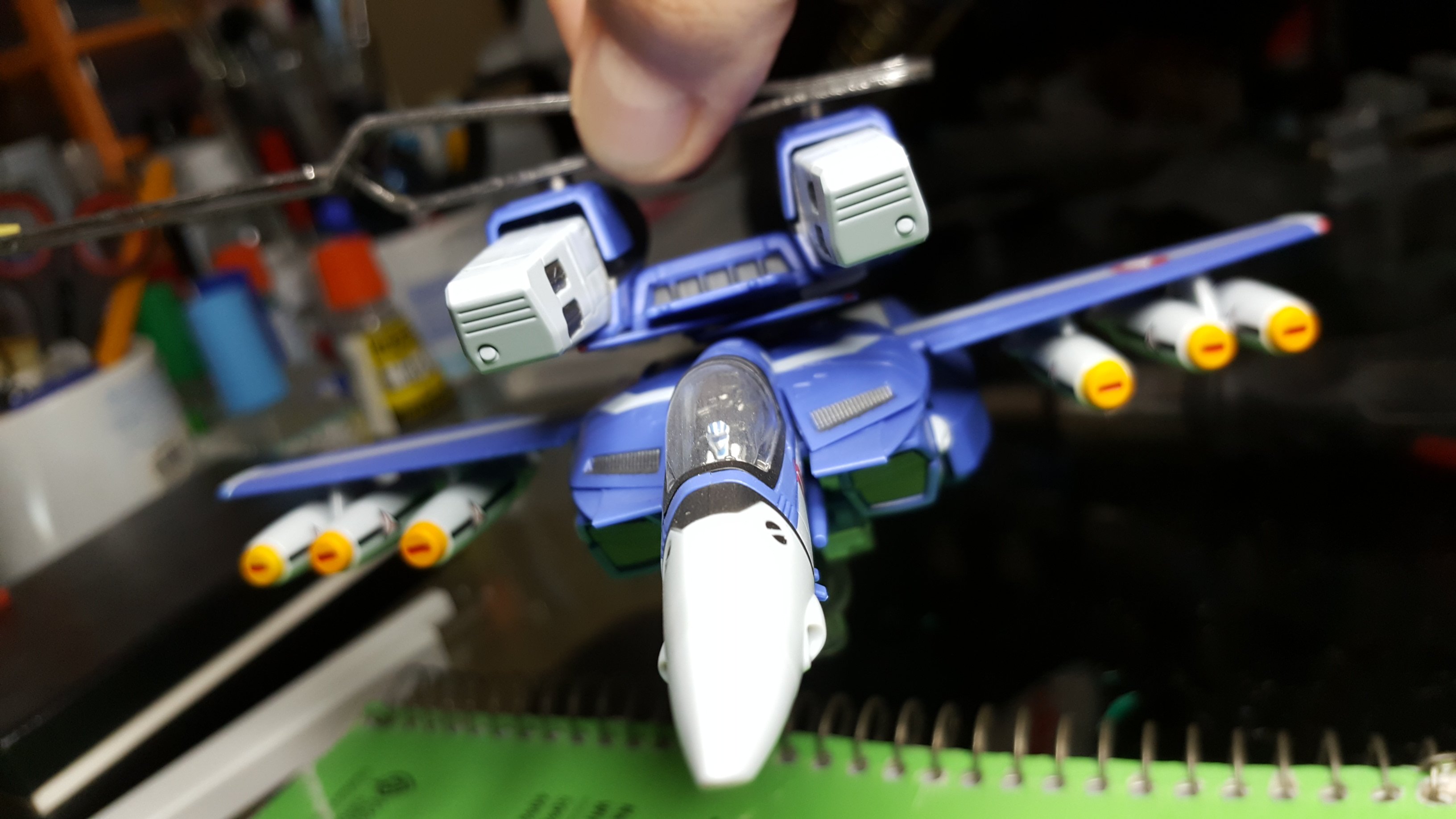

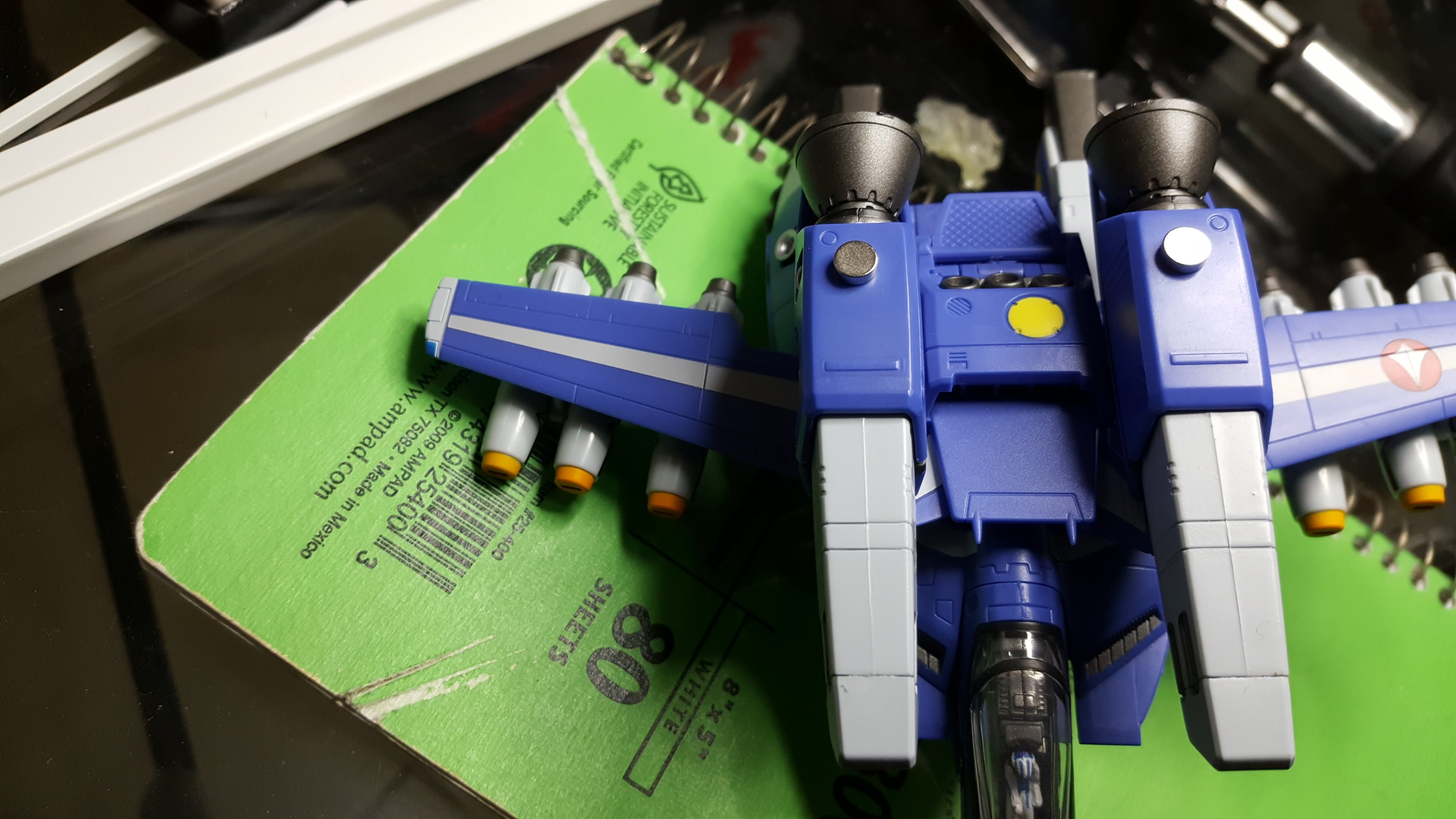

arbit Posted December 3, 2018 Posted December 3, 2018 (edited) On 12/3/2018 at 3:06 AM, kyekye said: 1/72 would be a plastic model? Pictures would be inspiring Expand Here is a link to my Launch Arm build for your reference. I did a quick test on my HM-R. I am holding it with only 2x 5mmx2mm magnets. I think that with 4x magnets mounted in the claws you will have a strong hold, even with smaller magnets to fit your claw. (A couple points on my test: All the weight is on the Super covers, so they need to be closed with epoxy. There is also stress at the connection points between the Supers and the valk, which needs to be reinforced. You also need a way to keep the backpack closed, in my images the backpack isn't opening because the magnets are positioned only at the rear. ) Edited December 3, 2018 by arbit Quote

kyekye Posted December 4, 2018 Author Posted December 4, 2018 On 12/3/2018 at 1:05 PM, arbit said: OMG, I just realized you're Kye. I'm a huge fan of your work Expand LOL! Thanks for saying. I'm working on over-sizing parts so that I can use magnets. Also I got a crazy idea, but not sure if it's gonna work. need some thinking... Quote

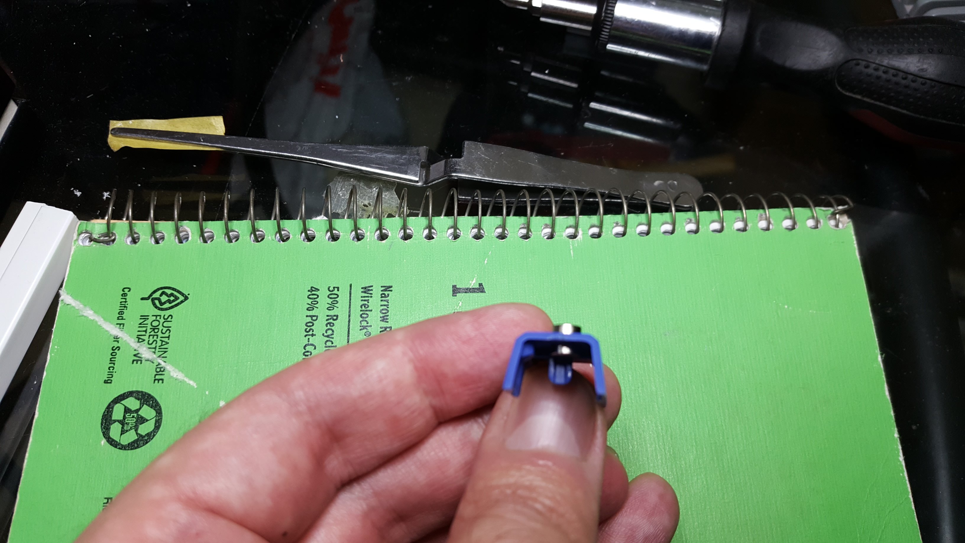

kyekye Posted December 28, 2018 Author Posted December 28, 2018 Finally got some time to re-work on parts design. Also found VF-1A Super Valkyrie in the box. Now I was able to actually measure the parts for accuracy. Now scaled up clamp parts - enough to put the magnets in. Hopefully 5 will hold it. Quote
