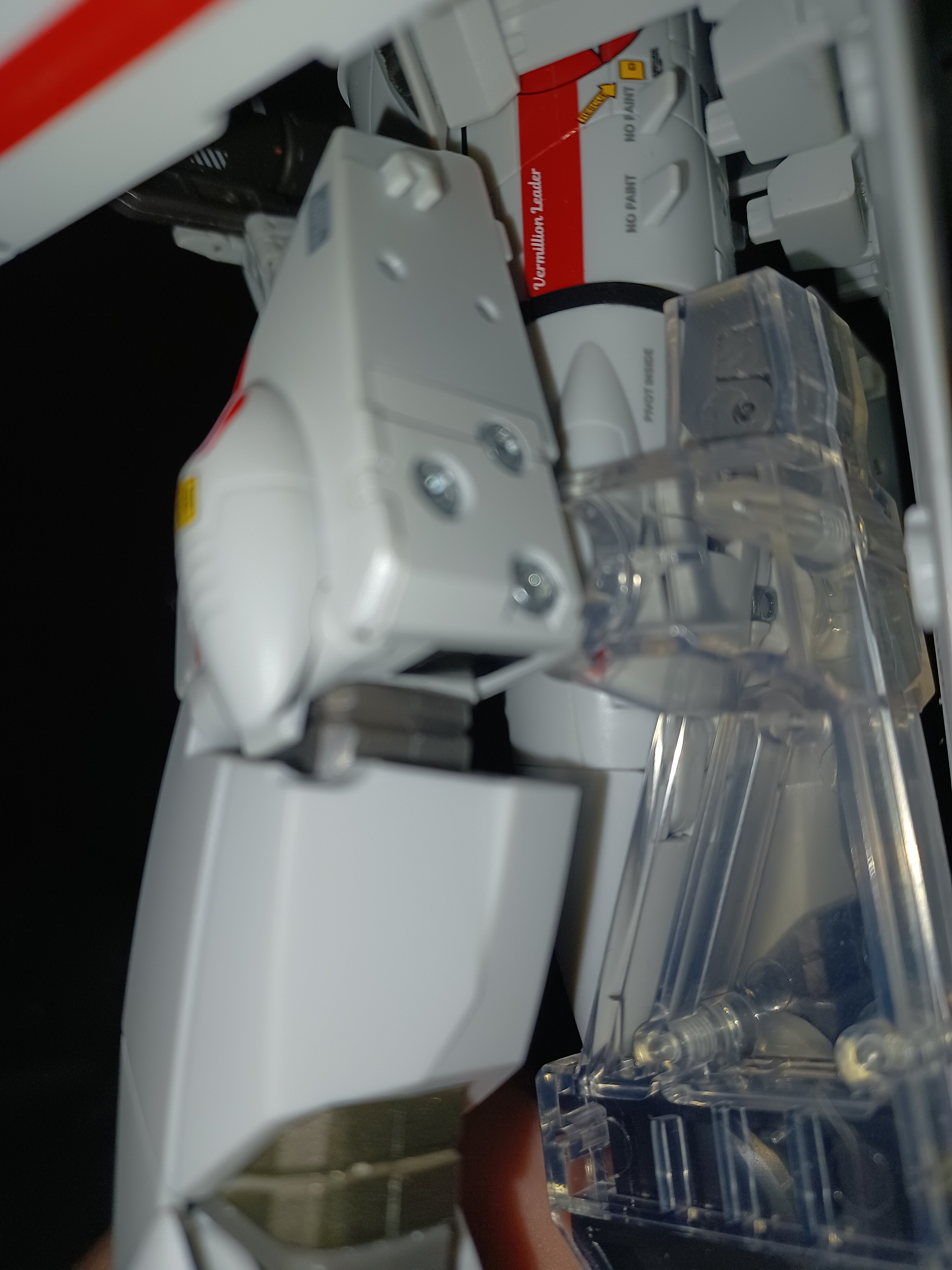

Laughingman687 Posted January 22, 2022 Posted January 22, 2022 (edited) Hello gentleman. I recently took the plunge into the plastic crack habit that is the Bandai DX Chogokin line, and up until my second VF1 I have been extremely happy with them... but to my absolute horror this evening: I've discovered that since the last pose I put my VF-1J into, it's developed a loose warble above the gerwalk joint- just above the new hinge that allows for outward-side movement. https://ibb.co/QPhK4Q2 *EDIT: the loose warble is where the gerwalk joint connects to the bottom of the intake fan housing above the thigh. Sorry I realized that the original info given was not descriptive enough of the problem part(s)/joint. Please tell me that this is something I can repair relatively easily...as between the weight of the legs and the collection of joints in the effected area, I'm afraid that I'll come home from work one day soon and find a legless Valk on my shelf. Edited January 22, 2022 by Laughingman687 Additional info given Quote

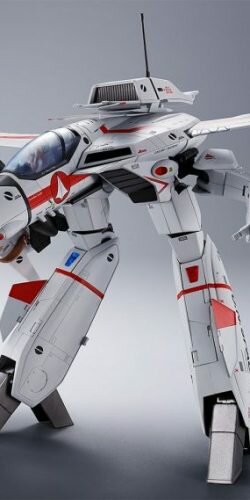

Sanity is Optional Posted January 22, 2022 Posted January 22, 2022 Just to confirm, you are aware that there is supposed to be a second joint in that area that lets the legs splay to the sides? Quote
no3Ljm Posted January 22, 2022 Posted January 22, 2022 (edited) Yup, there's a second joint under the intake. Here's a pic from @jenius Anymoon site showing the legs posed wider. Edited January 22, 2022 by no3Ljm Quote
Slave IV Posted January 22, 2022 Posted January 22, 2022 On 1/22/2022 at 7:07 AM, Laughingman687 said: it's developed a loose warble above the gerwalk joint- just above the new hinge that allows for outward-side movement. Expand Seems like he’s well aware of the joint. Quote
Laughingman687 Posted January 22, 2022 Posted January 22, 2022 Oh yes, well aware of said joint that allows wider outward motion.... the wobble/loose connection is where the gerwalk joints' inner frame connects to the bottom of the intake fan housing... 20220122_045713.mp4 Quote
Laughingman687 Posted January 22, 2022 Posted January 22, 2022 Also, from below. It's like a loose baby tooth up in' ere. 20220122_045950.mp4 Quote
last_raven Posted January 22, 2022 Posted January 22, 2022 (edited) On 1/22/2022 at 10:01 AM, Laughingman687 said: Also, from below. It's like a loose baby tooth up in' ere. 20220122_045950.mp4Fetching info... Expand I suspect that the (singular) screw from the splay joint to the rear of the intake detail piece has come loose or jumped some threads. It may pull out all the way as mine did but this happened for me due to the splay joint being so tight on my Hikaru movie ver. I had to take the leg apart and modify it and glue a bunch of stuff. It's held up to this day but I had to drill the splay joint to get to the screw head to try a longer screw and some threadlocker or glue (been a long time I don't remember) first before committing to locking it up and basically gluing the edges of the joint to the inside area of the housing and then the screw and screw head to all the surfaces they contact. This removed the splay motion on my broken leg so locked up the other leg too. You can avoid having to drill it if you have what you need to knock the roll pin out of the joint and reinstall it/another one and that will probably loosen up the joint enough to put less strain on that connection. If it's too loose after you can tighten it with some super glue into the roll pin area then moving the joint before the glue sets. A single metal screw into ABS or PVC (I think ABS for that) holds the entire leg on.. They could have had a hole from that diecast rear cover with the screws index with a pin on the splay joint to help give it some strength but I may be mis-remember how that whole upper leg area goes together. If you don't want to bother with all that even if the leg falls off it holds together awesomely in fighter mode with the leg just in place Edited January 22, 2022 by last_raven Quote
Laughingman687 Posted January 24, 2022 Posted January 24, 2022 Thank you Last Raven, after some sphincter-puckering plastic plying and a harrowing crash course in low torque drilling, I have it repaired...for the time being. On an unrelated note, and I think I already know the answer- shouldn't be surprised that there's some overlap here- but is your screen name referencing Armored Core? Specifically what was my golden age of AC III thru AC:LR? Quote
last_raven Posted January 24, 2022 Posted January 24, 2022 On 1/24/2022 at 5:48 AM, Laughingman687 said: Thank you Last Raven, after some sphincter-puckering plastic plying and a harrowing crash course in low torque drilling, I have it repaired...for the time being. On an unrelated note, and I think I already know the answer- shouldn't be surprised that there's some overlap here- but is your screen name referencing Armored Core? Specifically what was my golden age of AC III thru AC:LR? Expand I'm glad I could help. Definitely high up on the pucker factor. If you marred up your screw cover panel like I did, mine was an easy fix with some loose runner plastic in the same or similar shade of white that I shaved off and kind of molded in with tamiya cement SP then sanded. You'd never know mine was broken (or that the CA glue I used to secure the joint assembly had spilled out the front and all over the bare side of the leg, again fixed with slow gradual sanding) And thanks for catching the reference @Laughingman687 those were fantastic games with fantastic soundtracks. Likewise, I'm a big SAC fan. Laughing Man was a great arc. I'll have to look further up in my post history to credit the person who initially guided me on the repair. If you were able to do it with just a new screw or by threadlocking or gluing it, it's them who should have the credit. Quote
last_raven Posted January 24, 2022 Posted January 24, 2022 On 5/21/2020 at 3:12 AM, RedComet said: I fixed mine after getting some advice from a guy on FB. First, get yourself a baggie of this exact size tiny screw It’s Only 1mm longer than the original, but makes a big difference (Found mine at the Home Depot, <$1 for 2) Put loctite on it, let it sit for 30 minutes while you do the next step. then you will need to disassemble the leg, starting with the cover as said. After that screw is out you have to gently but firmly pull the thigh apart. This will give you access to the gray accordion looking piece of plastic. There is a screw attaching that to the metal part of the hinge, unscrew that. Now comes the really fun part, bend the hinge out as far as you can, then With the side that broke off flat on the ground, take a drill and drill down as straight as you can (Which will kind of go through the hinge top piece of metal at a diagonal angle directly towards where the screw is to make a hole just wide enough to put a small Phillips head screwdriver through. (Sorry the picture isn’t a bit better) Then it will look like this. This will let you actually put in a screwdriver in a way that will let you turn the screws you need to turn to fix the break. Then before actually trying to reattach it to the top piece with the new screw, I would undo the three screws that hold it to the hip join. Now you should be able to re-screw it in, one of my tabs was broken so I also applied a good amount of modeling glue that is supposed to be able to bind metal to plastic All around where the screw goes in the hole, but not in the actual hole itself, which is what Loctite is for. Line the screw up, gently re-screw it into the hole, it should connect snuggly, and let that part all dry for an hour. Then just carefully reassemble everything. It isn’t what I would call an easy fix, but better than just writing off a $300 figure right? Expand @Laughingman687 this is the post that got me started. Unfortunately this didn't work out for me though I did try. Thanks to @RedComet for the initial guidance Quote
