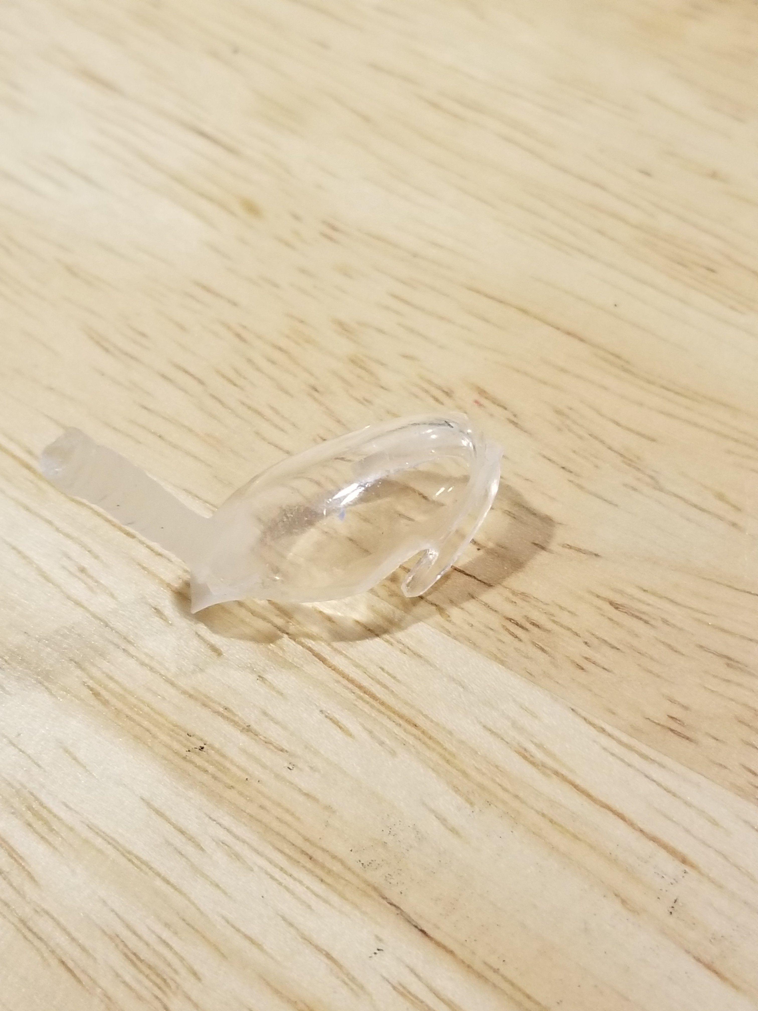

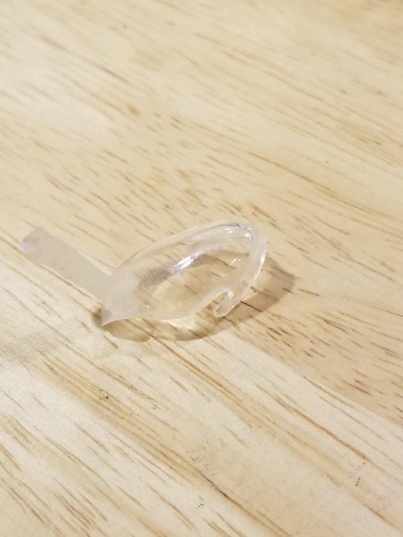

william02 Posted March 9, 2018 Posted March 9, 2018 On 26/12/2017 at 6:59 PM, Jasonc said: I will. I'll try to do it during the week. I've spent the better part of 4 months tweaking the angles and measurements of the front head glass just to get it where it is now. I'm quite happy to say that it now fits and works as it should. Dome may ask why I'm recasting it, instead of just putting it up on Shapeways. Well for one, you can never get this clarity in any shapeways print work. This allows me to continually recast them and not have to spend a fortune getting any sort of frosted xtreme detail parts made. Plus, FXD is extremely brittle. The idea is to have you guys not have to buy anything from shapeways, with the exception of 1 part that I simply cannot recast due to the complex design. In any case, this is an actual recast part, and you can see how clear it is. I'm very happy with this. Wow, what kind of resin are you using? Quote
Jasonc Posted March 9, 2018 Author Posted March 9, 2018 1 hour ago, william02 said: Wow, what kind of resin are you using? It's is Alumilite clear resin. It's a little difficult to get it super clear. The process starts by "baking" the mold in about 200 degree oven temp for an hour to heat the rubber so that the clear resin can run through the mold easy and get rid of bubbles. Then once the resin is mixed, it's slowly poured in the hot hold and then put in a pressure tank and cures for 2 eays. Quote

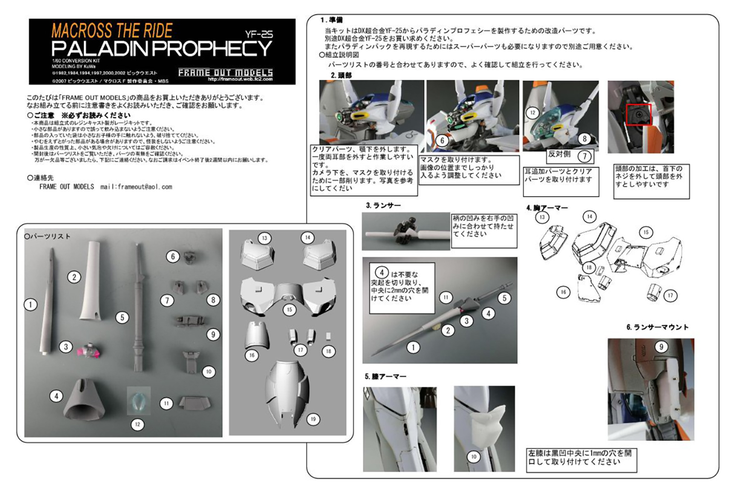

Jasonc Posted March 18, 2018 Author Posted March 18, 2018 Alright guys, a couple sets are done, and I'm testing some of the connectors to them, to make sure they work as I intended. I'll be sending out a few orders this week, as they are now ready to go. I will be attaching a copy of the Frameout directions, as they are exactly the same for putting it together, just with my designed version. I will have a short instruction here soon with the extra parts to put together, and will get a list of the armor and fast pack parts you'll need to make the kit complete. Quote

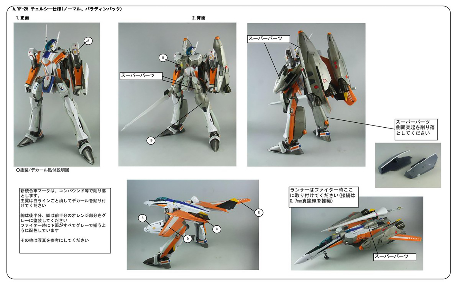

Jasonc Posted May 11, 2018 Author Posted May 11, 2018 OK, I will be putting these up for sale in another thread, but for those of you who have already purchased them, here are the origin instructions. The kit is put together the same way basically. Aside from slight aesthetic designs being redone, I did change the backpack hinge and there are steel metal pins that fit and need to be cut on the part of the lance that connects to the backpack. I have also added two 2mm magnets that can be added to the backpack connector. They are optional to help secure the lance in fighter a little better, but aren't necessary. The sect should stay secure quite well without it. As I've mentioned earlier, there is also an optional knee connector I created that IMO, works better than the one that was designed originally. The link is in one of my previous comments here, but I have also sent a version just like the original if you want to keep that original. In any case, here's the original instructions. Quote
valhary Posted May 11, 2018 Posted May 11, 2018 I have the digital version believe with better resolution Quote
Jasonc Posted May 12, 2018 Author Posted May 12, 2018 Much, much better. I'm going to try to see if I can make some directions with the new parts, but it's fairly easy to do them. I started work on this today, as I caught a bit of a nasty cold this week, and had to call in the last two days. I'm hoping to have this part done over the weekend, but I seriously doubt I'll get it done. Too many things to do, but here's the first stages with the newer designed parts... Quote
Xigfrid Posted May 12, 2018 Posted May 12, 2018 Thank you both for the instructions, I will try to get some time to assemble and paint it but I have been very busy lately with 3D modeling. Quote

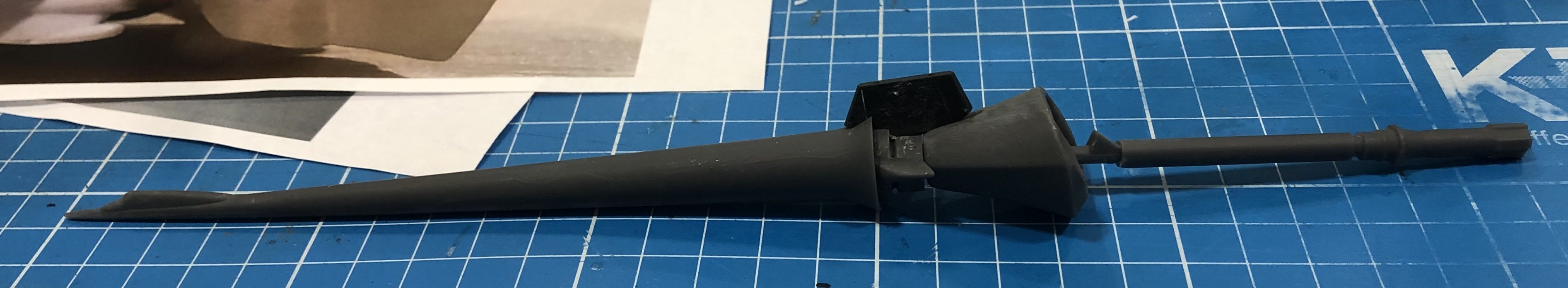

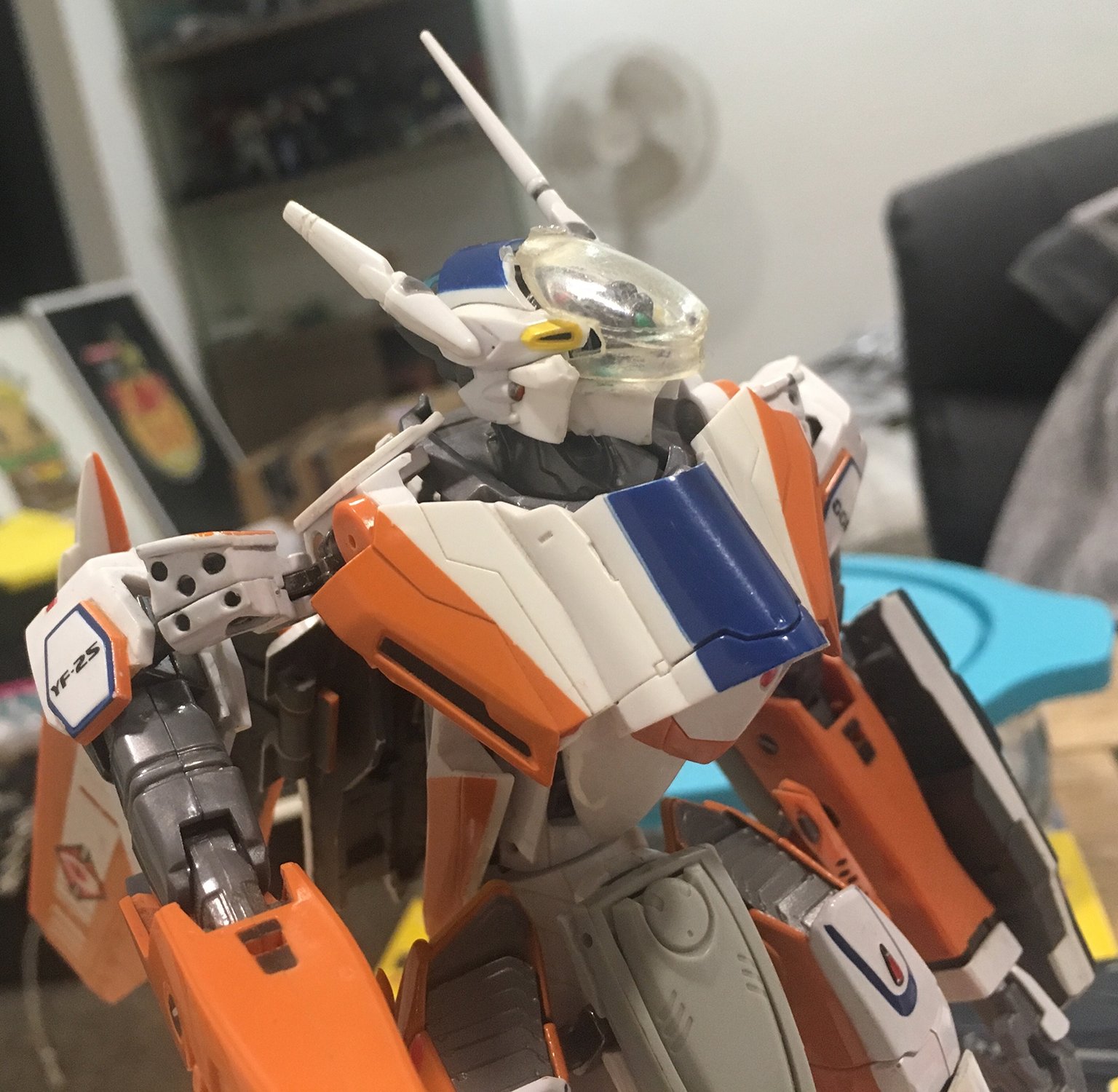

Jasonc Posted August 4, 2018 Author Posted August 4, 2018 So, it has been awhile, but I started putting together the kit I designed, and while I've already put up pics of the head, the lance is now to a point where I can put up pics of the work. Enjoy. Sorry if it's a big pic. I'm doing this from my cell phone. I just need to put the armor connector piece, and paint in some details, and it's all done. I've also got a chrome tint on the parts that will be on the armor. Quote
valhary Posted August 7, 2018 Posted August 7, 2018 (edited) finally I received my kit complete now need a tutorial for unassembled the head Edited August 7, 2018 by valhary Quote
Jasonc Posted August 7, 2018 Author Posted August 7, 2018 The head needs to have the current glass popped off. Mine luckily came off easily. It takes some work. I think the official instructions on the page may explain how to take it off. Quote
Jasonc Posted August 7, 2018 Author Posted August 7, 2018 1 hour ago, Xigfrid said: That chrome is looking sharp ! Thanks. That's a lot of light sanding, with primer, thinned out gloss black, and thinned out high metal chrome paint. I have one bottle of it left, and it's painfully hard to find locally. Nevertheless, I'm hoping to have more done tonight on the lance. I'm going to put some gold paint on some trim, and get the attachment piece on, if I can find my dremel for the steel prongs for magnets. Quote

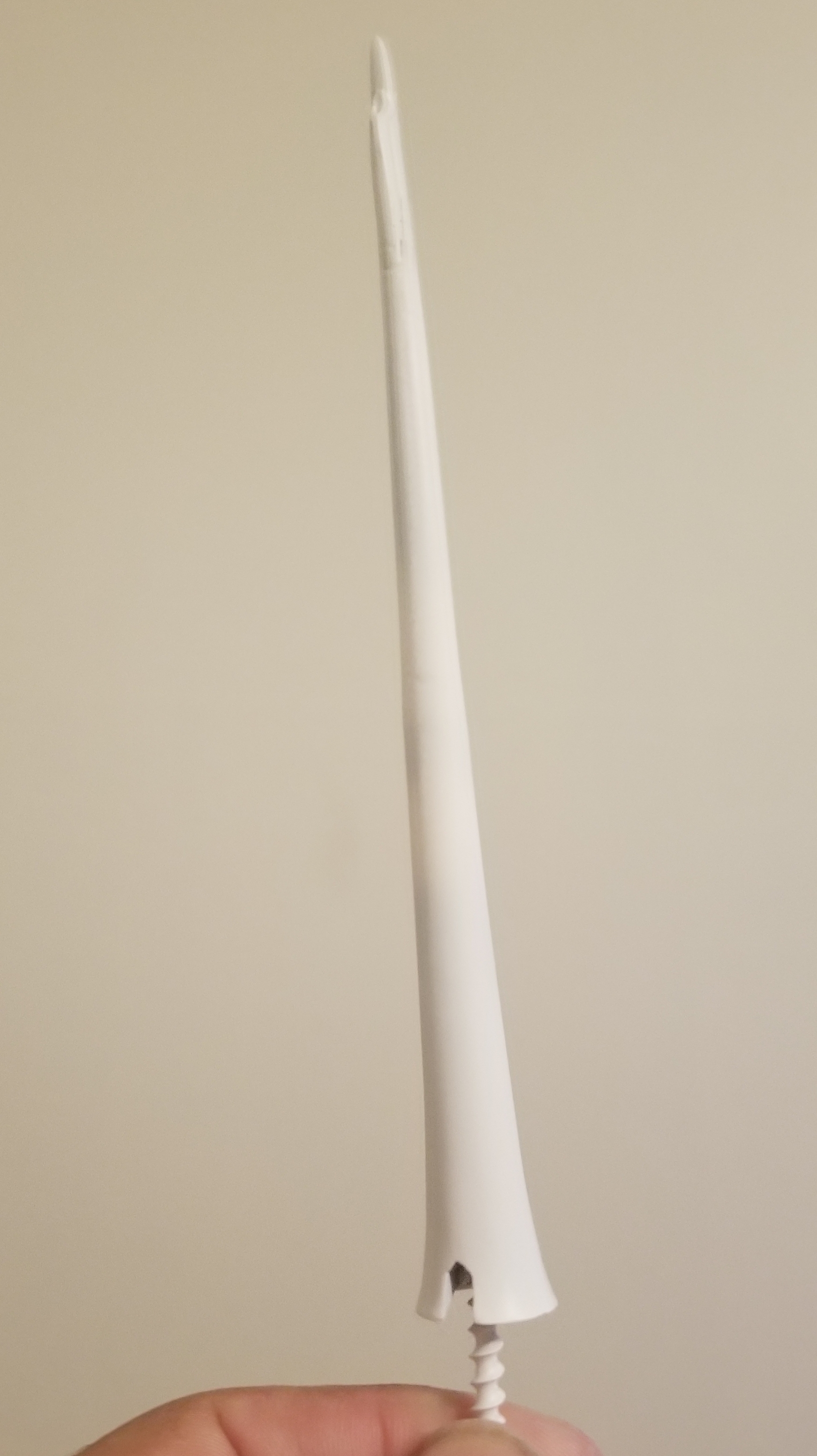

Jasonc Posted August 20, 2018 Author Posted August 20, 2018 Ok, so this is a bit of a work through with an experimental piece that actually came out way better than I had planned. Because I have Lways been a little iffy on a plastic handle being attached to the lance, I thought, "how can I put a solid piece of material on its place, and be able to carve out the part for the hand?" Well, I did some mods to the lance base, and made a 3mm diameter hole down it. Here is what it looks like So, it looks very rough, and needs a lot of paint and sanding to fill in the sponge like material. But not now. In my search, I looked for 3mm pins, pipe, something that is strong, but would be straight and do what is required. That's when I found the wood pieces I put my painted parts on. They're a little wider, but they're rough so what better way to fix them, then to sand them down. Now, it needs to be borrowed out a bit where that triangular piece on the printed part is, and about halfway down. I used an exact, the a file that is the perfect width. So this wood is actually quite strong and durable. Once everything lined up and the wood was slim enough to slide all the way in, here you go. Now the full length of the lance handle happens to be 105mm, so I now not the tip about 106cm, and sand it til it's just right. I used crazy glue to put that little triangle piece down. Crazy glue is great on two porous materials such as this 3d material (which is also very sturdy and durable) and wood. From this point, I must've used this grey primer and sanded about 6 times before it became smooth. After that, I put it together with some fine touches, and here she is. Hope you guys like it. Quote

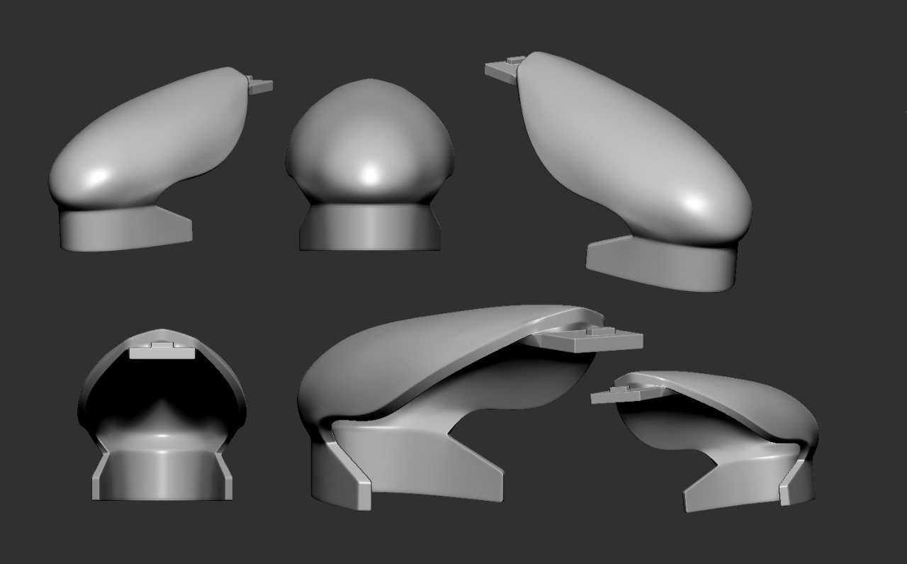

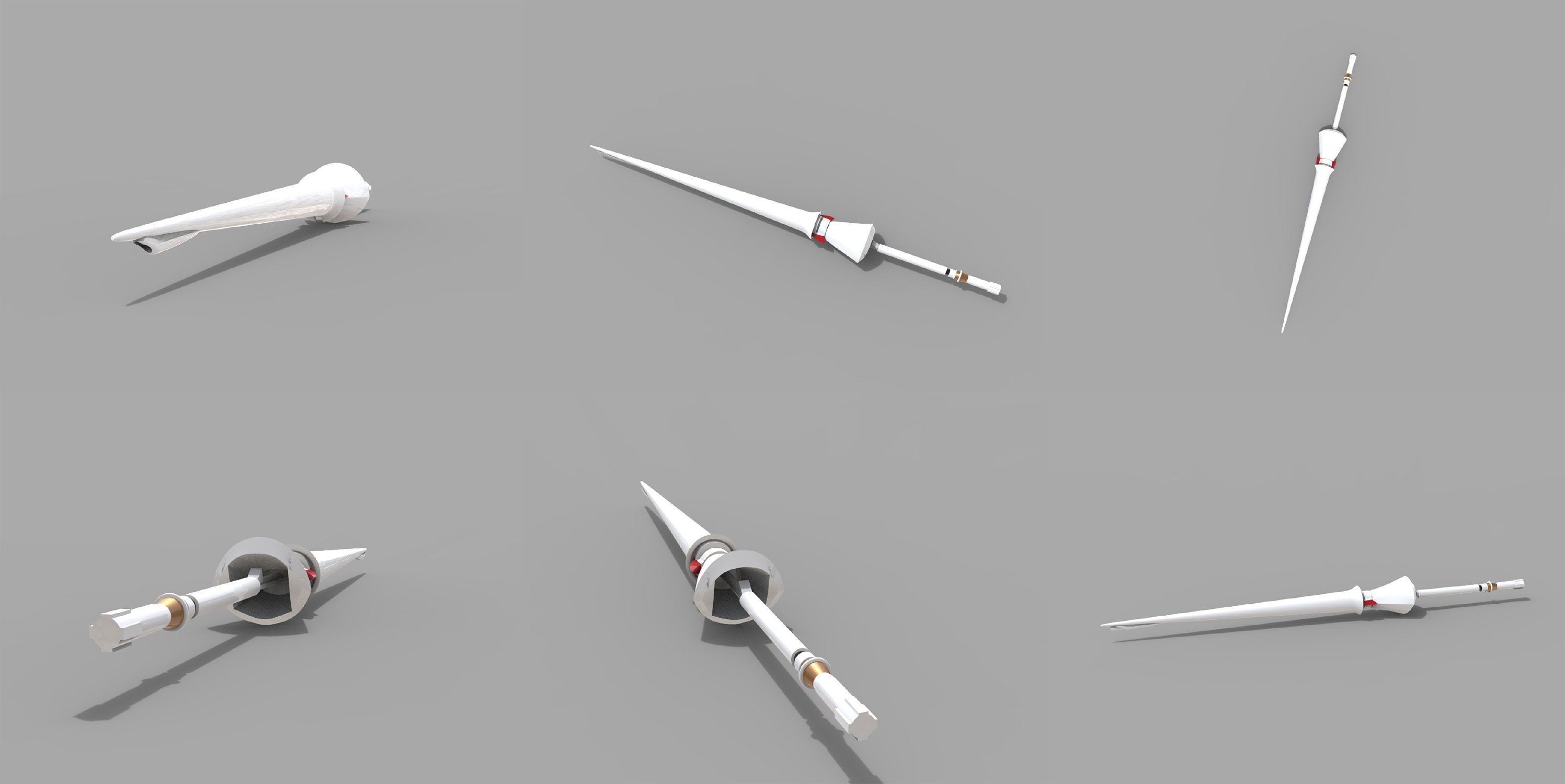

valhary Posted August 16, 2019 Posted August 16, 2019 I decided to remake in 3d print was much more easier starting from Jasonc parts (thanks again man!!!) still working in the head but I think with this system can get better quality Quote
Jasonc Posted September 27, 2019 Author Posted September 27, 2019 (edited) Since you're remaking these parts, I definitely want a set. I wasn't big on the two part lance, so is this available? The only thing though, if it is one piece, it must be a bit hard to paint the connector piece with the silver and orange, no? Edited September 27, 2019 by Jasonc Quote
valhary Posted September 27, 2019 Posted September 27, 2019 (edited) Let me make the resin test (still working in the head) and once will be ready you can decide if want the complete kit or choose specific only the parts that you need Edited September 27, 2019 by valhary Quote
Chronocidal Posted September 27, 2019 Posted September 27, 2019 If that lance is one large piece, how sturdy is the material at the thinnest part of the handle? That looks like the weight of the part may be enough to just snap it, unless there is some sort of stronger internal reinforcement. Quote
valhary Posted September 30, 2019 Posted September 30, 2019 In fact the lance was made in parts as soon as I can will post some pics to clarify Quote
