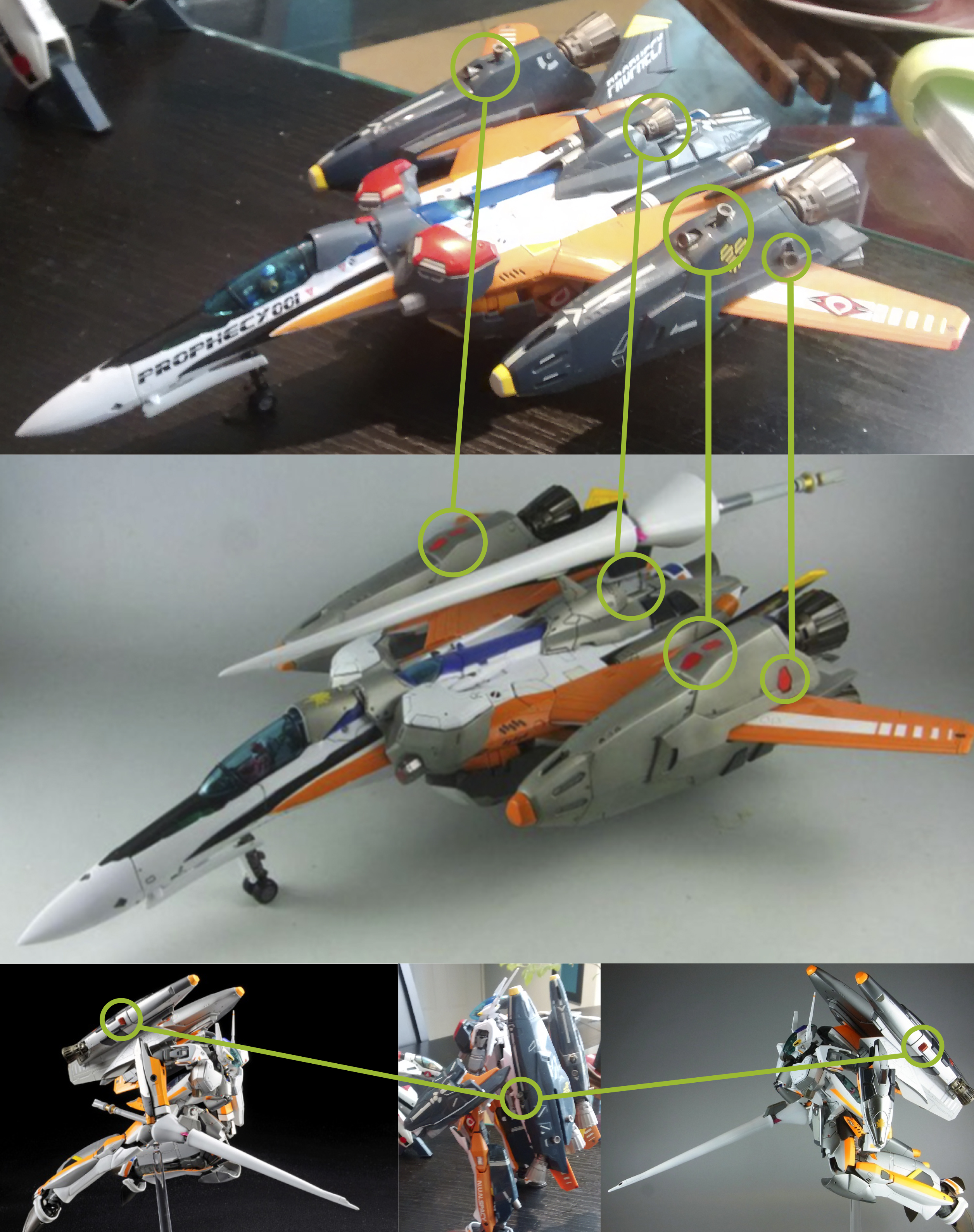

Jasonc Posted November 26, 2017 Posted November 26, 2017 Hey all. So, I was able to start on converting a Bandai DX YF-25 Prophecy into the Paladin version. I have the set from the WF kit that was done by Frameout a few years ago, and with me now being done on a project, have begun taking the super and armor parts of extra sets, and being able to use them for the kit. As I was not completely happy with the Frameout kit (not the best resin for a heavy lance), and parts that seemed to fit a little loose, I started 3D printing my own parts. They look similar to the original parts, but have differences in measurements and fits that IMO, make it slightly better. I've also used a sturdier resin that can hold up to the lance being the largest and heaviest part. So I hope I can make a version of this kit. It shouldn't be too difficult, and hopefully as I work on my build here, if anyone is interested in a set, send me a message. I may put up an interest thread later, but I can at least start to see if it's worth it. Anyways, without further ado, the project has begun. Quote

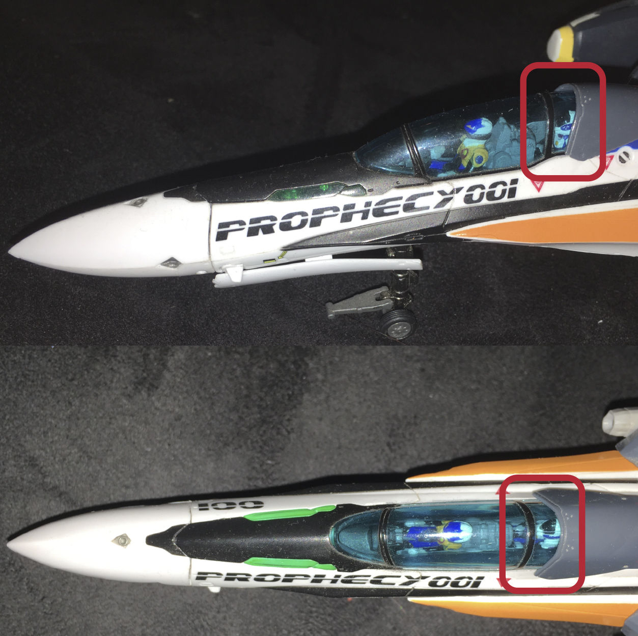

Xigfrid Posted November 26, 2017 Posted November 26, 2017 Awesome project, add me on the list! My main grippe about the Prophecy is the weird shape of the dual seat canopy, is it something that you can do? Quote
valhary Posted November 26, 2017 Posted November 26, 2017 add me at the list too!!!!!!! this is what we need more macross the ride stuff Quote
Jasonc Posted November 26, 2017 Author Posted November 26, 2017 2 hours ago, Xigfrid said: Awesome project, add me on the list! My main grippe about the Prophecy is the weird shape of the dual seat canopy, is it something that you can do? I probably could, but it wasn't on my list of things to do with the the set. So far, I've managed to do all of the lance, and most of the face parts, save for the visor. 31 minutes ago, valhary said: add me at the list too!!!!!!! this is what we need more macross the ride stuff Will do, and yes, I agree that we need more MtR stuff. I'm a huge fan of the custom work they did. I've got several of the pieces done, and once I'm finished, if I can get enough orders for it, I'll begin recasting the pieces. I'll need to figure out what I'm going to do with the clear visor, but once I get it all put together, I'll let you know. Quote

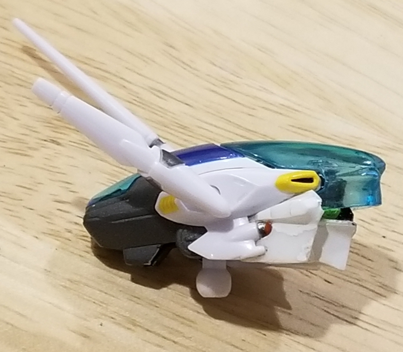

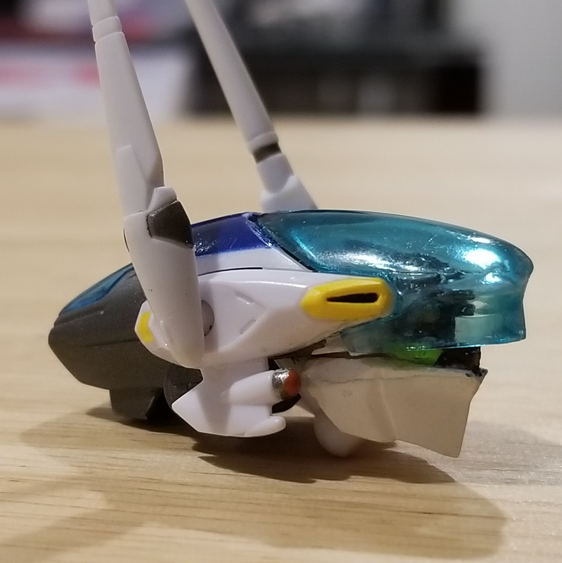

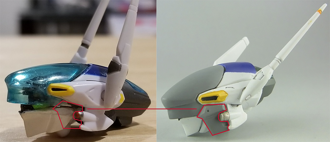

Jasonc Posted December 19, 2017 Author Posted December 19, 2017 Well, the cheek guards I designed work perfectly. They do require some sanding and cleanup like all resin, but they fit smoothly (after two tries). Quote

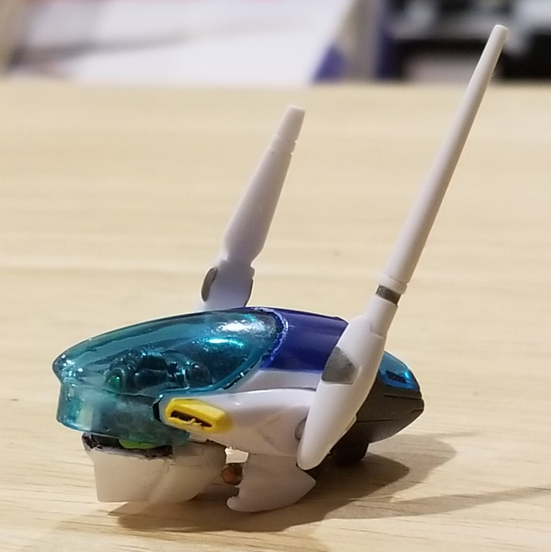

Jasonc Posted December 27, 2017 Author Posted December 27, 2017 On 12/24/2017 at 1:41 PM, valhary said: This will be epic I hope you upload all the process I will. I'll try to do it during the week. I've spent the better part of 4 months tweaking the angles and measurements of the front head glass just to get it where it is now. I'm quite happy to say that it now fits and works as it should. Dome may ask why I'm recasting it, instead of just putting it up on Shapeways. Well for one, you can never get this clarity in any shapeways print work. This allows me to continually recast them and not have to spend a fortune getting any sort of frosted xtreme detail parts made. Plus, FXD is extremely brittle. The idea is to have you guys not have to buy anything from shapeways, with the exception of 1 part that I simply cannot recast due to the complex design. In any case, this is an actual recast part, and you can see how clear it is. I'm very happy with this. Quote
Xigfrid Posted December 27, 2017 Posted December 27, 2017 Hum that brings a question, are you going to recast in blue or white? I can see that both colors could be great. Quote
Jasonc Posted December 27, 2017 Author Posted December 27, 2017 I'm going to keep it clear. The reasoning is that I don't mix enough clear resin to put any pigment in. Pigment messes with the integrity of the plastic, and because I use such a low amount each recast, I don't want to make it soft. Clear resin already is kinda flexible. Quote

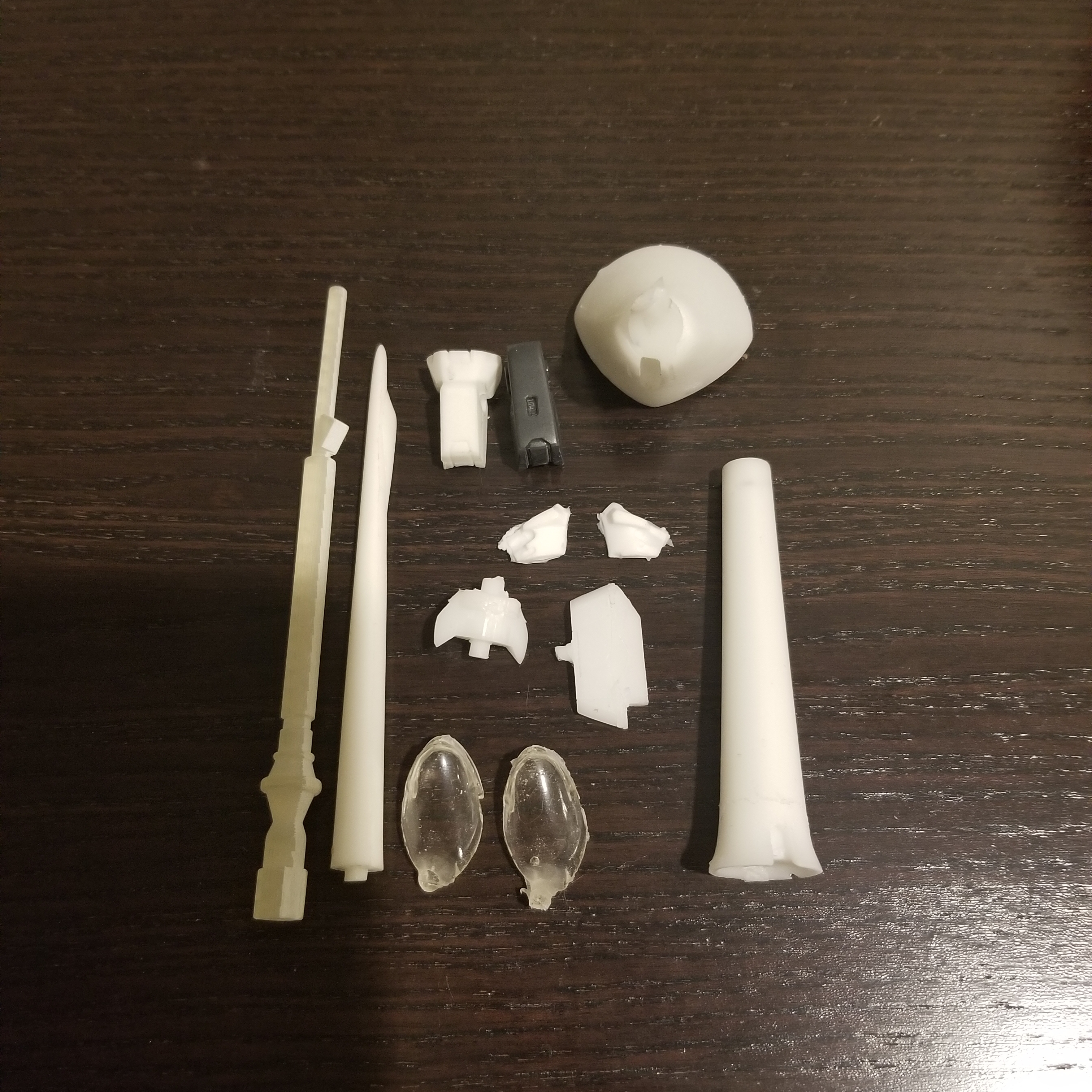

Jasonc Posted January 5, 2018 Author Posted January 5, 2018 K guys, I have some updates for the set I created. It is finished and I have started recasting parts. If you are interested in a set, I am selling the set for $45. This will include all the parts specific tot he Paladin set. These are parts that I have designed, with small changes, but overall, can be interchangeable with the original set (if any of you have it). There is one part that I did not recast because I simply can't, but can be found on Shapeways. I did redesign another knee joint that looks like the original piece, so I can add that as well for the option. In any case, the set is done, and recasts of the original printed parts are being made now. If you want a set, send me a pm. Shipping should be very low, as the parts are light. I will also scan a copy of the instructions here, so that everyone can see how the parts are to be put together. I have enough for about 15 sets max, and after that, I'm not making anymore of them unless there's a large demand after, which I doubt. Quote

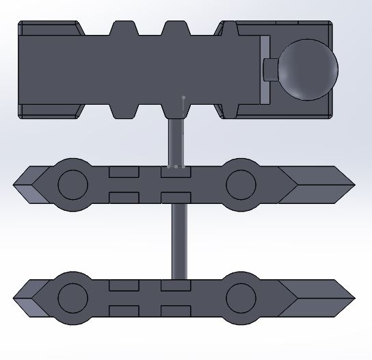

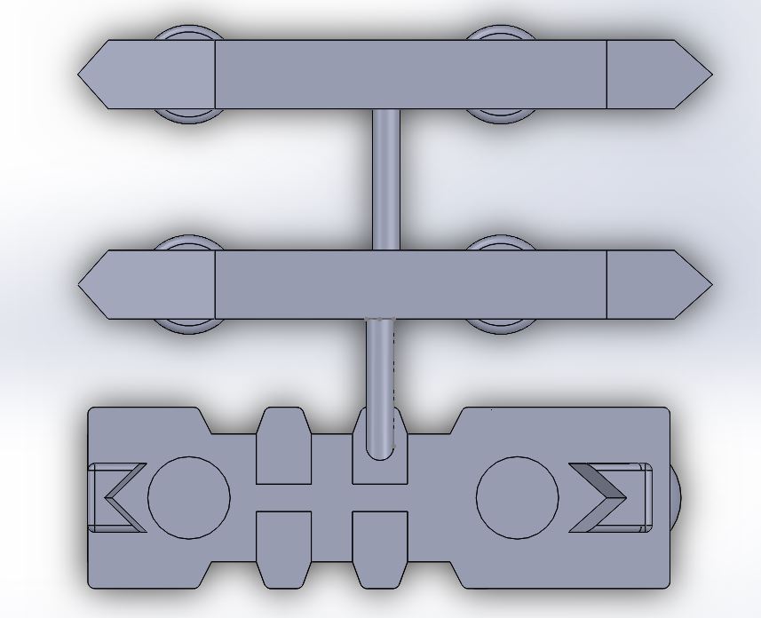

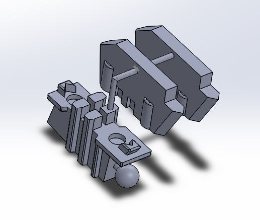

Jasonc Posted January 24, 2018 Author Posted January 24, 2018 (edited) In working on the parts, I realized that the lance being mounted on the top of the fighter isn't designed to hold without any glue. Because of this, I have spent some time redoing the top part of the lance and the backpack harness so that it can hold for both modes. you'll notice there are some indents on the harness, and on the lance piece that connects. I have designed some guides on the harness, as well as indents for 1mm x 3mm magnets to be placed inside it, as well as two 2mm thick steel rods to go in the lance piece that will help keep it down. I don't know how strong it will be, but if all works out, it might be able to provide some swooshing in fighter. I also made two different sized steel harnesses on two different lance pieces. I will try both, and whichever one is better, I'll obviously use that. I was about to send out a set to someone, but after dry fitting them, I was just really unhappy that the original set had two little nubs smaller than 1mm to hold the entire thing. It wasn't designed to hold properly, so let's hope this works better and I hope this design will be worth it for you all who want this. Edited January 24, 2018 by Jasonc Quote

Xigfrid Posted January 24, 2018 Posted January 24, 2018 You can enlarge them up to 1,1mm radius/2.1mm diameter and you will be good for WSF. I personally prefer WSF for its strength over FUD or FXD, specially for transforming toy! Quote
Xigfrid Posted January 24, 2018 Posted January 24, 2018 Also if you consider WSF premium, you should look into HP WSF they are at the same price and HP will need a kit more sanding but the details would be top notch Quote
Jasonc Posted January 24, 2018 Author Posted January 24, 2018 (edited) I'm going to be recasting parts, so crucial parts have been enlarged to account for resin shrinkage, but using fxd will save on cleanup, and the resin will make these pretty solid pieces. I do need to keep in consideration once I makeparts for a store though. It's why I tried to order two material versions. I'll readjust the model for way premium. Edited January 24, 2018 by Jasonc Quote
