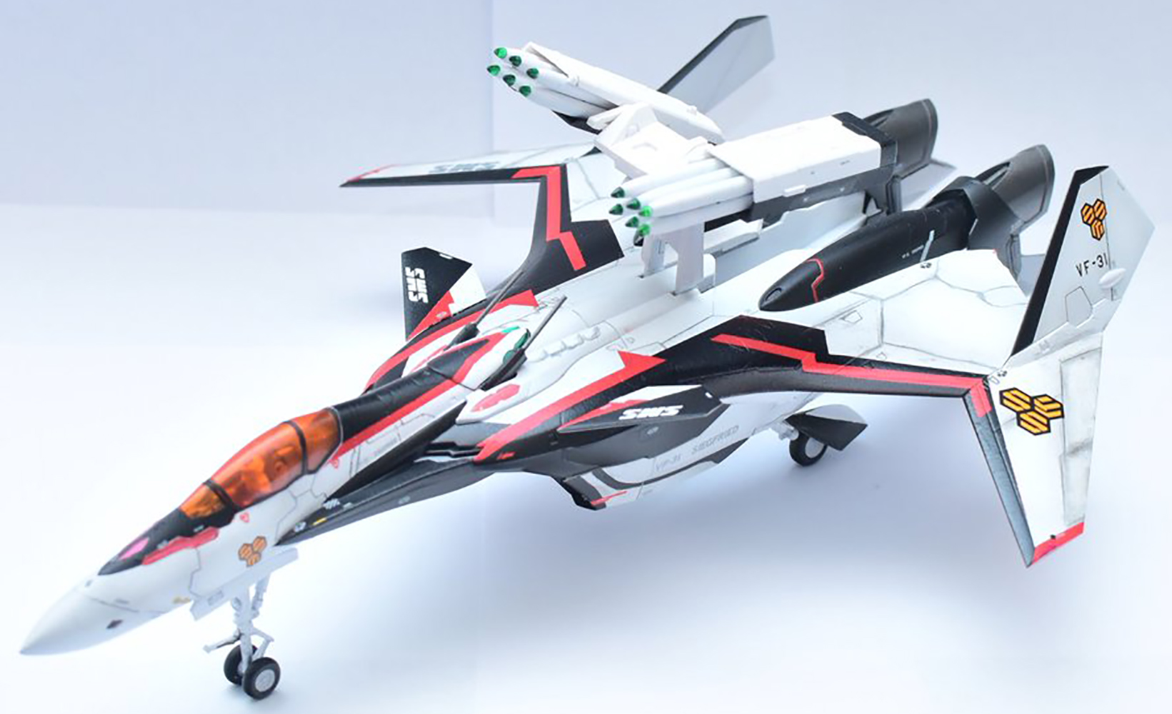

Shapeways parts have arrived.
Looks like some parts need a bit of tweaking, specifically the mating pegs between top/bottom of the main housing. The missile inserts need a bit more clearance between the missiles and the holes they poke through, especially if paint is going to be involved.
On the plus side, it looks like the hinge mechanism works great, and the door meshes properly with the lines of the housing. Also the size and shape is pretty damn close to the original.
I may end up making different versions of the parts based on print material, as the differences in fit and finish are quite large.
[edit] I'll put up images a bit later or tomorrow.

Alright, modified and re-uploaded all the part files.
Ordered myself a full set in FUD, except the doors which are in Hi-Def Acrylate for strength.
Should get here first or second week of December, once I verify that everything works, I'll publish the CAD files and open the shapeways files for printing.

Got the parts, most are good but I've got a few small issues to fix. The Acrylate doors need to have the hinge pin holes drilled out (with a 0.5mm drill bit...), also slightly bent and a bunch of nubs that need cleaning, probably will just reprint in FUD. There was also an interference I missed the first time around on the body shell, so need to update the model. I'm not going to reprint that, just shaved the conflicting area.
On the plus side everything else is looking good and fits nicely, even snaps onto the DX just fine and slots/deploys in fighter mode.
Once it's up I suggest printing everything in FUD or FED. Acrylate seems to need some work: drilling, de-nubbing, and some bending to straighten.
Full Imgur Album
Edited by Sanity is Optional
