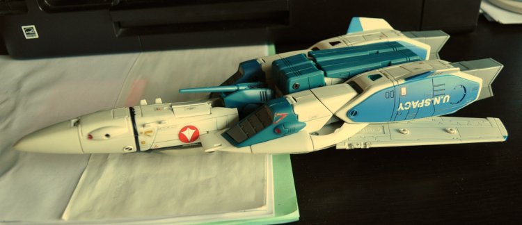

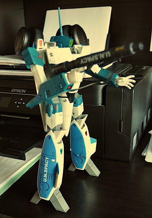

Ignacio Ocamica Posted October 30, 2019 Posted October 30, 2019 Here's a before/after pic. Now my TV CF is white again. Hope it stays this way!!! Quote
Lolicon Posted October 30, 2019 Posted October 30, 2019 8 minutes ago, Ignacio Ocamica said: Here's a before/after pic. Now my TV CF is white again. Hope it stays this way!!! WOW!!! That's incredible! It's like a brand new valk! Was this using hydrogen peroxide or the technique with the UV light? Quote
Ignacio Ocamica Posted October 30, 2019 Posted October 30, 2019 56 minutes ago, Lolicon said: WOW!!! That's incredible! It's like a brand new valk! Was this using hydrogen peroxide or the technique with the UV light? Yes, it's as white as when I first got it! I used the hydrogen peroxide technique. Quote
CHAVAKAISER Posted October 30, 2019 Posted October 30, 2019 Hace 1 hora, Ignacio Ocamica dijo: Aquí hay una foto de antes / después. Ahora mi TV CF es blanca otra vez. ¡¡¡Espero que siga asi !!! unfortunately the yellow will come back, but you can do the treatment as many times as you want Quote

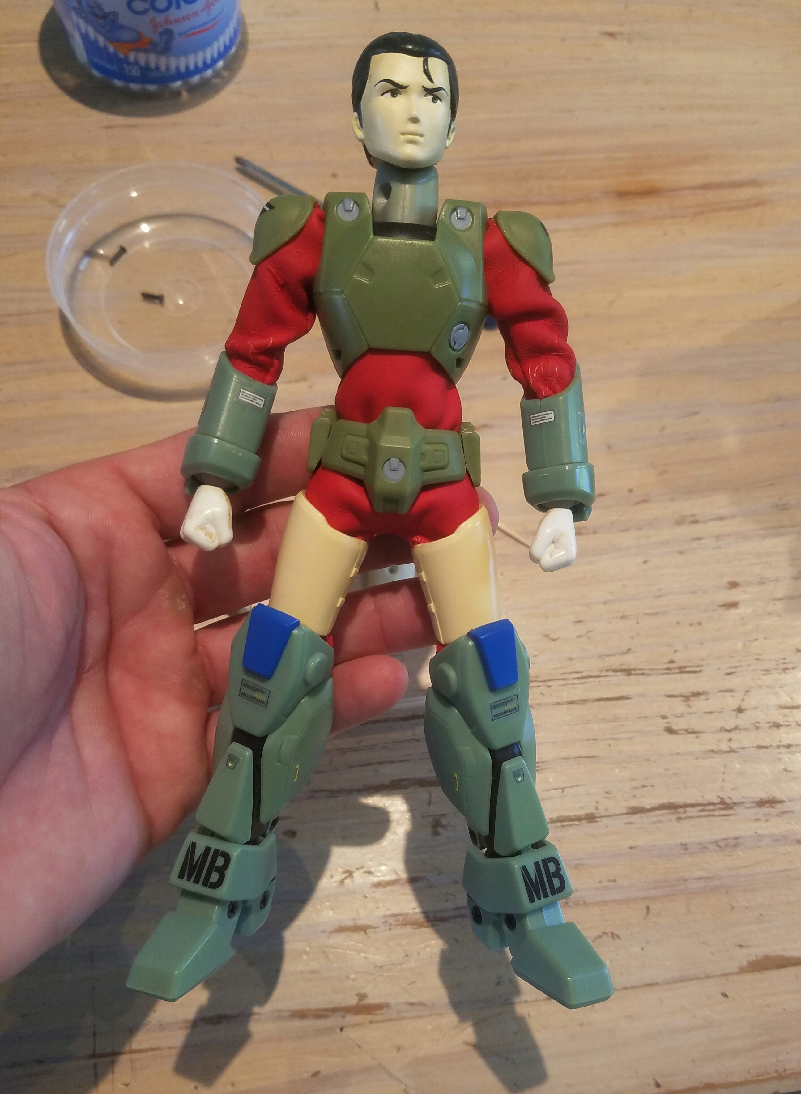

Ignacio Ocamica Posted October 31, 2019 Posted October 31, 2019 1 hour ago, Pedro2k6 said: Nice...Thank you Ignacio. You're welcome!! Now it's Rei and Stick turn (their thigh armor): Quote

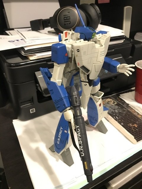

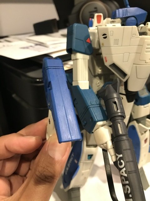

Mog Posted May 20, 2020 Posted May 20, 2020 So, apparently white and grey aren’t the only plastics that can “yellow”: Granted, I’m the idiot that left it up in the attic for the past seven years enduring all sorts of SoCal temperature variations. But the 1/48 was left in her original box, which doesn’t have a flip cover and doesn’t allow any sort of light through. Surprisingly the white parts haven’t really yellowed much if any, and I already repainted the yellowed/“tealed” parts back to Macross blue. Comparison of repainted arm to tealed-out arm: One half showing the damage, and one half repainted: Quote
Sanity is Optional Posted May 20, 2020 Posted May 20, 2020 In this case, it's probably outgassing from the plastic (including the clamshell) in a sealed space, plus the temperature spikes that did it. Quote
Mog Posted May 20, 2020 Posted May 20, 2020 Yah, kinda figured that’s what happened. Just surprised it impacted the blue plastic but had no impact on any of the white plastic. Or if it actually did impact the white plastic, it yellowed all the white pieces consistently. In any case, I’m glad it was only the blue that was affected. Made it a quick fix-up: Quote
nightmareB4macross Posted May 20, 2020 Posted May 20, 2020 2 hours ago, Mog said: Yah, kinda figured that’s what happened. Just surprised it impacted the blue plastic but had no impact on any of the white plastic. Or if it actually did impact the white plastic, it yellowed all the white pieces consistently. In any case, I’m glad it was only the blue that was affected. Made it a quick fix-up: Wow, that looks great! Which color did you use and brand. Even if they are a bit yellow, these old 1/48s do look great overall. Quote
David Hingtgen Posted May 20, 2020 Posted May 20, 2020 Yeah, blue plastic yellows (greens!) quite a bit, it's among the worst colors after white. I don't think I've ever seen red turn orange, though. Quote
Mog Posted May 20, 2020 Posted May 20, 2020 Regarding your question @nightmareB4macross, it’s Citadel Base Caledor Sky. It’s the same blue I used to touch up and brush paint parts of my custom SDF-1. Staring at the TV Max, the Citadel paint is just a smidge darker than the blue on the legs. But it’s passable. Quote
Lolicon Posted May 21, 2020 Posted May 21, 2020 18 hours ago, Mog said: Yah, kinda figured that’s what happened. Just surprised it impacted the blue plastic but had no impact on any of the white plastic. Or if it actually did impact the white plastic, it yellowed all the white pieces consistently. In any case, I’m glad it was only the blue that was affected. Made it a quick fix-up: Did Yamato make a 1/48 Max or is that a custom job? Either way it looks great! Quote
Mog Posted May 21, 2020 Posted May 21, 2020 (edited) Thanks. The TV Max and TV Kakizaki were some of the last 1/48’s produced by Yamato. They were packaged as Macross Chronicles, but they did NOT come with TV hands (a fellow MW’er helped me to acquire those). Edit: Actually, it was @Ignacio Ocamica who gave me the TV hands all those years ago. Glad I’m able to put them to good use again! Edited May 21, 2020 by Mog Quote

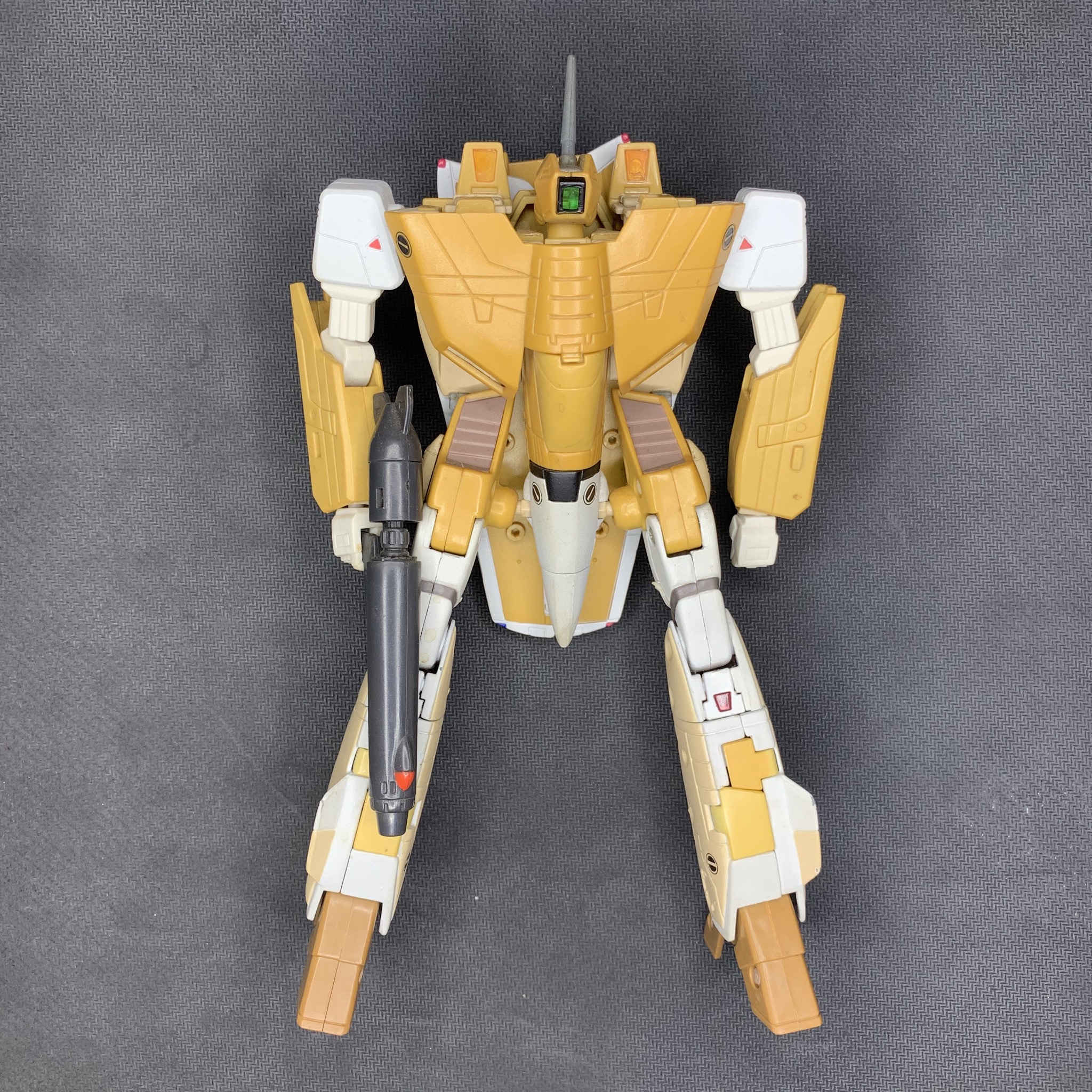

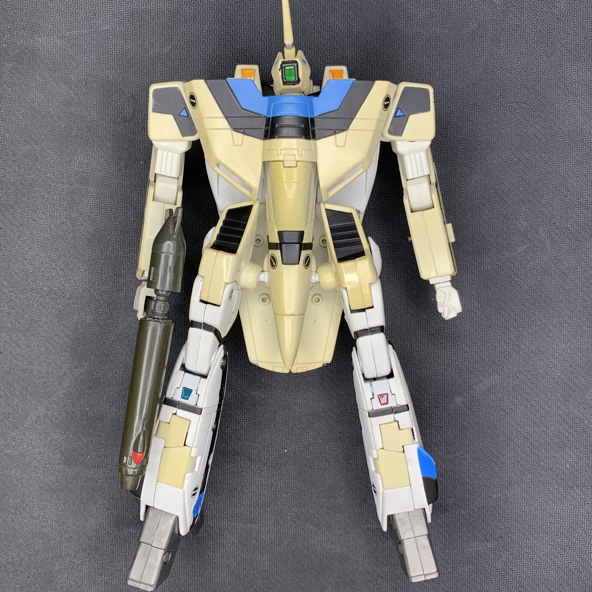

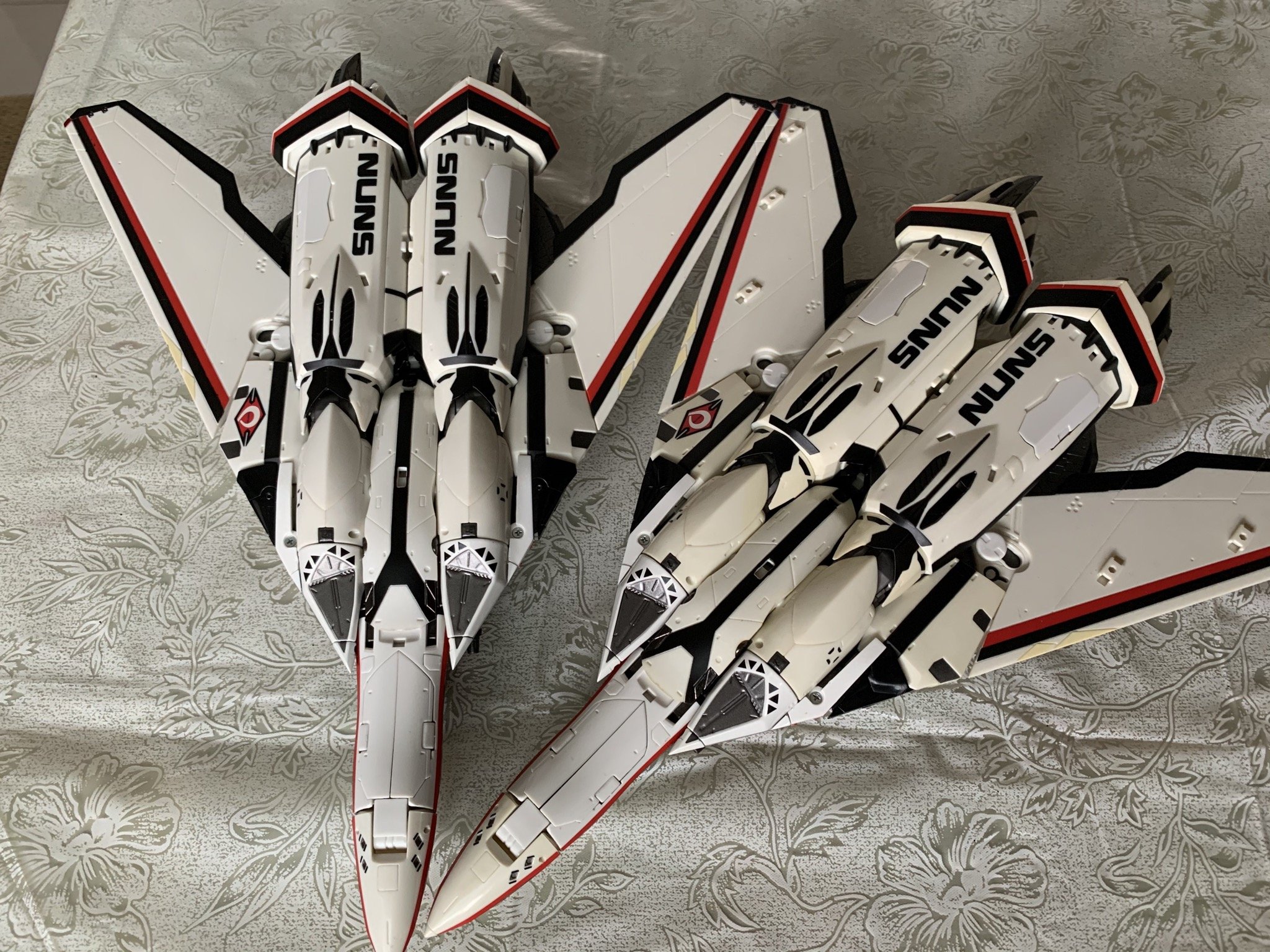

BlueMax Posted October 11, 2020 Posted October 11, 2020 (edited) These have never been exposed to direct sunlight, only ambient and fluorescent light when displayed. After the release of the V2 Yamato’s, they were retired from display and stored in almost airtight plastic bags and in darkness flor at least a decade. These are the results. The VF-1J was display and stored with the GBP-1S. You can see the difference in (dis)color. The VF-1A actually has very substantial yellowing, only mitigated by the fact that the bass plastic is already brown Edited October 15, 2020 by BlueMax Quote

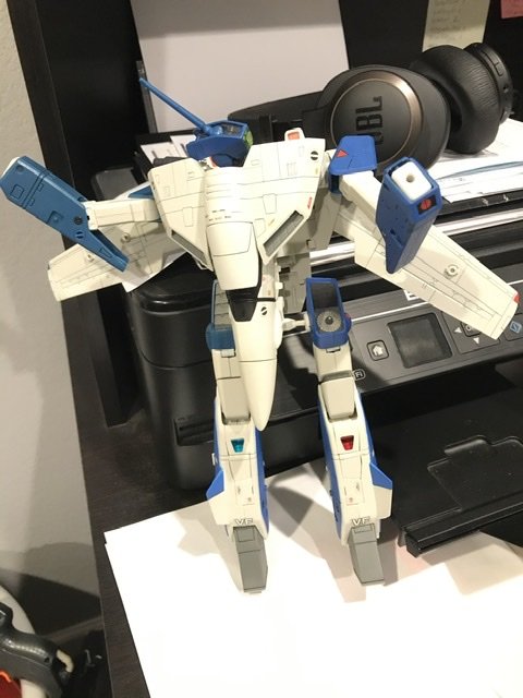

Hiryu Posted October 15, 2020 Posted October 15, 2020 I posted here a little over a year ago about my successful attempt at de-yellowing my vf-25 dx. I basted it using salon care 40 cream in sunlight, enclosed in a transparent bin. Worked brilliantly. Since then, the valk was placed on a shelf nowhere near direct sunlight. However, I am sad to report that after a year the yellowing has returned just as bad as it originally was. Areas that were not yellowing before have now started darkening as well. This is a real bummer. Wish there was a permanent solution. Quote
Lolicon Posted October 16, 2020 Posted October 16, 2020 That sucks. I wonder if after doing the whitening treatment if you should seal the valk in a layer of clear coat? Just thinking if cutting off exposure to the air would prevent re-yellowing if it's some kind of oxidation process. Quote
