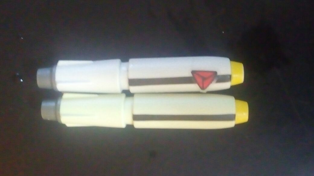

SpaceCowboy Posted March 26, 2018 Posted March 26, 2018 (edited) From my first whitening experiments, I then decided to take a G1 Jetfire and transform him into a VF-1S. I bought a yellowed G1 Jetfire for about $30. I bought a set of armor for a bit more ($50 maybe?) Before: Edited March 26, 2018 by SpaceCowboy Quote
SpaceCowboy Posted March 26, 2018 Posted March 26, 2018 Pro-Tip - don't do the whitening during one of the most cloudy February's you can remember. Quote

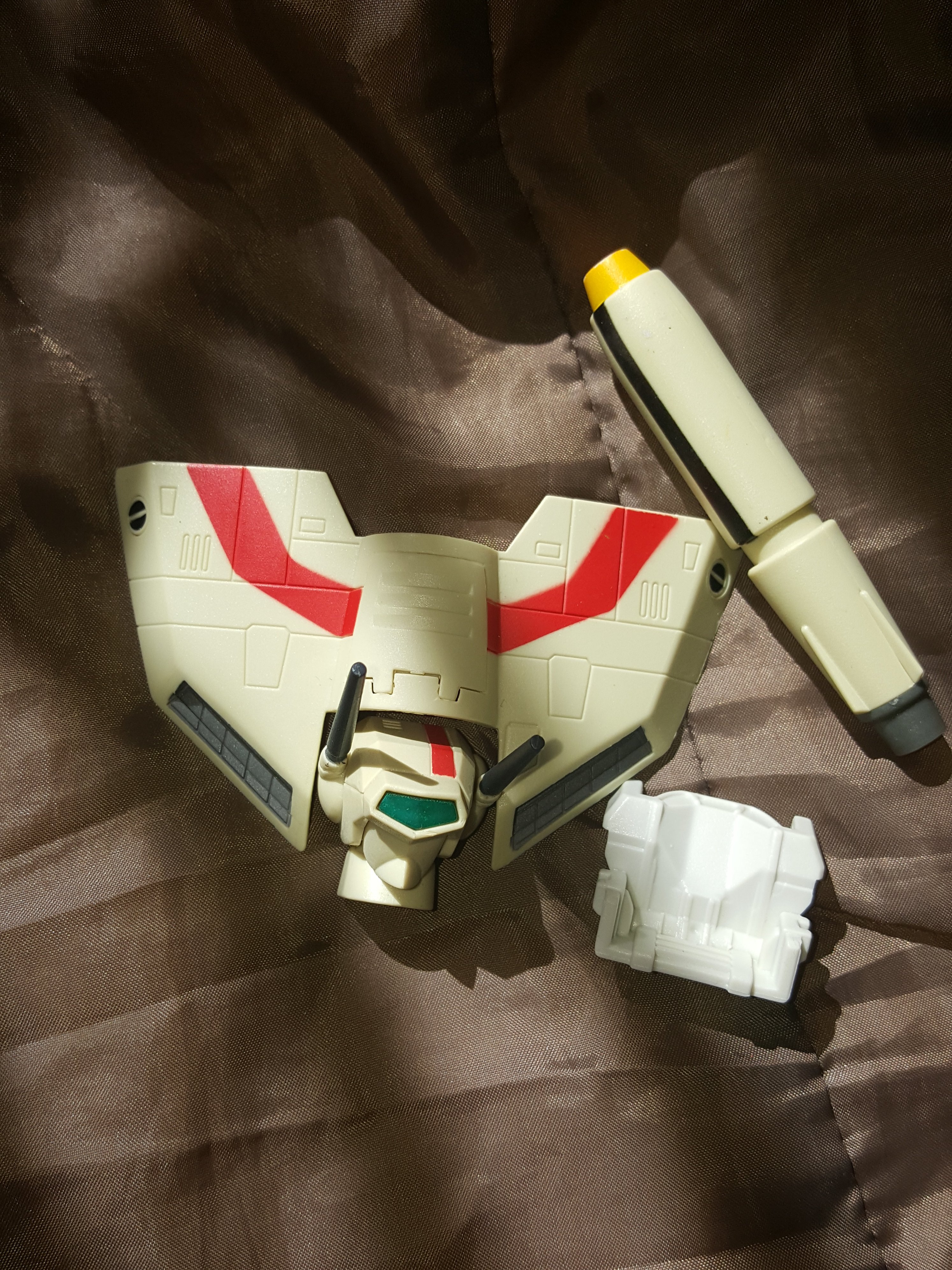

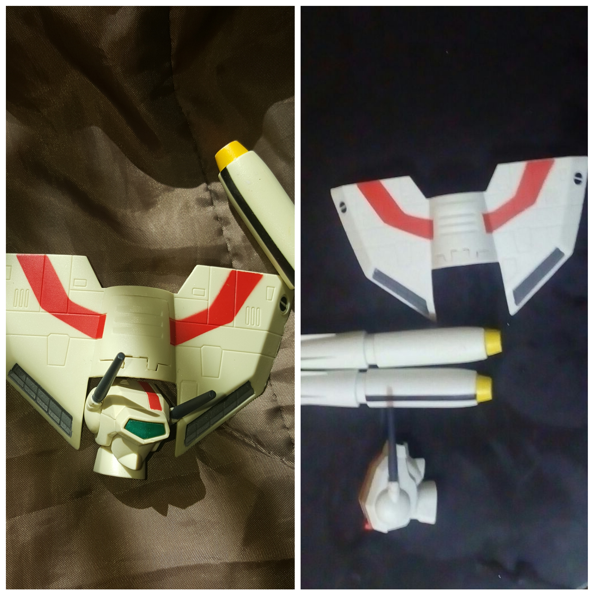

dafob Posted April 13, 2018 Posted April 13, 2018 (edited) So after going through this post I was inspired to finally try the whitening on a Yamato figure (after whitening a few G1 Jetfires). I used Developer 40 Hydrogen Peroxide Hair Gel. But I didn't want to experiment on any of mine so I picked up a cheap, damaged & yellowed 1/48 VF-1A: The yellowed figure next to a white VF-1J for comparison: Disassembled the figure in preparation for the Developer 40 treatment: The back panel and wings after one full day of sunbathing. The chest plate is untreated in this picture for comparison. The final result: It's still not as white as any of my original pristine figures but still very passable for display purposes. And especially since the junker figure only cost me $75, this experiment was totally worth it. Edited April 13, 2018 by dafob Quote
Shizuka the Cat Posted April 13, 2018 Posted April 13, 2018 14 minutes ago, dafob said: So after going through this post I was inspired to finally try the whitening on a Yamato figure (after whitening a few G1 Jetfires). I used Developer 40 Hydrogen Peroxide Hair Gel. But I didn't want to experiment on any of mine so I picked up a cheap, damaged & yellowed 1/48 VF-1A: The yellowed figure next to a white VF-1J for comparison: Disassembled the figure in preparation for the Developer 40 treatment: The back panel and wings after one full day of sunbathing. The chest plate is untreated in this picture for comparison. The final result: It's still not as white as any of my original pristine figures but still very passable for display purposes. And especially since the junker figure only cost me $75, this experiment was totally worth it. How do you go about applying the gel? Do you avoid applying onto the red and black painted portions of the plastic? Quote
dafob Posted April 13, 2018 Posted April 13, 2018 (edited) 10 minutes ago, Shizuka the Cat said: How do you go about applying the gel? Do you avoid applying onto the red and black painted portions of the plastic? From my own experience, the H202 does seem to affect some paint and not others. On my jetfires, I noticed it lightened the reds. Most of time, the solution is applied using a Q-tip directly on the plastic and over the paint. But for certain areas where I don't want the paint damaged (like the chest area in the above example), I cover the paint w/ tape before applying the H2O2. I then put those treated pieces in a sealed ziplock bag (to prevent drying/evaporation) and leave the bags in direct sunlight. Edited April 13, 2018 by dafob Quote
