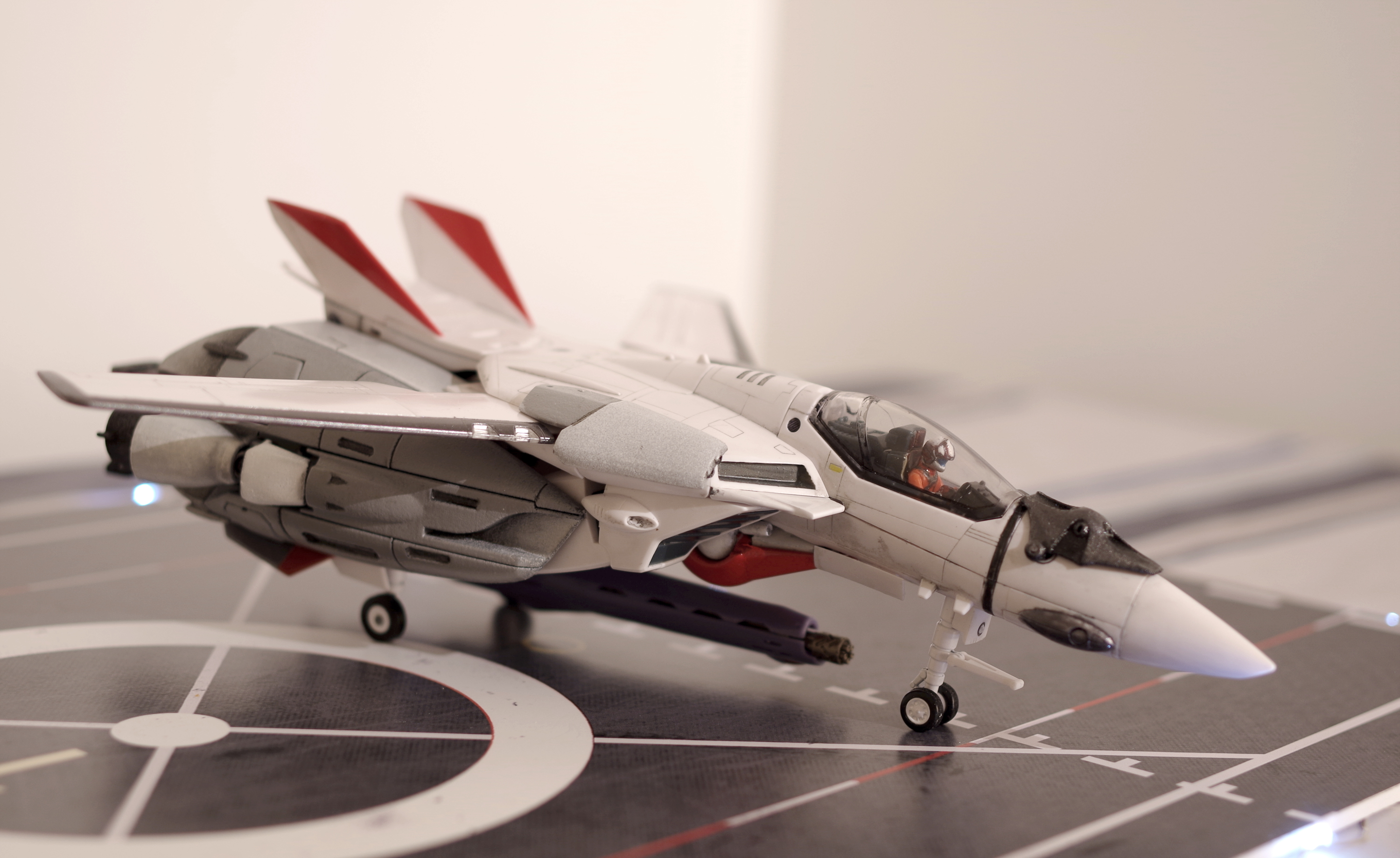

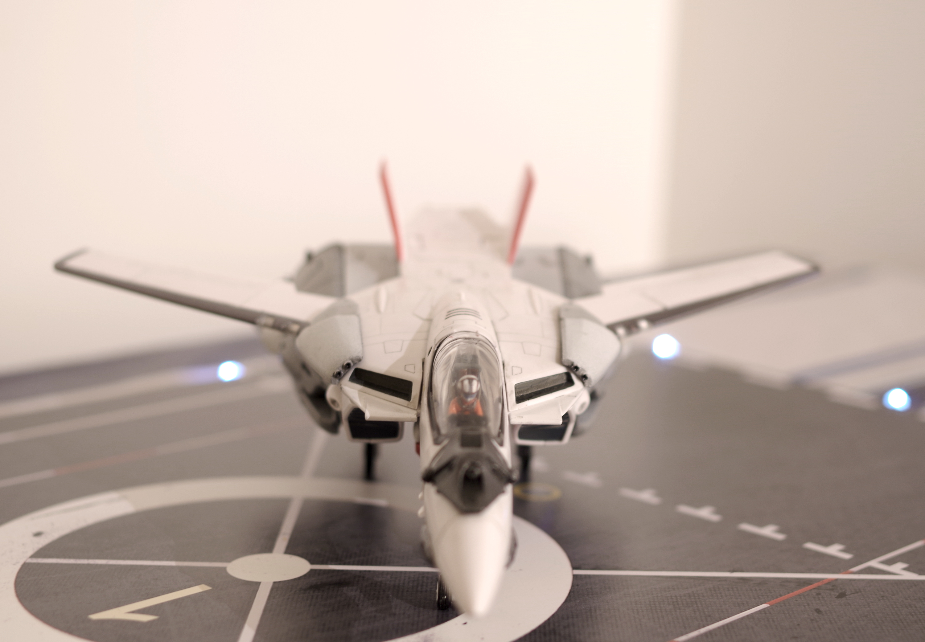

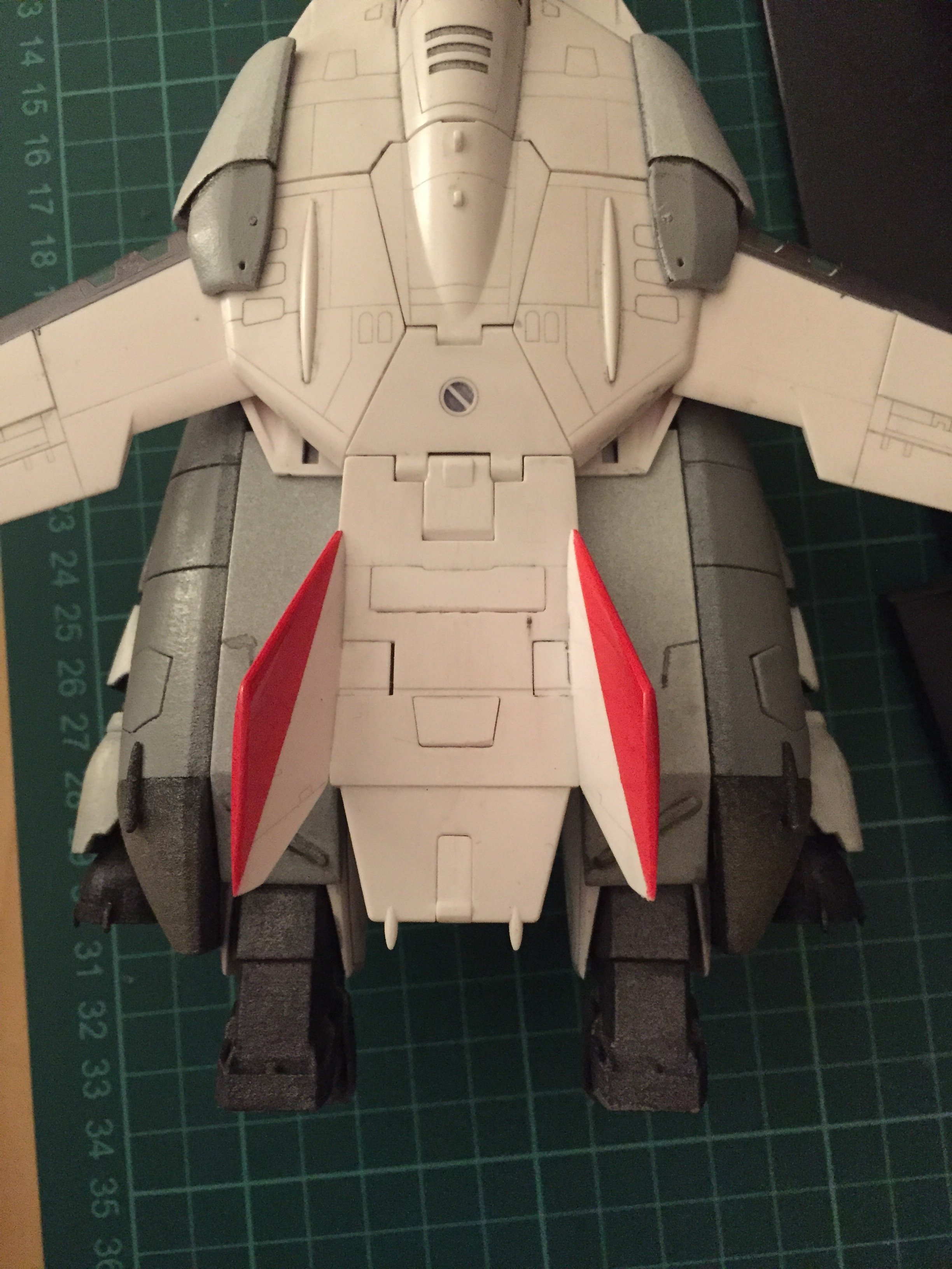

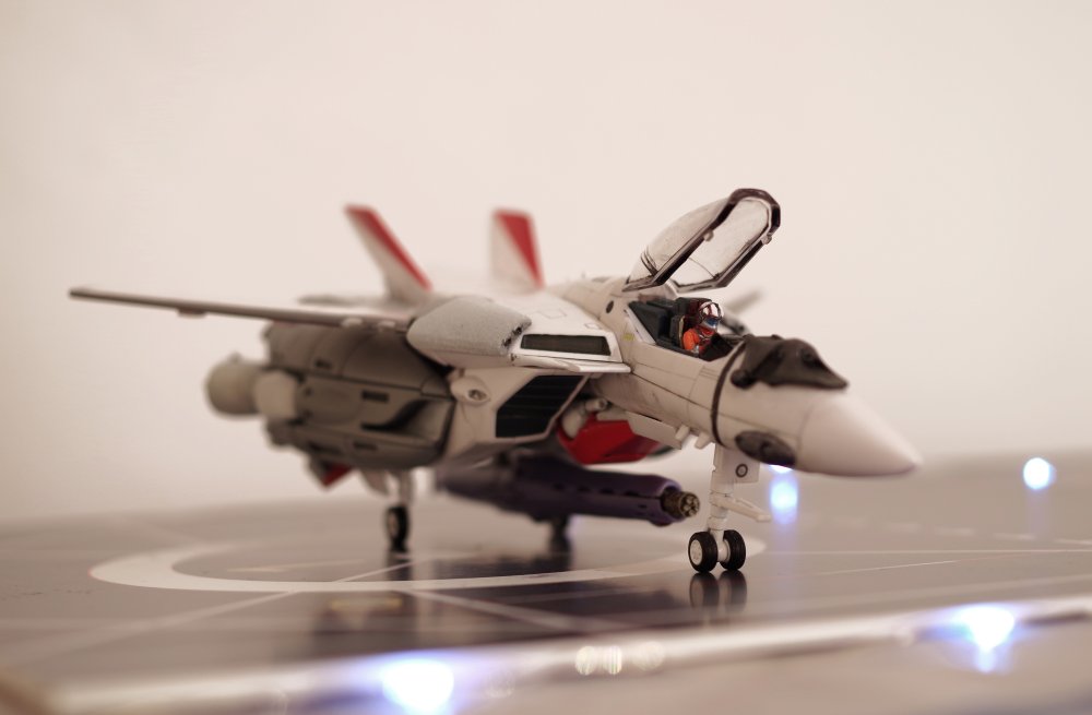

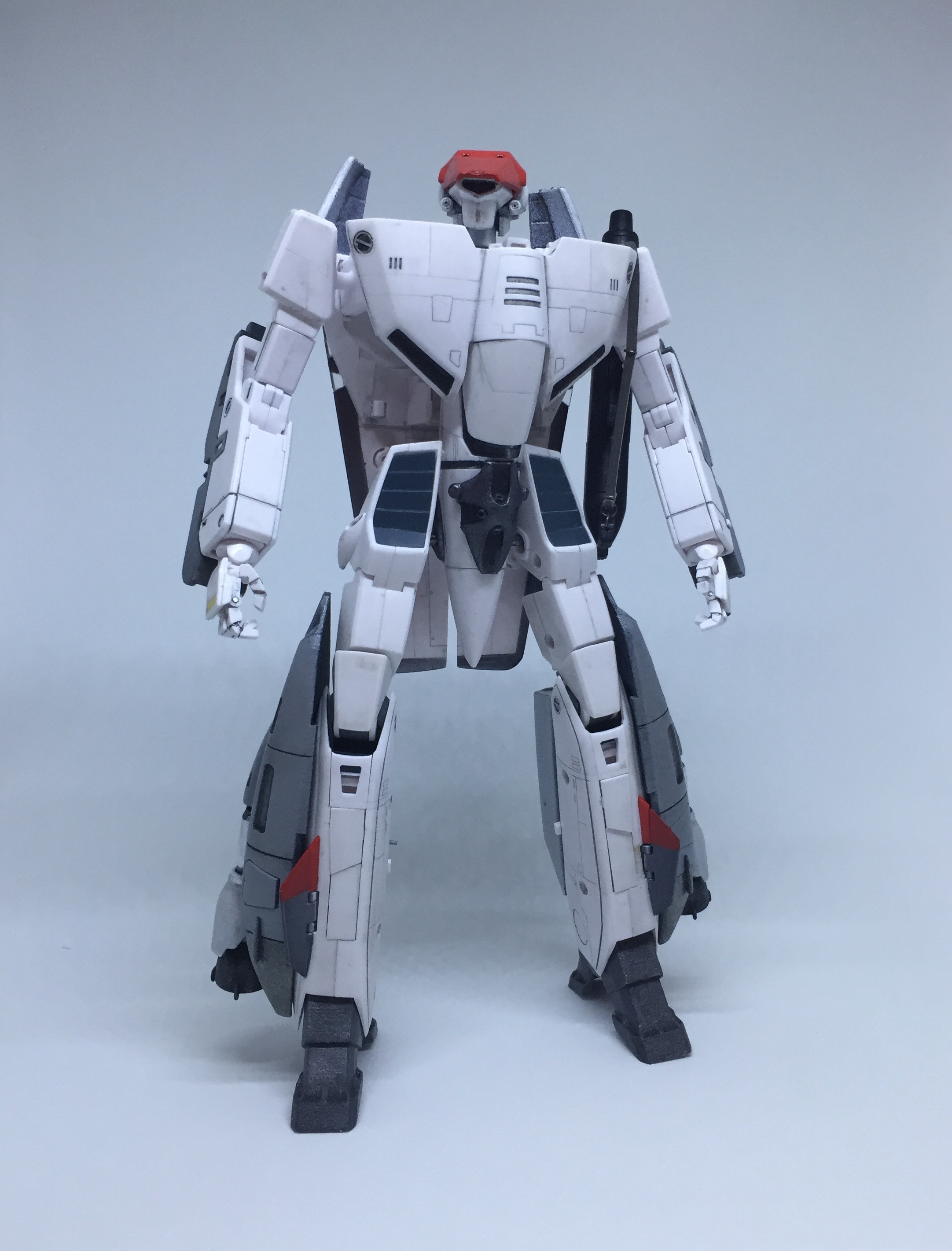

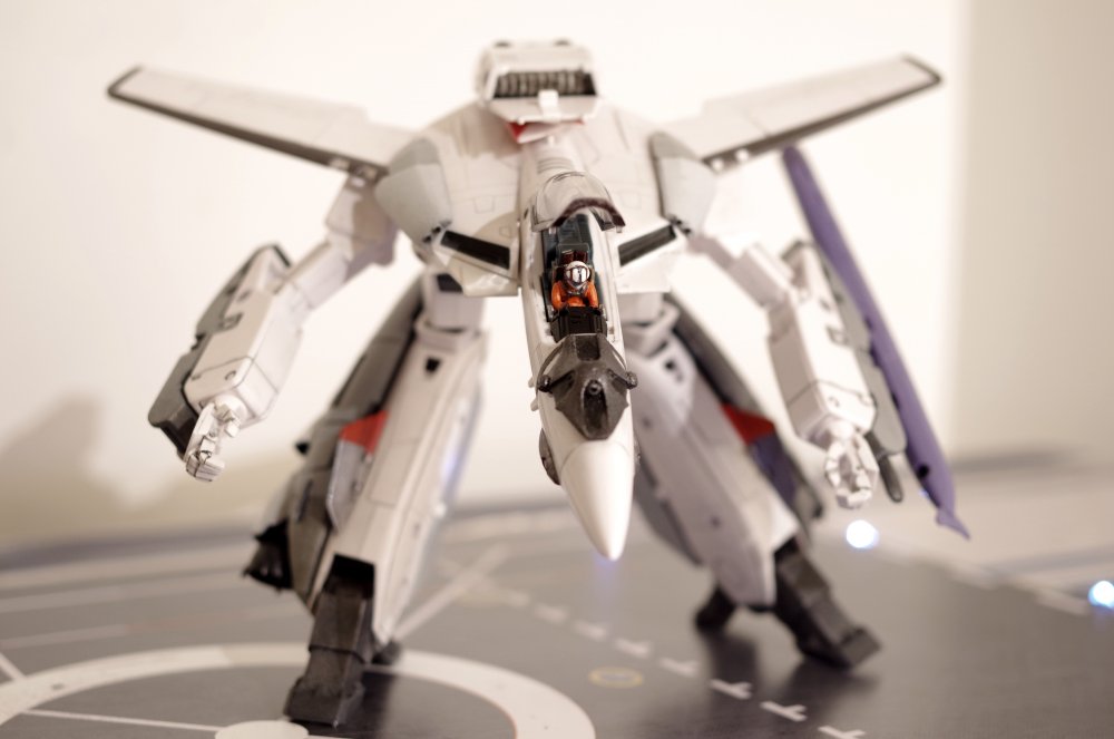

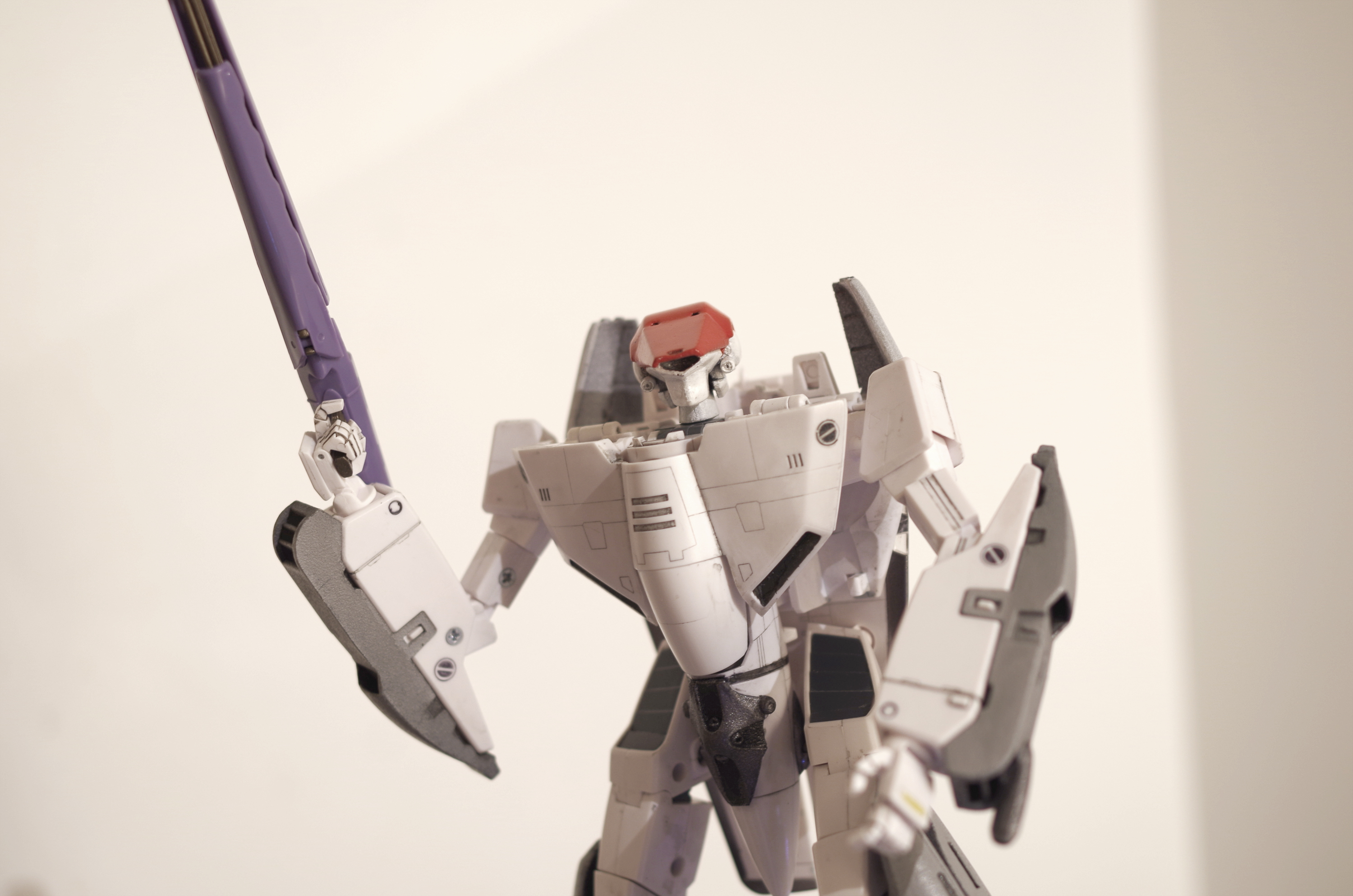

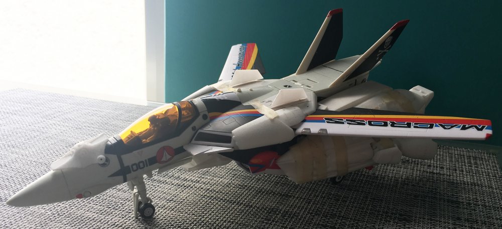

Xigfrid Posted July 17, 2017 Posted July 17, 2017 (edited) I wanted to present this custom of the VF-1X++ from Macross The Ride. The most notable VF-1X++ is ridden by Akuna AOBA in the story novels "Macross the Ride". The VF-1X++ also known as "double plus" has been produced in limited quantities. Among the special equipment, the most notable upgrades are the dual ELA-3000 thermonuclear turbine engines that have an extreme and powerful output making this VF-1 model very hard to handle. In the novel, the VF-1X++ is illustrated handling an Howard GU-17A (VF-25 gunpod), this is why this custom can store both the GU-17A gunpod and the classic GU-11 (VF-1 gunpod) in fighter mode. All the Shapeways parts are available here. They will need preparing and painting. The assembly instructions are available here. For the complete assembly, you will need a few pins cut to length, six screws flat head M1.7x6mm and two flat head M1.7x10mm And now the pictures (sorry a few clear parts are still not painted and missing) Edited July 17, 2017 by Xigfrid Quote

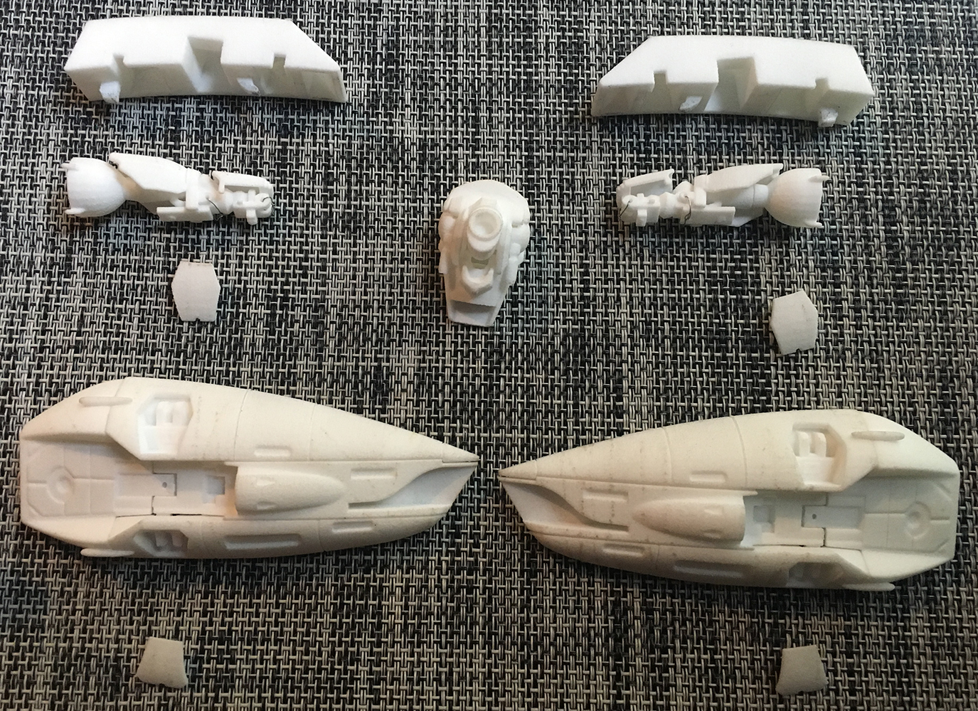

Xigfrid Posted July 18, 2017 Author Posted July 18, 2017 Thanks Bolt and you are welcome Jasonc. And don't hesitate to ask anything needed if something looks wrong during assembly. Quote

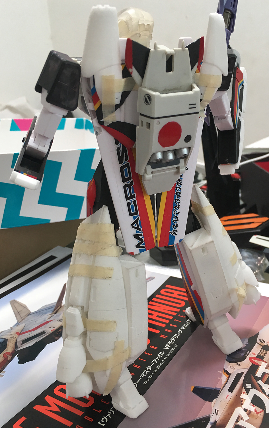

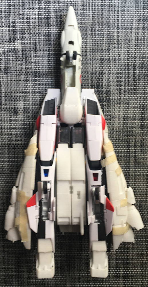

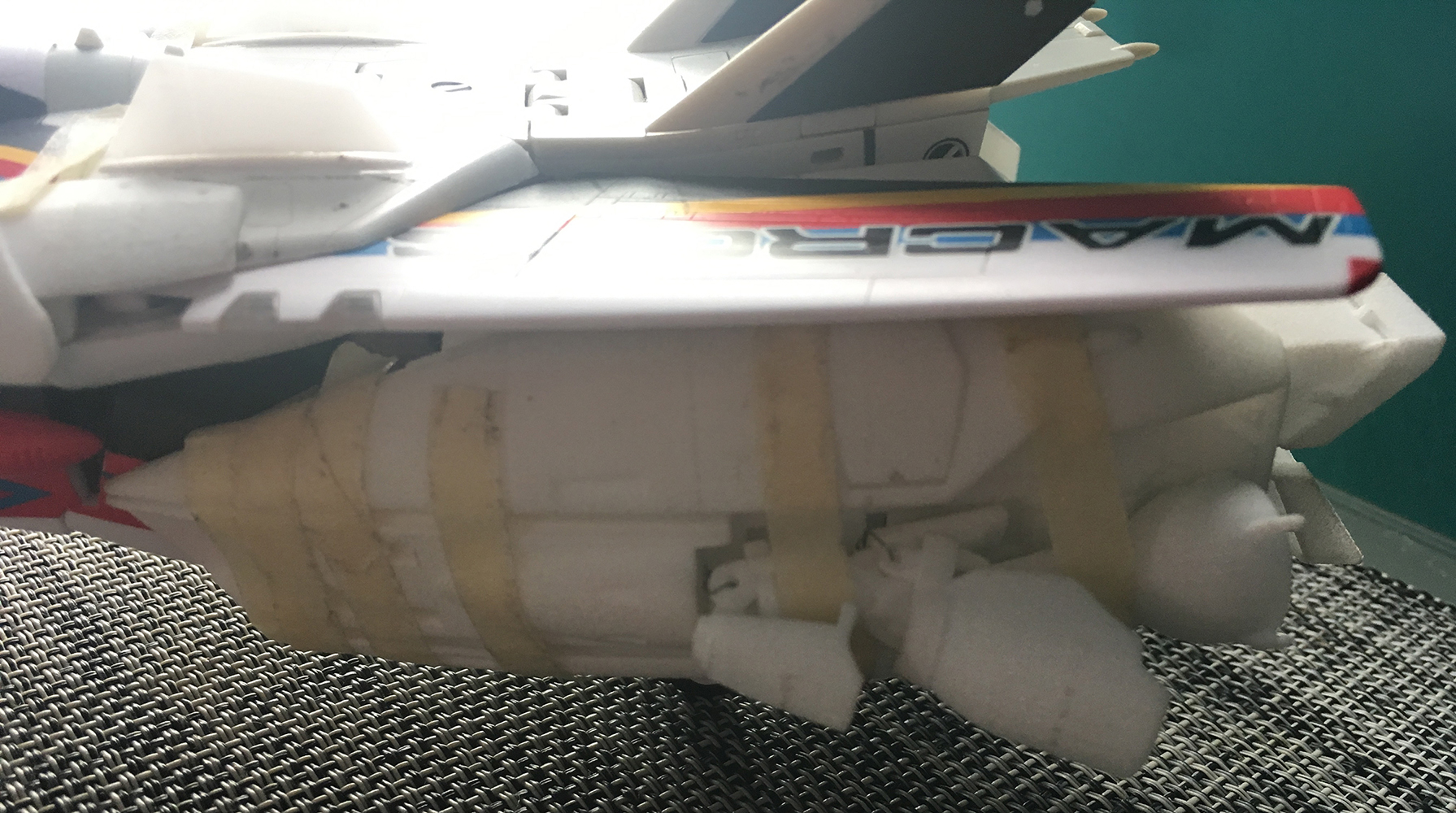

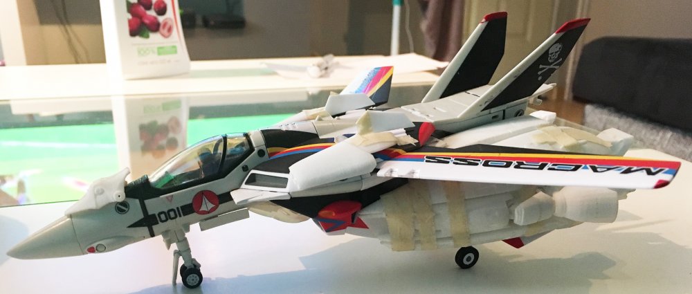

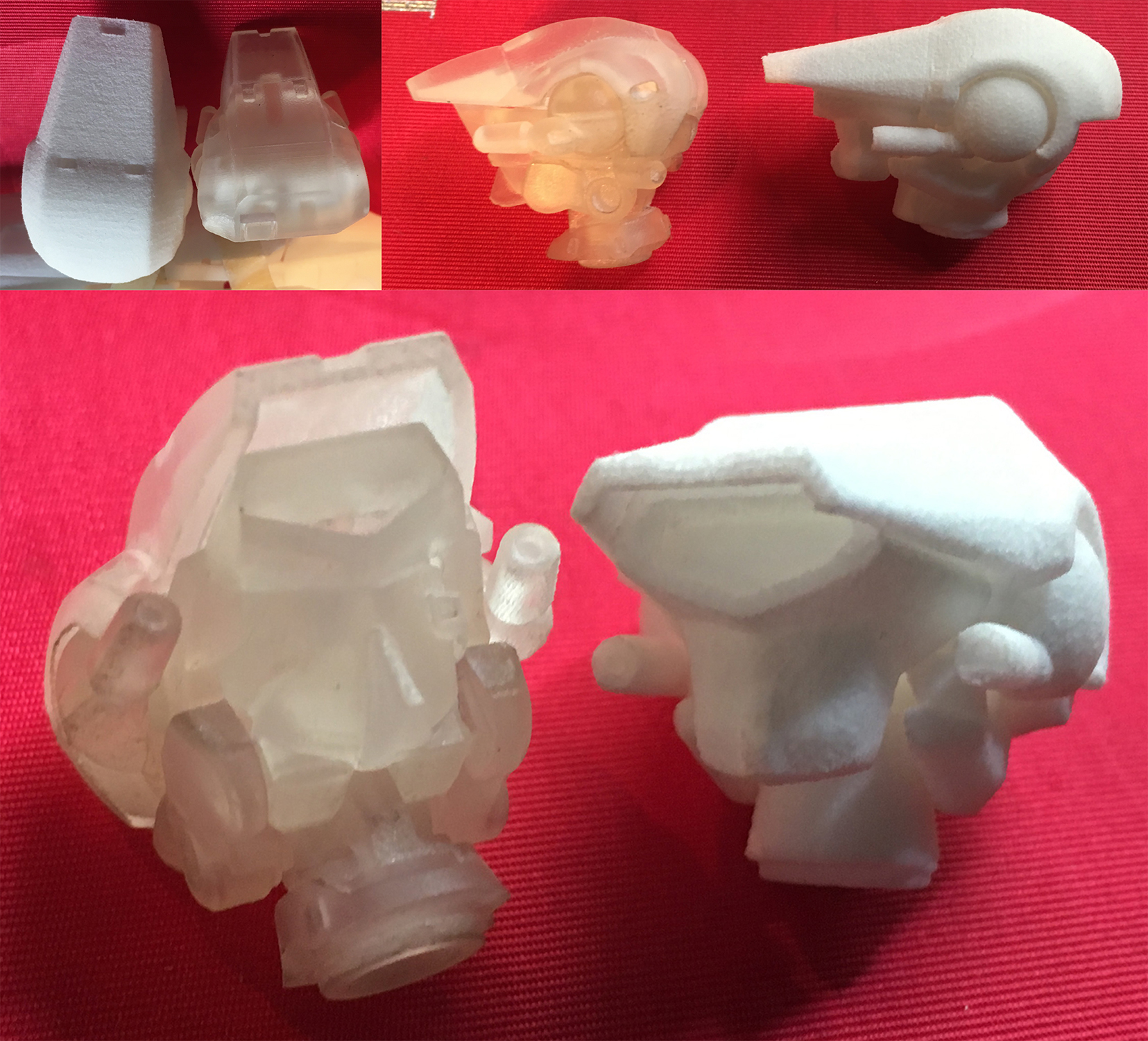

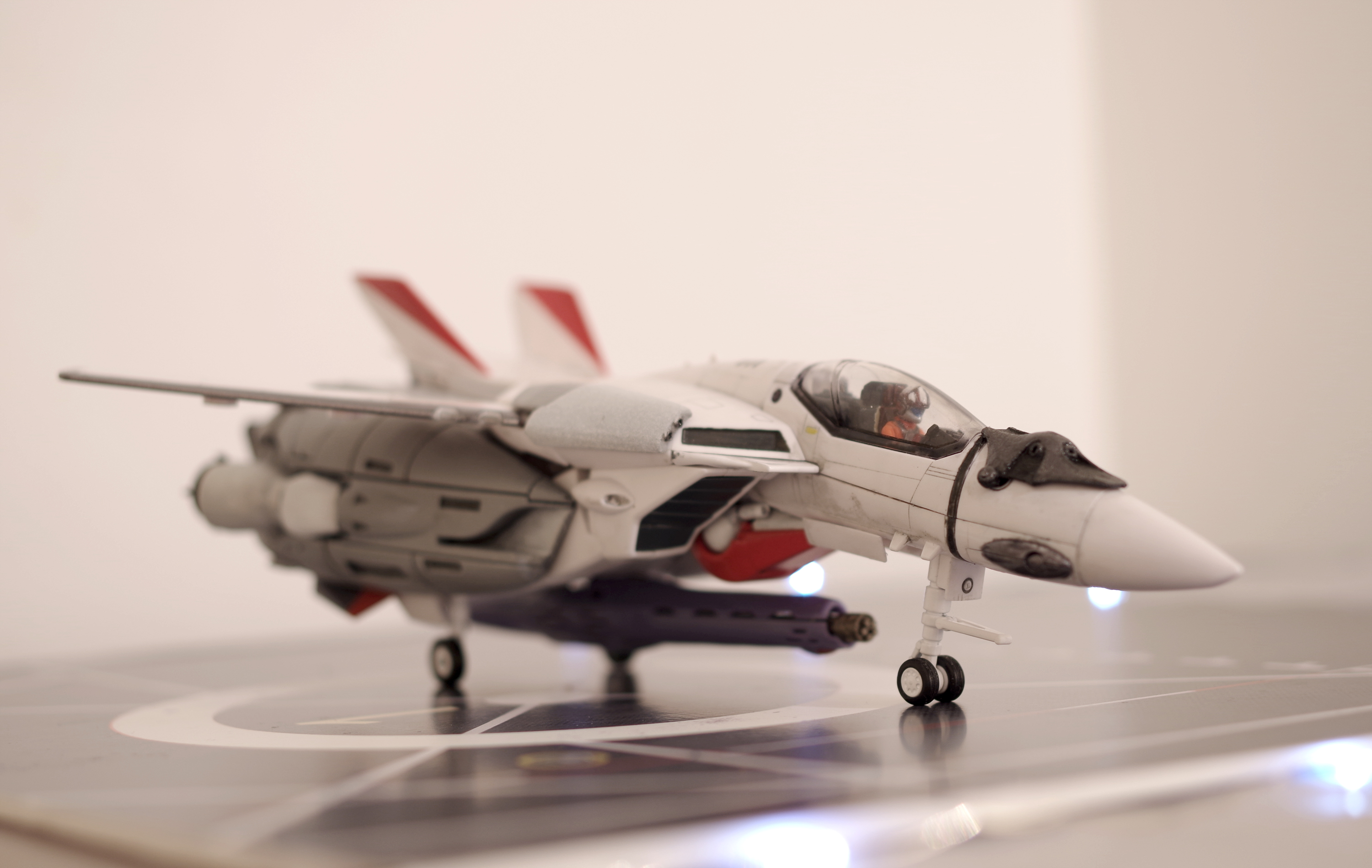

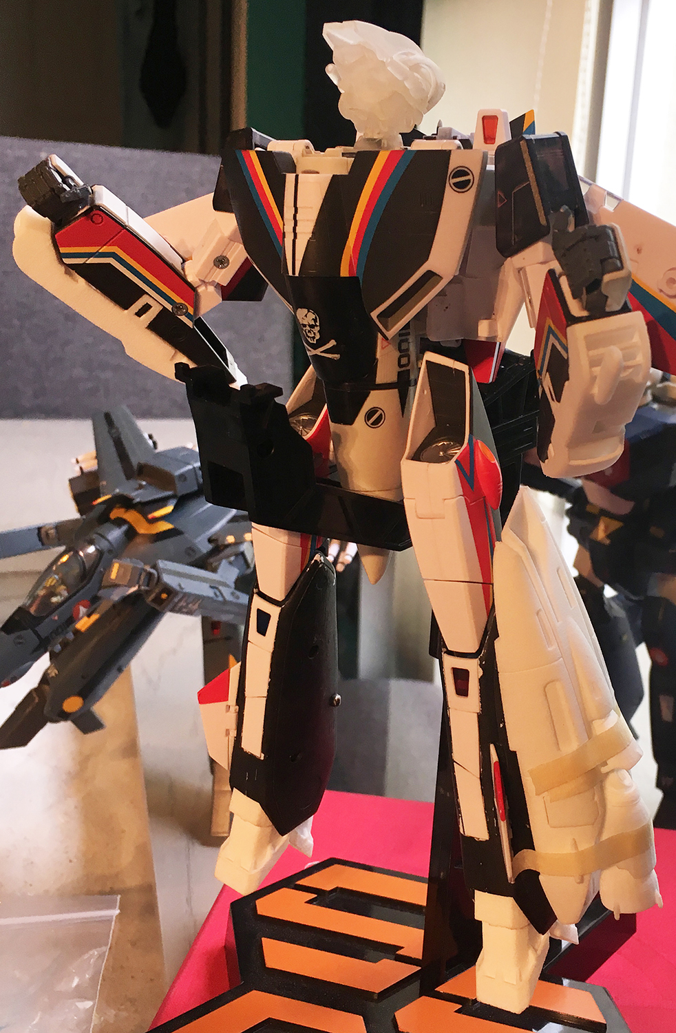

valhary Posted July 18, 2017 Posted July 18, 2017 This kit is insane I already have mine and is impressive 100% recommended To all of you Also you can see the comparision between the available heads the kurisama (clear) and the Xigfrid that come with the kit Personally I prefer kurisama design but if you are looking the closer version to the lineart Xigfrid is the option Quote
Xigfrid Posted July 19, 2017 Author Posted July 19, 2017 Hi @valhary thank you for posting your pictures. It gives new perspectives by seeing the same kit in different customers hands. I am looking forward to seeing your progresses. Quote
big F Posted July 19, 2017 Posted July 19, 2017 This looks great, also good to see so many pictures of the parts un prepared or painted. Quote

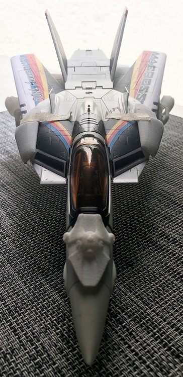

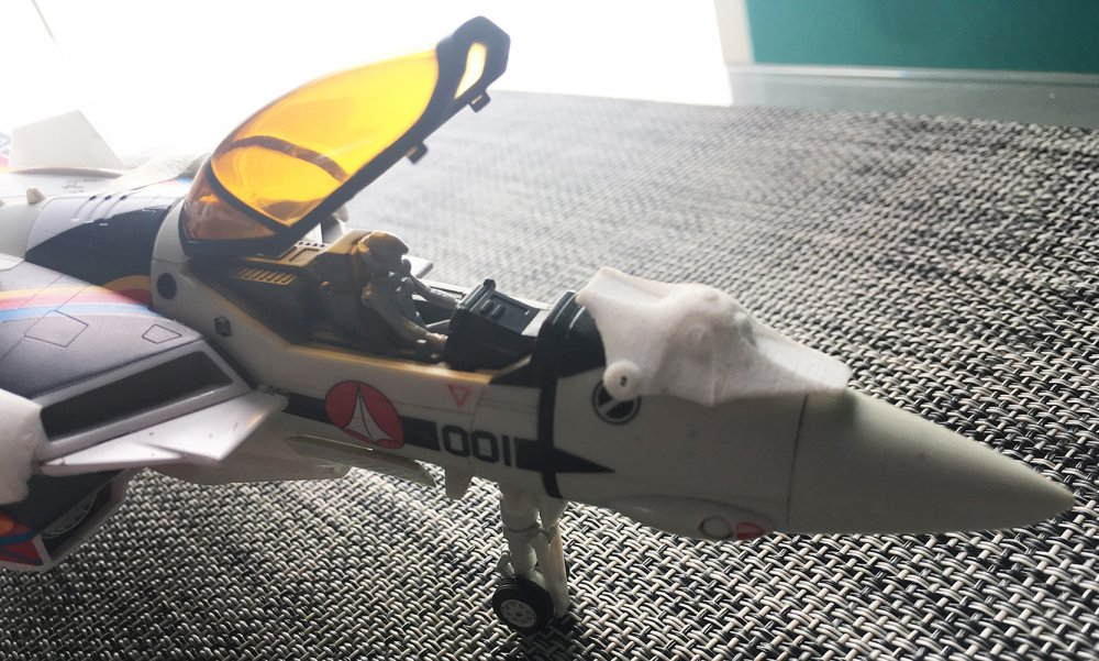

chyll2 Posted July 19, 2017 Posted July 19, 2017 I have question on the subject matter. What is the reason behind the added part on the nose or front of canopy. From what I saw, most of the upgrades are meant to lessen air resistance and add power which of course goes along with the theme of the manga. Quote
big F Posted July 19, 2017 Posted July 19, 2017 I would guess it's to do with targeting, looks like it has a camera type lense in the front or something to help manuverability with the rest of the fast pack set up. Quote

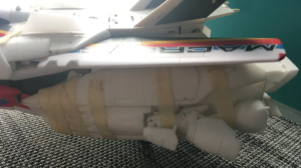

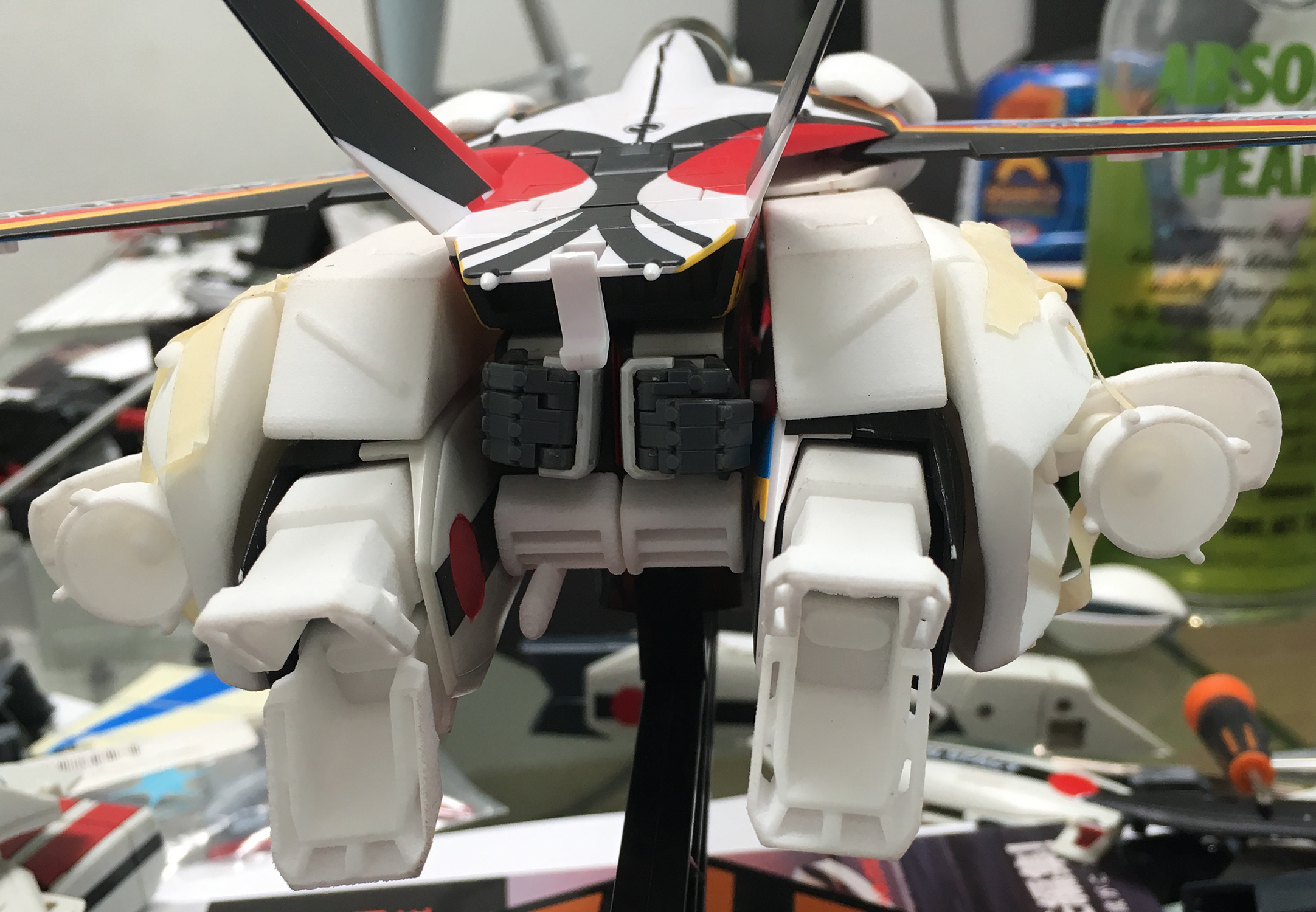

valhary Posted July 19, 2017 Posted July 19, 2017 I hope That can reach to see the articulation of the cover of the leg thrusters is very cool! Quote
wmkjr Posted July 19, 2017 Posted July 19, 2017 (edited) 3 hours ago, chyll2 said: I have question on the subject matter. What is the reason behind the added part on the nose or front of canopy. From what I saw, most of the upgrades are meant to lessen air resistance and add power which of course goes along with the theme of the manga. Stabilzing thrusters? This supposedly is an unstable (high manuveurability) valk due to the upgrades or something along that lines. Edit: This is 1/60 scale. Edited July 19, 2017 by wmkjr Quote

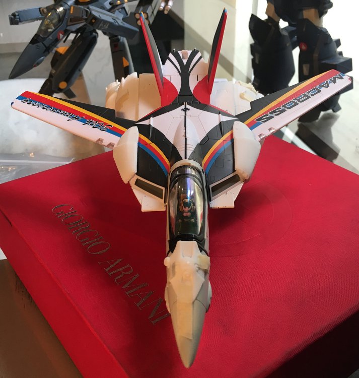

Mommar Posted July 19, 2017 Posted July 19, 2017 1 hour ago, Nyankodevice said: what scale is it in? That's a modified 1/60 Arcadia Valk. Quote
valhary Posted July 19, 2017 Posted July 19, 2017 You can see the detail is stunning and assume the confusion It's because the pilot that use only for clarification is a resin copy of the arcadia Isamu that seems to me has the best sculpture and proportion of a pilot 1/60 Quote
Xigfrid Posted July 19, 2017 Author Posted July 19, 2017 Wmkjr nailed it about the nose thrusters. Since the added propulsion power makes the VF-1 to act more like a missile than a plane, it needs the directional thruster at the nose level to have more directional mobility. All the parts are removable, just like in the novel, the upgrade parts are added on a classic VF-1. Though the aerodynamic is enhanced further with the unique head, with a large front cap, the wings have reinforcements for strength and the tails fins are shorter. I also took closer pictures of the opening/closing flaps. Quote

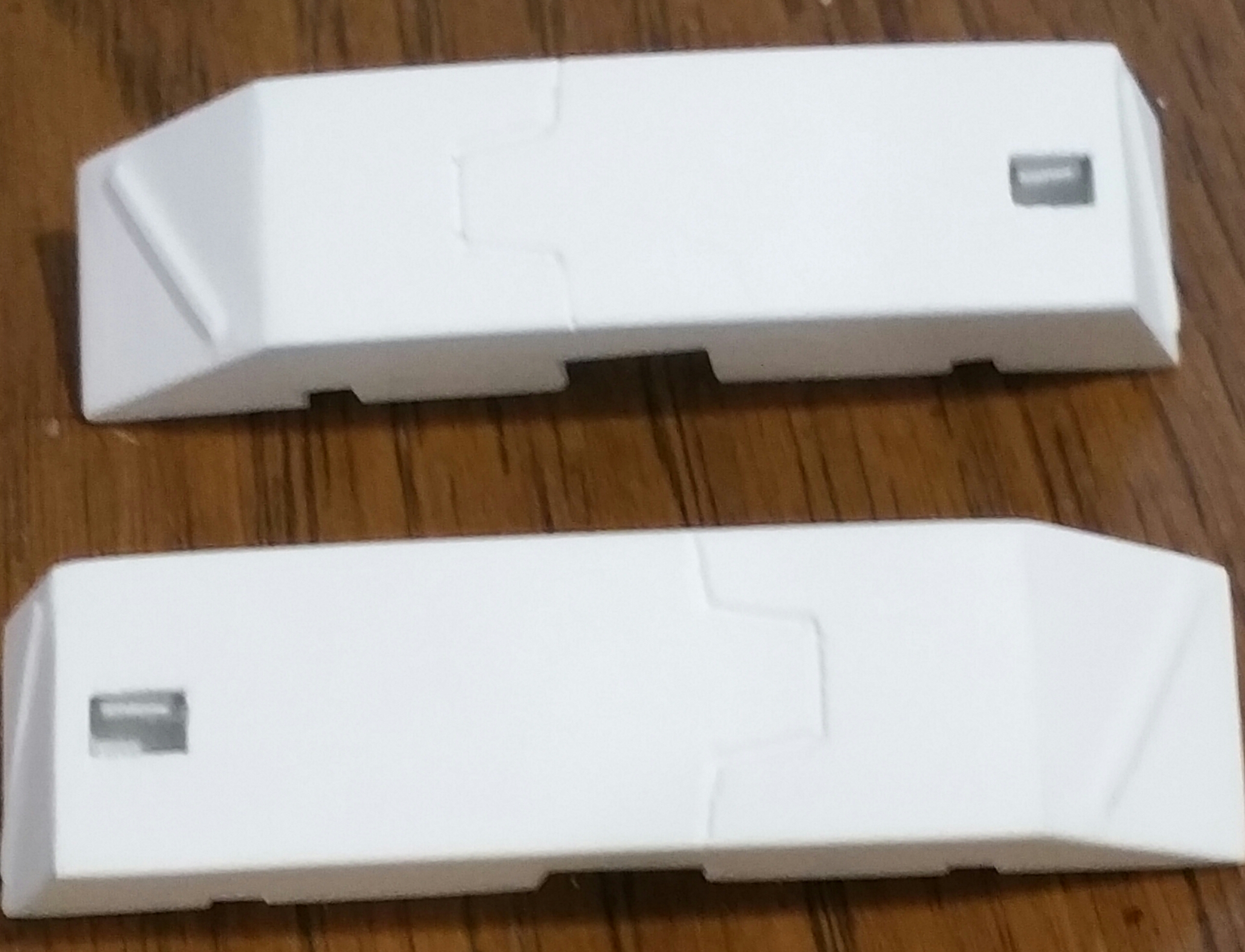

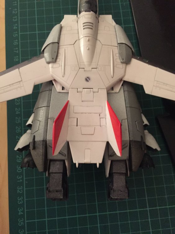

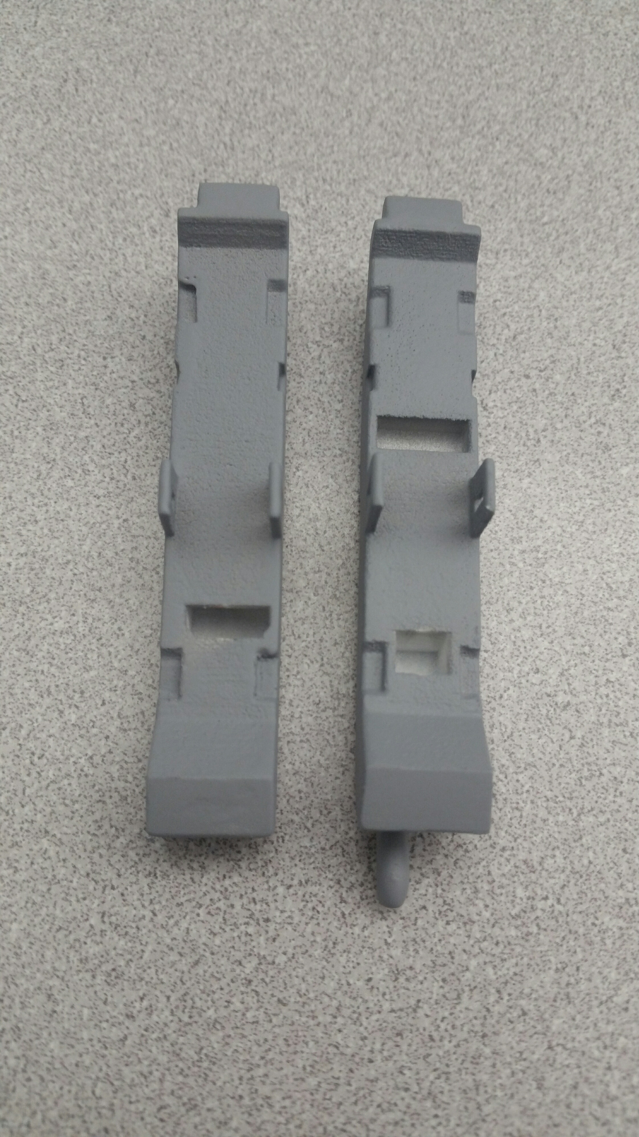

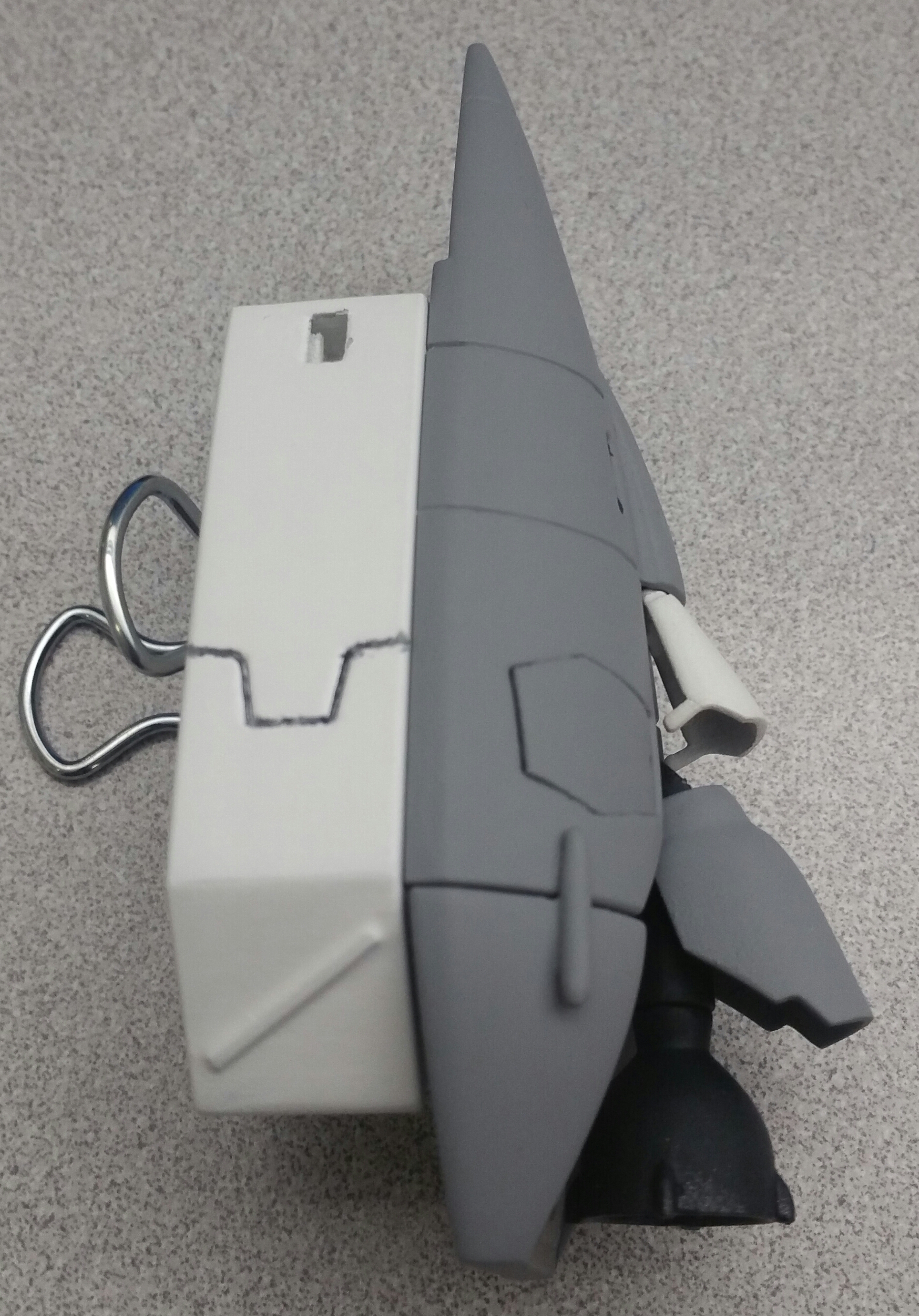

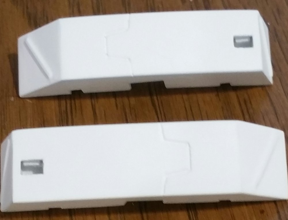

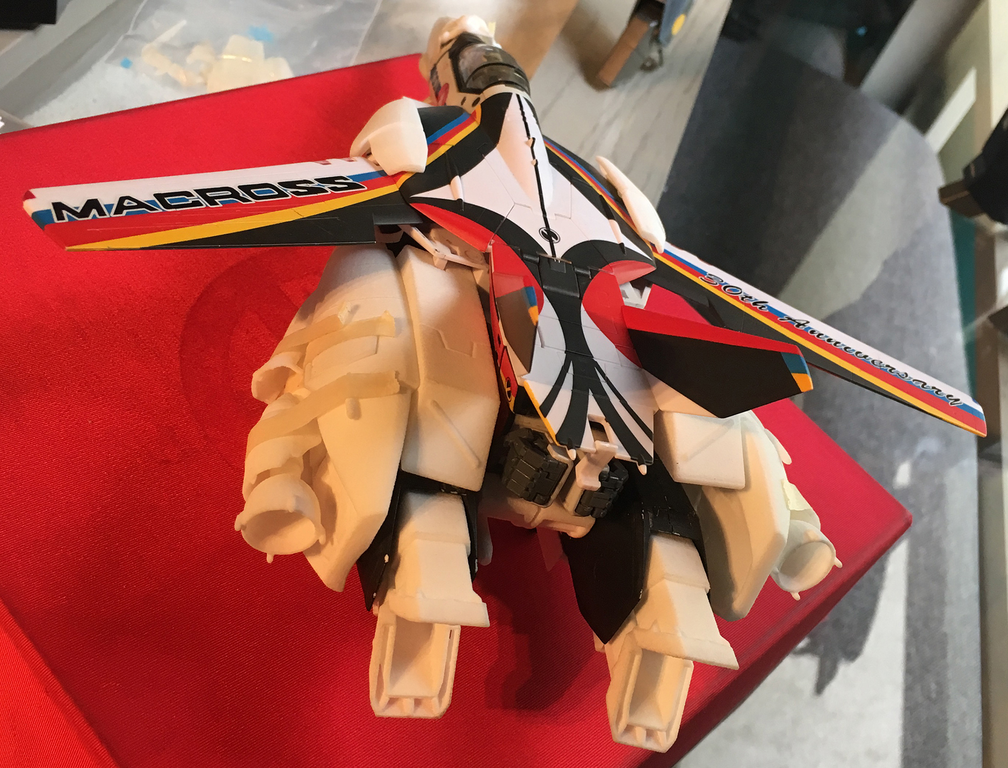

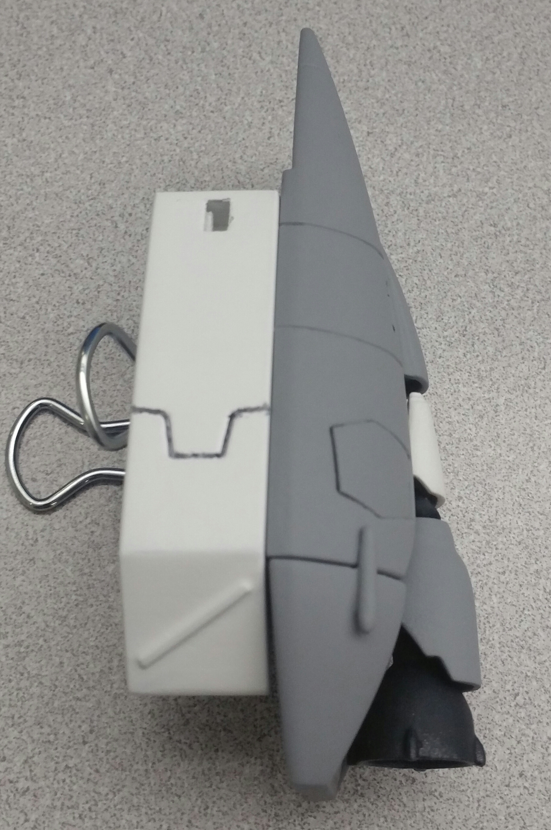

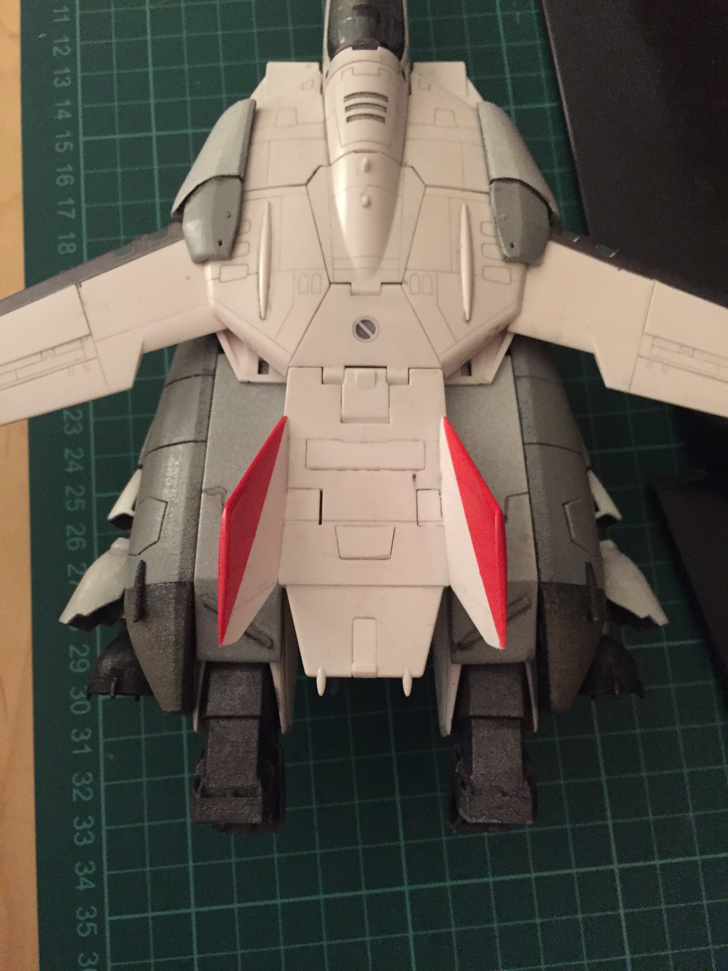

Jasonc Posted July 24, 2017 Posted July 24, 2017 Right now, I'm priming the hell out of the white calf backings that hold the leg armor. To get rid of the spongy look and feel of the material, I use Testors super fine white surface primer (lacquer). I put about 3-4 coats, and lay it on heavy, as a good portion of it will be sanded. After it all dries, the I use a 400 grit sandpaper, and lightly sand it all down to get a uniform, smooth surface. The end result is no sponge look. If you have grey parts, use a grey primer, but lay it on heavy. That's the trick. I'm working on parts in between waiting on other parts to dry for the drone. Quote
Xigfrid Posted July 25, 2017 Author Posted July 25, 2017 (edited) I use noname primer for standard or large projects and tamiya primer for my favorite ones. Also as first layer I have had good results using floor vermish: put the parts in a bath of vermish then hang them outside to dry. Once the surface is dry, you can add a primer layer and wait 24h. After the first sanding, the parts should be almost smooth Edited July 25, 2017 by Xigfrid Quote
Jasonc Posted July 26, 2017 Posted July 26, 2017 On 7/25/2017 at 0:28 AM, Xigfrid said: I use noname primer for standard or large projects and tamiya primer for my favorite ones. Also as first layer I have had good results using floor vermish: put the parts in a bath of vermish then hang them outside to dry. Once the surface is dry, you can add a primer layer and wait 24h. After the first sanding, the parts should be almost smooth I may have to try this sometime. I have a few bottles of Future floor polish. I'm hoping to have a picture of the finished rear leg brackets today. They are looking quite good, and with a light 400, then 800 grit sanding, they feel like toy pieces. I wish I would've had this method down better when working with the drone wing in WSF resin. I know it's going to be a pain with the leg boosters and those parts, but I will try the floor polish with one, and fine surface primer for the other, and see what works best for small parts. I may also try another method of using Mr. Putty on the entire part, rubbing in in very well, or even diluting it, then letting it dry and sanding from that. I know that would fill in instantly with the pores, but not sure of the clean up and how difficult that would be. I think one great benefit of that method, is that the paint would adhere very well to the putty. I'm waiting on my last parts to complete at Shapeways, and for some reason, this order is taking way too long. It's still not done on the printing process, so either there was a problem, or they messed up and forgot my parts. Either way, time will tell. Quote

Jasonc Posted July 27, 2017 Posted July 27, 2017 So, last night, I used some putty on the arm parts, as those are going to be a grey color, and the primer Tamiya has in grey, while a nice grey (more on the warmer grey side and very fine), doesn't fill in the spongy texture too well. I am using the Mr. Putty on these parts, and I put a layer of it on last night. I should be able to sand later today, and then put a layer of the primer on today, then see the results. For the nose thrusts, I ordered that in FUD, and it only requires little and light sanding. I've already sanded the bulk of it, but need to sand the hard to reach places now. Then I'll re-primer, and I'll need to recast, as it's a brittle material. I'll color cast it in black, or a dark grey, and then I can do all the drilling and pin inserts I need to do. I know it sounds like a ton of work for simpler stuff, but I get involved sometimes, LOL. The wing definitely needs that shielding on the face of it and the extra long flap. I may use styrene for the flap, and figure something out for the wing lead. Quote
Jasonc Posted July 28, 2017 Posted July 28, 2017 OK, here's a comparison of the arms. One was puttied once, then sanded, the other was painted with heavy primer a couple times and sanded each time, then it was painted once with grey primer, lightly sanded, then painted again. Both were then matt coated after their paint jobs were sufficiaently covered. To be honest, the feel and look of both of them is the exact same. The major difference is the amount of time involved. Painting/drying/painting several times takes forever. while puttying/drying/dutifully sanding is really only a fraction of that time. The arm with the extra sensor coming off of it was the putty one. I'm quite happy with the end result of both, and will more than likely switch to just puttying the entire part. Both are really smooth and you can't tell they're WSF parts unless you look on the inside really close, and even then, it's hard. Really happy with the finish. Quote

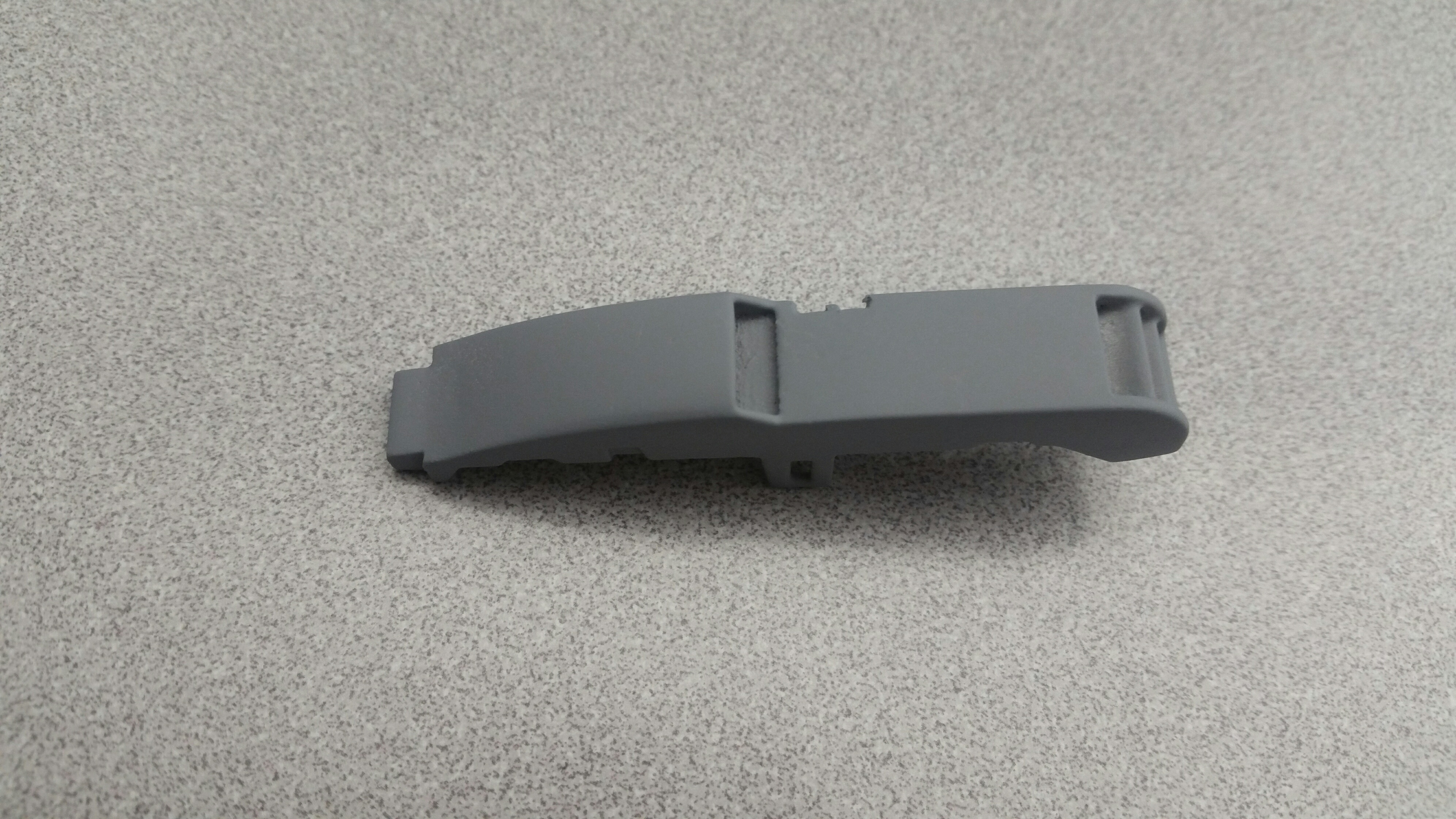

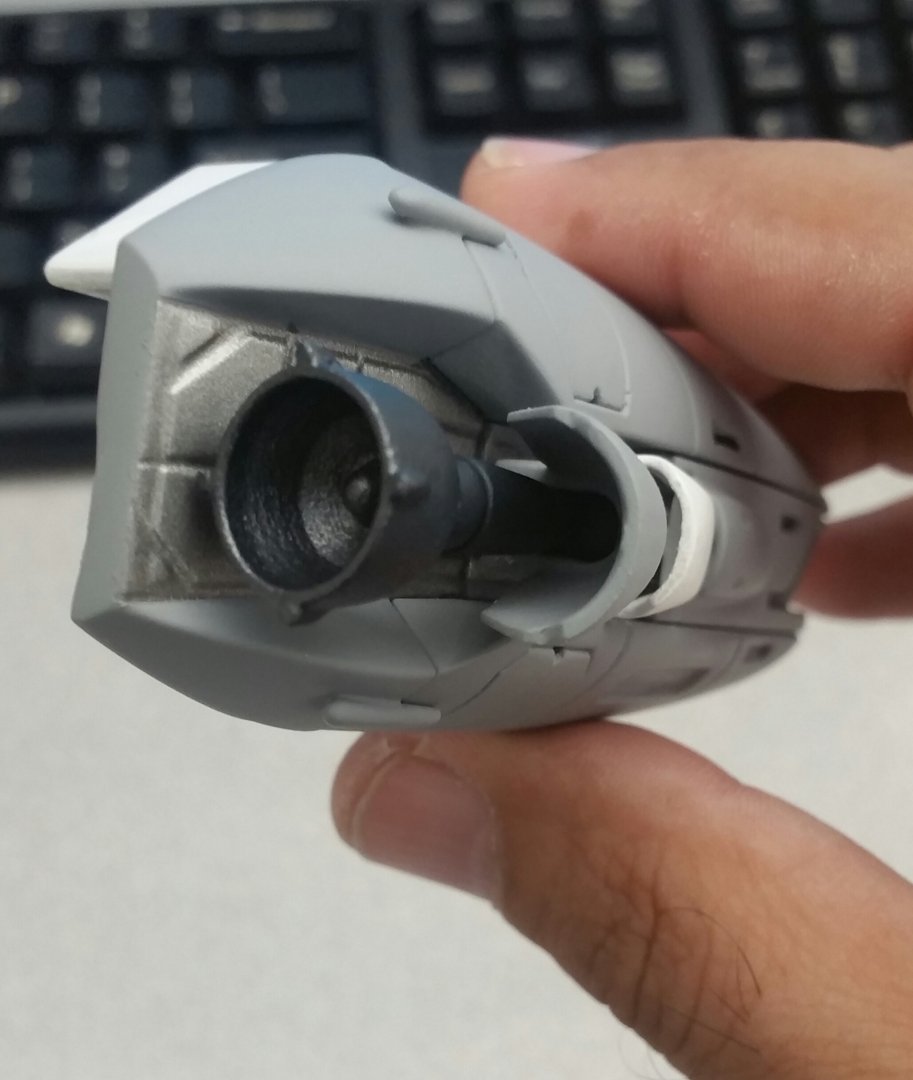

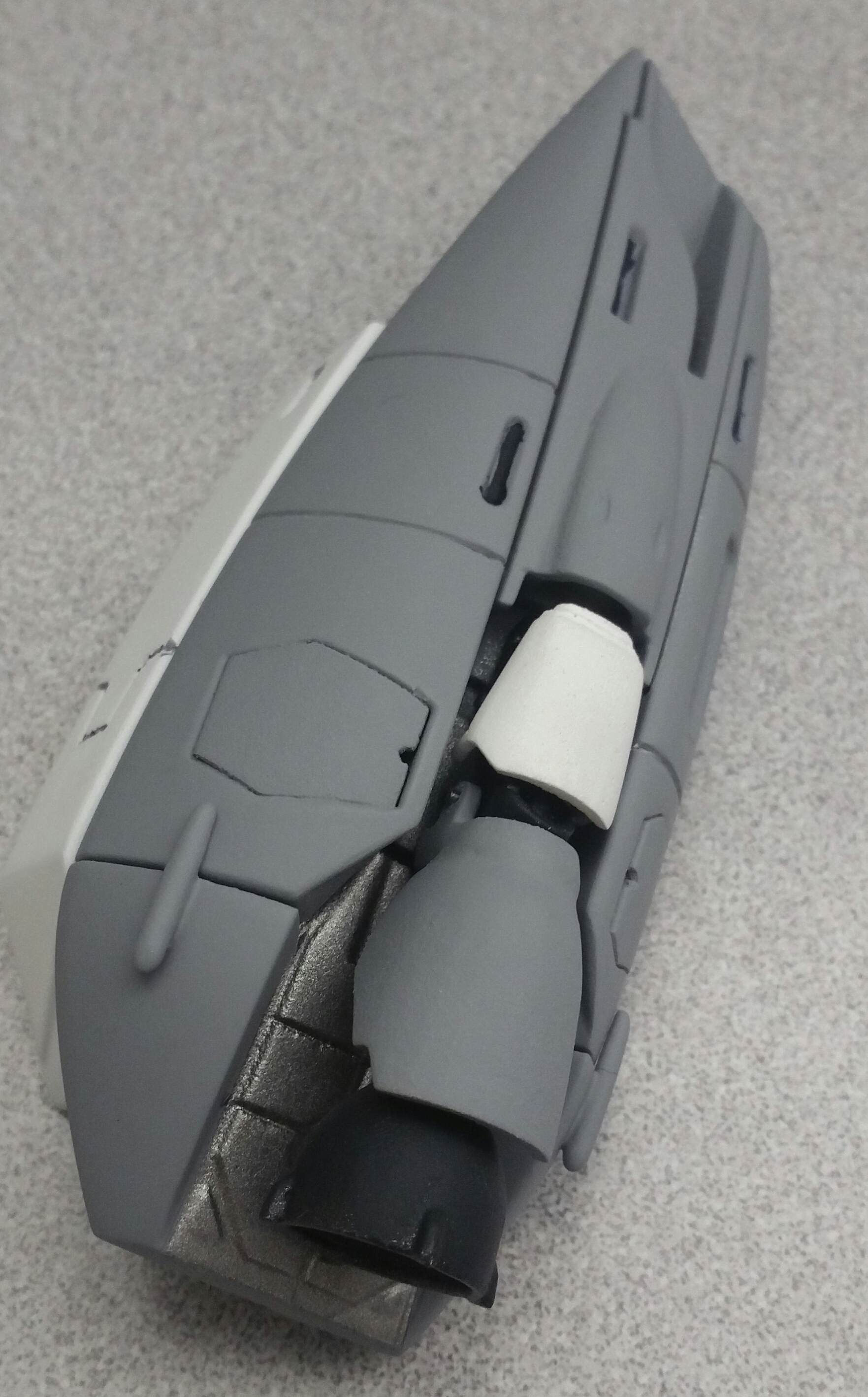

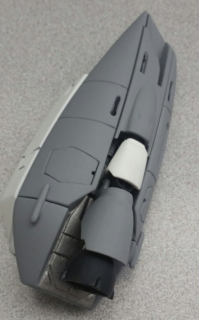

Jasonc Posted September 1, 2017 Posted September 1, 2017 Ok, so leg piece for the right side is done. I also just finished the feet, and found a great color by Tamiya called rubber black, that is a bit lighter than regular black and is a matte finish. I used that for the feet and booster nozzle and engines, and used gunmetal inside the booster. The grey is simply Tamiya grey fine surface primer, and the whitend is model master super fine surface primer. The section under the booster is stainless steel metalized on black. Quote
Xigfrid Posted September 1, 2017 Author Posted September 1, 2017 Really nice surface finish there! Don't forget to add a glossy finish layer on top of the grey primer if you want a more realistic look. Quote
Chronocidal Posted September 1, 2017 Posted September 1, 2017 Wow, I'd never guess that was a 3D print, that's beautiful! Funny story about it being realistic though.. if you ever really want to see something bizarre, get up close and personal to a factory fresh military aircraft. It honestly throws off your senses. I got to walk around a hot-off-the-presses Superhornet once, and it was just the weirdest thing to see a perfectly matte finish on an aircraft. The paint was flawless, no wear, no stains, nothing. It actually looked like a toy. By the way, as a side note, I bet you that "Rubber Black" color would be a good match for the black nose panels on the DX VF-25s. If you've managed to chip the paint on that little point on the nose during transformation, it might be a good match to cover it up. Quote

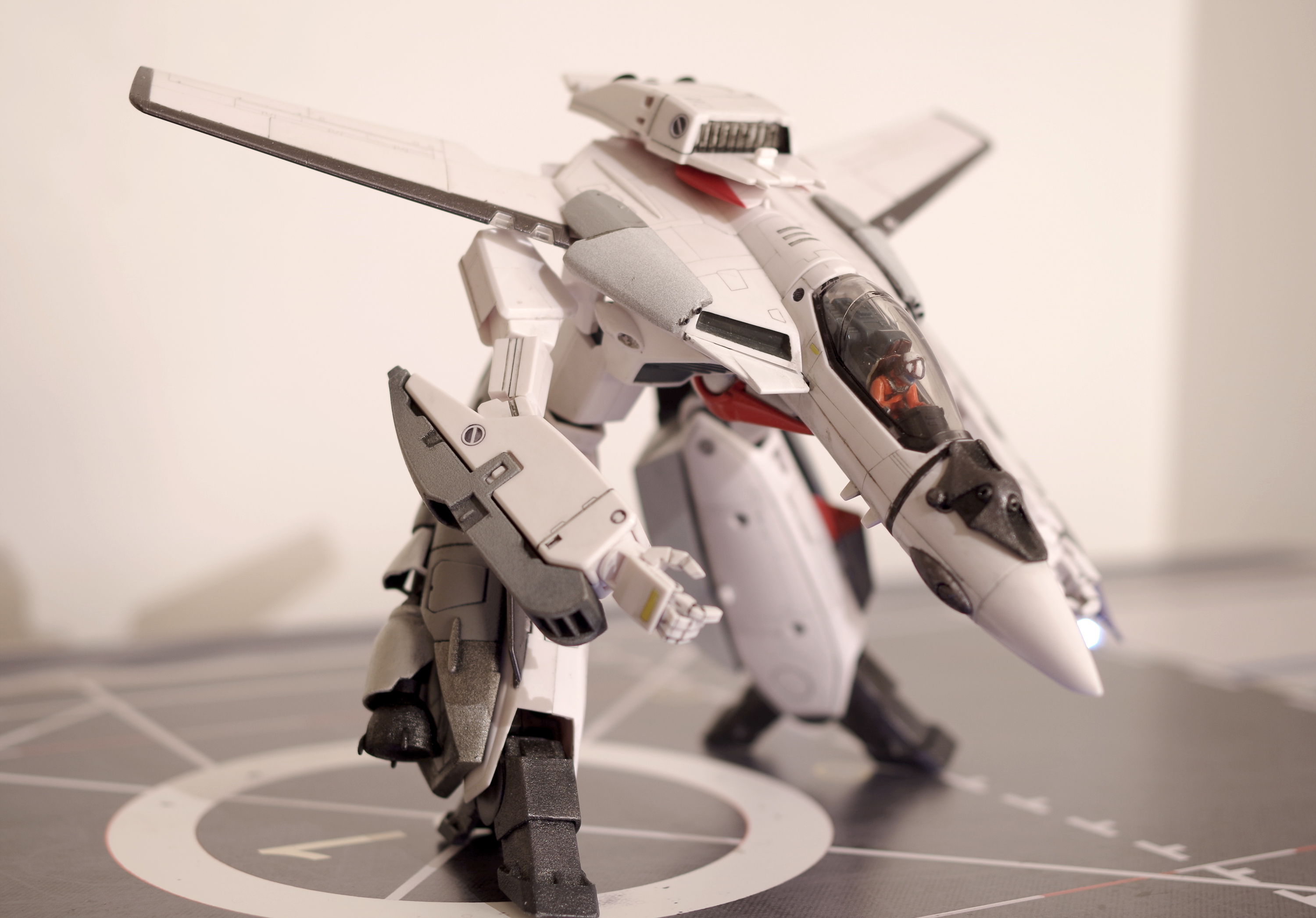

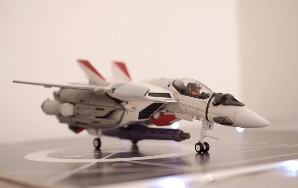

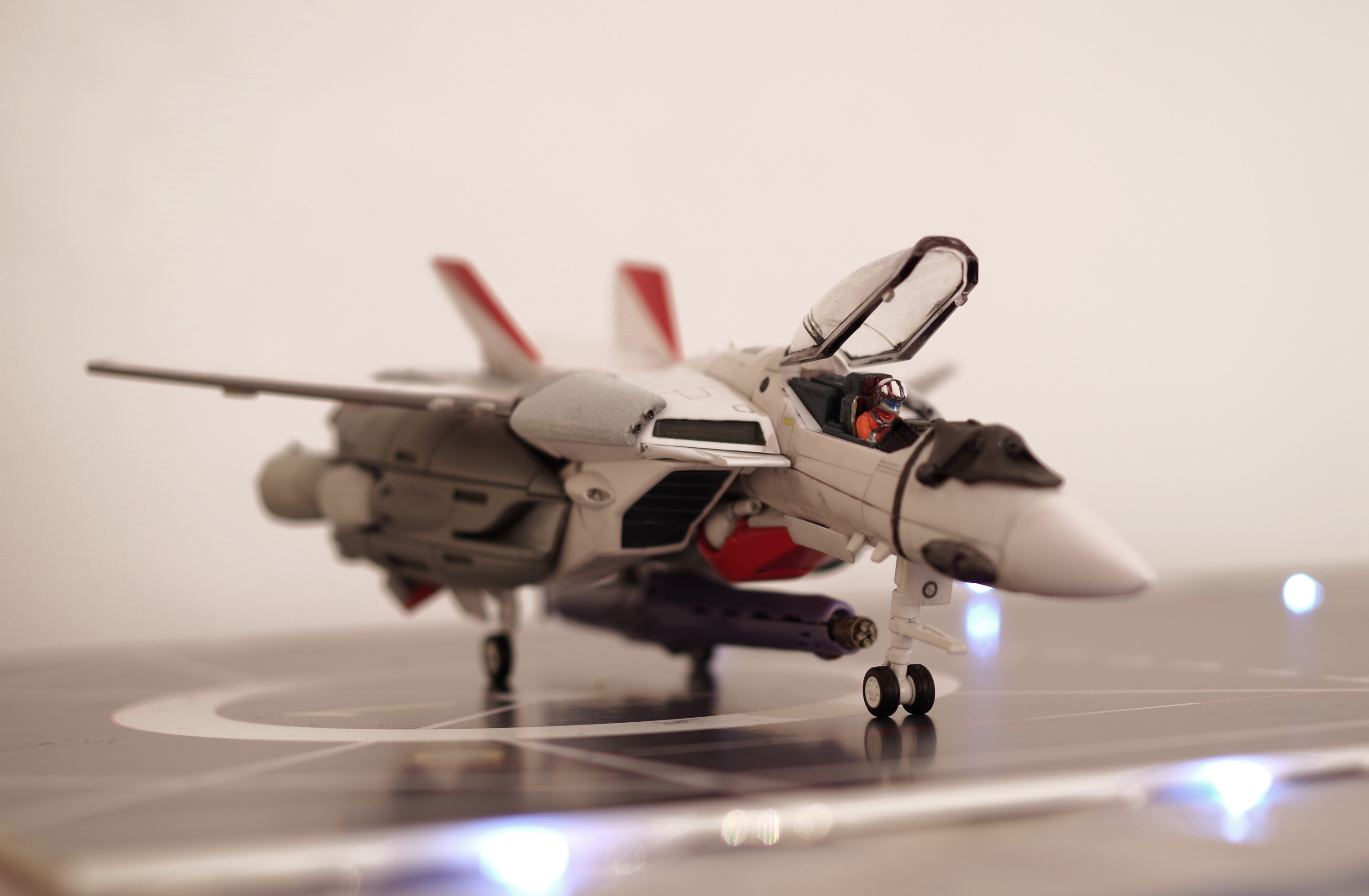

Xigfrid Posted September 1, 2017 Author Posted September 1, 2017 Just received as a gift a little photo studio, I had to make a quick test with the phone camera. I can't wait to make the photos again with this setup Quote
