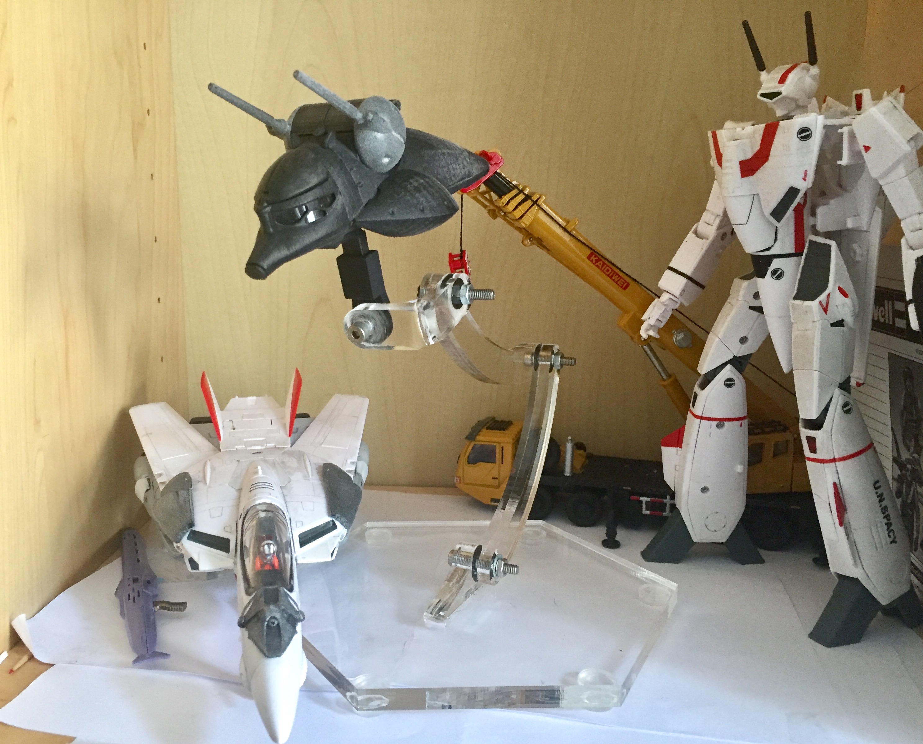

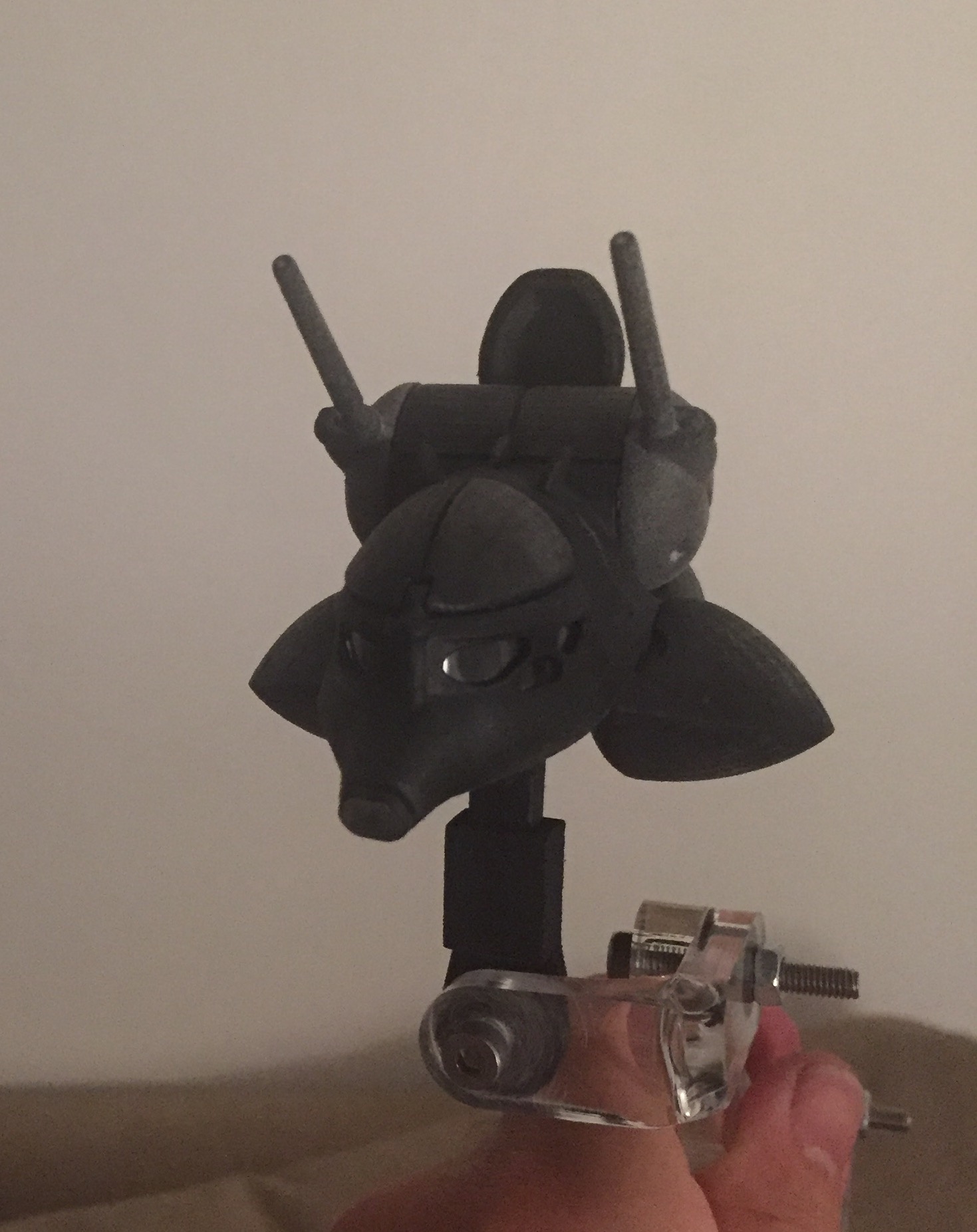

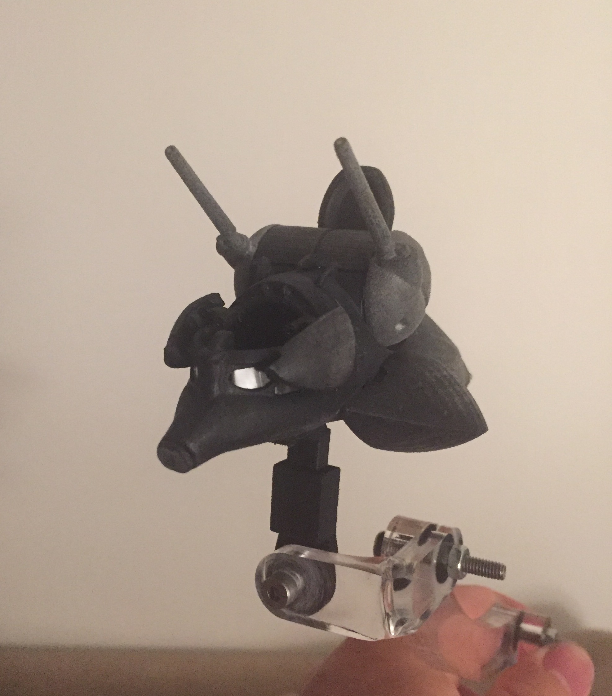

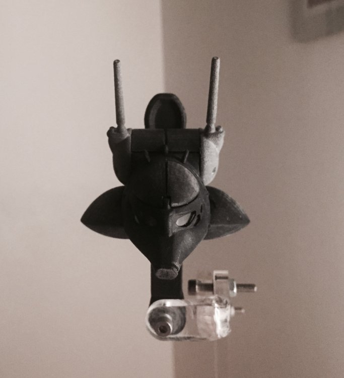

Xigfrid Posted June 21, 2017 Posted June 21, 2017 (edited) Also receive this little head today. They have been test mostly in the new black HP WSF and the antennas are in Grey HP WSF from Shapeways. I have been very impressed by the finishing of both polished (black) and the untouched (grey) materials, but the print accuracy is somewhat weird compared the the traditional WSF, resulting in more cut and sanding to make all the parts fit together. If you wonder when the rest of the Octo will be ready? Well it is in progress and depending on how much anime magic needs to be resolved, it can take some time Edited June 21, 2017 by Xigfrid Quote

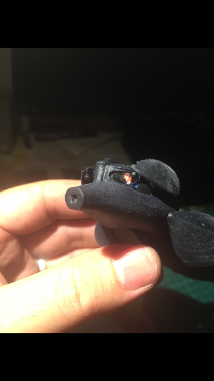

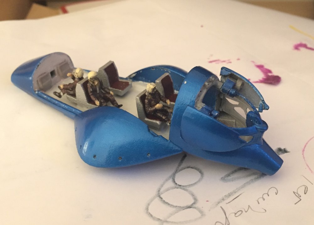

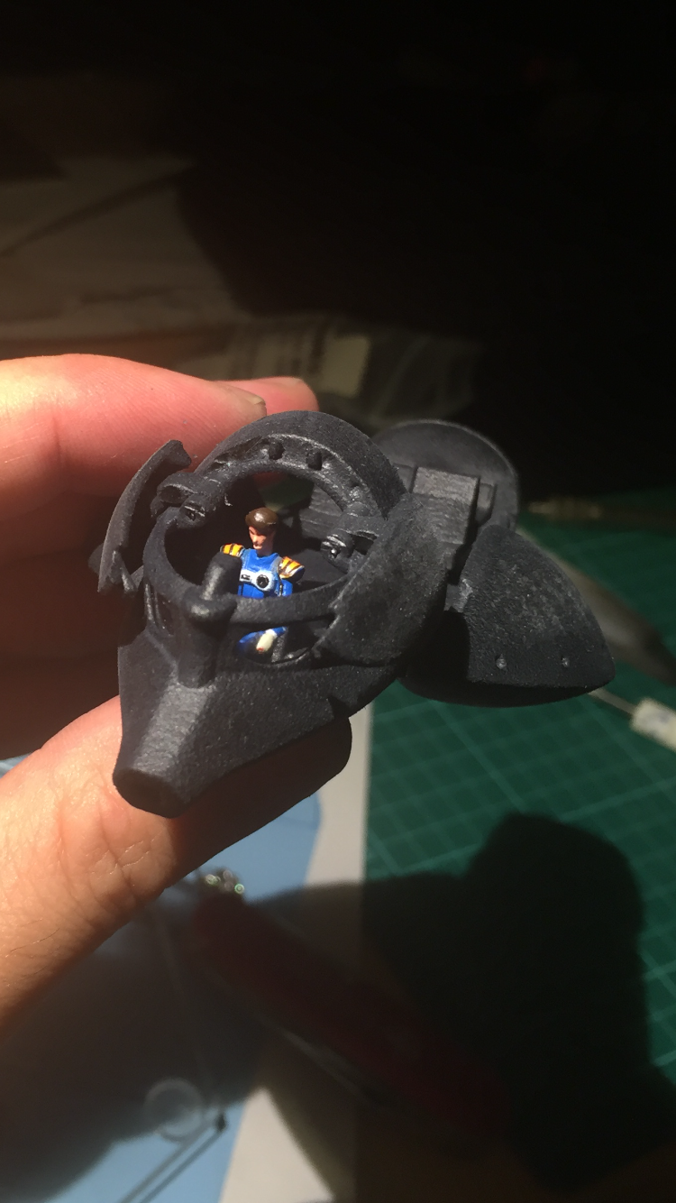

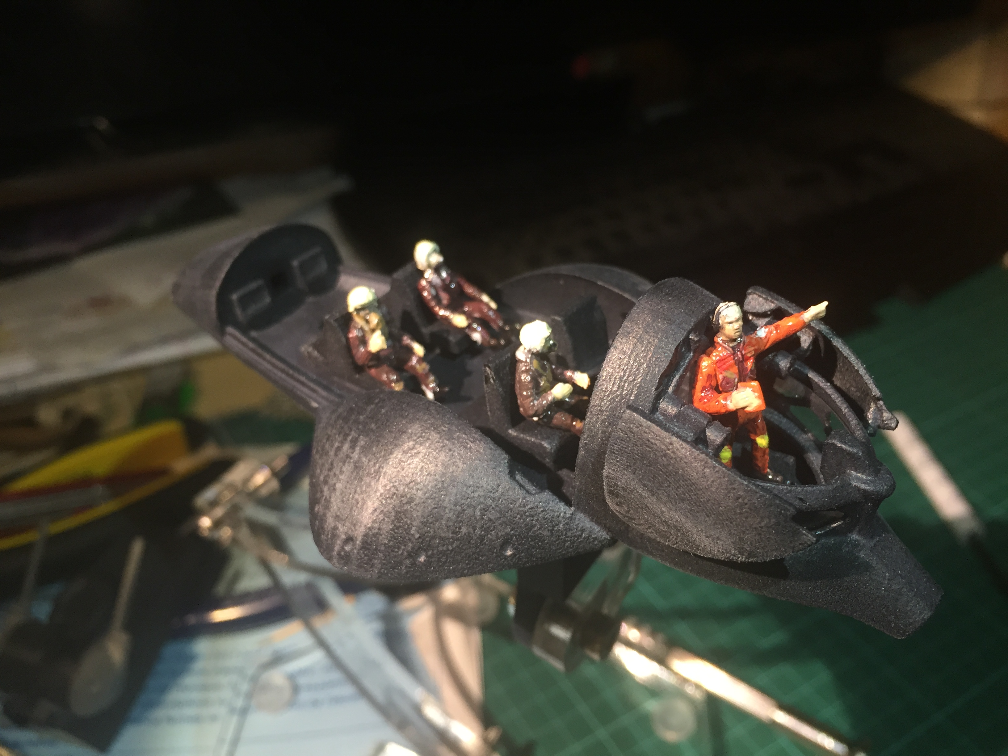

Xigfrid Posted June 21, 2017 Author Posted June 21, 2017 With Isamu's help, the cockpit size is validated! Quote
wmkjr Posted June 22, 2017 Posted June 22, 2017 How do you like the HP material? Easier to sand? More durabe than FUD? What is it cost wise? Quote

Xigfrid Posted June 22, 2017 Author Posted June 22, 2017 3 hours ago, wmkjr said: How do you like the HP material? Easier to sand? More durabe than FUD? What is it cost wise? I really like it so far, I just hope that the precision faults were just a bug for early beta tests. The material feels and acts just like WSF, not that easy to sand so but extremely durable and playable like plastic Because you need less sanding, the material really holds well small details. The resolution is 10x less than FUD, I would say that HP Wsf keeps 0.2mm details perfectly visible, where classic WSF would be around 0.5mm. Cost for the moment is the same as WSF+1$. Thank you @slide, and yes this is the one @505thAirborne Quote

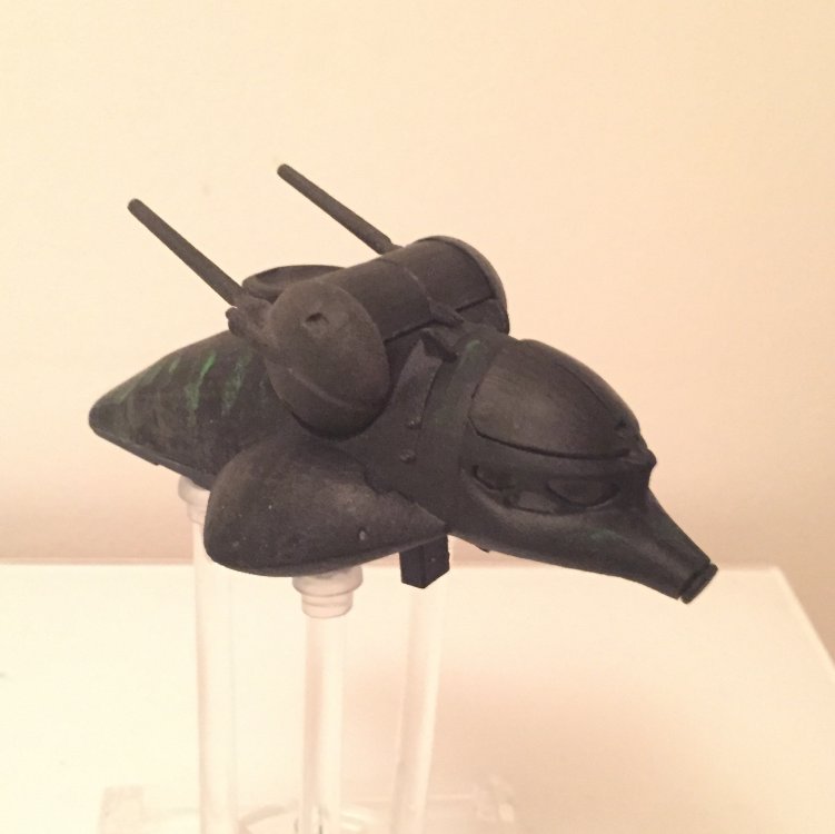

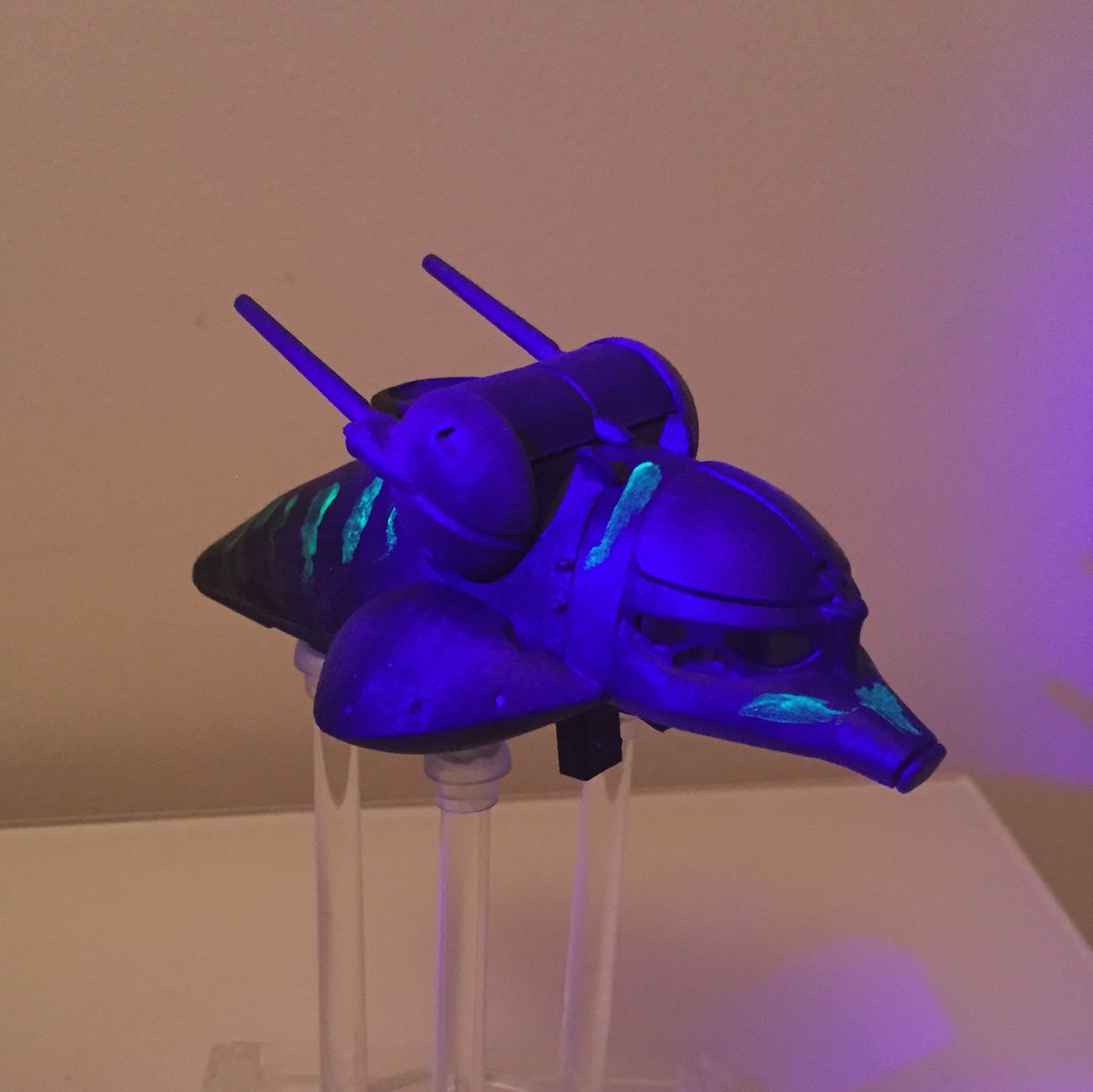

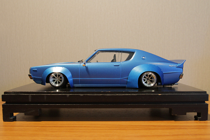

Xigfrid Posted June 26, 2017 Author Posted June 26, 2017 Lacking inspiration for modeling so I have reader a few reviews and stopped at the Light Metallic Blue TS-54 as a paint base according to this one. also I have been playing with my child and phosphorescent painting and called it the "Tiger shark camo theme" Quote
Tage Posted June 28, 2017 Posted June 28, 2017 Hah nice! I've been thinking about putting some glow in the dark paint underneath some clear parts of models to help them glow. Quote
Xigfrid Posted June 29, 2017 Author Posted June 29, 2017 20 hours ago, Tage said: Hah nice! I've been thinking about putting some glow in the dark paint underneath some clear parts of models to help them glow. That's probably a good idea if applied as a thin mist with an airbrush, it can be evenly applied and semi transparent. Quote

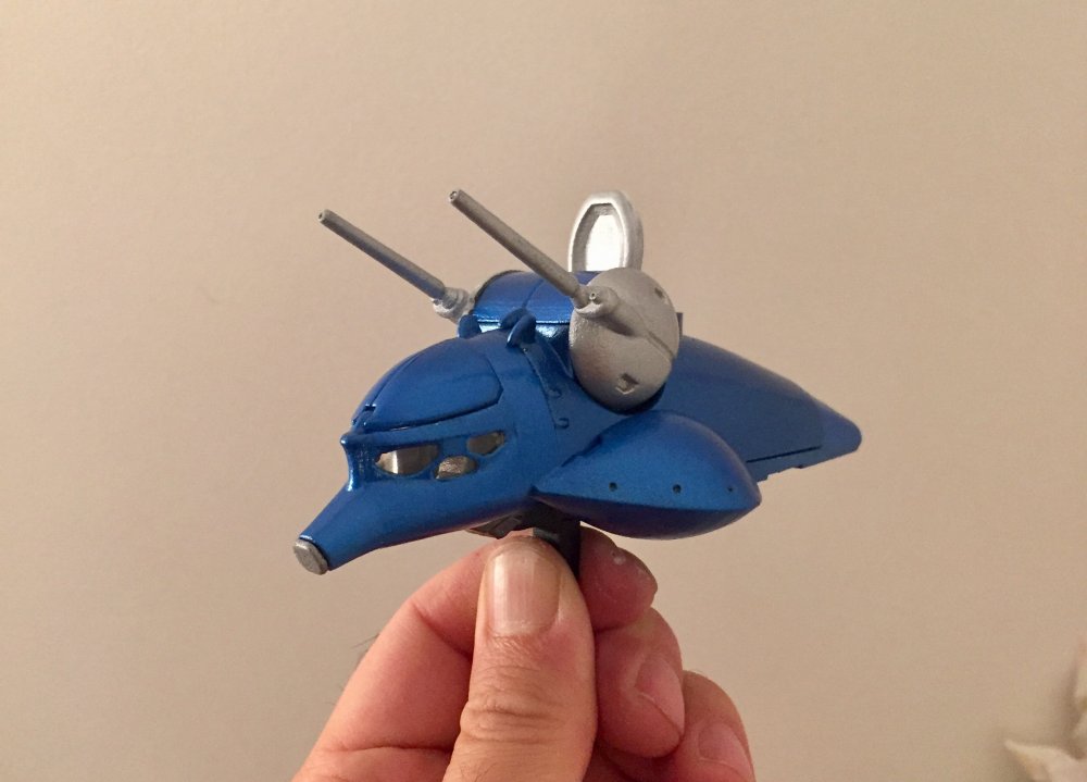

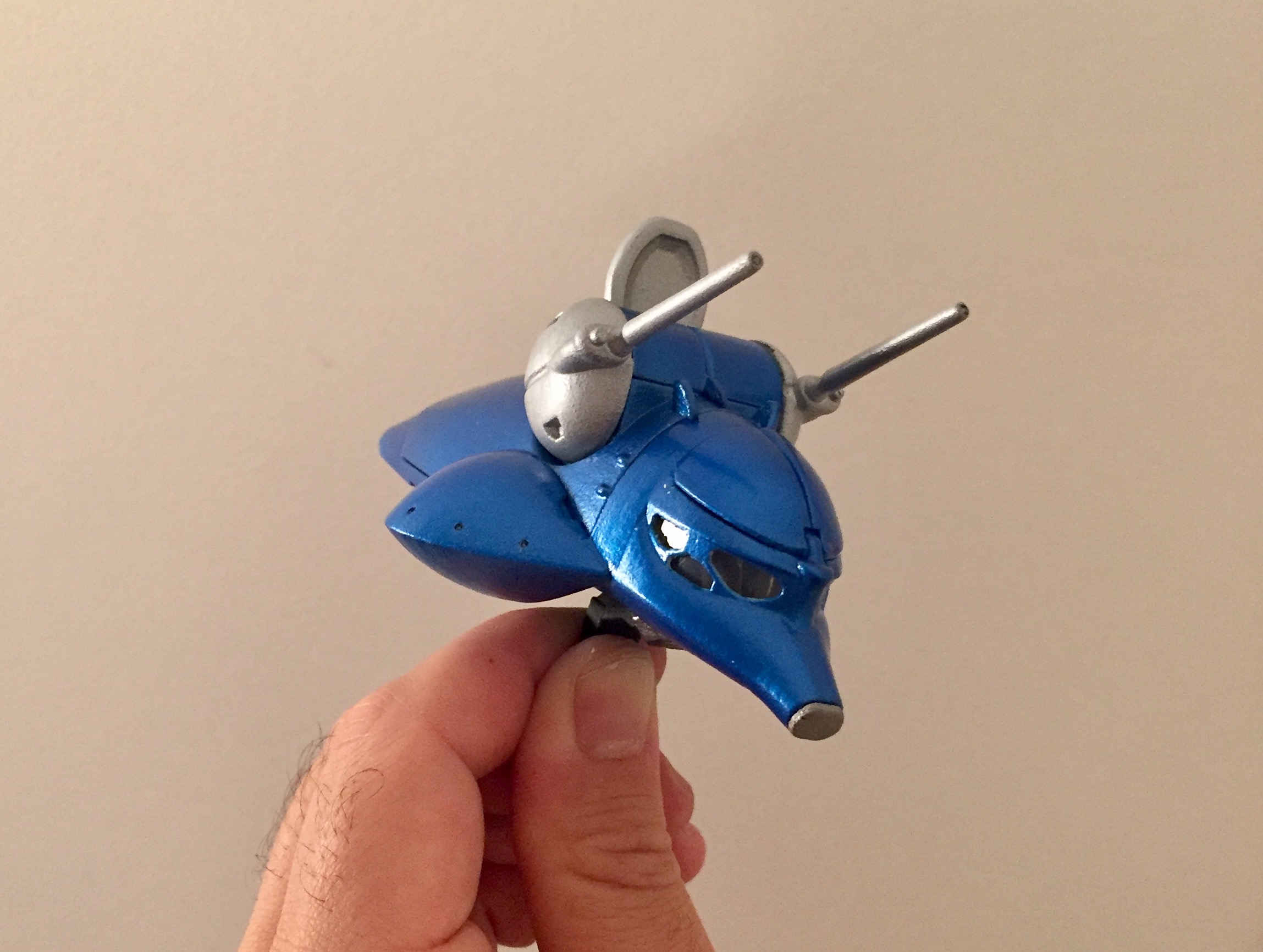

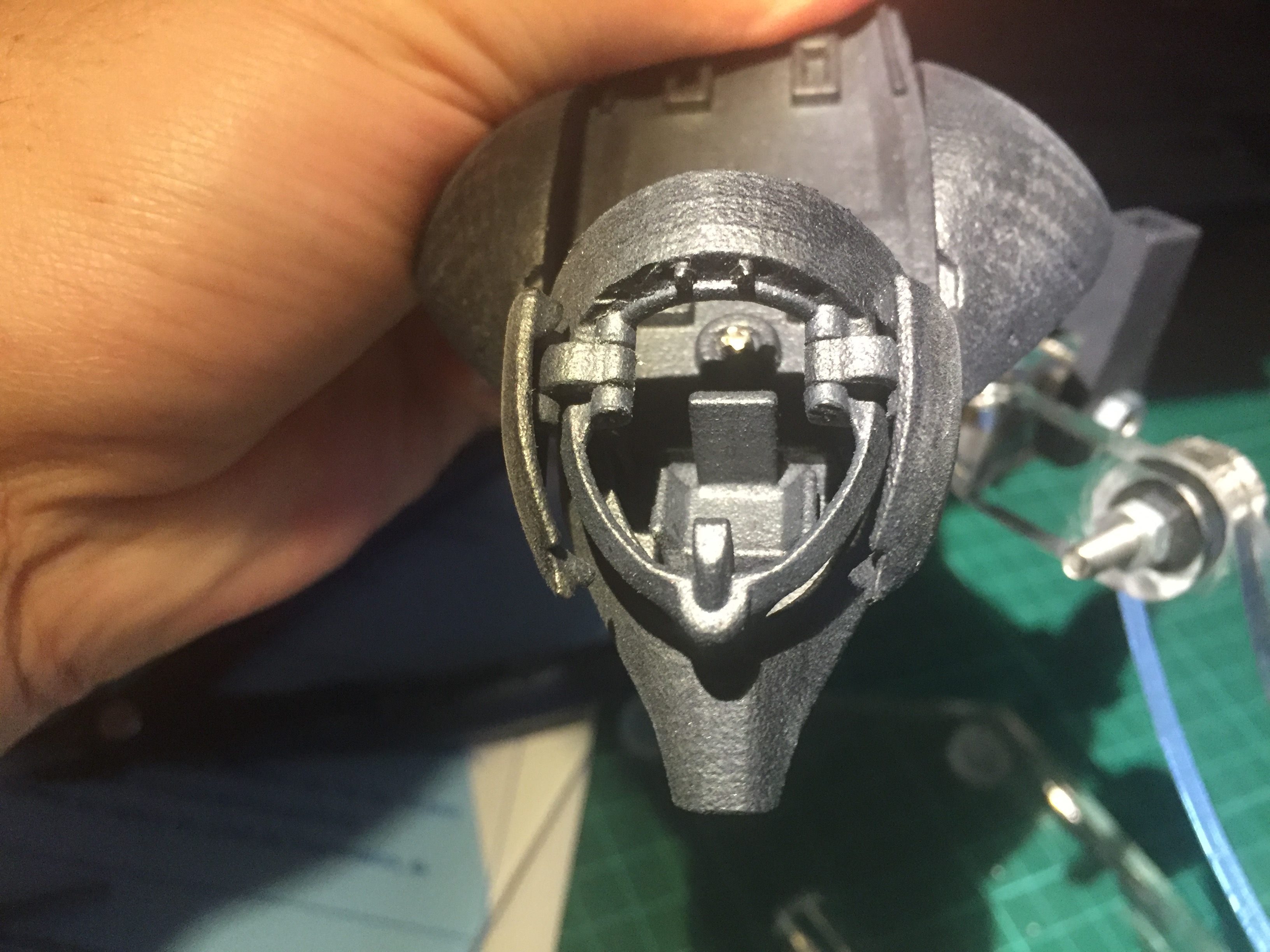

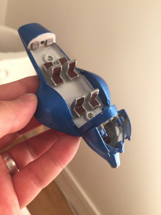

Xigfrid Posted July 11, 2017 Author Posted July 11, 2017 I have a try to the painting, it is pretty and shinny Quote
Jasonc Posted July 18, 2017 Posted July 18, 2017 The head looks very Gundam like, but it looks so badass. I want this as well, LOL. Quote

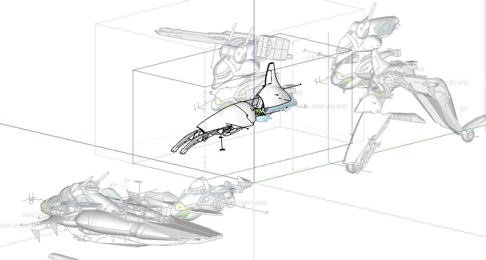

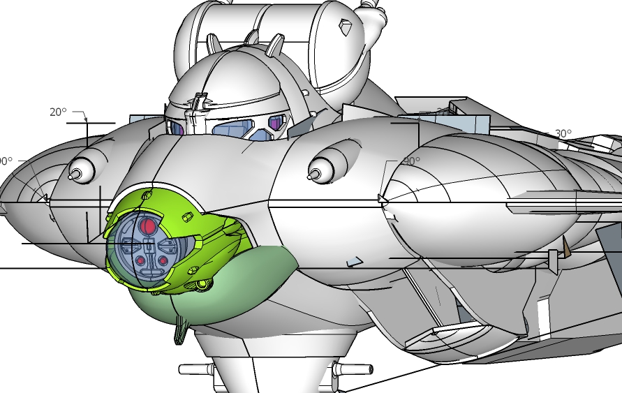

Xigfrid Posted July 25, 2017 Author Posted July 25, 2017 Not much news, apart that for those who's wondering how does it look like to work on a transforming model. Quote

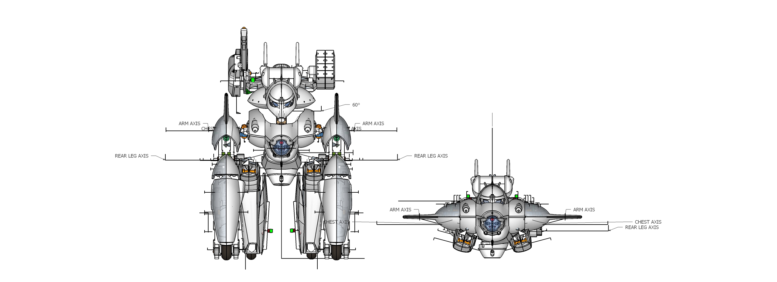

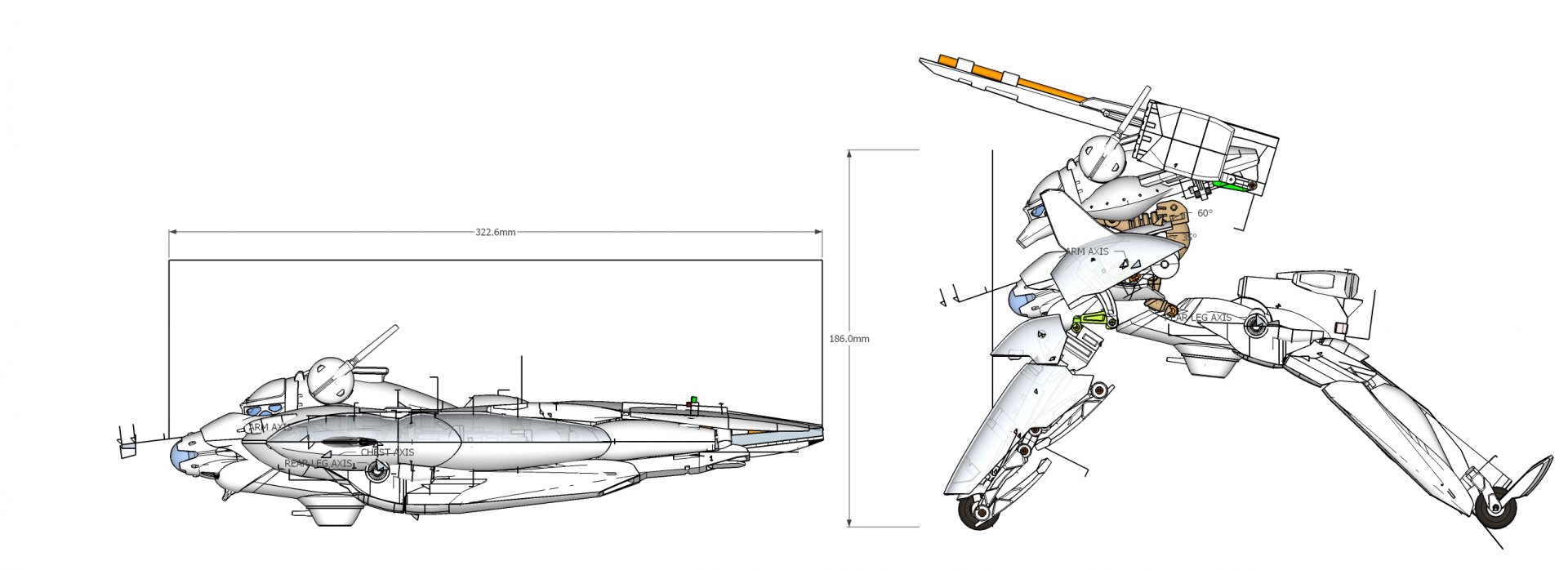

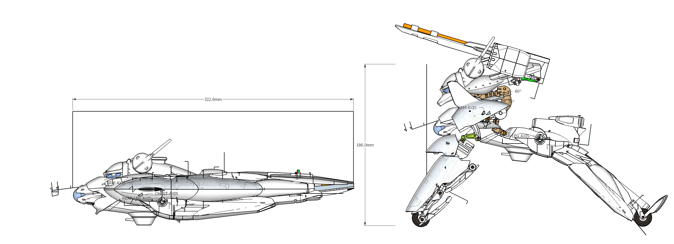

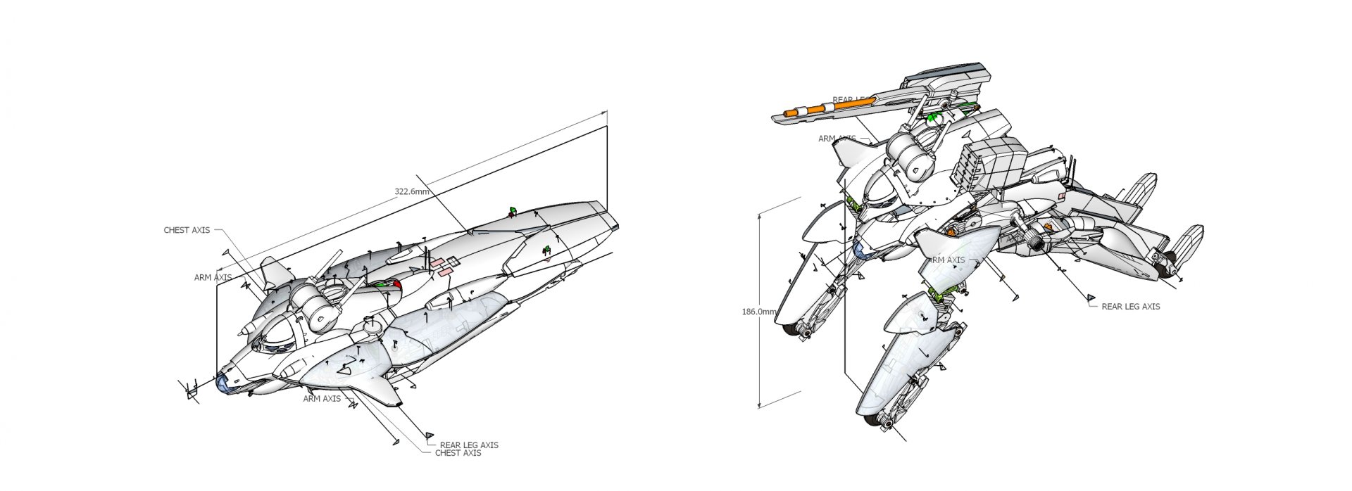

Xigfrid Posted October 17, 2017 Author Posted October 17, 2017 Big update, at least from my point of view: all the anime magic has been solved and I could obtain a perfect transformation. Now I need to clean the model, check for tolerance and printability before processing to 3D printers. Quote
mickyg Posted October 17, 2017 Posted October 17, 2017 LOVE your work Xigfrid! Really impressively done modelling there. Quote
Sanity is Optional Posted October 17, 2017 Posted October 17, 2017 What CAD package are you using? Quote
Xigfrid Posted October 18, 2017 Author Posted October 18, 2017 I got tired of this model a few times but as a 3D challenge it is entertaining I use skechup Quote
