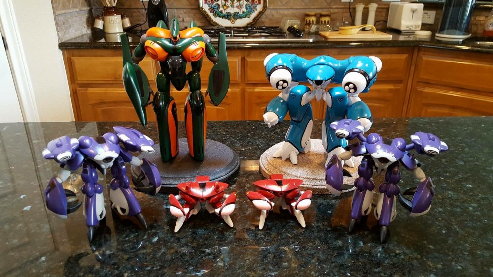

derex3592 Posted June 2, 2017 Posted June 2, 2017 Here's a couple of pics with Cap's Invid and a Toynami Alpha and Beta along with an old school Gakken Alpha. Hopefully I'll be able to find the how to build resin kits thread this weekend. Quote
505thAirborne Posted June 2, 2017 Posted June 2, 2017 Awesome pics derex, thank you again, I'm sold! Captain, you're getting a PM! Quote

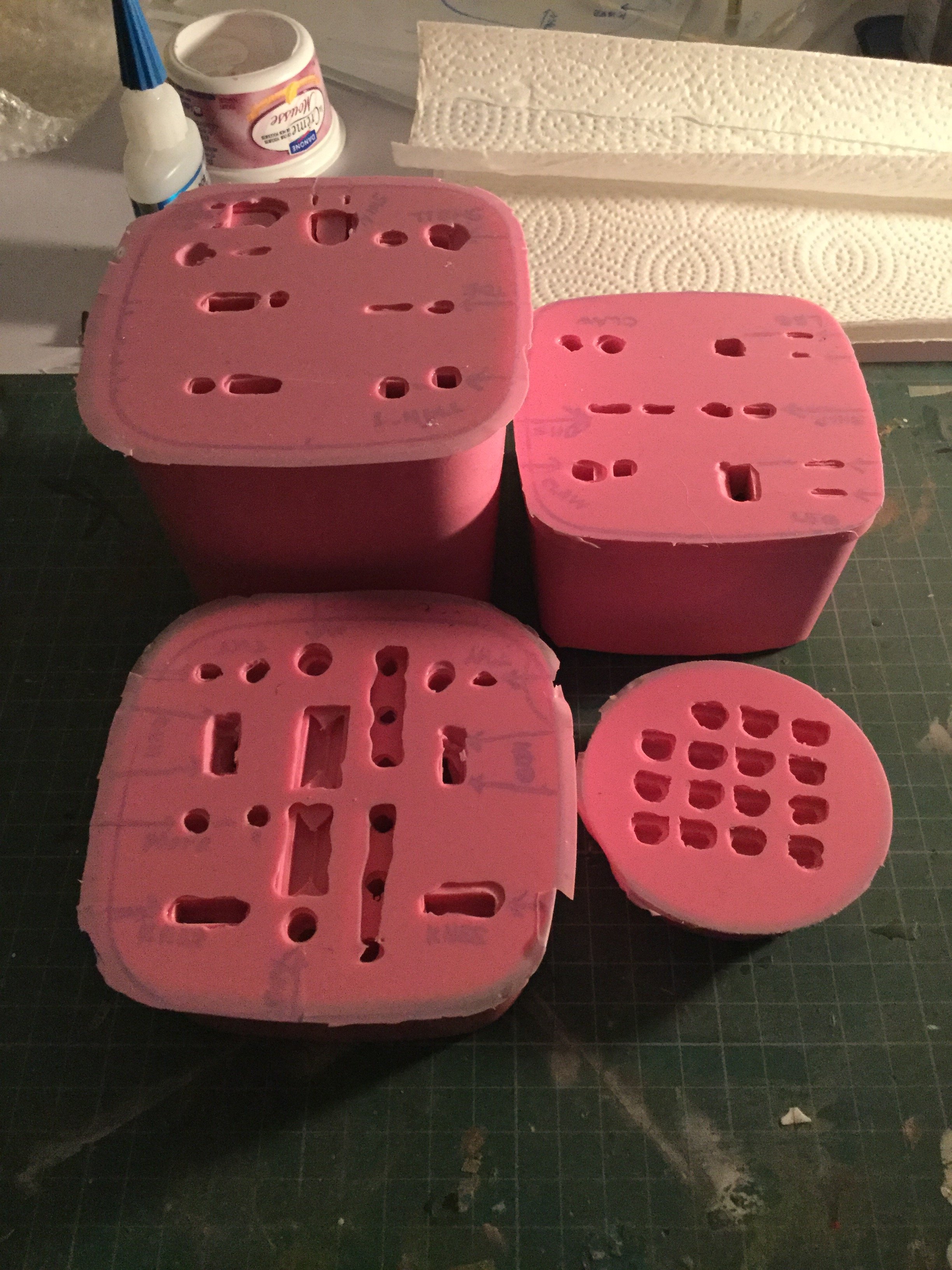

captain america Posted June 5, 2017 Author Posted June 5, 2017 Molds prep is proceeding according to schedule. Will be pouring the pink goop this afternoon. Quote

captain america Posted June 7, 2017 Author Posted June 7, 2017 Hey everyone! Molds will be ready tomorrow; I'll open them up and let them breathe until Saturday when I'll start casting. Will have a pic or two up by tomorrow. Quote
captain america Posted June 8, 2017 Author Posted June 8, 2017 Molds are airing out. Took a little longer than expected because I wanted to do a significant but subtle mod to the thigh parts. I felt that the hips were set too wide originally and wanted to narrow them a tad to look more like the style sheets. Had to cast an intermediate part, blah-blah-blah I succeeded! Quote

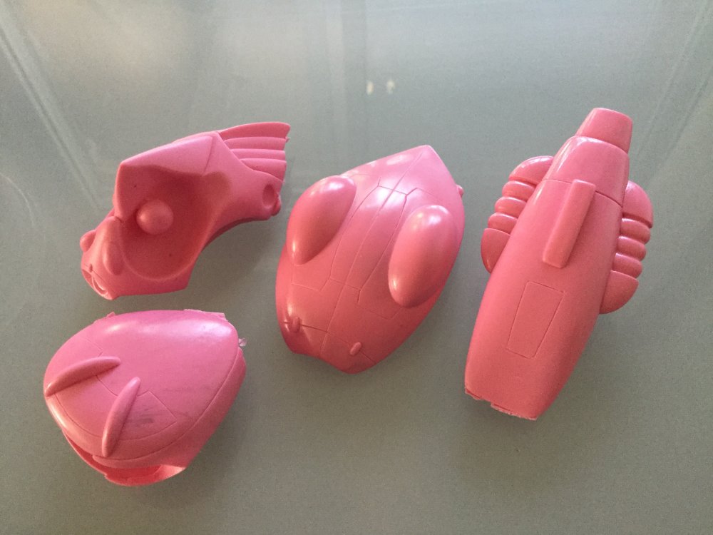

captain america Posted June 12, 2017 Author Posted June 12, 2017 On 6/9/2017 at 5:18 AM, arbit said: Thanks. I recently used smooth-on 30 to make a mold and found it really nice. Do you use a pressure chamber for the resin, or just pour? Because of the moisture-sensitivity of the resin, you have to pressurize the resin. Also a Monday update: the first castings didn't come out as expected... They came out bettar! But don't take my word for it, see for yourselves. Quote
coronadlux Posted June 12, 2017 Posted June 12, 2017 They look really good. I don't see any air pockets or voids. Quote
