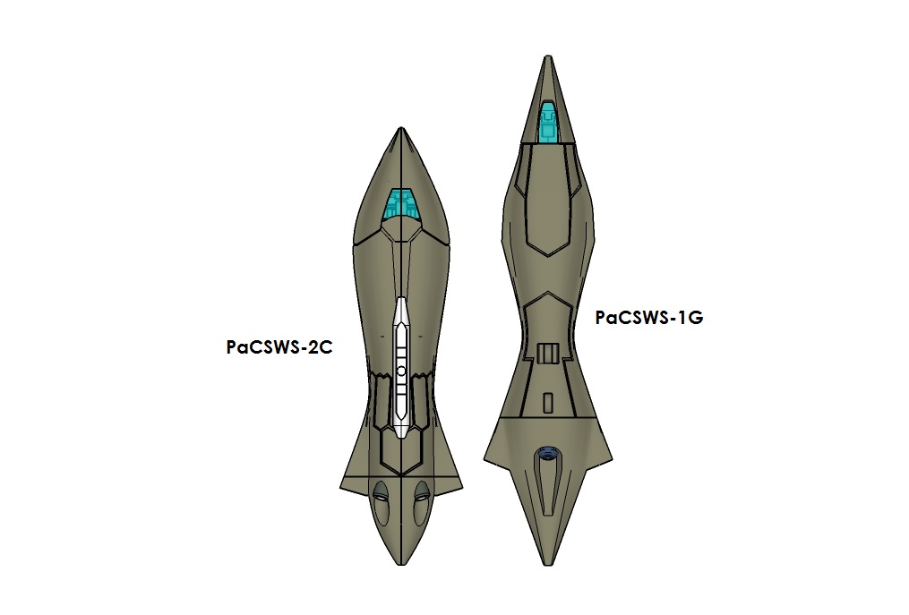

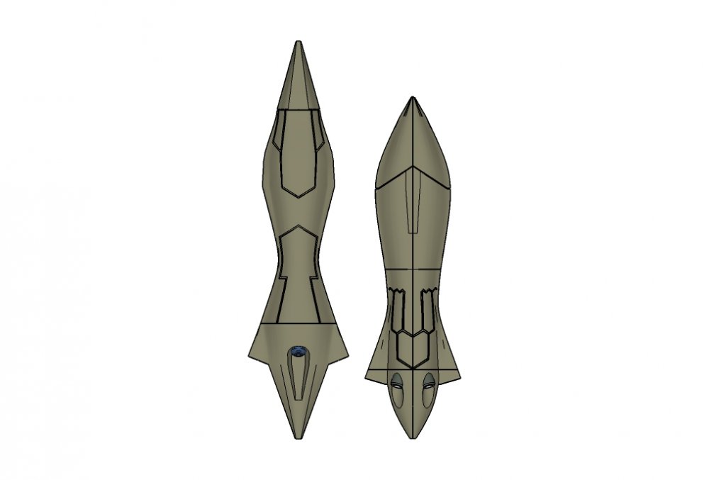

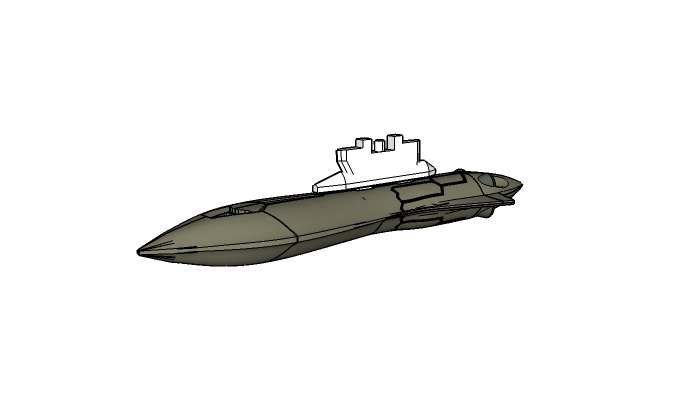

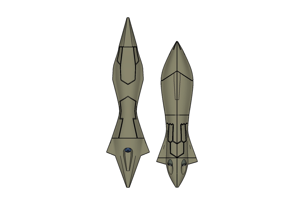

Xigfrid Posted June 6, 2017 Posted June 6, 2017 Made up the PaCSWS-2C variant today, it was trickier than expected because it is not vertically symmetrical. Since I have access to the Black HP Strong and Flexible beta test, I will order a couple of these in this material and see what this HP printer is all about I have put the 2C next to the 1G variant for size comparison. Quote
Mommar Posted June 6, 2017 Posted June 6, 2017 I didn't realize those two things were different. Quote

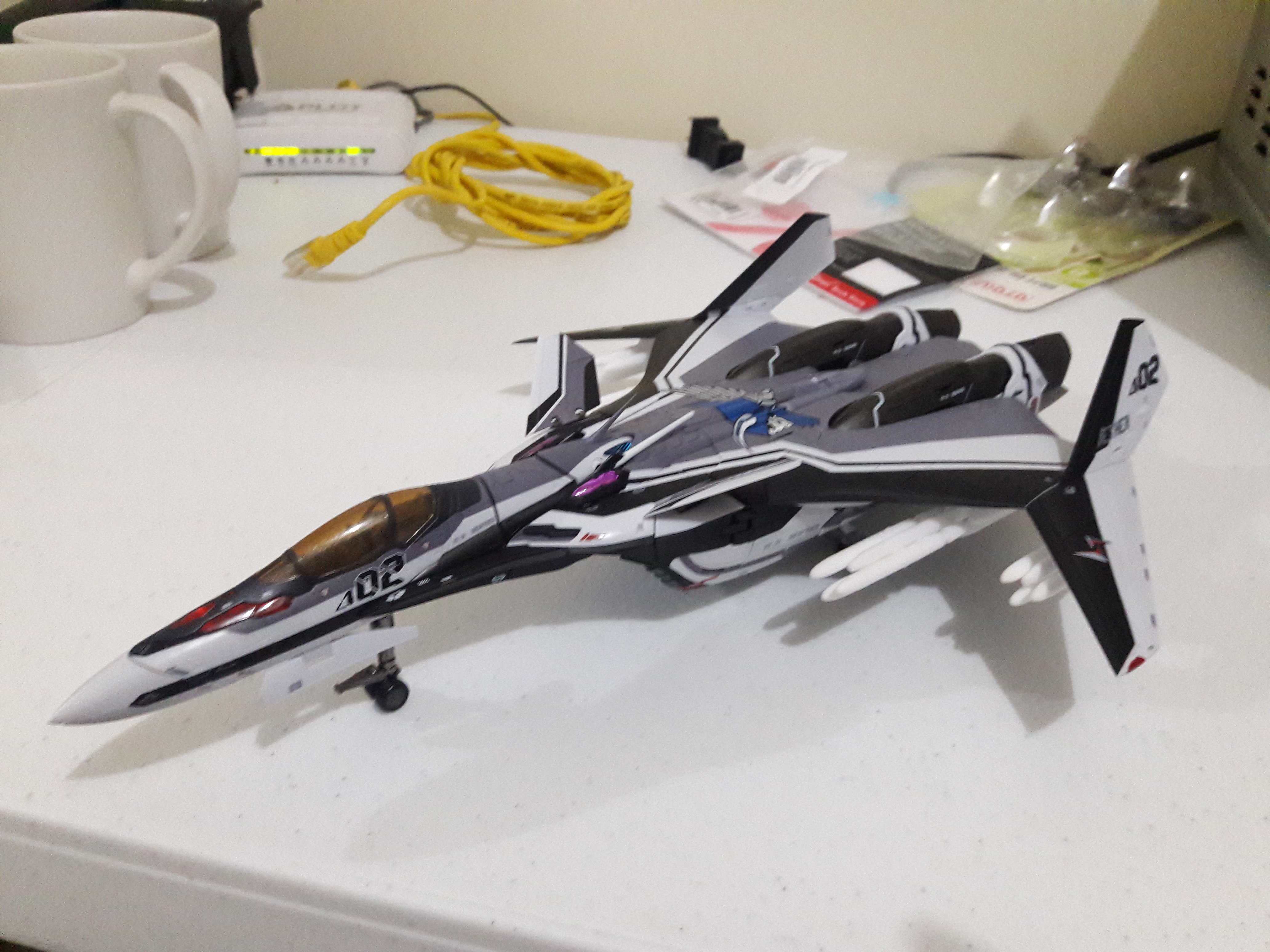

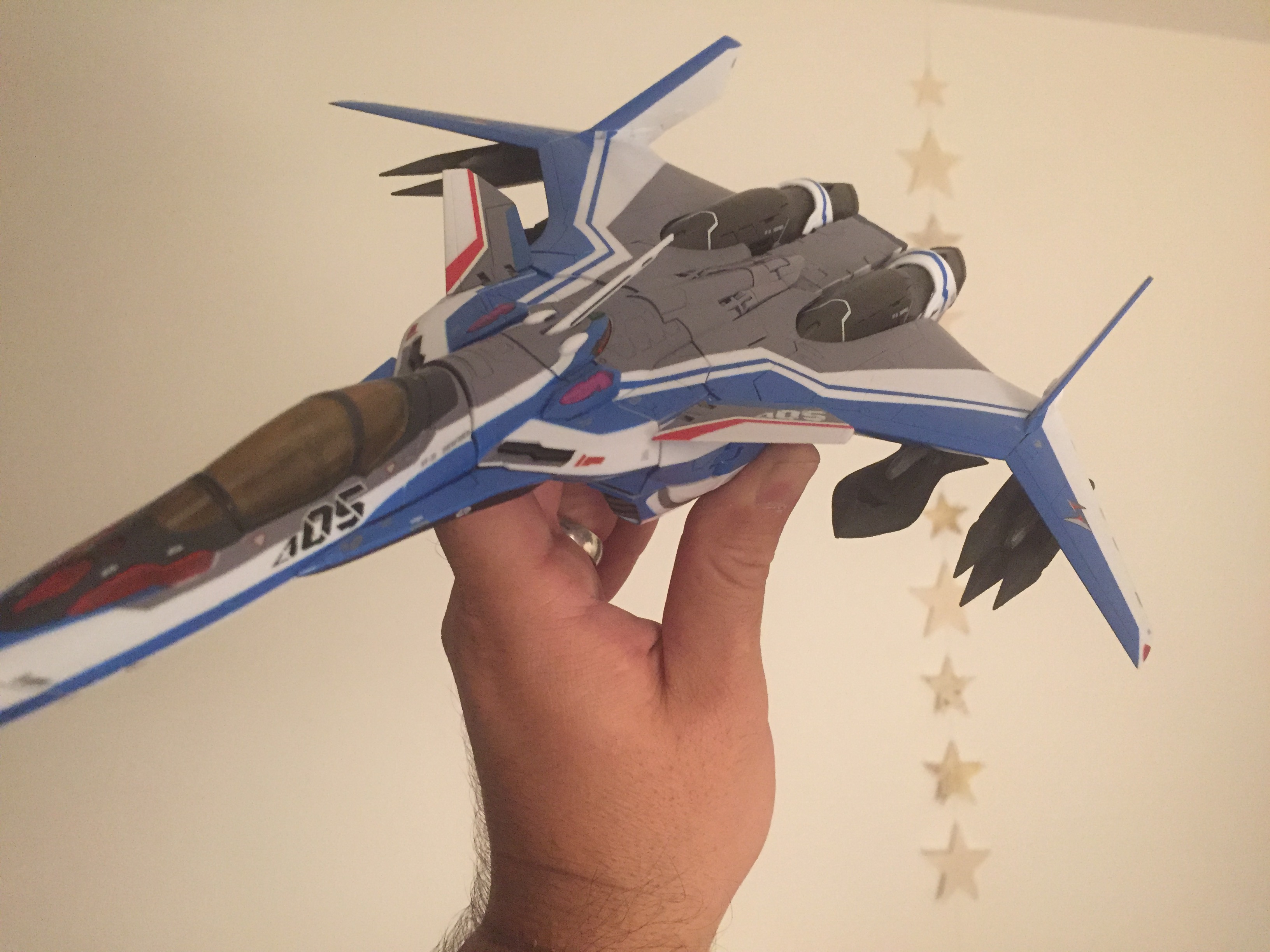

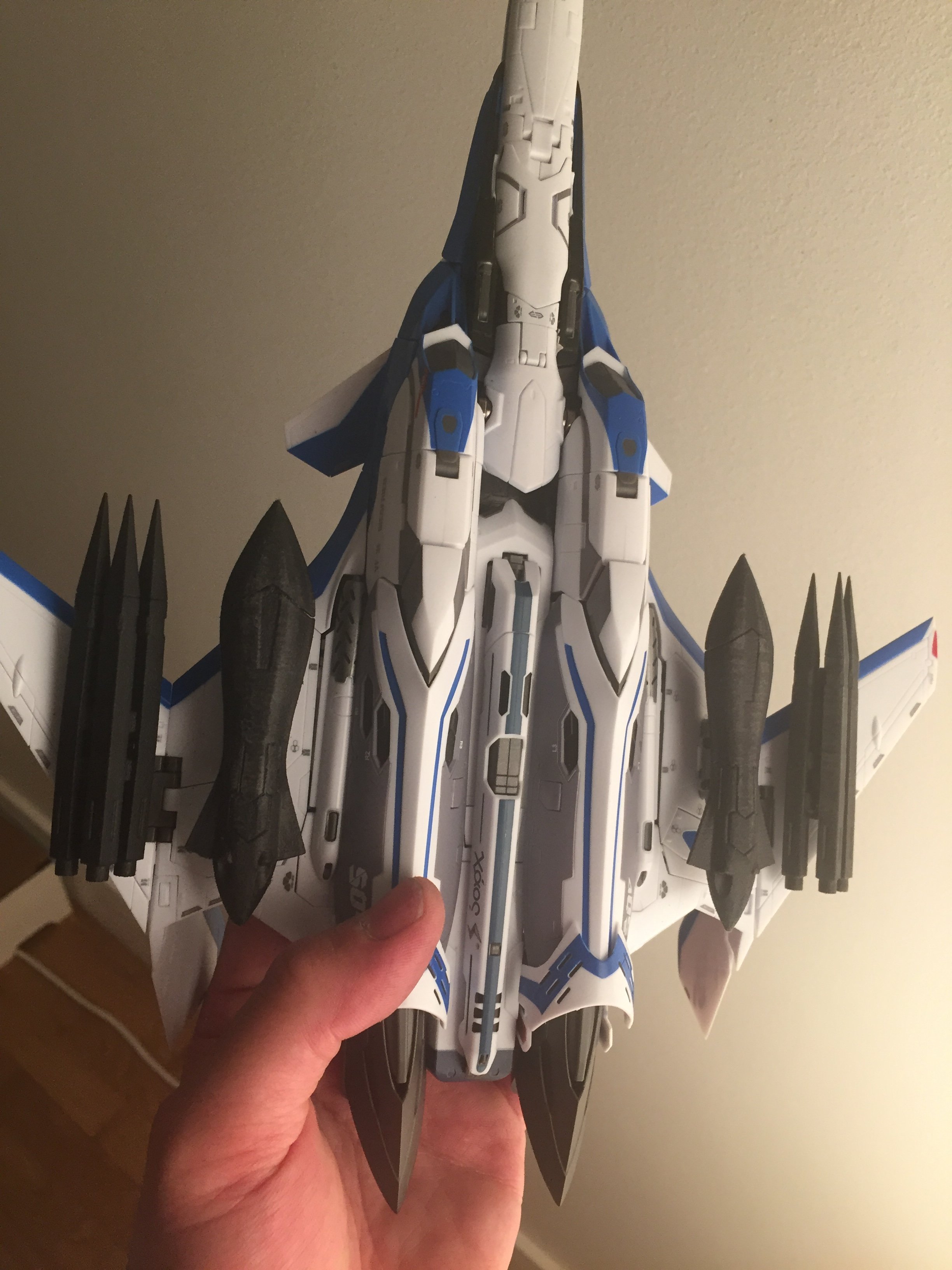

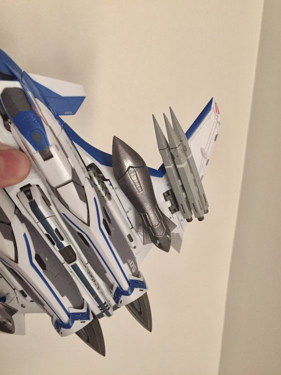

chyll2 Posted June 6, 2017 Author Posted June 6, 2017 Only have time to snap fit. I have to remove the notches/circular nub-like in the pylon since it is very hard to attach the missiles. I don't know though when will I have time to complete it. Question on the color of pylon, any suggested Tamiya spray color that would look good? Quote
Xigfrid Posted June 6, 2017 Posted June 6, 2017 27 minutes ago, chyll2 said: Only have time to snap fit. I have to remove the notches/circular nub-like in the pylon since it is very hard to attach the missiles. I don't know though when will I have time to complete it. Question on the color of pylon, any suggested Tamiya spray color that would look good? Nice! I also noticed that the tabs were a bit too tight on my PaCSWS-1G. So I have slightly reduced the thickness on the model now (0.1mm just to tell) Color wise, seriously white is too hard to color match, I just gave up on my VF-1X++ and went with different shades of gray. Just prime it with Tamiya grey primer, then heat up a white primer spray and spray from a 50 - 80 cm distance a very light mist of white primer over it. Repeat the white until you got too different grey shades and finish it with a gloss coat TS-13. You also have the AS spray cans, with military aircraft colors, but grey primer is cheap and ok! Quote

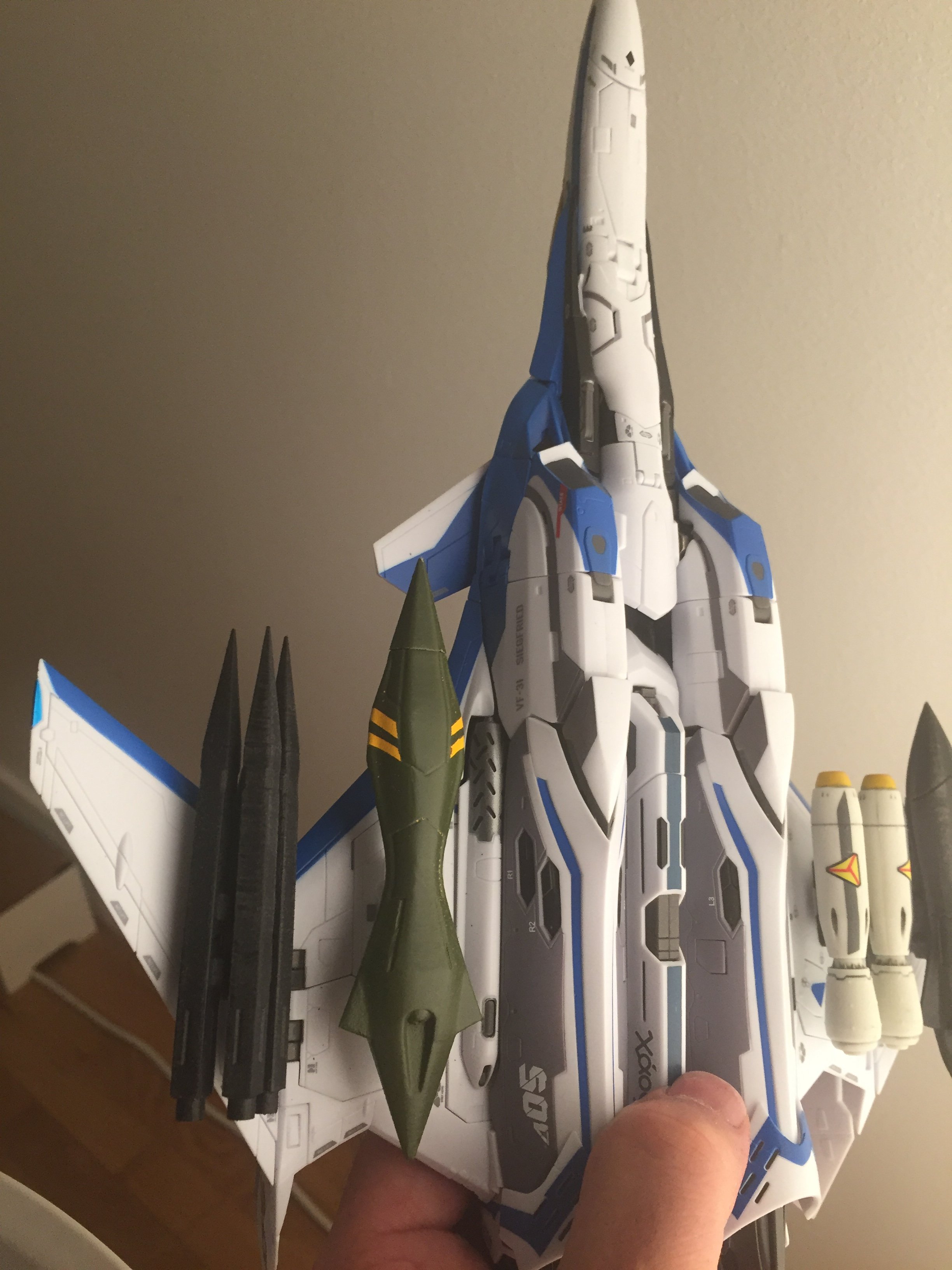

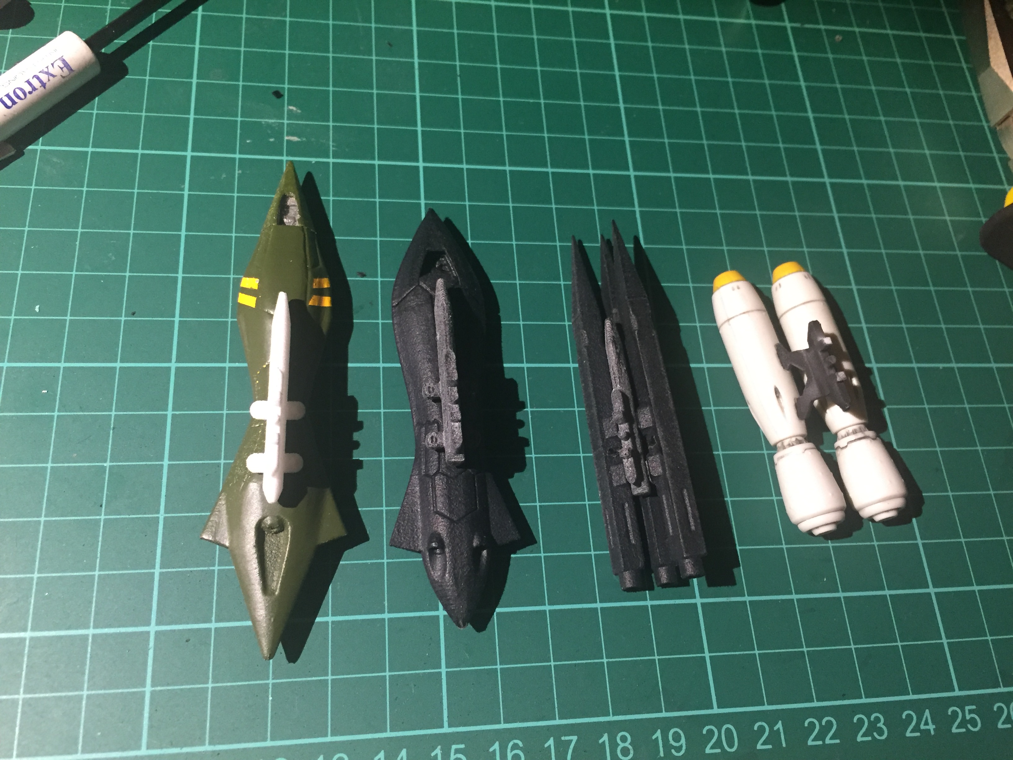

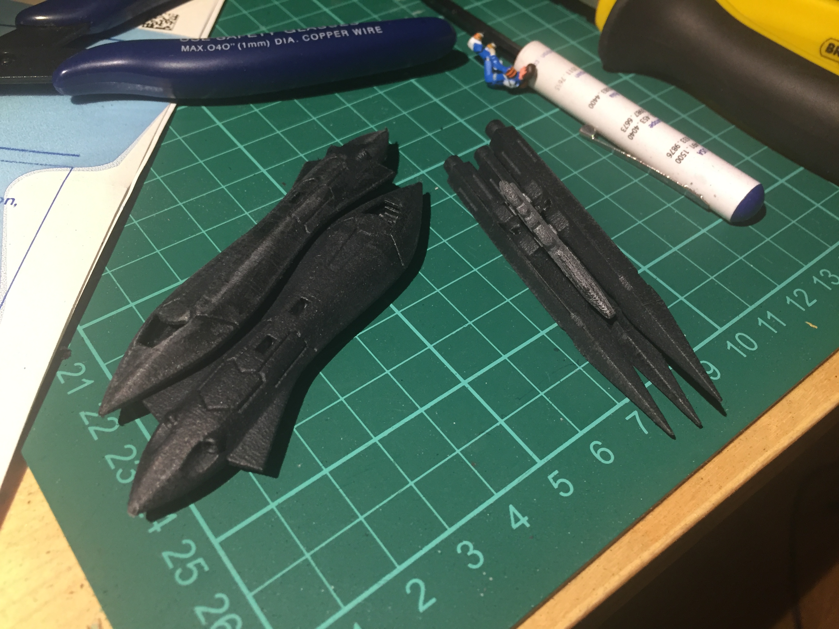

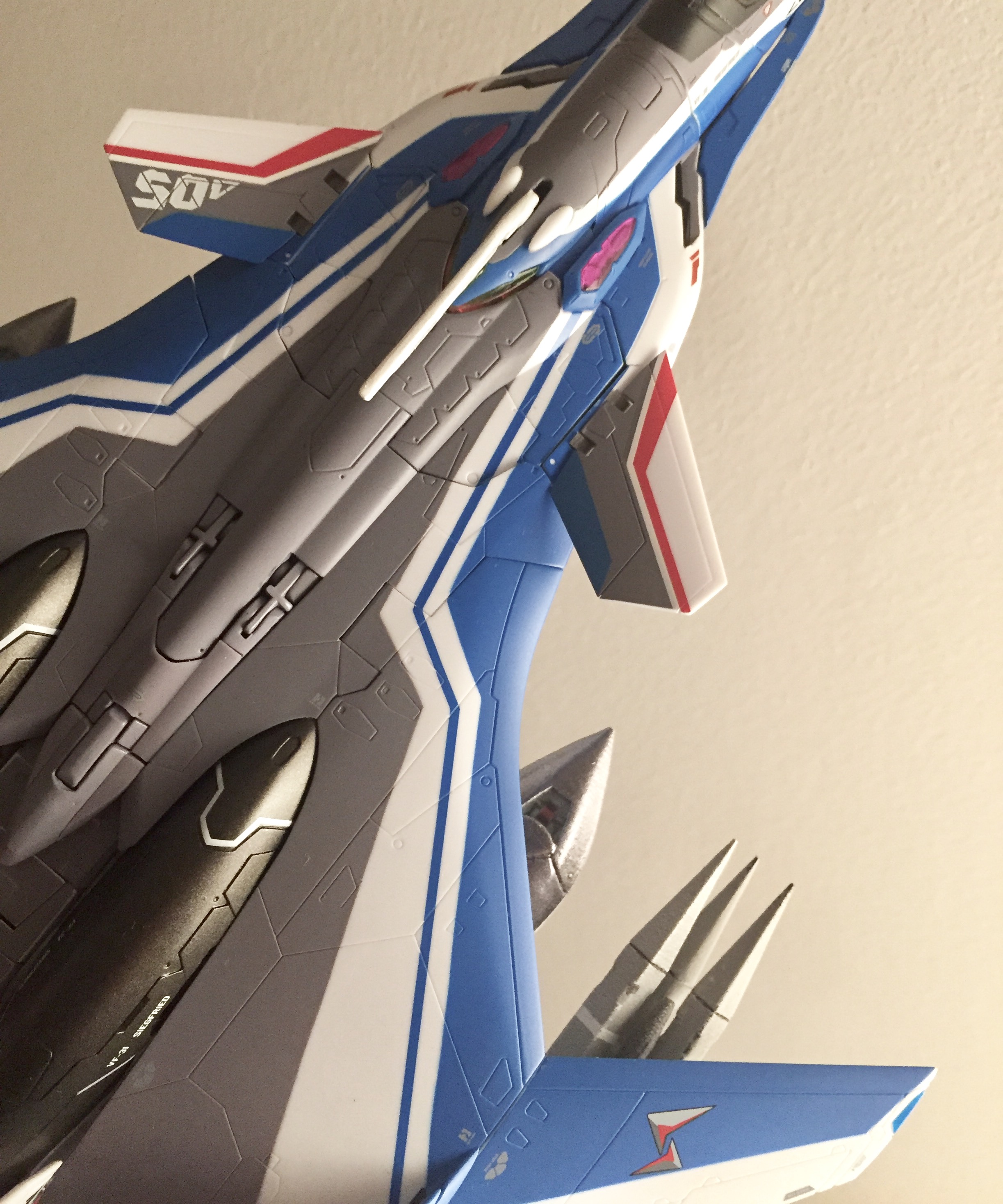

Xigfrid Posted June 21, 2017 Posted June 21, 2017 (edited) Receive the TMM and PaCSWS-2C missiles and quickly assemble them. This is the new Black HP WSF material, I did just a bit of sanding, no primer, no paint. Edited June 21, 2017 by Xigfrid Quote
chyll2 Posted June 22, 2017 Author Posted June 22, 2017 looking really good. how is the new material doing? is it worth the cost? Quote
Xigfrid Posted June 22, 2017 Posted June 22, 2017 Yeah the new material is really a step forward for 3D printing: sharper details than the classic WSF for only an additional 1.00$ i can't wait when they fix the beta test issues and make it available for purchase Quote

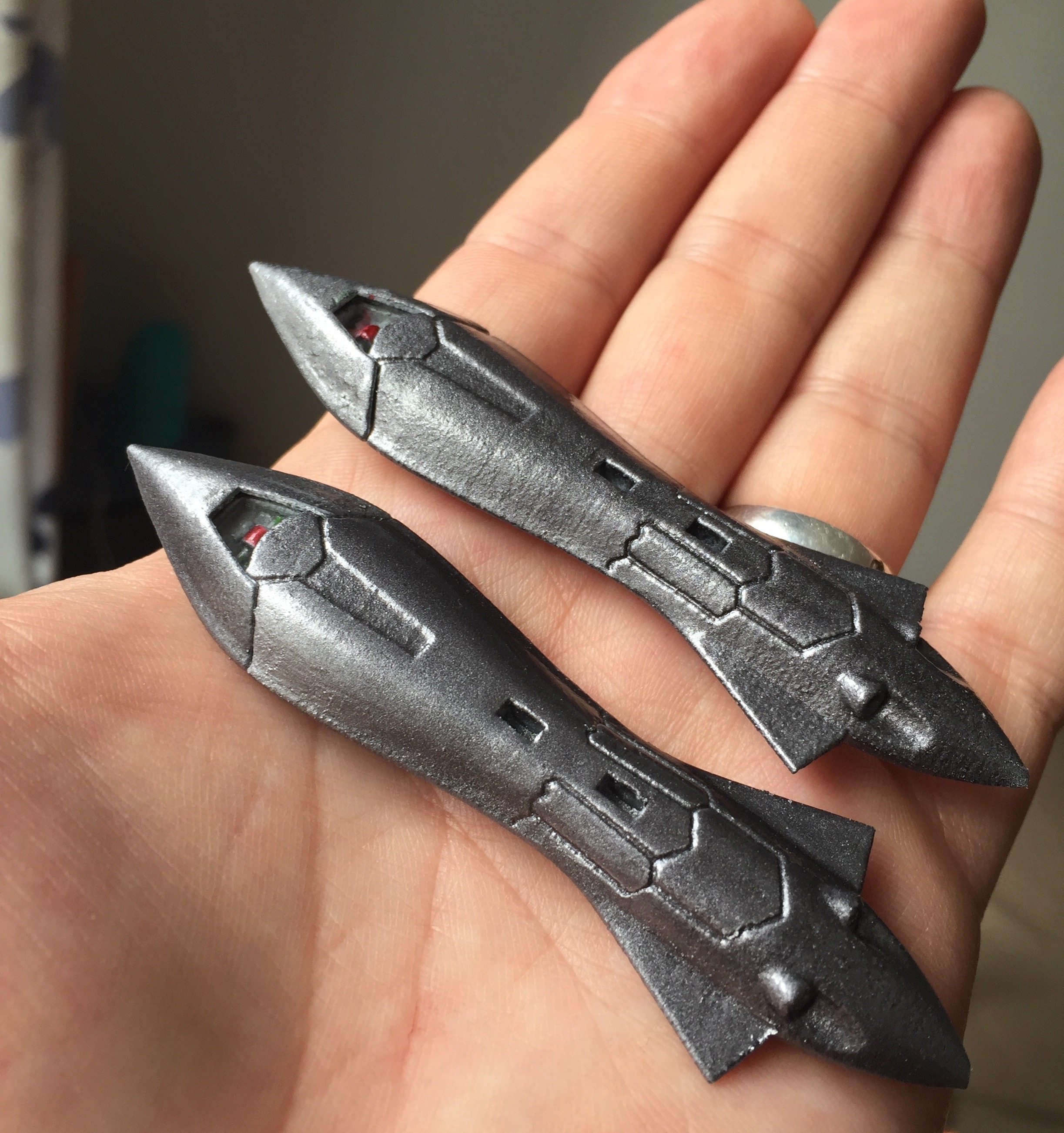

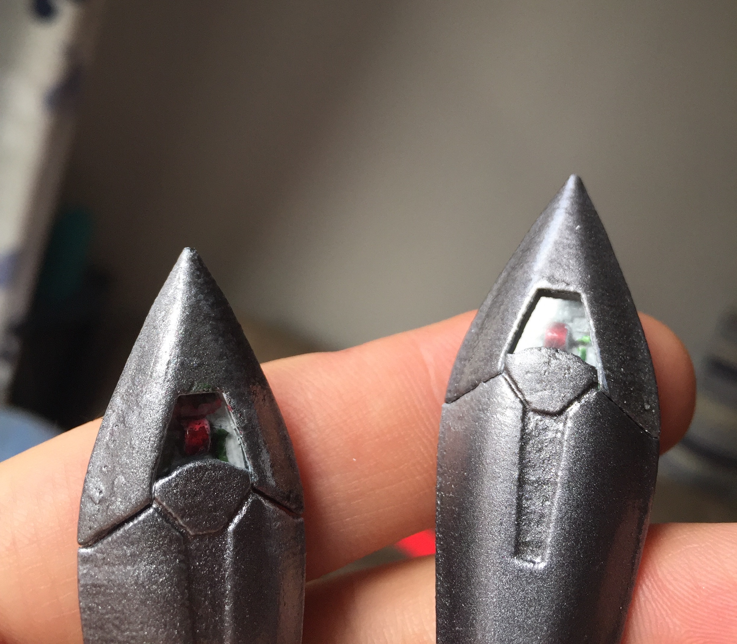

Xigfrid Posted June 30, 2017 Posted June 30, 2017 My new favorite color is officially light gunmetal aka TS-42. Added the canopy to the PaCSWS-2C. Quote

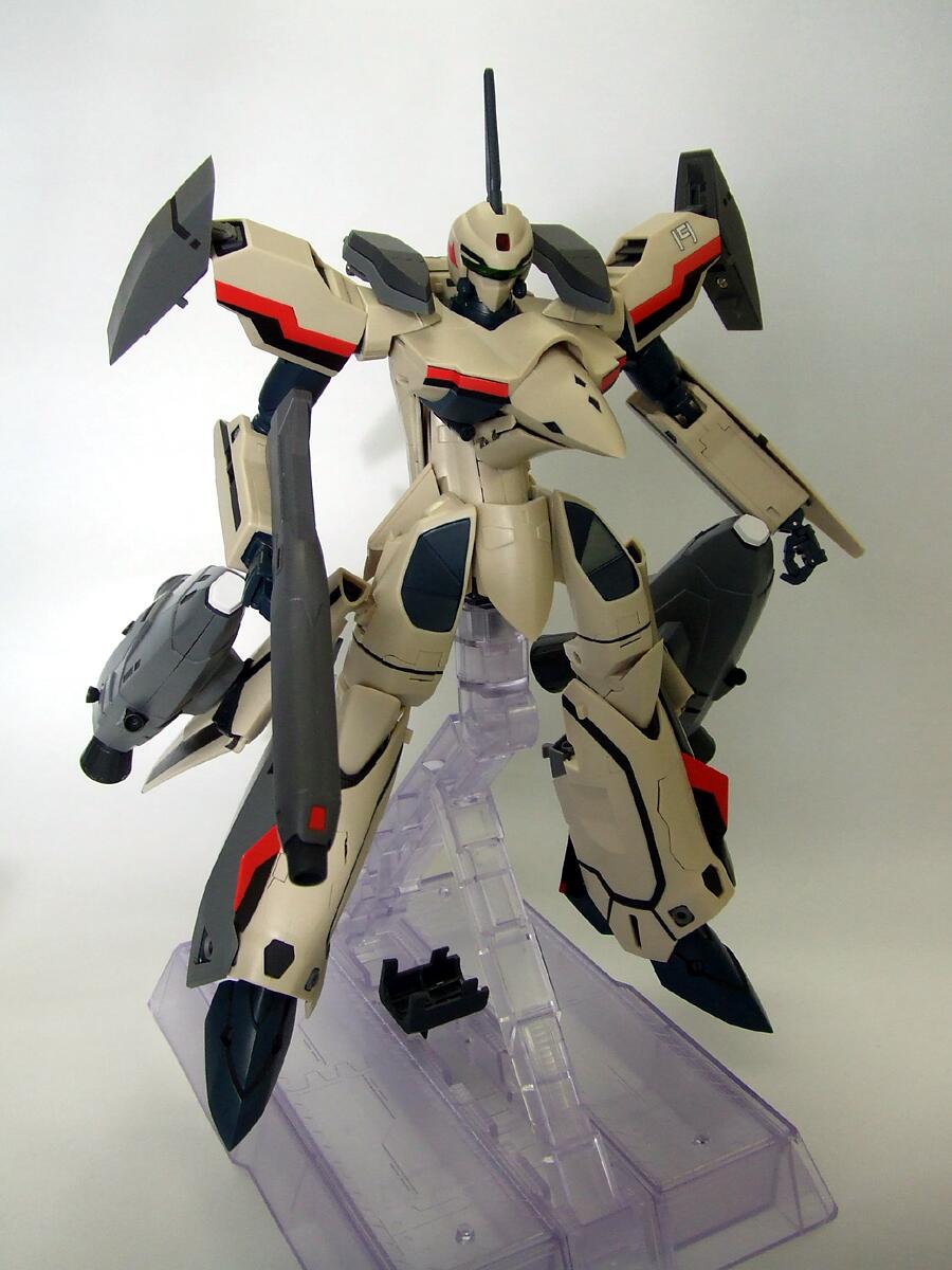

no3Ljm Posted August 24, 2017 Posted August 24, 2017 Is it ok to request, even if it's not a weapon? If so, how about those side wing holder clip for VF-19Advance's Boosters? Can it be done ala-Arcadia's YF-19? Quote
wmkjr Posted August 24, 2017 Posted August 24, 2017 1 hour ago, no3Ljm said: Is it ok to request, even if it's not a weapon? If so, how about those side wing holder clip for VF-19Advance's Boosters? Can it be done ala-Arcadia's YF-19? Should be doable. The tricky part is the booster clip to the pivoting wing clip. Wow. Just noticed it's been almost a year to the day since you wished for this. Quote
Xigfrid Posted August 24, 2017 Posted August 24, 2017 It worths a look, let me know if you have better pictures on how the Arcadia version clip locks to the wing. Quote
no3Ljm Posted August 24, 2017 Posted August 24, 2017 (edited) 13 hours ago, wmkjr said: Should be doable. The tricky part is the booster clip to the pivoting wing clip. Wow. Just noticed it's been almost a year to the day since you wished for this. I'm desperate. Hahaha! If only I know how to do 3D stuff. 12 hours ago, Xigfrid said: It worths a look, let me know if you have better pictures on how the Arcadia version clip locks to the wing. Hey Xigfrid. Thanks! Will PM you a clear pic later. I'm sure everyone will grab one once they see it's really doable. It's a shelf space saver. Edit: Also, just adding this one in. Since 3D print comes in black plastic, we don't need to paint it since it will blend well with the VF-19Advance black stripes. Edited August 24, 2017 by no3Ljm Quote
