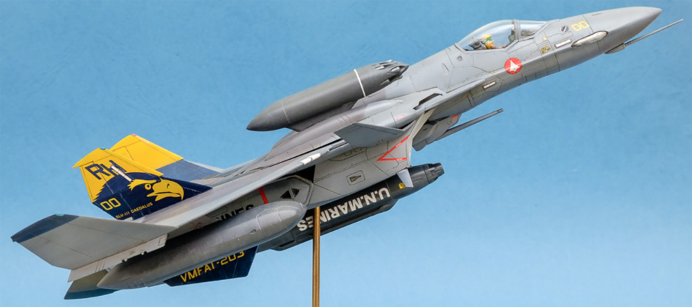

wmkjr Posted March 8, 2017 Posted March 8, 2017 (edited) Finished VF-0B here and here. Finished VF-0C here. Hello. I always wanted both a VF-0B and a VF-0C but I doubt Arcadia will do them (though one can hope!). I bought extra D's and A's in the hopes that the canopies could be swapped so I could make both a B and C. Thankfully they could and posted a couple of pics in the toys section. Although they looked okay I thought "both of them need a paintjob" so here I am. Bear with me as I'm a noob at these things so some of the ways I do things might not be the best way but it worked for me. Some helpful tools to have are: Spudger/Pry tool kit for the tiny screw hole covers and areas that need a little gentle help. Roll pin set and a small hammer to access the pins in the swing bar and to separate the chest piece. Don't need to do this using the new way. Extra plastic containers with lids labeled to keep all the small parts together. Don't do what I did and leave them in ziplocs as I found out the hard way as my darling wife threw a bag of small parts out into the rubbish and I spent half a day sorting through bags looking for it First thing I did was to take apart as much of the valks as I could so that I could mask and paint. Here is a pic of it apart, primed with Tamiya fine grey, and sprayed in AS-16 light grey. The legs are together and hanging. The rest of the time was masking and painting the various colors. I decided not to do the SPW scheme and instead do the VF-8 theme in the Master File. I sprayed the nose and lighter colored parts AS-20 insignia white, TS-16 yellow, and TS-29 semi gloss. After I let everything dry I put it all back together. Here's some pics of it in gerwalk and fighter modes. There's still a lot of stuff I need to touch up and put on some decals but that's where I'm at now. Thanks for stopping by! Here is the scheme for the VF-0B: This is the VF-0C scheme: 3/13/17: I added on the VF-0C to this thread so that I don't need to do another one. Edit 3/22/17 VF-0B Colors: Tamiya fine grey primer, AS-16 light grey for the main color, AS-20 Insignia white for the lighter parts, TS-18 yellow and TS-29 Semi gloss black. TS-80 flat clear. VF-0C Colors: Tamiya fine grey primer, TS-81 Royal light grey for the main, AS-7 Neutral grey, TS-15 Blue, TS-16 Yellow, and TS-29 Semi gloss black. TS-80 flat clear. EDITED: 8/26/17 I want to thank fellow member Ratatarse as he also did conversions but had a different way of converting. The difference is that he showed an easier way to convert than the way I did it. All he did was swap the cockpit sections along with the cockpit shields. Disregard all the rest of the instructions as my method was trying to fit a square peg in a round hole. Lol. Edited August 28, 2017 by wmkjr Added new instructions for an easier method of converting.

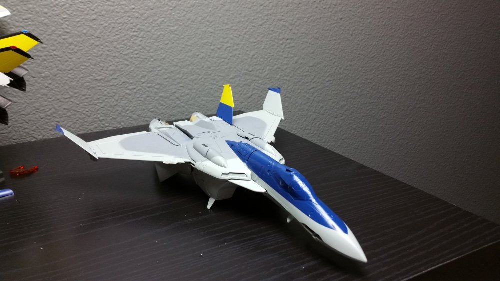

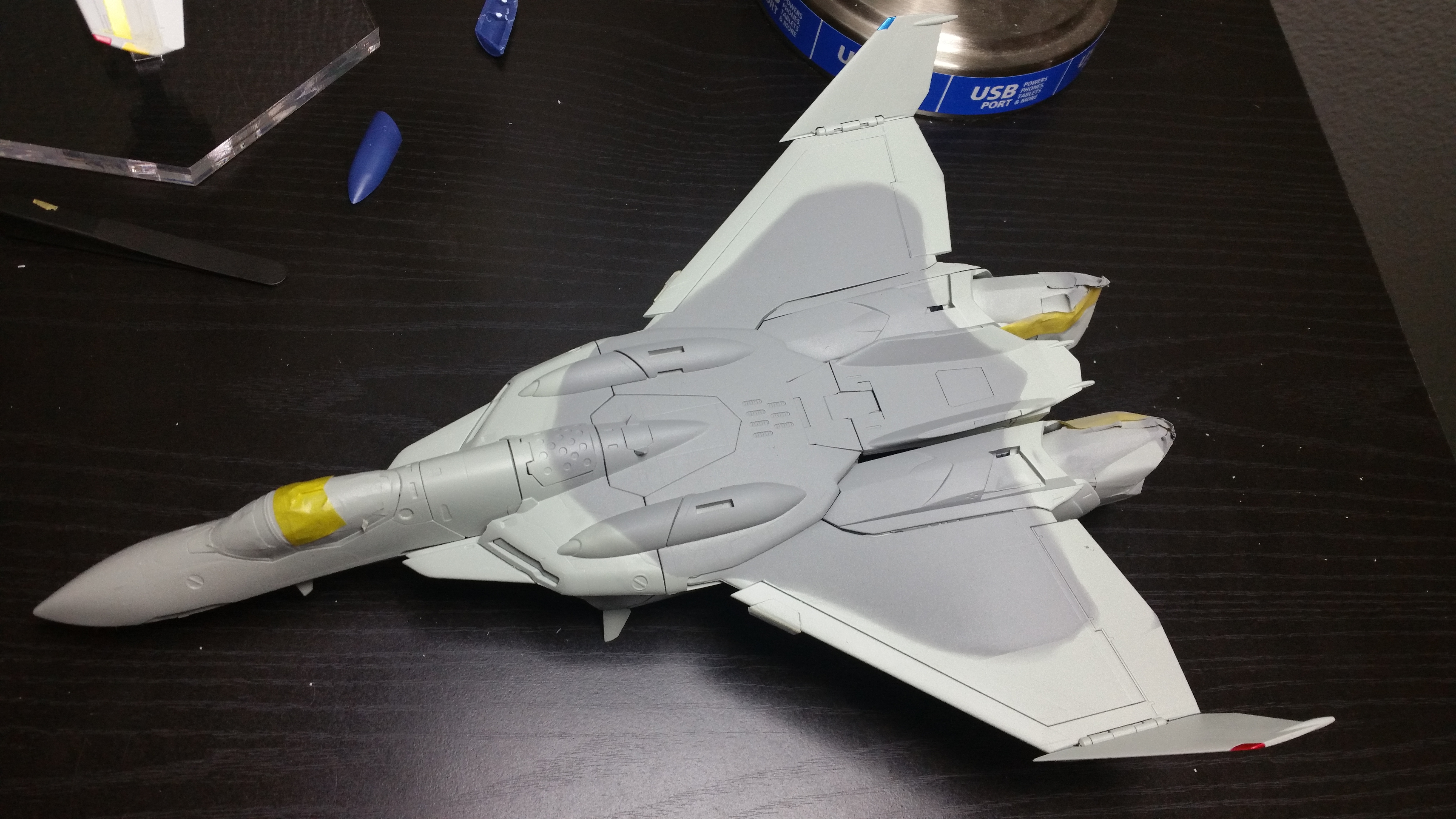

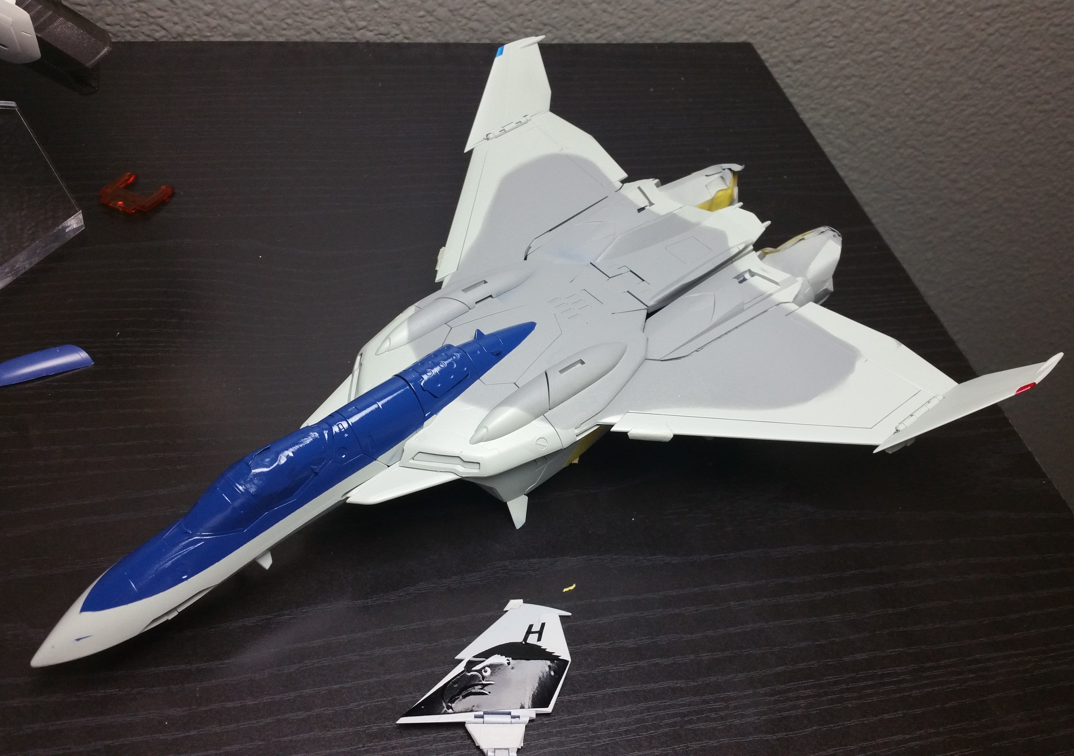

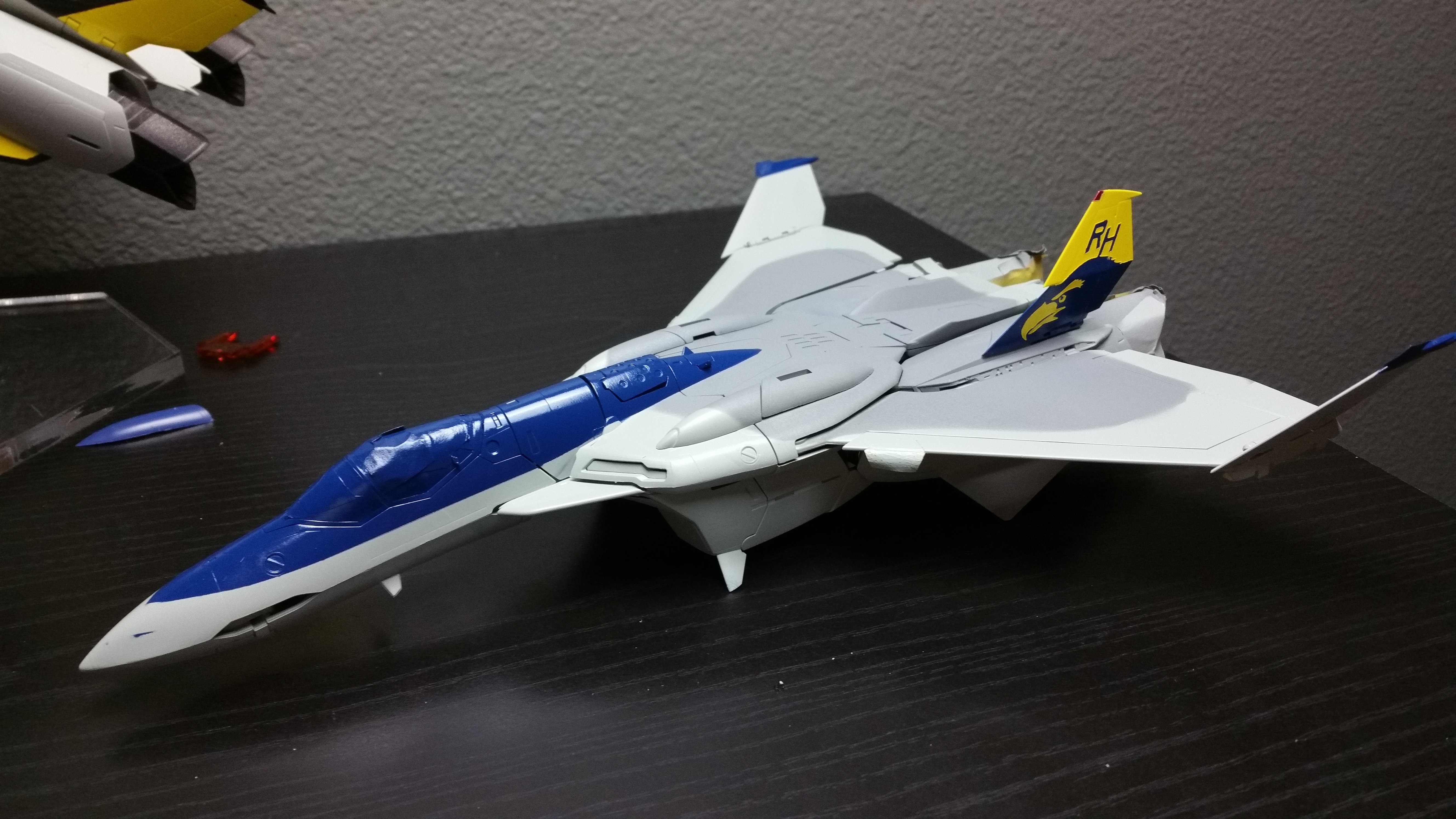

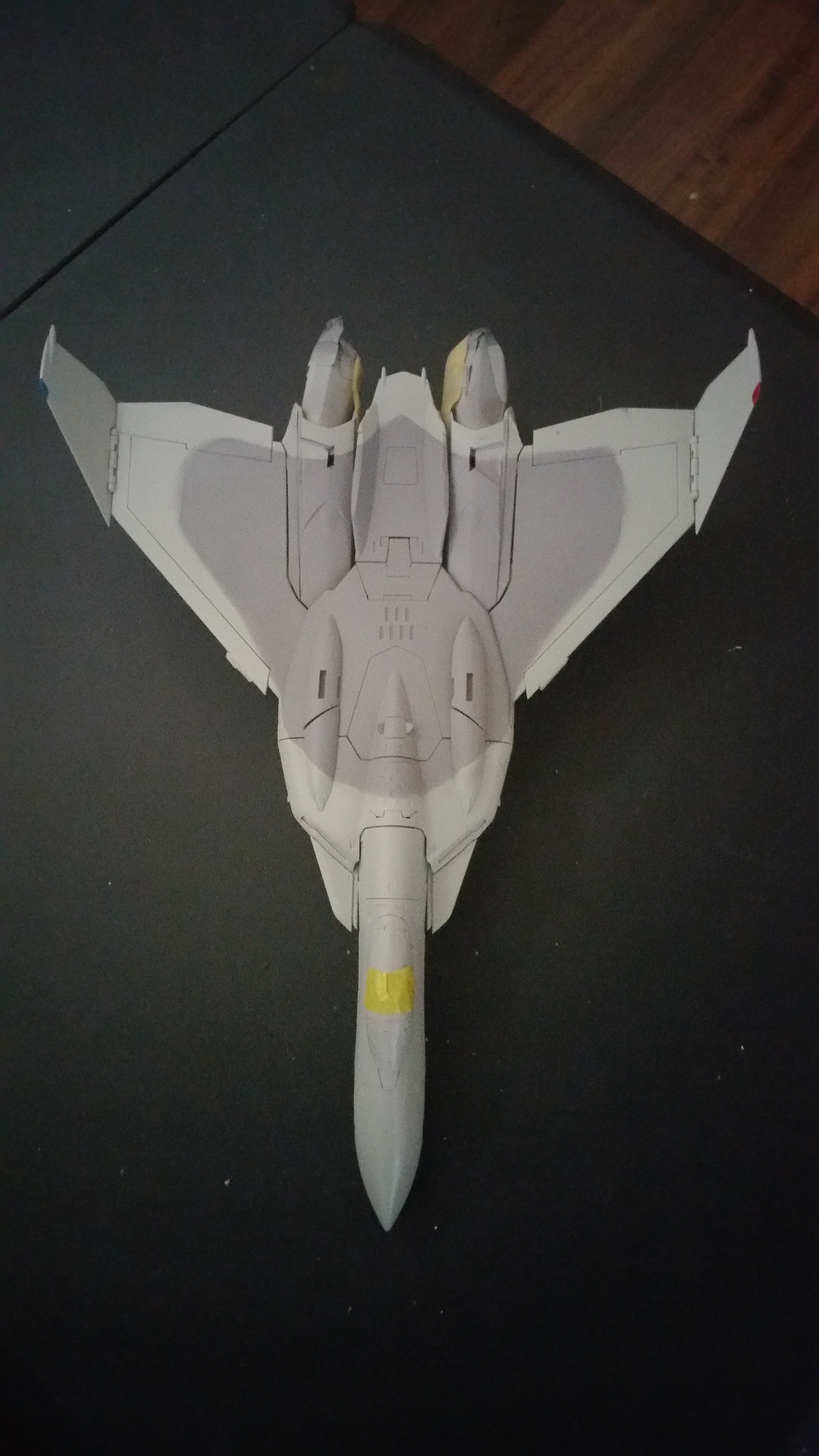

wmkjr Posted March 14, 2017 Author Posted March 14, 2017 Hello again. Here is where I'm at now. I put the B on the side for now till everything is cured. I finished priming and spraying the base color for the VF-0C. After I let it sit for few days I sprayed on the darker grey color which is what I have now. I'll be masking the front so that I can spray the blue in a few days.

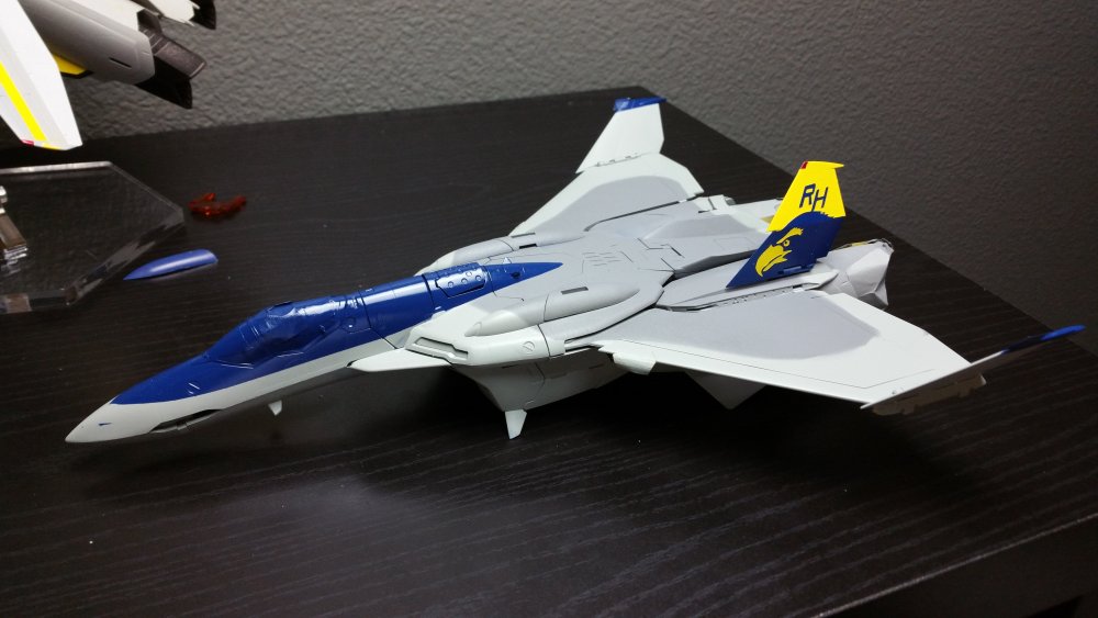

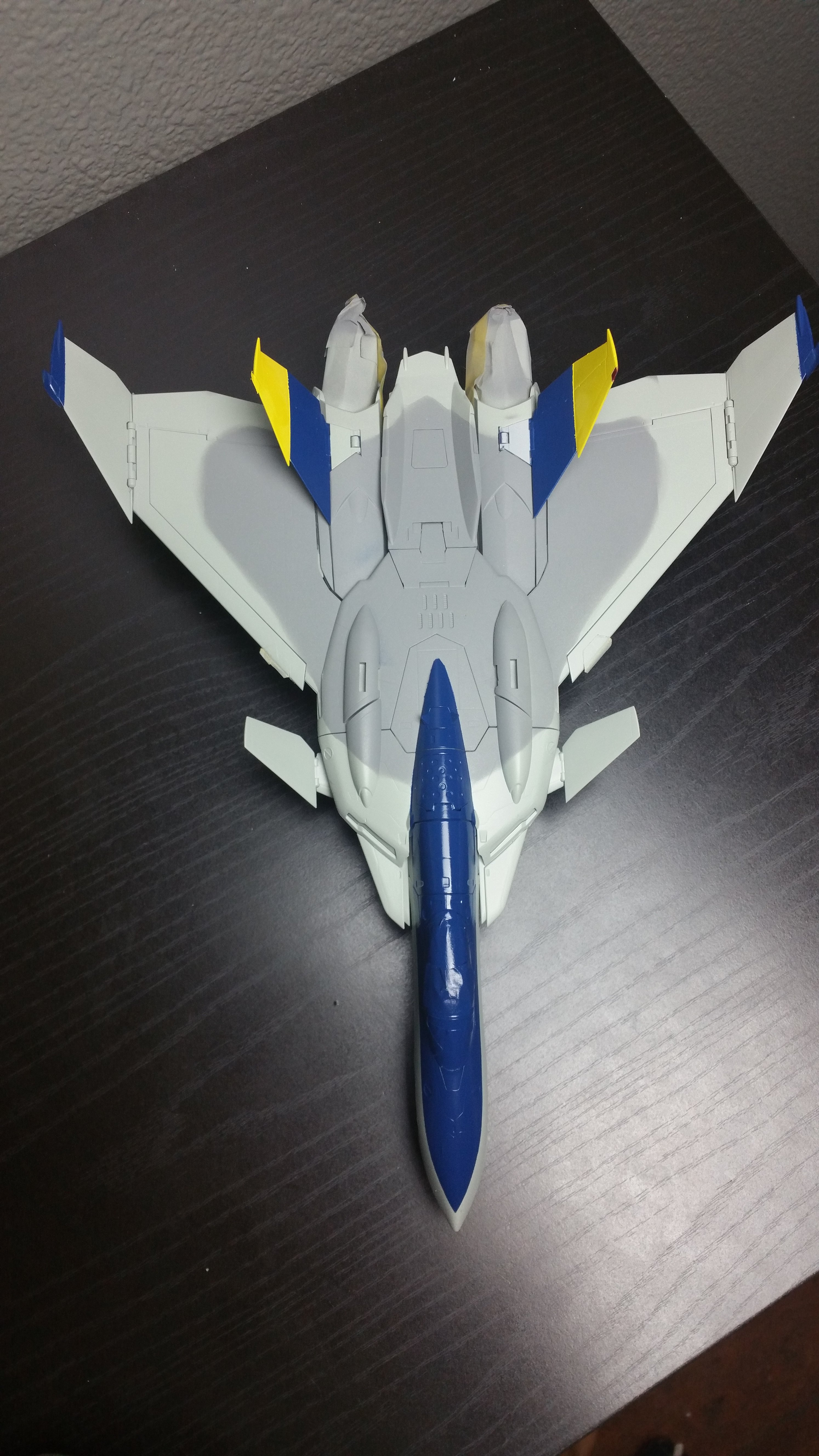

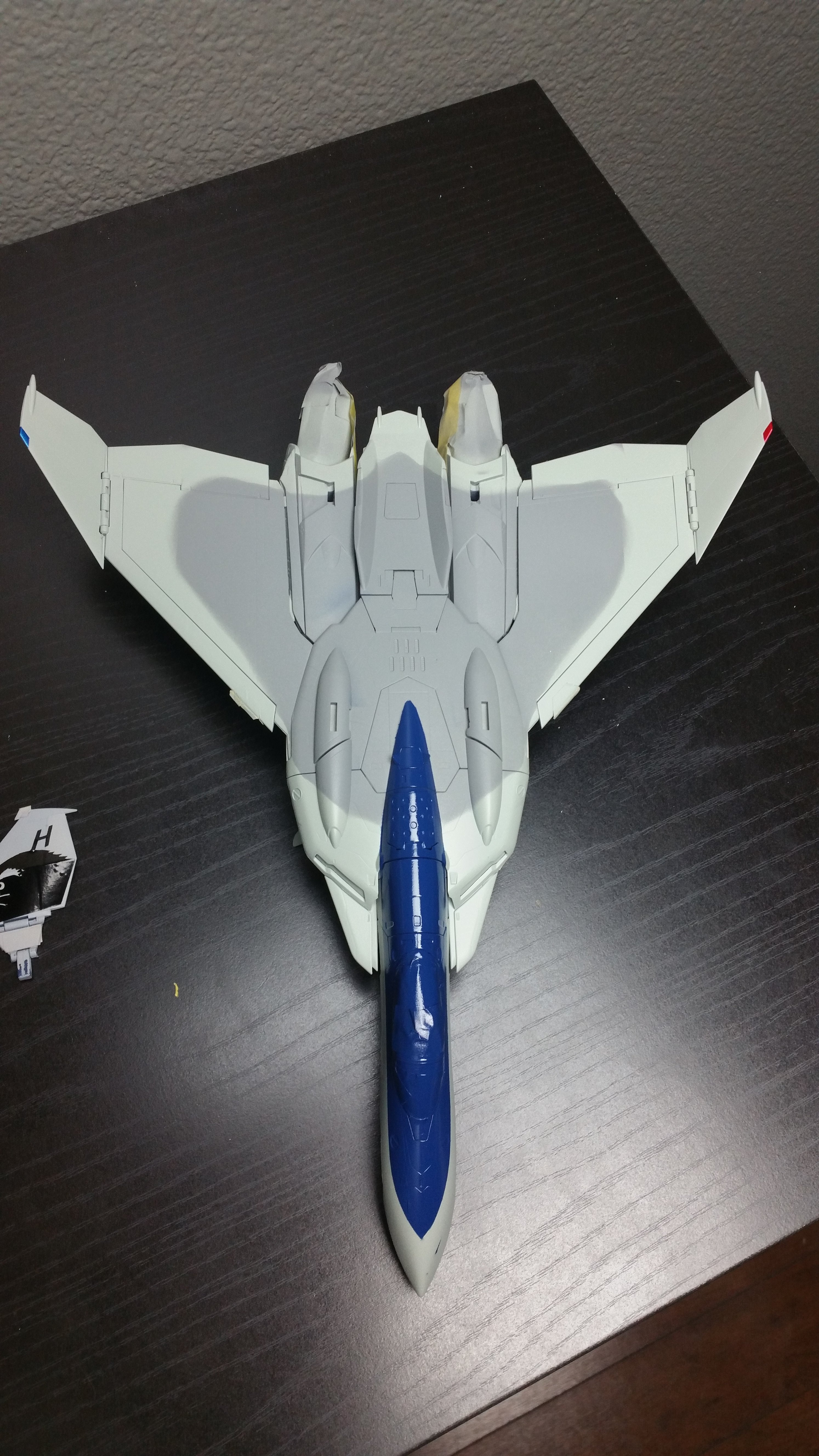

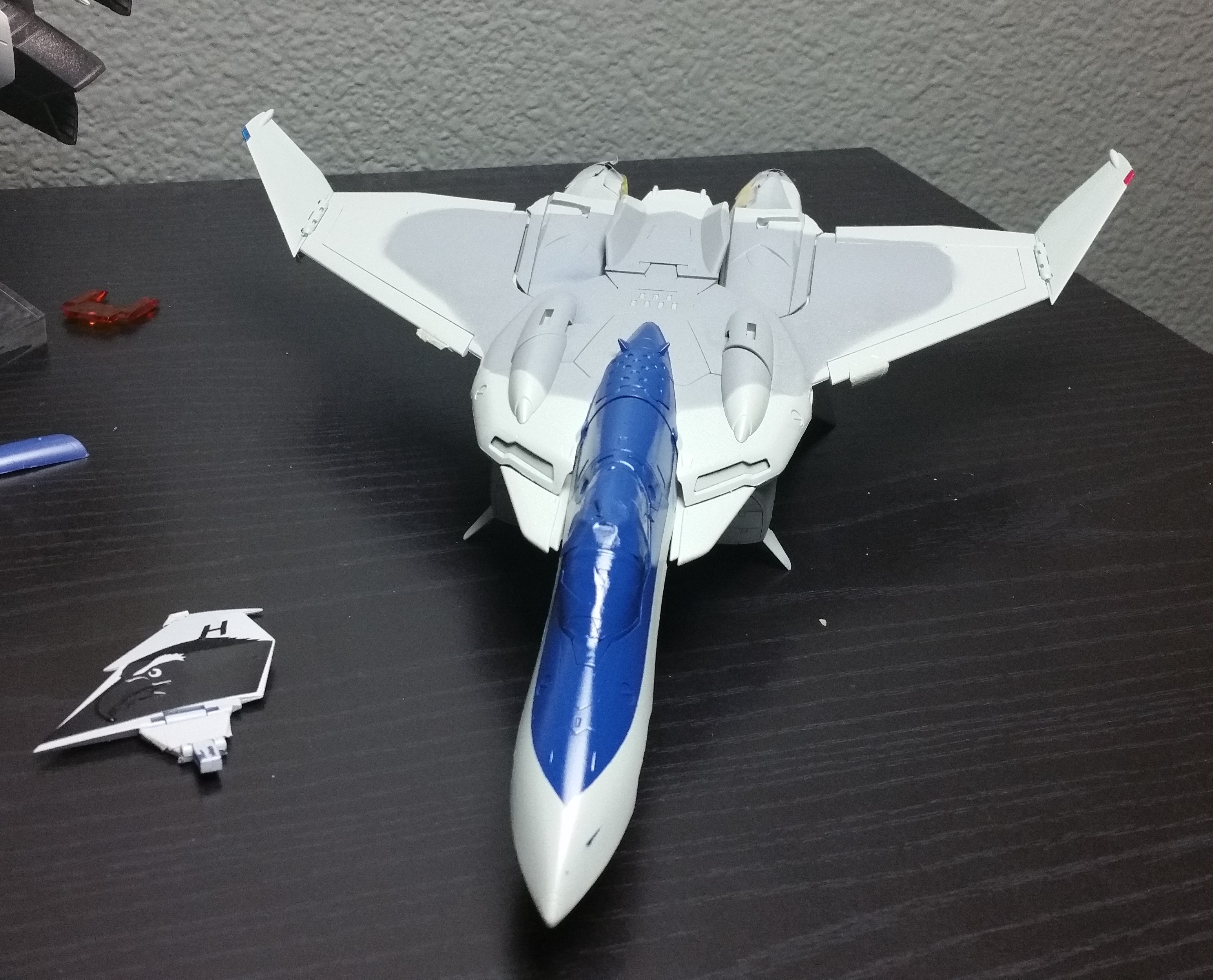

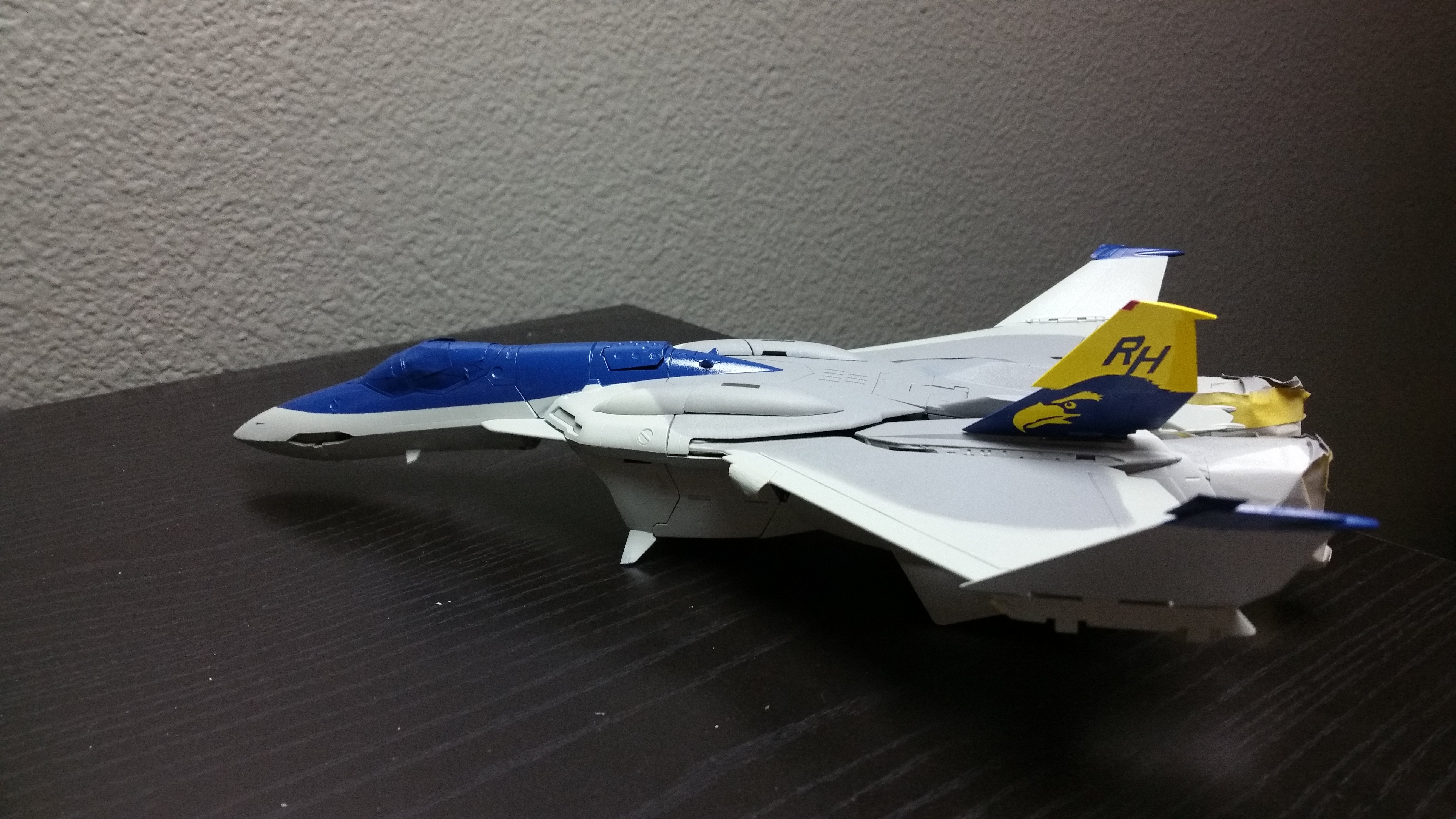

wmkjr Posted March 15, 2017 Author Posted March 15, 2017 (edited) I've sprayed the nose blue. Just need to do the leg fins and wing tips then gotta figure out the hardest part to me, the tailfins. I tried looking for a high res image of the tailfins but couldn't find one so I just grabbed a pic online, upscaled as much as could then retraced it line by line in Inkscape. Luckly, my wife has this thing called a Silhouette Cameo so I'm experimenting with using a low tack vinyl decal as a mask. I gave it to her in a png file and she inputted it in her software. The one you see is just a test as she started to throw it away after she thought she made a mistake. I put it on to see if it'll work ( I didn't peel the beak part), I'm impressed at how small that thing can cut! It sticks on pretty good and peels off nice and easy with no residue or damage to the paint. Next thing I'll do is test paint the tailfins then work on the UN MARINES font and right tailfin RH letters as it slants in the opposite direction. Edited March 16, 2017 by wmkjr
wmkjr Posted March 16, 2017 Author Posted March 16, 2017 BUWAHAHA! I did it backwards as I painted the tailfin blue overall then the yellow. Getting access to the smaller parts of the decal is a PITA. Now I gotta draw the other side's RH lettering and redo the decal to face the other way. I don't have the other texts because it's too small to work with.
Chronocidal Posted March 16, 2017 Posted March 16, 2017 (edited) See.. this is what I would basically love to do with all of my models. Painted markings are just so much more attractive to me, I love trying to paint as much as possible and only use decals for very small lettering and things that would be impractical to paint. Those vinyl patterns pretty much nailed the markings on the tail, I love how clean that looks. By the way, as long as you're at it.. why not cut out some clear plastic inserts and replace the painted on wing lights? That's one feature I was pretty disappointed with when Arcadia didn't keep the clear ones. Edited March 16, 2017 by Chronocidal
wmkjr Posted March 16, 2017 Author Posted March 16, 2017 17 minutes ago, Chronocidal said: See.. this is what I would basically love to do with all of my models. Painted markings are just so much more attractive to me, I love trying to paint as much as possible and only use decals for very small lettering and things that would be impractical to paint. Those vinyl patterns pretty much nailed the markings on the tail, I love how clean that looks. By the way, as long as you're at it.. why not cut out some clear plastic inserts and replace the painted on wing lights? That's one feature I was pretty disappointed with when Arcadia didn't keep the clear ones. I give you credit as it's a PITA to do your own paintings this way. As far as the clear inserts go I'm not at that level to trust myself with something like that let alone attempt. The one thing that helps me is that I have a lot of free time on my days off from work and can goof off and learn some of the programs to help create these.

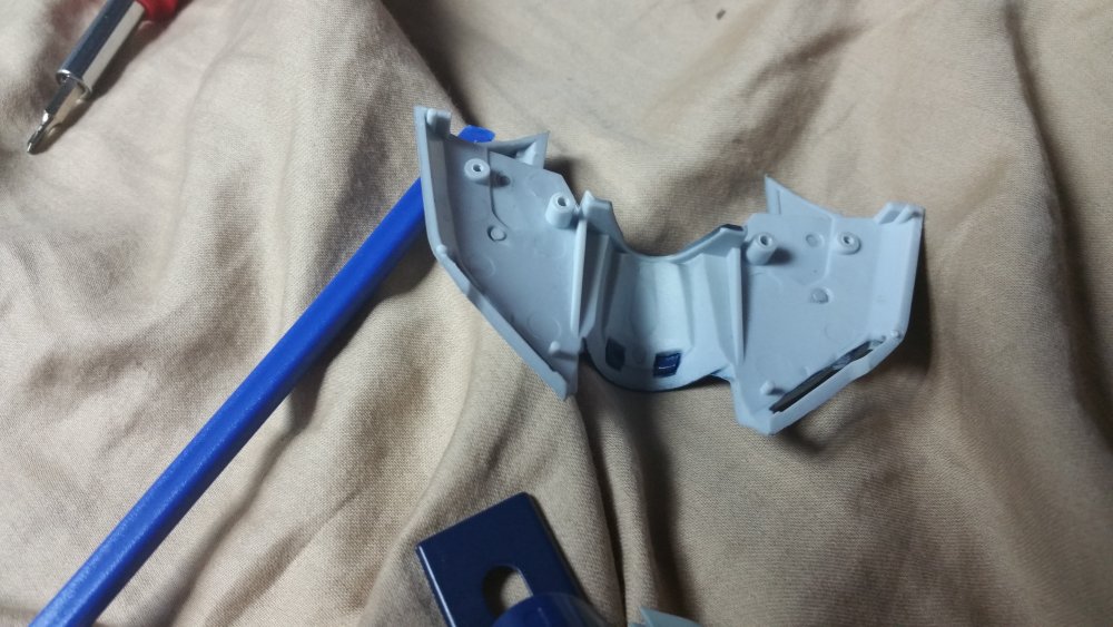

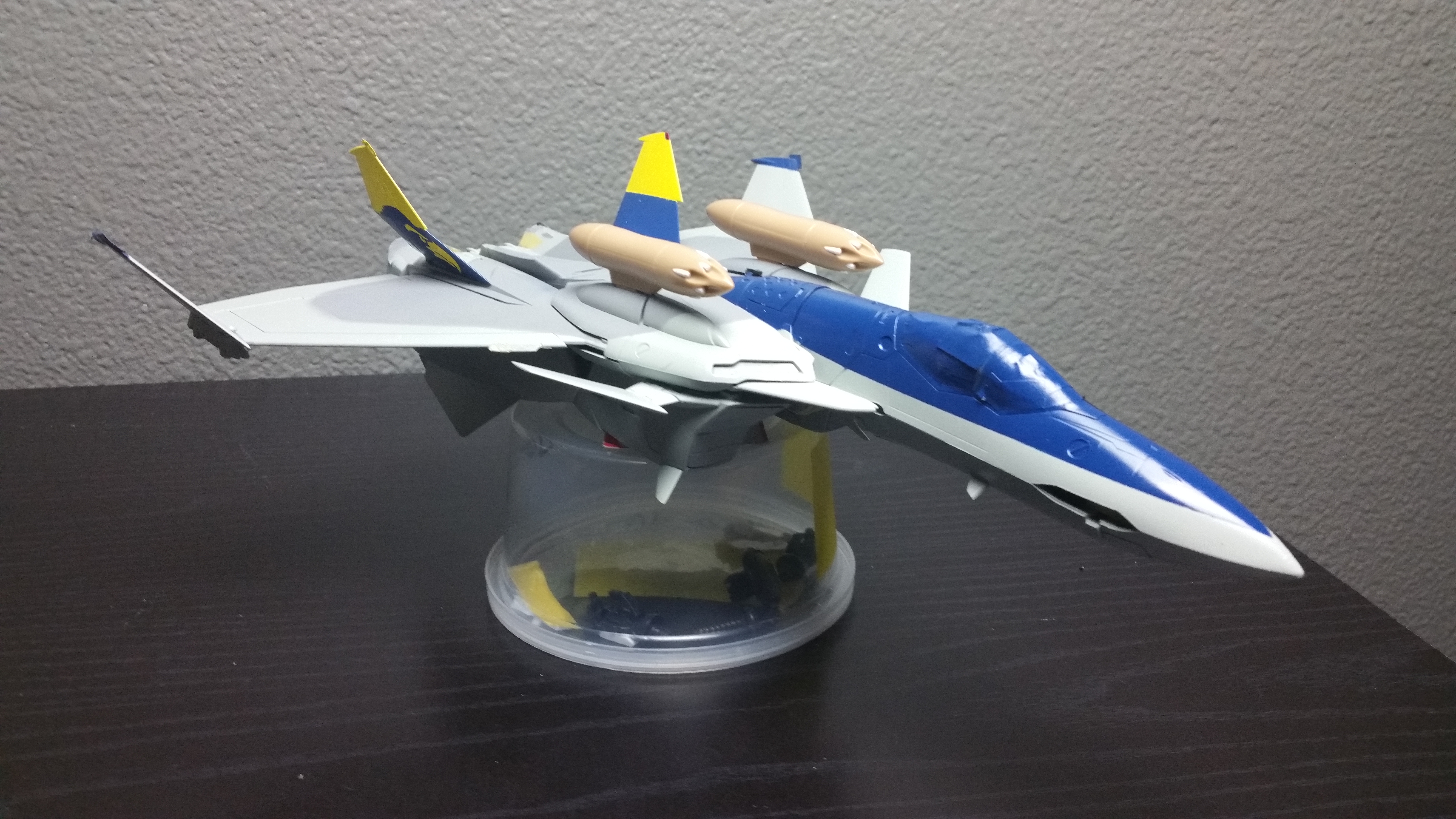

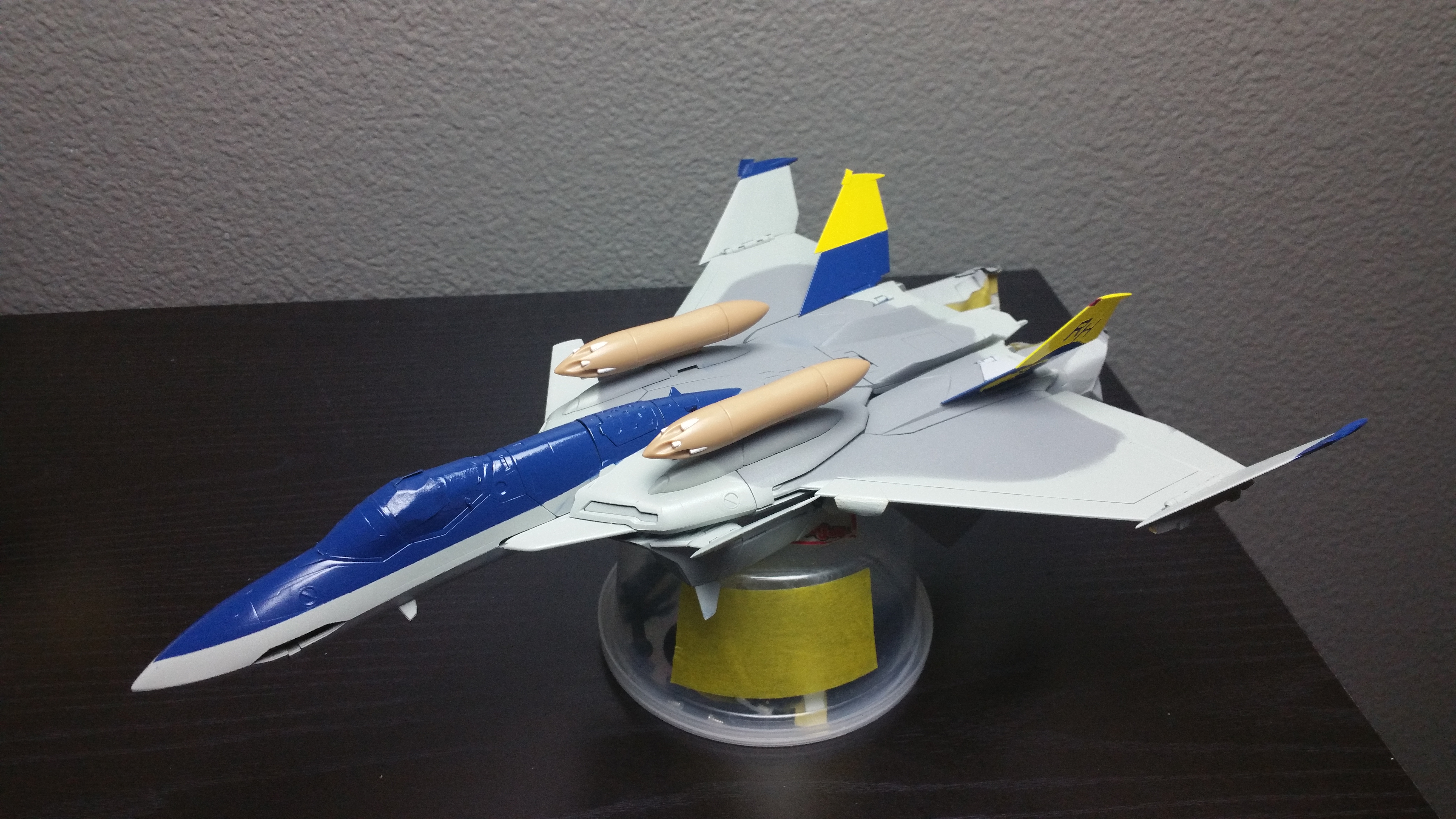

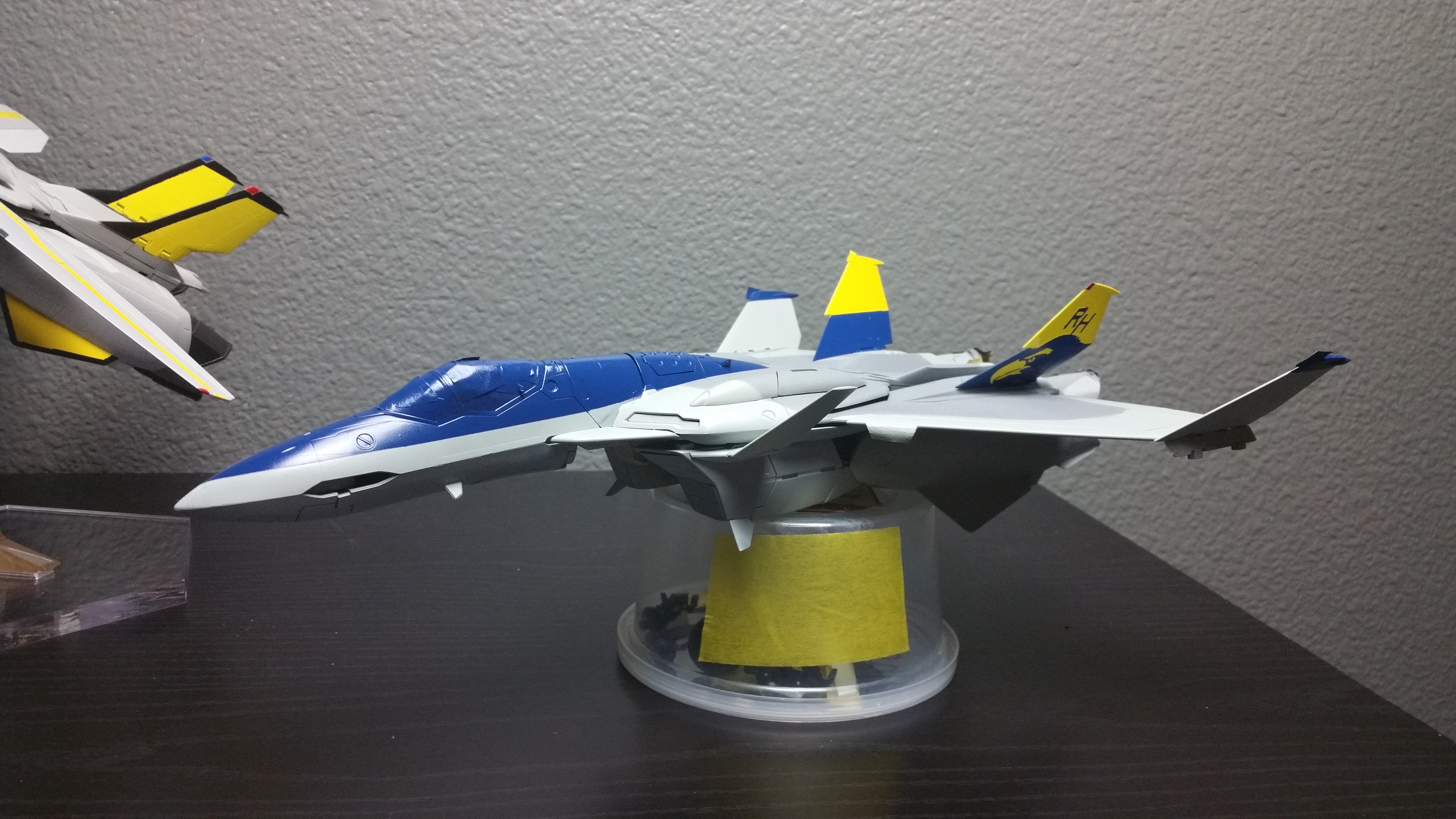

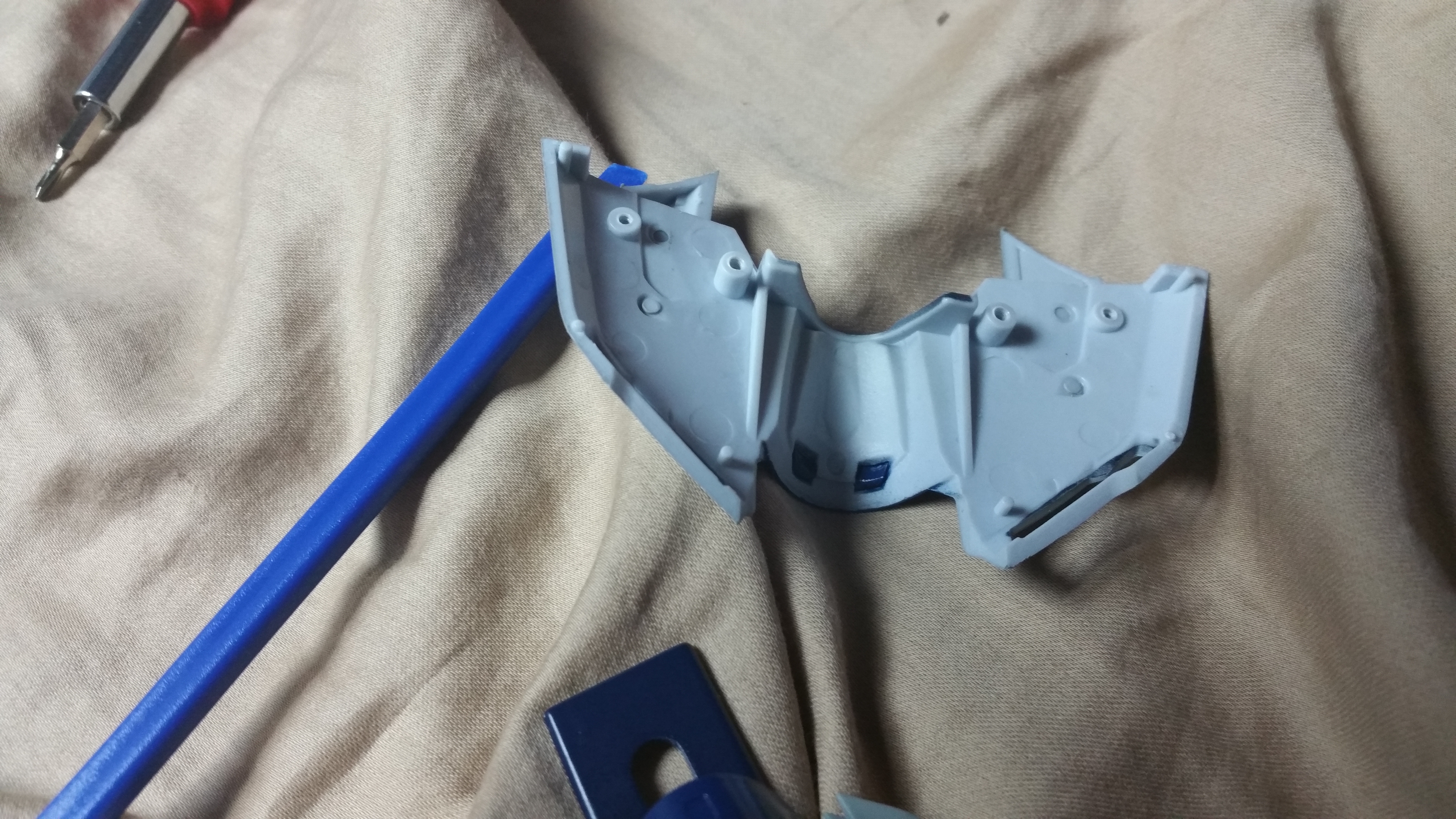

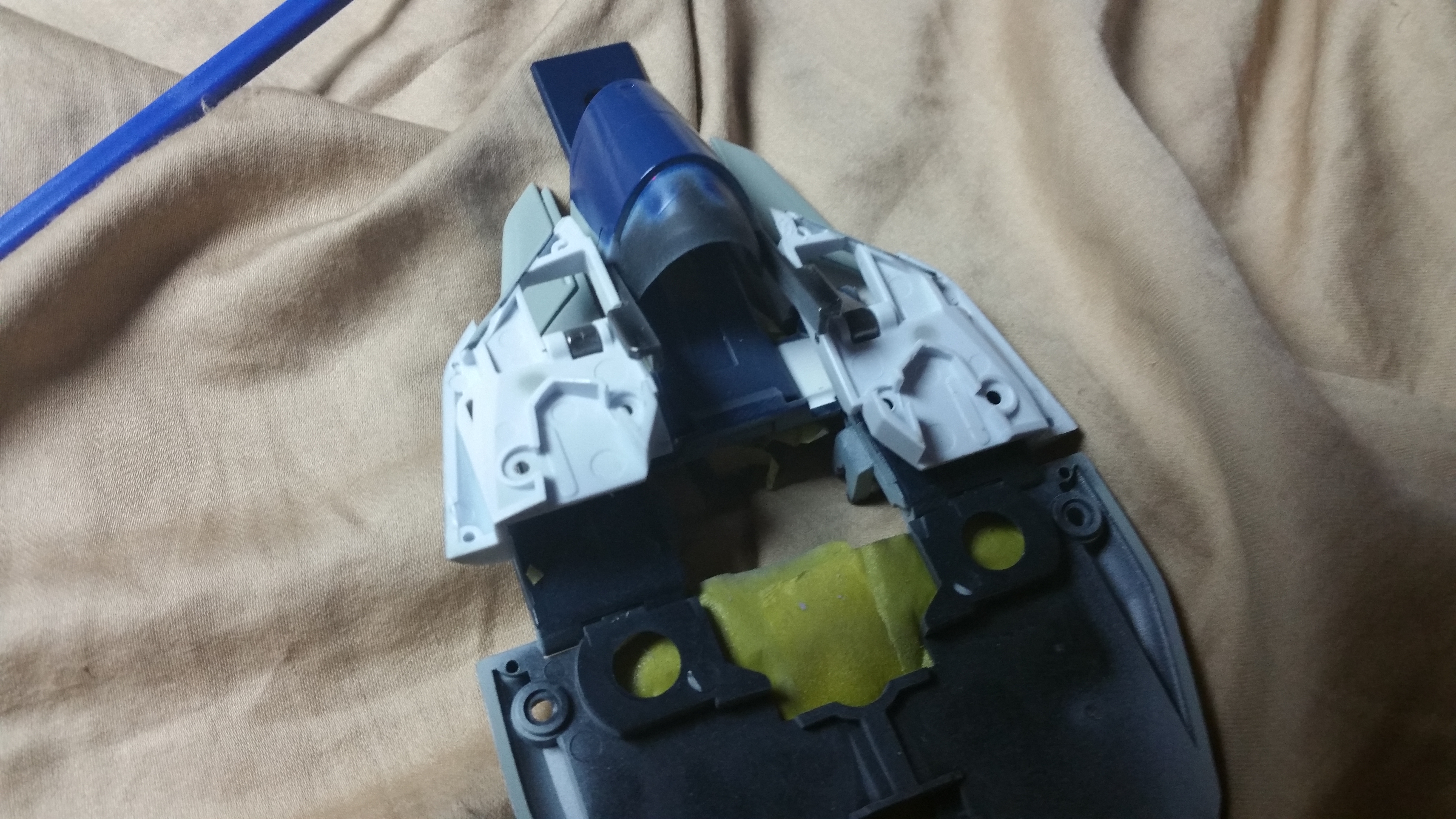

wmkjr Posted March 17, 2017 Author Posted March 17, 2017 Finished the other tailfin. I also extended the blue at the nose as i found out that it was too short. Here are some pics of it mocked up with the missile pods and canards. I've run into a mistake on my part. I swapped the upper chest covers thinking that was all that's needed but it appears that I now need to swap the bottom part of it out as the 0D has an indent for the canards and it's on the 0B right now. At first i thought I couldn't get to that part as there are 4 small screws (1 smaller one than the other for the outer hole) holding it together and after taking out the screws it was clamped together pretty tight. I used my spudger set to gently pry it apart. Here is the top half of the upper chest piece with the 4 screw holes: Here is the bottom half that I need to swap out under the white area. I just need to take out the pins that's holding it, take apart the 0B a little, then swap them out. That's it for now.
