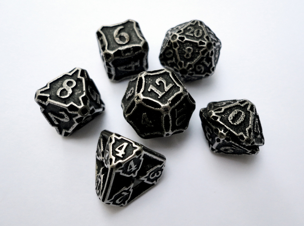

Dax415 Posted February 20, 2017 Posted February 20, 2017 (edited) Hi guys, I would really like to learn how to 3D print but don't know where to start. I'm hoping those of you more knowledgeable/experienced can help get me started and avoid any unnecessary pitfalls. As a first project I would like to make some custom dice. I know the style I want (see pic below), mine will have a wolf head and different styled numbers on a 6 sided die, I like the raised number effect with the color underneath, but don't know how to make it happen. Help appreciated! Thanks! Edited February 20, 2017 by Dax415 Quote
MILKAUTICO Posted February 20, 2017 Posted February 20, 2017 https://www.instructables.com/class/3D-Printing-Class/ Check this link, Quote
Xigfrid Posted February 20, 2017 Posted February 20, 2017 This is not really hard. I can explain a few steps in detail: 1) make the general geometry of the dice, 6-side dice would be a cube, pretty easy with any 3D cad software. 2) draw / write the letters and wolf head on a surface, raise the letter and the head with the cad tool called "push/pull". Then copy paste them on each face of the cube dice. 3) make a few "push/pull" to create the contouring of each number. 4) upload it to a 3D printing service that can print in laser sintering metal (Shaepways equivalent would be "steel"), order one. 5) darken the steel dice with , which ever method you prefer: search google for "steel darkening method" 6) with a sand paper, clean the extruding numbers and geomtries. done Quote
