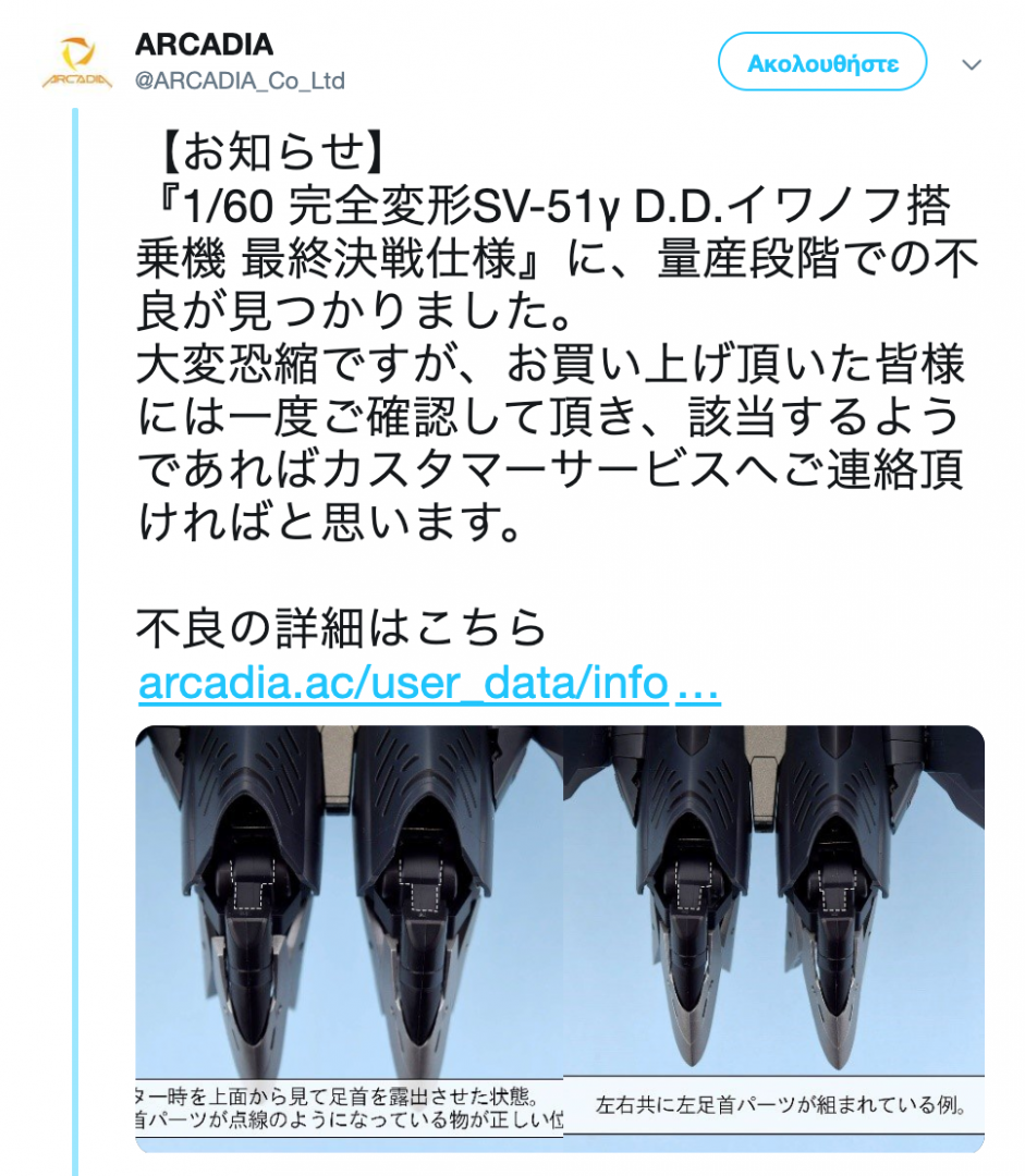

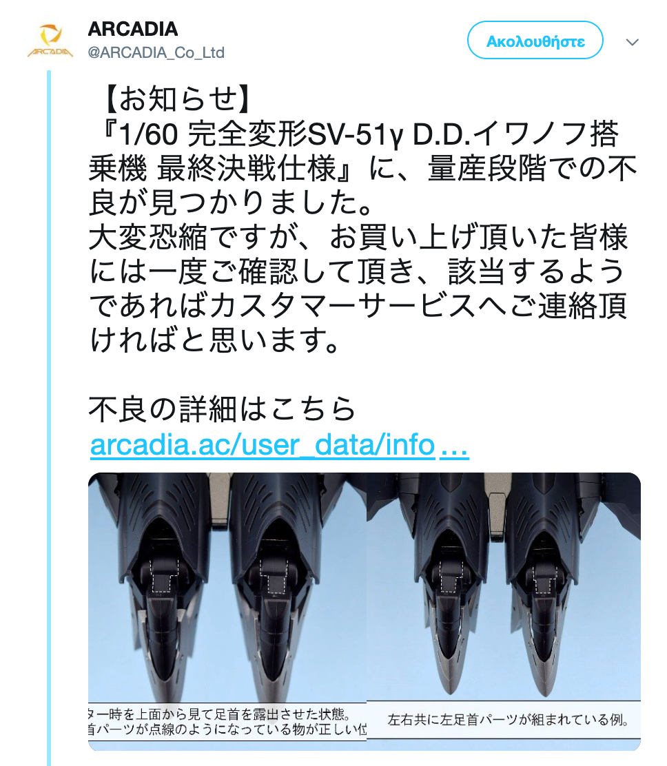

moose Posted September 12, 2019 Posted September 12, 2019 So Arcadia is has taken to Twitter to address this misasembled foot thing. Not sure what it say as the correction they are proposing to do How many of these defects are showing up. Is it alot or here and there. I bought this from hlj and it's in my warehouse and now I want them to check it before they send it. Quote

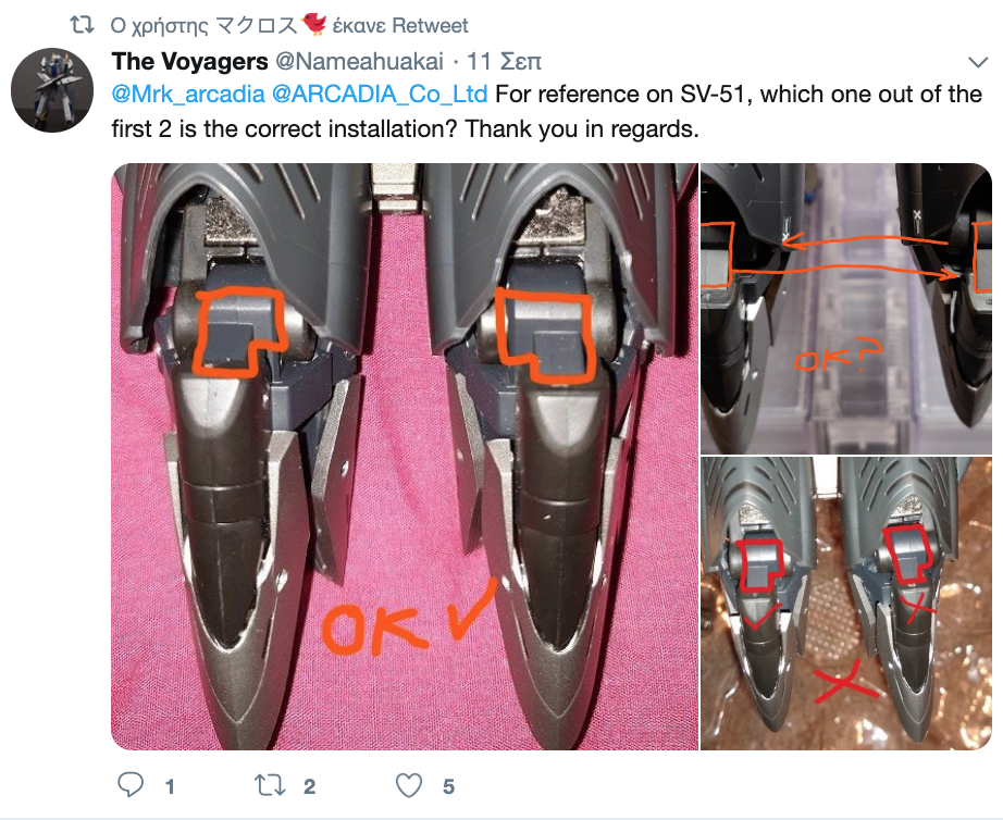

ArchieNov Posted September 12, 2019 Posted September 12, 2019 On 9/11/2019 at 11:18 PM, anubis20 said: @ArchieNov can you take a pic of these parts since you have a good one. We are trying to figure out if they are also supposed to be facing the same way or if there should also be a left and right for these parts. Thanks!! @anubis20 Sorry late reply. Didn't see your post earlier. But yeah, I checked mine and those parts are facing the same way. Quote

anubis20 Posted September 12, 2019 Posted September 12, 2019 47 minutes ago, Jarrod said: I wonder if that's where all the confusion is coming from? Since the upper ankle joints are the same, perhaps the workers did not understand the foot was different? Yea basically that ankle piece would be the only difference and at a quick glance they all look the same. Quote
valhary Posted September 12, 2019 Posted September 12, 2019 https://arcadia.ac/user_data/info20190912.php Quote

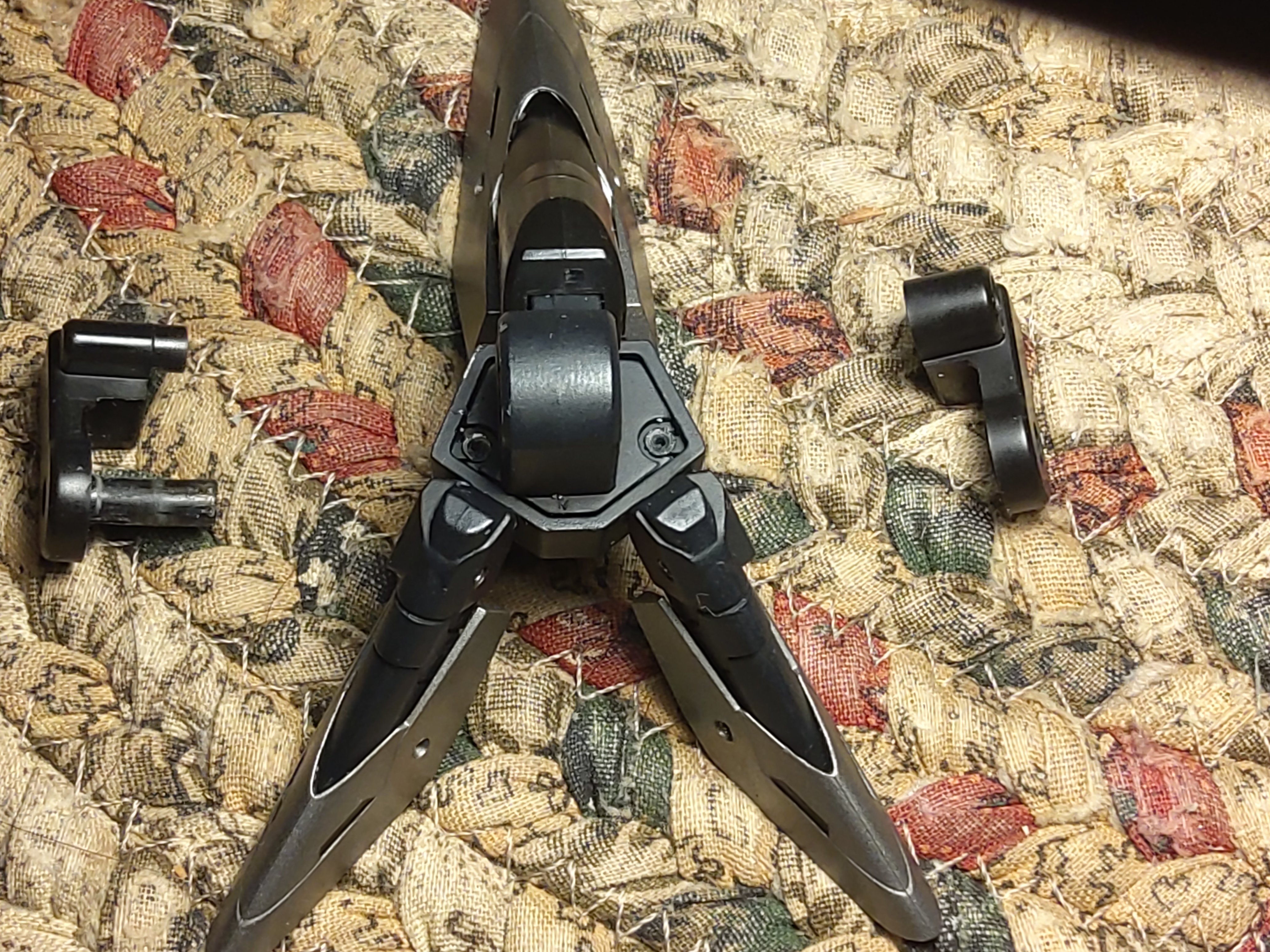

Jaustin89 Posted September 13, 2019 Posted September 13, 2019 (edited) I just pulled mine apart and this isn't a 3D printable fix; the whole foot assembly below the ankle needs to be replaced. The ankle itself may be wrong but isn't the issue as it's effectively symmetrical. Edited September 13, 2019 by Jaustin89 Quote
Slave IV Posted September 13, 2019 Posted September 13, 2019 4 minutes ago, Jaustin89 said: I just pulled mine apart and this isn't a 3D printable fix; the whole foot assembly below the ankle needs to be replaced. The ankle itself may be wrong but isn't the issue. So what is the issue? That offset part that the ankle attaches to? Quote

Jaustin89 Posted September 13, 2019 Posted September 13, 2019 (edited) 18 minutes ago, Slave IV said: So what is the issue? That offset part that the ankle attaches to? Yup; and it's a single piece that's central to whole foot with everything attaching to it being either pin joints or glued and riveted on. There's no way truly fix it short of a replacement foot or a ton of work rebuilding the whole assembly. The piece that would need to be replaced is also metal so a printed plastic replacement would likely wear out fairly quickly at best since they seem to only use metal in high stress parts. Shaving down one side of the ankle like a previous poster showed will get you a bit more clearance within the leg to have it fit a little better but I can't imagine it'll make all that much of a difference when the foot has that kind of offset built into it. Edited September 13, 2019 by Jaustin89 Quote
