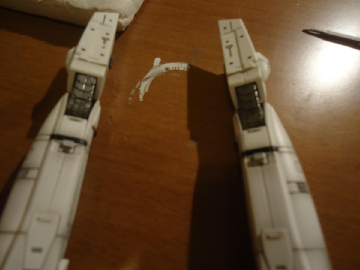

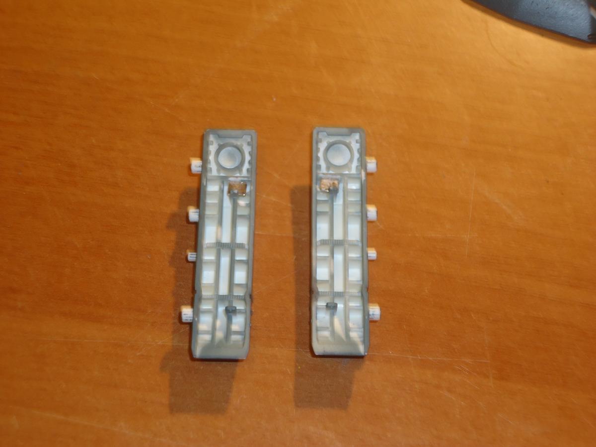

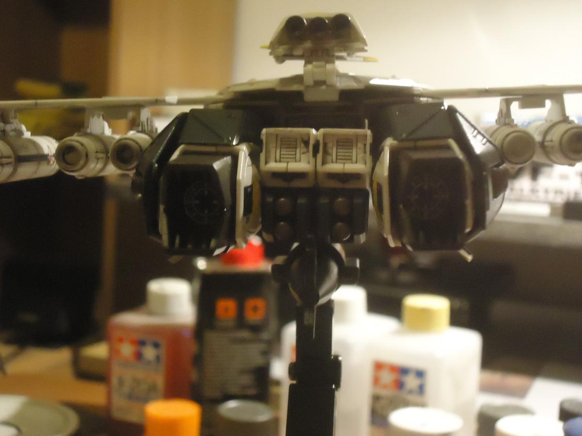

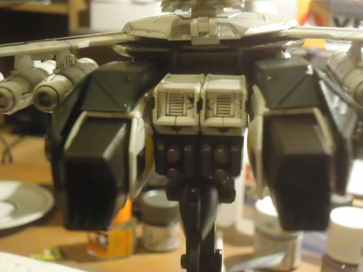

Fixed canopy and the small magnets modification. I used 2 different magnets size 3mmx2mmx1mm and 4mmx3mmx1mm. It was an easy fix, i just glued with super glue the magnets to the legs and armour, then i dug some space on the legs armor parts for 4x3 magnets to connect to the legs 3x2 magnets.
