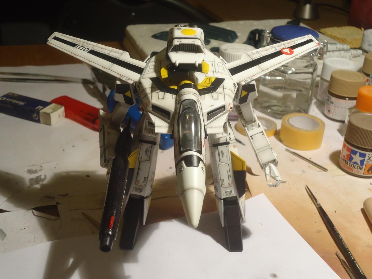

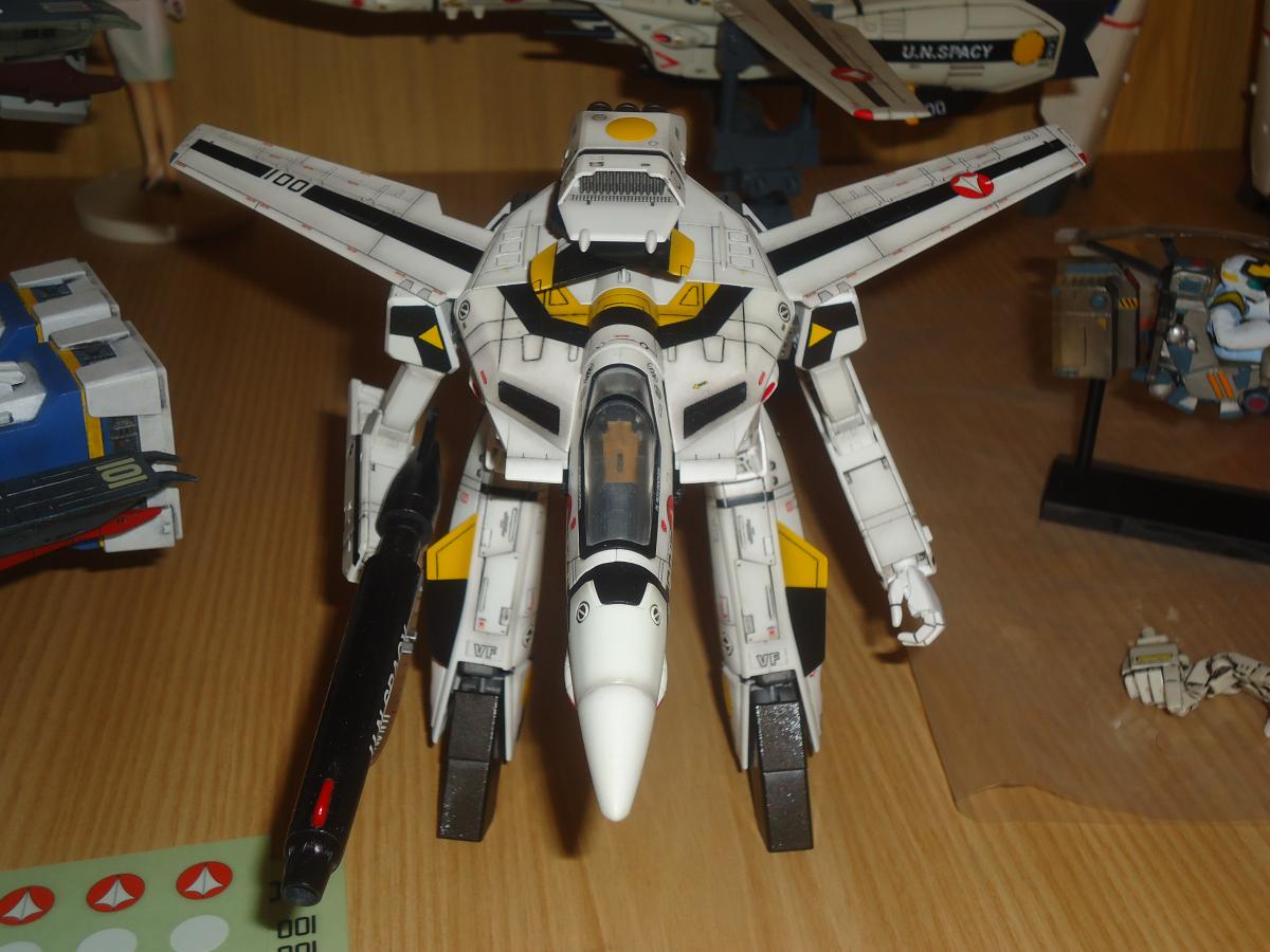

Gatsu Posted June 6, 2016 Posted June 6, 2016 Guys, is there somebody who has a bandai 1/72 vf1 model kit to trow away? I'd need a canopy glass for my vf1, and a truster of the fast packs, unluchily... Completed mine, but the canopy is ruined and a thruster is missing, dont know why, maybe it fell off or it was missing in the runner This is my work, as you can see the glass is matted. Quote

pengbuzz Posted June 7, 2016 Posted June 7, 2016 (edited) I usually polish my canopies, maybe I can be of assistance here. If the canopy is matted due to overspray from clearcoat or sanding, here's what to do: 1) clean the canopy with rubbing alcohol (90 percent Isopropyl alcohol works best). See if that removes the clouding. If not, proceed to thenenxt step: 2) polish with #0000 grade steel wool 3) polish with toothpaste (sounds silly, but it works, no particular brand is needed) 4) polish with facial tissue 5) Dip canopy in Pledge floor wax with Future finish. This should make tha canopy CRYSTAL CLEAR. Hope this helps! -PB Edited June 7, 2016 by pengbuzz Quote
Gatsu Posted June 8, 2016 Author Posted June 8, 2016 Hi. I noticed now that i should have posted this topic in the wanted section... anyway.. Thanks for the suggestion (facial tissue??) in fact this is what happened: i uised the masking film to paint the black staff in the canopy glass but when i removed the film i noticed that it had left some glue on the plastic... nothing worked, i tried alcohol to clean it but nothing. I had the terrihble idea of using a bit of nitro thinking the nitro required some time to corrode the plastic. Instead the nitro corroded it in 1 second, So i used the ultra fine abrasive paper to smooth the surface and then i spraied clear gloss. This is the best result i was able to achieve, the glass was totally matte before the treatment i did. Quote
pengbuzz Posted June 8, 2016 Posted June 8, 2016 Okay, thanks for the explanation on that Gatsu. The cockpit is still salvageable: for the future though, NEVER use clear gloss on it. It'll craze and fuzz the canopy. How to save it: 1) wet-sand the canopy with 6000 grit sanding film 2) wet-sand with 12000 grit sanding film 3) polish the canopy with #0000 steel wool 4) polish the canopy with toothpaste 5) polish the canopy with kleenix 6) 5) Dip canopy in Pledge floor wax with Future finish. I've used this process on "unsalvageable" canopies, and even when molding my own and removing distortions from them. I hope this is of some help to you. BTW: let me know if you cannot salvage it, i may be able to help. Quote
