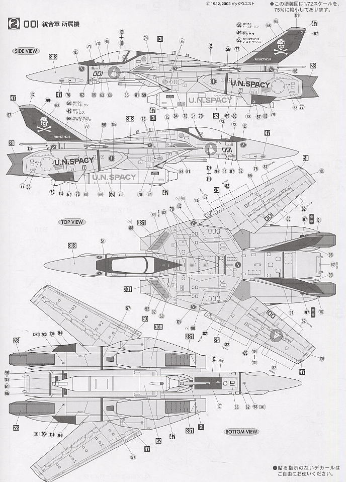

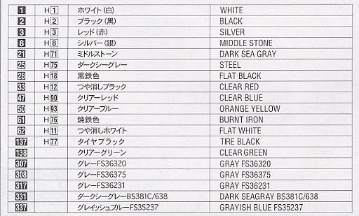

I was going to do a VT in low vis vis colours but have decided to do my VF-1D instead in these colours, mainly because I'm pissed Hasegawa didnt do a 1/48 version of this in which case I would have done it in the orange and off-white scheme. Anyways I managed to get the paint scheme and colours from a very helpful website. I'll follow the old Hasegawa 1/72 low vis kit paint scheme:

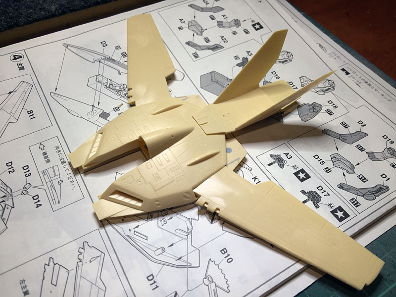

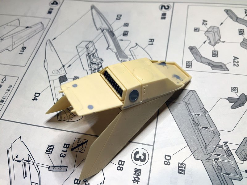

Finally made a start today on the VF1D. Main body done, plus wings. Tail section with additional etch fittings.

Thats my thoughts exactly. I was only going to load her up with AMM's (fighter to figter missiles?) but then thought maybe fighter to ship missiles might work better in the context of dual control like the F14's. Here is the colour call outs I fogot to post:

Thanks; these calllouts help!

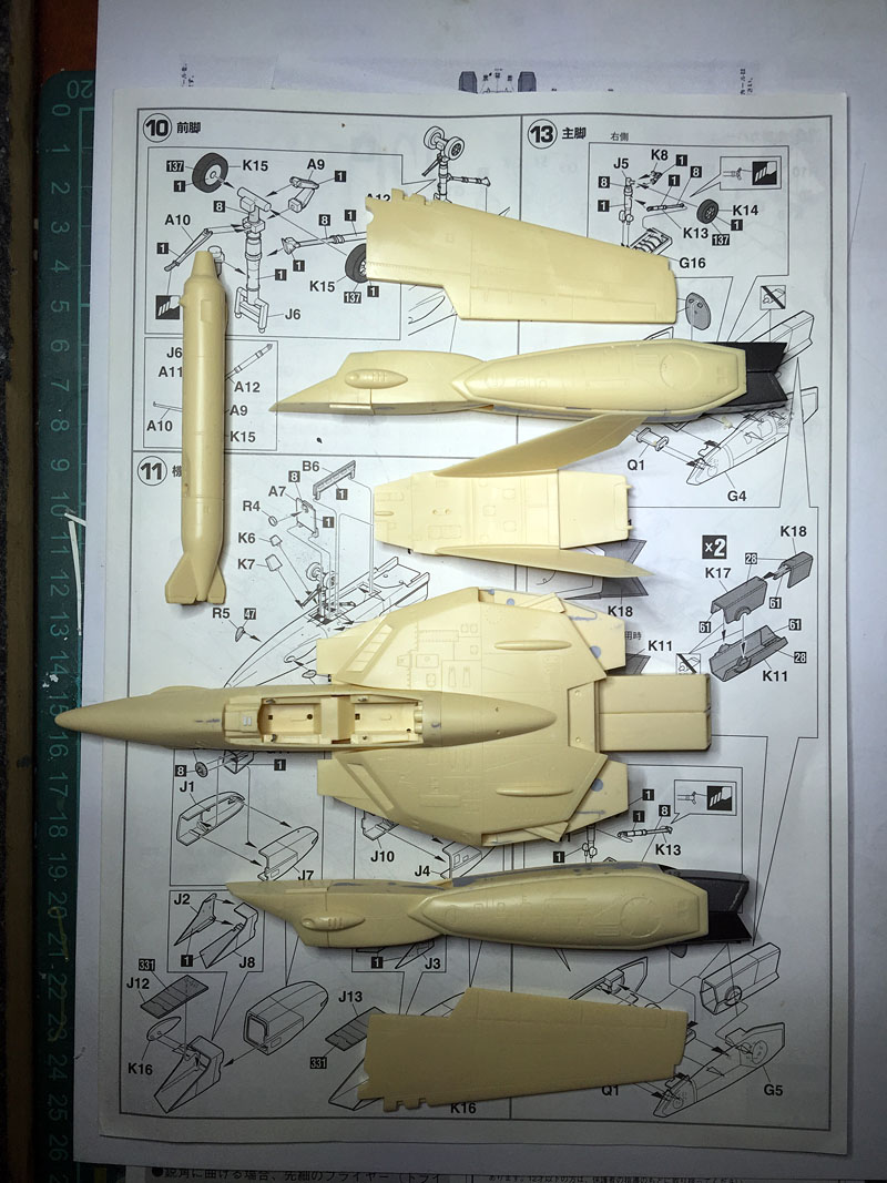

More progress shots. All parts are now ready to be primed and painted.

i noticed that you're going to paint them separately.. is this the way to build these Macross kits?
as i used to build normal aircraft, but i never paint them separately.
any issue when putting them together after painting?
i saw that most Macross build paint the parts separately, and got me curious before i attempt to build mine
Thanks :unsure:
Its easier to mask off the parts for some of the more fiddly panel lines and stripes. The gunpods are usually a different colour from the rest of the plane as well

I would normally paint my aircraft in the same way as you mention but with the VF's because the arms and legs etc are separate and articulated on the (supposed) real thing, when fitted to the main body there are gaps, sizeable gaps that would be hard to get paint into so I leave them off. The trick is to mask those areas you need to apply paint to or scrap the paint off so the glue can penetrate to the plastic.

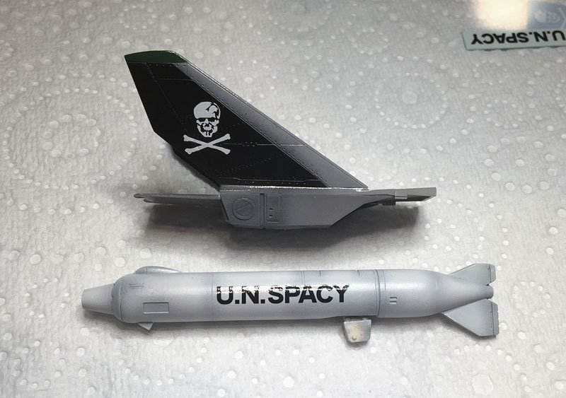

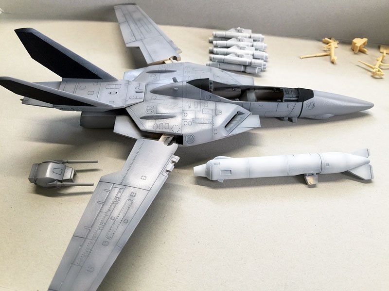

Quick update. Base colour done. Anti glare and vertical stabilisers done. I've decided to do Green Skull colours on this but they'll be restricted to the very tops of the vertical stabilisers and the forward part of the stabiliser fins on the legs. I've also painted the gun pod and AAM-1 missiles in white with a few drops of H338 to take the 'white' out of it.
Edited by Mintox
That looks excellent! I wasn't sure what to think of the white gun pod when I saw it in the Hasegawa low viz kit instructions, but I like how yours looks. Can't wait to see it finished!
I'm with you on this one. I stood there at my workbench in two minds and thought if it doenst look good I'll just spray it another colour. As it turns out I think it'll work in white, especially once the decals go on and its dirtied up a bit.

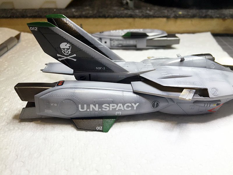

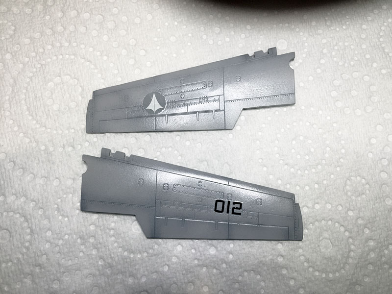

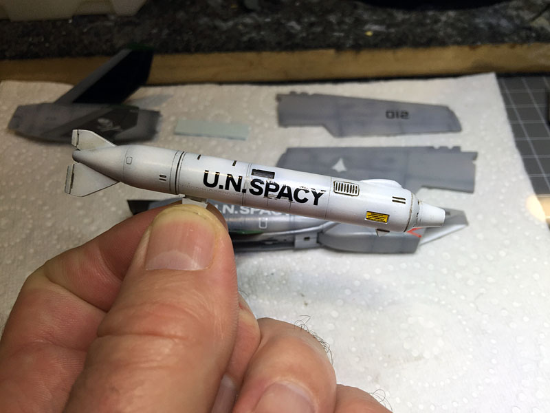

Starting the decaling now. The gun in white with the black letters for some reason reminds me of the UN vehicles and with their white and black markings.
Edited by Mintox
Im liking the white GU-11 gun even more as I start the weathering process on it.
Edited by Mintox
I was not sold on the White gunpod [think of the poor grease-monkey who has to clean that fighter!!]... dat weathering tho...,
Looks pretty sweet Mintox!
Love the green trim on your VF, that GU-11 is superb!

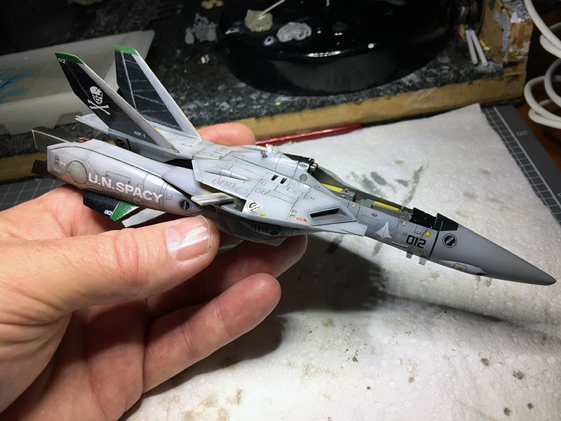

More progress shots. Finished all of the pin washes. I've got a few small items to paint like the wheels and pin wash the AAM-1 missiles and then its onto some weathering with pastels and then its done.
That looks fantastic! I really like the look of the D, I think because it reminds me of the 2-seat F-14. I really like how this scheme looks on the D. I hope I can start working on one here shortly. The scheme I want to do will be similar in color, but a different pattern.

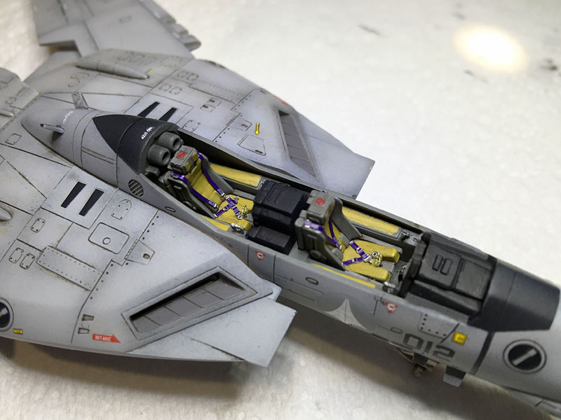

Detailing the cockpit. I've added some seat straps and ejection pull chord otherwise the cockpit is pretty stock.
