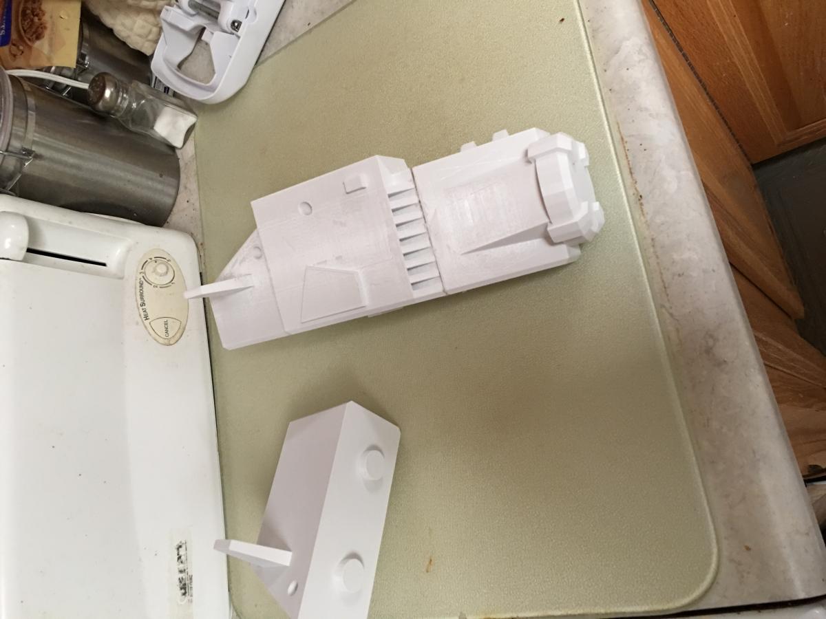

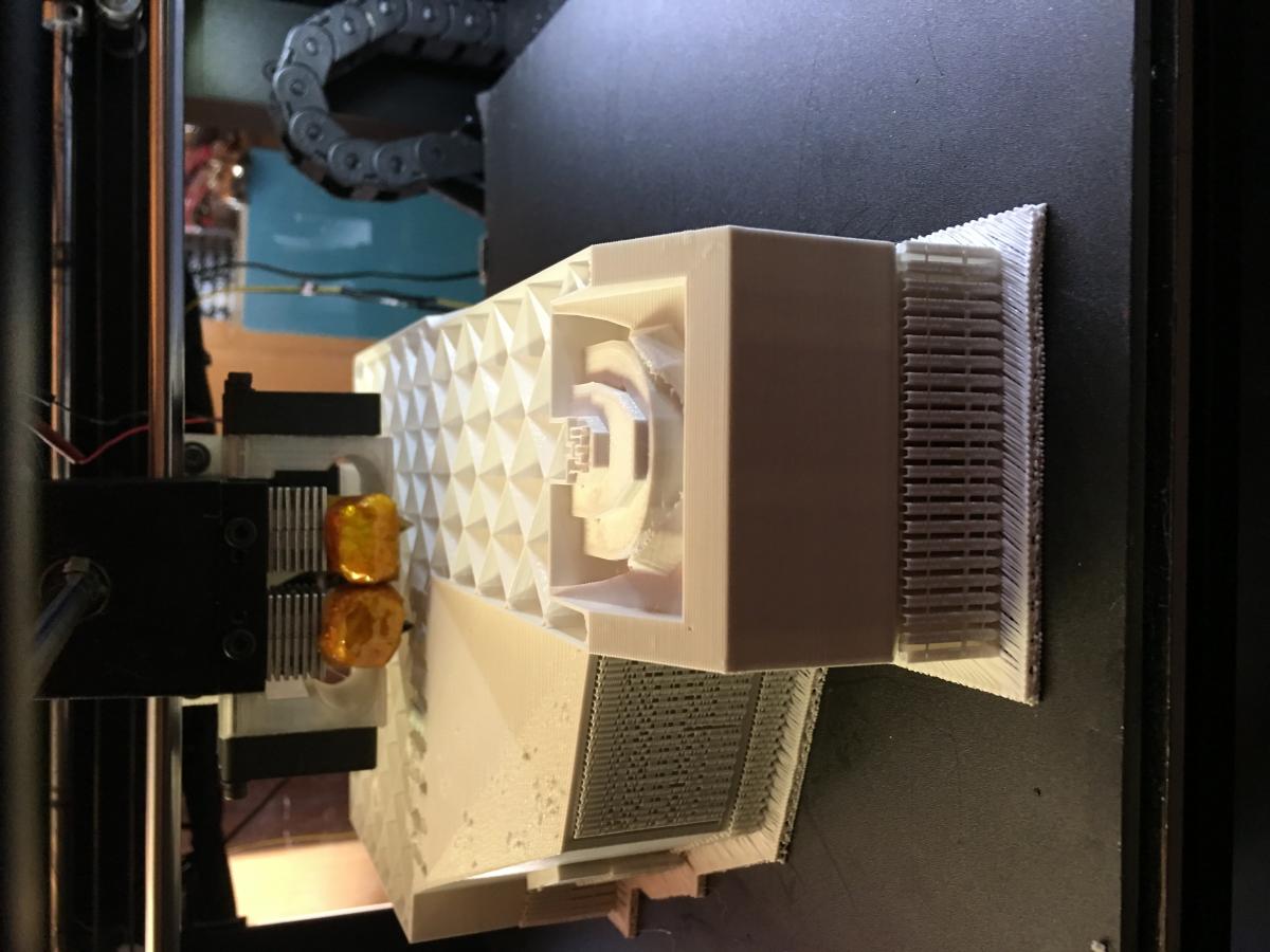

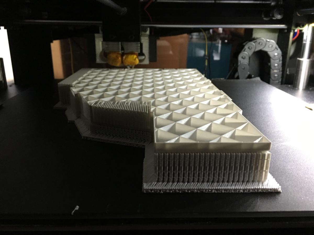

Firesped Posted May 19, 2016 Posted May 19, 2016 3D printing the SDF-1 Bridge in 1:285 scale. I didn't make the 3d model, but I did scale it to 1:285 and broke it into pieces to be printed on my raise3d N2 FDM printer. I did redesign the four large antenna that stick out to be replaced by rods. so there are insert holes in the model for that. so far I have printed out the back of the left side. I tried to print out the front part of the left side but I am having some issues. so I went ahead and started the right side. Here are some pictures showing various states of the print. I want to go in eventually and update the left side so it has all the inner layers of the bridge modeled out. There is a kickstarter I am backing for a new material called Polysmooth, that comes with a polysher device. They are going to make a transparent filament for this that will polish see through. Quote

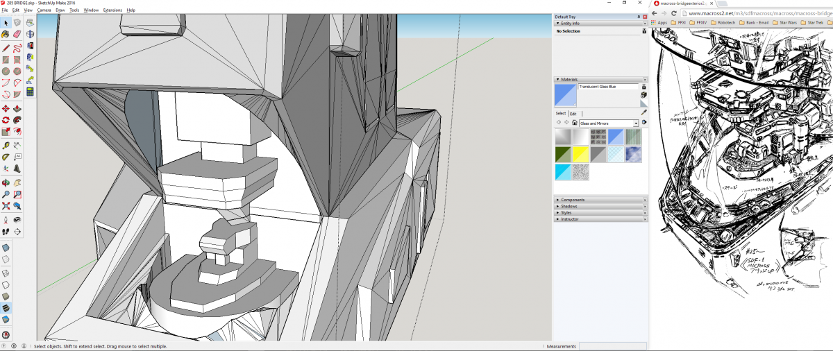

Firesped Posted May 21, 2016 Author Posted May 21, 2016 I just had to have a detailed bridge in this print! so I kinda added some simple facsimily of the internals. I'm breaking the front left part into 3 pieces. the lower section, the dome and the tower. I've finished my bridge details for how I want them and I have the dome and the lower part done. I still have to make the tower interface with the dome. I have the dome hidden in this screen shot. Quote

Firesped Posted May 22, 2016 Author Posted May 22, 2016 had to reprint the top and I cut back the part that printed before then glued them together. I should be able to print it without issue in the future, just need to fine tune some settings. I think because it is printing the top solid layers faster, they are not bridging well, so I need to add more top solid layers. Right now I am at the 20 hour mark on the left side bottom. here is an earlier photo as well. You can see the bridge details I added. I'm going to print the dome in ePC, a polycarbonate filament and see how it turns out. If it doesn't turn out well, I have a transparent blue filament. Quote

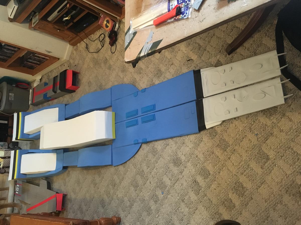

Firesped Posted May 23, 2016 Author Posted May 23, 2016 another member here is making mock up of the rest of the ship. This is to go with it. Quote
Felindar Posted May 25, 2016 Posted May 25, 2016 That would be me. I suppose I should just start my own thread. I just figured people deserve to see what it is going to be slapped on. Quote
