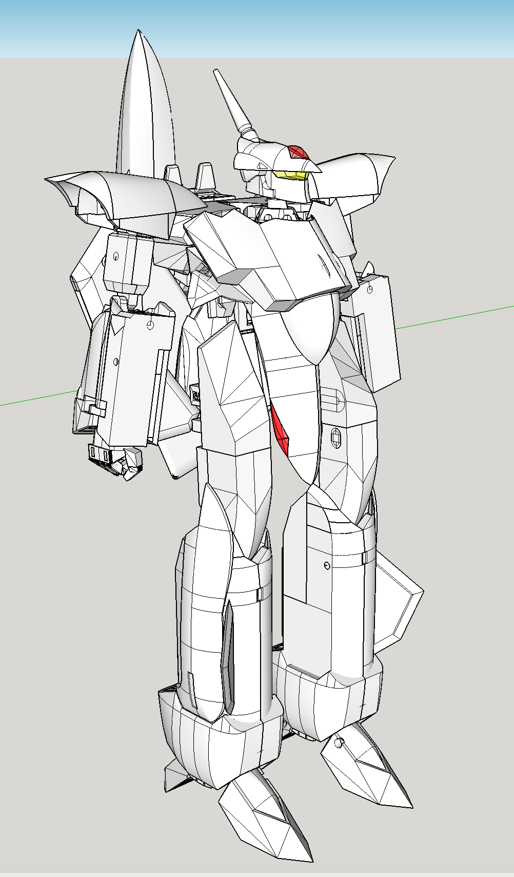

Kelsain Posted January 18, 2017 Posted January 18, 2017 (edited) The arm hole looks very similar to the VF-11. Admittedly, that's one of my big sticking points with that toy. However, it's also a pretty effective way to hold the gunned in fighter mode. What if you simplified the shape a bit. While the gun handle may flare out at the bottom in the line art, is it necessary on your version? If the handle is simpler, the shape of the cut-out can be simpler and may look less weird. Edited January 18, 2017 by Kelsain Quote
Tage Posted January 19, 2017 Author Posted January 19, 2017 Thanks guys, glad you like it. Had a bit of a think on the arm and gunpod, i think pegs are the way to go as the previous indent was actually pretty deep when i measured it. This way is a little more hidden. So marked in red is where the pegs will go, and i've created seperate handle parts that'll also peg into the gunpod itself. So there is a plane and then a robot arrangement for the gunpod. For the plane arrangement, these plugs will help hold those arm parts nice and together in the middle (you're only seeing half of the plane in that second picture). And i was thinking about creating a seperate handle part for the gunpod anyway that'll have a ready made hand holding it, as creating a fully (even semi) functioning hand that articulates is going to be a bit tough due to it's size. So! Apart from putting anything else like pegs in to keep things together while in each mode (which i'll do at the very end), mechanically speaking in the basic sense – he's complete! Everything else is now finesse. haha Onwards and (sorta) upwards! Quote

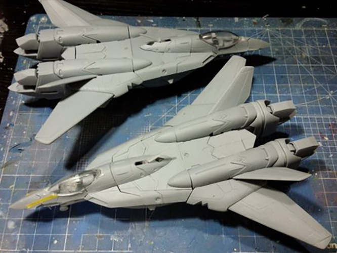

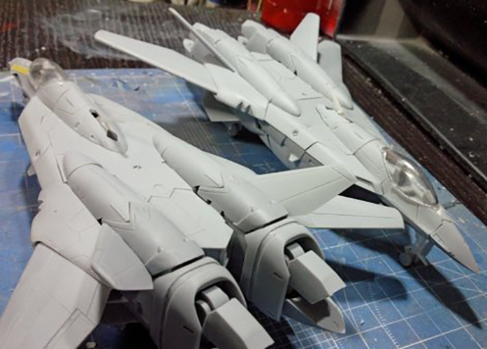

wmkjr Posted February 6, 2017 Posted February 6, 2017 3 hours ago, trojan_gambit said: Is this you, Tage ? https://mobile.twitter.com/expertenannex/status/827922728569053185 That's a GK maker that did harder to find valks in 1/100 scale. He made a 1/72 VF-5000 last year. Quote
Tage Posted February 6, 2017 Author Posted February 6, 2017 Yeah, sadly not me. Love Experten's work though. Good to see how his VF-5000 is looking. Particularly the leg fast packs... I'm currently just finishing them up myself. I was thinking of a way of still having them without cutting even more away of the wing parts... Otherwise there'd be a huge gap between the legs/engines and wings when the fast pack isn't on – keen for it to look smart and tidy with and without fast packs. Looks like he's just cut a slot out of the leg fast pack so the wing parts rests in there. Doesn't look too bad actually. I'll post up more of an update where i'm at once i'm happy with this leg fast pack :-) Quote

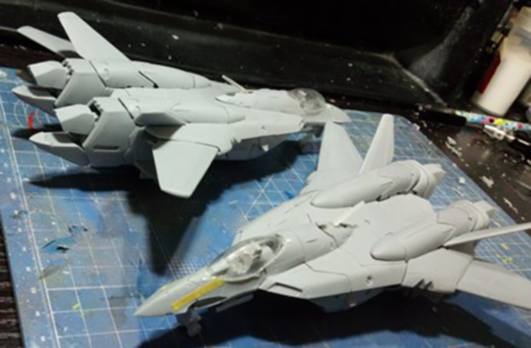

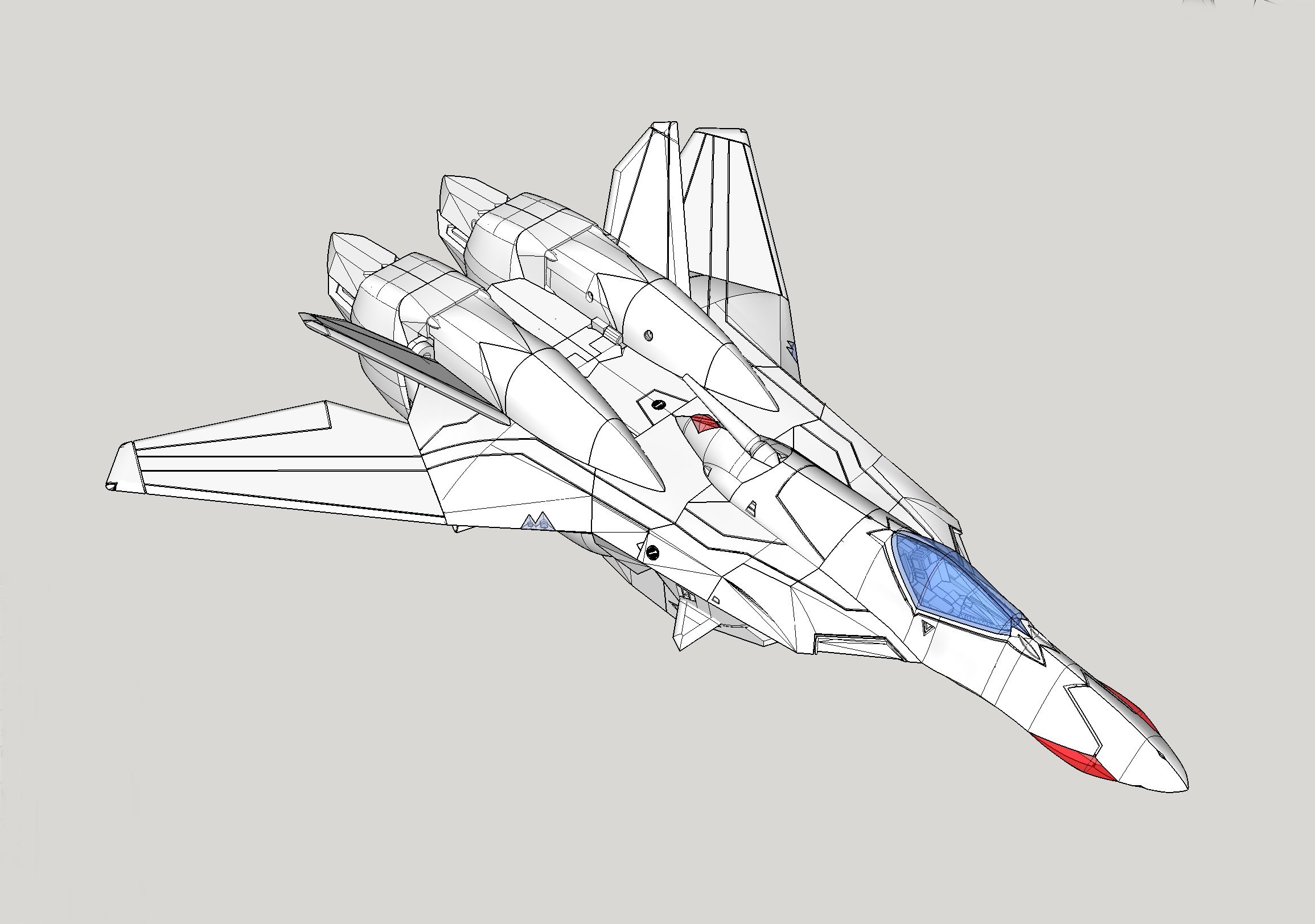

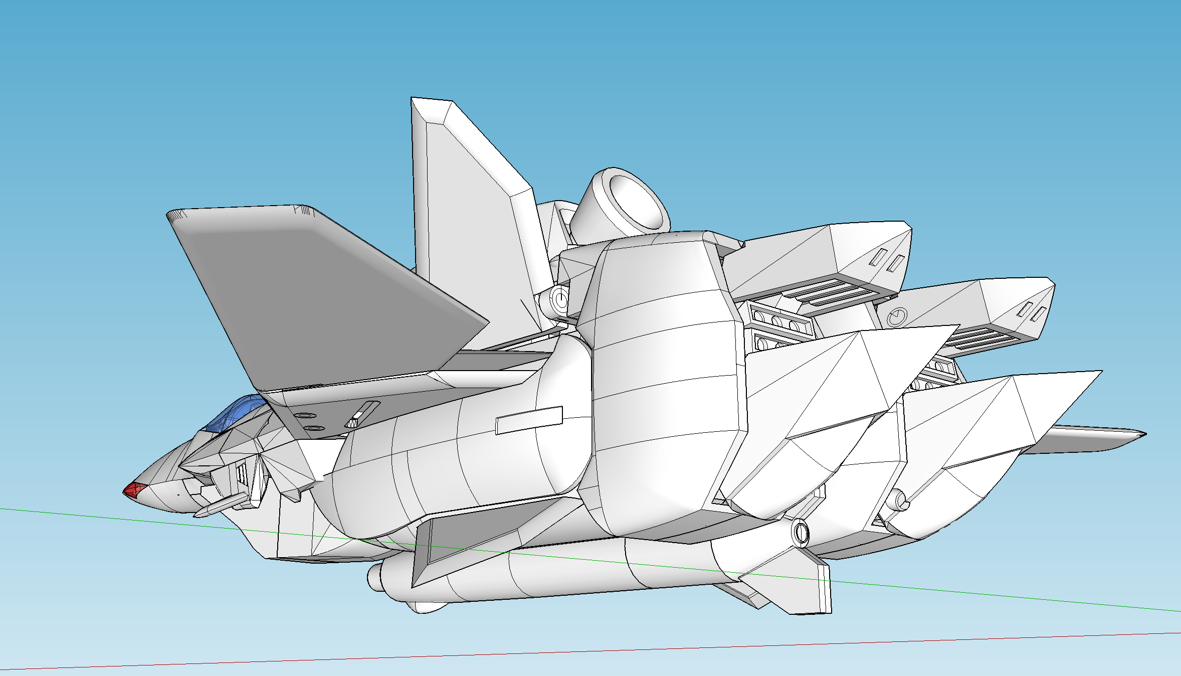

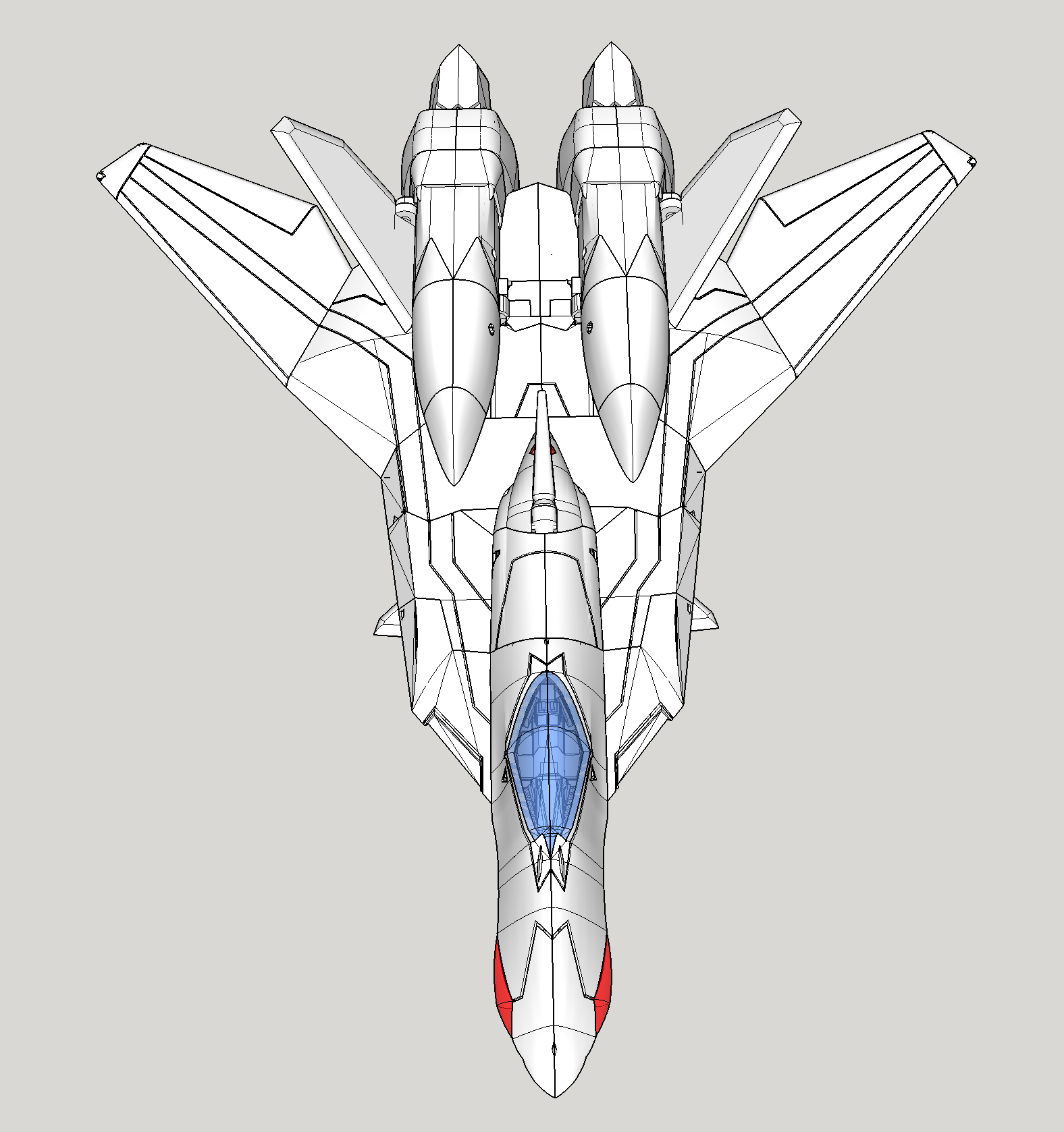

Tage Posted April 18, 2017 Author Posted April 18, 2017 Hey guys! Right! Update time! Sorry it's been a while. I've finally finished the leg fast pack! Had to cut away a bit of the top of it to allow room for the wing in fighter mode, but overall, i'm happy with the result. So next is detailing this thing with panel lines. I've had a look at comparing this model with the line art to make sure i'm as close as i can be, and look i'll be honest, it's not THE best rendition of a VF-5000. My guy has some chunky legs and arms compared to the line art. And a few squashed proportions here and there. But i'm actually pretty happy with my work on this, as i need to keep reminding myself that this is my first ever proper 3D project, and somethings aren't going to be 'perfect'. And really - to get me up to speed with using Sketch Up, and make this transforming valk thing possible, I have been just copying the SHE kit and essentially upscaling it, with a few little improvements here and there. So even looking at the SHE kit, it's not really accurate to the line art, but it's close enough I reckon. And at the end of the day, i still think it looks cool. And should look even cooler once printed. One thing i'd love your guys' advice on though is the head... is it there yet? Thanks for your continued interest in this rather epic project. cheers. Quote
valhary Posted April 19, 2017 Posted April 19, 2017 in general terms looks awesome!!!! the macross valks specifically are very difficult to make and at the same time look good in the 3 modes (anime magic) for that reason in the most of cases you have prioritize one mode over the others however I see well proportion in fighter and battroid only need to see the gerwalk mode but I like it!!! I cant wait to see printed this bird! and one more time thanks for have the courage to do this project very refreshing Quote

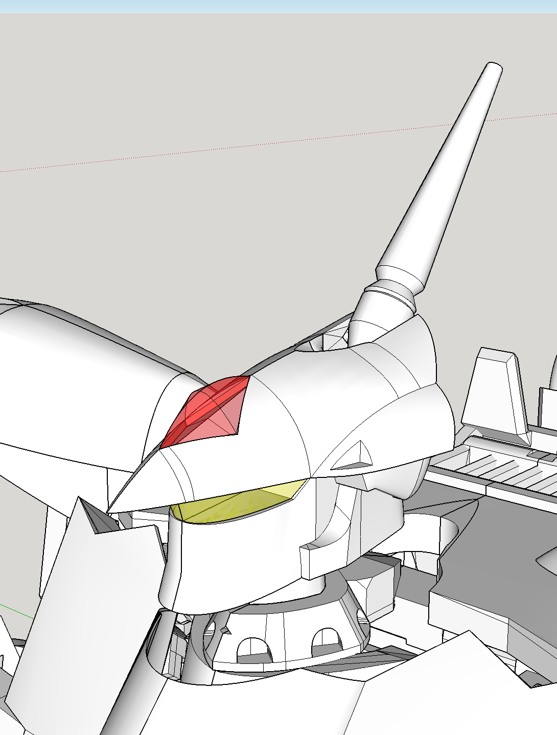

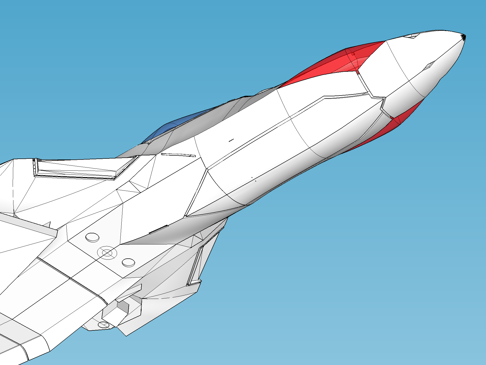

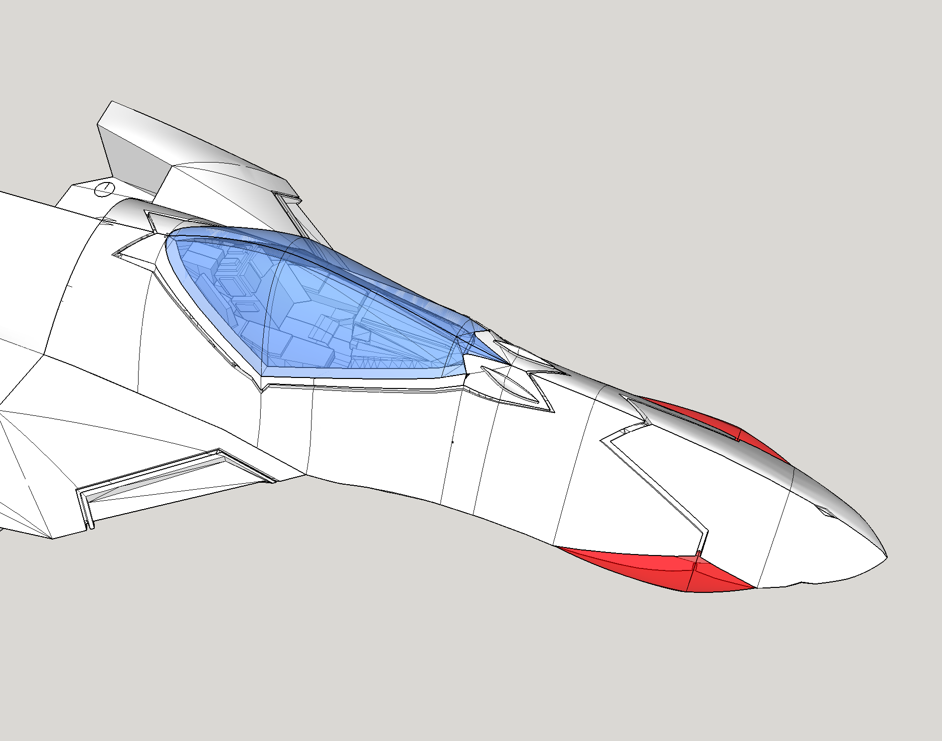

Tage Posted May 1, 2017 Author Posted May 1, 2017 Hello again! Back at it again - and hoping to keep up with weekly updates. This week I've been adding panel lines! I started on the hardest part, which was the nose and around the cockpit. Mainly to learn a few lessons which is now making doing the rest of the panel lines pretty quick and easy. I've printed off some of the line art and highlighting that as I go as a bit of a checklist so no panel lines get missed :-) The panel lines look deep and big at the moment in 3D, but i'm pretty sure they'll be fine once printed. Big shout out to Xigfrid for explaining the tech side of these panel lines in an old PM many moons ago haha. Cheers. Quote
Sildani Posted May 2, 2017 Posted May 2, 2017 Now the Star Mirage starts to come into its personality so to speak! Cheers! Quote

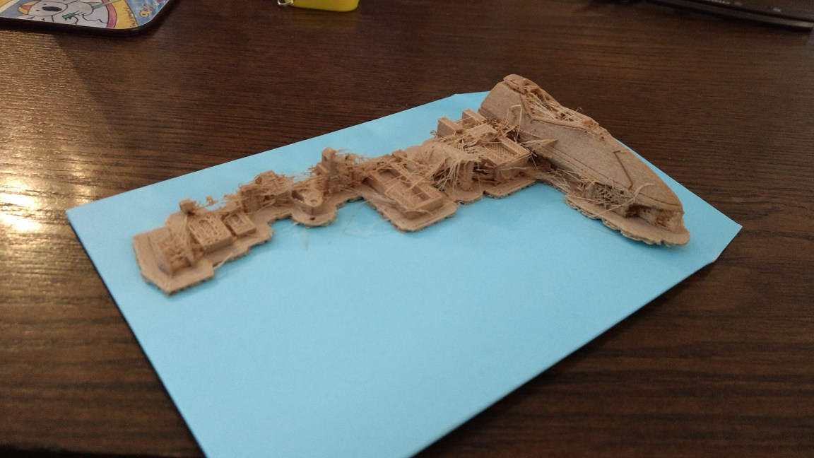

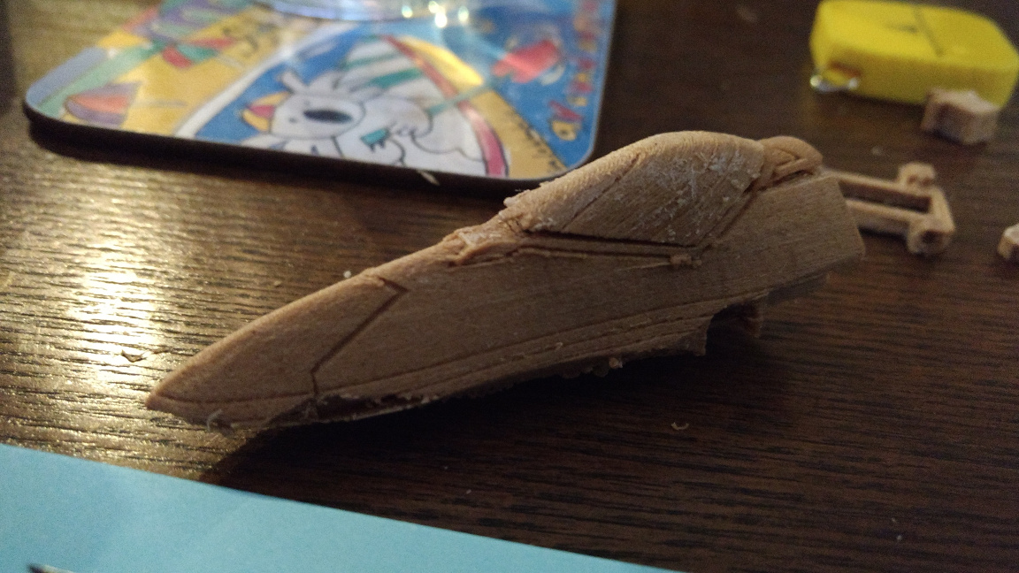

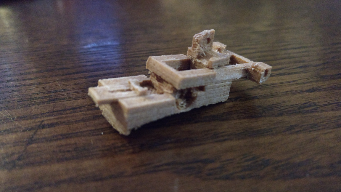

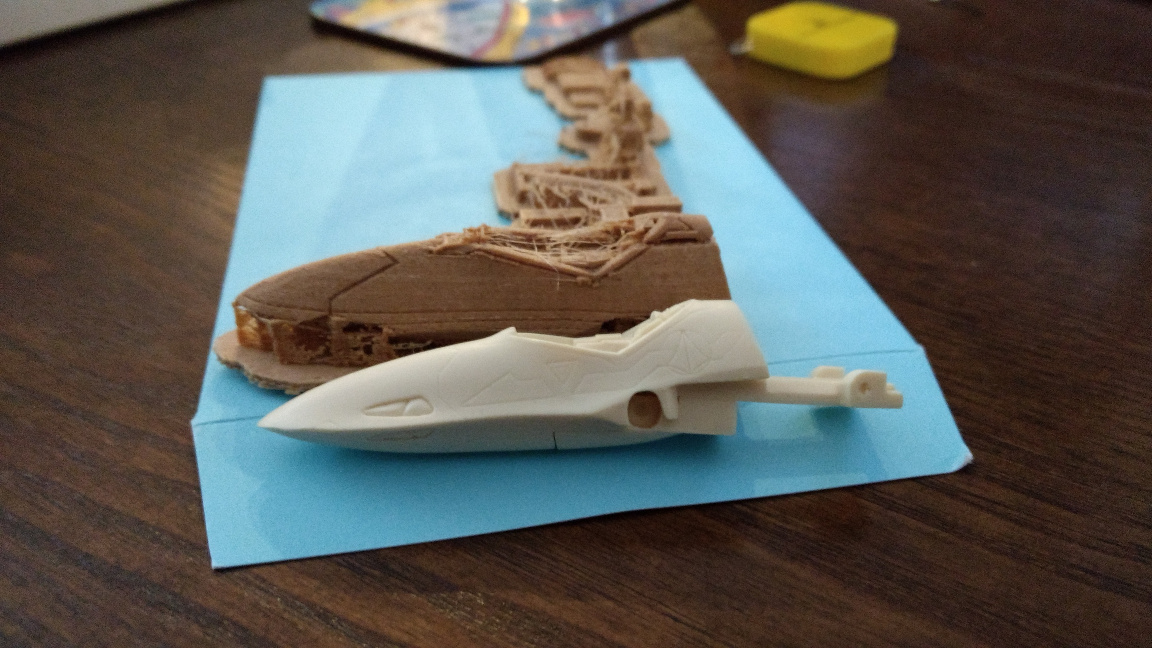

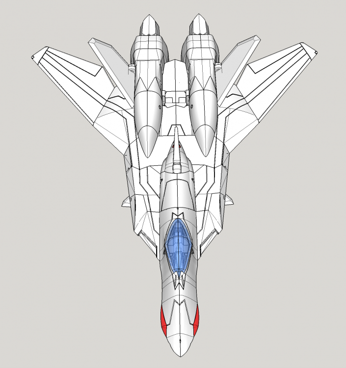

Tage Posted May 7, 2017 Author Posted May 7, 2017 Hey guys, update time! Just been doing more panel lining this week. Overall it's going well, the main time spent is actually repairing the mesh of the model the panel lines cut into, as some overlapping errors occur sometimes. But really liking how its is really coming to life. Also did a quick test print on my friend's 3D printer.... I think a few more tests are required as i don't think any of the pieces came out as good as i'd like. As you can see, I tried the nose and some internal parts for this test. My friend has a Makerbot Replicator 2 for those who know what that is. Used this wooden material he actually recommended as it's meant to be easier to clean up and sand. It also makes the whole thing look like a wafer once printed! It was easy to clean, but I think i'm going to have to do a few tricks like splitting sections in half.... This is because the support structures the printer builds up to support high objects (like you can sort of see for the nose) really eats into the detail i've worked so hard on, and is hard to clean off lol. Also, this material is weak as hell, which doesn't matter too much as i'm hoping to then cast these pieces in a stronger material, but it would be nice to make sure all the joints and every piece comes together before i do cast him. Plus i think i'd need to print each part at a time rather than his big chunk at a time like i did. But really, I'm looking into just going with Shapeways and using their stuff and go from there. But hey, it was a fun test anyway. Nice to start to see the size difference and how it's going to come together. Hope you like! Quote
valhary Posted May 7, 2017 Posted May 7, 2017 Very interesting by my side I have the mini makerbot that only allow PLA Ignorant the existence of wooden material by other side is so nice that you test all the parts before you make it available in shapeways I already bought some things in shapeways that actually not even works because never been tested Quote
Sildani Posted May 8, 2017 Posted May 8, 2017 The first tangible fruit of your labor, Tage! It looks like a spider spun a cobweb over a wooden carving, but it really looks like the nose has a good shape! Well done! Quote
Chronocidal Posted May 8, 2017 Posted May 8, 2017 The thing with Shapeways is that it's going to be a high quality print, but it's also too expensive to use for the prototype stage. You probably don't want to be ordering parts over and over from them as you ensure that things fit together, or it'll get really expensive really fast. That nose looks like a pretty good start though, even with the material as rough as it is. You'll probably want something a little sturdier and smoother for test-fitting parts though, if that's what you plan to do. What's the other plastic nose you have there, a resin kit? Quote
Tage Posted May 8, 2017 Author Posted May 8, 2017 Cheers dudes. Chronocidal - Yeah so the resin kit is the Studio Half Eye kit of the VF-5000 I've been trying to copy and make into a 1/60 to match the rest of my Macross collection essentially. And yeah i'm hoping if i do need to redo any parts it's going to be a minimal amount. Quote
Xigfrid Posted May 8, 2017 Posted May 8, 2017 I didn't know this use of the wood filament. Interesting. If you use shapeways, you will see a huge boost in quality of print for sure, just make sure to make best use of the print orientation. This nose should be printed vertically, not horizontally! Quote

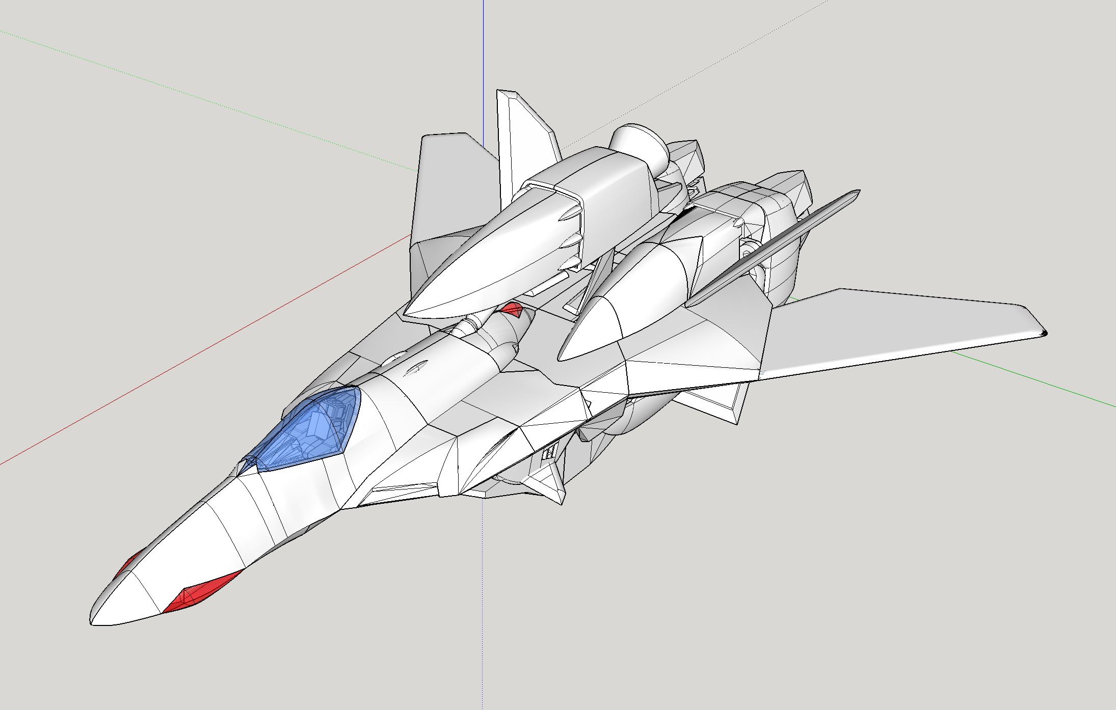

Tage Posted May 14, 2017 Author Posted May 14, 2017 Happy Sunday everyone! Not too much new to report. Just still going on details. Repairing the top tail fin after recessing the panel lines took the longest this week as there were just so many errors! Main exciting detail part i added was the little black circles that are on a lot of valks. Xigfrid - once it comes to printing SLS, the orientation of things don't really matter does it? Or will i still get a bit of stepping? Thanks dudes. Quote
Xigfrid Posted May 14, 2017 Posted May 14, 2017 Hey Tage, this is coming along nicely. The panel lines are really important because it is so hard to scribe them later, make sure to put too many than too few. Yeah sls is prone to very small steppings. These are not a problem on small surface but bigger flat surfaces like the wings or the fins would become a nightmare to sand if you don't make sure of the best orientation for printing. Quote
