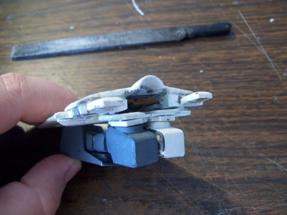

pengbuzz Posted June 9, 2016 Author Posted June 9, 2016 Okay, time for some recent pics everyone! First up: The shoulders were sticking out a little too much in fighter mode, but I didn't want to mess up the soldier mode either (although the shoulders kinda bugged me there too). The solution I found was to trim them down my a millimeter or two, change the angle on the outer slope slightly and glue in new plastic plates to cover where plastic had been taken out. It smooths the underside out a bit more and makes the shoulders stick out a bit less. Next up: I had to revert to the original system for retaining the legs to the body, but the plastic pegs holing the leg pegs to the chestplate kept snapping! First the originals let go, then every single replacement gave out. I finally solved it by making new pegs out of metal (coat hanger wire), bending them so they would go into the post that supported the leg, and angled up to their final position going into the chest. Yeah, the pic doesn't show it very well, but I really wasn't in the mood to photograph the wire. And yes, the intakes are a little bit of a mess. I'll fix that when structural stuff is finished and buttoned up. I also did some adjustments on the rear fuselage: I got the legs to sit a little higher up in comparison to the back fuselage and backpack/ tail. It was bugging me how low the legs were and how high the tailpack was riding. Overall, the kit is nearing the end of the "structural" stage; I don't think I can correct every single little thing on this (thought about lengthening the lower leg/ nacelle), nor do I want to keep trying to. Next up is the detail stage, where I start addressing the messy parts and file down some stufgf that was reworked. Stay tuned... Quote

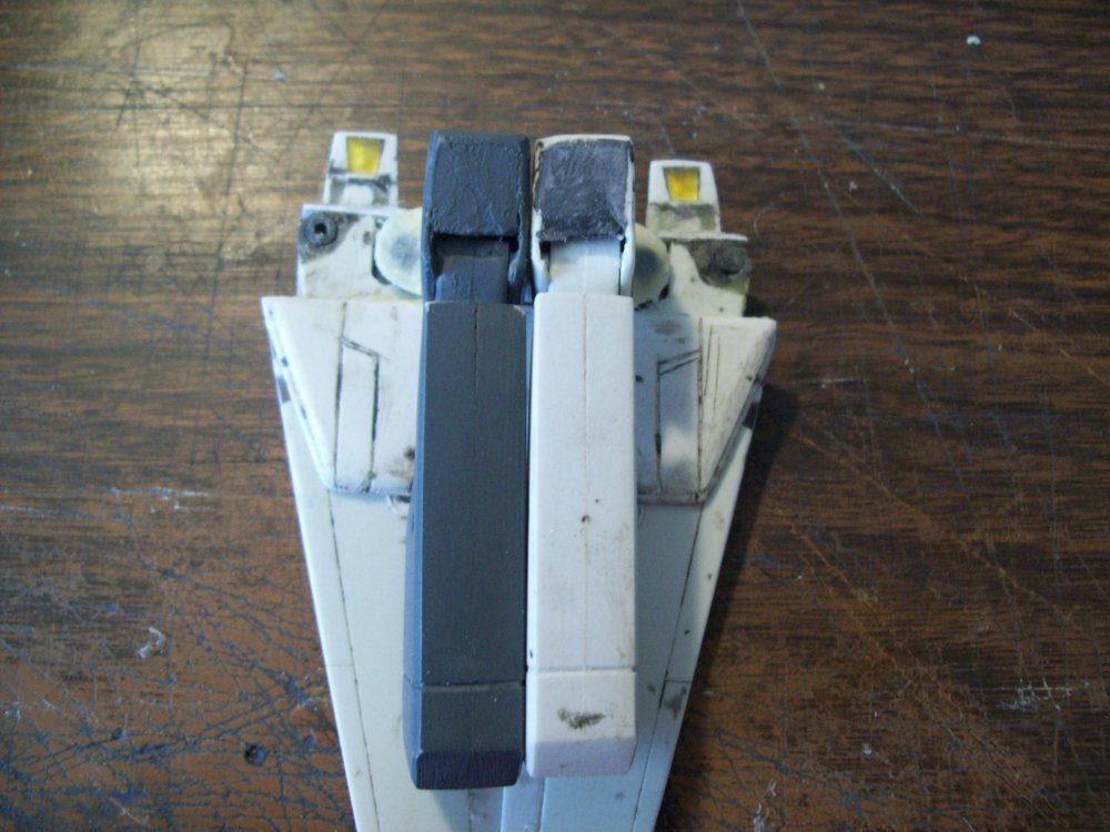

pengbuzz Posted January 17, 2017 Author Posted January 17, 2017 Okay folks; it's been a while (kidney stone, eye infection, had the kitchen sink thrown at me, etc...). Anyways, building the arm transform now. I tried JB Weld, but id just would not hold for me (cleaned the parts thoroughly/ degreased them, roughened them with sandpaper, made sure mix and temp were right and it didn't work.), so I went back to my old standby .Also, the upper shoulder/ lights section pretty much crumbled, so I totally rebuilt the shoulder area, and am reworking the transform for it. Once this is done, then it's just a matter of cleanup and assembly. Â Stay tuned folks... Â Â Quote

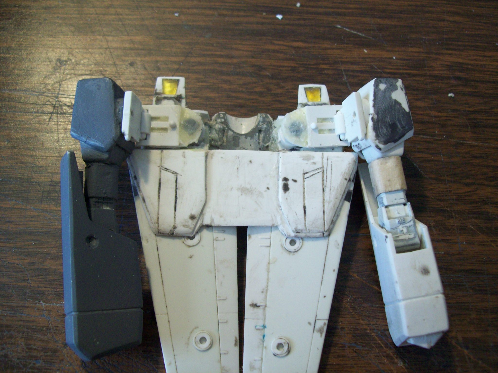

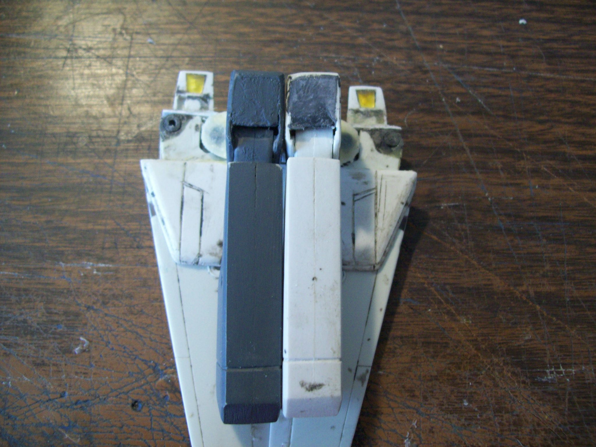

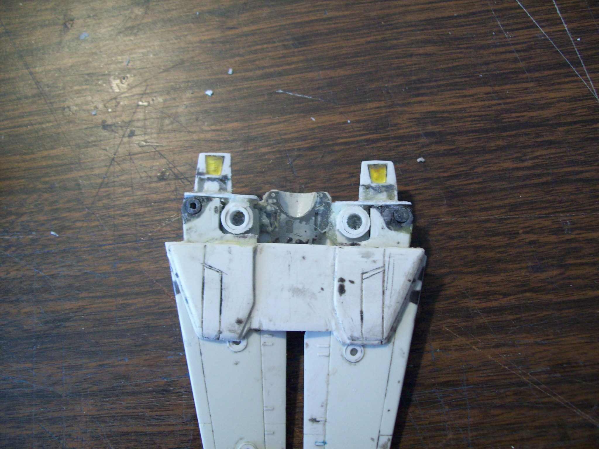

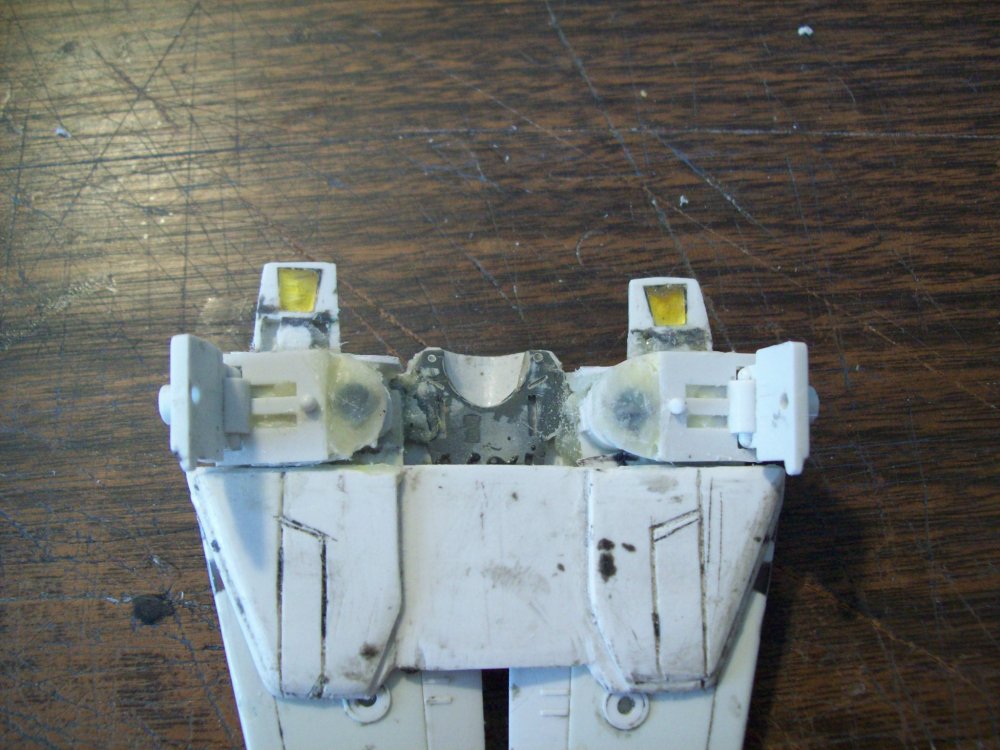

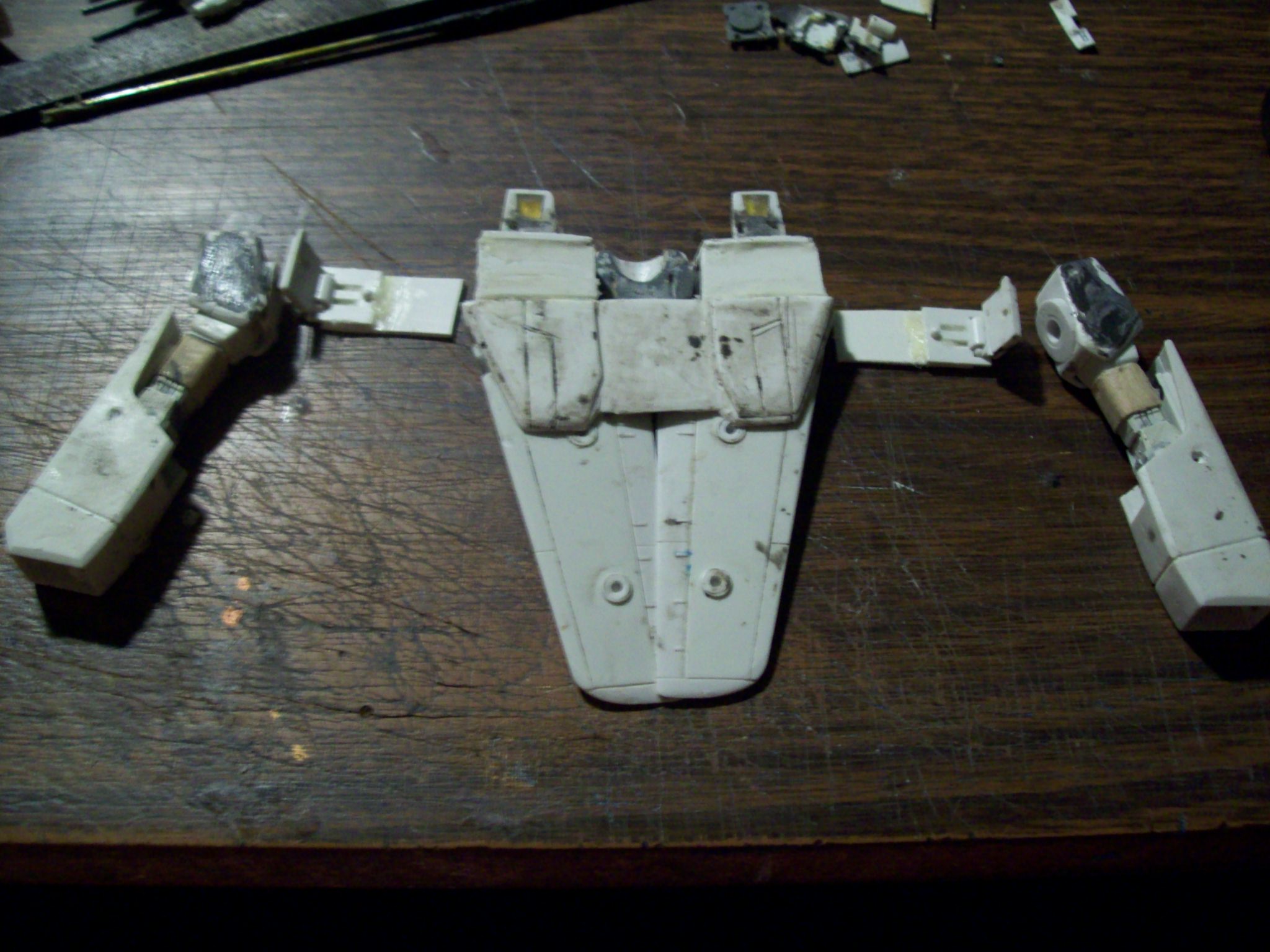

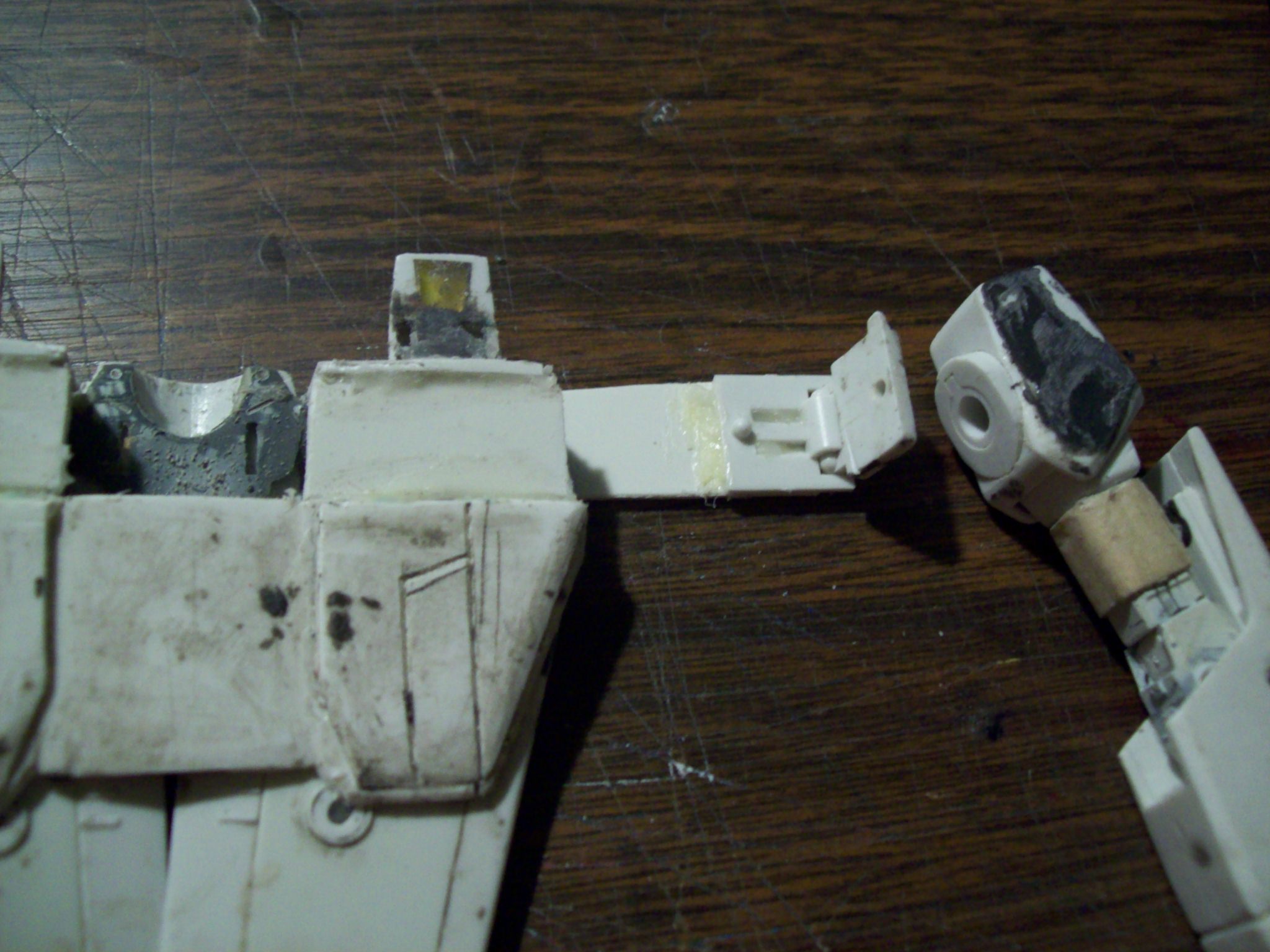

pengbuzz Posted January 19, 2017 Author Posted January 19, 2017 (edited) UPDATE: finally got the arm transform integrated into the back plate: I ended up taking a page out of Yamato/ Arcadia's notebook: I implanted the rotators into the backplate (after notching the wings to make clearance for them) and placed poly-caps to retain the post for the arm retainers.Had to remove much of what I had originally installed, but the casings for them make for a much more stable platform to glue the top shoulderplates and searchlights to: A better look: Â With shoulder parts/ arm retainers in place (fighter mode): Â In deployed position (Battroid Mode) Â With arms attached (I began some parts priming...yay!): Â Folded for Fighter Mode: Â The whole idea was to provide a stable setup for transforming the arms, while at the same time, bringing them closer into the body of the Fighter so they didn't "dangle" below the head. At this point, I'm reinforcing the chestplate and addressing issues with the leg retainers for Fighter mode/chest sliders: the plastic embattled and as a result, the "blades" on them crumbled. I'm scratching up a new pair that should be in tonight or tomorrow evening. After that: joining the front to the back (installing the rear shoulder folding hinge) and building a new joint box for the "backpack": that will be implanted and glued into place and should keep the "floppy syndrome" for the backpack completely out of the picture. UPDATE 2 in just a moment folks... Â Â Edited January 19, 2017 by pengbuzz Quote

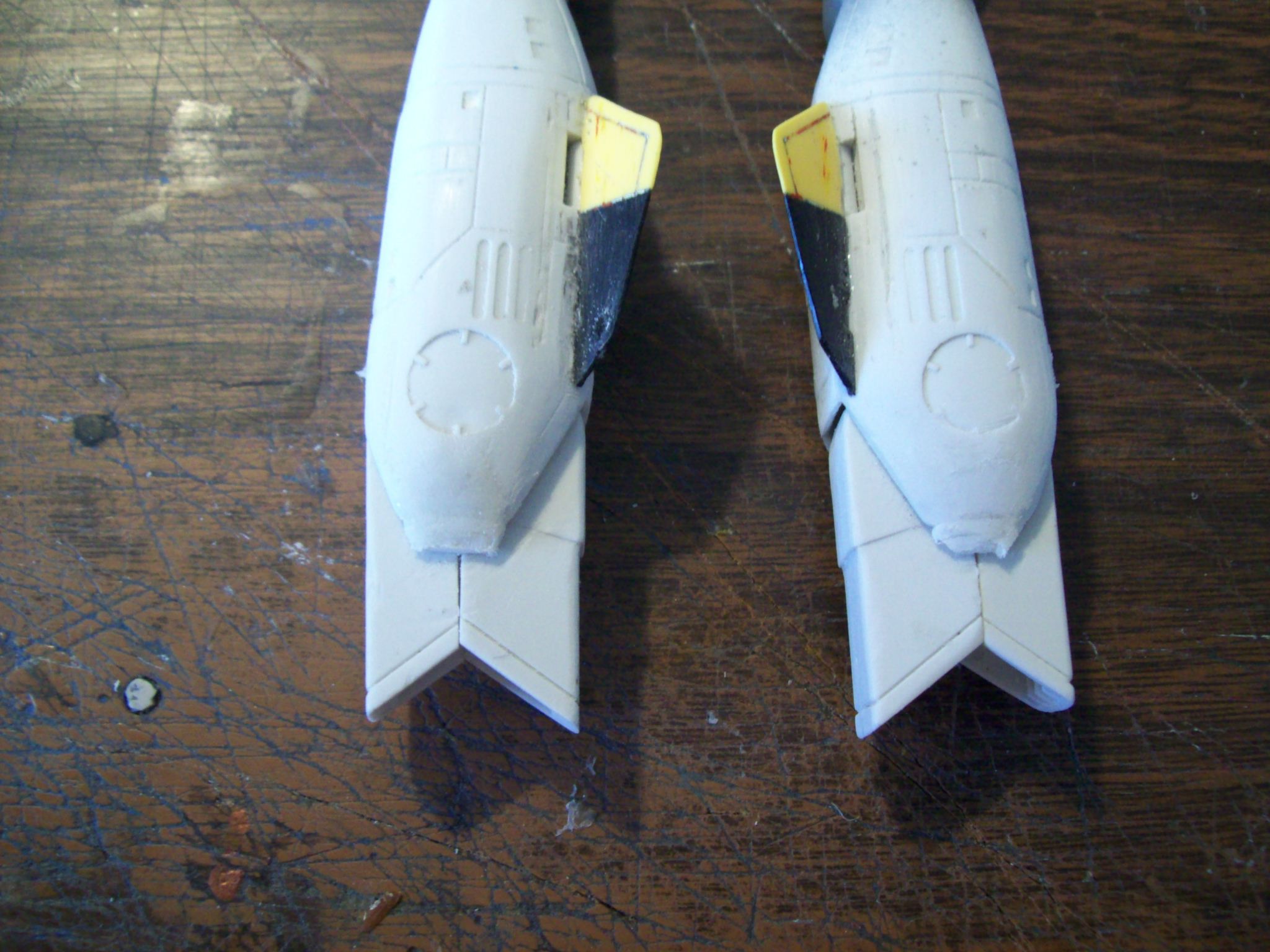

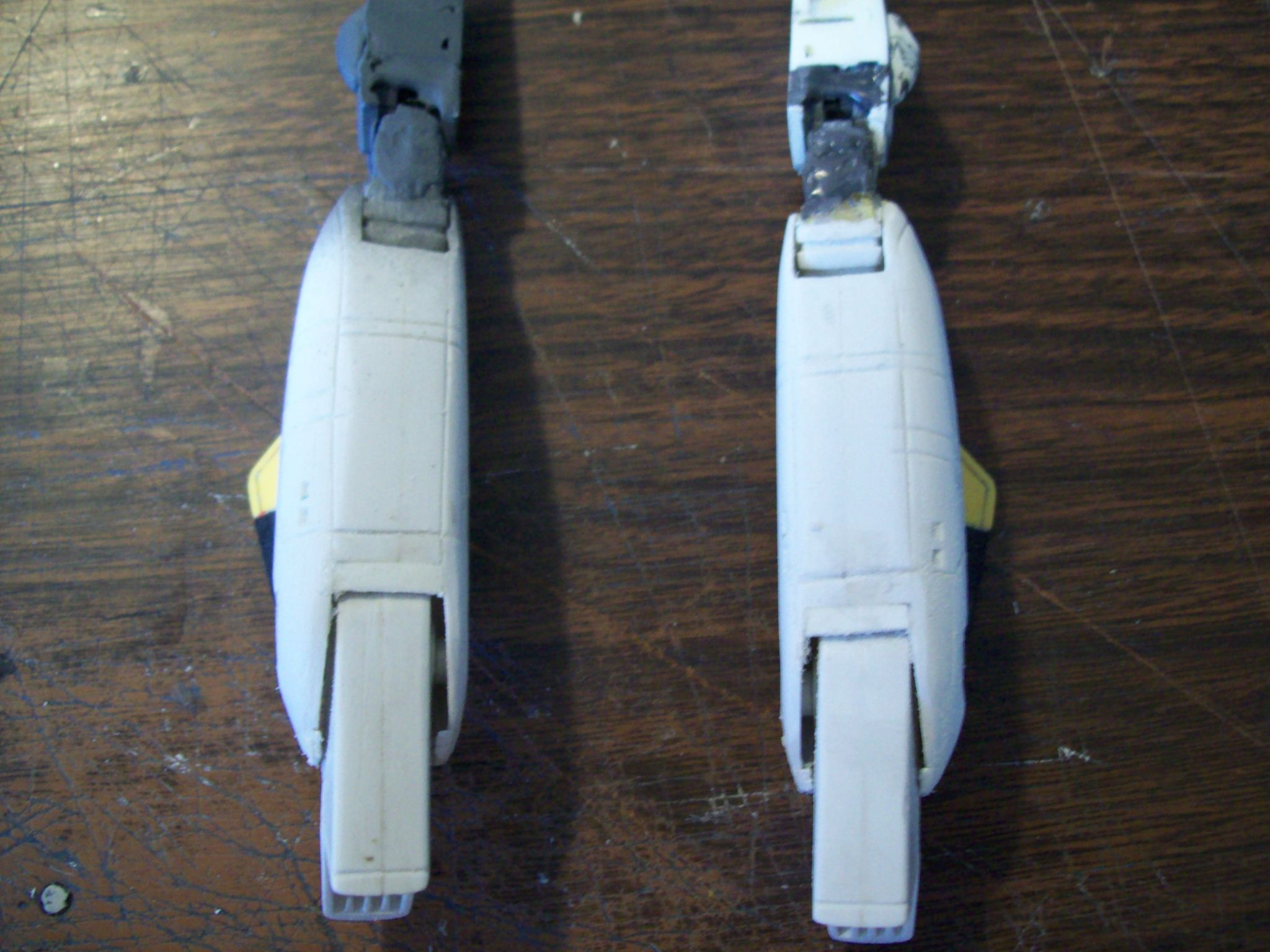

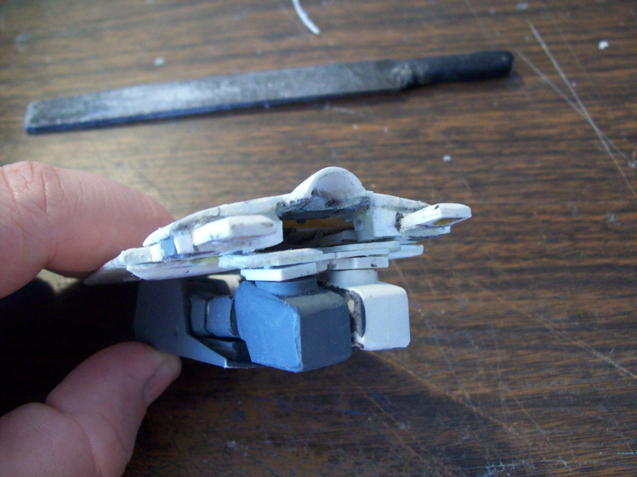

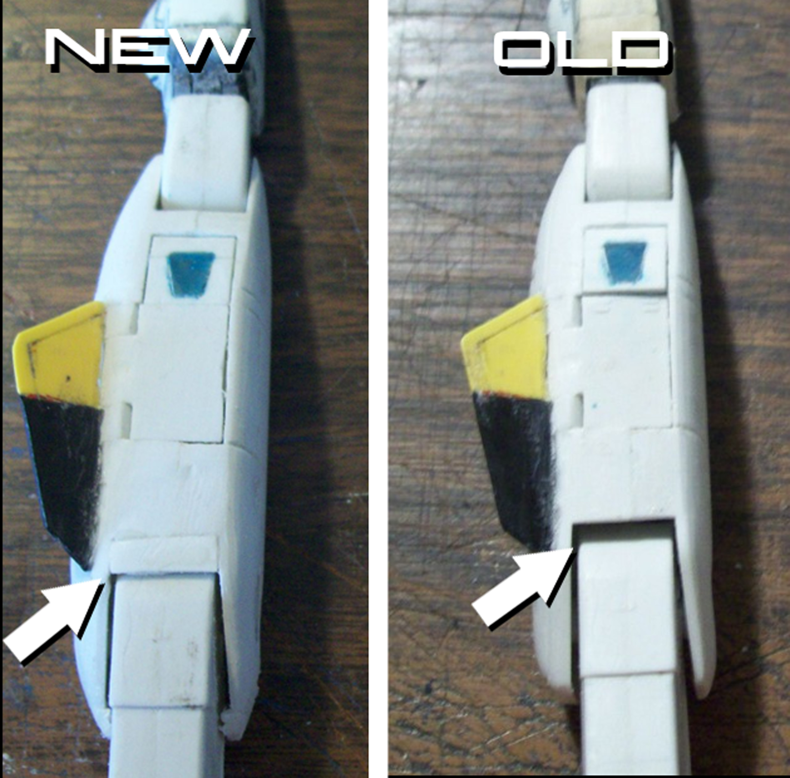

pengbuzz Posted January 19, 2017 Author Posted January 19, 2017 (edited) UPDATE 2: Â I also took a good look at why the legs seemed so out of scale with the rest of the valkyrie, when I noticed something: Â It wasn't the length of the legs, but the "cutouts" for the feet! Â Â Â With that in mind, I went ahead and closed the gap on the thruster/ foot openings, while leaving enough room for them to open in Battroid mode, as well as tilt back in Gerwalk mode; Â I also extended the sides on the engine housing, as they were also a bit short when compared to the line drawings ?blueprints of the VF-1S' engine nacelles: I think it looks a lot better now: and when compared to the line drawings, the lower leg seems a bit more in scale now... Stay tuned... Edited January 19, 2017 by pengbuzz Quote

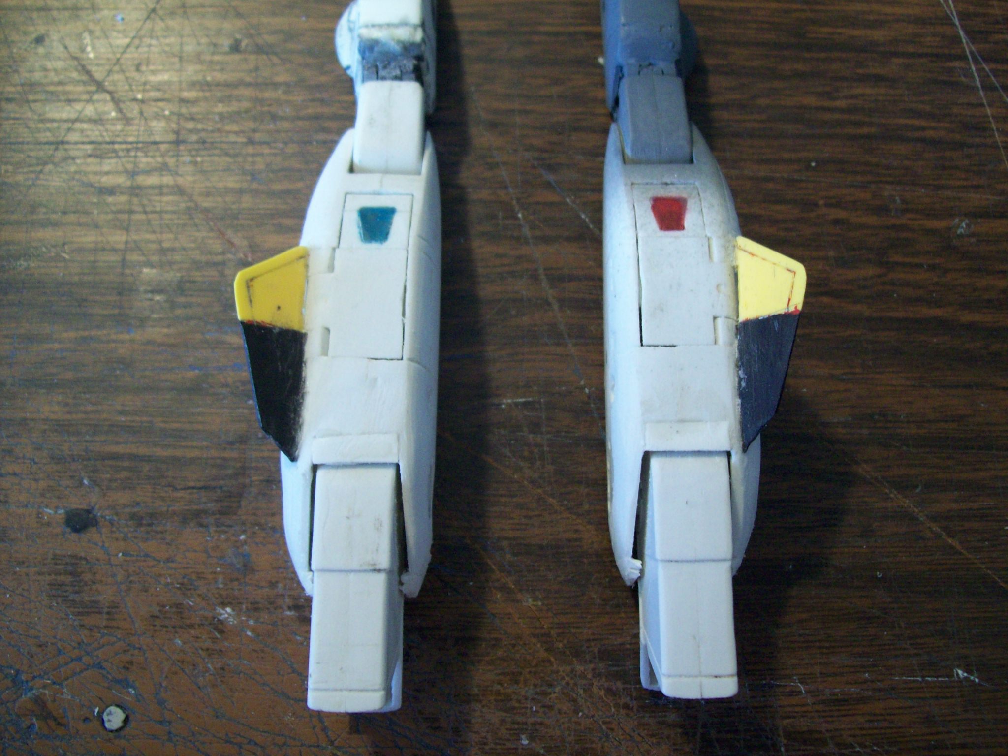

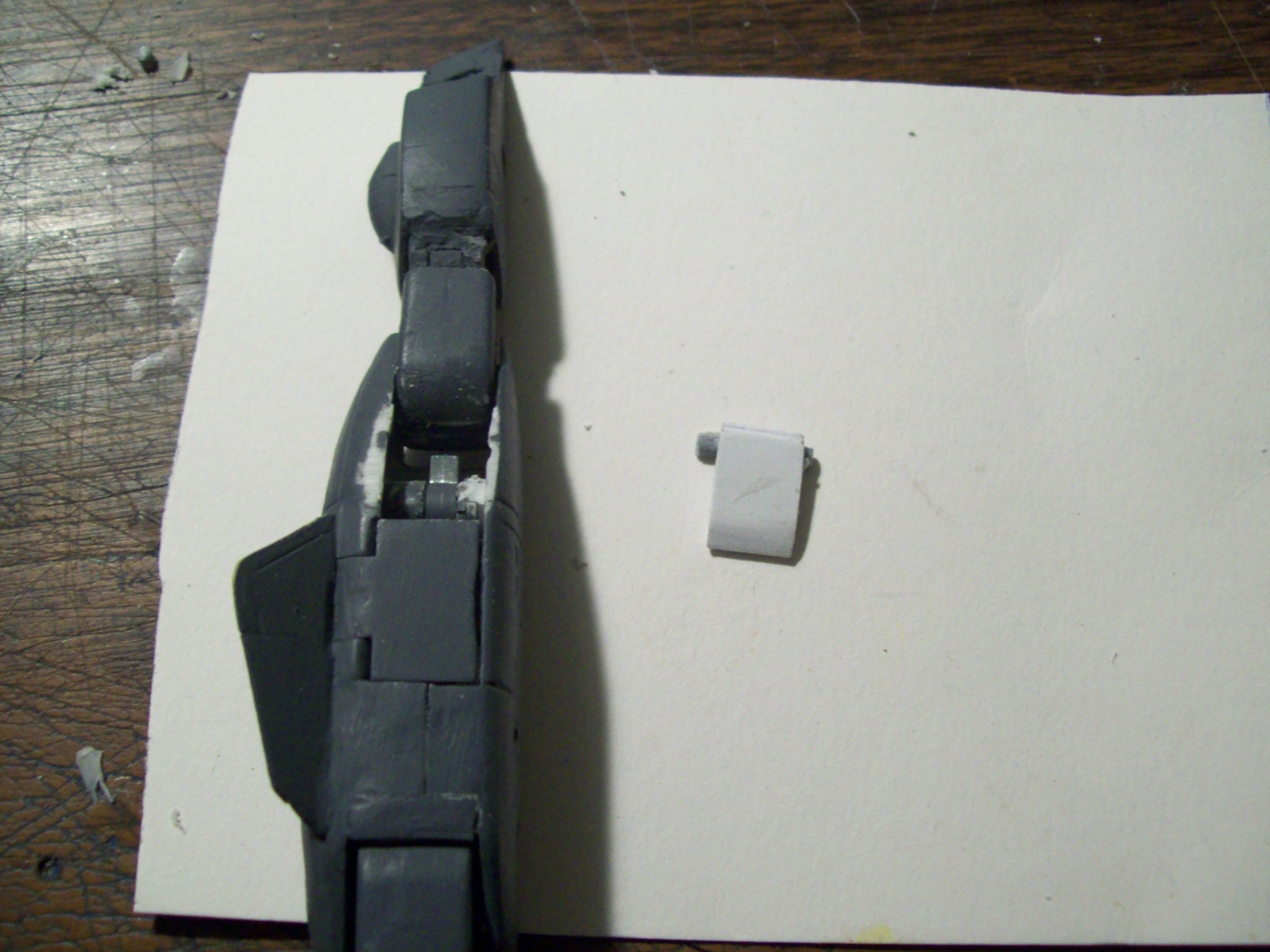

pengbuzz Posted January 23, 2017 Author Posted January 23, 2017 (edited) UPDATE: Another issue I noticed was with the door with the red and blue lights on them> Comparing it to the schematics for the VF-1, they should go all the way up to the knee rather than end below it with a "bar" between them and the knee joint. So with that, I went to work... An inner piece on either side of the leg will be glued in with a hole drilled for the new door to swing open and closed. Meantime, an internal racing piece will replace the "bar" above the door as to keep the leg from popping apart (otherwise, it's just the lower leg and back holding it together. Hoping to head to paints soon, but I figure "I'm in this deep", may as well address this stuff before I "seal up" the parts and start color coats. Tay Stuned... Edited January 23, 2017 by pengbuzz Quote
pengbuzz Posted January 23, 2017 Author Posted January 23, 2017 UPDATE: So far, upper doors are going okay, but super glue got into one of the lower ones. When I tried to free the door, it broke. At this point, I decided one something I was previously on the fence about: redoing the main landing gear doors the proper way (two angled pieces instead of one "barn door". Just have to source the joints and do some more filing and plastic work.... ...Maybe I should have saved up for a 1/60 V2 VF-1S? lol Stay tuned... Quote

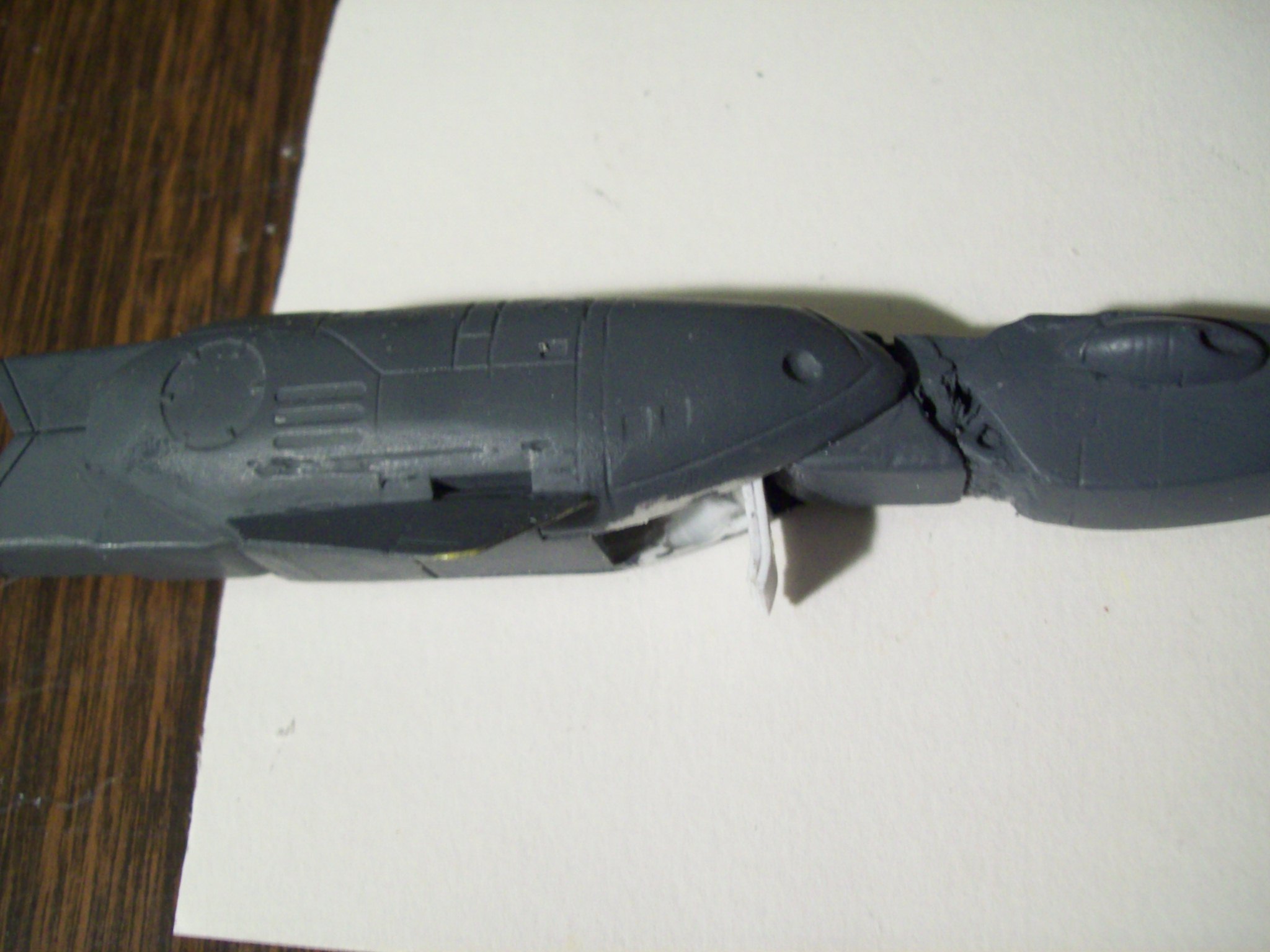

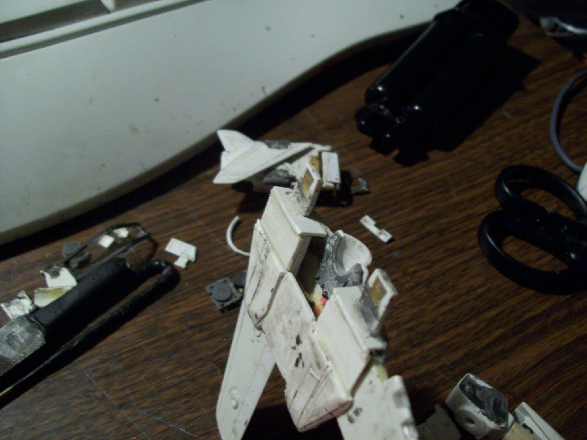

pengbuzz Posted January 24, 2017 Author Posted January 24, 2017 (edited) Well, my two idiot cats thought it would be a fun idea to have one of their "furry scurries" through the house, where they promptly barged into my work room and plowed into the table I set up for drying the parts. One cat stopped in time, but the other did not and crashed into the first one, sending both into my drying table. (They were supposed to be corralled in the other room with the door closed. How they got out is still being determined...) Casualty report: Chest plate is separated from the main body but can be reattached. Minor scuffs and whatnot on most of the valkyrie. One clip on the arm transform was broken but repairable and a head laser snapped off (superglue most likely will repair that one). However, the implanted head-transform I designed and installed is shattered and is going to be the world's biggest pain in the ass to redo, given the location and setup (buried deep in the cockpit area, which is buried in the sub-armature of the chest and a major PITA to get a,t let alone modify). Not to mention the money spent on materials and whatnot for it, the frustration level is at a scale comparable to the SDF-1 preparing to fire the Main Cannon... Â I nearly hurled this project against a wall with all my might. It took major amounts of self- control NOT to.... Â In any event, I don't have the money to replace parts on this or to keep buying adhesives for the bazillion issues (food and other things like bills are priority) that keep cropping up on this "self-inflicted wound of plastic" I did to myself. So, this is going back on the shelf until I either figure out how to salvage the transform (I don't want a "static" robot, which I just despise) or get sick of it and toss the damned thing in the trash. Â Me and my bright ideas, right? Edited January 24, 2017 by pengbuzz Quote
