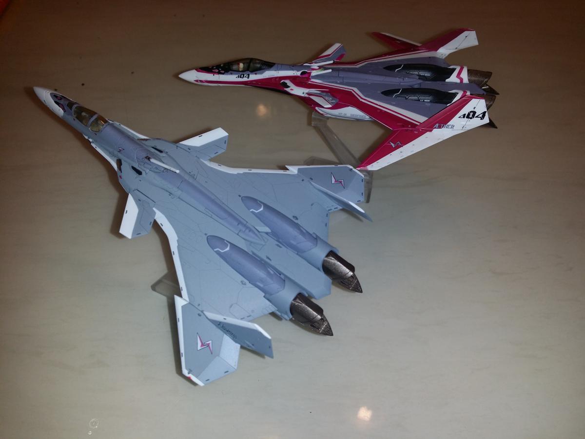

Graham Posted September 10, 2016 Posted September 10, 2016 Built Mirage's VF-31C and the VF-31A Kairos today. Quote

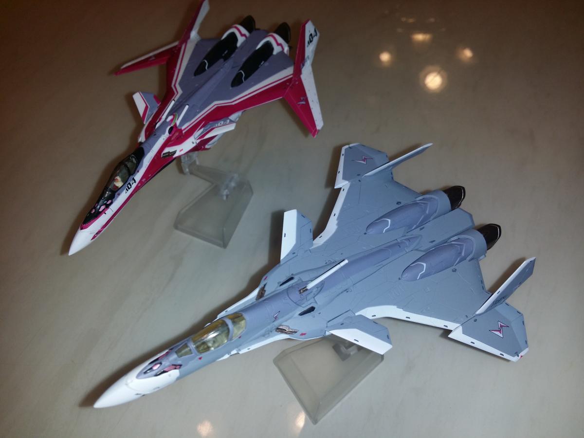

seti88 Posted September 10, 2016 Author Posted September 10, 2016 My swag haul. Will start building today. Gonna start with Mirage first, as a test build as that's the one I care least about if I mess up anything. Nice pic! Quote

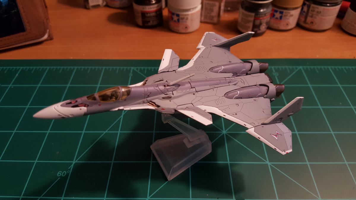

derex3592 Posted September 10, 2016 Posted September 10, 2016 Got my 31A done this morning. Going to do the water slide decals here in a few. Quote

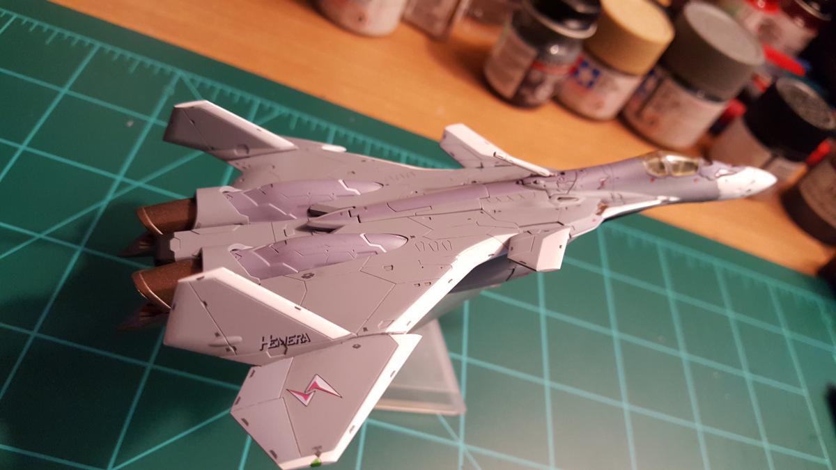

derex3592 Posted September 12, 2016 Posted September 12, 2016 Here's my three. I did a panel line wash on the top of the 31A with pro modelers dark dirt clay based wash. It definitely helps bring out the details. Will probably do it on the other two eventually. Quote
