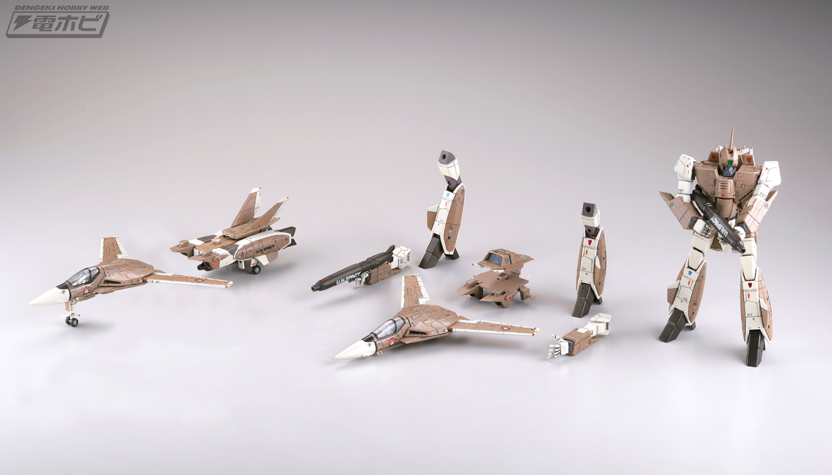

seti88 Posted April 21, 2016 Author Posted April 21, 2016 (edited) Yup thats what i tot too. But just to address the glue question, and whether or not you glue everything and if unable to switch back to other modes... from DH website... http://hobby.dengeki.com/news/188653/ If you build gerwalk, i suspect you will have the figher back + the battroid body as modular leftovers. But it does look as you can switch modes after you glue the main components.. And nothing would stop you from building a Franken valk with different 1s,j,a parts. Whether u want to or not that's the question haha... Edited April 21, 2016 by seti88 Quote

Graham Posted April 21, 2016 Posted April 21, 2016 Confused......So does this mean that the Gerwalk kit is not a complete kit even though it's the most expensive? And does it mean you have to buy an extra Fighter mode and Battroid mode kits just to complete the Gerwalk? If that's the case I'll probably cancel my Gerwalk order and just stick with the Fighter and Battroid kits. Quote
jenius Posted April 21, 2016 Posted April 21, 2016 As I understand it, the GERWALK kit is both battroid and fighter kits. You can have a fighter mode and a battroid mode. However, if you want to build a GERWALK you can do so and you'll have half a fighter mode and half a battroid mode left over. Quote
Duymon Posted April 21, 2016 Posted April 21, 2016 It's like the Wave 1/100 kits; You get fighter and battroid separately and then there's parts to make gerwalk. Seeing as the Fighter and gerwalk parts have little T-sliders on them I highly doubt it's a permanent thing. Quote
seti88 Posted April 21, 2016 Author Posted April 21, 2016 (edited) You can make a fighter OR a battroid OR a gerwalk with ONE gerwalk kit. Its part-swappable depending on the mode you want. Edited April 21, 2016 by seti88 Quote

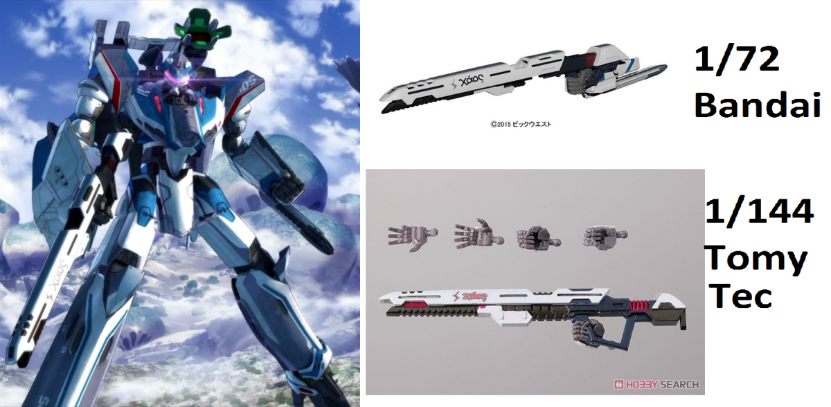

kajnrig Posted April 24, 2016 Posted April 24, 2016 (edited) So this is a really REALLY minor point, but the handle on the gunpod is different between the Bandai and Tomy Tec models. It seems the Bandai one is a bit closer to the animation, but there hasn't been a very good angle of it at this point. Overall it looks like the Tomy Tec one has more inaccuracies all around, but it still doesn't look bad per se. Those biceps are bigger than they ought to be, but then they also look more substantial. Edited April 24, 2016 by kajnrig Quote
