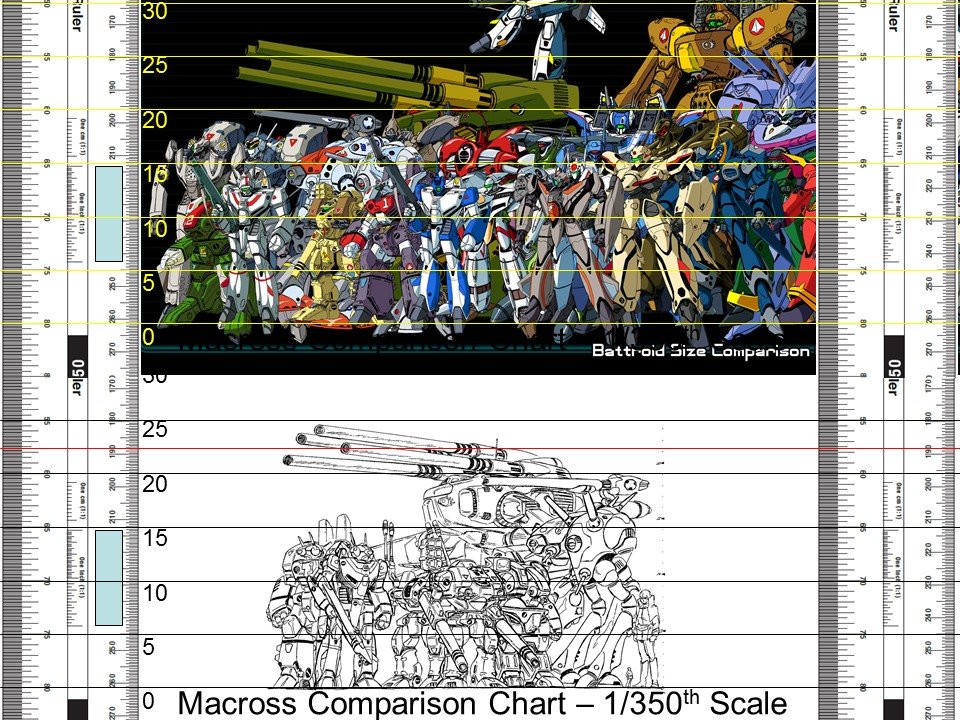

MechTech Posted January 27, 2016 Posted January 27, 2016 Several of us scratch building have run into this problem also known as "anime magic." Stuff looks good in the book or in the anime, but the two don't work out right, not even in multi-viewed drawings side by side! I've attached one sample that I use to scale with (higher res available). The B/W drawing is official and the other is a fan compilation. As drawn in B/W, stuff works out - I've built several items in 1/350th using this scale to include a Spartan, a VF-1J GBP / fighter, Regult and a Monster. The real answer was mentioned earlier, the Zentraedi vary in size. Officially, soldiers are 10M tall. One word of caution, the anime messes stuff up BAD and is inconsistent. Look at MANY screenshots for anything you want to reference including color because there will be inconsistencies. The newer CGI stuff may not be as bad, but the older hand drawn art is notorious for inconsistencies, some were on purpose as jokes by bored artists. According to the B/W drawing, Kamujin and the Monster are pretty close to scale in that screenshot. EXO and I have scaled them about the same too. Hope this helps! - MT Quote

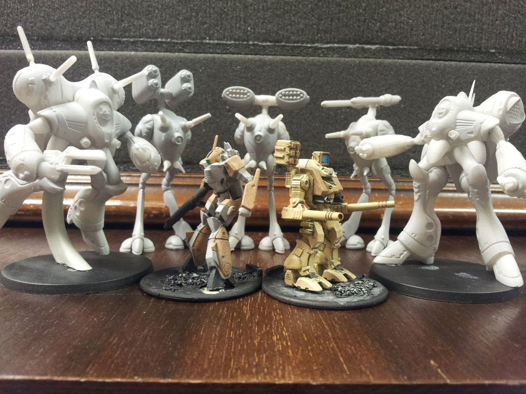

NZEOD Posted February 14, 2016 Author Posted February 14, 2016 (edited) This is more the size differences between Zent/Meltrandi and Human machines I was thinking... Although the Regults need to be a bit bigger. Edited February 14, 2016 by NZEOD Quote
NZEOD Posted February 15, 2016 Author Posted February 15, 2016 (edited) Those are the figures from the abomination that is the tabletop wargame Robotech Tactics. Warhammer 40K figure sized. Edited February 15, 2016 by NZEOD Quote
MechTech Posted February 15, 2016 Posted February 15, 2016 They don't look bad except for those "non-cannon" kits - MT Quote
