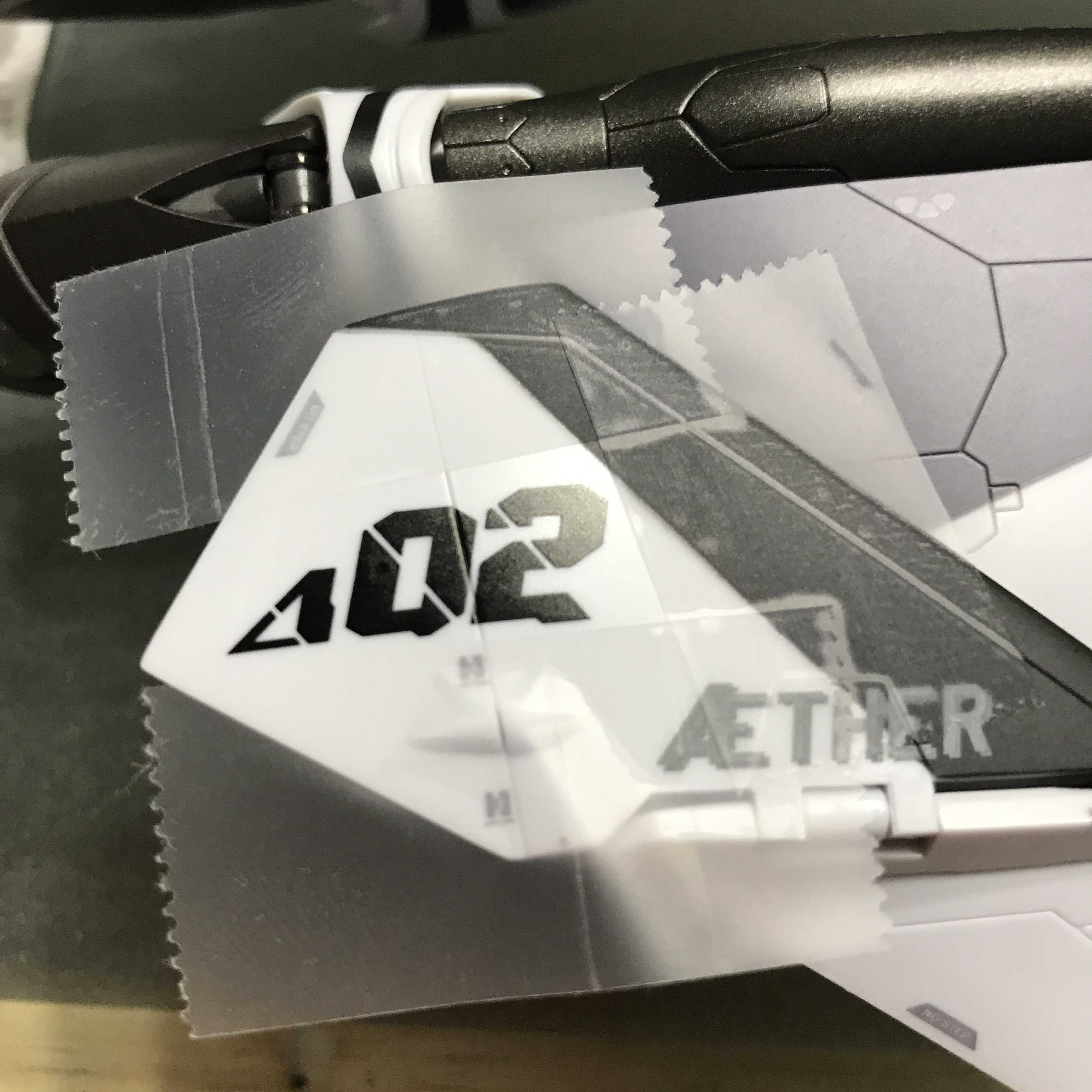

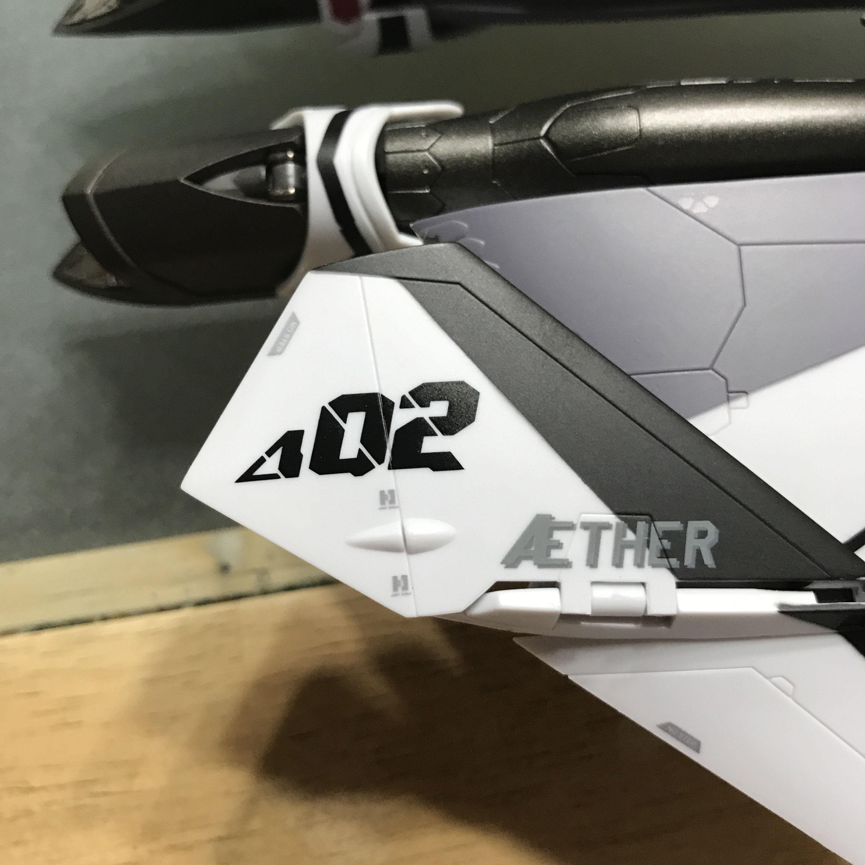

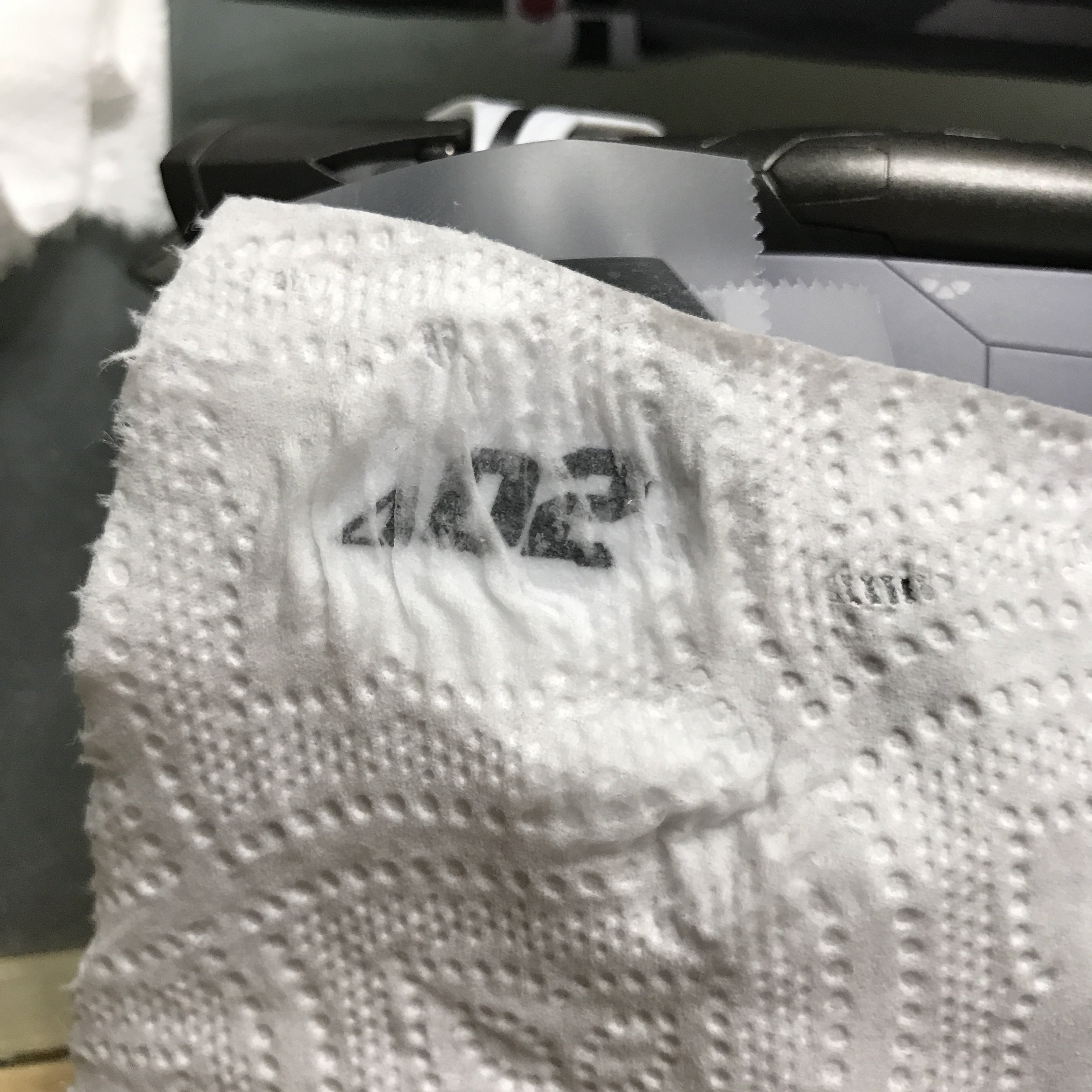

no3Ljm Posted May 23, 2017 Posted May 23, 2017 (edited) 10 hours ago, no3Ljm said: Thanks for this Seti. I forgot about MicroSol. I already have that. Will try it soon. I tried and soaked it for 5mins as per the video tutorial and it didn't do nothing. Edited May 23, 2017 by no3Ljm Quote
seti88 Posted May 23, 2017 Posted May 23, 2017 That there is proof of good quality tampo from tampo king bandai Sorry it didnt work, tho not sure if you want to try without a tissue and let it sit longer and try a couple of times.. saw this vid using a specialised tampo remover....but even he had to do multiple rounds to try and get the tampo out... Quote

wm cheng Posted May 23, 2017 Posted May 23, 2017 32 minutes ago, no3Ljm said: I tried and soaked it for 5mins as per the video tutorial and it didn't do nothing. MicroSOL only works on decals - Tampo is a paint application. I'd try isopropyl alcohol first - its pretty safe on plastics, I used it to take off the "Made in China" tampo printing on the bottom of some of the wings in the past and it seemed to work well. MacrossJunkie also used it to remove the glittery gold from the canopies to great effect (which I want to try when I get time). Worst case, I'd go up to lacquer thinner which pretty much eats all paints - Mr. Color Thinner seems to work really well on a few different types of paints and seems more gentle than most lacquer thinners out there. Just my 2 cents, good luck! Quote

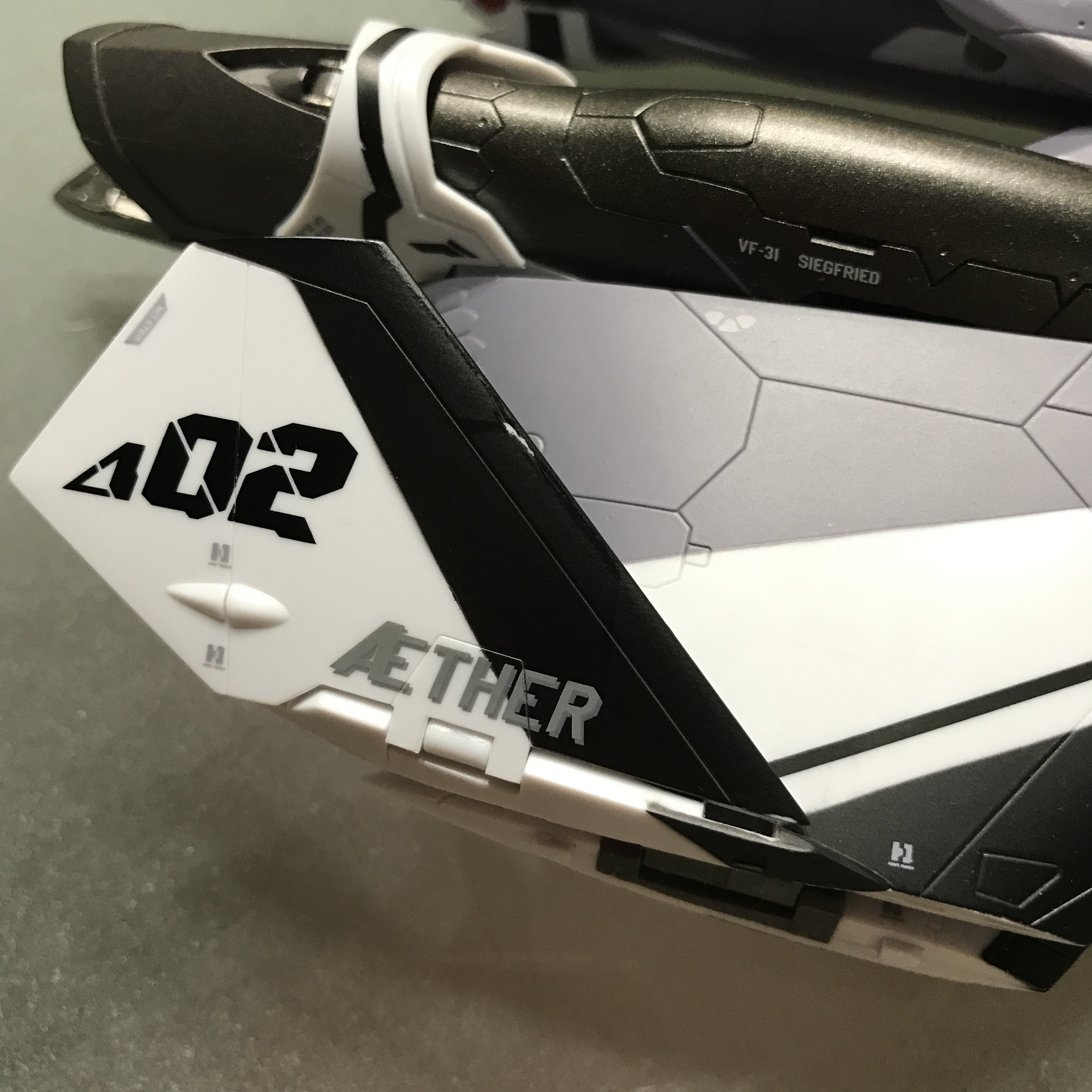

no3Ljm Posted May 23, 2017 Posted May 23, 2017 (edited) After soaking it for 10mins, here's what happened when I clean the MicroSOL residue. Good thing it will be covered by red decal or paint later on. Or when I got lazy and my plan didn't work, it will be just covered with Super Parts. Edited May 23, 2017 by no3Ljm Quote

seti88 Posted May 23, 2017 Posted May 23, 2017 Whoa that looks to be the area where your scotch tape was covering...could it be a case of too sticky a tape or a combination of microsol and scotch tape residue? Or is it just a matter of letting the microsol do the work? Your intended area doesnt seem much affected... Quote
no3Ljm Posted May 23, 2017 Posted May 23, 2017 4 minutes ago, seti88 said: Whoa that looks to be the area where your scotch tape was covering...could it be a case of too sticky a tape or a combination of microsol and scotch tape residue? Or is it just a matter of letting the microsol do the work? Your intended area doesnt seem much affected... I think the culprit was is when I left it soaked the liquid probably traveled within the grooves of the tape and from the panel lines. And when I came back to clean it up after 10mins since the tampo print that I want to be removed didn't do anything, I tried to lift the residue from my fingernails after I removed the tape, and voila! All I can do is this -> , since I don't want to bang my head afterwards. Quote
seti88 Posted May 23, 2017 Posted May 23, 2017 As long as you didn't smash ur valk into the wall i would say thats a good response good thing you chose to work on messer, more choice of black ink markers (or even black panel liner?) available to fill in .. Quote
