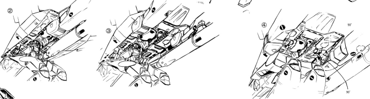

Aurel Tristen Posted October 23, 2015 Posted October 23, 2015 I'd say that's a good guess, but the bigger question is, where is the second and third image from? I've never seen the pilots seating position during transformation illustrated. And am I the last person to learn that the front landing gear partially deploys? O__O Quote
spanner Posted October 23, 2015 Posted October 23, 2015 I have seen those smaller diagrams before with the seating position and landing gear box extended to make room for the pilot seat rotation. The top illustration I've seen also but does seem a little spacious than you'd expect. In reality it would be somewhat cramped. Quote
Aurel Tristen Posted October 23, 2015 Posted October 23, 2015 Where was the second one at? It looks like a toy or model manual or something. The top one is rather common (as Macross goes), but yeah, it looks a wee bit spacious for sure. Though it would be hard to show all those details without it being GoPro like. The cockpit transformation discrepancies are one of my biggest issues with the VF1. I think the YF19 and others had it right. Just tilt the seat back! Quote

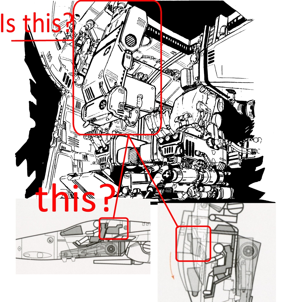

logan_4600 Posted October 23, 2015 Author Posted October 23, 2015 Guys! That pic is actually in this forum! Is from the book series Variable Fighter Master File. (im trying to see if a can get one of those books) You can find them here http://www.macrossworld.com/mwf/index.php?showtopic=34651&page=5 So, what do you say? is that accurate? On 10/23/2015 at 2:40 AM, spanner76 said: I have seen those smaller diagrams before with the seating position and landing gear box extended to make room for the pilot seat rotation. The top illustration I've seen also but does seem a little spacious than you'd expect. In reality it would be somewhat cramped. Hooo yeah! I´m having a VERY hard time with my CG VF triying to make everything work mechanically accurate, and then have the space that the pics shows. Some things when you start wroking them just, doesn´t seem to work well. On 10/23/2015 at 2:55 AM, Aurel Tristen said: Where was the second one at? It looks like a toy or model manual or something. The top one is rather common (as Macross goes), but yeah, it looks a wee bit spacious for sure. Though it would be hard to show all those details without it being GoPro like. The cockpit transformation discrepancies are one of my biggest issues with the VF1. I think the YF19 and others had it right. Just tilt the seat back! Yes, also the VF-0 acctually making the seat AND instrumental rotate seems more logic. But, if the VF-1 is like that... well... i will model it like that! Quote
logan_4600 Posted October 23, 2015 Author Posted October 23, 2015 Ook! This going somewhere. The gear sholud not be getting down, but, its just to show you it does move too! You have the seat getting in position, and the head too. Also the fron gear bay goes down to make the space (in this vid, the full nose and the actual cage / bay are absent ) Quote
grigolosi Posted October 23, 2015 Posted October 23, 2015 The problem I have with the lower 2 diagrams is the position of the pilots head to the canopy. That canopy is damn low. Typically there has to be room for the pilots head so he can swivel and move, even on an aircraft like the F-16, which has an angled seat the pilots will use their fist as aa measurement to make sure they have proper clearance between the canopy and their helmet . The lower two diagrams pilot looks like they are out of proportion. Quote
logan_4600 Posted October 23, 2015 Author Posted October 23, 2015 (edited) I get what you say. Looks like the pilot and/or The seat should be smaller. Edited October 23, 2015 by logan_4600 Quote

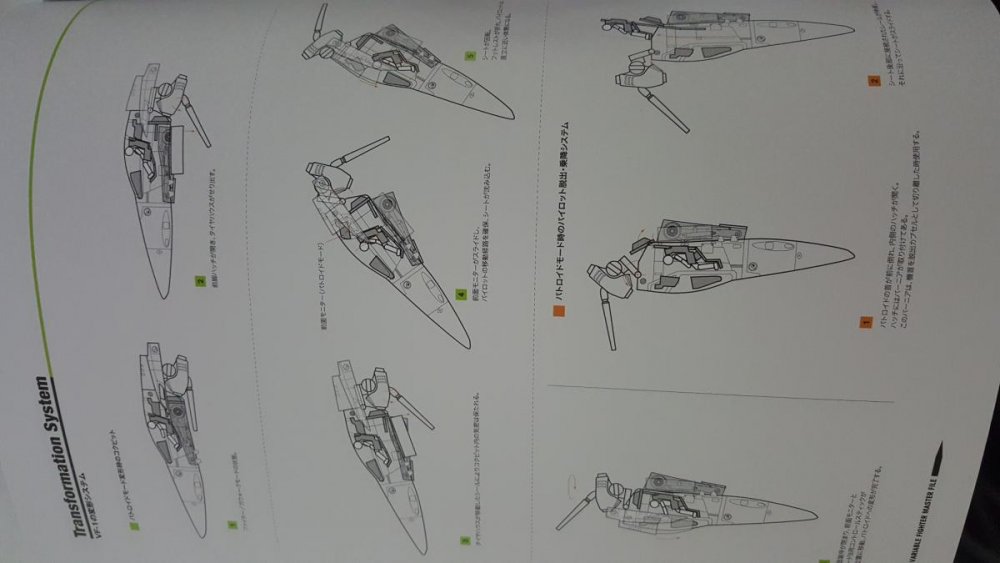

Mr March Posted October 24, 2015 Posted October 24, 2015 This transformation diagram is from the Variable Fighter Master File VF-1 Valkyrie Vol. 2 Space Wings, but remember, these Master File books are not necessarily official continuity. They have the disclaimer. I've scanned a better version, attached here. Quote
logan_4600 Posted October 24, 2015 Author Posted October 24, 2015 But, they make sense. If not, The front landing gear shuould be way farther from The cockpit to make some room for the pilot seat to rotate. I did re watch the first and second episodes from Macross and it makes sense. ( other VFs in other series are simpler tough ) Quote

grigolosi Posted October 24, 2015 Posted October 24, 2015 (edited) Also the nose tire looks to be out of proportion also. Typically fighter nose tires tend to be smaller than that. Even when it is a double tire like the F-18 or F-14 would use. Even most nose tires on these aircraft tend to be around a foot and half in diameter or a little wider than the human head. That angle box section of the nose well could be reduced in size when the tire is proportioned correctly and more than likely the only area raised to allow for the torque links to fit would be directly over them. You would be shocked at the amount of space that can be utilized in a well engineered wheel well. I also just noticed something amiss in the lower 2 diagrams, mainly the left one. The barrel for the laser on the A model VF-1 would be in the way of the nose gear as it extends. I would also suspect that the strut would work better for landings if it was mounted the other way. With the trunnion pin being mounted to the rear of the well and the nose tire being in the front of the well when it is retracted. Just give an idea of what a modern fighter wheel well looks like here is a link with walk around photos of an F-16. http://www.aircraftresourcecenter.com/awa01/001-100/awa002-F-16C/00c.shtm Edited October 24, 2015 by grigolosi Quote

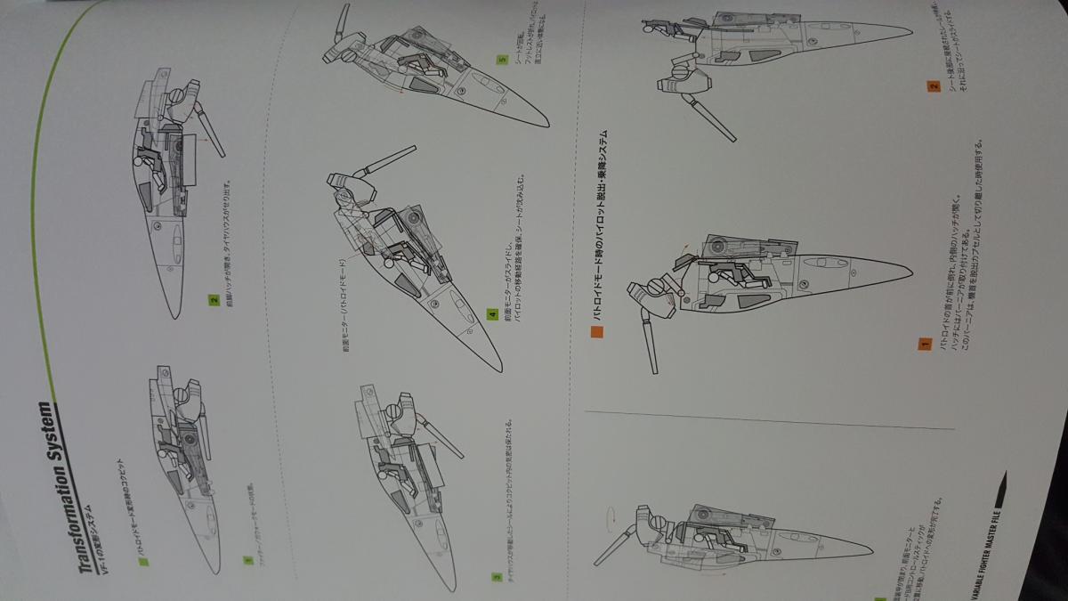

spanner Posted October 24, 2015 Posted October 24, 2015 On 10/24/2015 at 2:20 AM, Mr March said: This transformation diagram is from the Variable Fighter Master File VF-1 Valkyrie Vol. 2 Space Wings, but remember, these Master File books are not necessarily official continuity. They have the disclaimer. I've scanned a better version, attached here. ahhh yes this is true but for that particular section of the transformation this illustration does seem to make good sense. I'll admit there is some technical material in these books which does comes across as silly or rubbish but overall they are overall pretty good. And probably the best currently available. Quote
Mr March Posted October 24, 2015 Posted October 24, 2015 I'd listen carefully to grigolosi, he's on the right track. Though this transformation guide from the VFMF book has some good stuff, it does have some things wrong, most specifically scale. The landing gear are way too large, especially accounting for the official Shoji Kawamori schematics. I've attached an image that shows the VF-1 Schematic FRONT TIRES and they are much smaller, as grigolosi has said. As stated, that forward gear bay is taking up a more space than it would.spanner76The VFMF books are lots of fun and they do contain trivia about aspects of the Macross valkyries that have never been detailed in the official trivia. But we do have to be careful when accepting information within their pages since the disclaimer in each book specifically states they are not official continuity. As long as the individual pieces of trivia within the VFMF books don't contradict anything official, they do serve as a good guide for the Macross universe. I'd say this transformation guide does suffer some problems and it's problems with scale do preclude the diagram from being official, but I will agree it does show a lot we don't see and makes a lot of sense of the transformation mechanisms despite a few exaggerations. Aurel Tristen The Variable FIghter Master File books are indeed legitimate official Macross products. I think you may be able to find them cheaper than the link you've posted. They are filled with a lot of great images, cross-sections and schematics. Now, the "accuracy" of those images my be debatable (espeically amoung the more artistically skilled fan artists we have on the forums) but they are well worth investing to give you ideas and reference. Quote
grigolosi Posted October 24, 2015 Posted October 24, 2015 That diagram looks more exact to scale than the other ones. The tires look properly scaled compared to the figure at the nose. But the barrel of that laser is still a bit too long to allow clearance when the gear is retracted. It only needs a little bit taken off the front to provide the clearance. Quote
