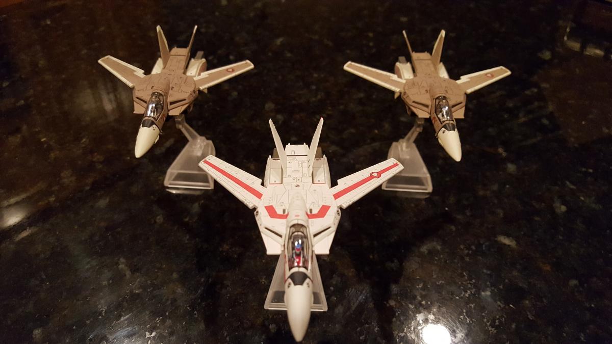

derex3592 Posted September 28, 2016 Posted September 28, 2016 These things are amazing! The detail is mind blowing. Far better than the Delta Valks. Going to build them this weekend hopefully! Quote

derex3592 Posted October 3, 2016 Posted October 3, 2016 First VF-1A done! Great little kits.. the ONLY parts that will drive you to the edge of sanity are the two tiiiiiny dual antennas under the nose. Damn.. LOL. You have to glue them in. Everything else is great. 1 down, 2 to go! Quote

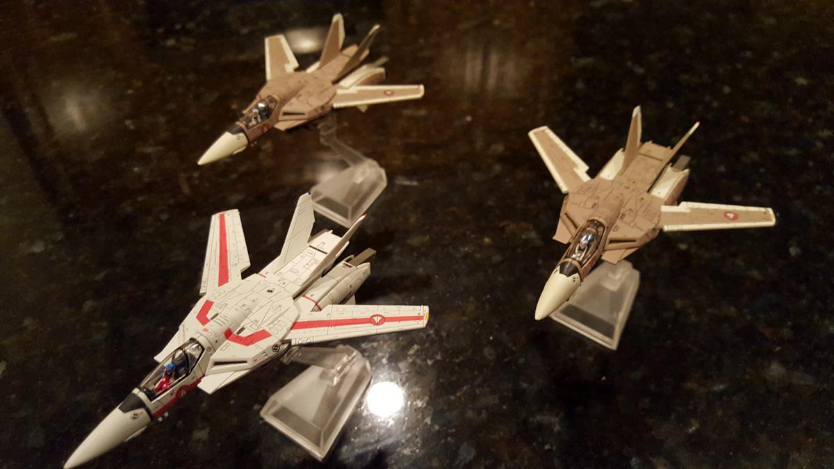

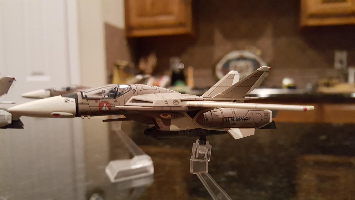

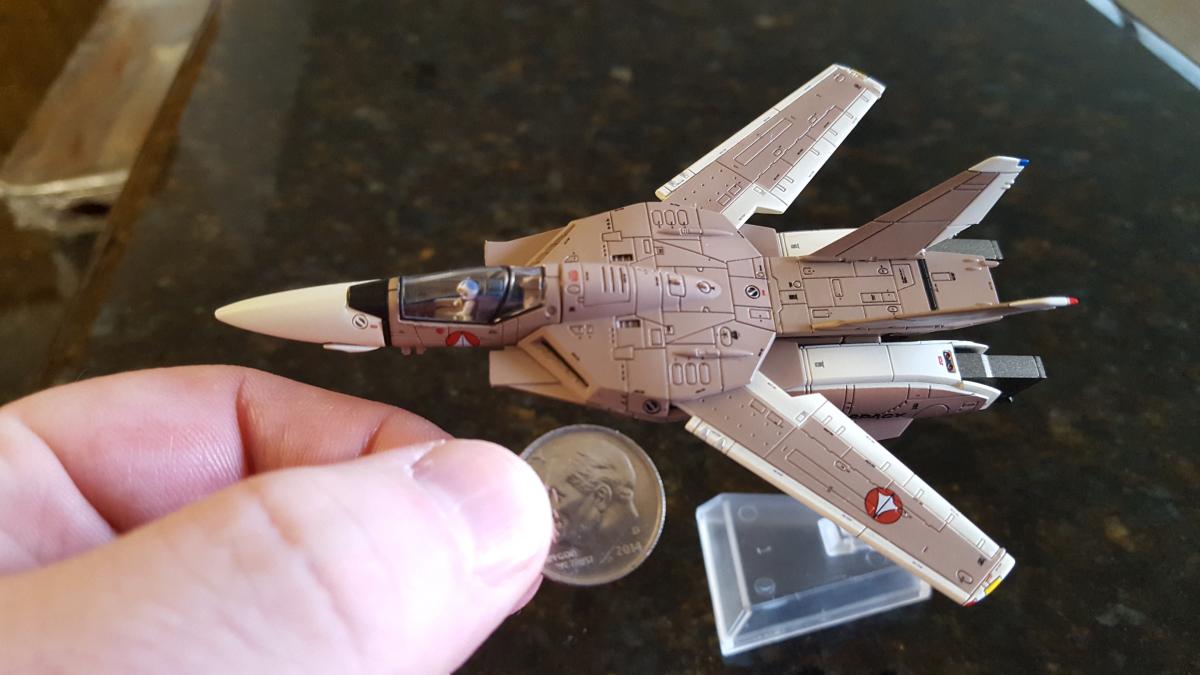

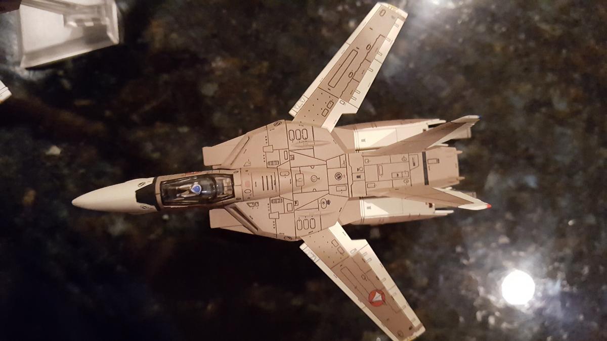

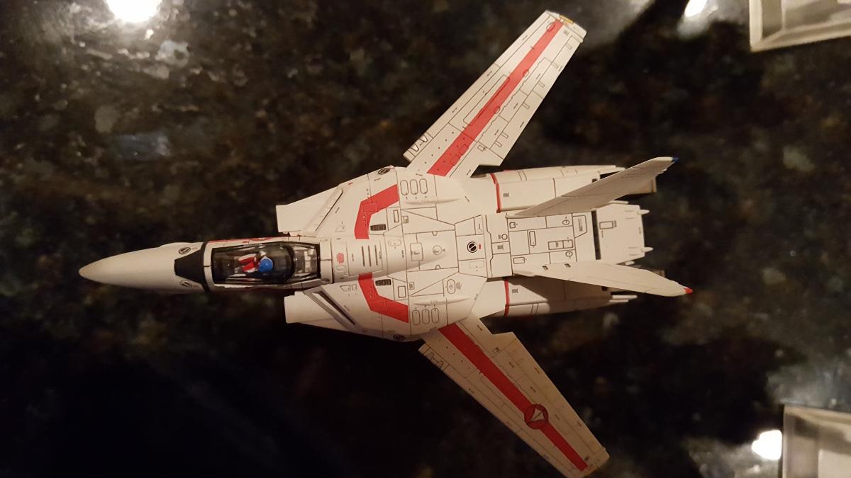

derex3592 Posted October 10, 2016 Posted October 10, 2016 Hikaru and squad reporting in! Finished these up over the weekend. I did flat coat them to give them a little more realistic military feel. Quote

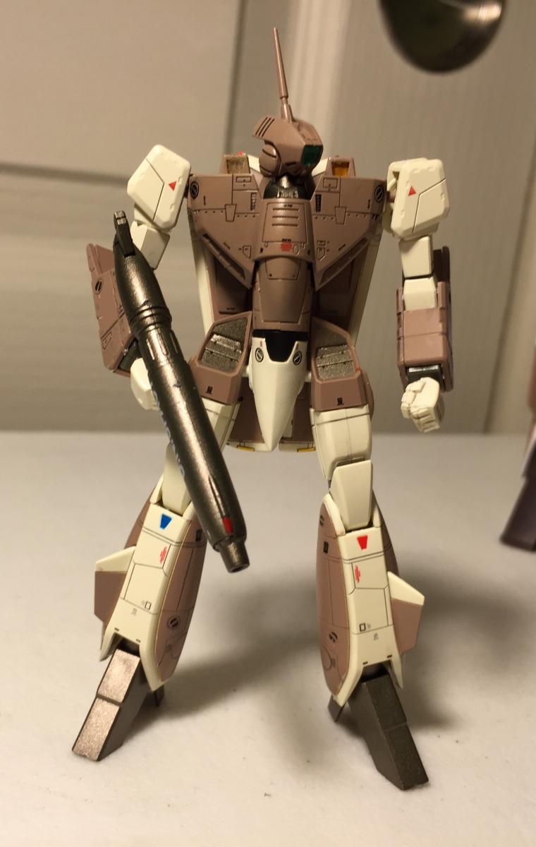

locidm Posted October 12, 2016 Posted October 12, 2016 (edited) Its possible but its not a fun experience which I would constantly do. Basically after I did it once I decided to not try to parts form them again out of fear that in the handling and disassembly process the pegs will break. Which is why many have suggested getting multiple sets if having all forms is a must. The have to do SuperPack versions. BRING IT! And after that, some VF-25 love! Luckily I did pick up 2 boxes of the dual mode 1A CF kits during HLJ's sale. Guess I'll build all 3 modes with the two kits. I only got one fighter and one battroid kit for 1S though, guess I'll have to give up the gerwalk there. Shame. I did just finish the 1A battroid last night, my first one. Looks great with wonderful details. I had to strip the inside of the lower leg part quite a bit to allow room for the foot connector (I think its fitment is derailed by the paint). Otherwise a relatively straight forward build. Have you guys been applying glue between the hip piece that connects to the crotch and the hip cover? I find the hip joint a little too loose but am afraid to apply glue there in case it gets stuck. Edited October 12, 2016 by locidm Quote

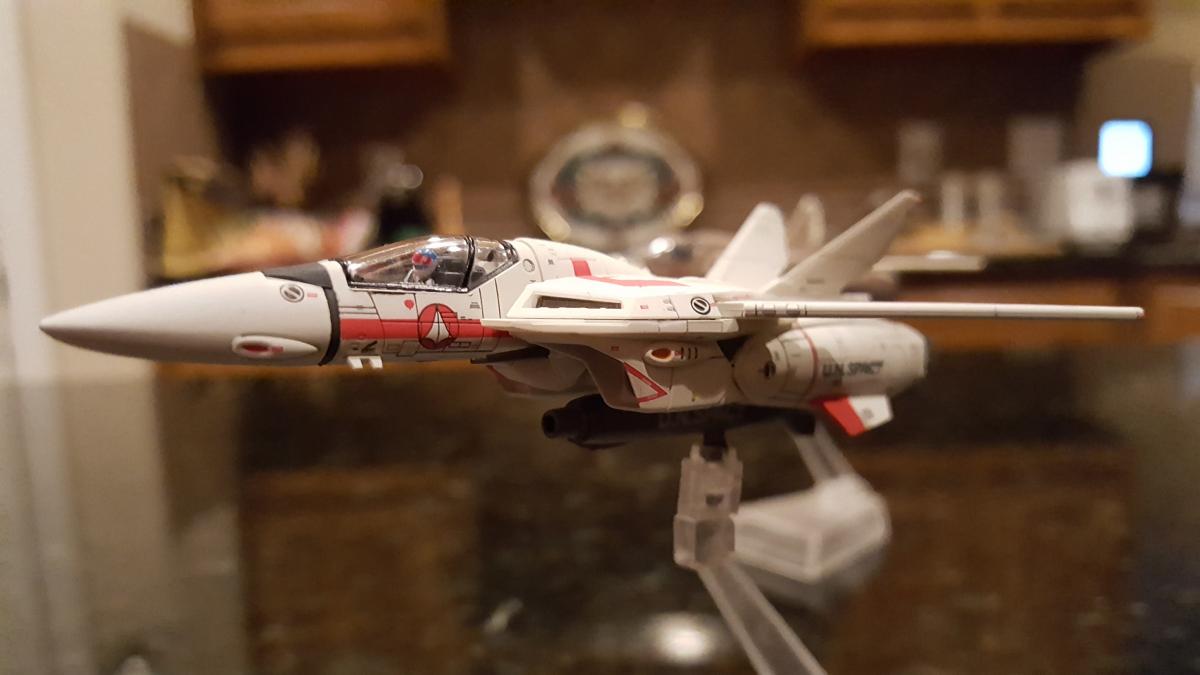

locidm Posted October 13, 2016 Posted October 13, 2016 (edited) Sorry to hear about your shipping issues!Have to say, it fairs pretty well against its bigger brethens! Edited October 13, 2016 by locidm Quote

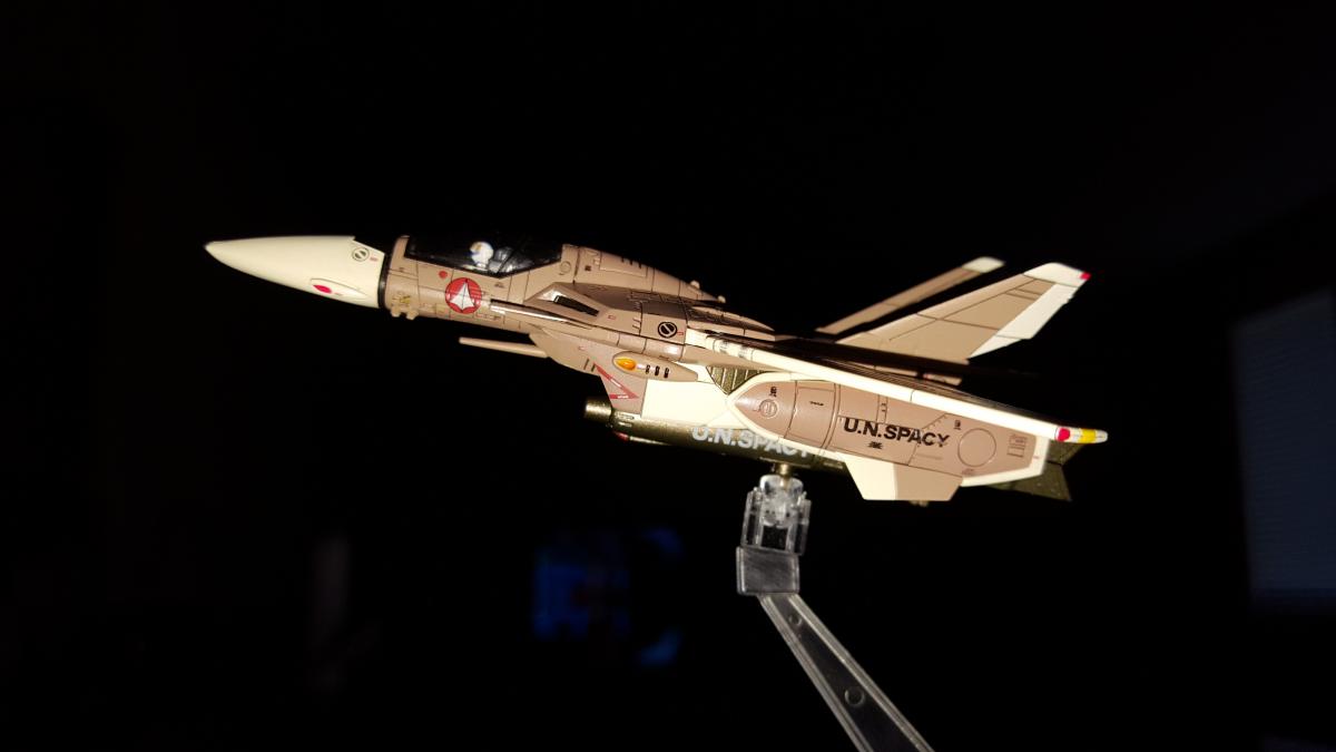

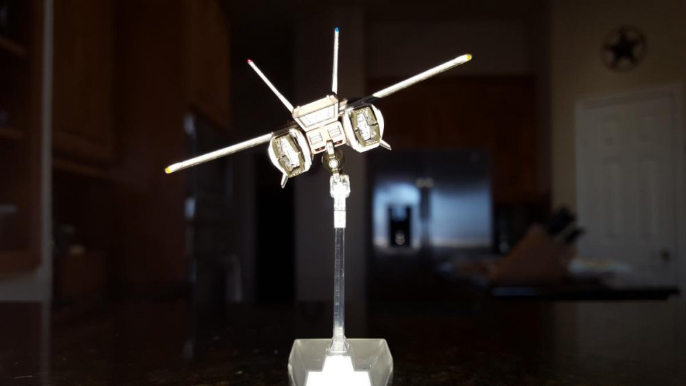

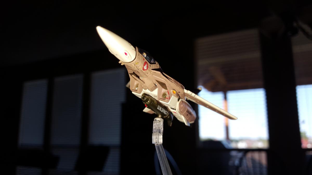

NZEOD Posted October 17, 2016 Posted October 17, 2016 (edited) VF-1 above the Dragon Carrier deck Engines Lit The Light Leakage issue... Easily fixed with some tinfoil lining inside the legs Edited October 17, 2016 by NZEOD Quote
GMK Posted October 17, 2016 Posted October 17, 2016 (edited) Just got the body, arms, & gunpod of my CF -1A Battroid together - wow! May ditch my Wave 1/100 kits. Edited October 17, 2016 by GMK Quote

NZEOD Posted October 17, 2016 Posted October 17, 2016 (edited) Only took an hour to do as well. Pretty simple to piece together. I had to glue the nose cone on and I've chosen to glue the tail fins and the legs to the body and pilot to the seat. Should be able to get it down to 45mins on the next 3. Used a blade to remove the items from the sprue instead of clippers and it worked fine. Each piece does need the sprue tabs in the parts trimmed off once its removed. Tamiya cement worked fine to glue everything including the nose blade antenna. Only bits that are easy to screw up are the feet/nozzles upside down and the LED Plates upside down in the legs. The electrical connection from the stand into the plane is a bit iffy and needs a little fiddling to get it to light up. The OP11 light unit needs 2 x LR44 Hearing Aid batteries, or you could mod it easily enough to run off a USB plug with a 100ohm (brown black brown) 1/4W resistor soldered onto the Negative/Ground wire of the USB cable. http://www.petervis.com/electronics/Standard_Resistor_Values/Resistor_Colour_Code/100R.gif Also... there is a piece of clear plastic film in the battery holder... its tempting to remove it but DONT. Its an insulator to stop that battery cell from shorting out. Edited October 17, 2016 by NZEOD Quote
