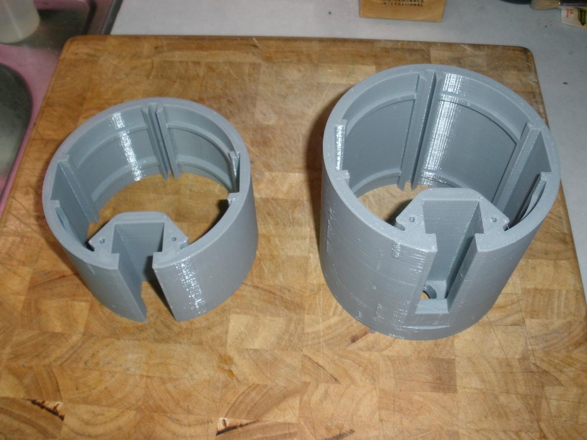

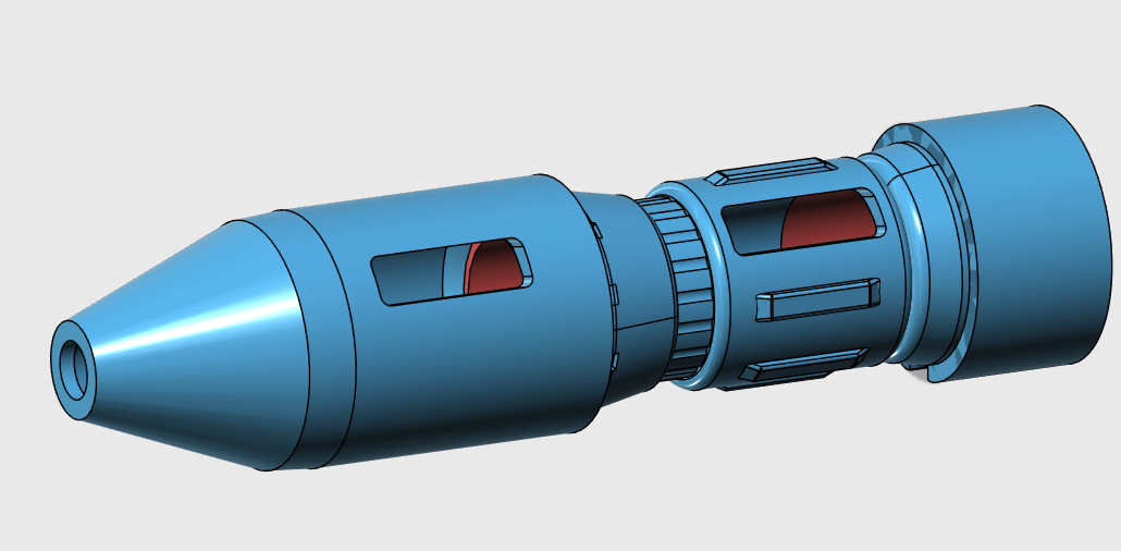

Bushwood3006 Posted September 20, 2015 Posted September 20, 2015 So a couple months ago I decided I wanted to get int 3D Printing. After tinkering a bit I wanted to do something cool. So I figured Gunpod. Been messing with Autodesk and here's what I have so far And after 12 hours of printing. The plan is to have it motorized with light and sound..... And maybe a smoke generator. I also need to thicken up the outside diameter Quote

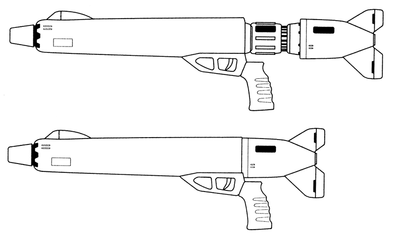

Bushwood3006 Posted September 20, 2015 Author Posted September 20, 2015 Using this for the dimensions. Scaled up about 4 or 5 times. But I'm going for more of the Yamato 1/60 pod. It's not gonna be 100% right size wise. I'm using 1/2inch pvc for the barrels so everything needs to be tweaked to accommodate it. Quote

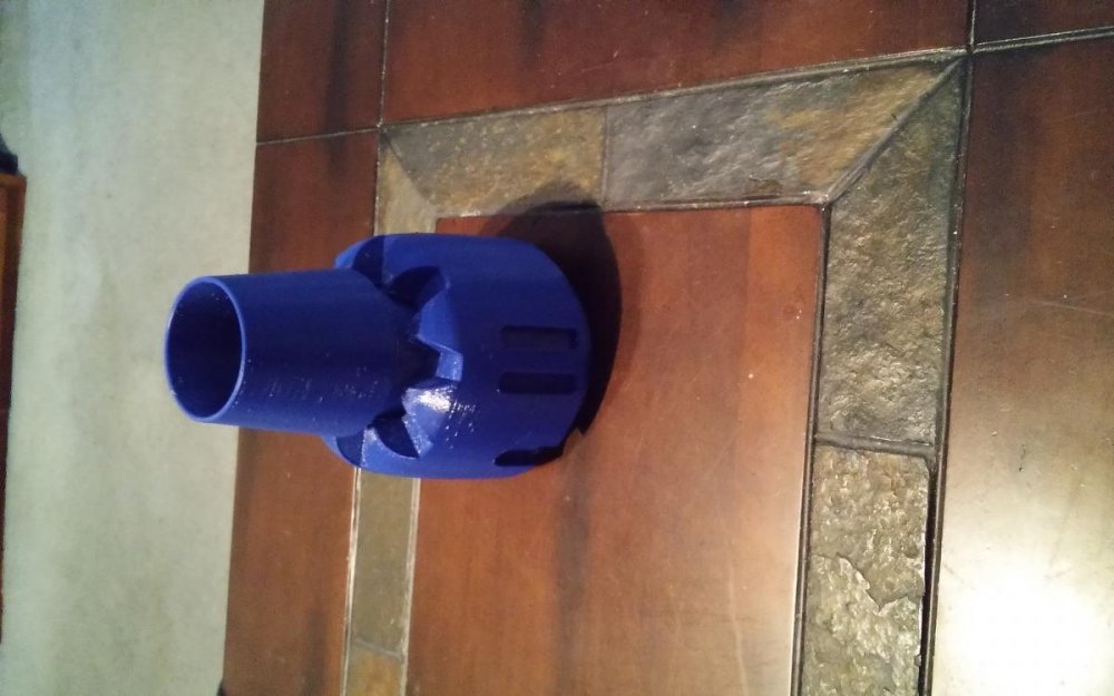

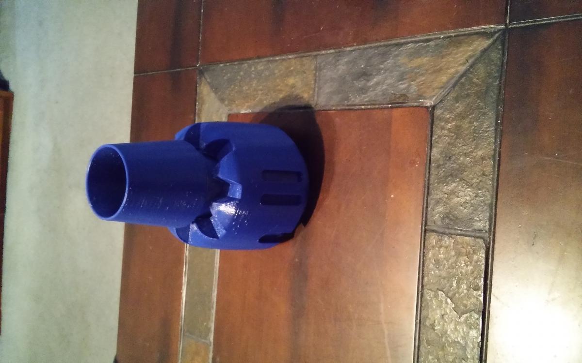

Bushwood3006 Posted October 1, 2015 Author Posted October 1, 2015 So after redesigning the front end to bulk it up. This thing is gonna be big and heavy. And time consuming. The new crown piece was a 12+ hour print. Quote

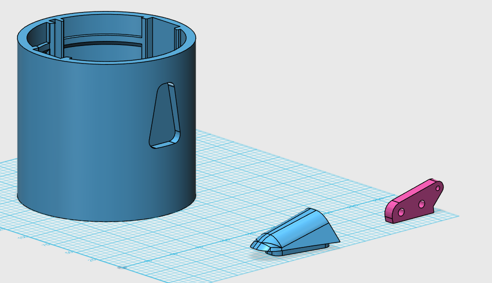

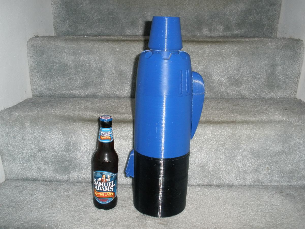

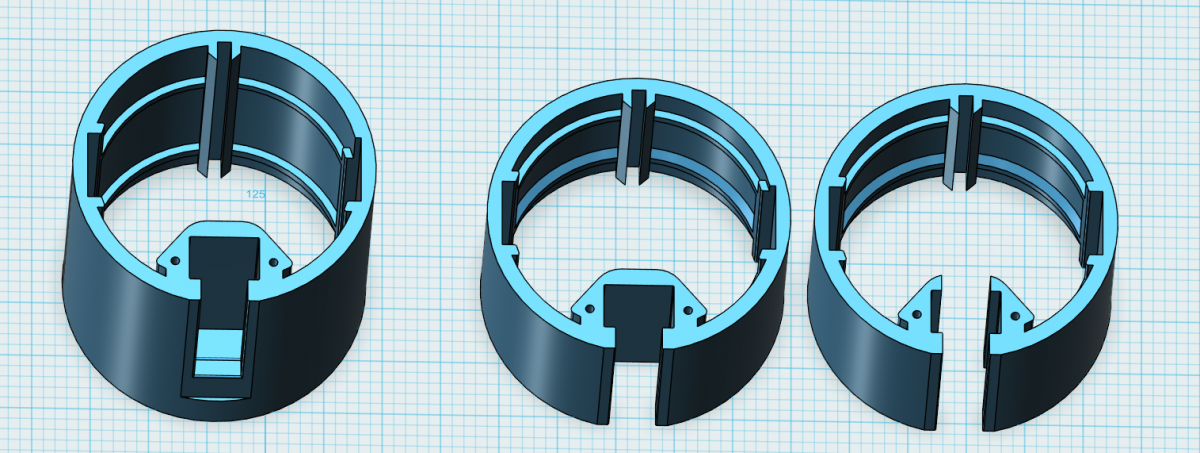

Bushwood3006 Posted October 12, 2015 Author Posted October 12, 2015 Progress so far. Unfortunately not a lot got done in the past 2 weeks, Added more pieces to the scrap bin than I did to the actual gun. A lot of lessons learned. Like when doing something for the first time with a new controller, DONT DO IT during a 16+ hr print. Had to print out the black piece twice because my controller does not lock the print head when its pause like my computer software did, and i shifted the print head when I went to change the filament (FML). Still fraked it up on the second attempt at it, but it was salvageable this time. I still need design the pistol grip assembly and make it so its removable. Redesigned Cad files , Progess so far for some scale Quote

MechTech Posted October 12, 2015 Posted October 12, 2015 Looks like it could shoot that beer bottle. Looking great too!!! Would you want to sell these? - MT Quote

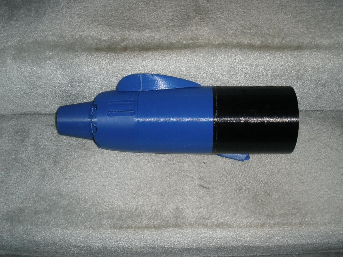

ce25254 Posted October 13, 2015 Posted October 13, 2015 Looks like you ran out of the blue spool and moved on to black! I bet this is heavy. Quote

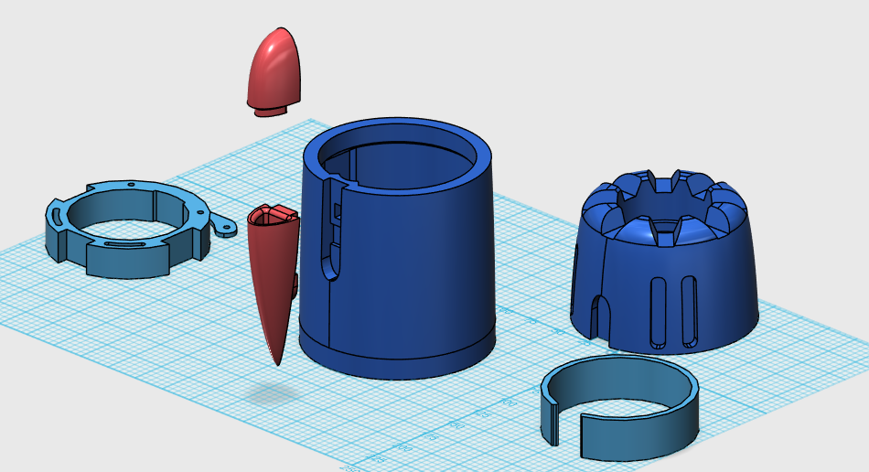

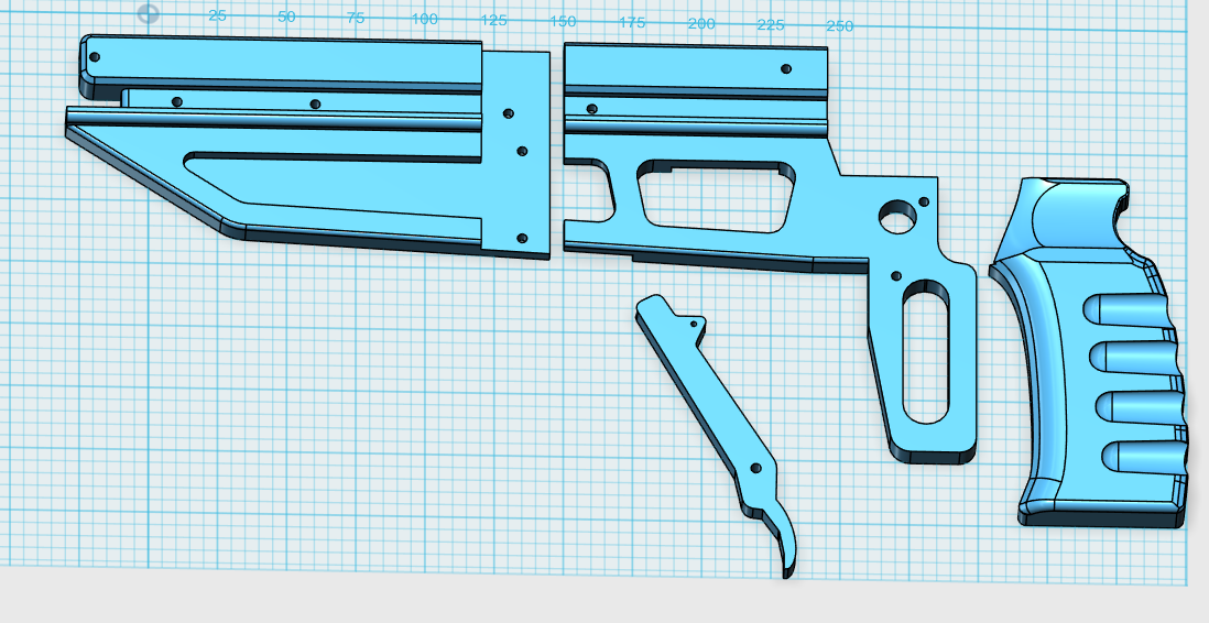

Bushwood3006 Posted October 19, 2015 Author Posted October 19, 2015 the Cad for the Grip and it's body section. This was a pain to model. Hard to figure out how to make it easily removable and sturdy. Plus i had too many crap on one screen causing the program to crash. Quote

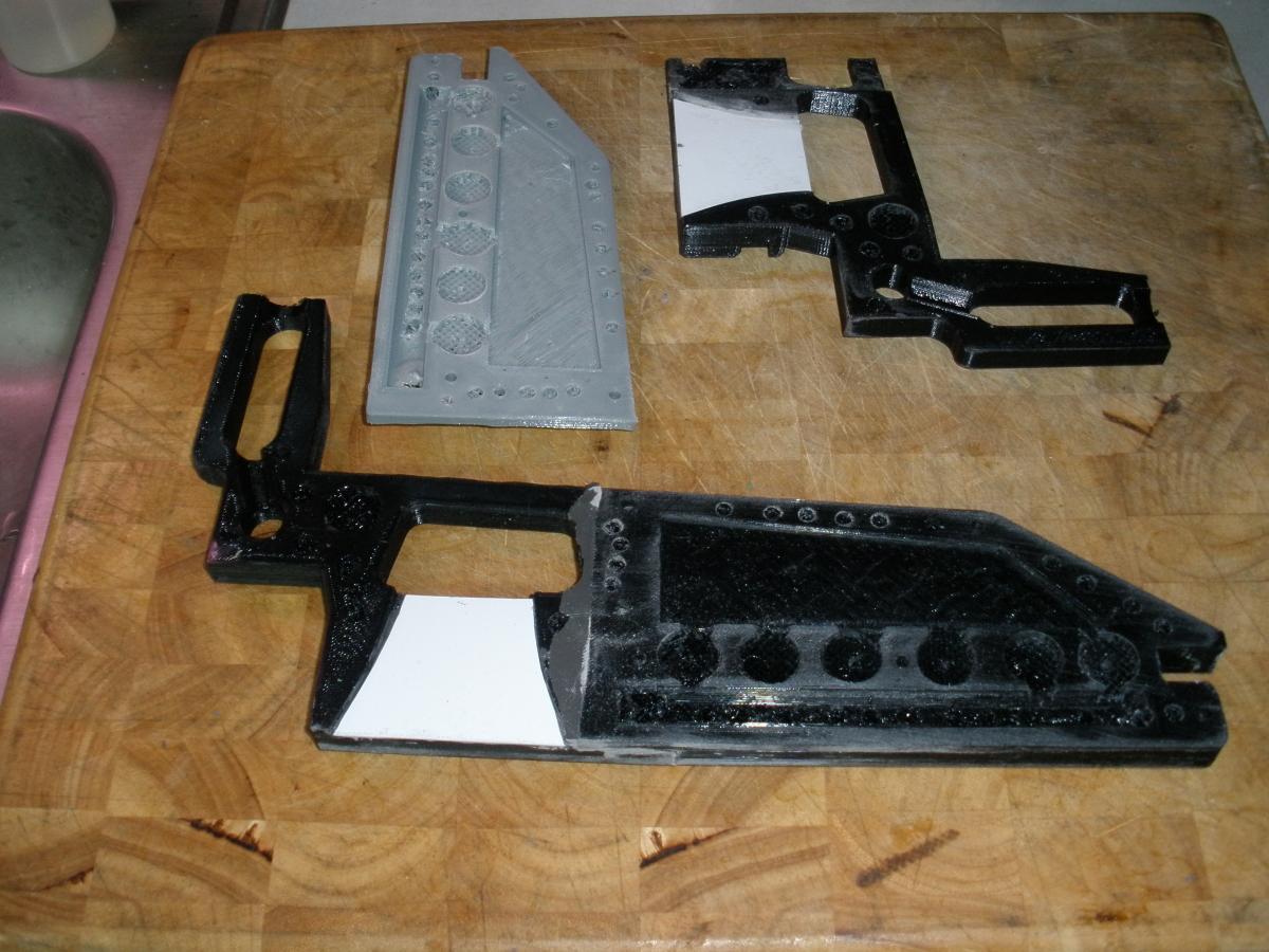

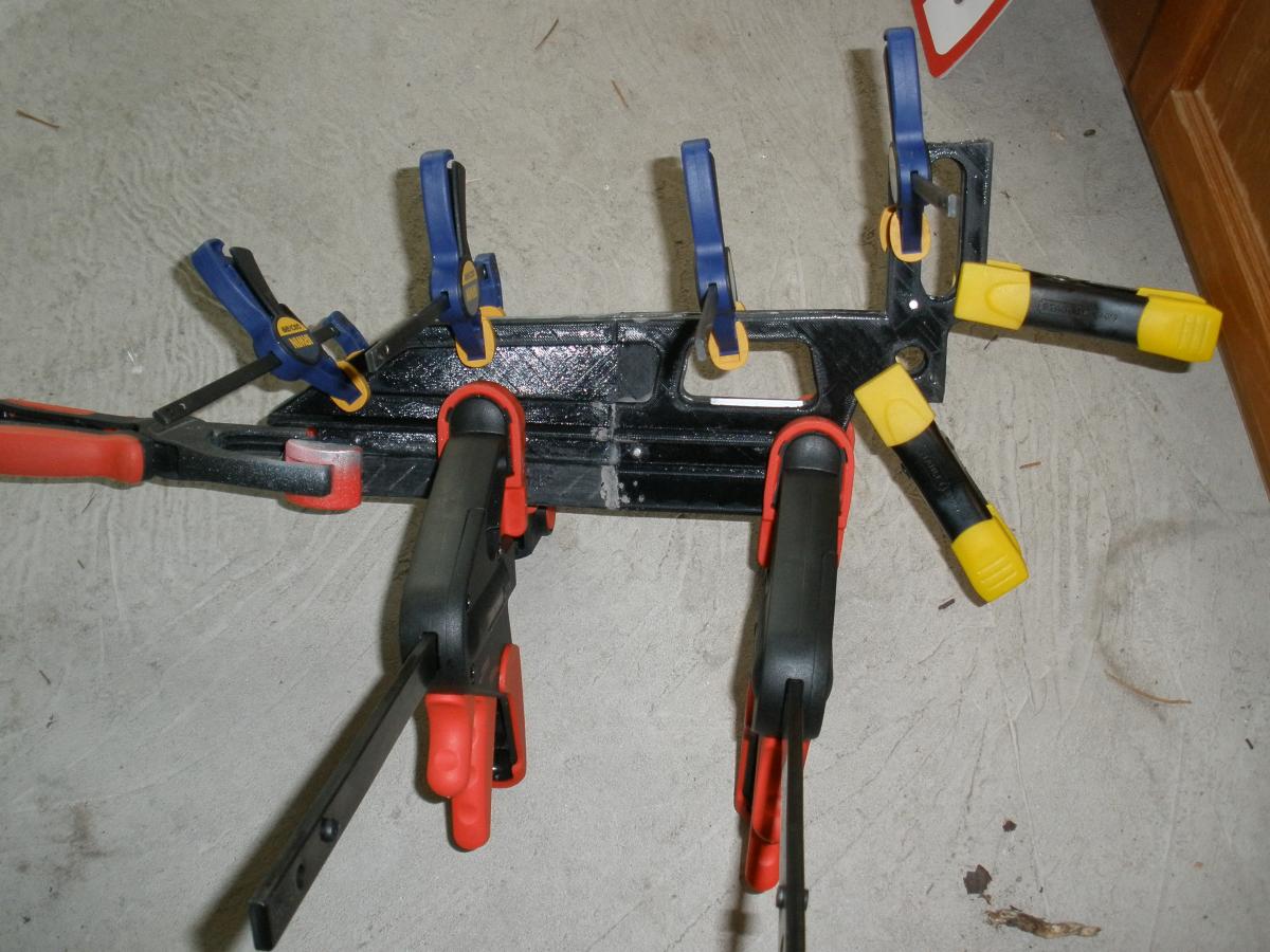

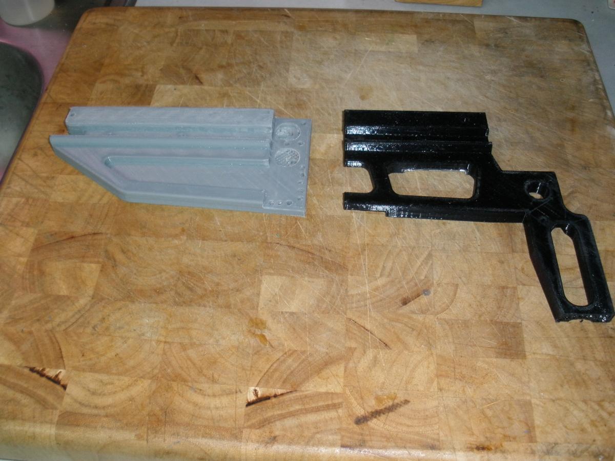

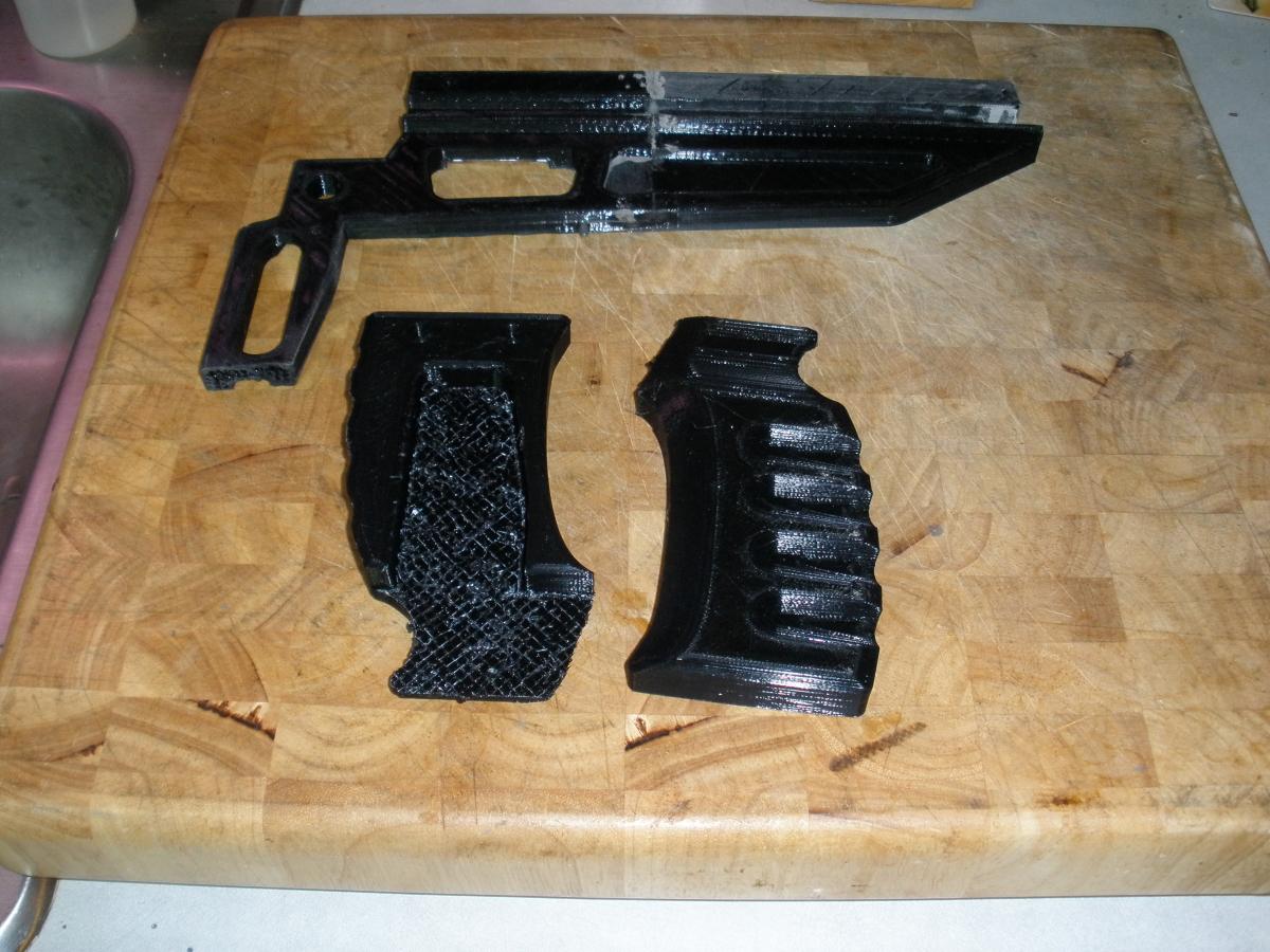

Bushwood3006 Posted November 2, 2015 Author Posted November 2, 2015 More stuff printed out. Had a few storms lately, and with prints between 10 and 15 hrs, lost a few pieces to power outages. Started gluing up the grip. (JB-weld is your best friend.) The holes drilled all along the seam edge is because i want to infill the piece with casting resin for added strength. so i needed to make sure it could flow everywhere. Also started work on the butt-stock and rotor assembly. Quote
MechTech Posted November 3, 2015 Posted November 3, 2015 This is coming along nicely! That sucks about losing power too. Keep it up! - MT Quote
Bushwood3006 Posted November 3, 2015 Author Posted November 3, 2015 This is coming along nicely! That sucks about losing power too. Keep it up! - MT Yeaa the last 2 weeks have been like... Oh crap its raining again. Please dont loose power, please dont loose power, please dont loose power.......F@#$!!!!! Quote
