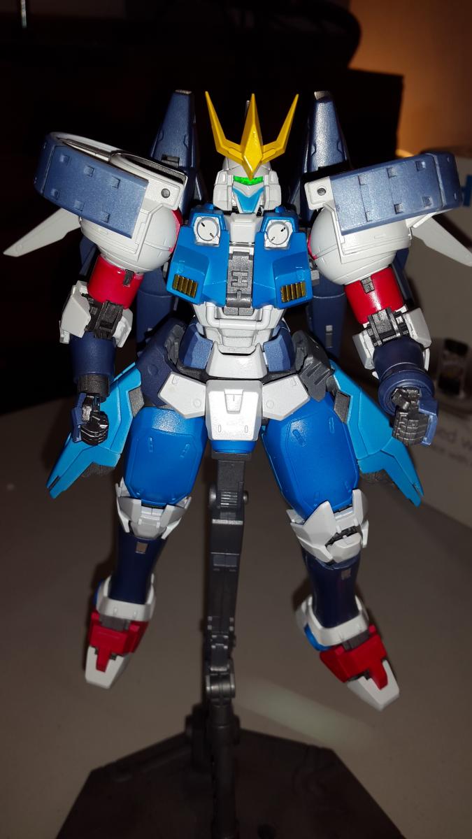

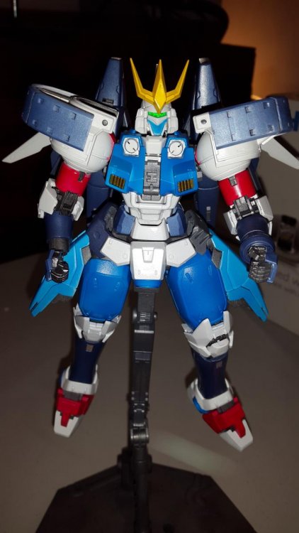

Mr Bomber Posted August 16, 2015 Author Posted August 16, 2015 (edited) thx for the tips guys! i tracked some revell glue and models, got a few models to practice with before going pro on valks. I made one, and so far was kinda easy but was a mess with the glue, it got everywhere, ill upload a pic tomorrow. Today i finished painting and futuring my very first model, here is a pic, let me know what you think still need to panel lined it, and set the decals, that would be done in the upcoming week if i got time. i know the paint scheme is a little childish/comic like, but i kinda went creative when painting it. Edited August 16, 2015 by Mr Bomber Quote
Model-Junkie Posted August 16, 2015 Posted August 16, 2015 Paint application looks great. What scale is that Tallgeese III? Quote
Mr Bomber Posted August 16, 2015 Author Posted August 16, 2015 Paint application looks great. What scale is that Tallgeese III? Thx that means a lot from someone called Model-Jukie!!, its 1/100 scale and really fun to work with, i got the gun and the shield too, but they were drying on the other side. Quote

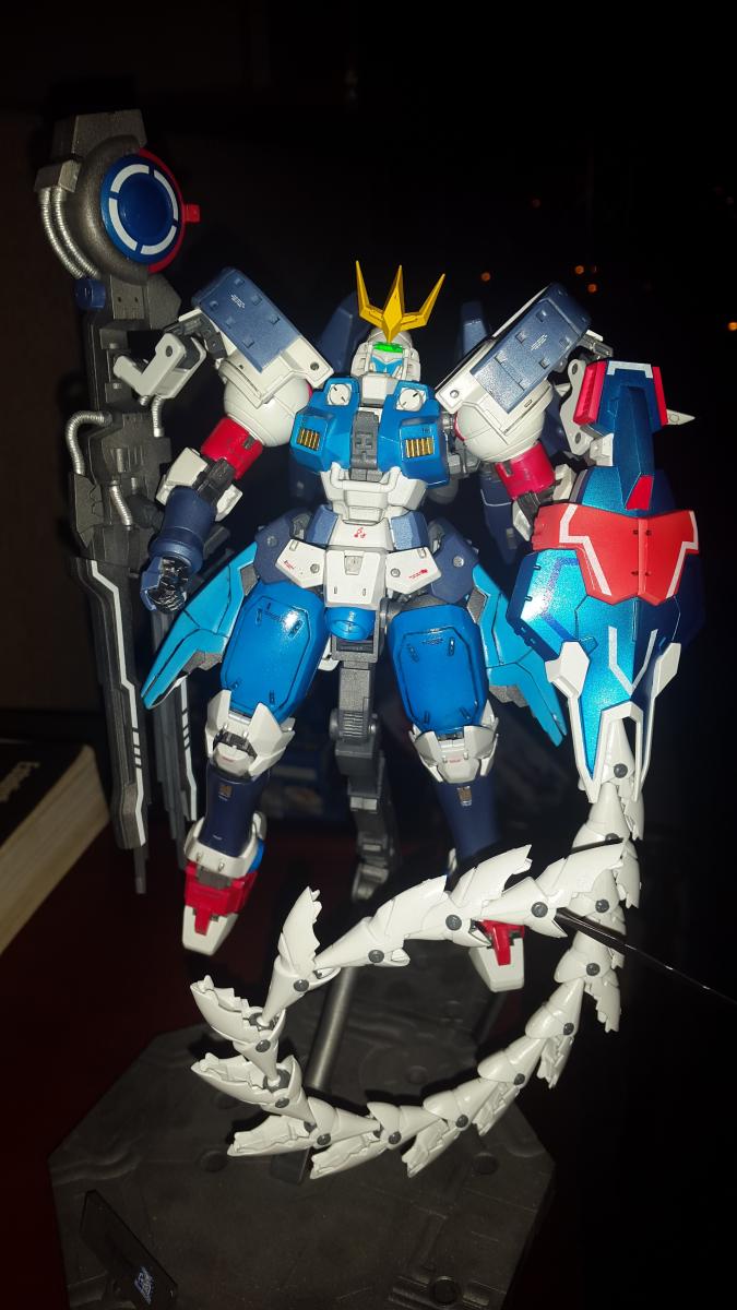

Mr Bomber Posted September 4, 2015 Author Posted September 4, 2015 BTW i finished my tallgese III. Its panel lined and i applied some decals on it, then futured again. please let me hear your thought on it. Quote
KH355hamdi Posted September 28, 2015 Posted September 28, 2015 When it comes to painting, less is more. Keep it original and simple. Quote
