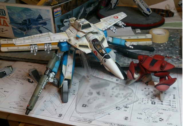

Mintox Posted May 17, 2015 Share Posted May 17, 2015 (edited) Awesome work. I love these mechs. They make no sense but then who cares right? What scale is this? Edited May 17, 2015 by Mintox Quote Link to comment Share on other sites More sharing options...

Cesar Enrique Posted May 18, 2015 Author Share Posted May 18, 2015 (edited) I wonder why the topic was moved to "Anime and Sci-Fi" where you can post off topic if the Inbit is a Robotech character, and it is a Kit. Awesome work. I love these mechs. They make no sense but then who cares right? What scale is this? Althought it is 1/48th scale the kit is pretty small, watch it compared to a 1/72 Gerwalk: Great job! I've been contemplating whether to weather the Inbit kits. I really like the shading you did. If you make it weathered I deffinitely want to see it, I was very tempted to do it that way...I still have the second baby crab, so... Edited May 18, 2015 by Cesar Enrique Quote Link to comment Share on other sites More sharing options...

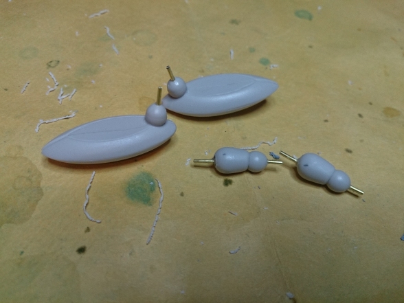

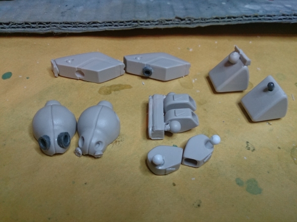

DarrinG Posted May 18, 2015 Share Posted May 18, 2015 The eye looks great that way. I will not be doing LEDs in mine so maybe I will try the same as you. If you have time, please post some more detail about which joints you switched for ball joints . . . Quote Link to comment Share on other sites More sharing options...

derex3592 Posted May 19, 2015 Share Posted May 19, 2015 If you have time, please post some more detail about which joints you switched for ball joints . . . Yes! I would love to learn how to do this as well! Quote Link to comment Share on other sites More sharing options...
Cesar Enrique Posted May 19, 2015 Author Share Posted May 19, 2015 I hope this helps: You can see a comparison between original parts vs parts that were modified or prepared for pinning and ball joints. Basically I cut the original resin joints, sanded the area, and used a dremel tool and a pin vise to fit the new ball joint system, I used cyanoacrylate to glue them in place, then I primed, masked and painted as usual. For other parts, I just used brass beams and cyanoacrylate. Quote Link to comment Share on other sites More sharing options...
DarrinG Posted May 19, 2015 Share Posted May 19, 2015 It does help - thx. Some of the ball joint systems I have worked with, the socket will unexpectedly crack - and need replaced. Which would be painful if its already been mounted in and painted like you've done . . . Quote Link to comment Share on other sites More sharing options...
